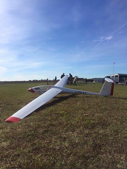

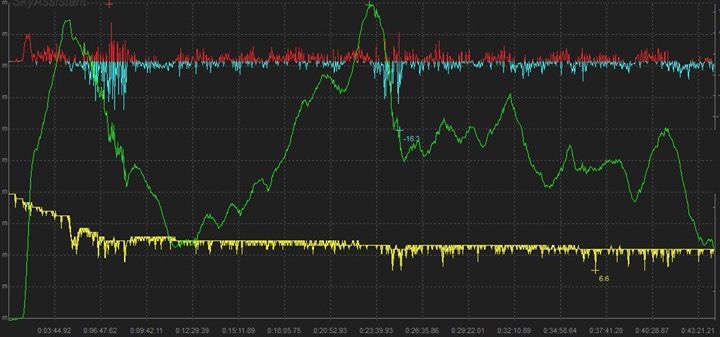

                    Just a teaser, here is yesterday flight, pict of the bird and snapshot of the vario log
                    For the trolley you can not go wrong with the horizon hobby one, they designed it for the ASW-20
                    Stephane

                    As for the trolly (http://www.horizonhobby.com/launch-t...20-p-han495509) they are all out of stock as (they have been pulled from stock - not the correct item (in Picture) being sold) I can't find one. If you know where one is I will be glad to order. Tried with Graves as well - pulled from stock. I think there has been a mix up on products somehow.
                    What was the altitude on the vary - I was not able to see left hand column...

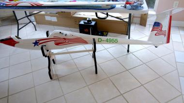

                    • Well guys I wanted to show you my patriotic spin on the ASW-20. Decals where designed by and purchased from Callie Graphics. Enjoy
                      • I LIKE THAT ! Callie comes thru again.
                        • BobR
                          BobR commented
                          Callie, placed her on their web page. I am honored
