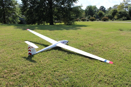

            Here are pics of mine! Graphics by Gary Sibert of Decal-It are the white stars, flags on fin, number '57' and 'N' numbers on fuse. The rest is blue paint and clear coat on nose and red Monokote on rudder and blue Monokote on wing tips.
            • French1
              French1 commented
              Mike, can't wait to see it in person for Winamac
              See you there
              Stephane
            • Dion Dunn
              Dion Dunn commented
              Saw it in person today. Really, really nice looking ship!
