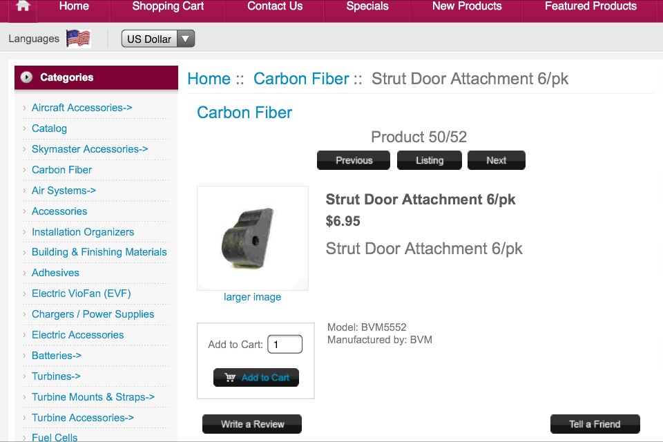

            Originally posted by gunny11 View Post
            I never use rubber bands for anything because they just don't last. Instead I use very lightweight Springs with BVM door anchors. This is for the retractable landing gear doors.
            What are BVM door anchors and where did you acquire them?

            • #82
              Bvm jets strut door attachments. You Really don't need it! a piece of hardwood would work just fine.
              Gunny
