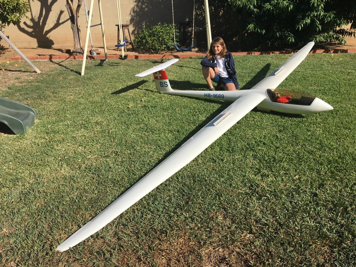

  • Hey Kevin,
    Looking good brother!!
    Congrats
    • I agree Kevin, Looks great!! Cool scheme and red always looks sharp. Keep the nose down in the pattern.... Cumby in March? Hope the weather cooperates. The Blanik is probably thankful that there is another glider in the stable to lessen the spar bending passes! Fly safe.
