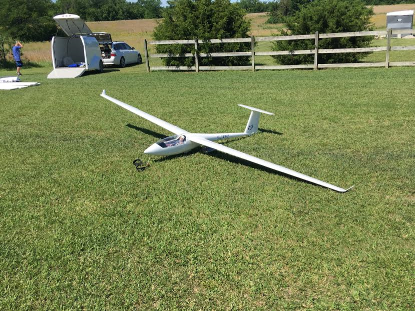

                    • This ASW belongs to Cecil Davis one of our club members....first flights were last Saturday with the expected results.....flew GREAT !
                      • Nice winglets!
