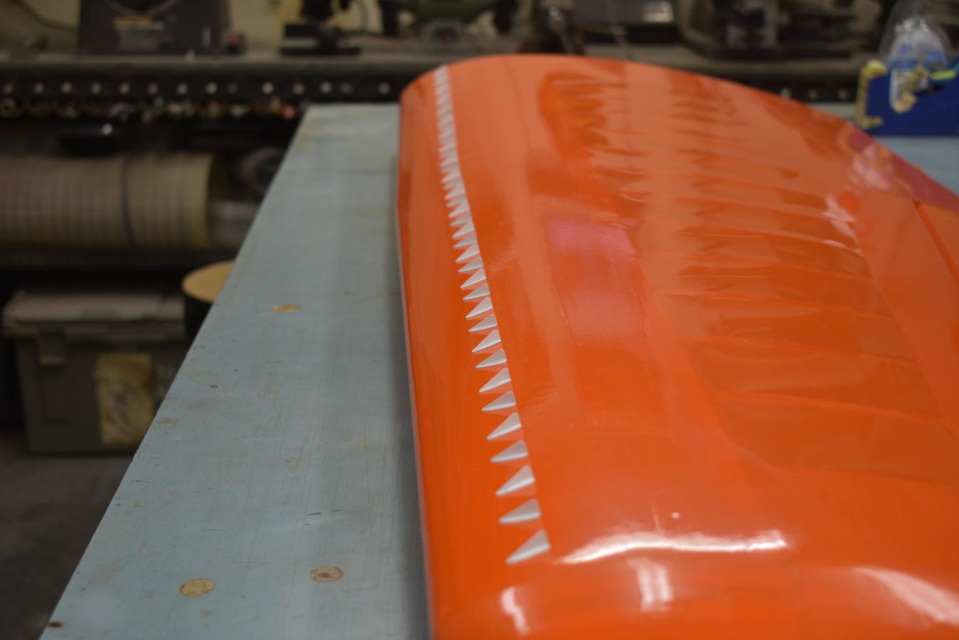

            • As of post #215 the vortex generators are figured out and done.

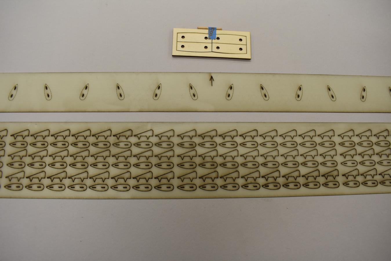

              • This will be an optional kit laser cut out of .015" thick G-10. It includes a manual and drawing and a G-10 template with a gluing jig.

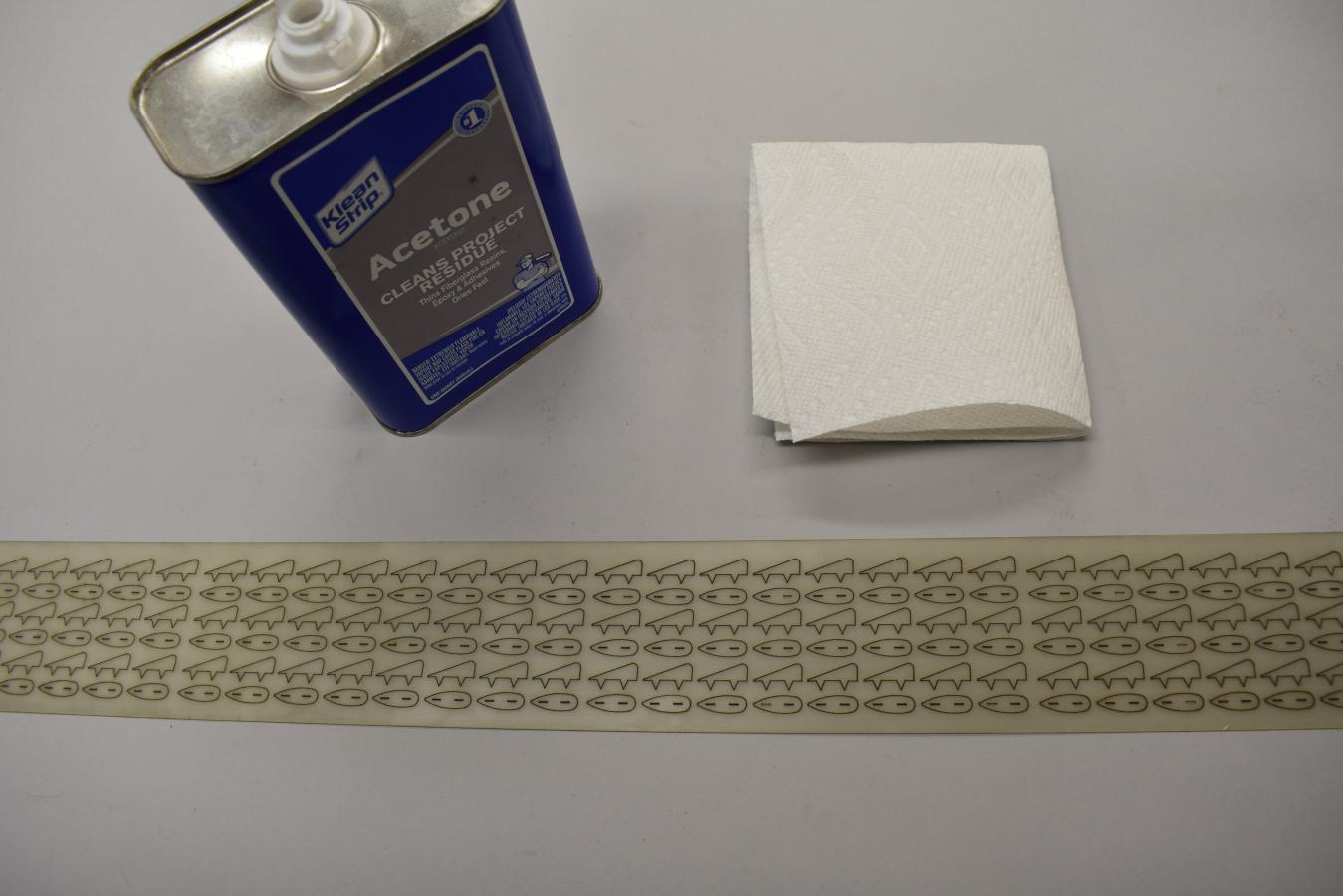

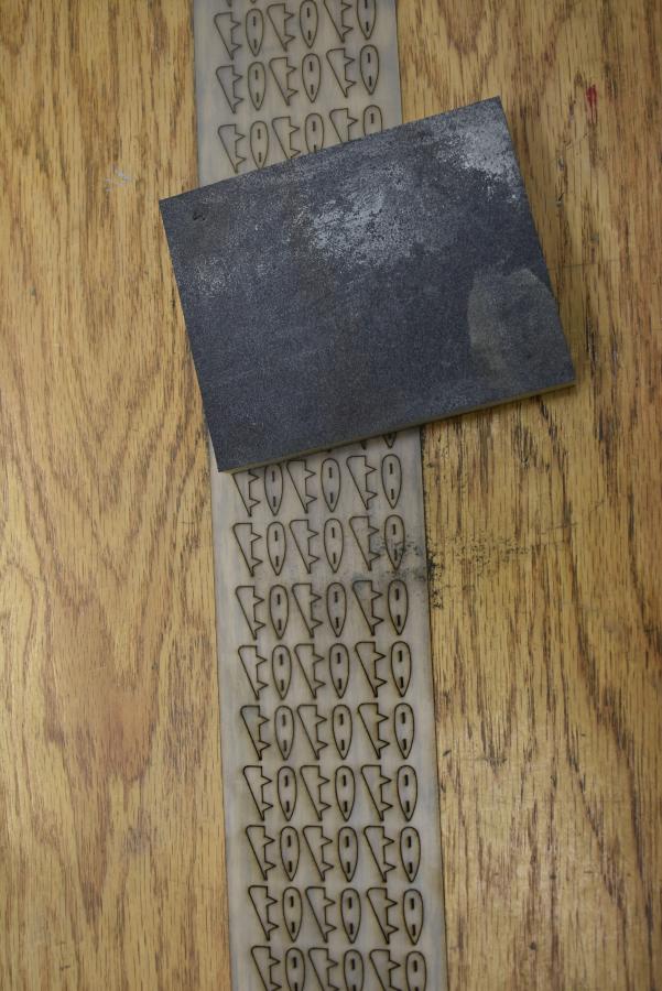

                • First is to clean the soot off the sheet.

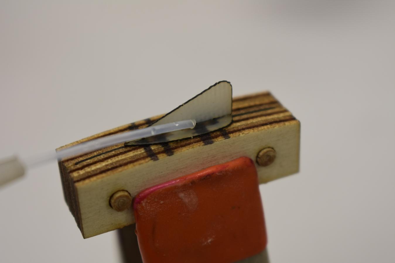

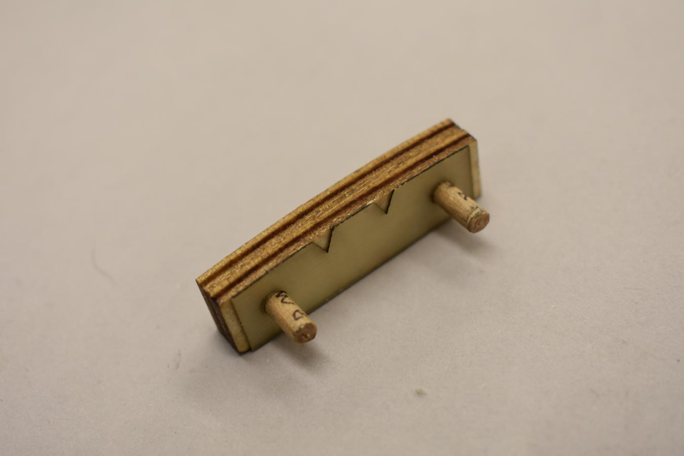

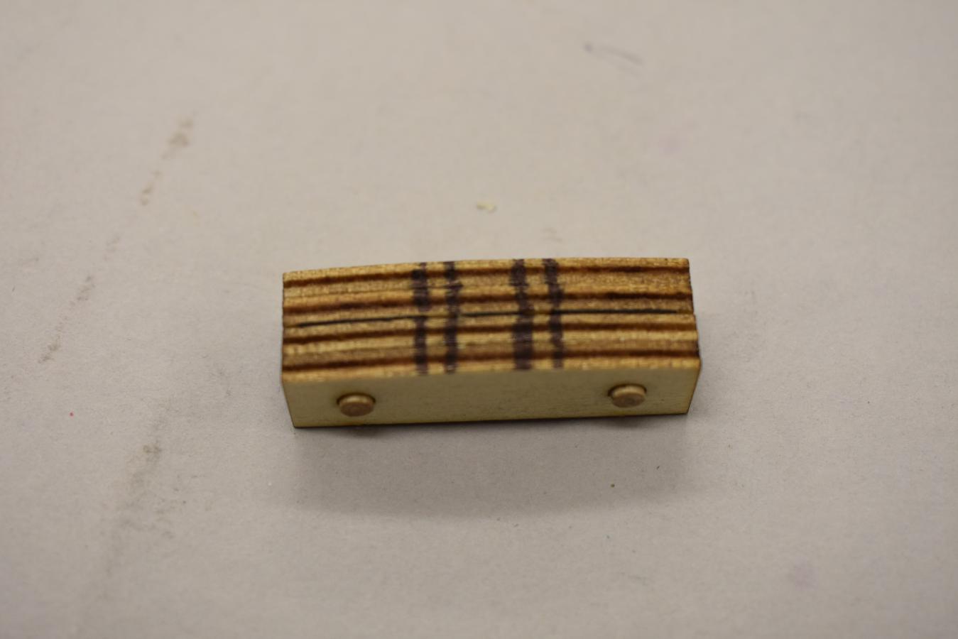

                  • Then the gluing jig is assembled.

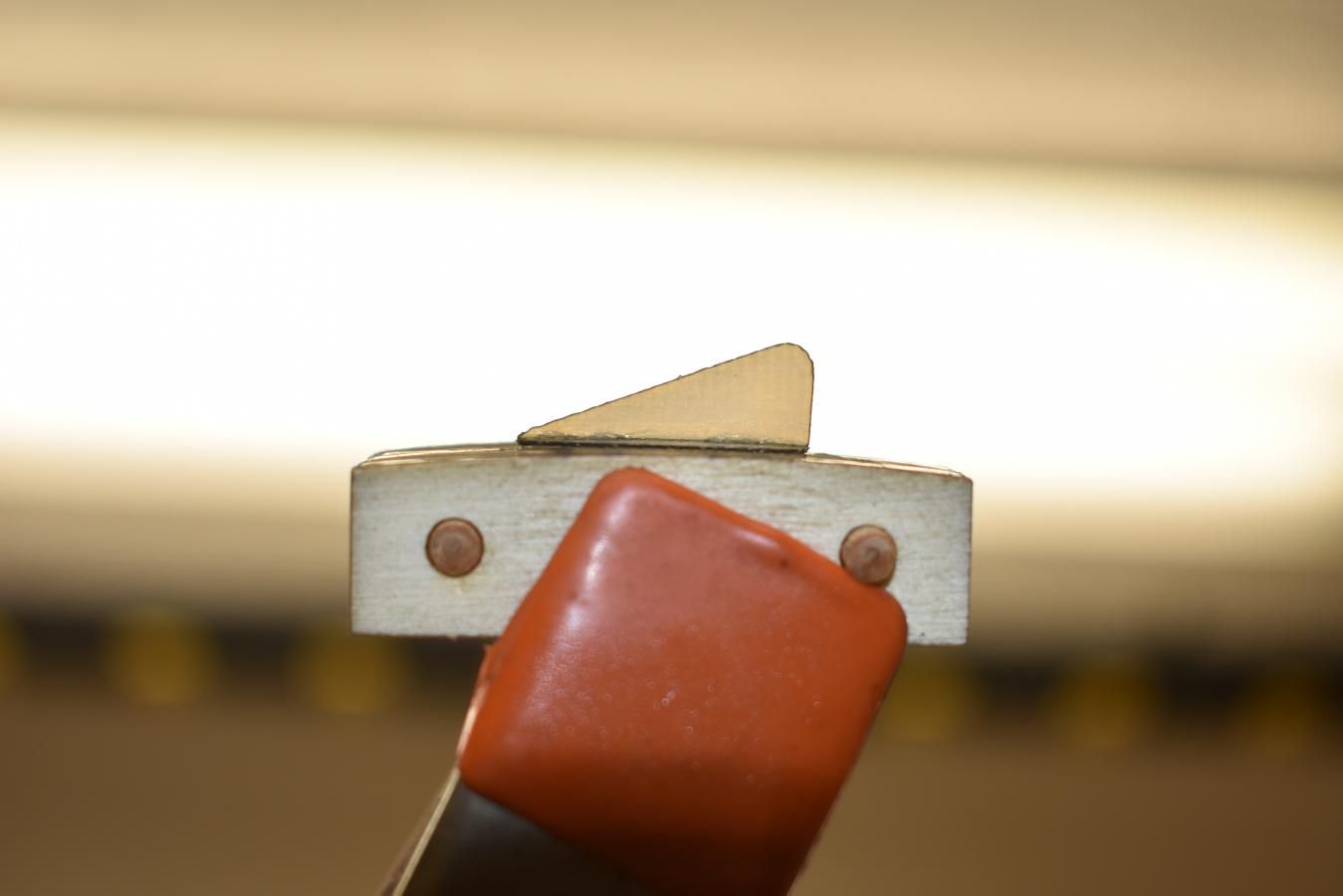

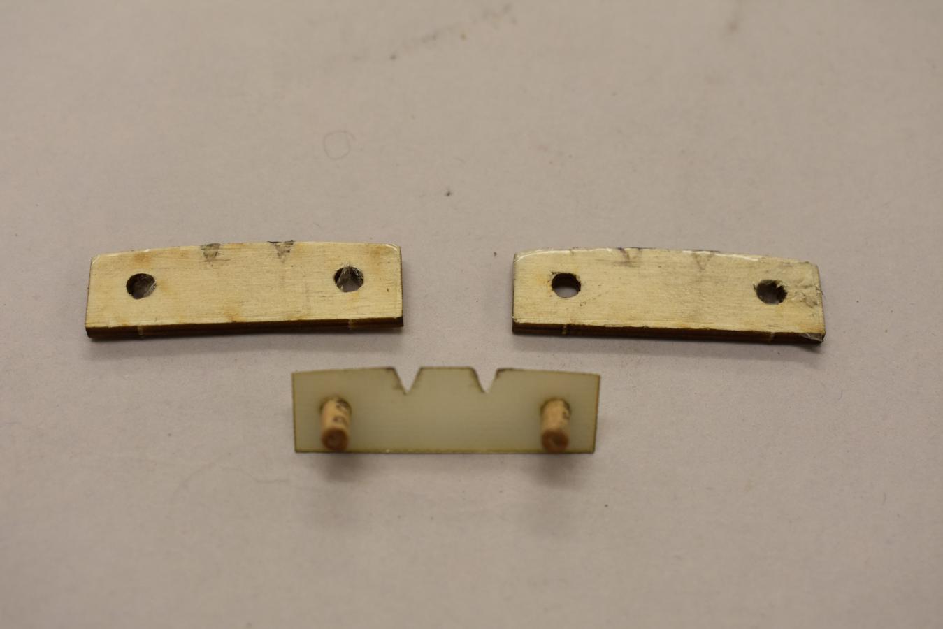

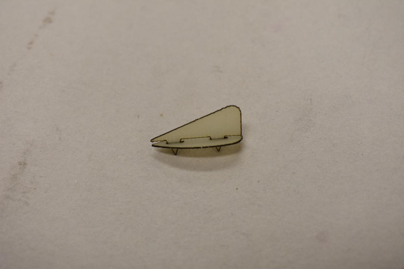

                    • The fin and base are assembled and inserted into the jig. Bead of CA glue is added and repeat.
ID:	39522 Click image for larger version
ID:	39523 Click image for larger version

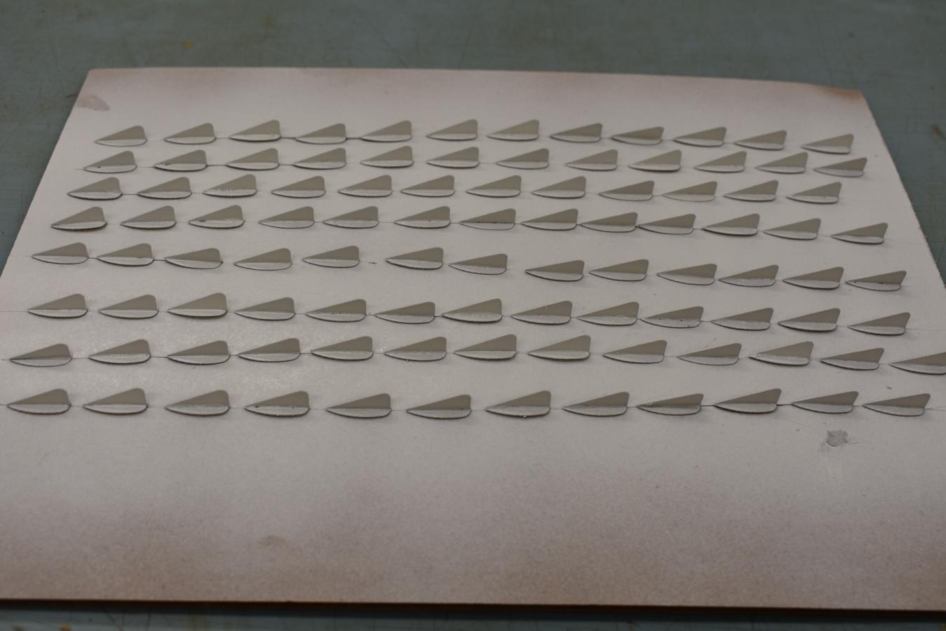

                      • A whole lot of them and a few spares done and stuck into cardboard for priming and paint.

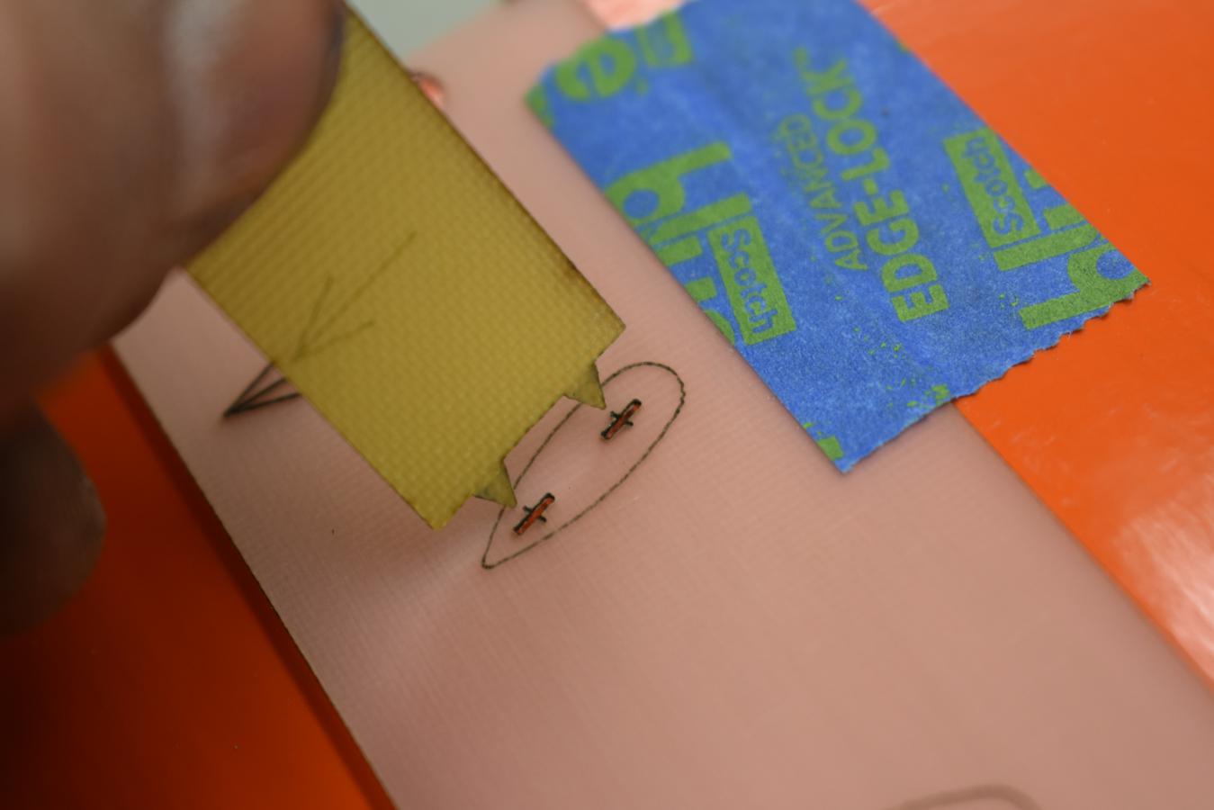

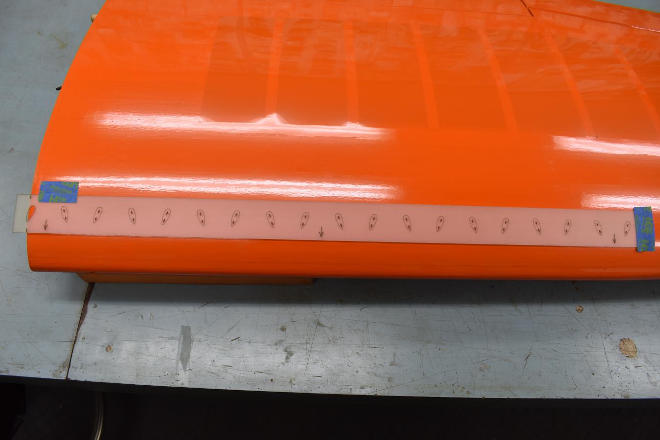

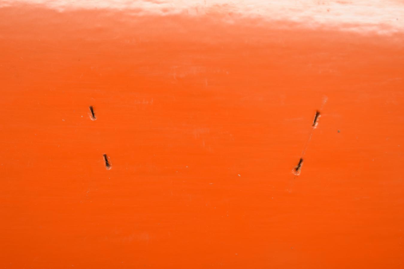

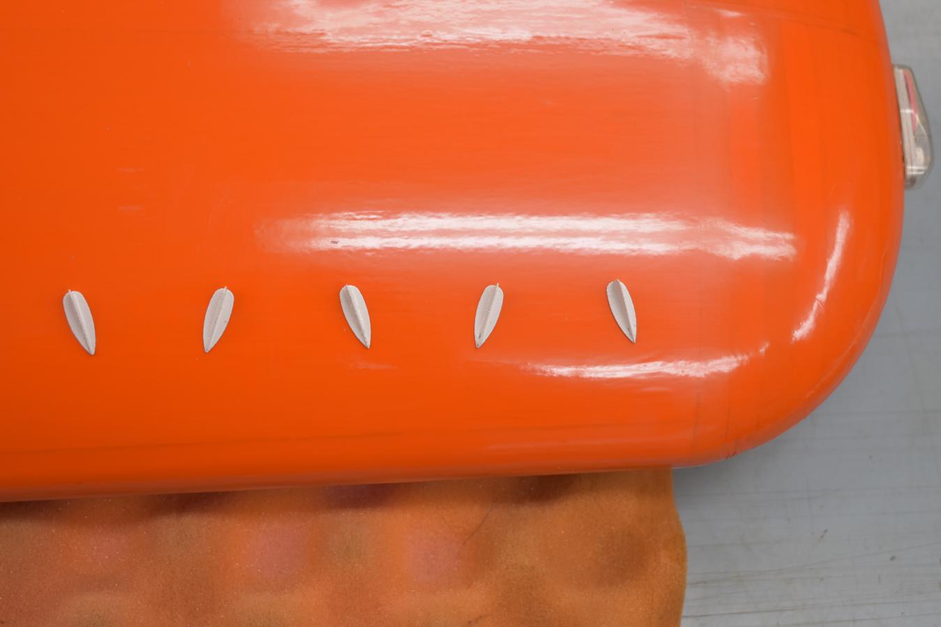

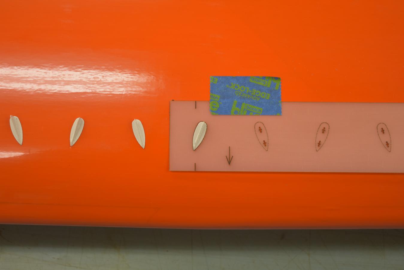

                        • The drawing shows dimensions for positioning the template and it is taped into place. Then a knife and a piercing tool is used to puncture the skin. Once you have done the entire length of the template, it is removed and the individual vortex generators are glued on.

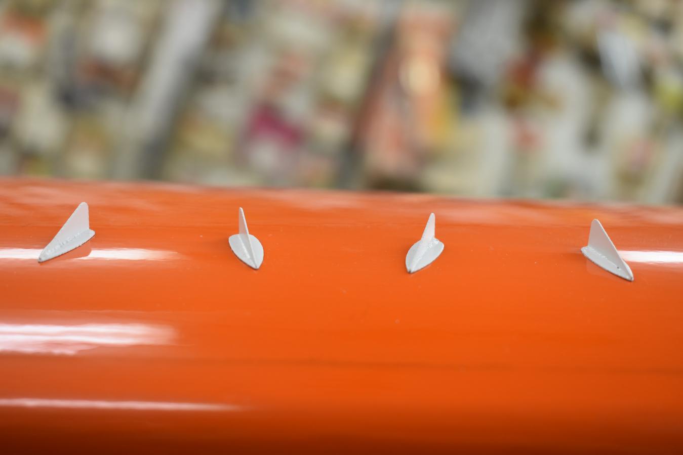

                          • The end of the template is moved over and slips over the last vortex generator and the process is repeated.
