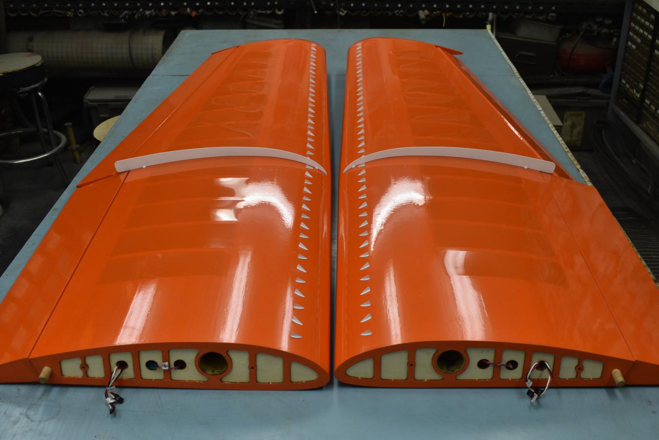

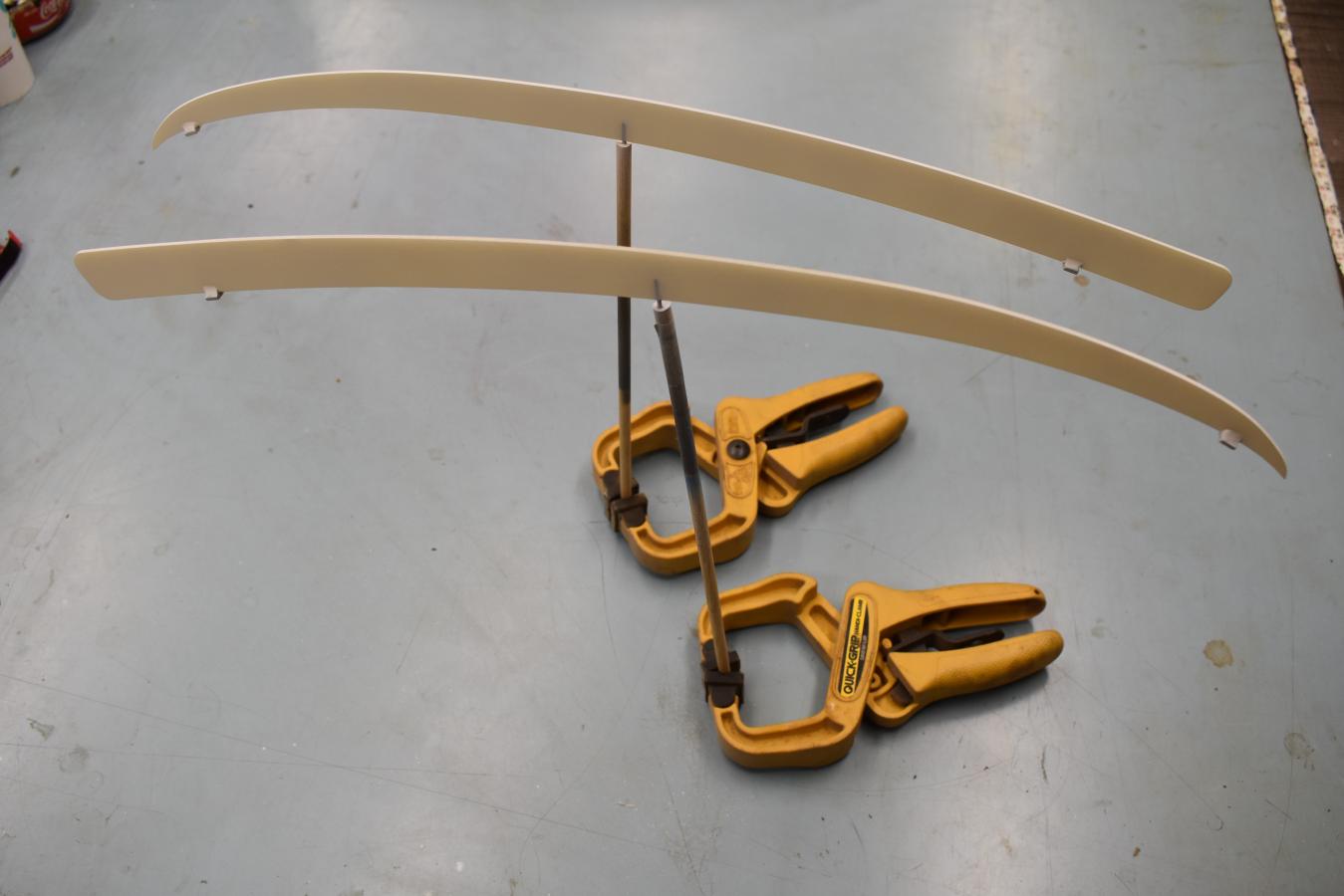

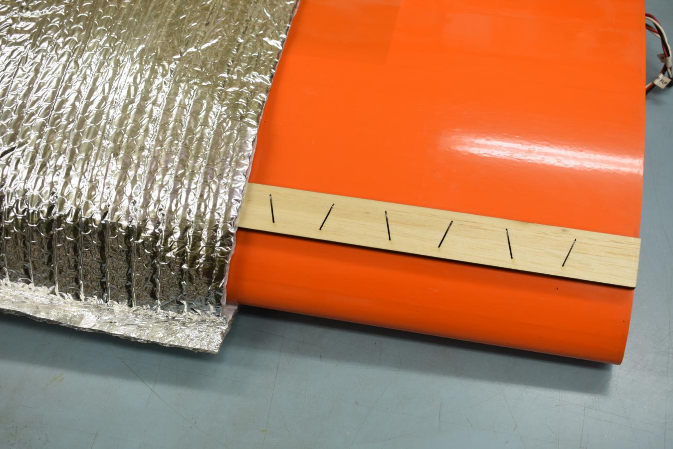

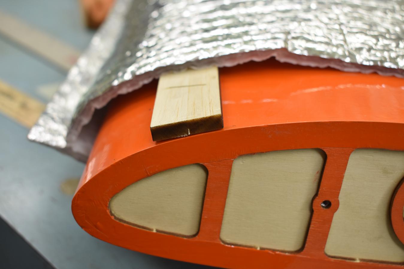

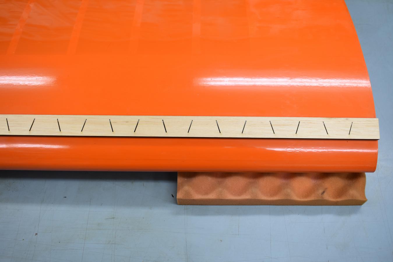

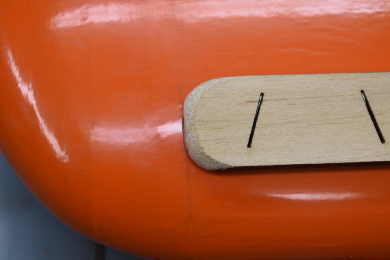

  • !/4" thick balsa protective strips are provided to keep the vortex generators safe from transportation etc.
    • And that's it for now folks.
        Amazing...simply amazing!!!
        Beautiful work there Gunny, you are a scale master class fabricator and builder!
      • MarnochS
        MarnochS commented
        Two Thumbs Up.....
    • Sometimes I want to just find something wrong with your setup just to be right once in a while. But its impossible. Really nice execution Gunny. The transportation strips are a home run.

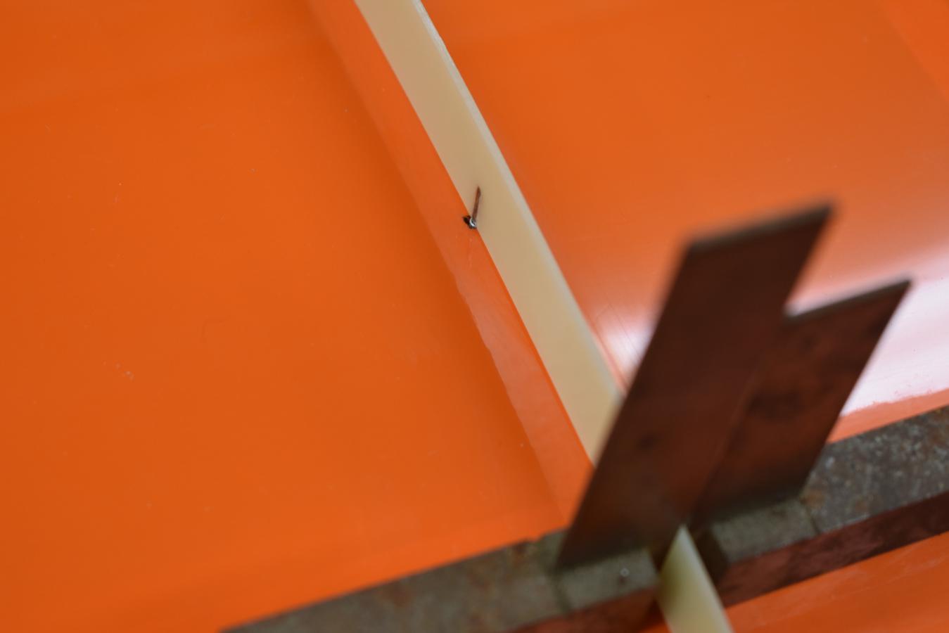

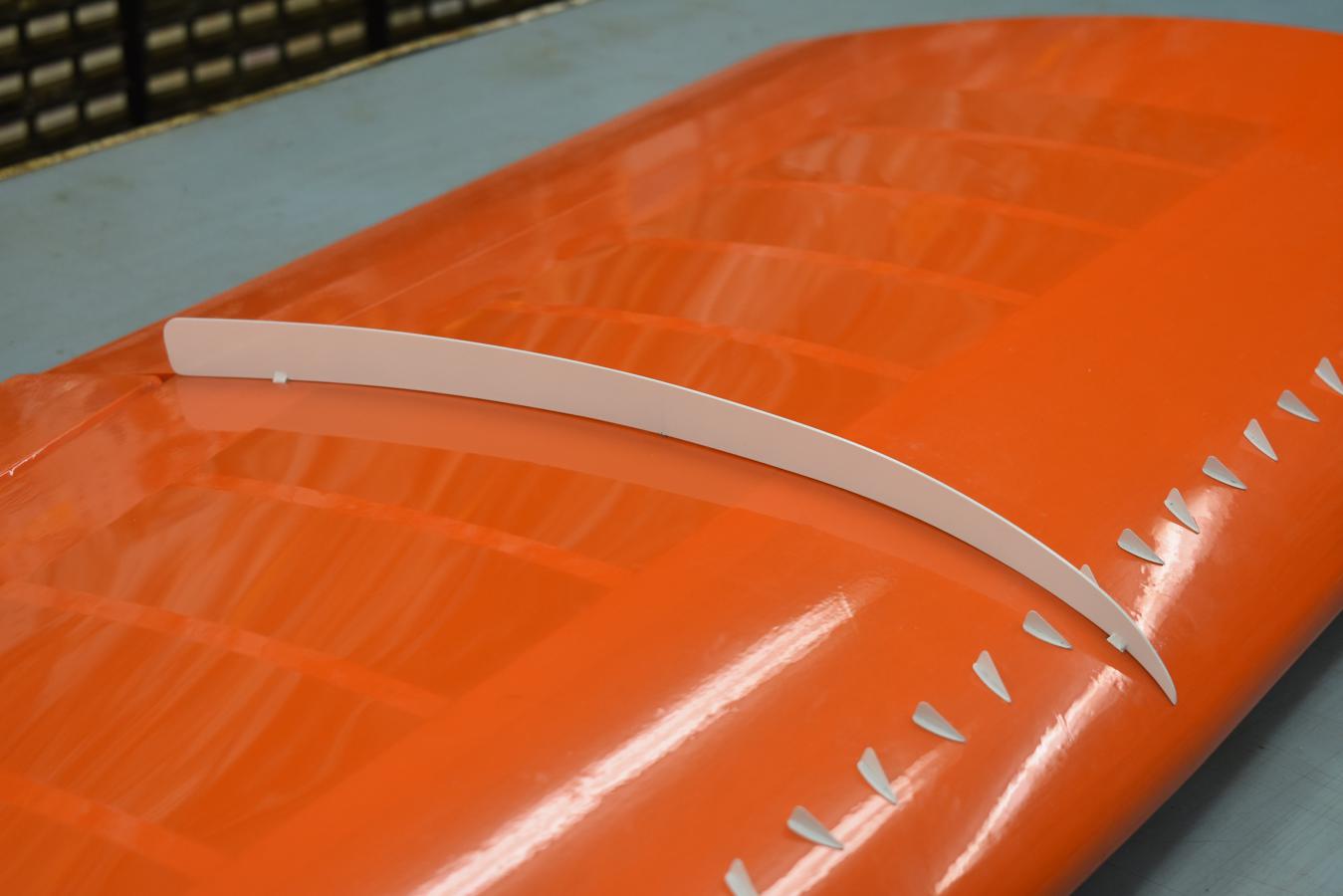

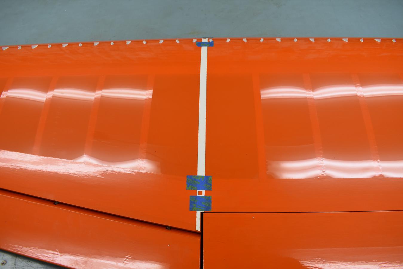

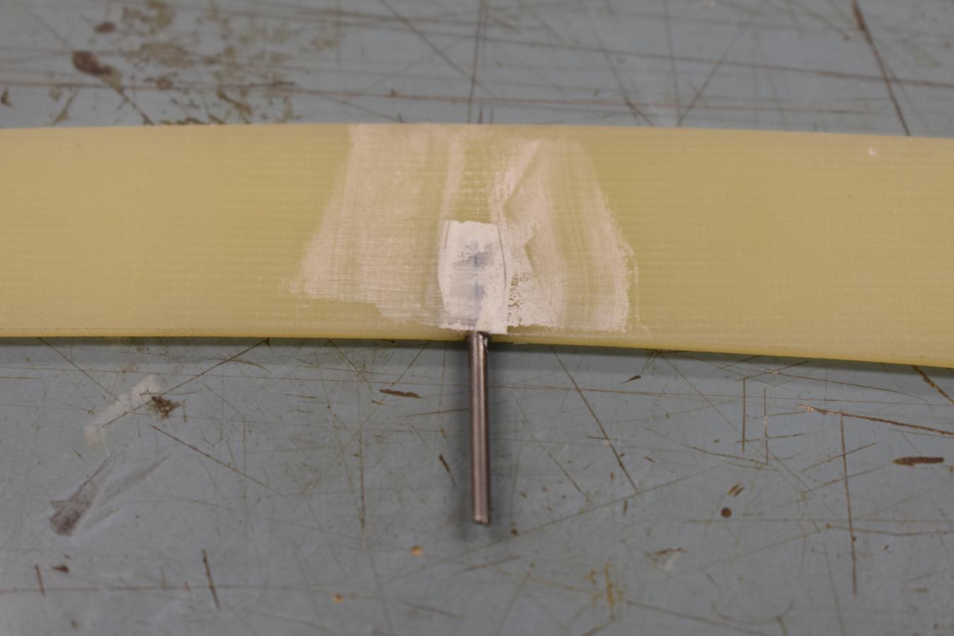

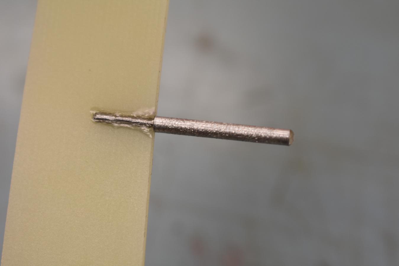

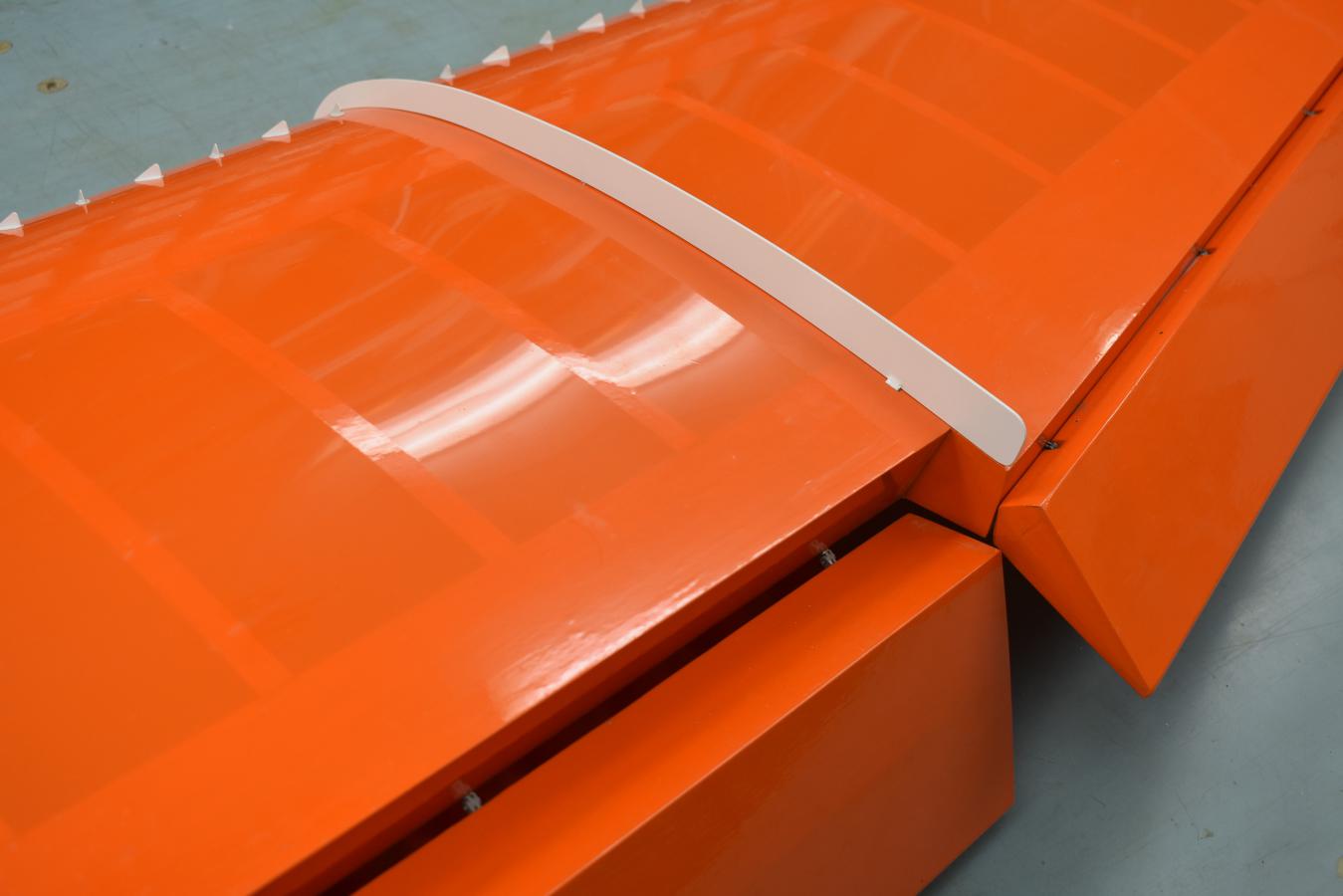

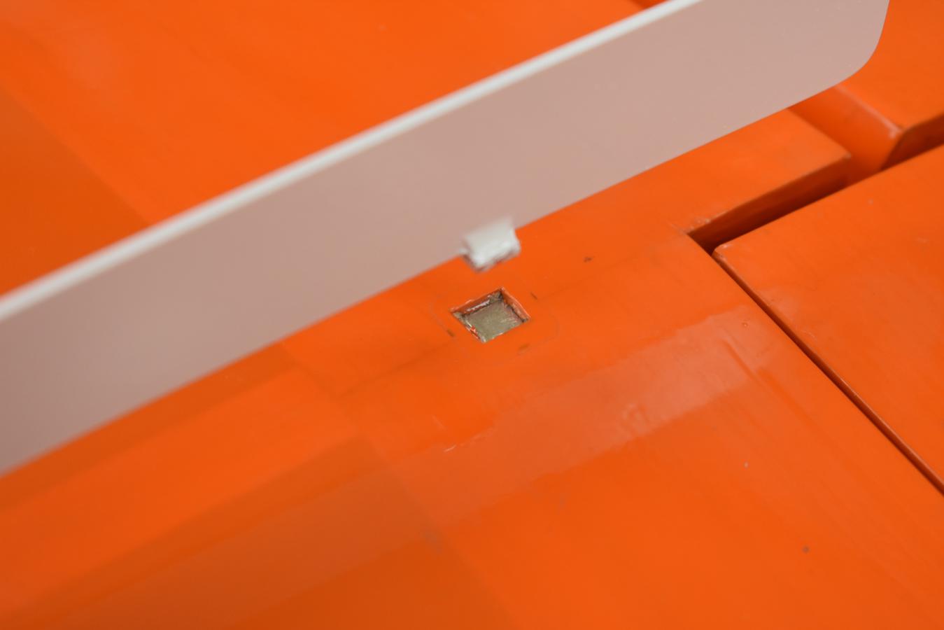

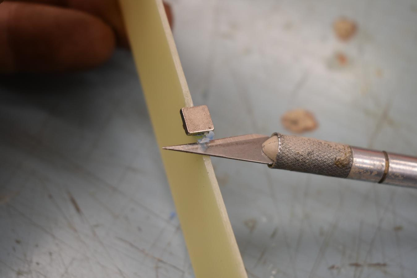

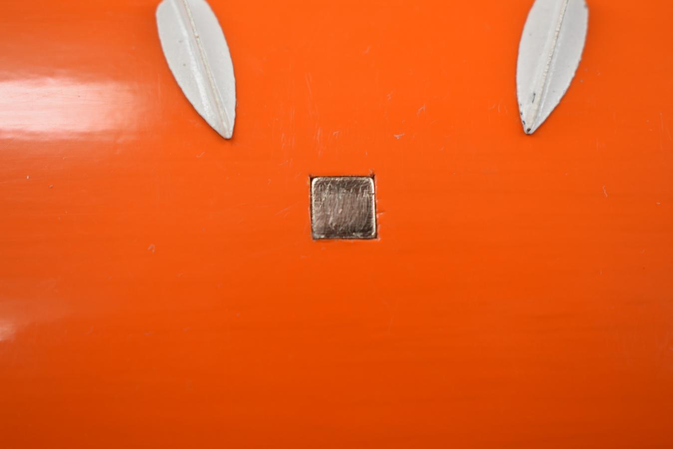

        • Finished developing a set of stall fences for the Cessna 185. They are CNC cut from 1/6" thick G-10 and are locked into position in the wing skin with 1/4" square magnets and a 1/16" dia. pin.
          Click image for larger version  Name:	DSC_3014.JPG Views:	0 Size:	98.2 KB ID:	39765
          Click image for larger version  Name:	DSC_3017.JPG Views:	0 Size:	40.6 KB ID:	39766
          Click image for larger version  Name:	DSC_3018.JPG Views:	0 Size:	39.1 KB ID:	39767
          Click image for larger version  Name:	DSC_3021.JPG Views:	0 Size:	67.2 KB ID:	39768
          Click image for larger version  Name:	DSC_3024.JPG Views:	0 Size:	62.3 KB ID:	39769

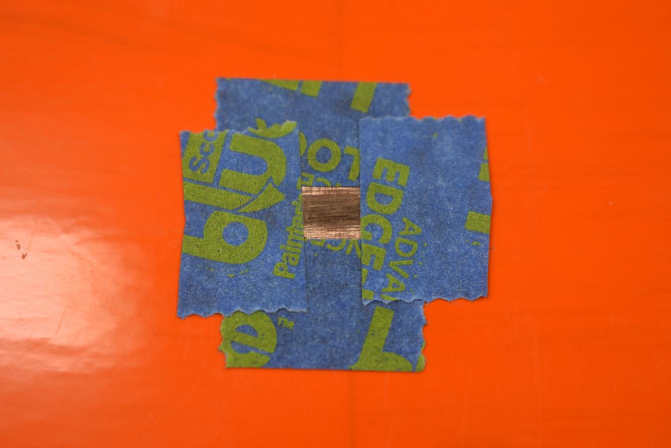

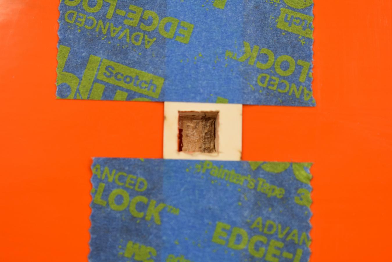

          • Template taped into position and sheeting cut to rib.

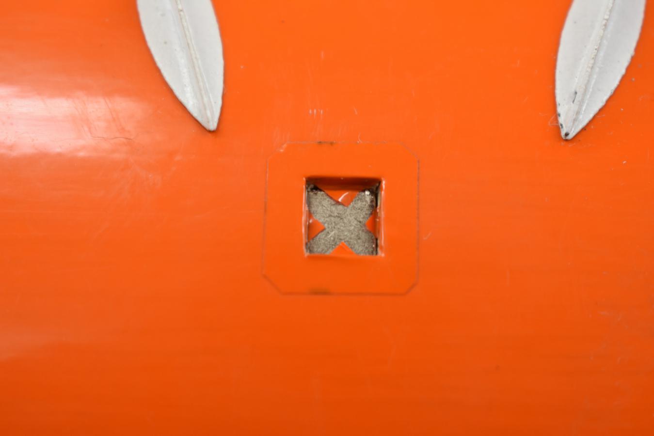

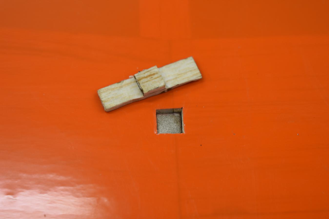

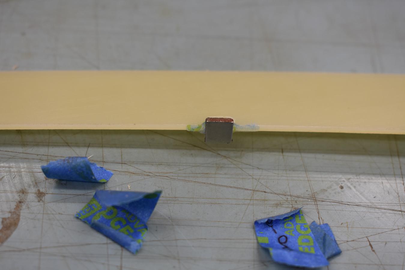

            • First magnet is glued in then second magnet is dropped in.
ID:	39780 Click image for larger version

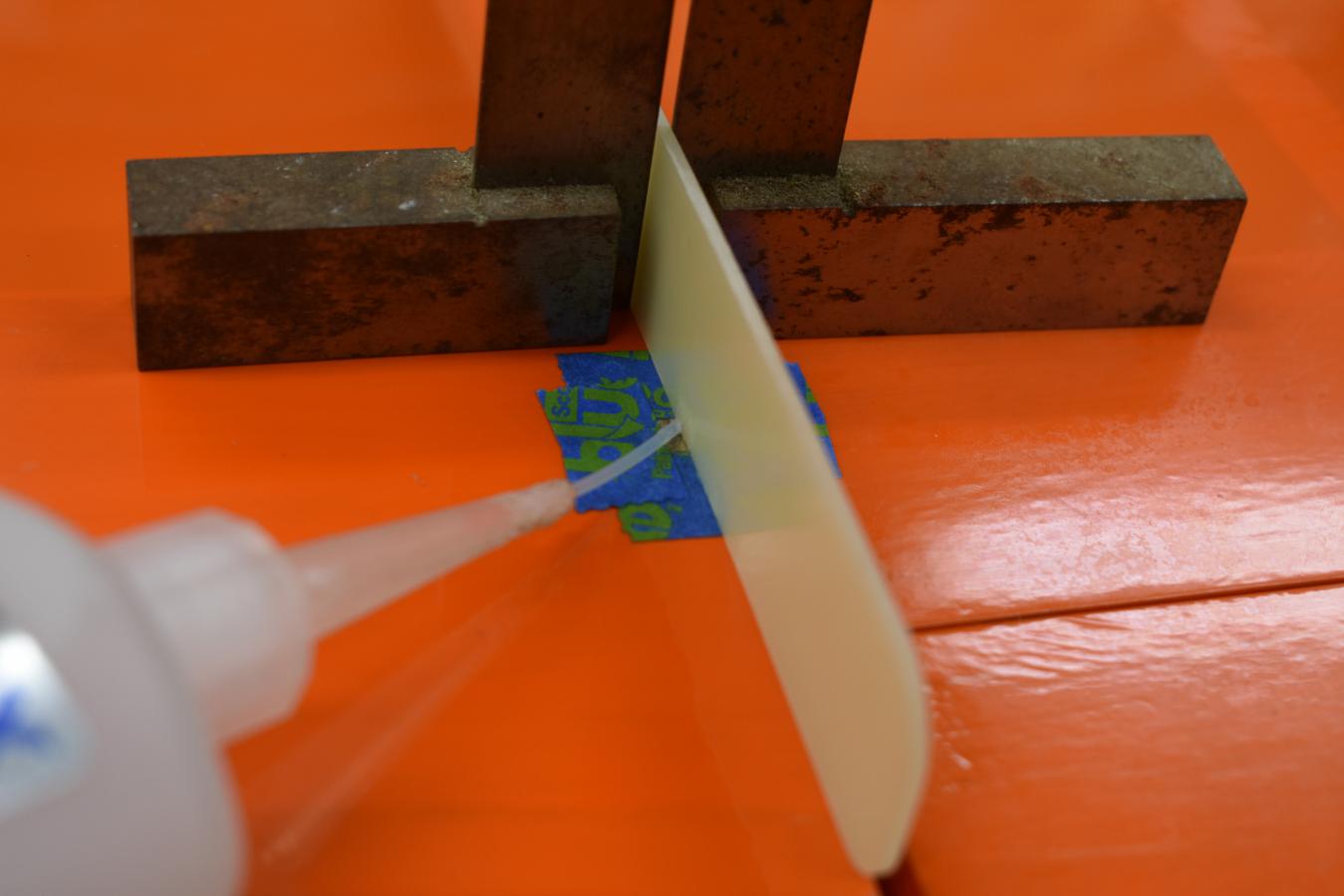

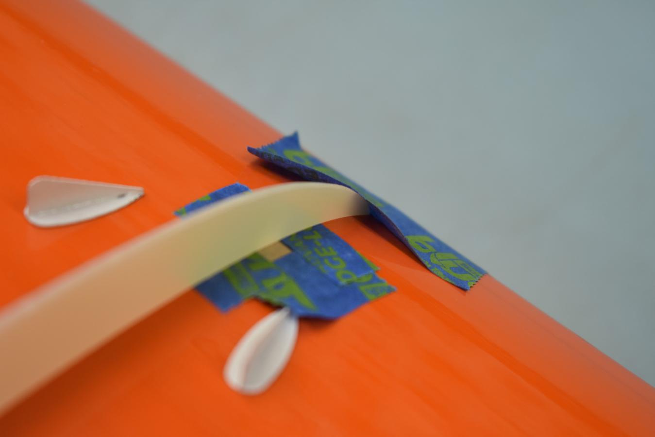

              • Stall fence is centered and glued on.
ID:	39787 Click image for larger version
ID:	39789 Click image for larger version
                • Tape is removed and cleaned off from stall fence.
                  ​​​​​​​ Click image for larger version
ID:	39791 Click image for larger version

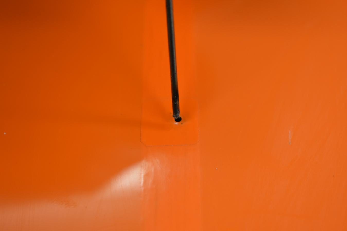

                  • Then the pin and receiver tube is installed.

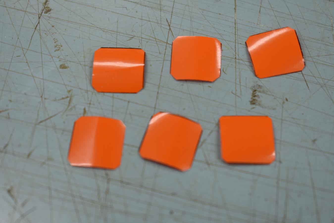

                    • And add little covering material patches.
ID:	39797 Click image for larger version
ID:	39799 Click image for larger version
                      • Filler. primer, paint and done.
ID:	39801 Click image for larger version
ID:	39803 Click image for larger version
ID:	39804 Click image for larger version

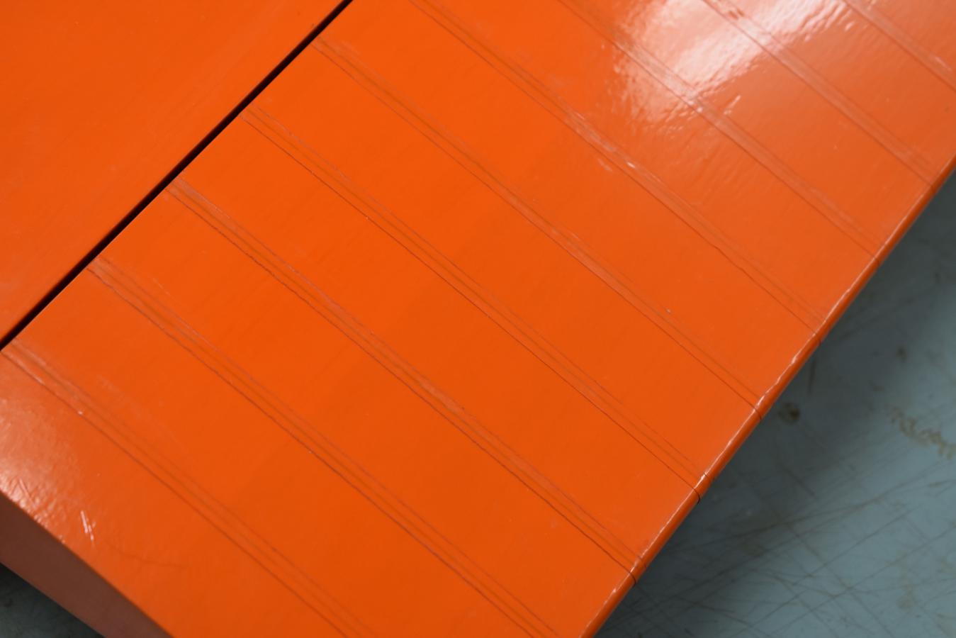

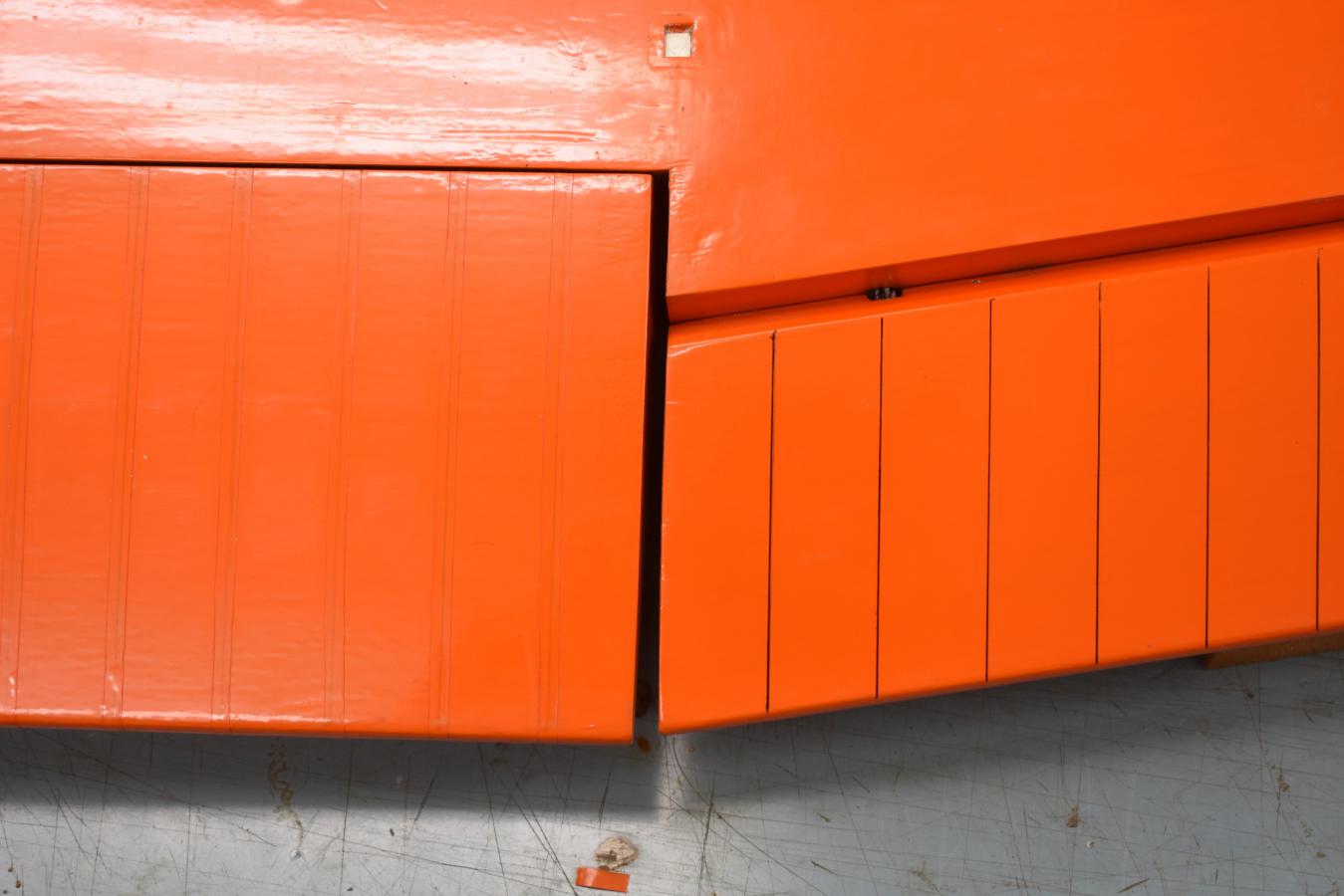

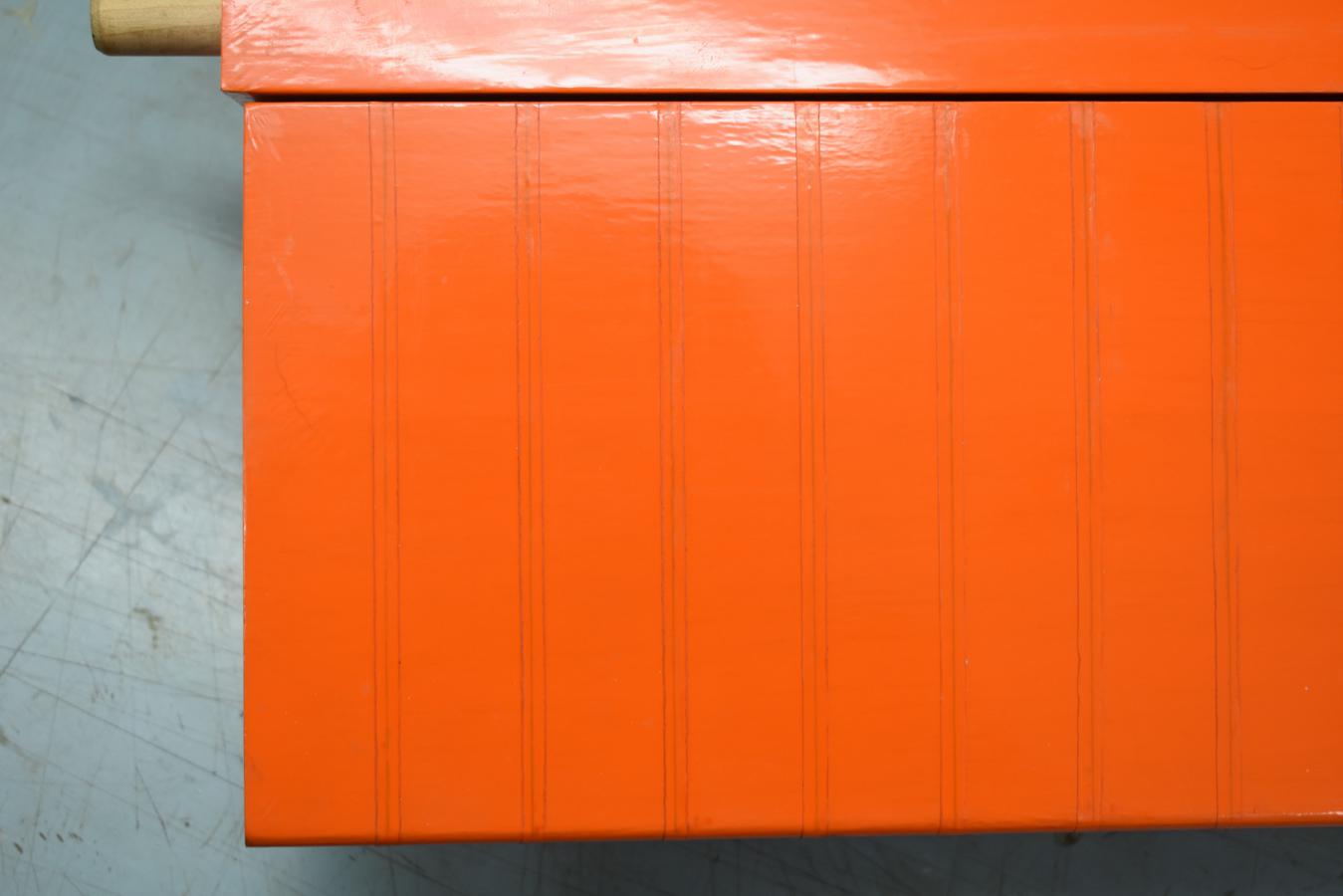

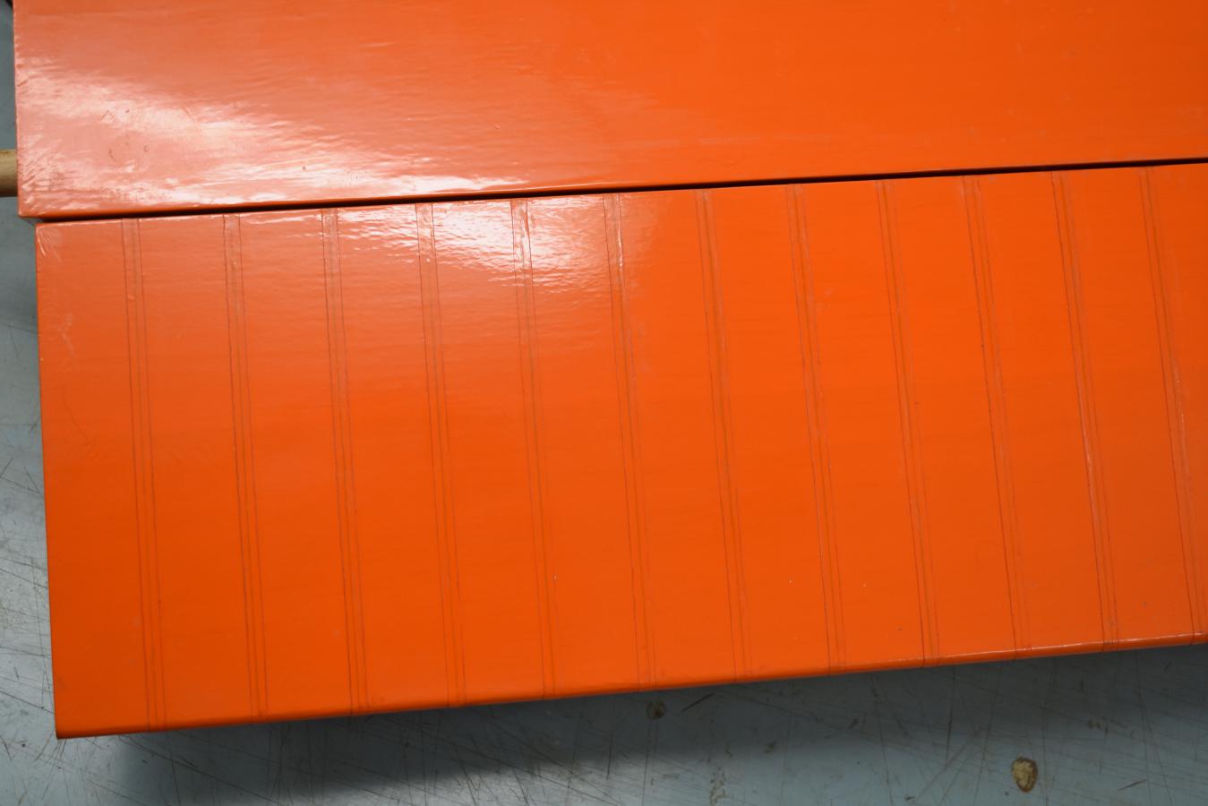

                        • So, Got into Cessna 185 mood again and decided to draw up the spacing of the control surface corrugations.
                          Then I was contemplating of using scale "plastruct" abs angles glued onto the covering, masking and painting them,,,, Ah, no! So I decided to go with a faster and simpler method of simulating them by ironing on 3/16" wide strips of covering material. The orange ultracote is opaque and I would like to see the crease line down the middle (sorta like a 3D effect) and I simply used a fine point marker using a 1" wide spacer to mark all the lines. Having a laser cutter, I cut a bunch of the covering material strips. I used the small trim iron and stuck them down. Another reason I went with this method was as a tow plane Im sure the tow line would have unziped a few of them off the rudder or elevators if a glider got out of wack.
