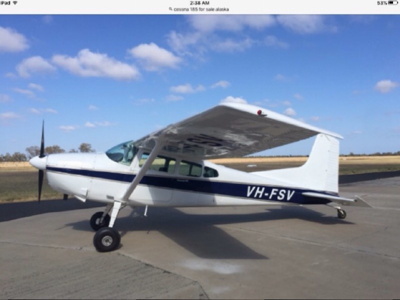

    Here is a picture of a full-scale cessna 185 and some "spy" photos to tease you with!

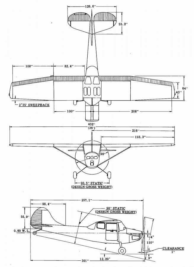

        As much as I like the C185 we really need a 30% one of these that is structurally capable of towing.
          L-19 Bird Dog, one of my favorites... Vailly Aviation (now sold through Ziroli Plans) has it in 1/5 scale all the way up to 1/3 scale. Roy Vaillencourt And Nick Ziroli Jr are very good friends of mine and we are in the same flying club. So I didn't want to step on their toes by designing something that they already have out there.
          Thats how this 185 project got started initially 3 years ago when Jim D. started building one of the Bird Dogs and it got shelved because it wasn't a "Gunny Kit" lol.

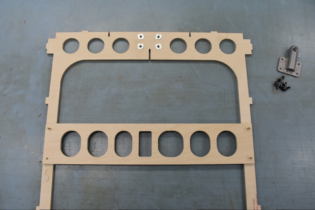

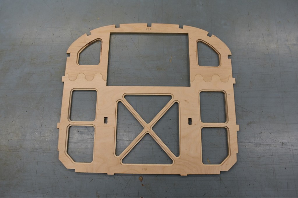

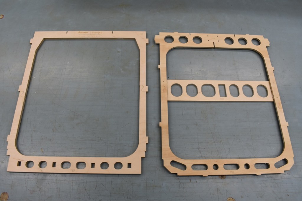

                  Starting with the fuselage build the first thing to do is to join some of the formers together.
                    Former F2 is 1/4" birch ply and has 1/4 lb of lightening holes, These holes will come in very handy later on in the build. When the model will be finished they will be capped off with 1/16" ply laser cut covers to prevent oil dirt etc, from entering the model.
