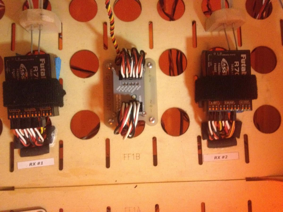

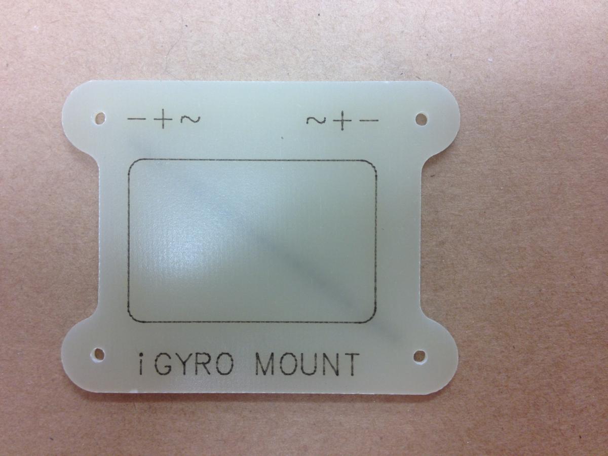

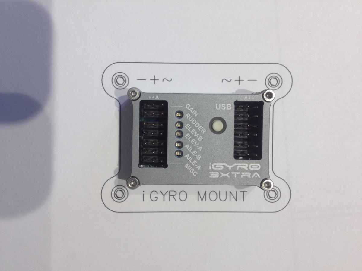

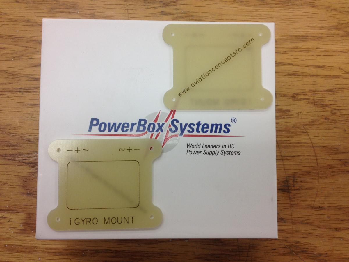

  • Also during Covid I added the PowerBox I Gyro system in it. The newer version is now the 3XTRA which I was happily to purchase from Swiss1 at the Model Box, Thanks Jerremy! I made this G-10 mount for it. With all the VG's and stall fence hanging off the wing PLUS the gyro... Man! this is now my favorite airplane to fly at my local field.

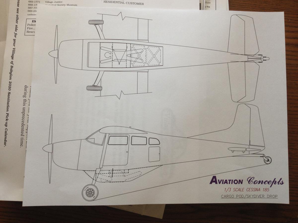

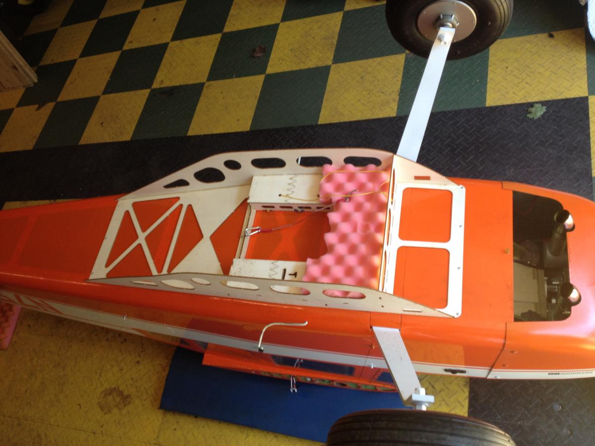

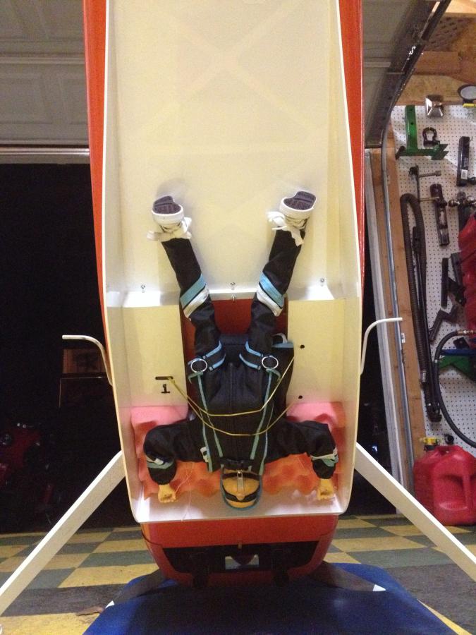

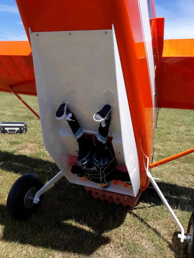

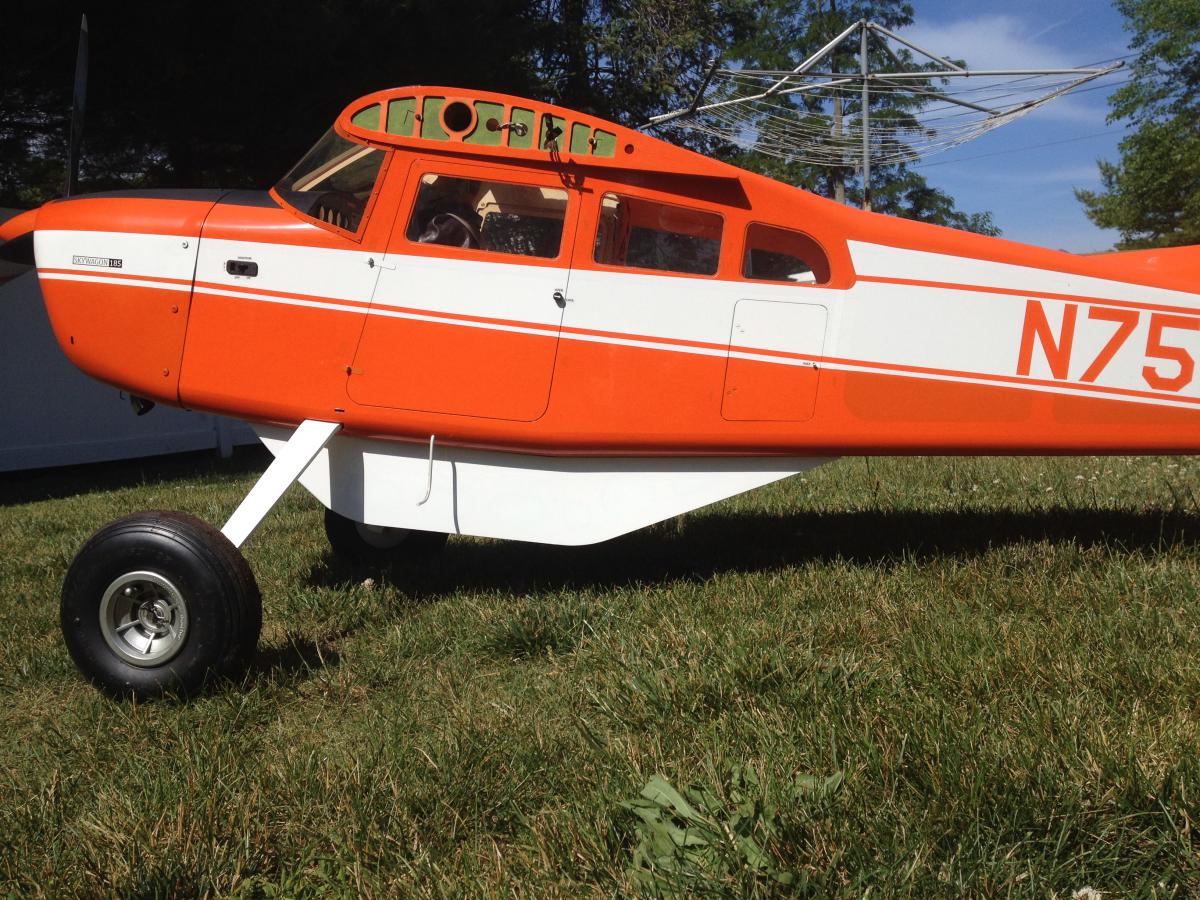

      • Made a cargo pod for the 185...

          If I had a pod that nice...why would I want to jump out!!!

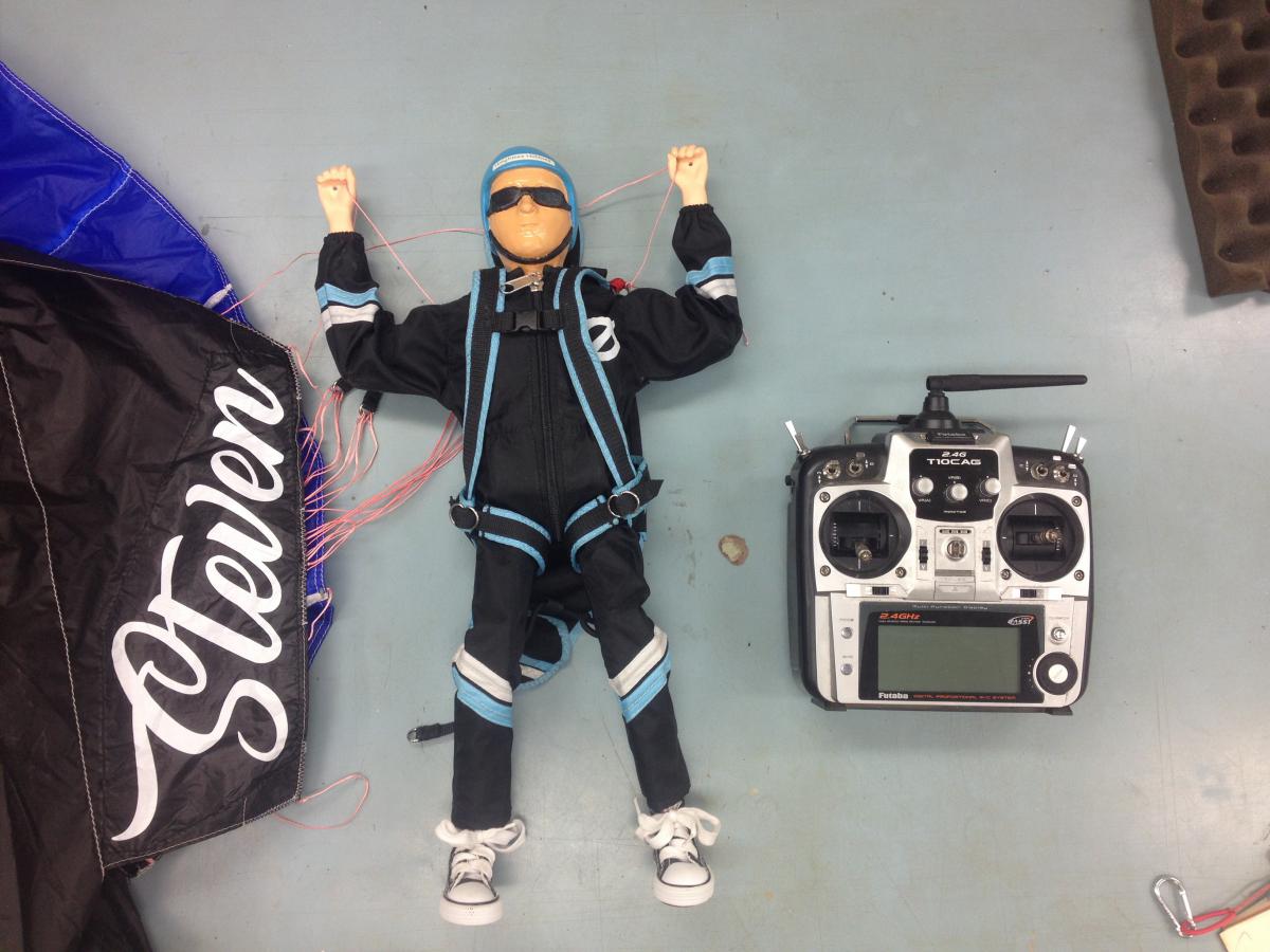

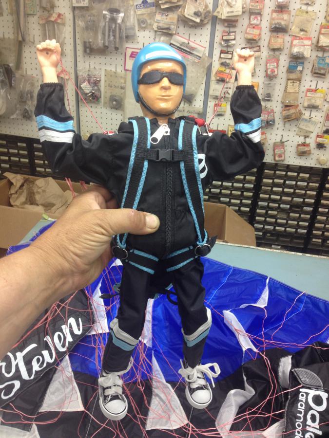

      • Yes , the pod is for my 1/3 scale skydiver. 4 3/4 pounds. On the third jump the release servo for his chute stalled and wouldn't open or eject the parachute. Reason was I put one too many folds in his chute while packing it. Ugh! packing the parachute is not easy when there's a breeze at the field. Though, I did replace it with a stronger digital servo.

        • Here's what he looks like in the air. 5 foot canopy.

          • never saw one that large.. did you make him from scratch..........looks like fun but not on a windy day at cumberland..........
            • gunny11
              gunny11 commented
              Bought it from Esprit Models Steven Skydiver. Definetely not for windy days.
