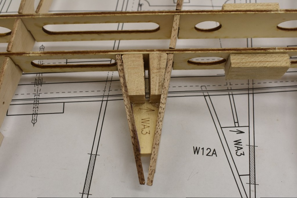

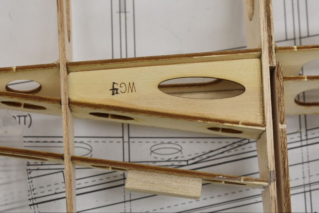

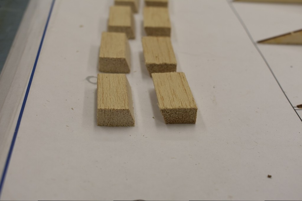

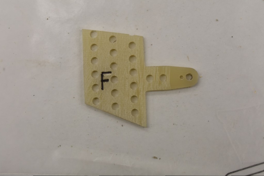

  • Flap hinge blocks and aileron hinge blocks. Flap G-10 horn.
ID:	34831Click image for larger version

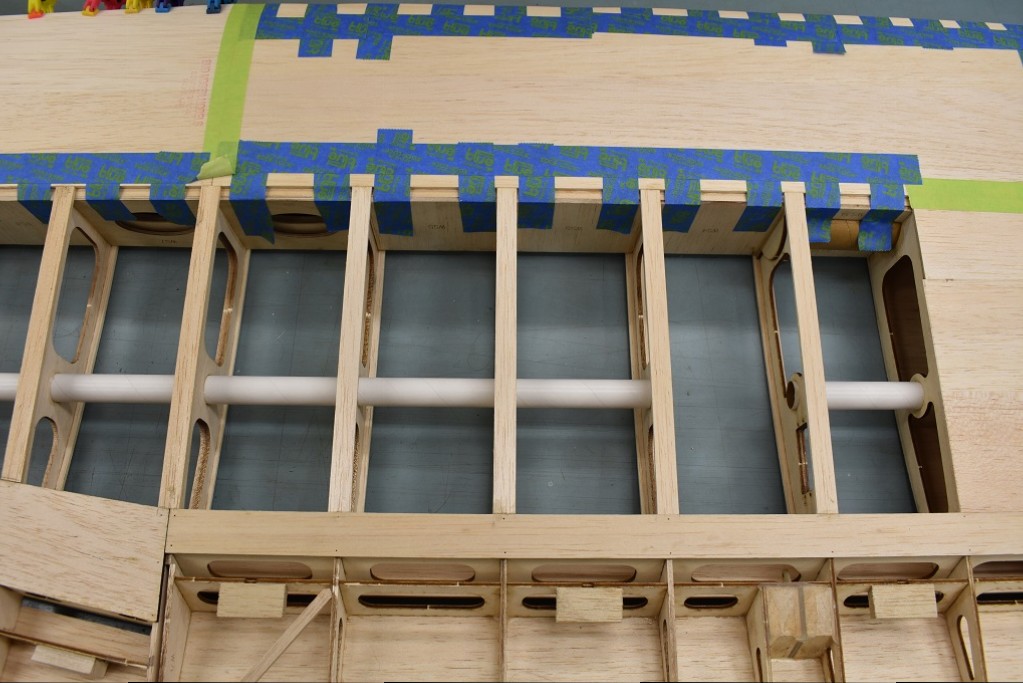

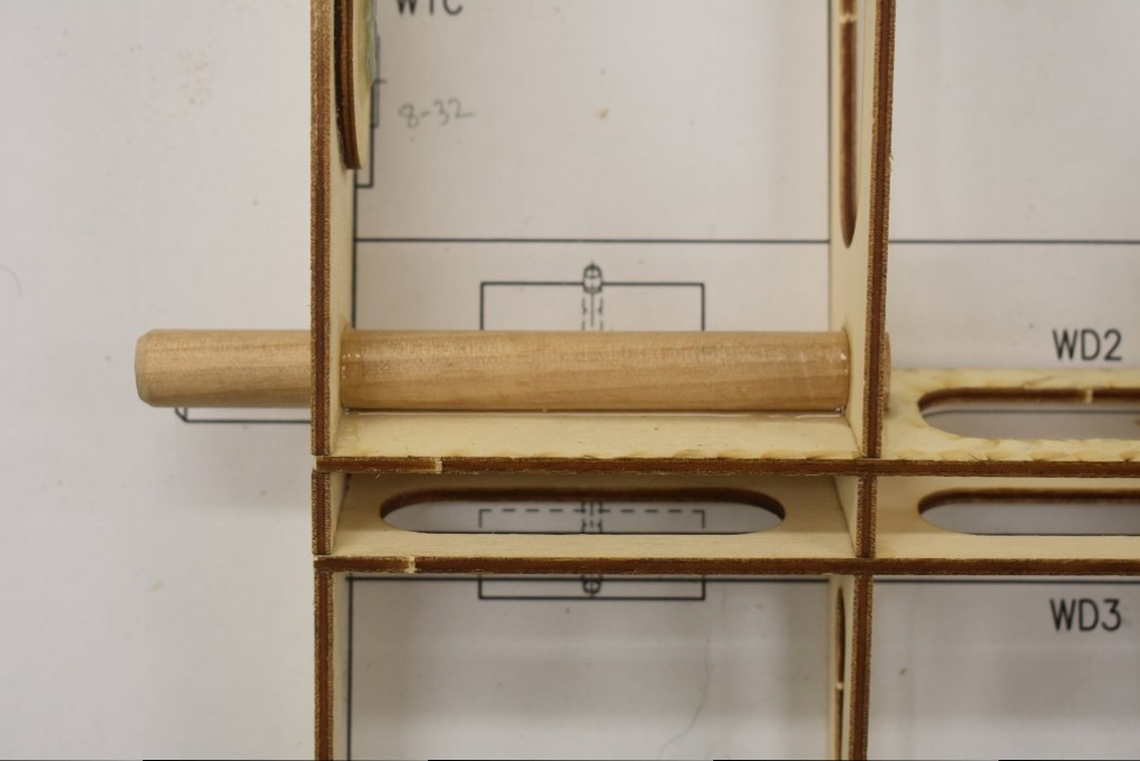

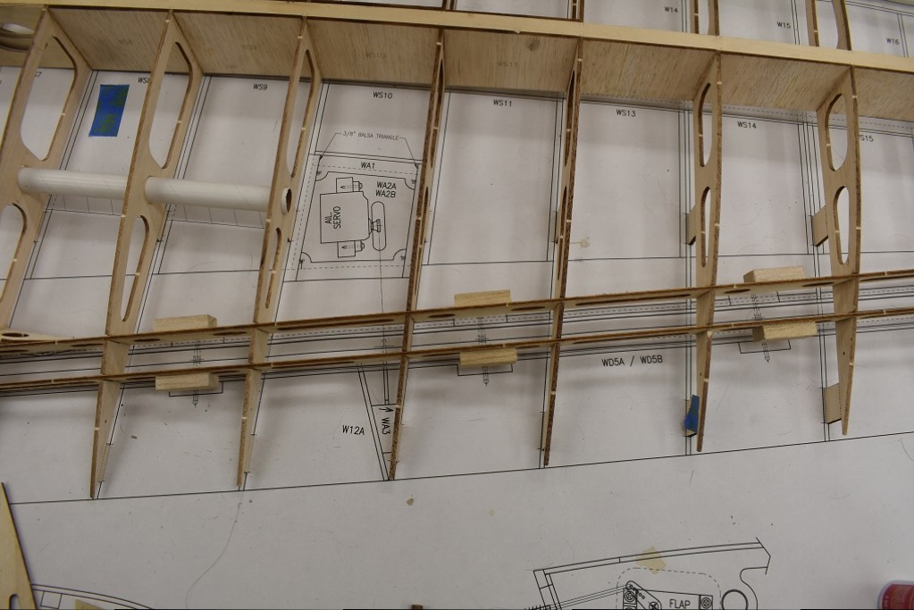

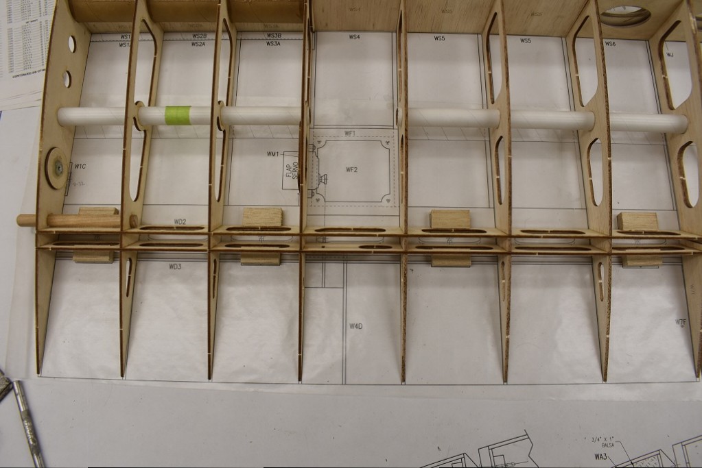

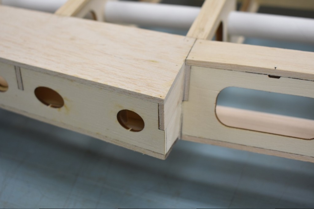

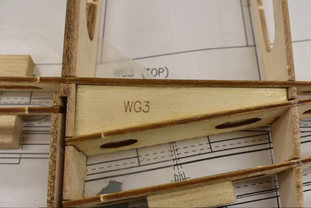

    • Anti rotation dowel 1/2" dia.
      Top and bottom gussets that boxes out the overlapping drag spars.
      Aileron horn pocket structure.
      And the L.E. sub cap. Funny how all those lightening holes in the leading edge cap will come in real handy when sheeting the front. (stay tuned for that)
ID:	34837Click image for larger version

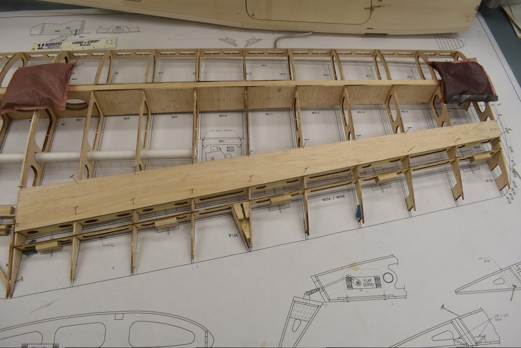

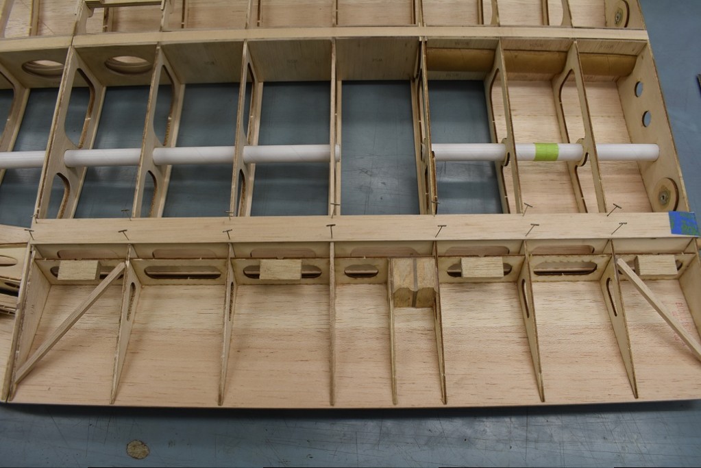

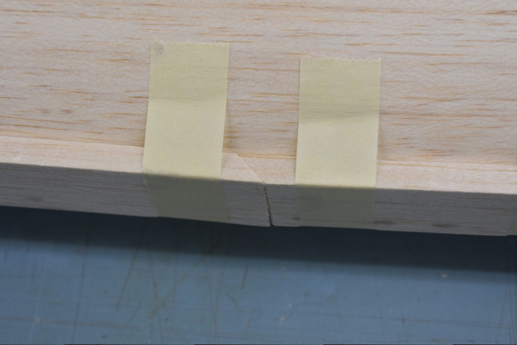

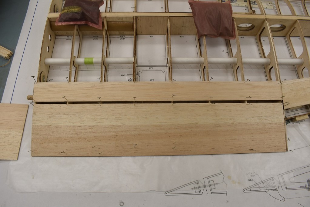

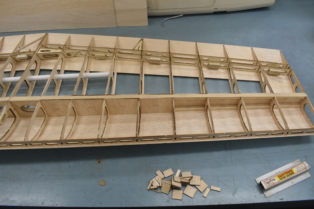

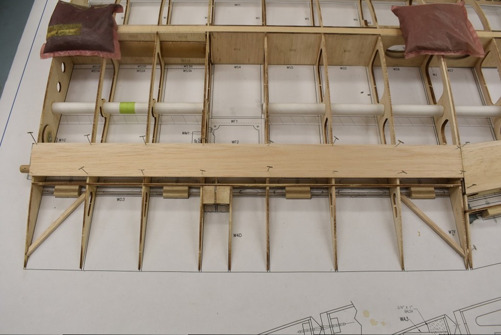

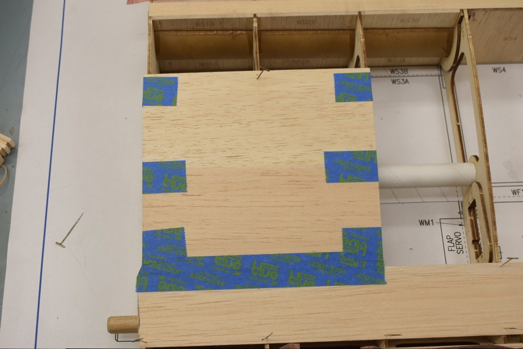

      • Sheeting... The sheeting thickness is 1/8" thick.

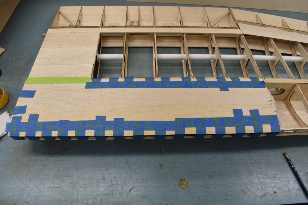

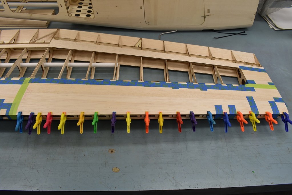

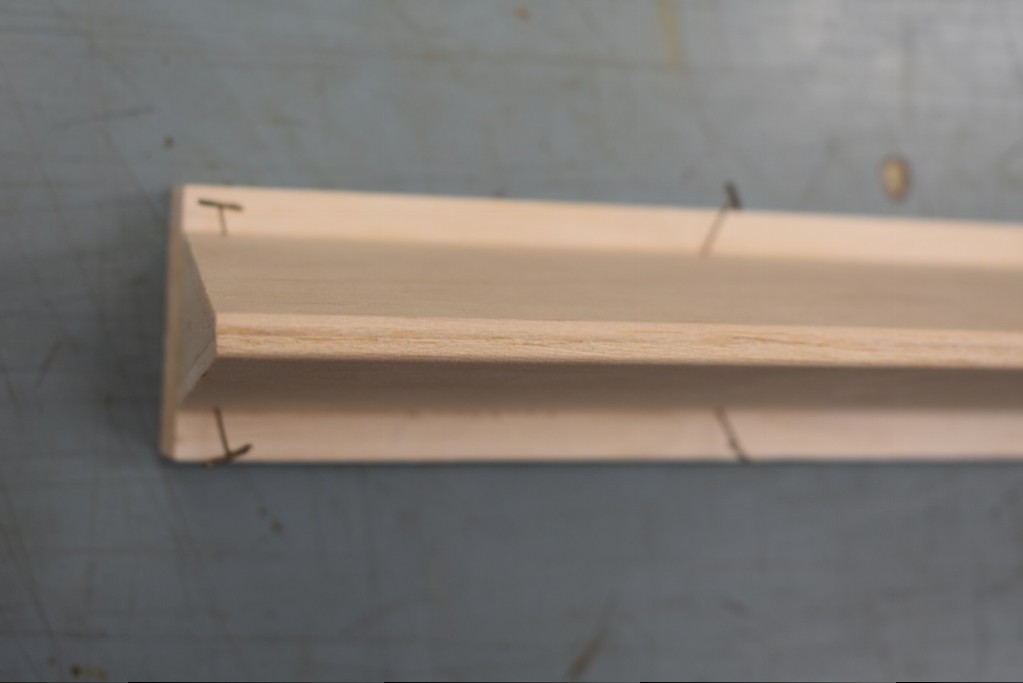

        • Finishing up the top sheeting with cap strips.

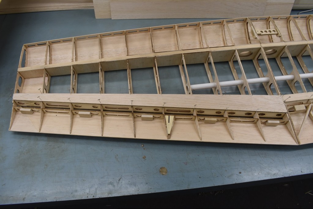

          • Wow.....Very nice!

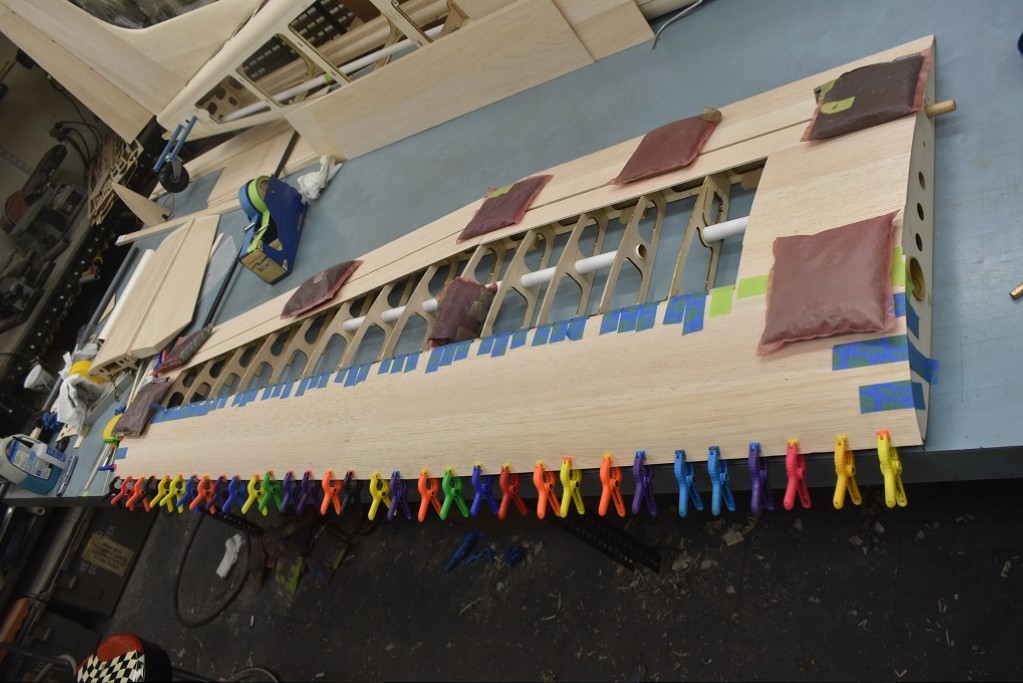

            • Thanks, and its pretty much the same on the bottom side. The tabs snap off the bottom of the outboard panel and a little fine sanding.

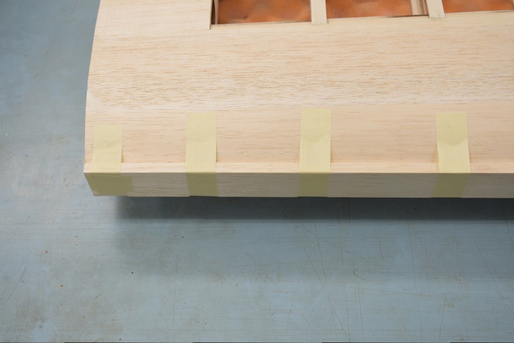

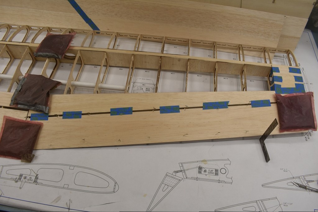

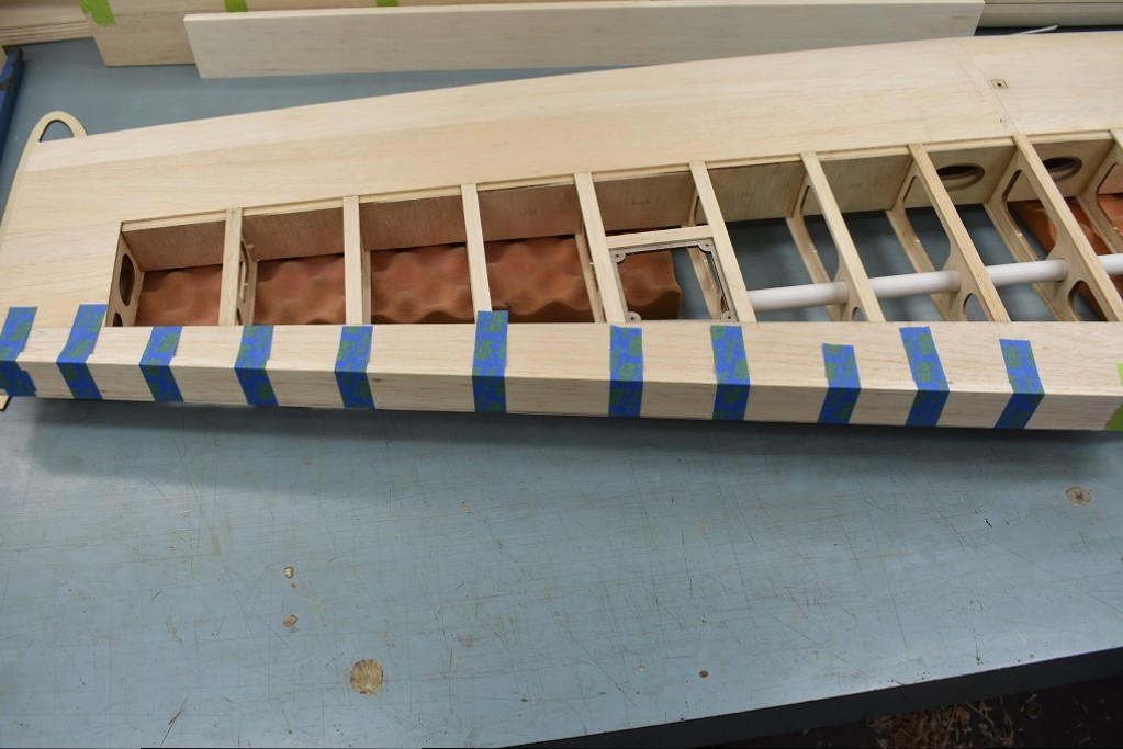

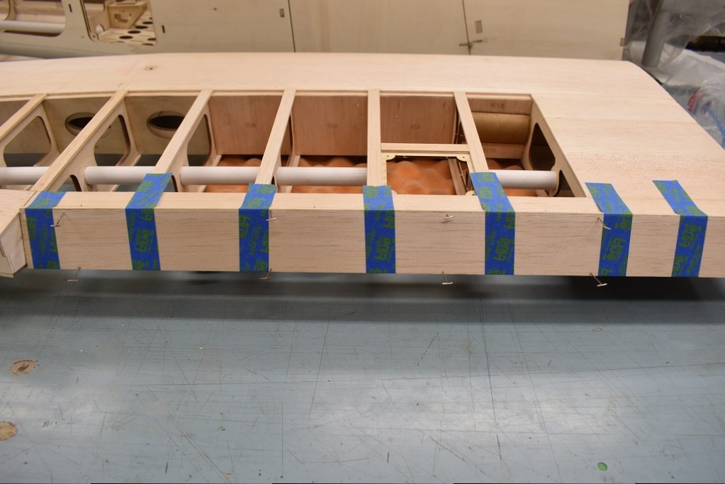

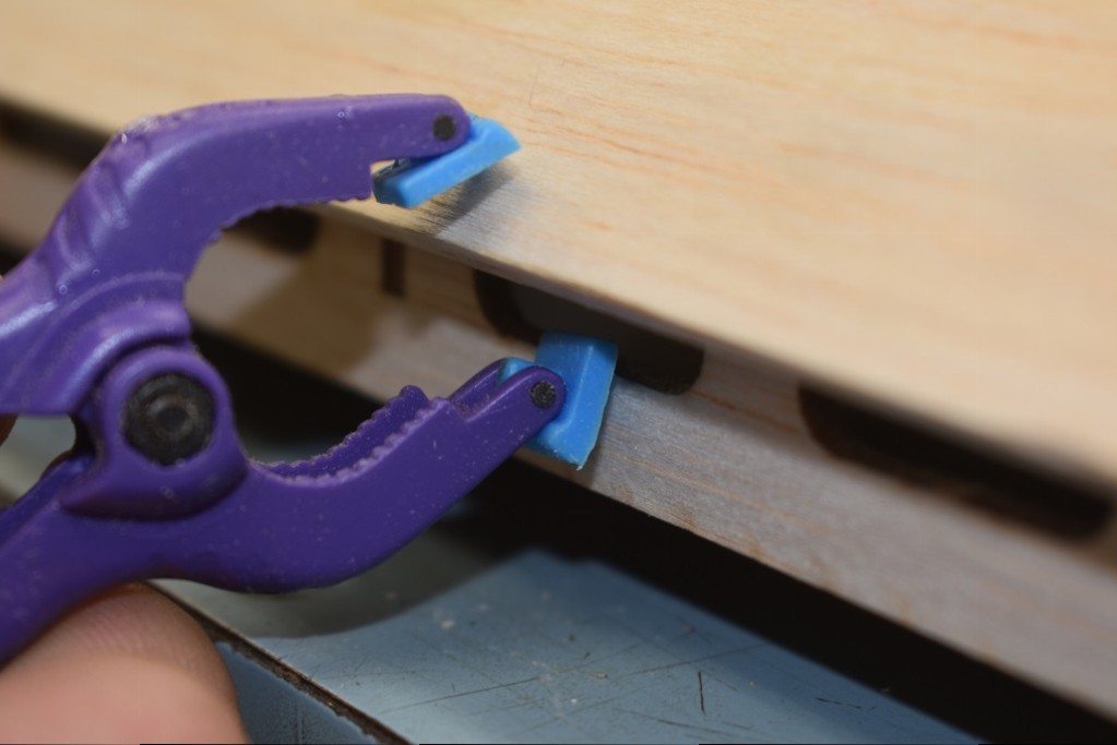

              • Cap strips added to the bottom.

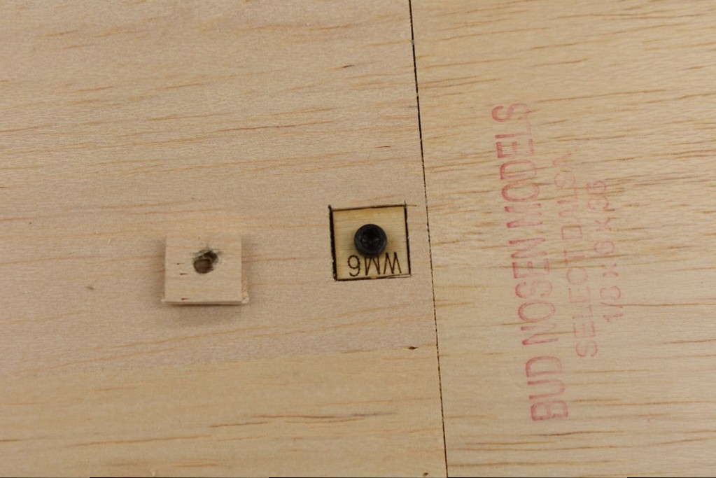

                  The holes to allow clamps to be used in lieu of pins is a great idea! Go one step further and use scrap on top of the sheeting to keep clamps from leaving footprints.
                • gunny11
                  gunny11 commented
                  Yes, absolutely.

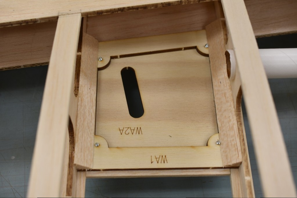

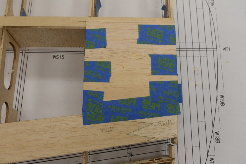

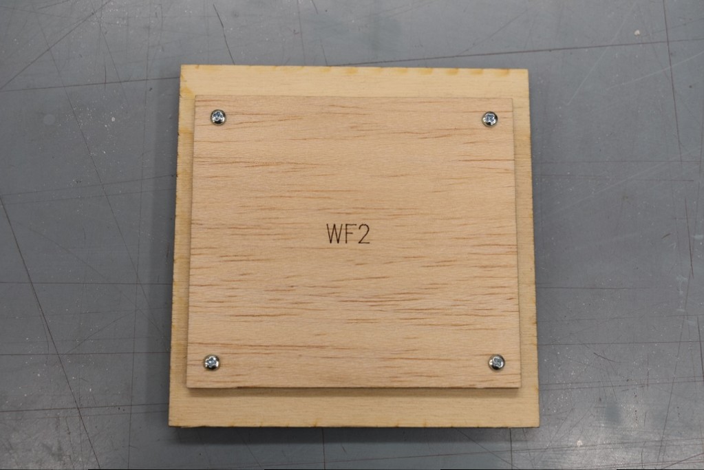

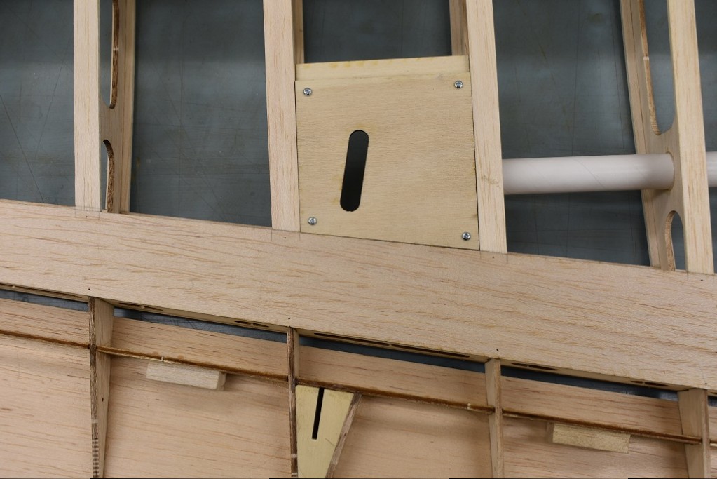

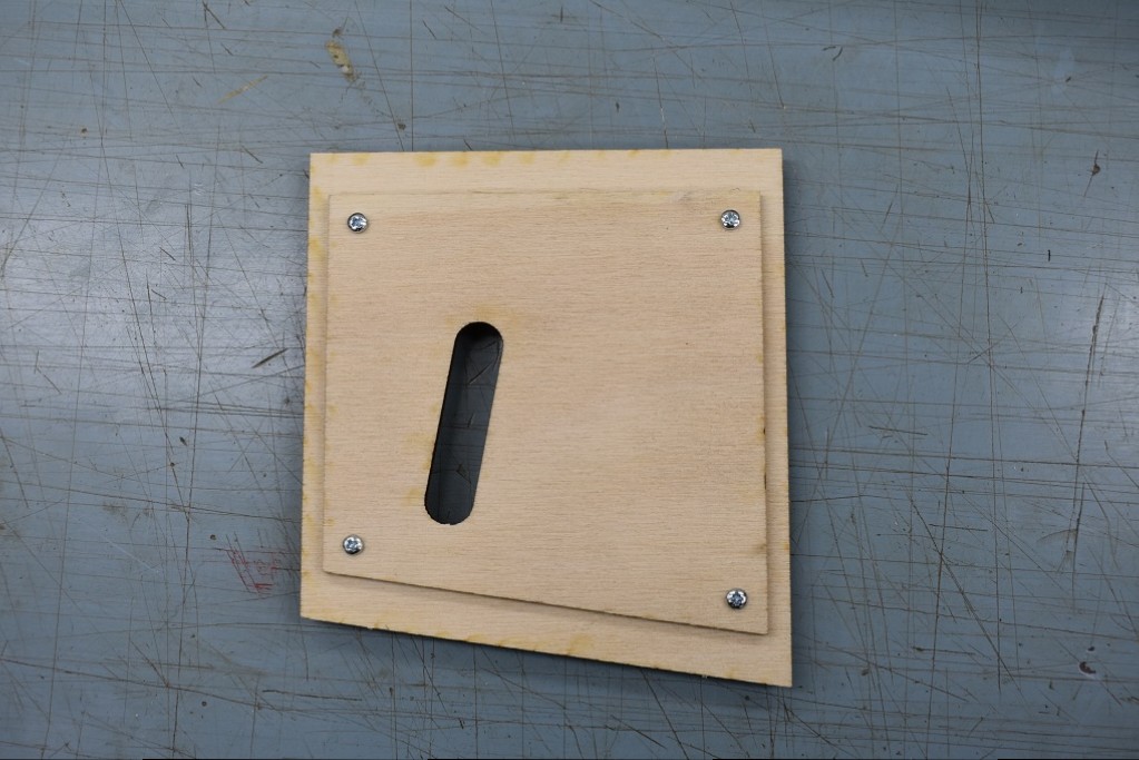

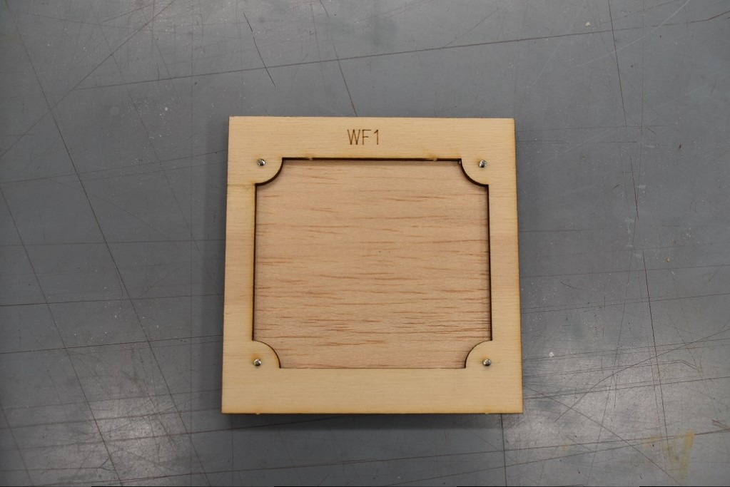

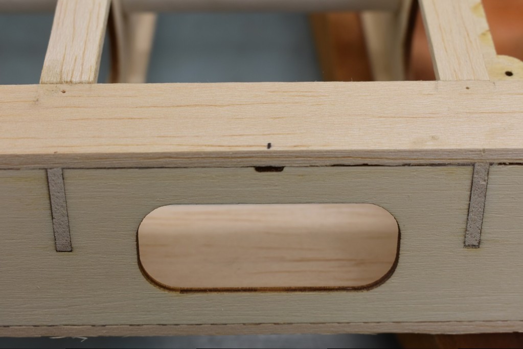

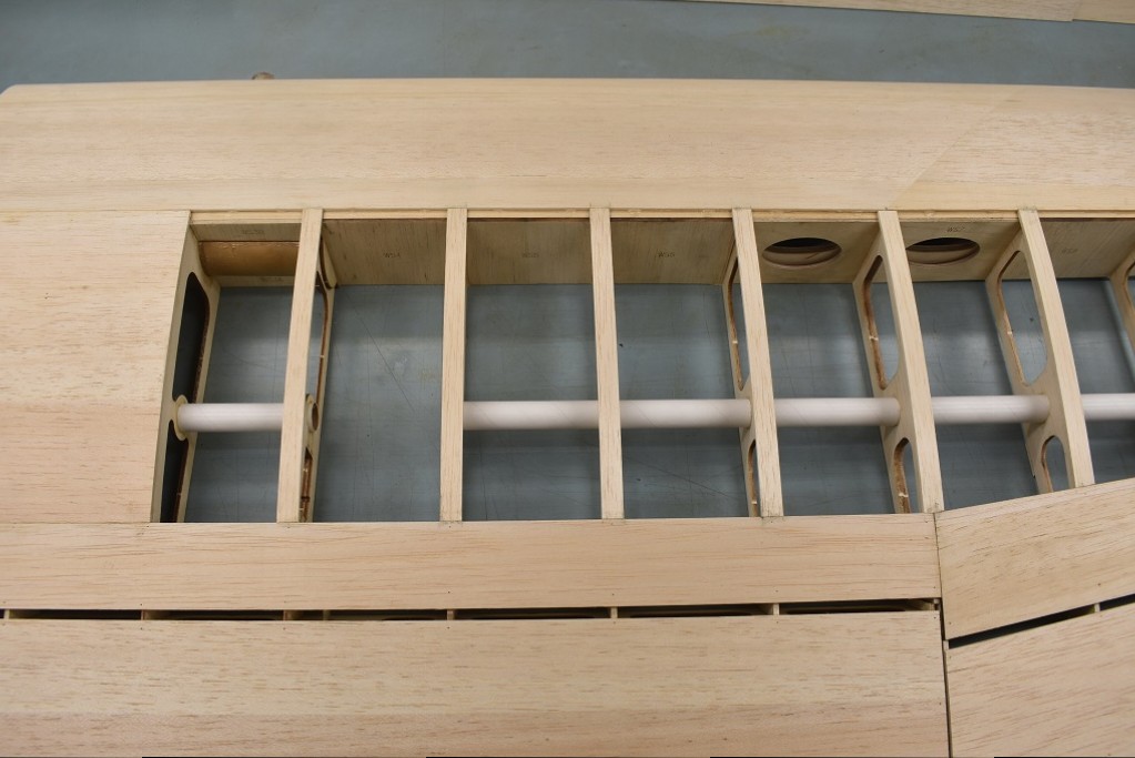

              • Flap access hatch.

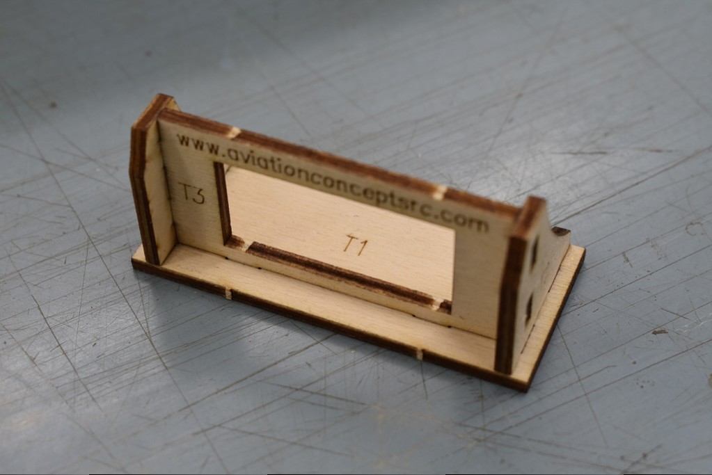

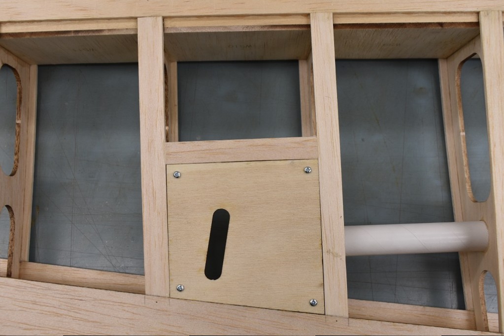

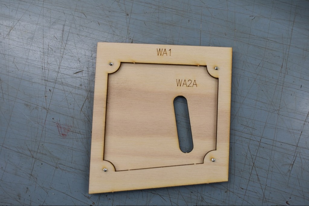

                • And here is the aileron hatch.
                  Click image for larger version  Name:	DSC_1822.JPG Views:	1 Size:	136.9 KB ID:	35168
                  Click image for larger version  Name:	DSC_1823.JPG Views:	1 Size:	143.0 KB ID:	35167
                  Click image for larger version  Name:	DSC_1825.JPG Views:	1 Size:	135.9 KB ID:	35170
                  Click image for larger version  Name:	DSC_1828.JPG Views:	1 Size:	119.2 KB ID:	35169
                  Click image for larger version  Name:	DSC_1829.JPG Views:	1 Size:	97.1 KB ID:	35171

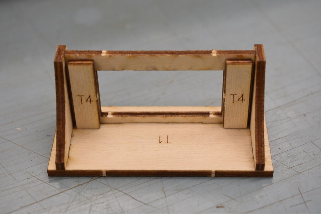

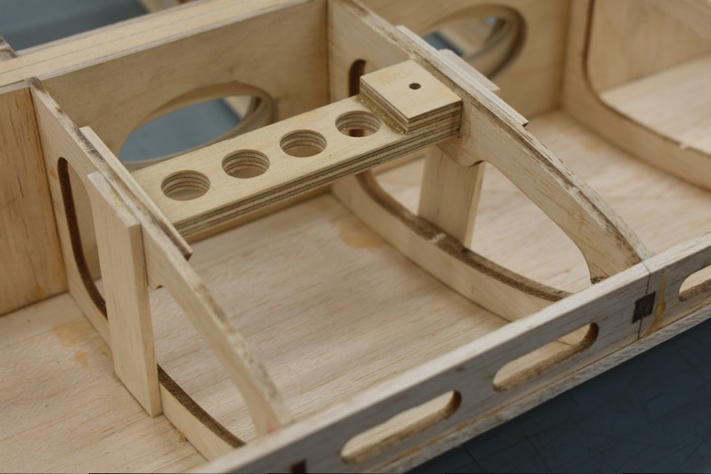

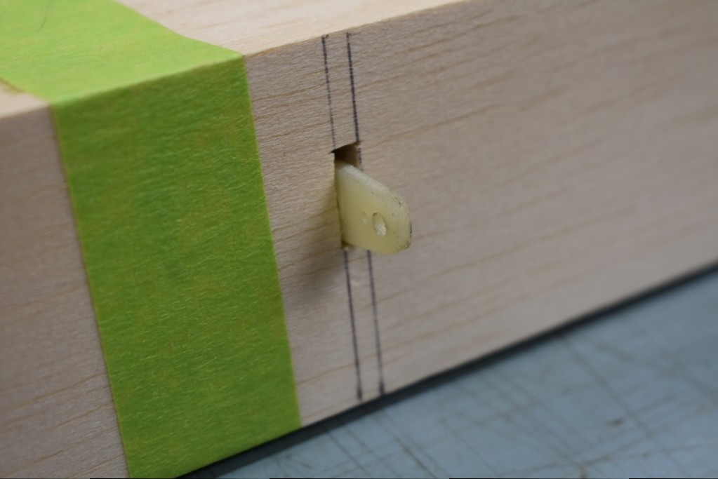

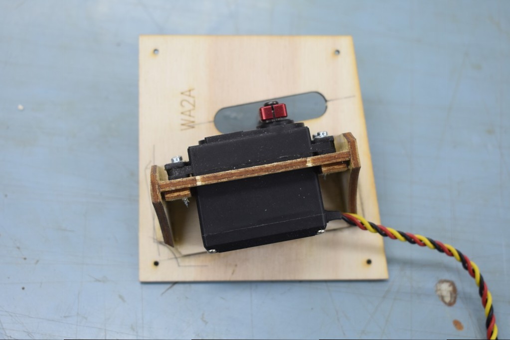

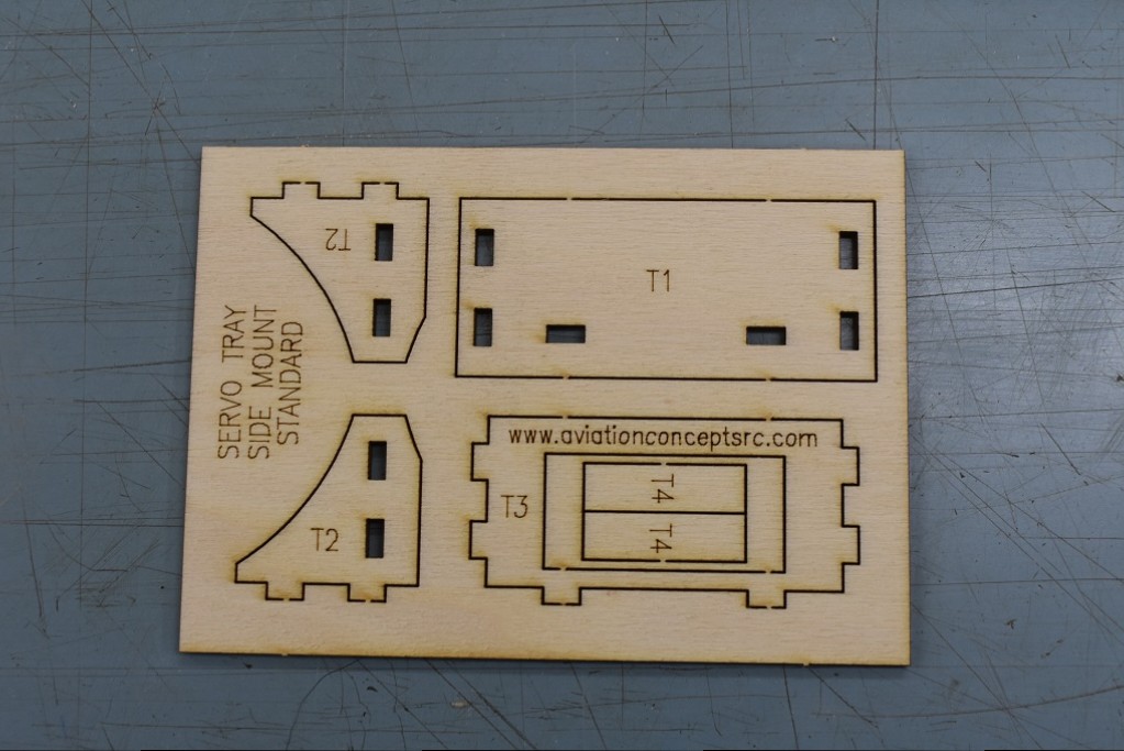

                  • The kit will include 4 of these. 2 for the ailerons, 1 for the throttle and 1 if you wish to use for choke.

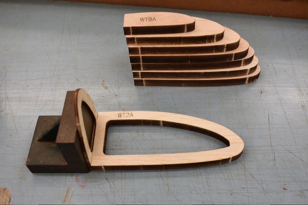

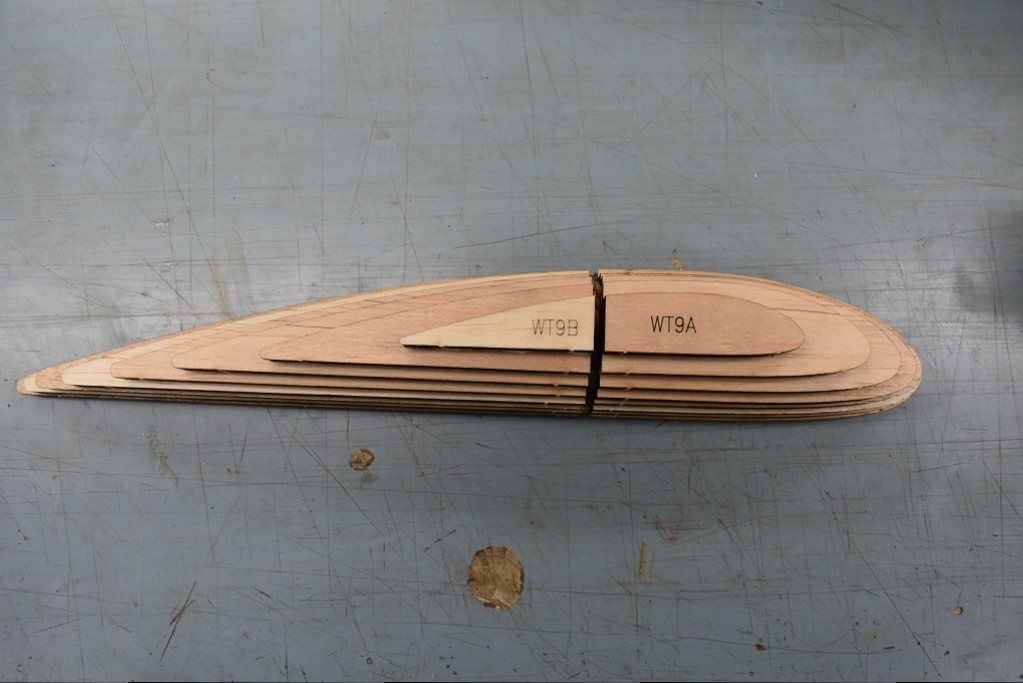

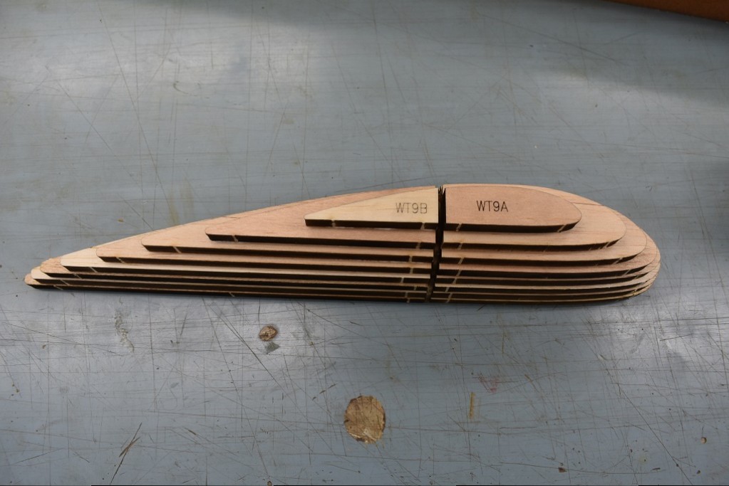

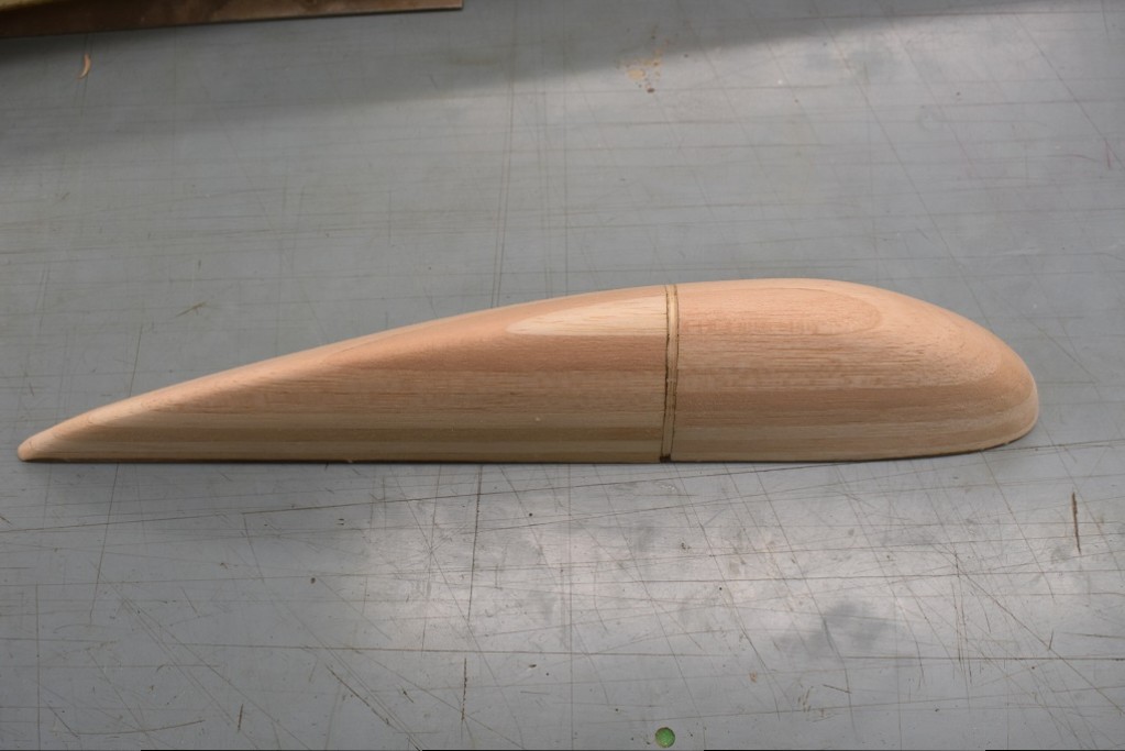

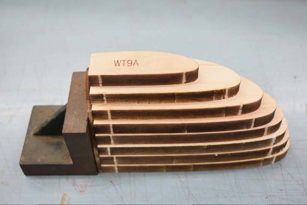

                    • A hard point is added for the wing strut attachment as to not crush the balsa.

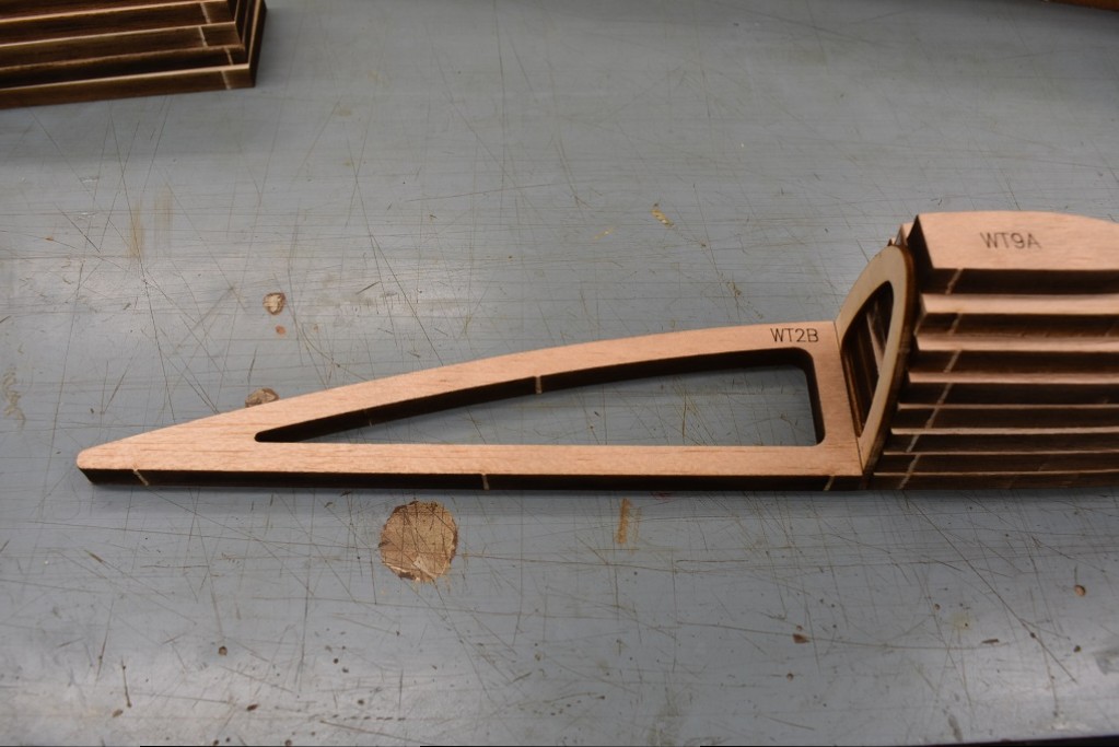

                      Also, getting a little side tracked... Playing with wing tip.

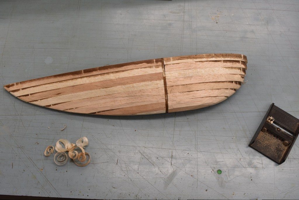

                      • Just winging it
ID:	35349Click image for larger version
                        • Truly artisan work there Gunny, hollow wingtips were never this easy.
                          I am really enjoying how this design and construction is unfolding.,
                          Thanks for sharing this with the community, awesome work !
                          • gunny11
                            gunny11 commented
                            Thanks nichda, Just thinking outside the box.

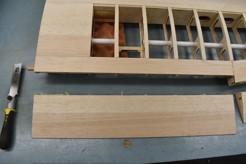

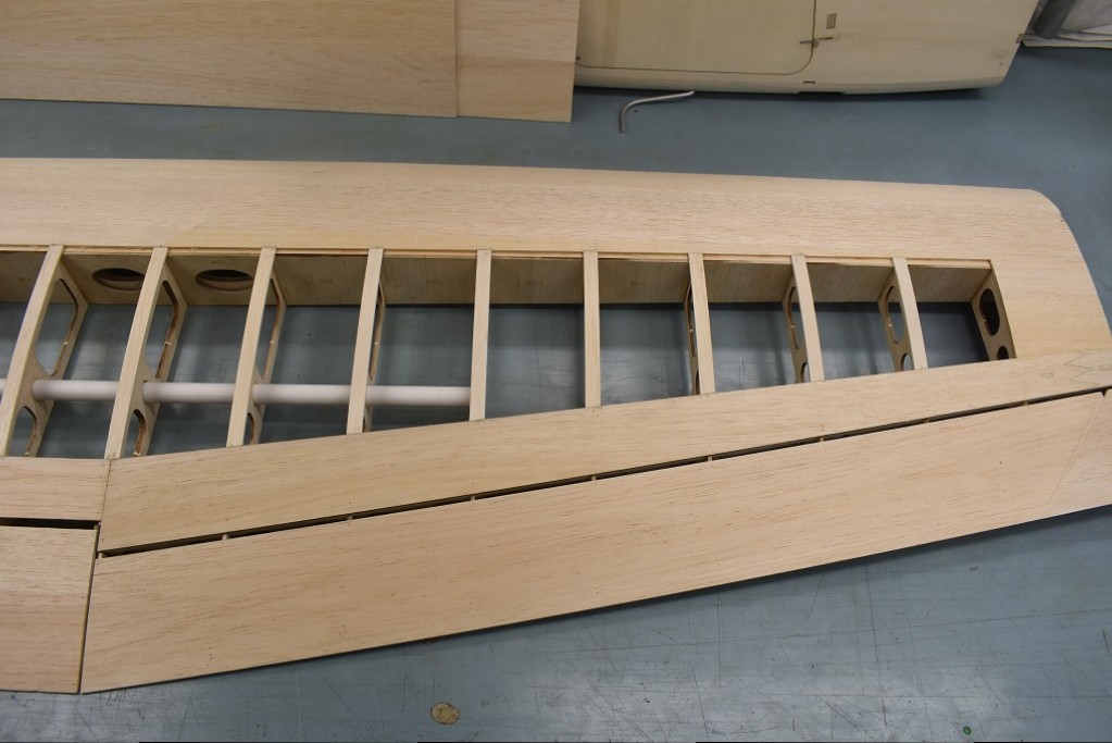

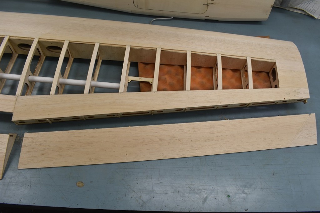

                        • Now is the time to cut off (separate) the flap and aileron from the wing. And a little sanding smooth.
