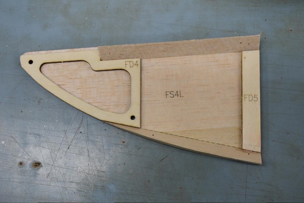

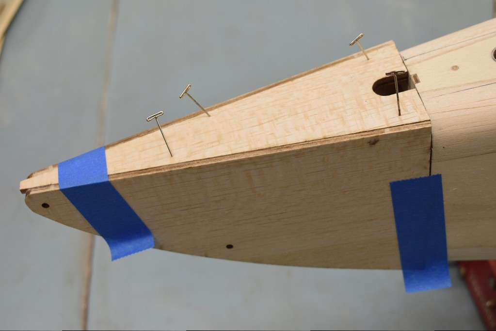

    So the plan (right now) is to have the rudder servo reside in the tail cone.

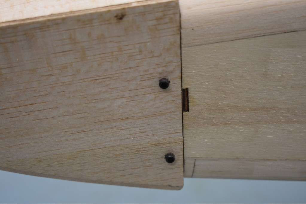

      And the cone is mounted using 4-40 socket head bolts that is recessed in the balsa.

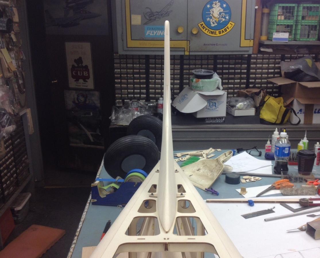

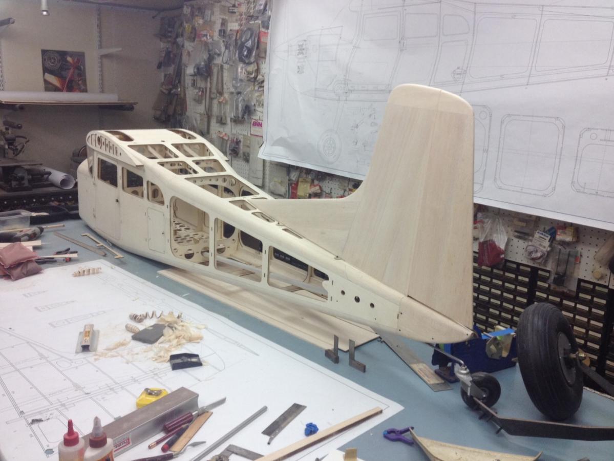

ID:	33835 Sorry guys for not posting in the last couple of days, I've been having fun building the fin! Here is a sneak peek from the R&D shop room.
        Click image for larger version  Name:	image.jpeg Views:	1 Size:	108.7 KB ID:	33834Click image for larger version  Name:	image.jpeg Views:	1 Size:	114.1 KB ID:	33836

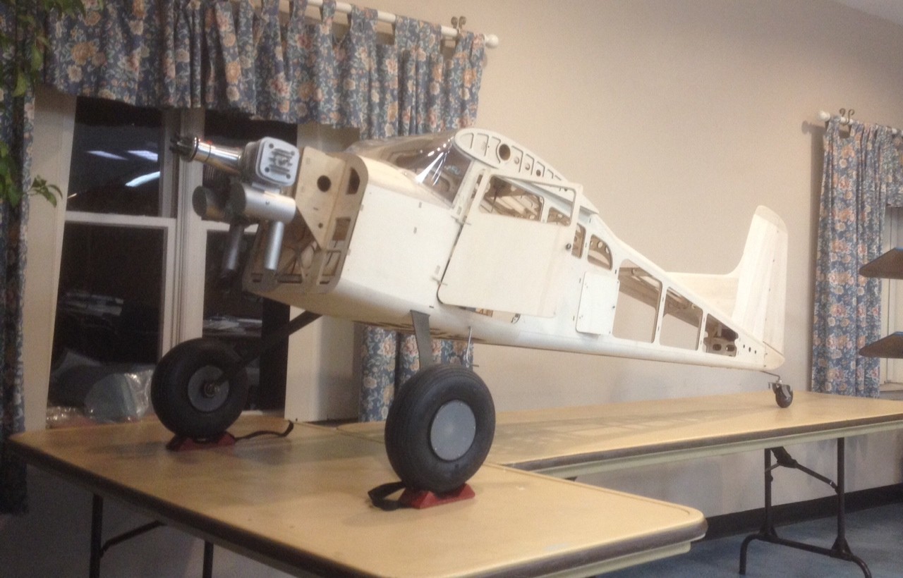

              Wow! Thanks for the nice compliments Steve and Len. I just came home from our giant scale club meeting and it very well received. Last month I just brought in a couple of the CNC cut formers and couldn't believe how far I came along in one month...

                I'm going to have to make bigger wheel chocks.... LOL

              Those wheels/tires look way bigger then scale.......is that what your going to use for the finial version?

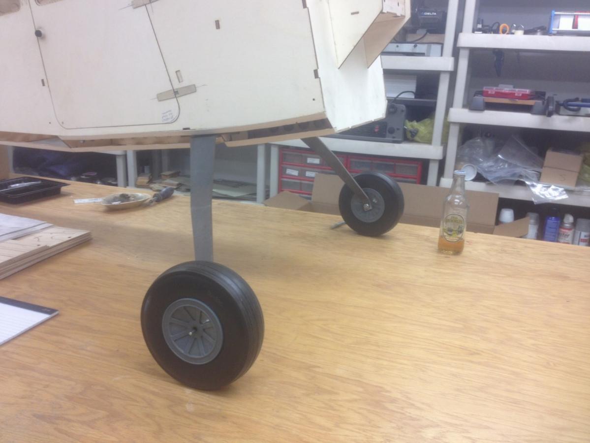

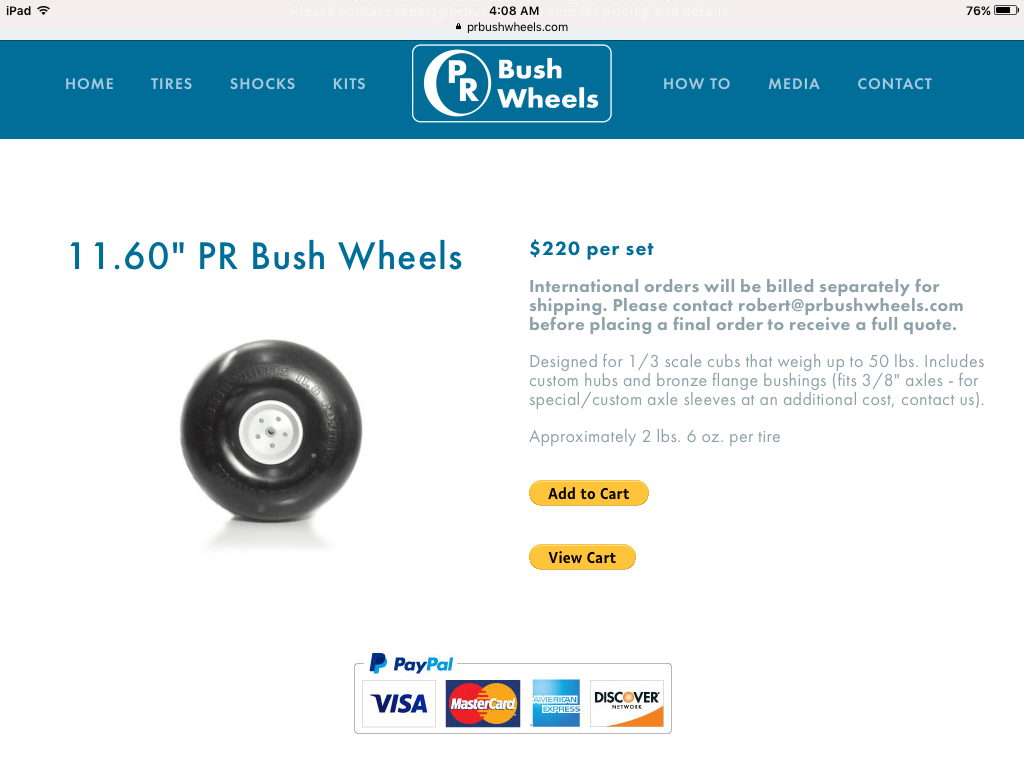

                Well Tom, your kinda correct. Stock out of the Cessns factory in 1/3 scale it would be 7" diameter. I.e 7" Du-Bro wheels. But Sinkhappens kept sending me pictures and videos of all the 185 bush planes up in Alaska. He and I are hooked on tundra wheels which would be 11 5/8" diameter. It saddens us that the owner PR Bush Wheels had passed away this past November. The wheels you see are 10" diameter and as for the final version it is uncertain at this time.
ID:	33888Click image for larger version
                • gunny11
                  gunny11 commented
                  So if anyone has a set of PR Bush Wheels for sale, new or used let us know.

                  Those look correct........I kinda understand the “fetish” with the “BushWheels” compensating for other “inadequacies” but........we don’t tow off of rocky creek beds. So the tires/wheels that are used when the plane is put into service as a tug would be the “scale” choice........I’m pretty sure you said that this whole endeavor was to produce a “scale tug”, right?

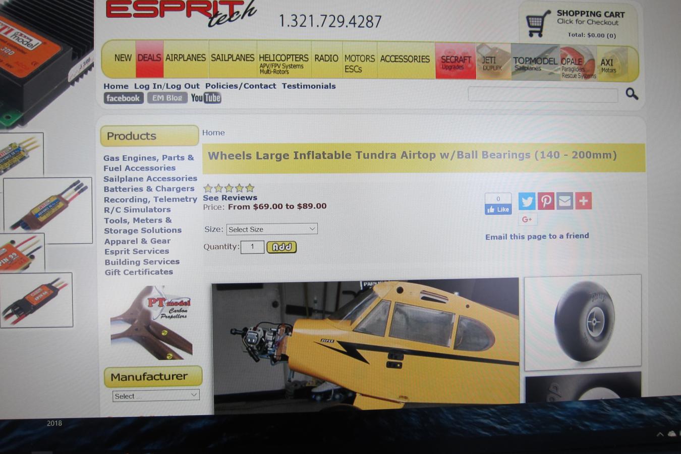

ID:	33900 On Esprit web site, they show Large Tundra Airtop wheels up to 8 inch...(french) I have used these on my Pegasus 108% they are a bit heavy but not fragile.

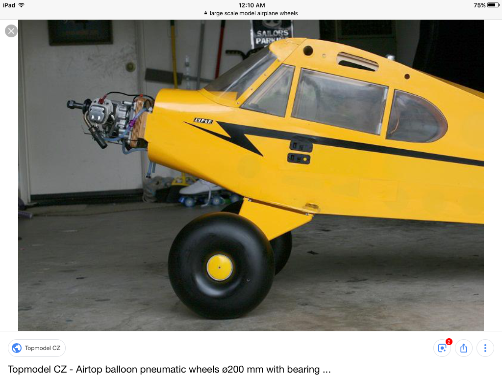

                        Yup, they are good, I have the 8" on my 1/3 scale cub. Their picture.
