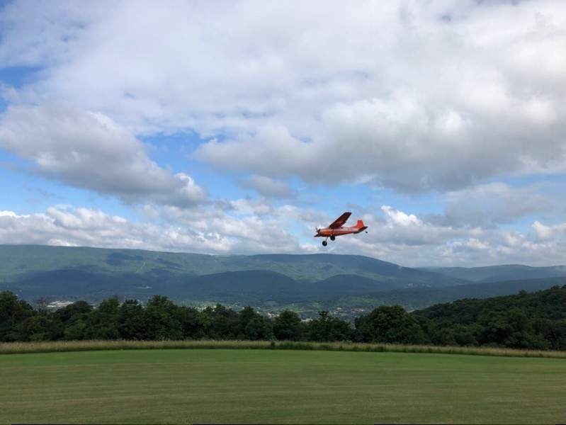

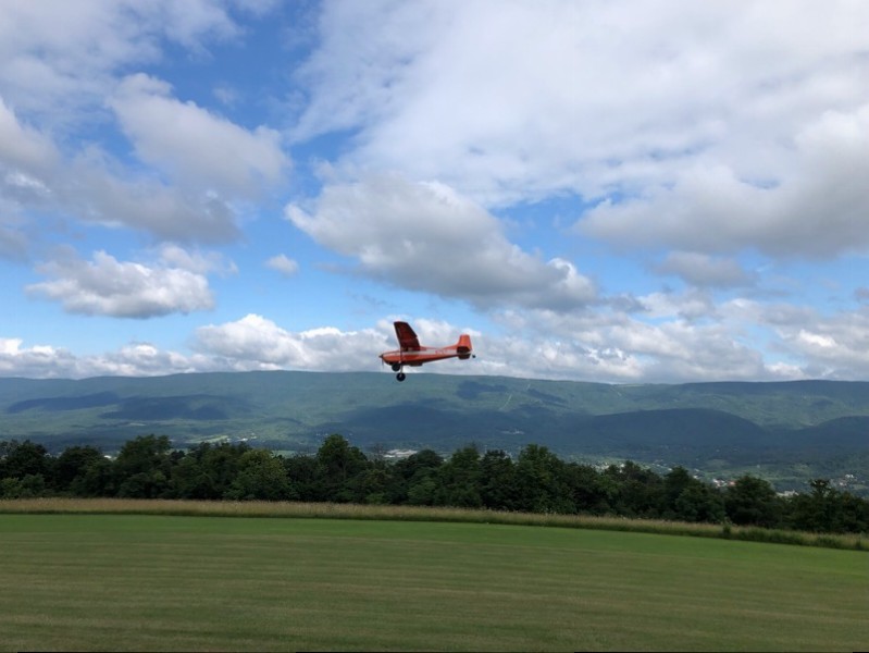

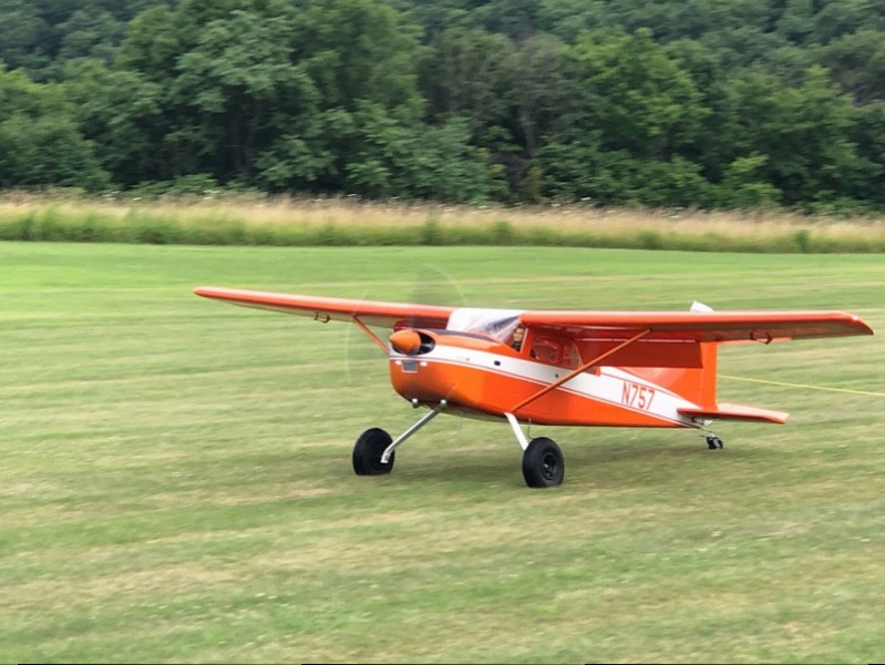

  • The Cessna 185 at Cumberland Summer Soaring event.

      Thanks Jim, sweet landing photo's. I'm pleased that you were smitten by it.
  • i must say this plane is a marvel to watch. such scale flight with no bad habits.. and enough power to tow up the big ones.. its a keeper for his kit line........
    and after meeting gunny i now know why so many people talk about his building skills and his friendly personality.. arkus too
    • gunny11
      gunny11 commented
      Thank you so much for the kind words, it's always nice to meet new people and talk rc.

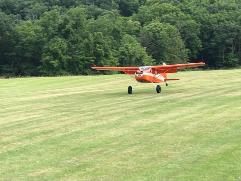

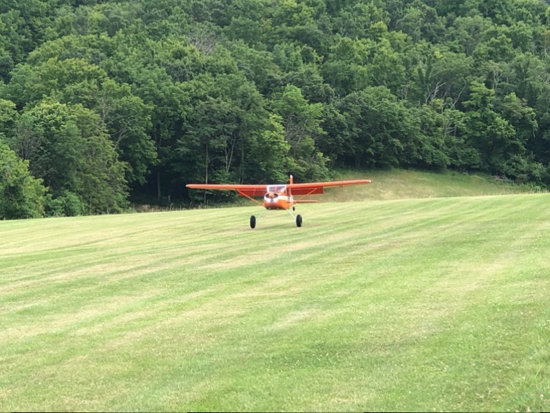

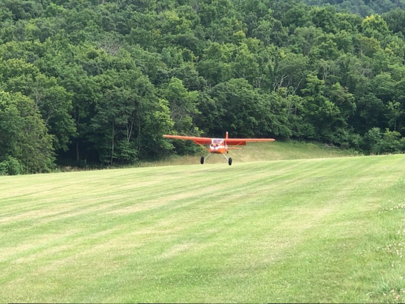

  • Can't get much more realistic!
Name:
    • gunny11
      gunny11 commented
      Steve! I absolutely just love this shot!!!!!
      I can't believe this was the first shot you took from a cell phone.
      Looks like a full scale flying over the valley. One in a million shot..
      Yeah... that picture is awesome!
  • Fooled me, and I was flying it..... ( I think)

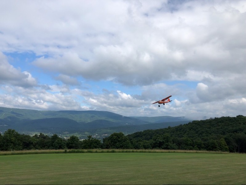

    • Gunny, Great Job! It's a beautiful plane. Glad I got to tow behind it once (I think it was once). The rest of the time I was compelled to take pictures. The extra touches like the lights make it that much more realistic.
      So I did a quick grab and edit of some shots I had. So here are a bunch, mostly of the evening flying. There will be a few more in the album when I can get it done but for now - enjoy.

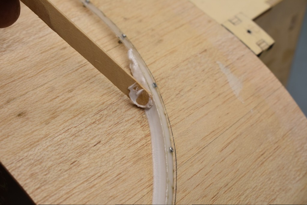

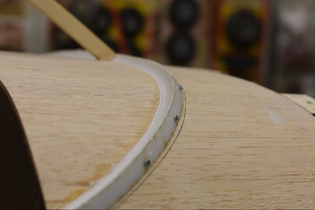

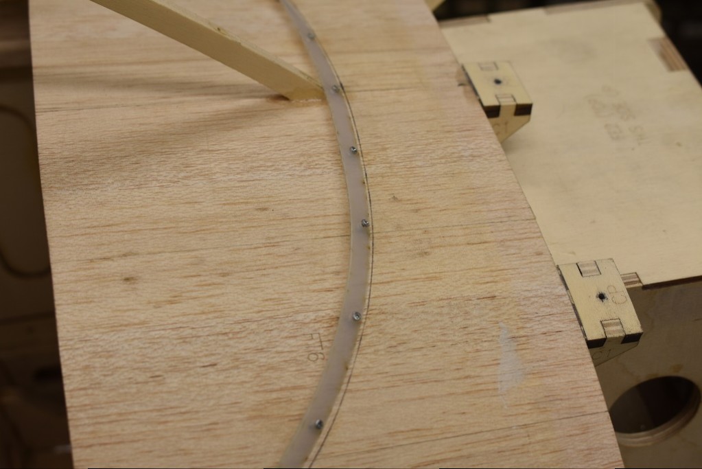

        • So, back to the build thread...

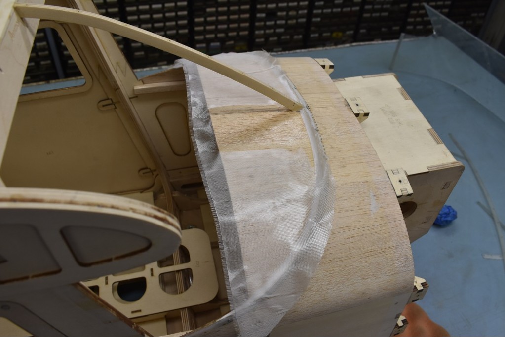

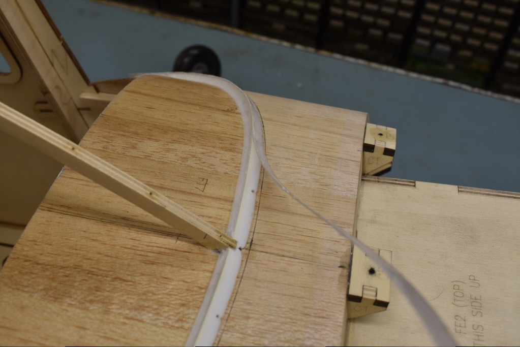

          Wanted to add to the bottom windshield/instrument hood a fillet for better attachment. I came up with a neat idea by using a false windshield strip. (included in the kit).
          Mixed up some epoxy and micro balloons and easy peazy. Once cured removed the strip. I glassed the hood because flat black covering on here can wrinkle. So glassed and painted it.

          • Did you wax the inside of the false strip so the epoxy would not stick to it?
            • gunny11
              gunny11 commented
              No, I instruct in the manual to leave on the plastic protective coating. Like packing tape, nothing sticks to it. However, I instruct the builder to wax it if they accidentally removed the plastic coating.

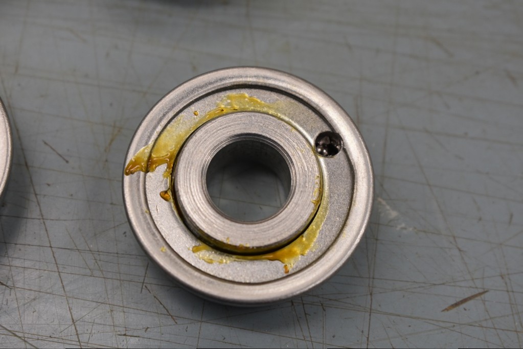

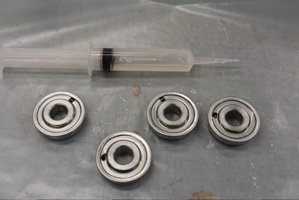

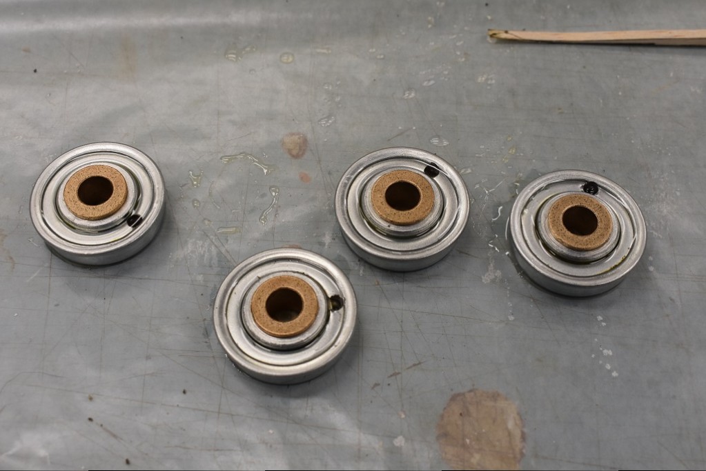

          • On my 10" utility wheels I was concerned that the ball bearings would make the plane roll and roll and roll and never stop. Now that I flew this wheel combo, I'm so glad I did this mod. What I did was drill a hole in the bearing race and wash out the grease with a degreaser and compressed air. Then I locked the ball bearings with epoxy. Inserted oil-lite bushings and before the epoxy fully set-up I put everything back together with the axle bolts to keep everything aligned.

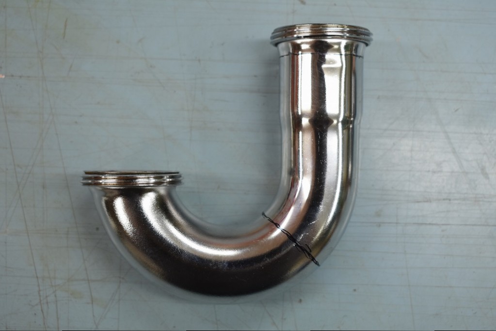

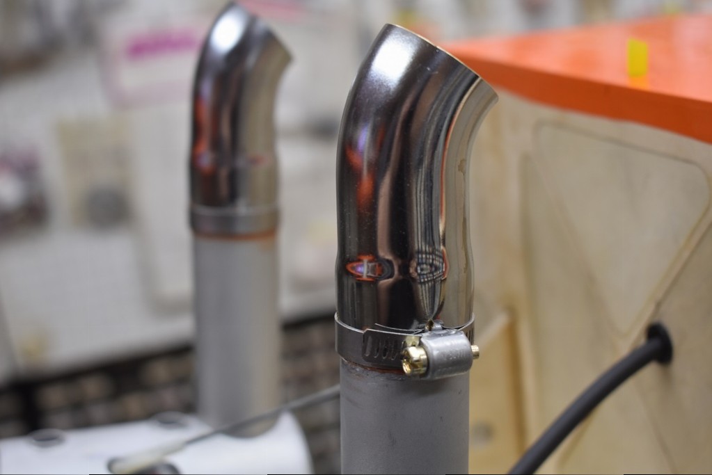

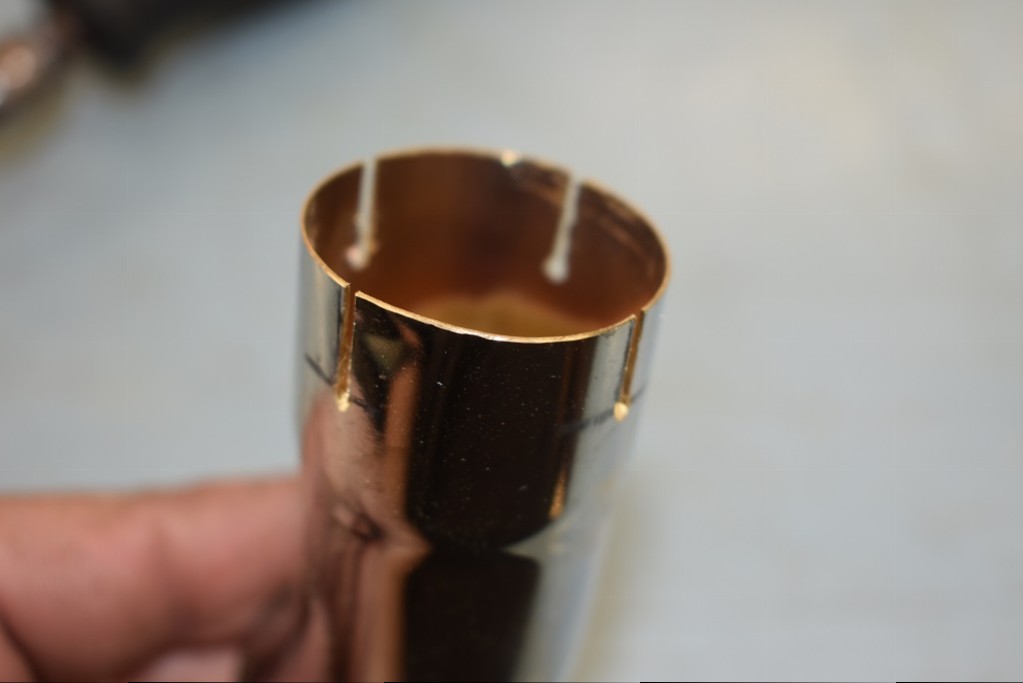

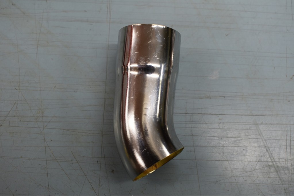

            • This plane even has a bathroom sink part installed in it! LOL

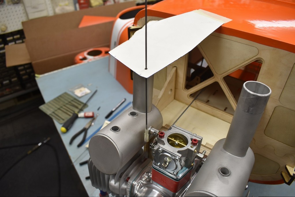

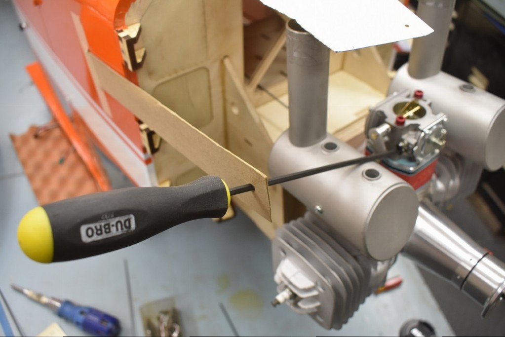

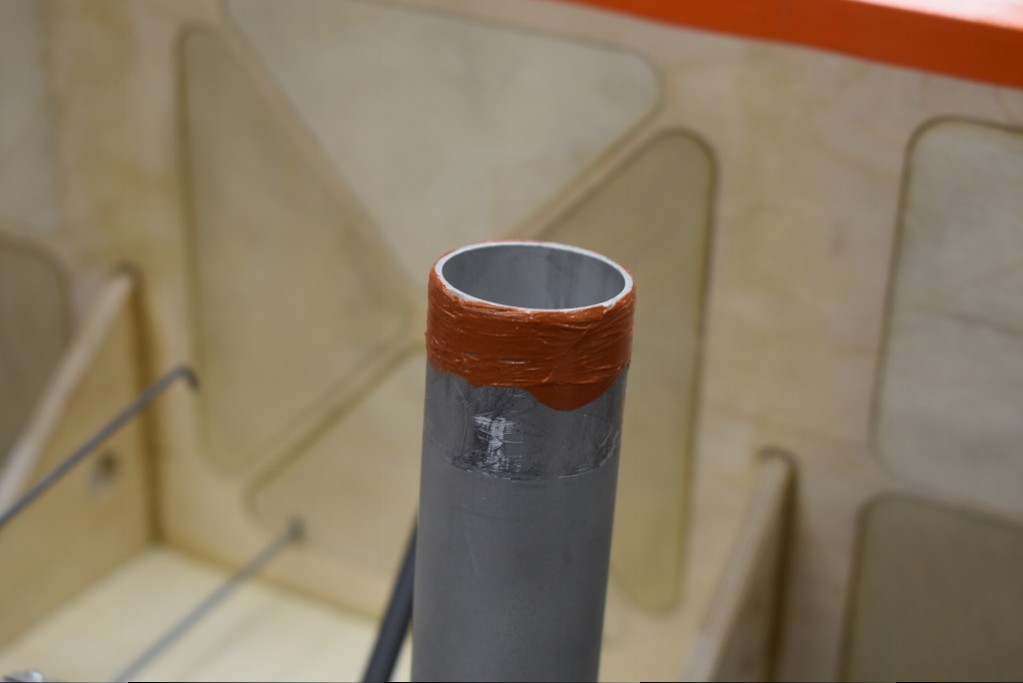

              I searched and searched for materials to use for extensions of the exhaust pipe. Never found anything that would work... Until one afternoon I was in Ace Hardware store and saw an 1 1/4" bathroom P-trap. Well, why not give this a try? It's thin metal is light weight and has a nice chrome finish. Here is how I did it.
              Cut the P-trap as shown and drill four holes half way down the flared end 90° apart. Cut slots to the holes and add high temp RTV silicone and clap onto the stacks with a hose clamp. This worked out extremely well. The muffler stacks on the DA 150 is about 1 1/2" too short. You can even use an 1 1/4" straight tail piece.
              Click image for larger version  Name:	DSC_2273.JPG Views:	1 Size:	92.6 KB ID:	37746
              Click image for larger version  Name:	DSC_2274.JPG Views:	1 Size:	93.7 KB ID:	37745
              Click image for larger version  Name:	DSC_2280.JPG Views:	1 Size:	48.3 KB ID:	37744
              Click image for larger version  Name:	DSC_2286.JPG Views:	1 Size:	56.9 KB ID:	37743
              Click image for larger version  Name:	DSC_2290.JPG Views:	1 Size:	76.0 KB ID:	37747

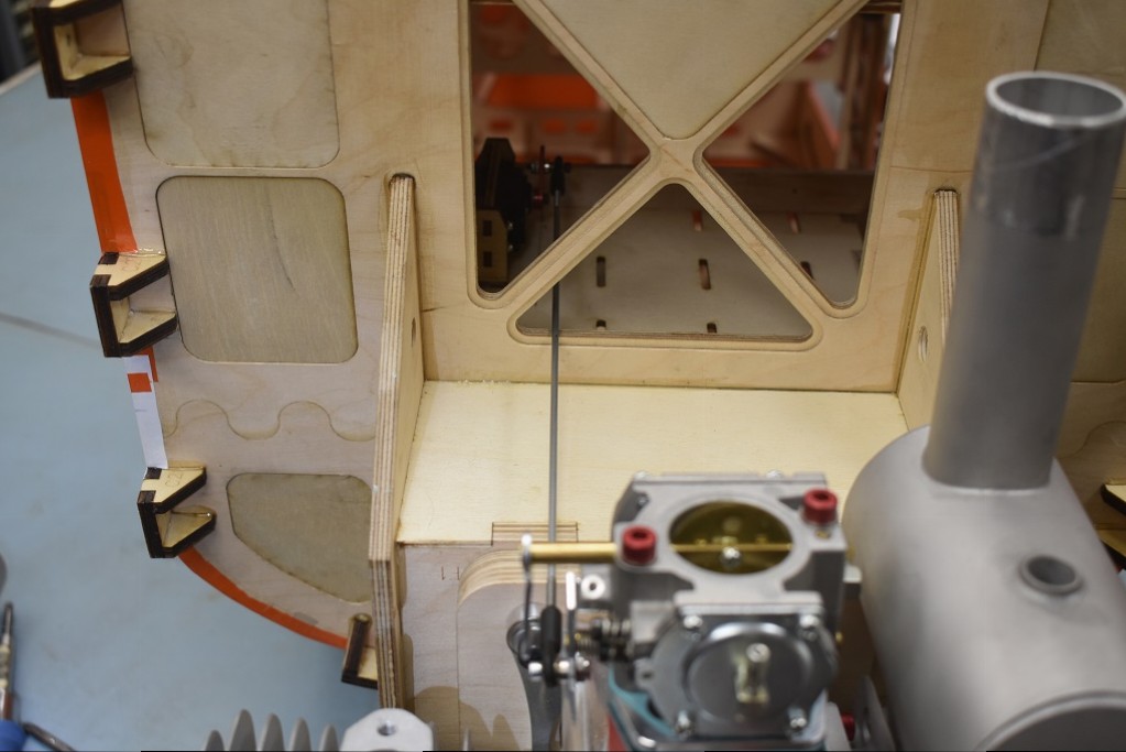

                • Some shots of the power plant end...

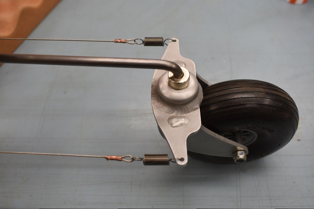

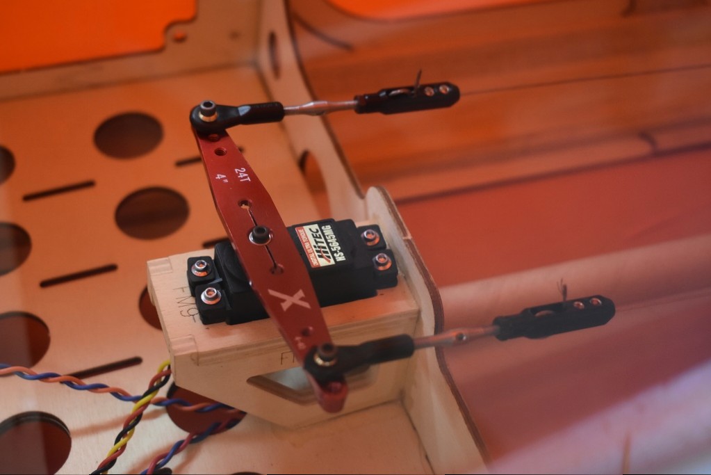

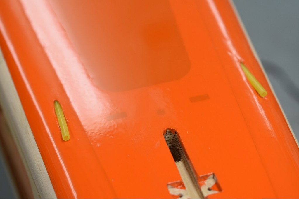

                  • Pull pull cable installation for the tail wheel steering is done after the bottom of the fuselage is covered.
