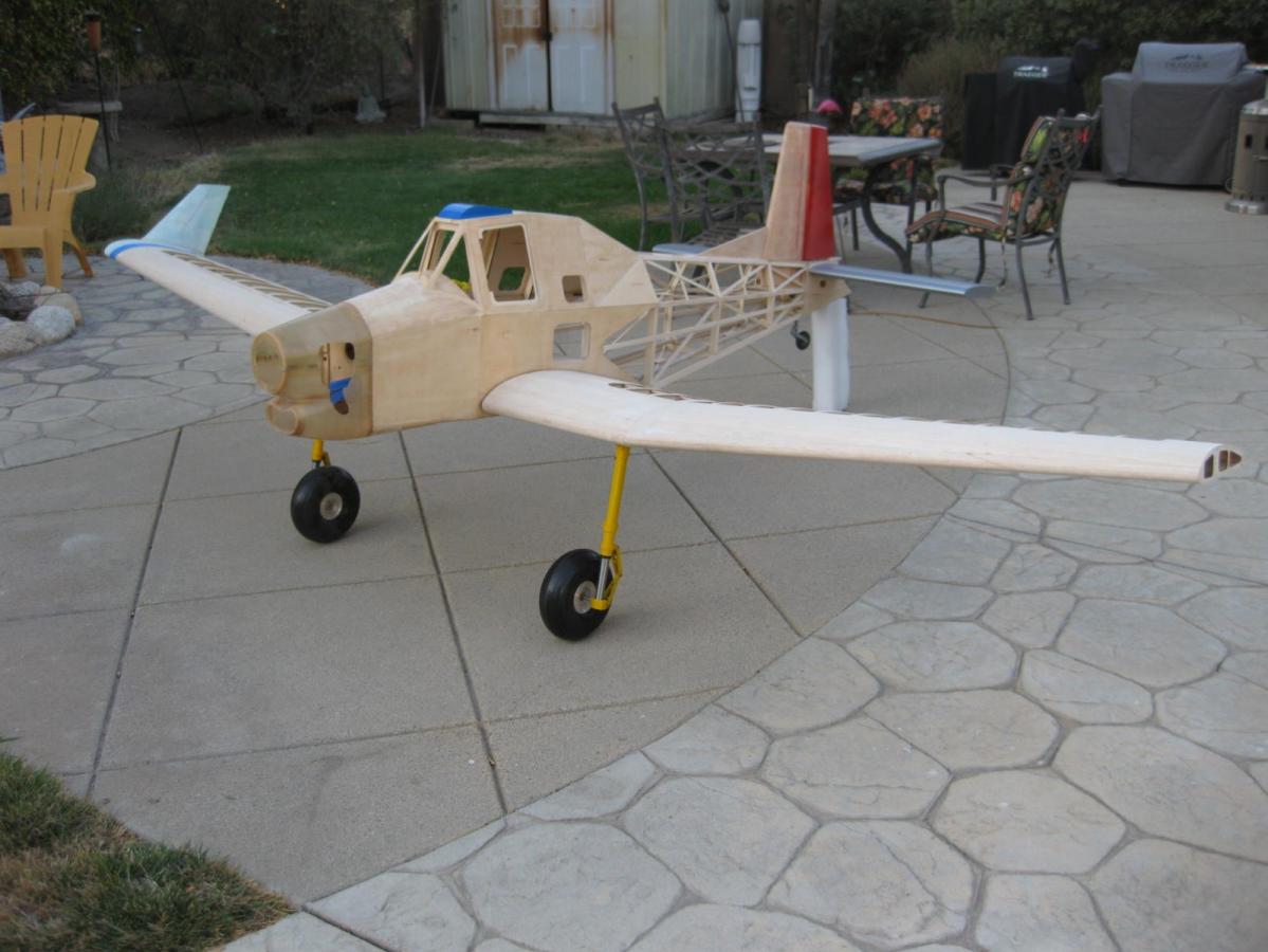

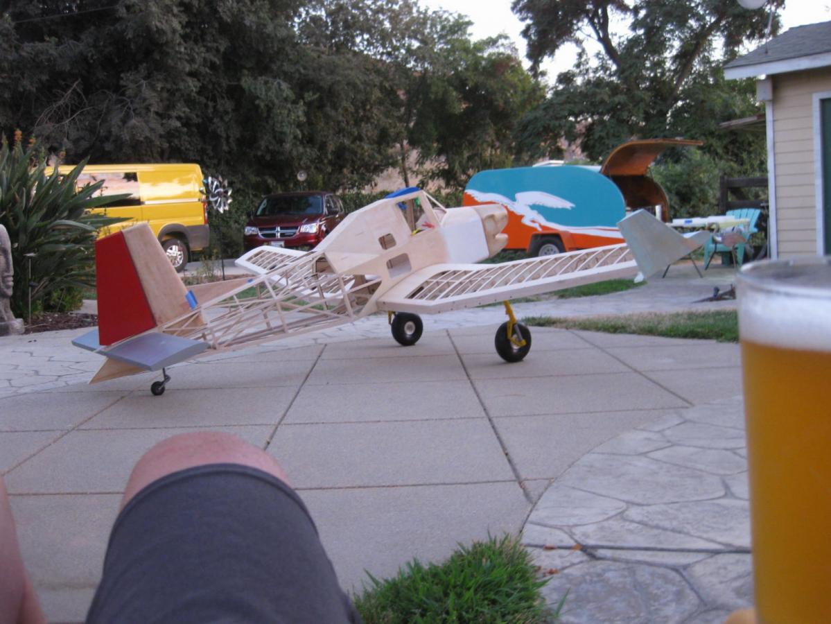

    Thanks Guys,
    Taking a moment to assemble the bits and pieces.....and am Enjoying the view.
    Click image for larger version  Name:	IMG_5135.JPG Views:	1 Size:	129.2 KB ID:	38213
    Click image for larger version  Name:	IMG_5117.JPG Views:	1 Size:	104.7 KB ID:	38214
    Guess I better get going on that left wing tip winglet.

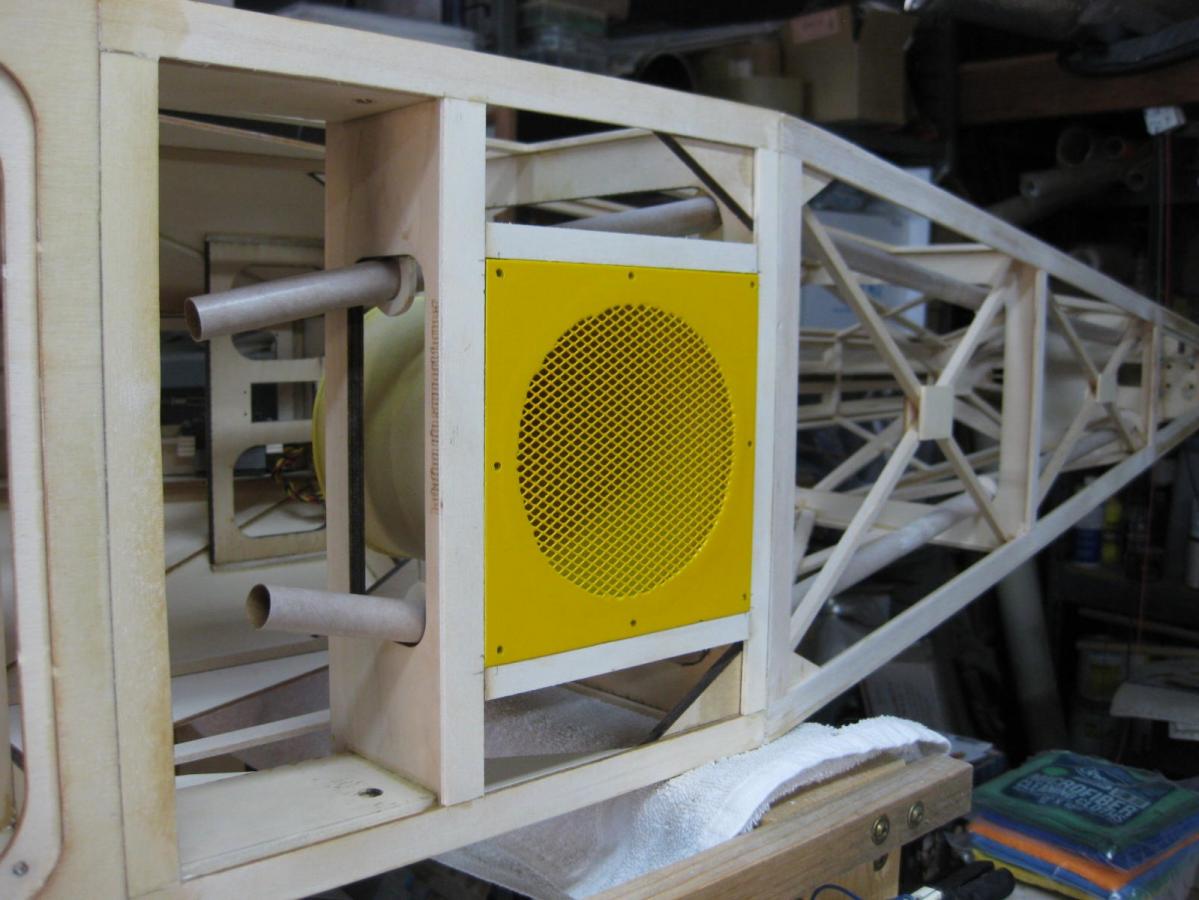

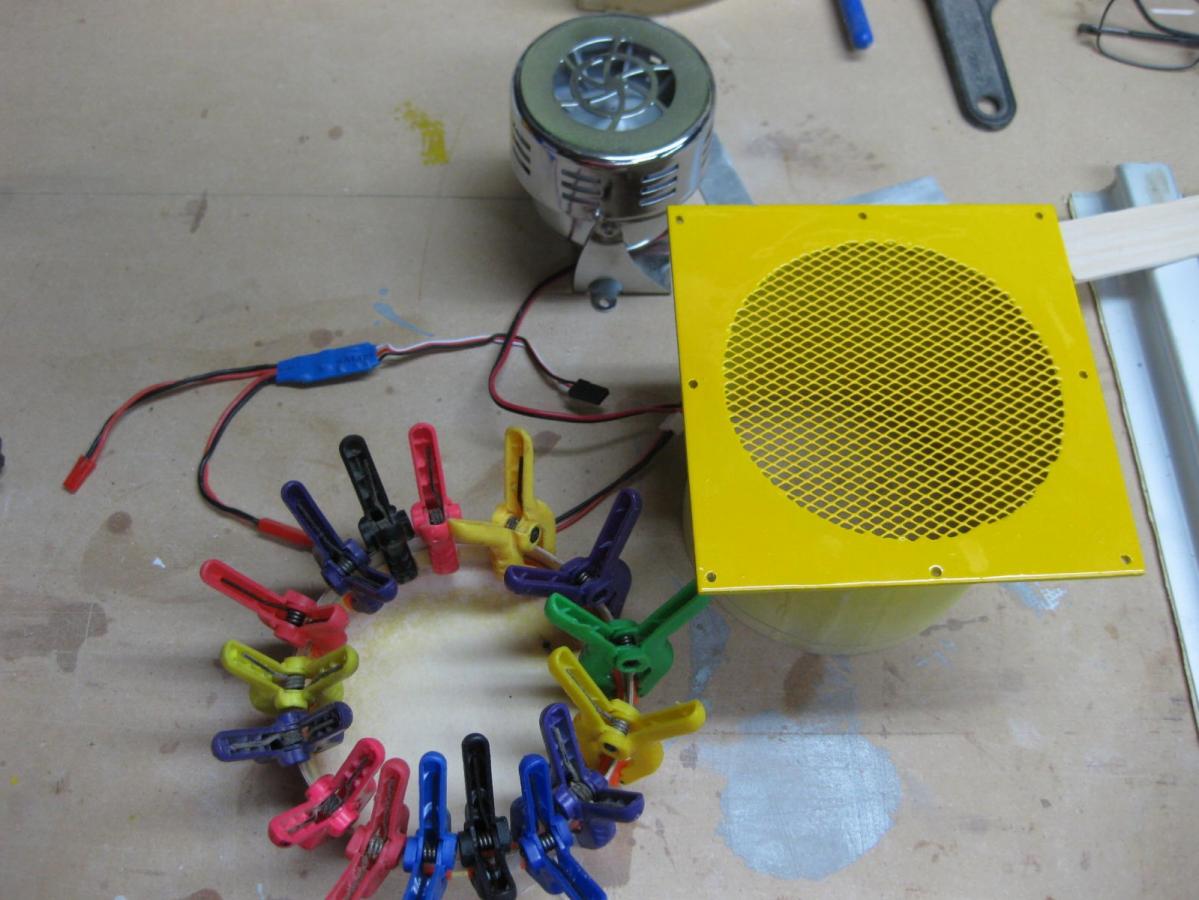

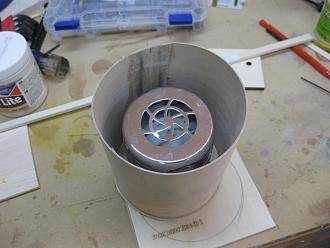

        Stuka-Effektmodul
ID:	38306Click image for larger version
ID:	38305Click image for larger version
ID:	38310Click image for larger version
ID:	38309Click image for larger version
          I like the Stuka siren idea!

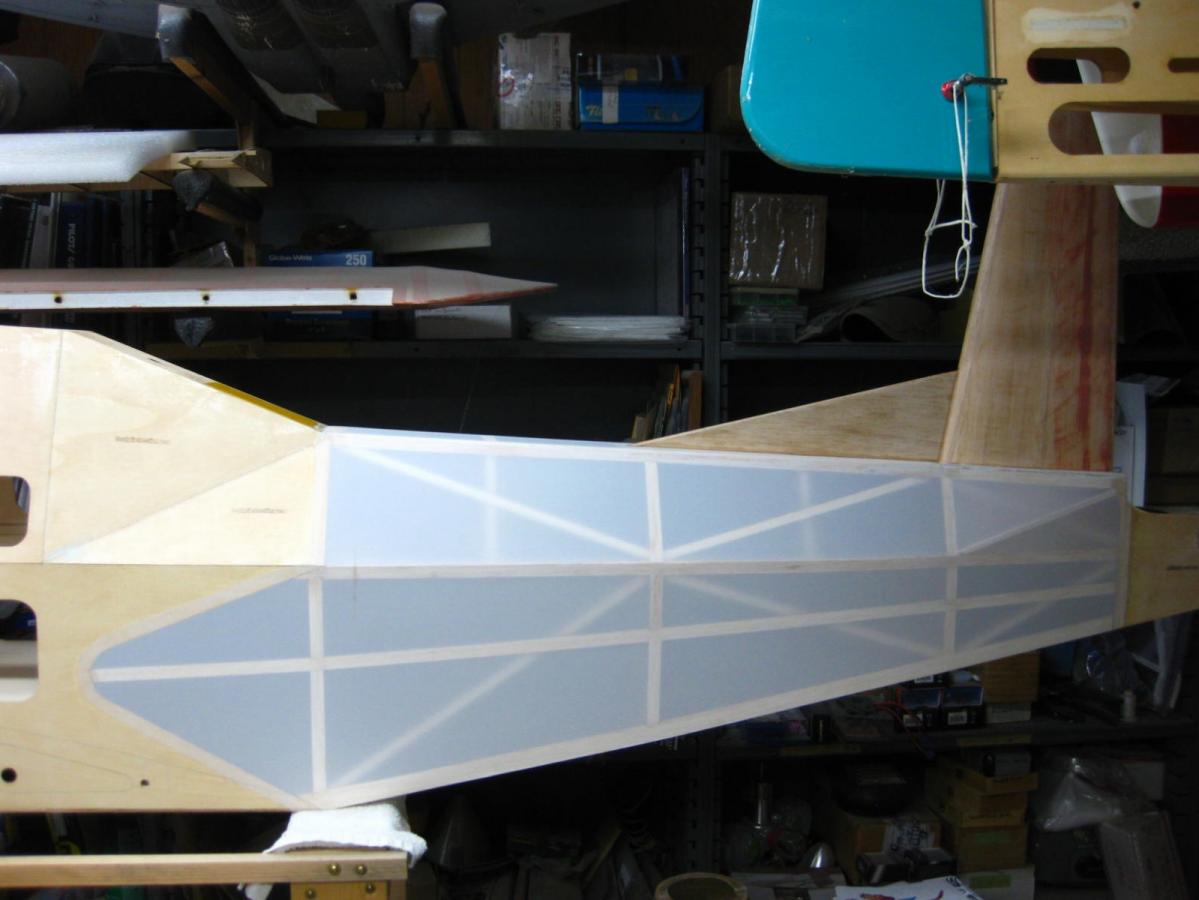

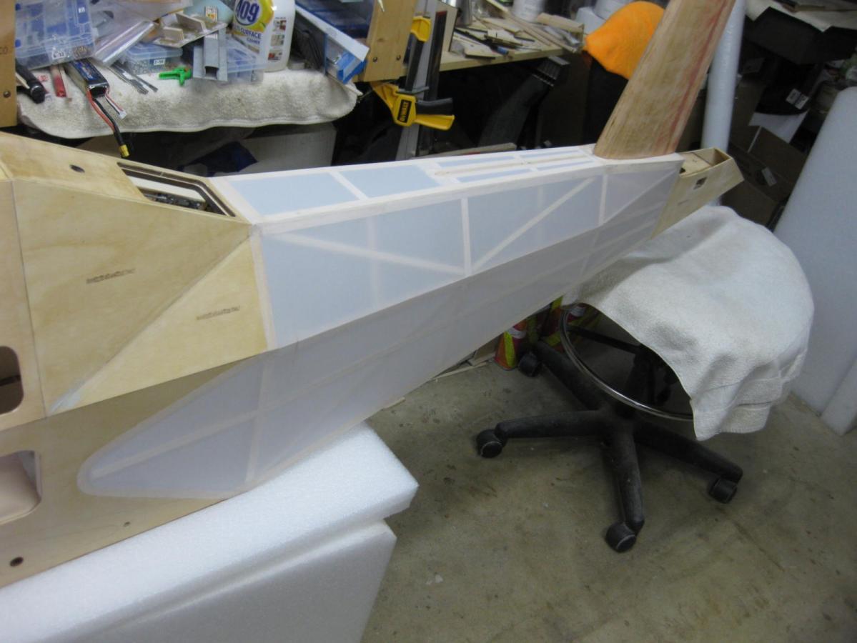

        Modified Stits lite process begins - modified as in the PolyTak is thinned 3:1 and then two coats are brushed on to the surfaces that you want to glue down. Then fabric is glued down by passing a paper towel saturated with Polyfiber thinner over the fabric laying on the coated surface.
        Bottom first as the top/sides piece will wrap around to the bottom to hide the seem.
ID:	38318Click image for larger version
        Then the top and sides
ID:	38319Click image for larger version
ID:	38320Click image for larger version
        Trimming the edges and ...... almost makes me consider a see-thru type of color scheme -
        With the dorsal fin installed.

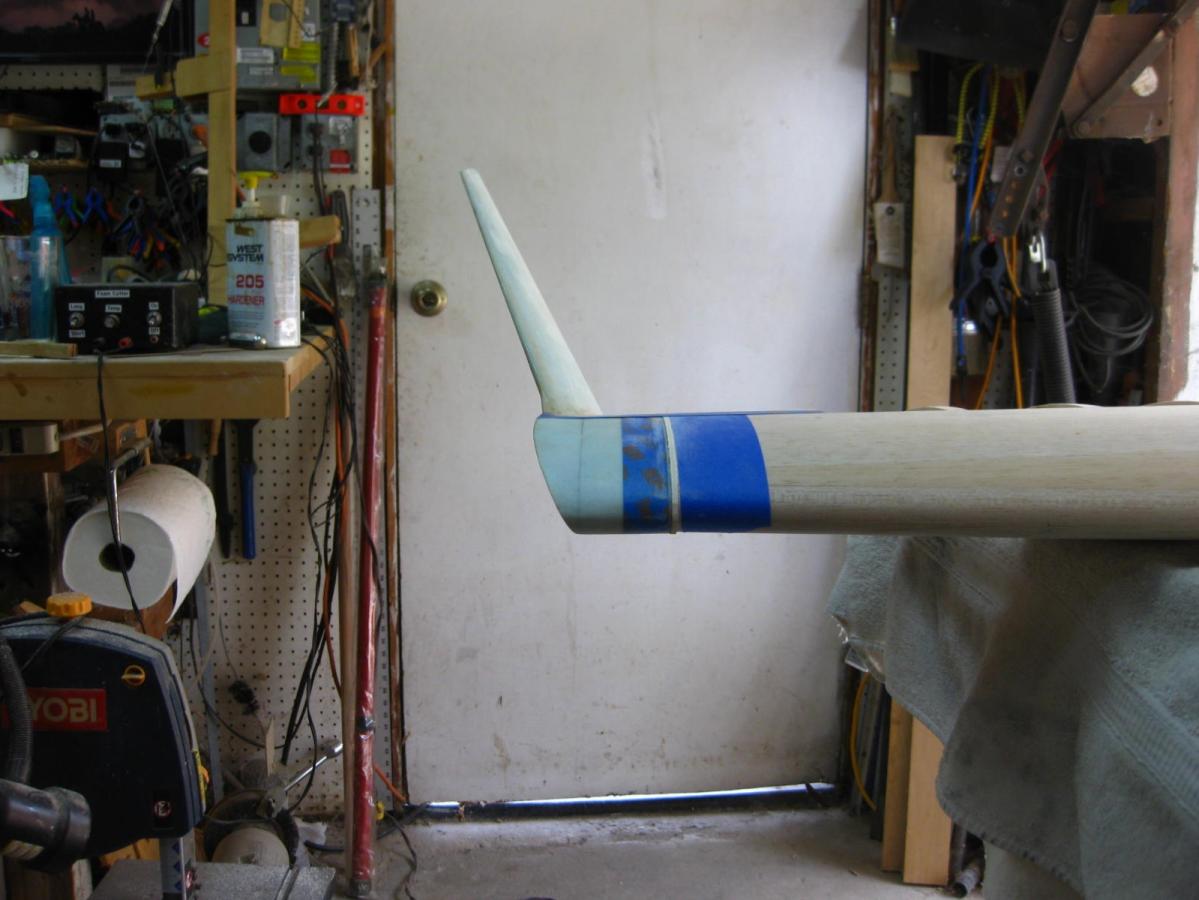

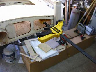

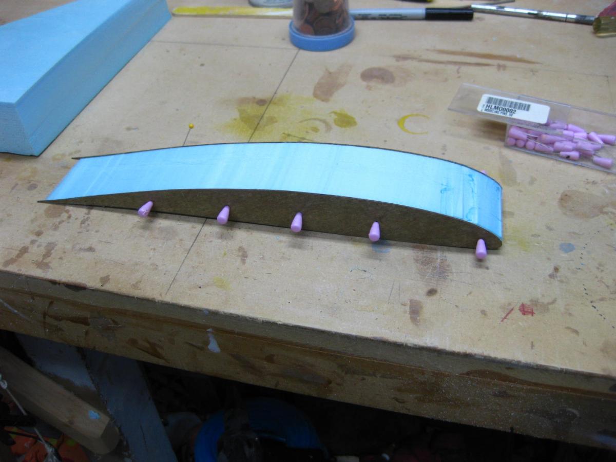

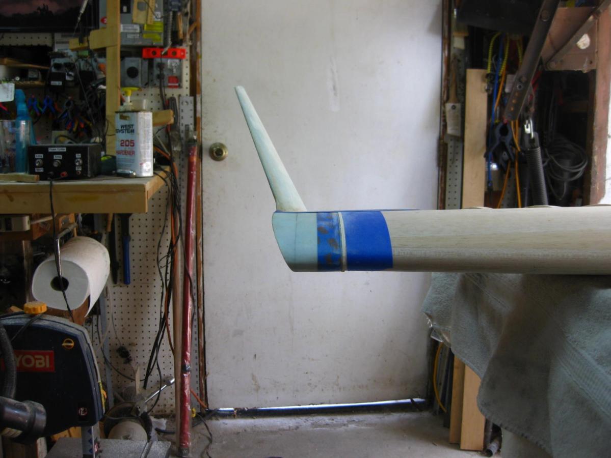

        • #96

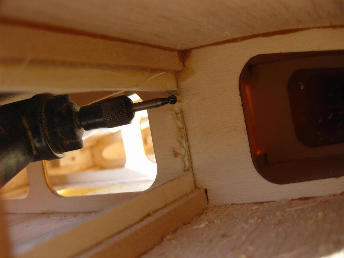

          Winglet support structure installation before wing covering.
ID:	38329Click image for larger version
ID:	38328Click image for larger version
ID:	38326Click image for larger version
ID:	38330Click image for larger version

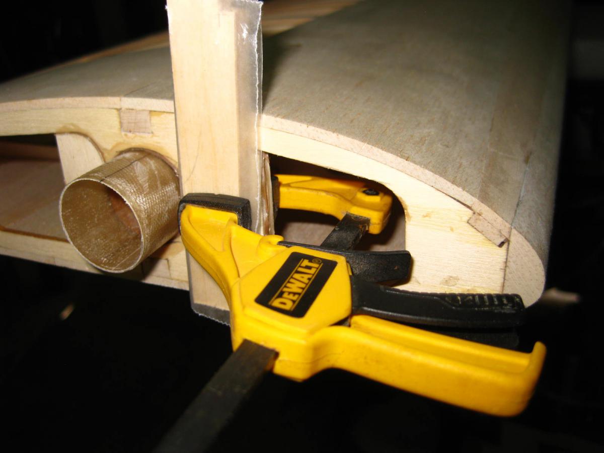

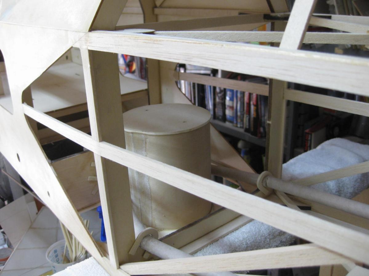

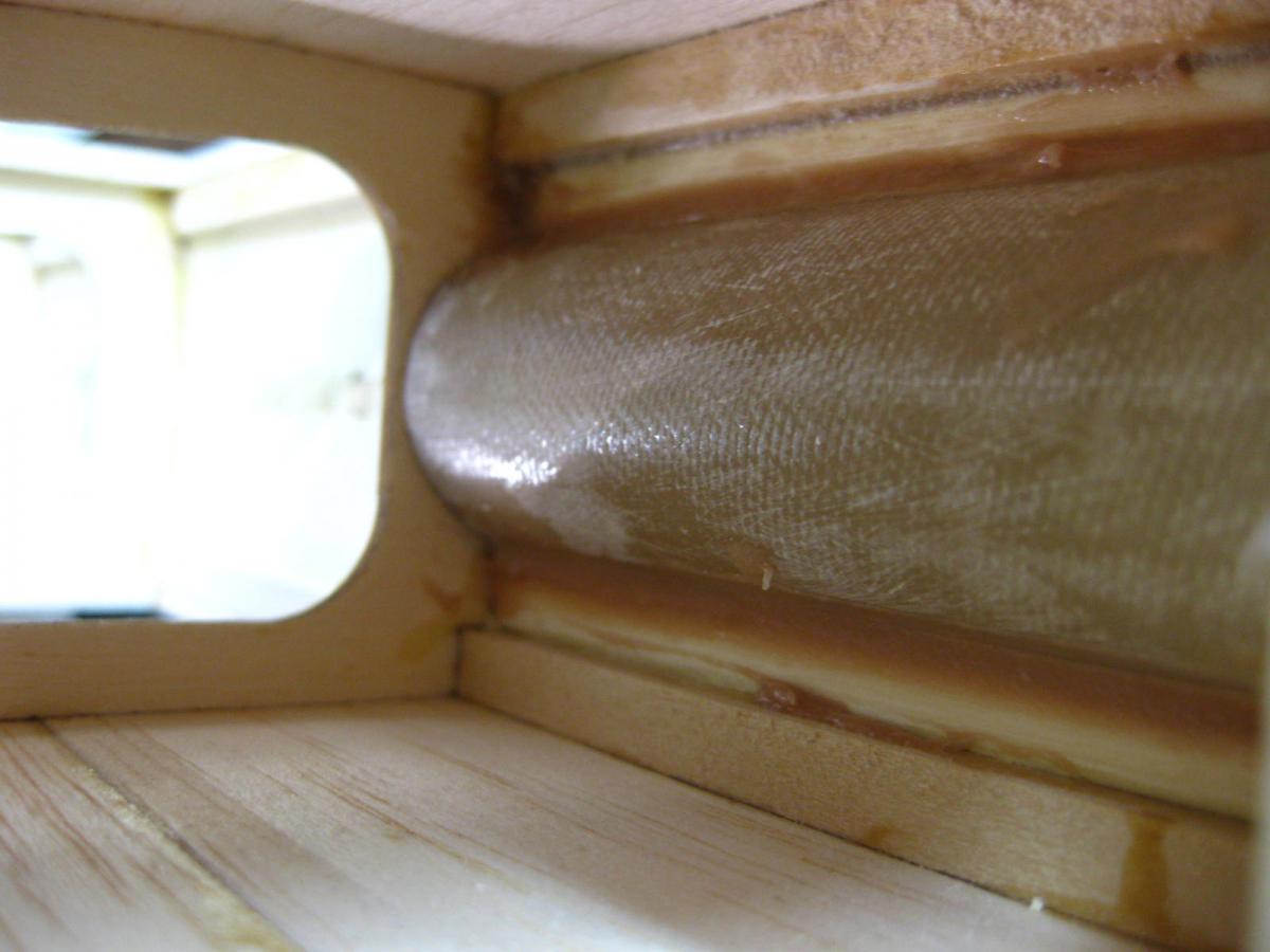

          • #97
            wax paper around the tube works great for making wing tubes, just the right amount of clearance.
ID:	38342Click image for larger version
ID:	38344Click image for larger version
ID:	38340Click image for larger version

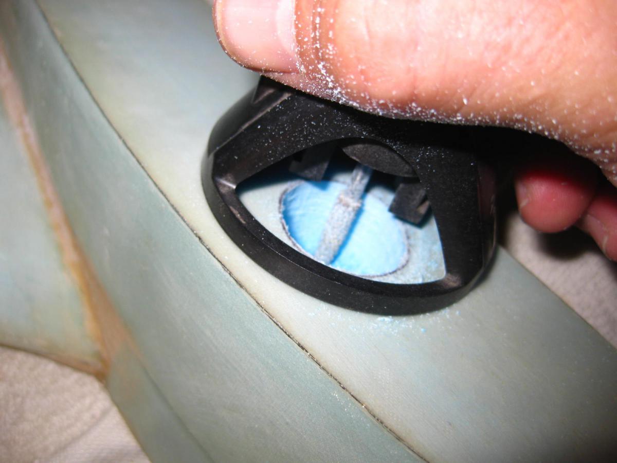

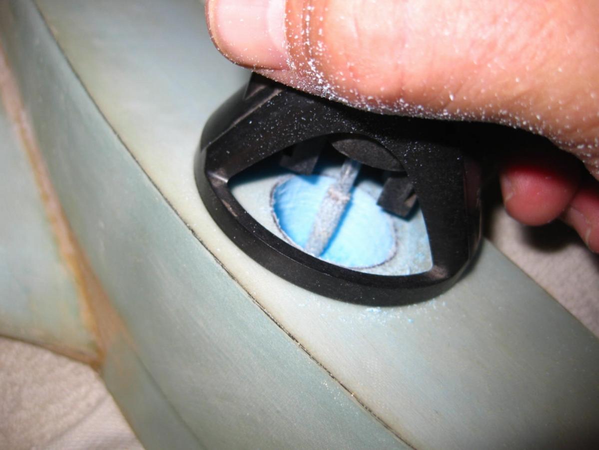

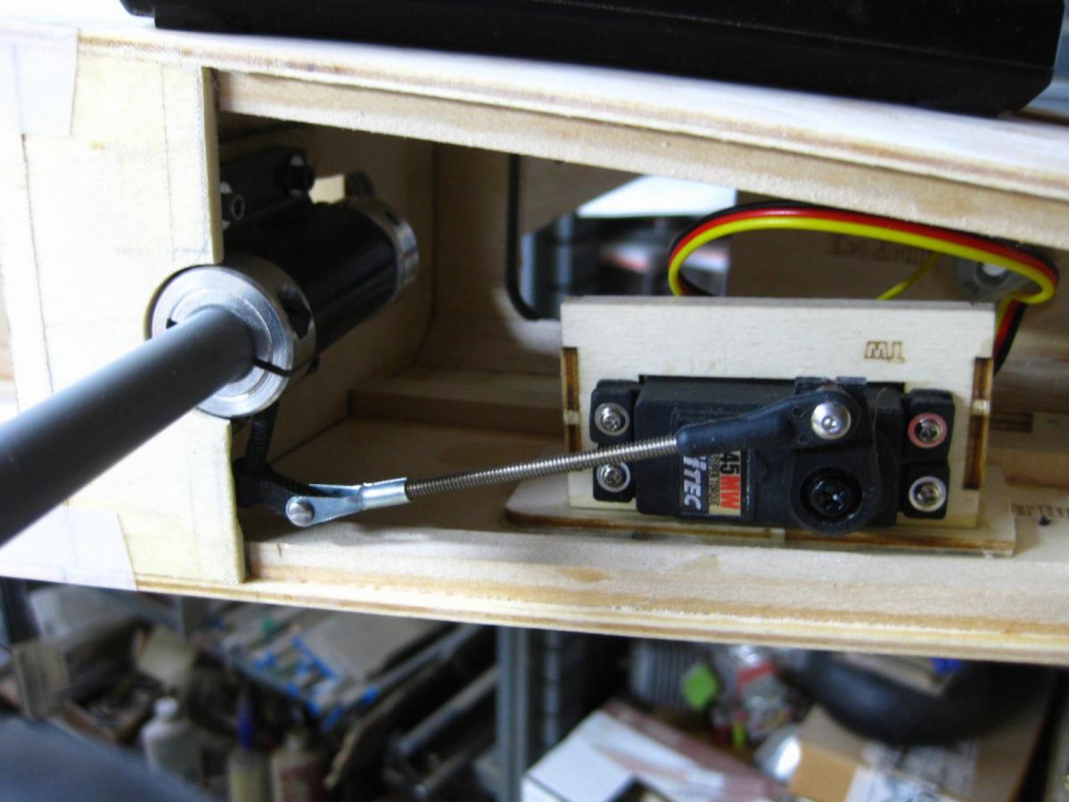

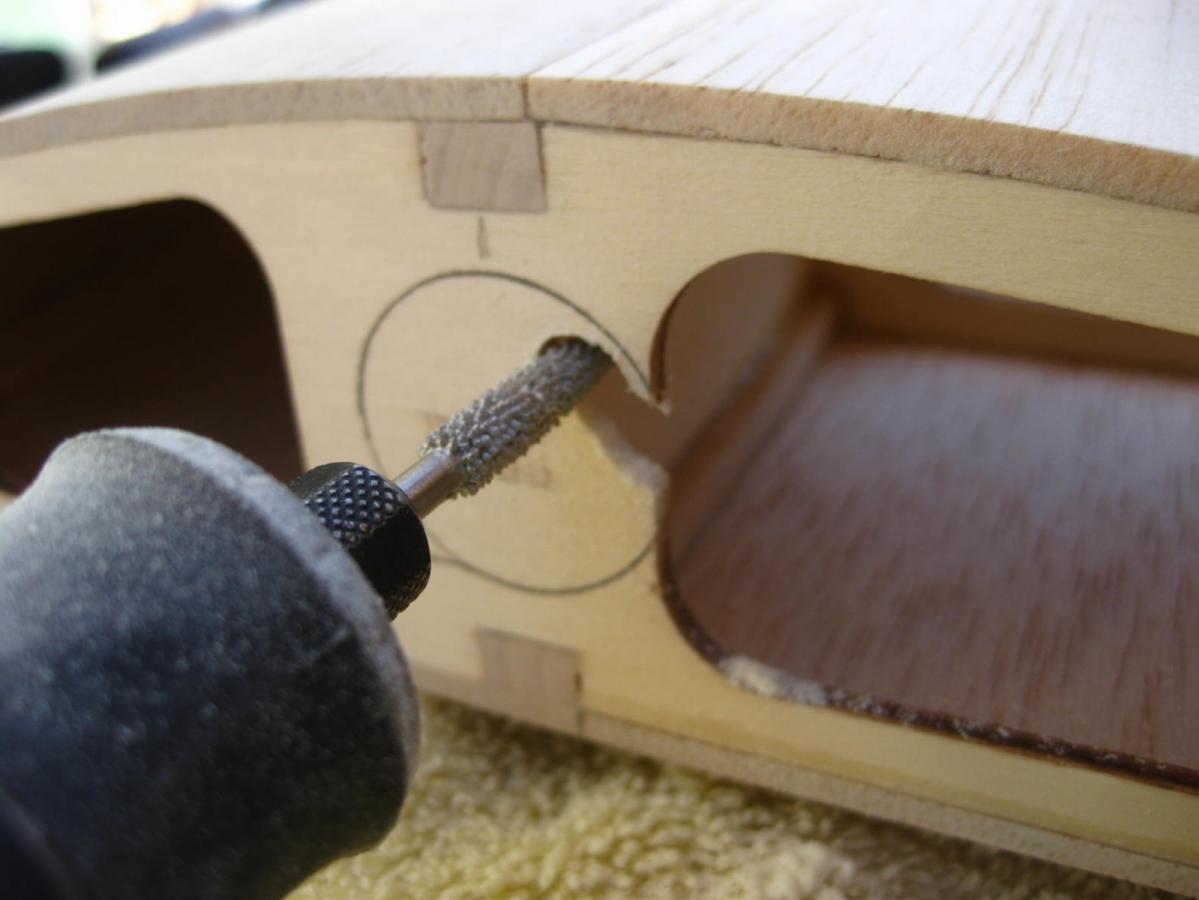

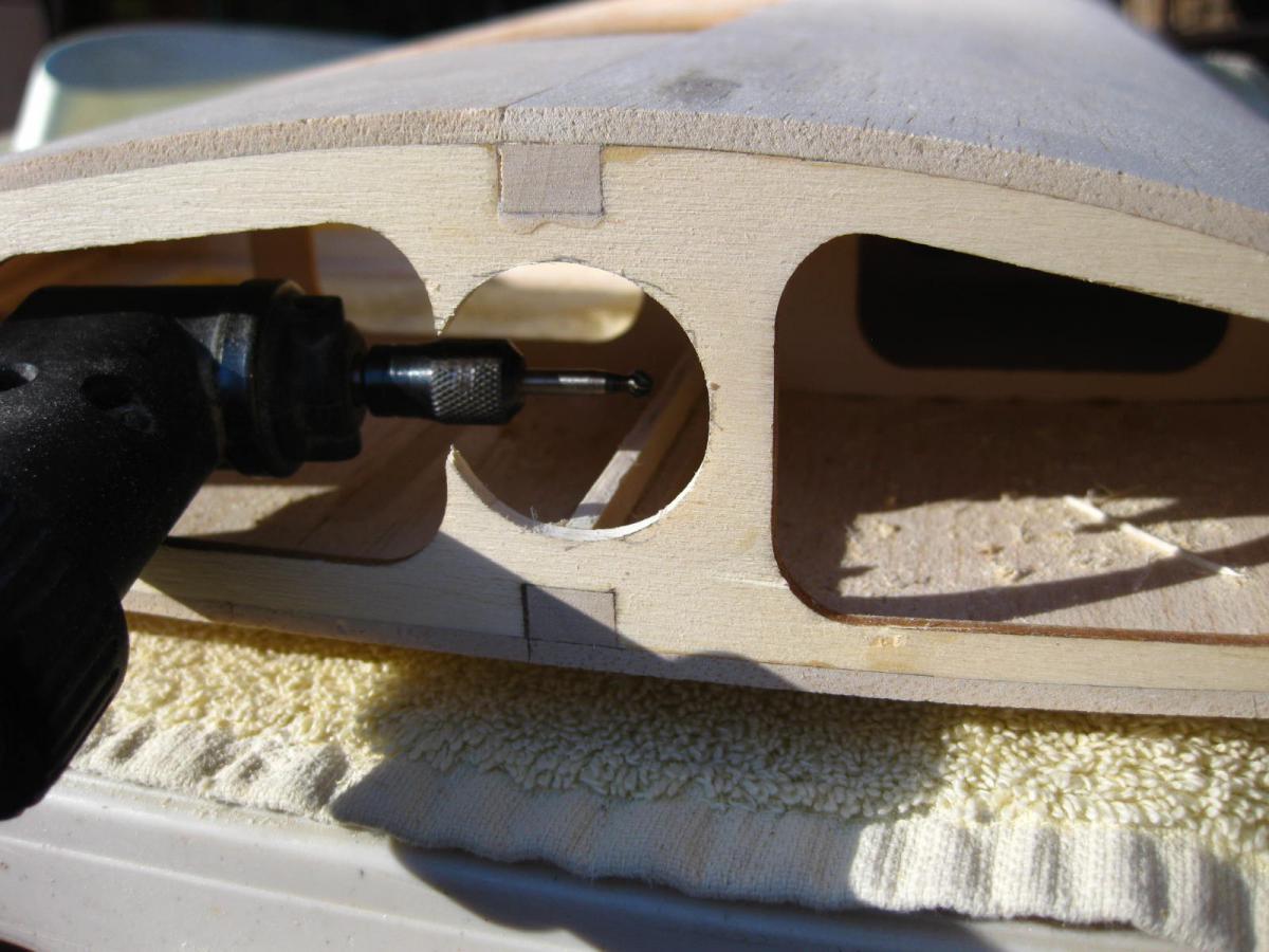

                One of the minor things, Tail wheel control.
                The Robart control arm is thicker than a standard Klevis connector ....and then I remembered I had some Robart control horns with thicker connectors ends ( for my ......uhmmmmm...........1/3......Schweizer 2-33........)

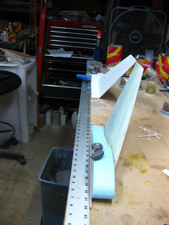

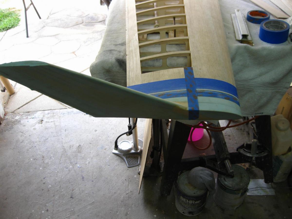

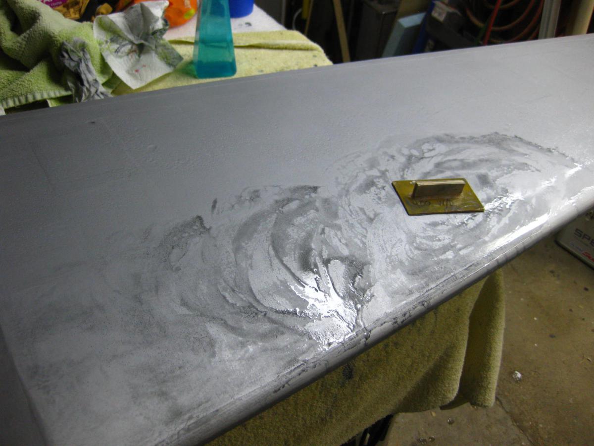

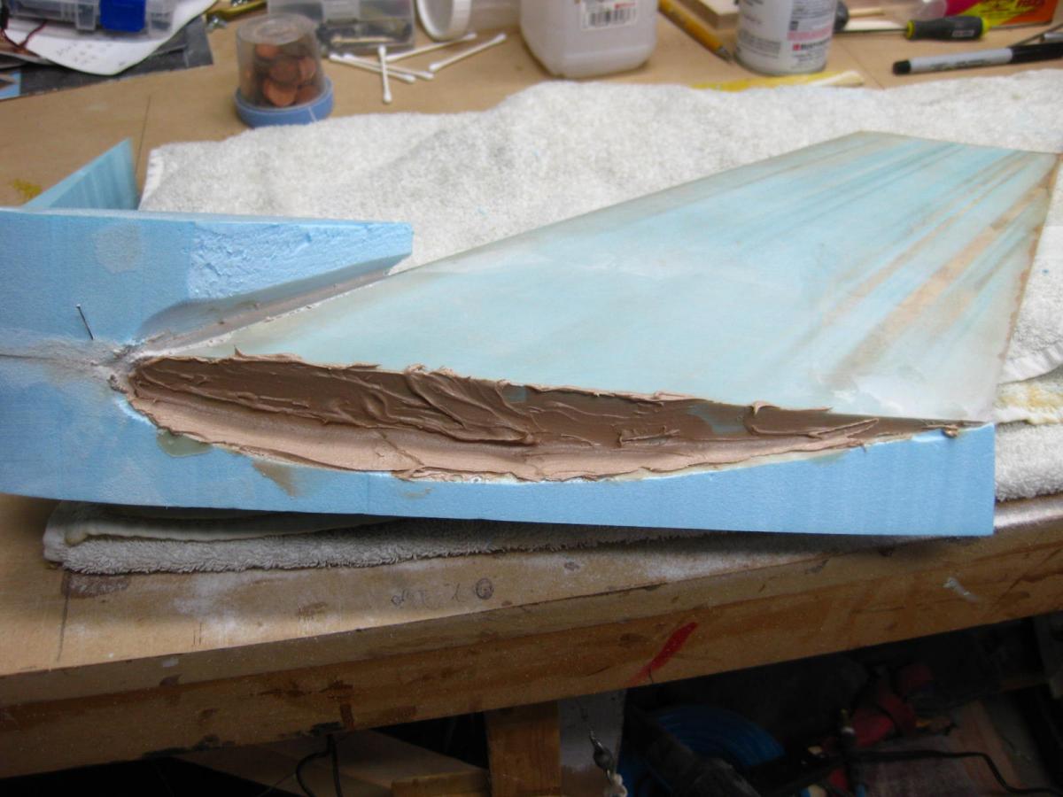

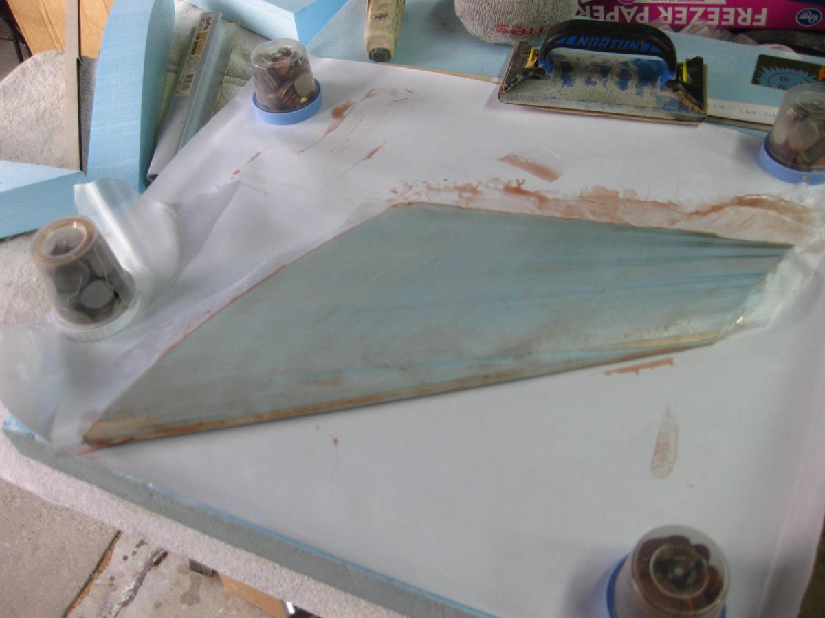

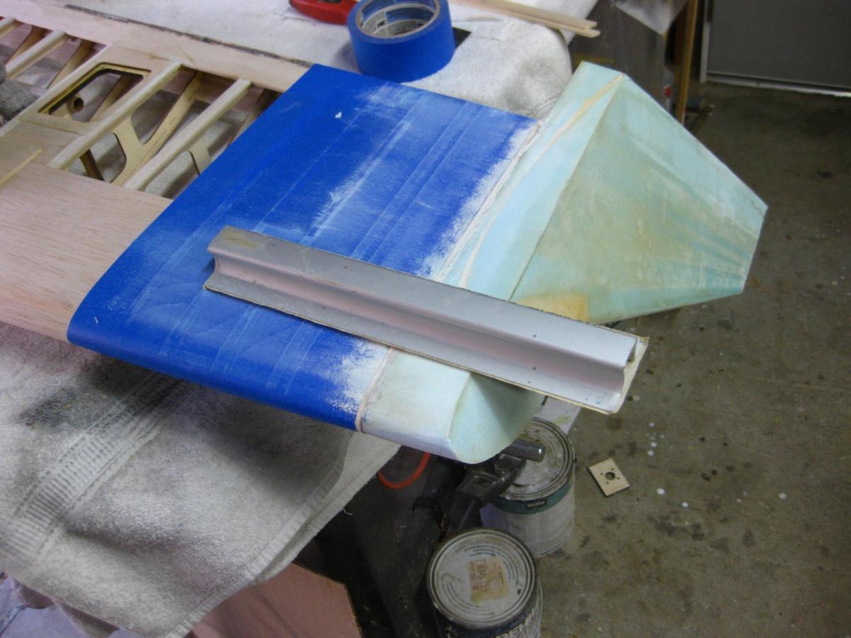

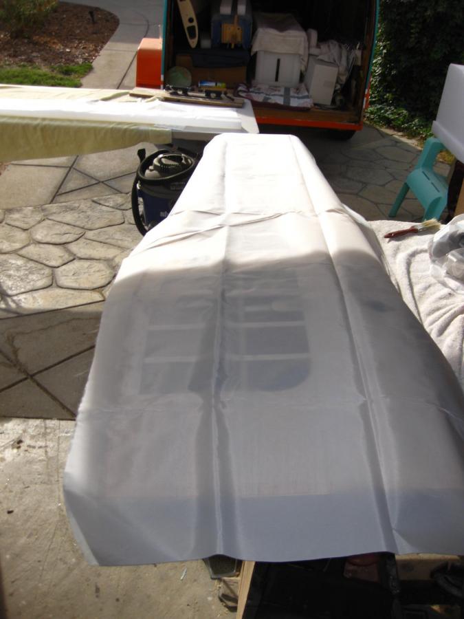

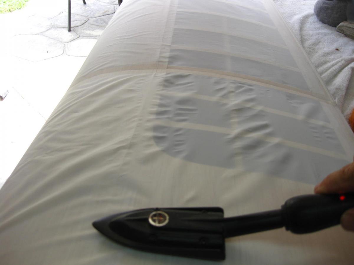

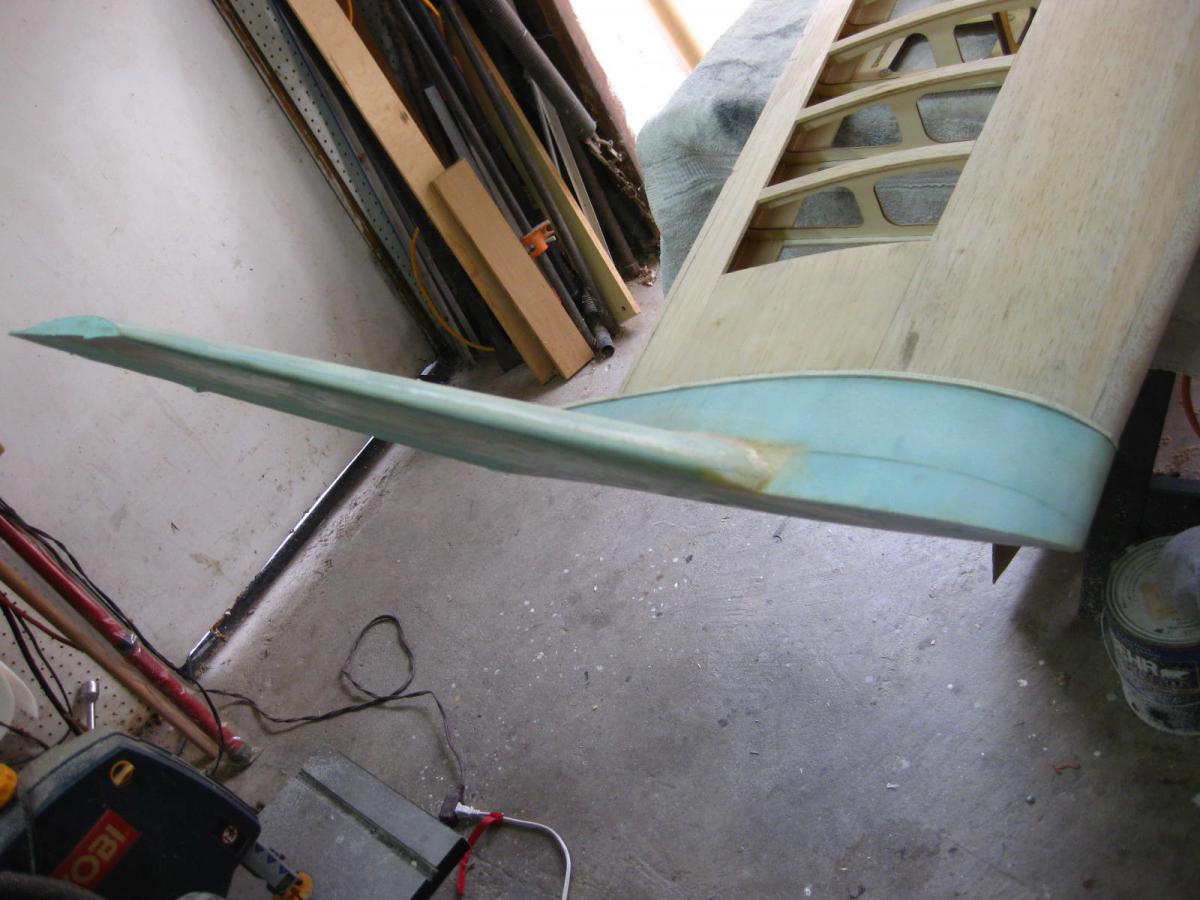

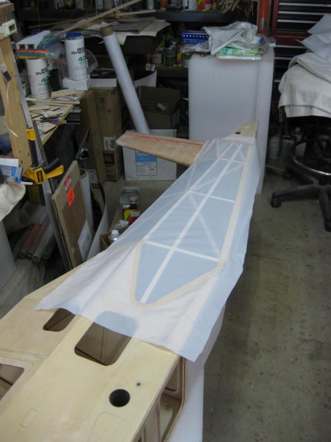

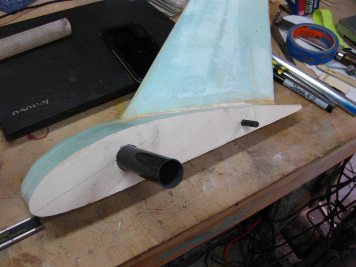

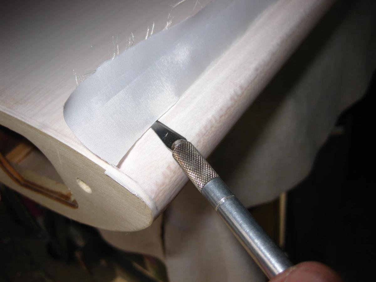

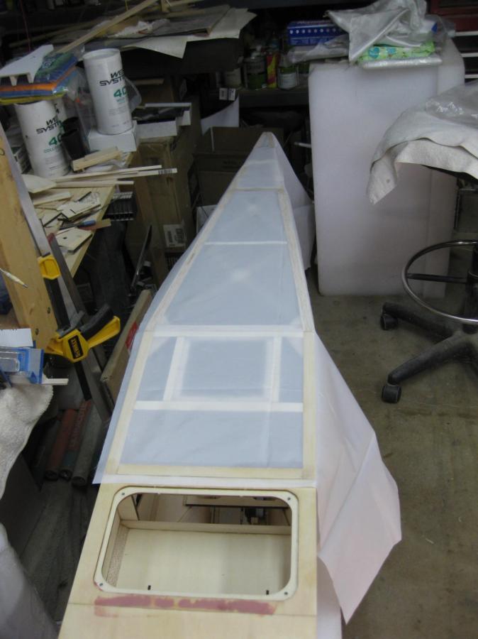

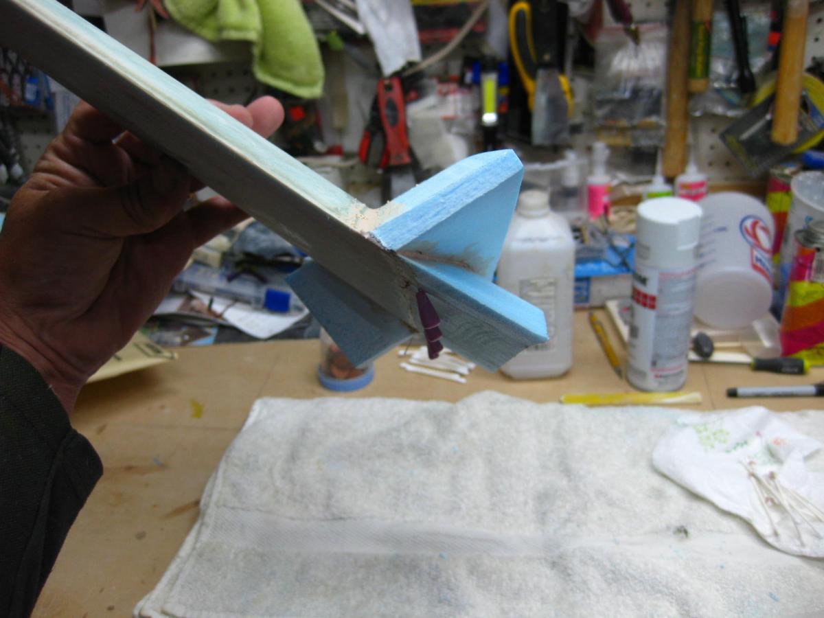

                  • Profile sanding the wingtip winglet and fiberglassing the Left tip winglet airfoil.
ID:	38457Click image for larger version

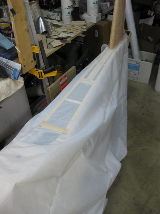

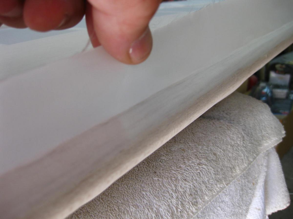

                    Covering the wing and shrinking to 300 F in 25 degree increments
ID:	38458Click image for larger version
                    Cutting the overlap worked pretty good
ID:	38459Click image for larger version
                    PolyTak was applied around the servo cover / landing gear openings before covering, then after shrinking, thinner was applied around the area to glue it down.

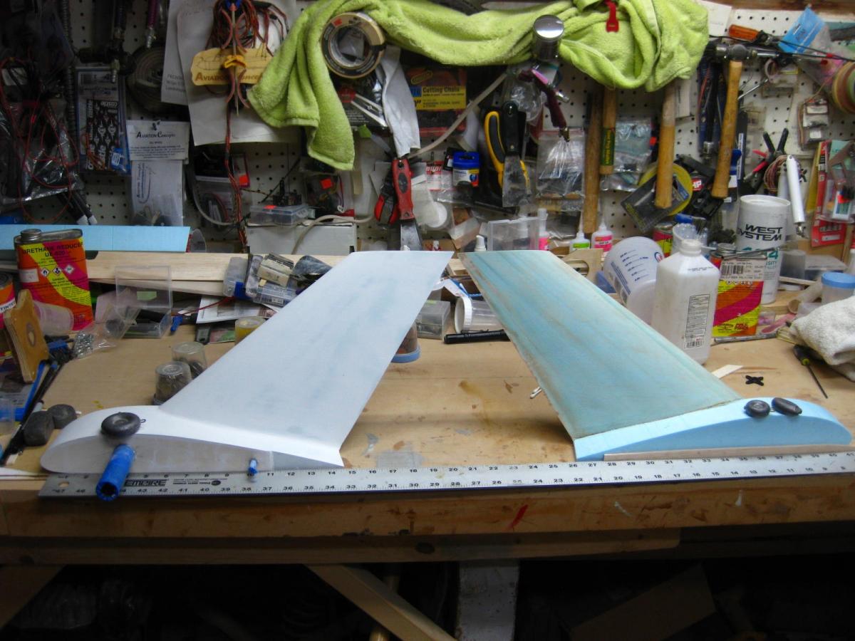

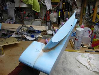

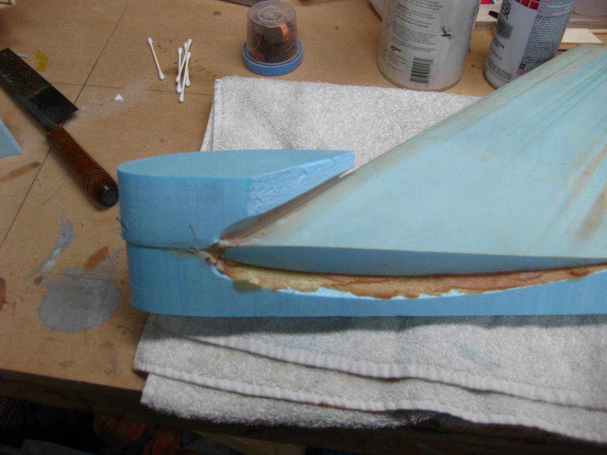

                    • Left wing tip progress.....in picture format.
ID:	38467Click image for larger version
ID:	38465Click image for larger version
ID:	38469Click image for larger version
                      Some Sanding Required ......

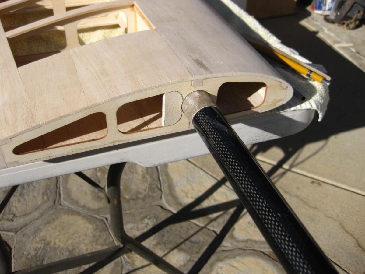

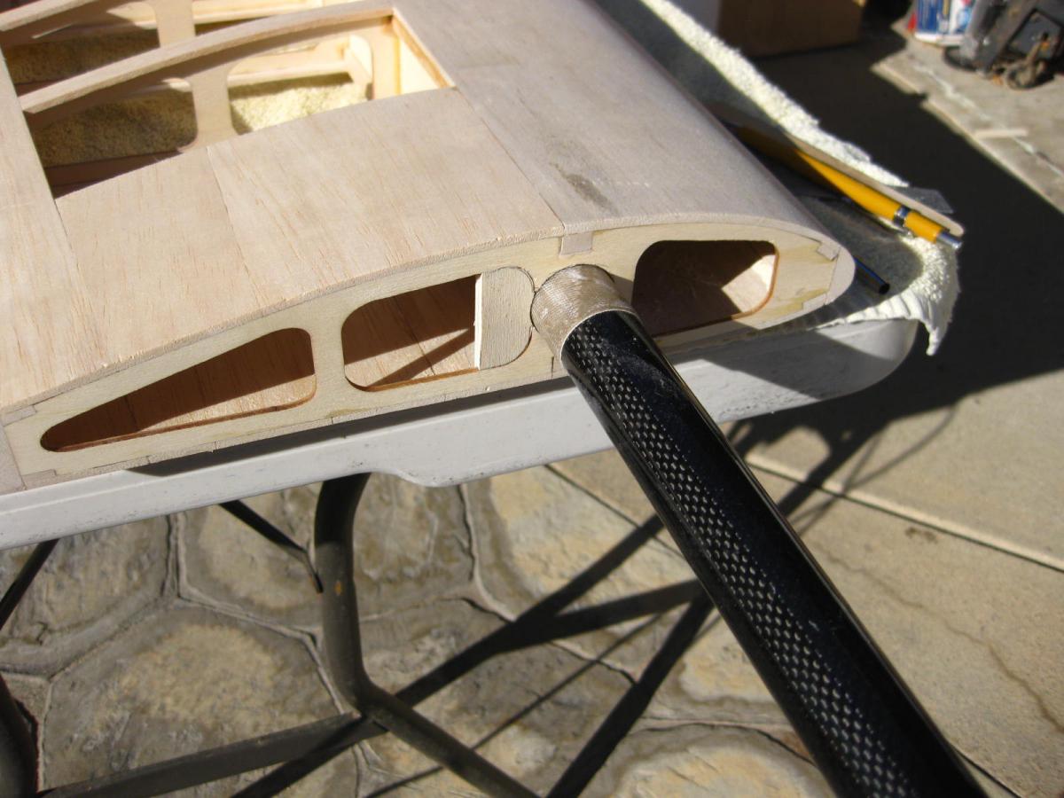

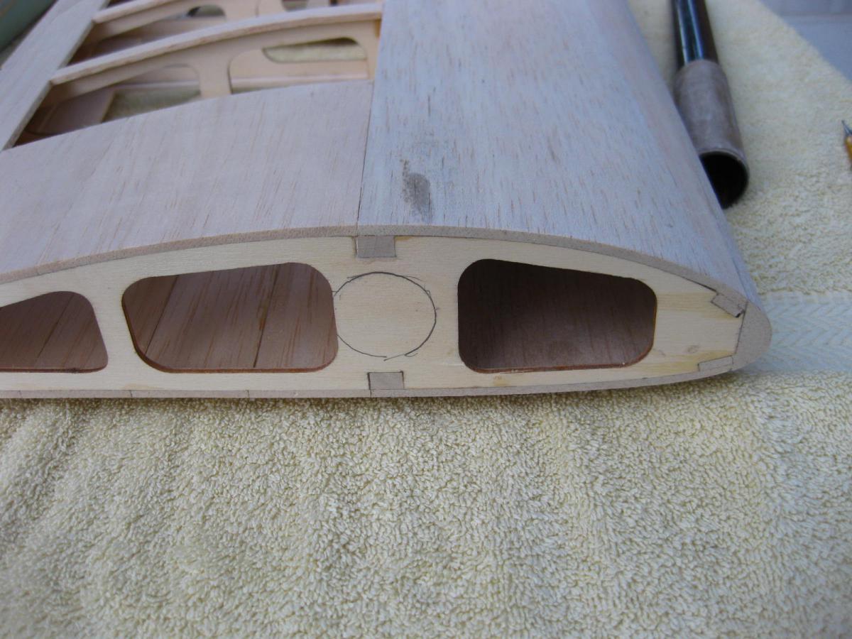

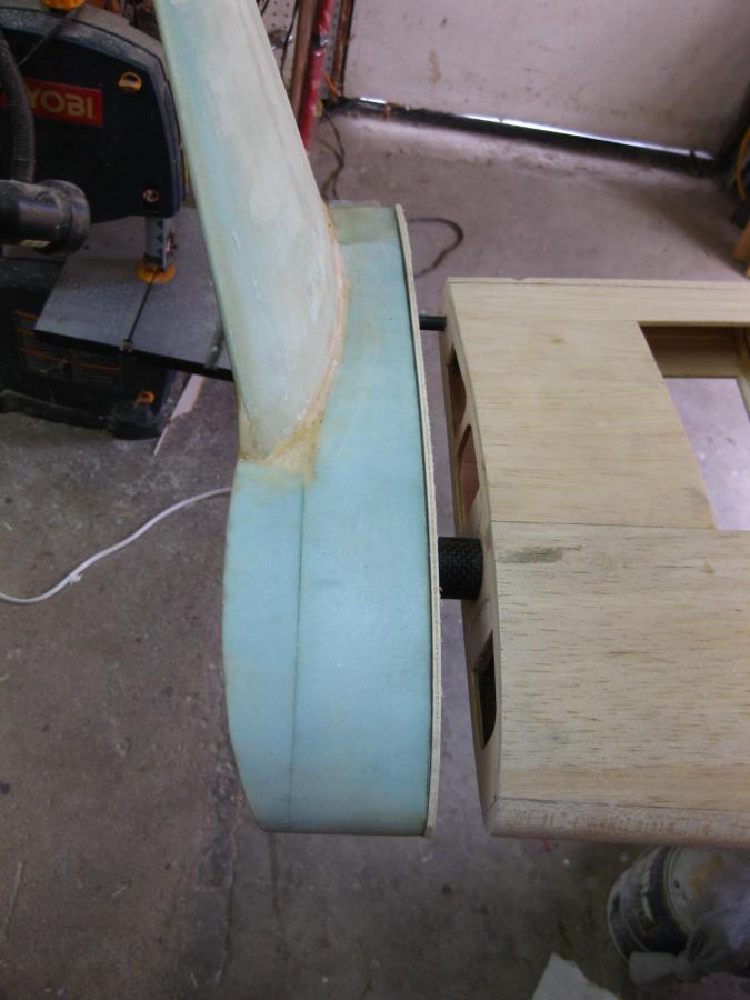

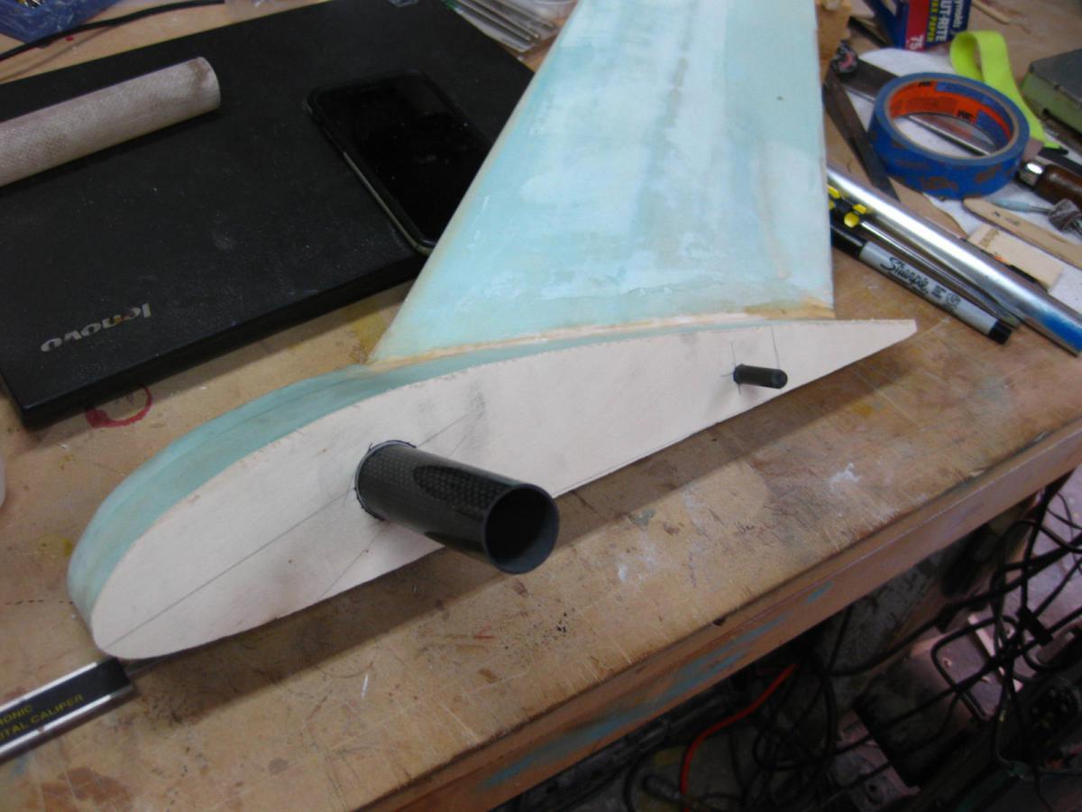

                      • Wing Let tube installation.
                        Click image for larger version  Name:	IMG_5178.JPG Views:	0 Size:	131.9 KB ID:	38562 Click image for larger version  Name:	IMG_5179.JPG Views:	0 Size:	68.2 KB ID:	38559 Click image for larger version  Name:	IMG_5183.JPG Views:	0 Size:	76.9 KB ID:	38560 Click image for larger version  Name:	IMG_5182.JPG Views:	0 Size:	116.4 KB ID:	38565 Click image for larger version  Name:	IMG_5194.JPG Views:	0 Size:	79.7 KB ID:	38561 Click image for larger version

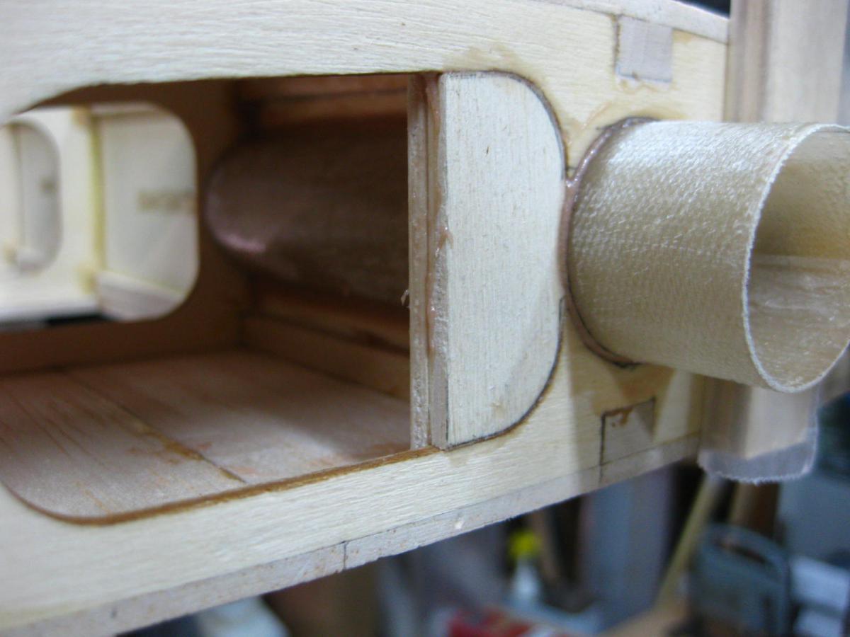

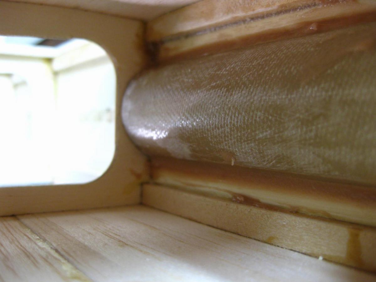

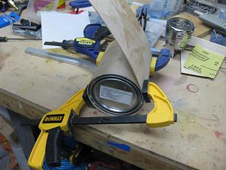

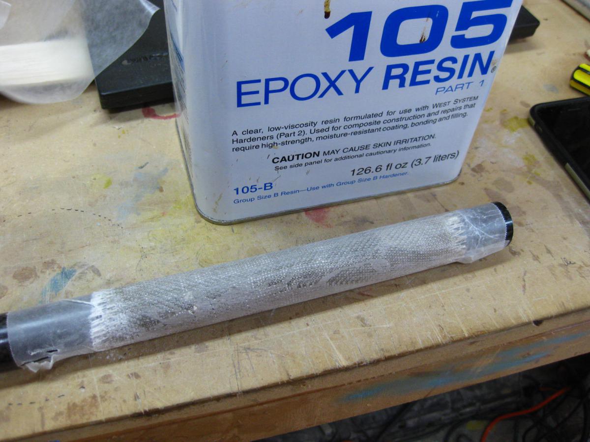

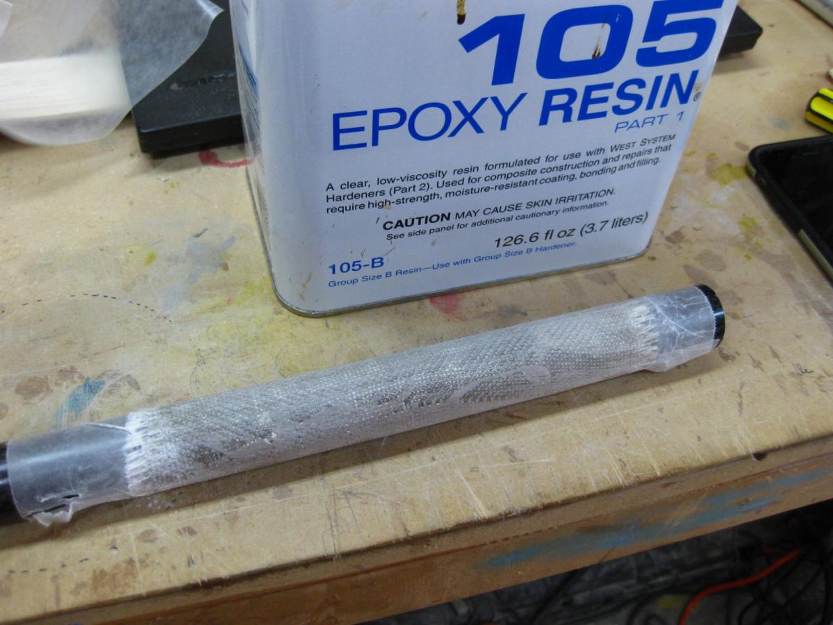

                        • a layer of wax paper over the tube and then 2 layers of 6 oz fiberglass is an easy way to make sockets to match your tubes.
ID:	38567 Click image for larger version
ID:	38570 Click image for larger version

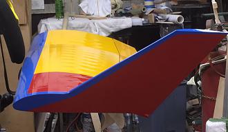

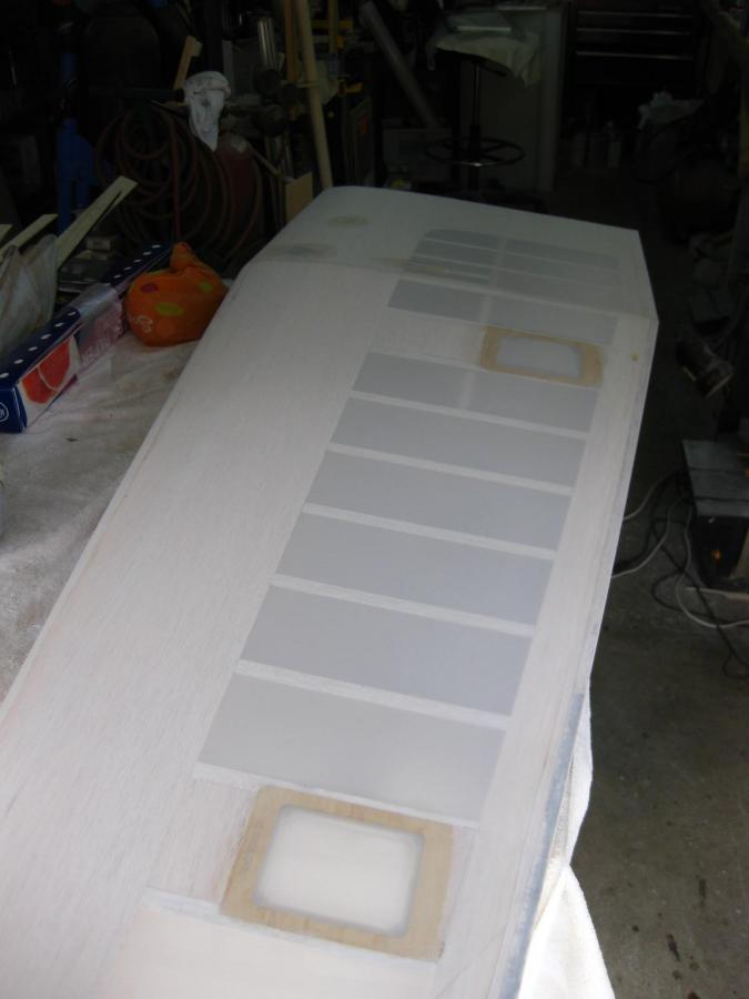

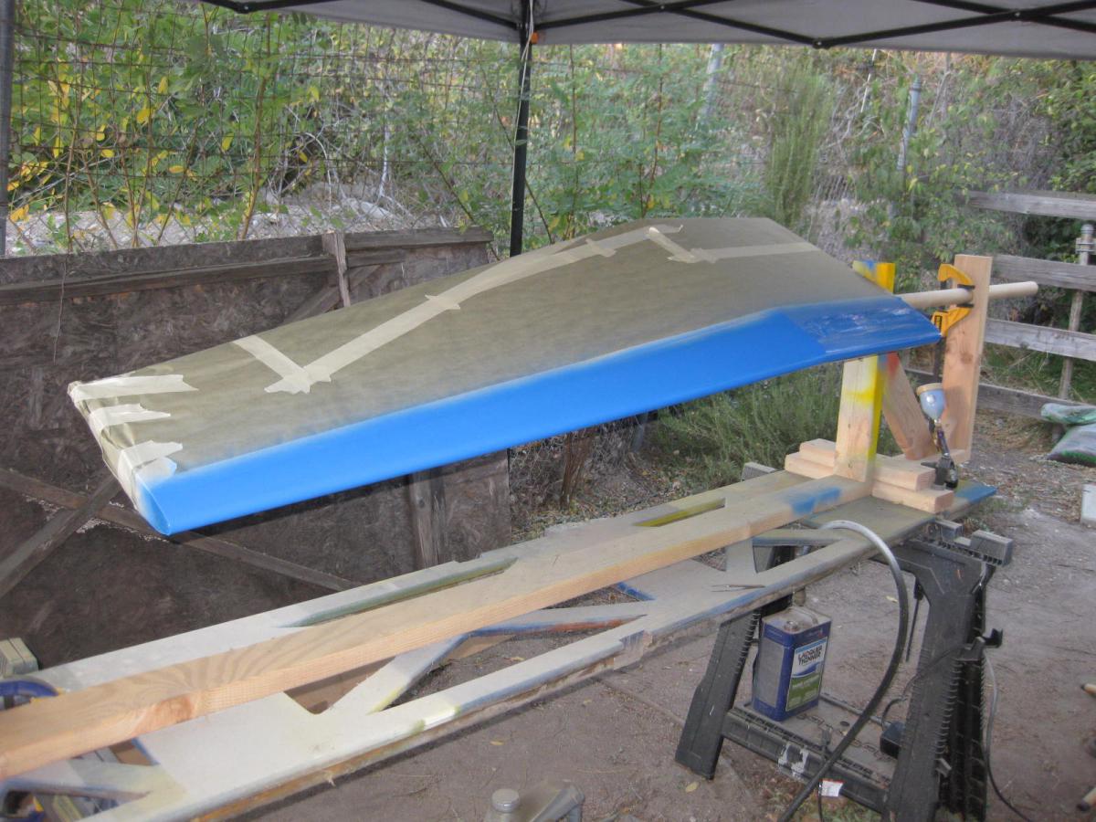

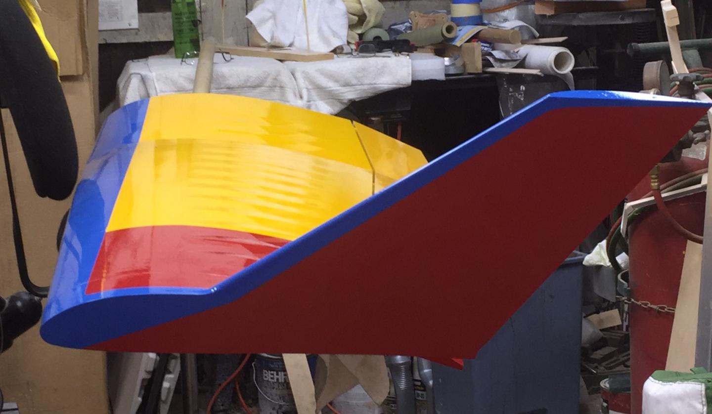

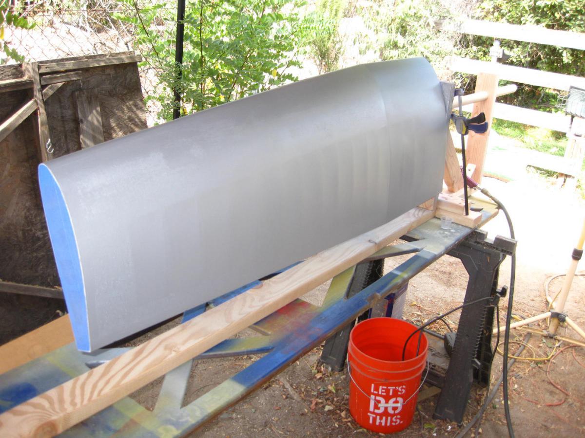

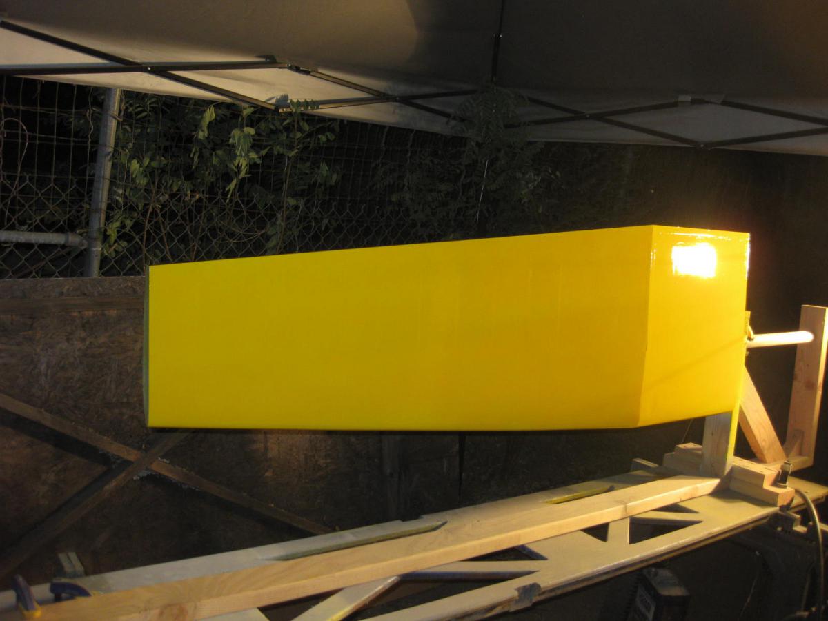

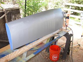

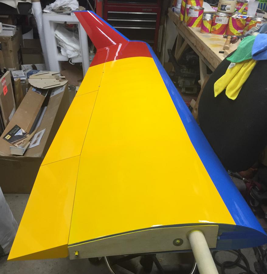

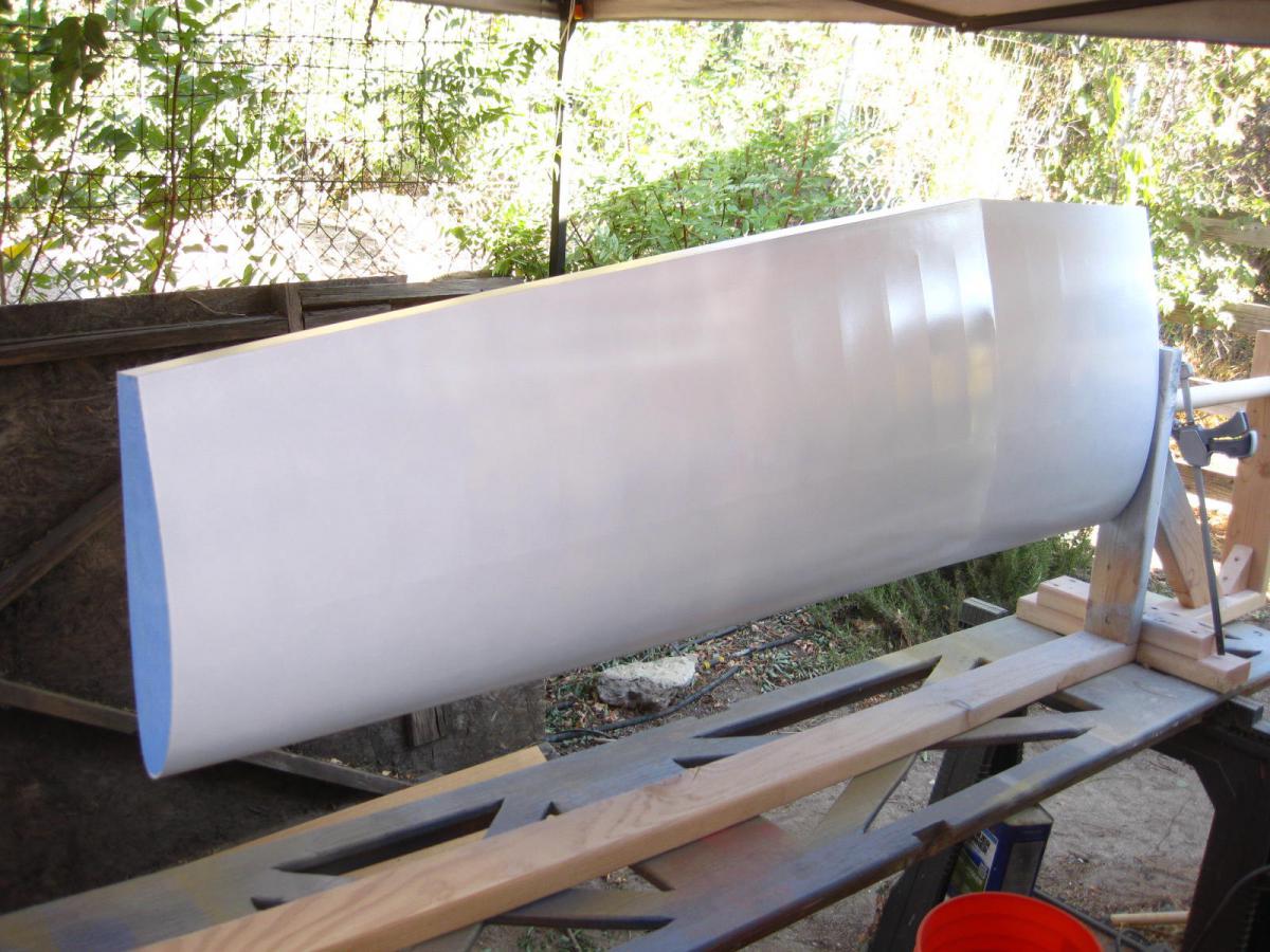

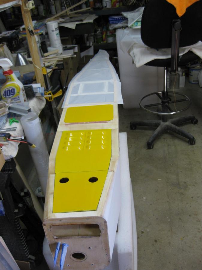

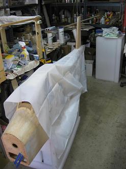

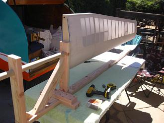

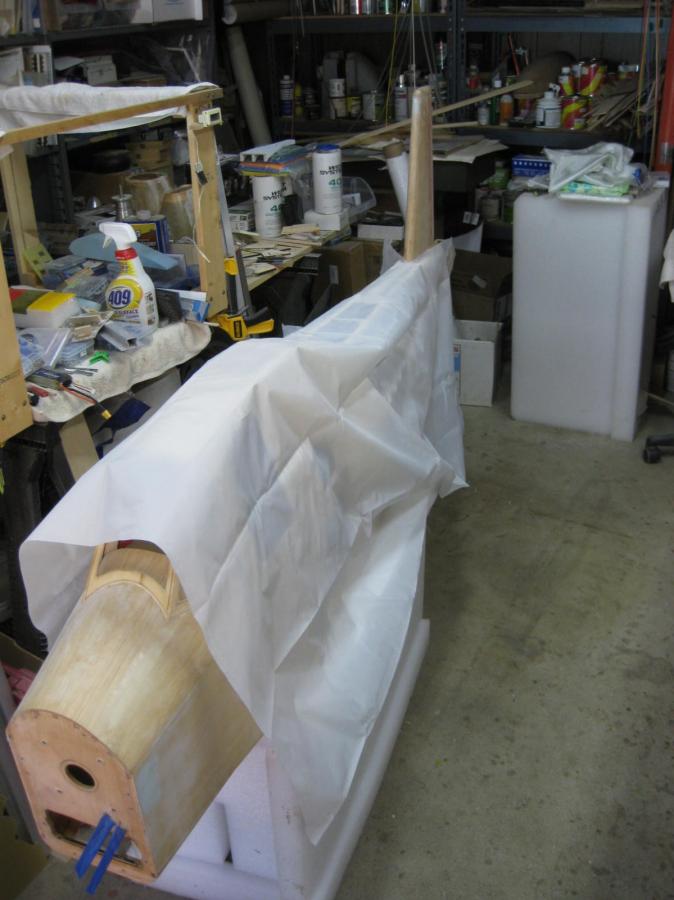

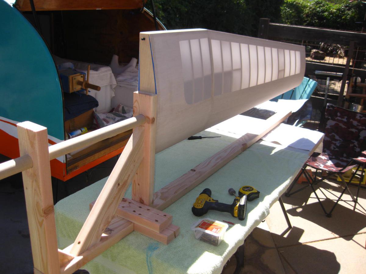

                          • Wing painting with a Rotisserie
ID:	38574 Click image for larger version

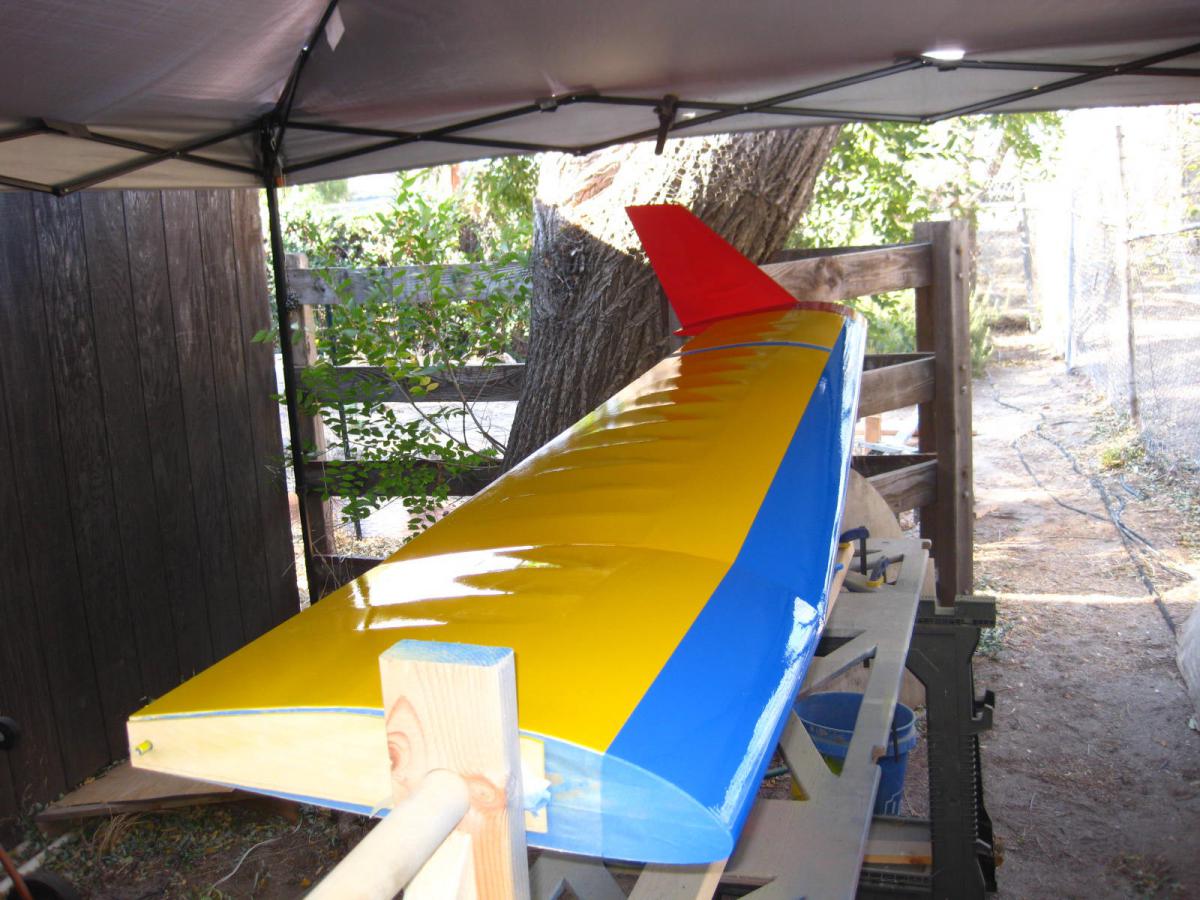

                            White base for the Yellow
ID:	38577 Click image for larger version
ID:	38580 Click image for larger version
ID:	38581 Click image for larger version
