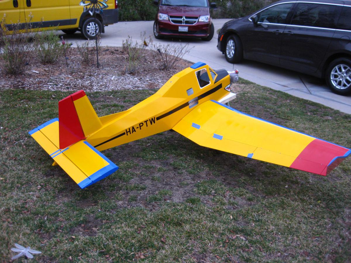

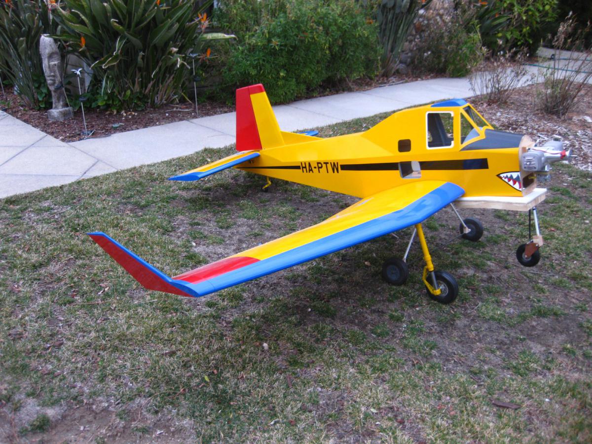

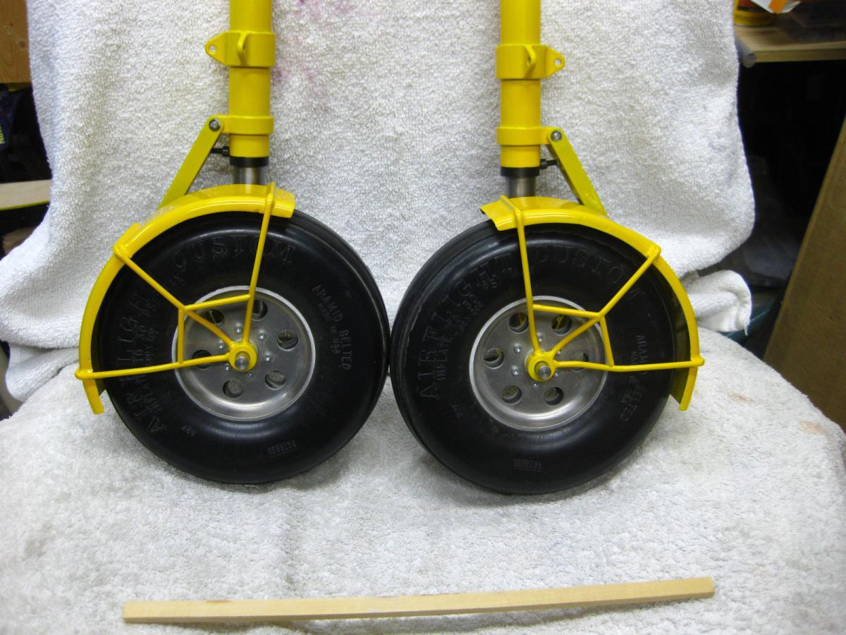

    • I guessed correctly on the dolly height and successfully installed the wings with the landing gear installed.
      Of course, the winglet and stabilizer were unnecessary for the test.....but.........

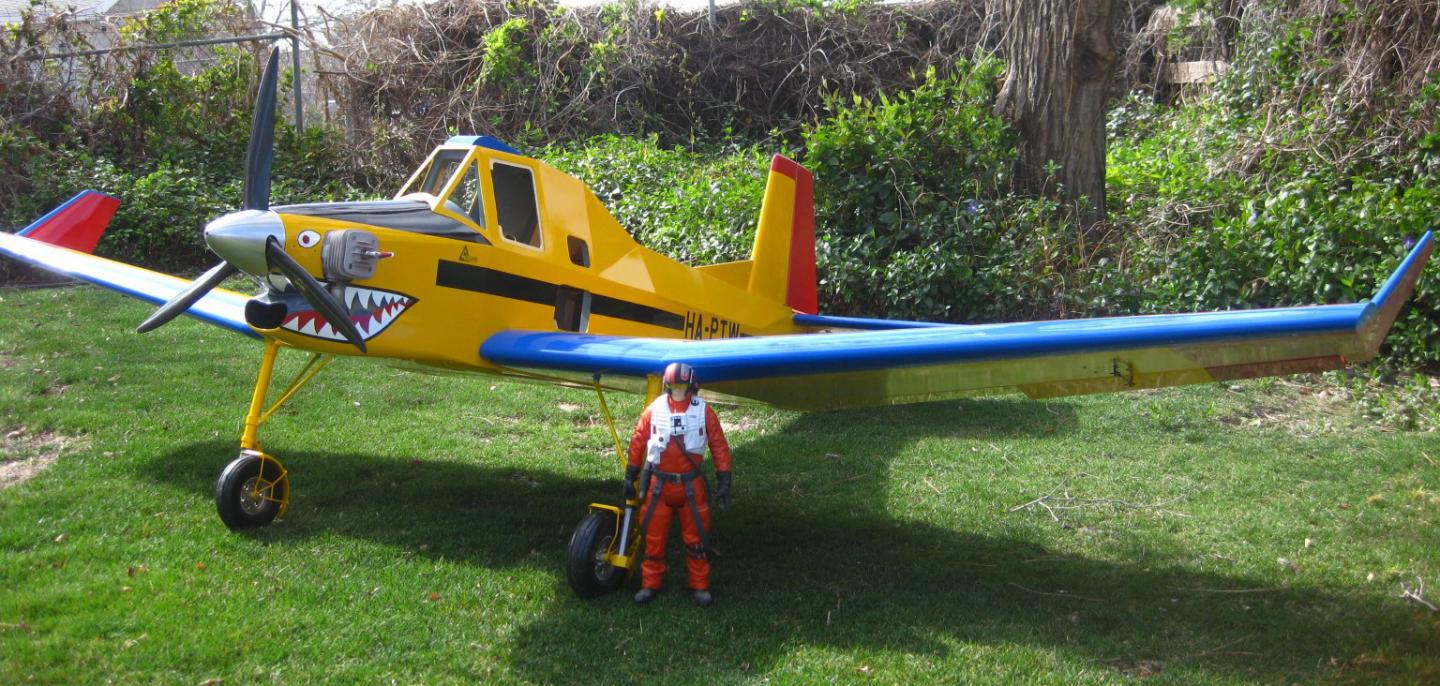

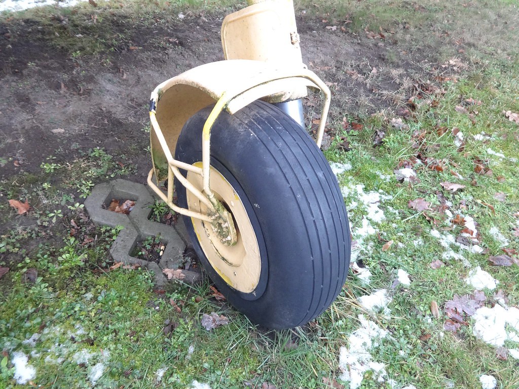

        VS. the high clearance original

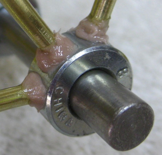

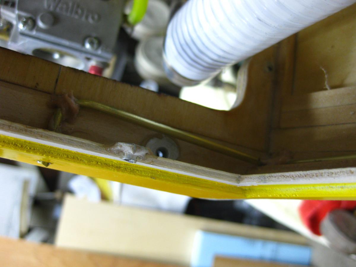

      • what did you use to bond the brass wire to the collar and the other wires

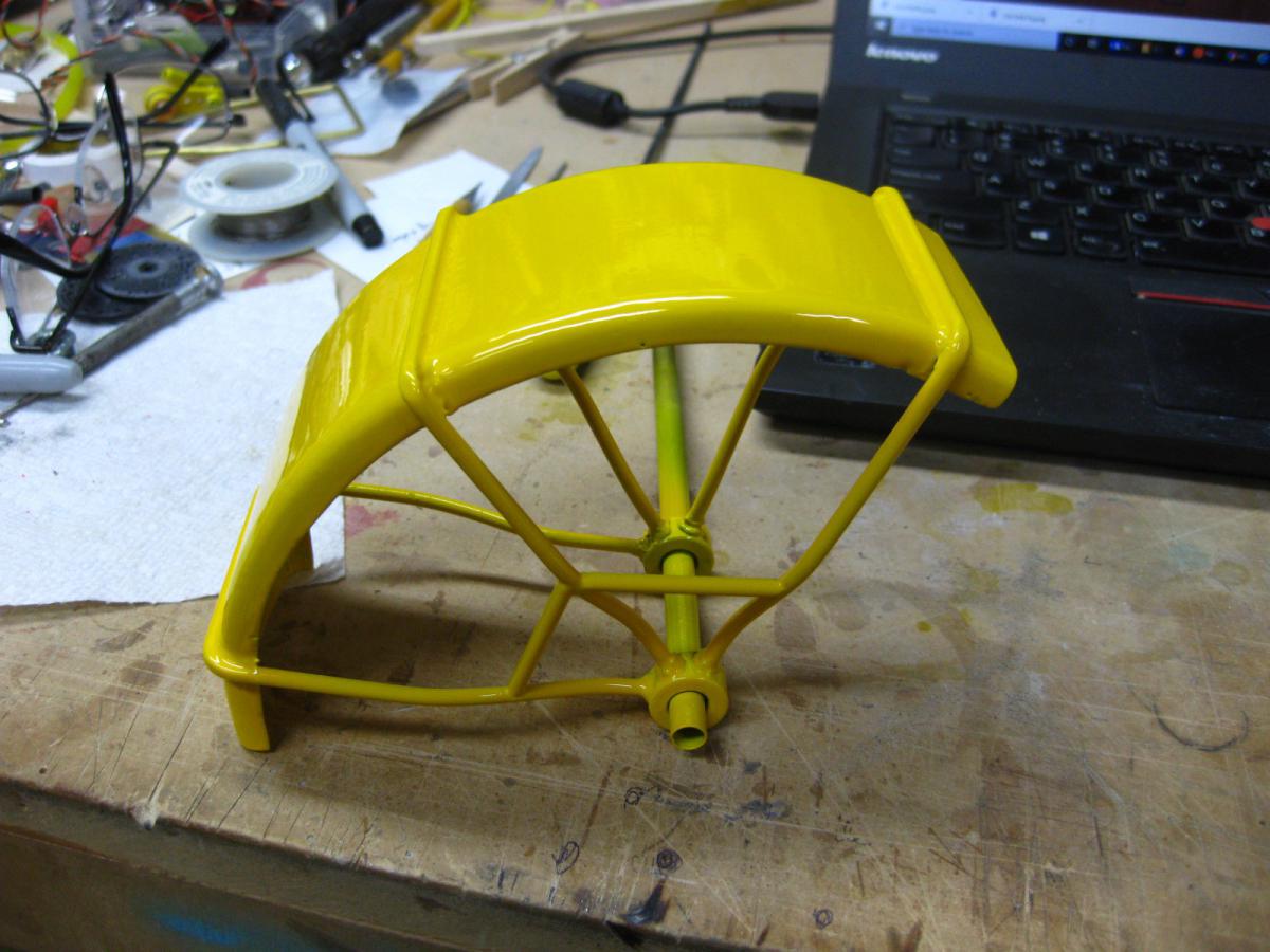

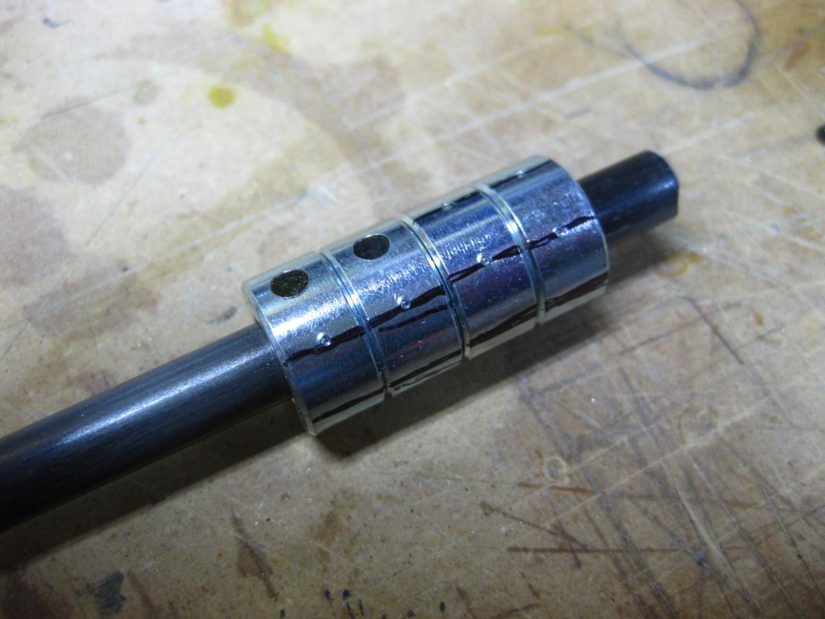

        • The 1/8" brass tubing was glued to the collars using West System/ 404 high-density Adhesive filler. I drilled holes in the collars for a little extra surface area contact and mechanical structure.
          The cross bracing is just silver solder attachment after contouring the tubing to try to match the mating surface.
          Precision drill hole duplication.

          • thanks i guess hysol can do the trick also.. very nice work

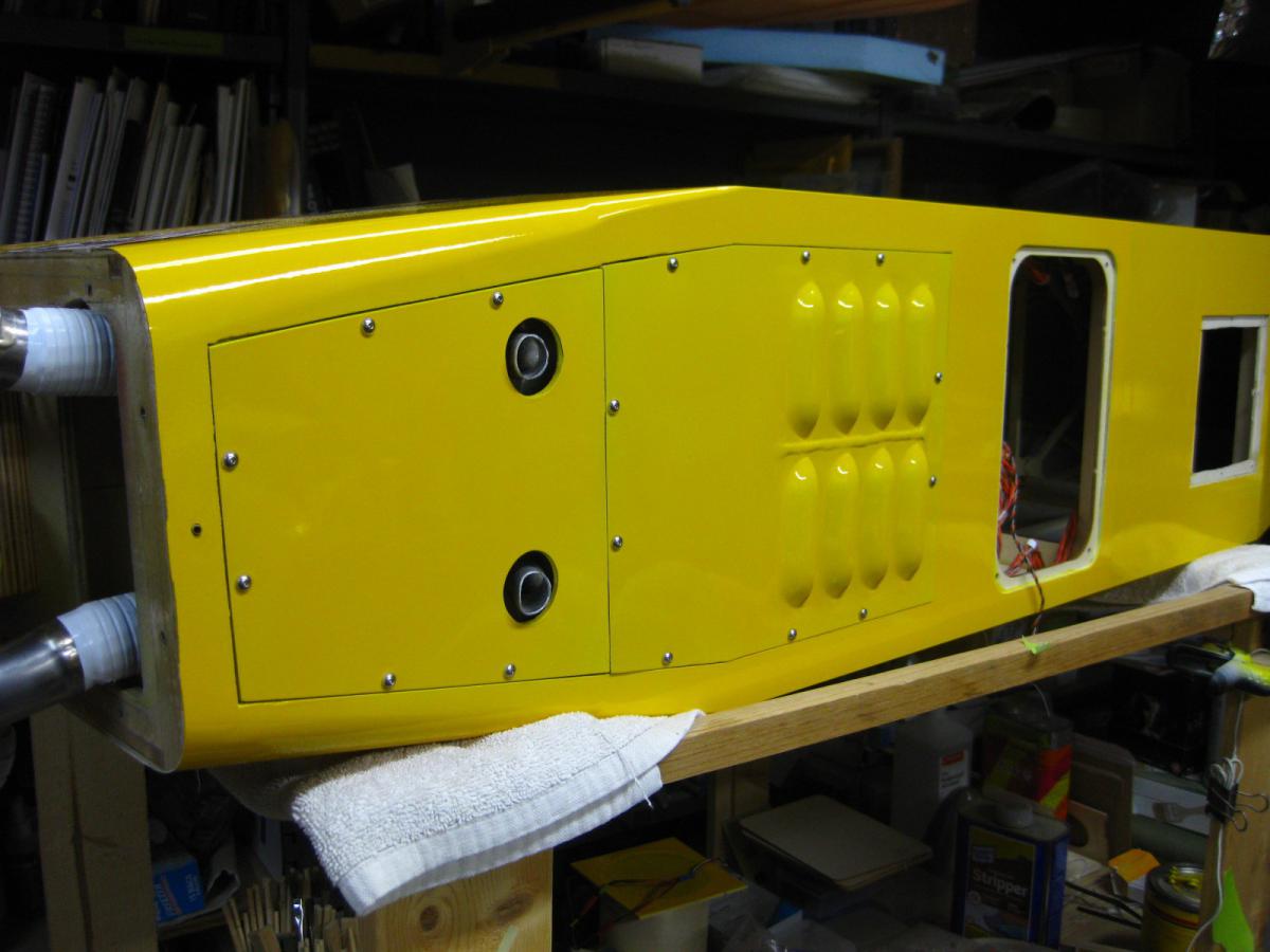

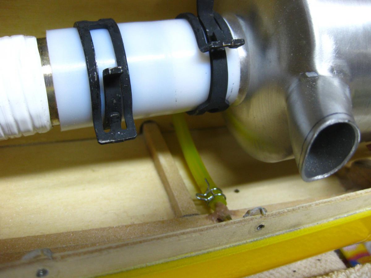

            • Vent for the gas tank and buttoning up the canister compartment

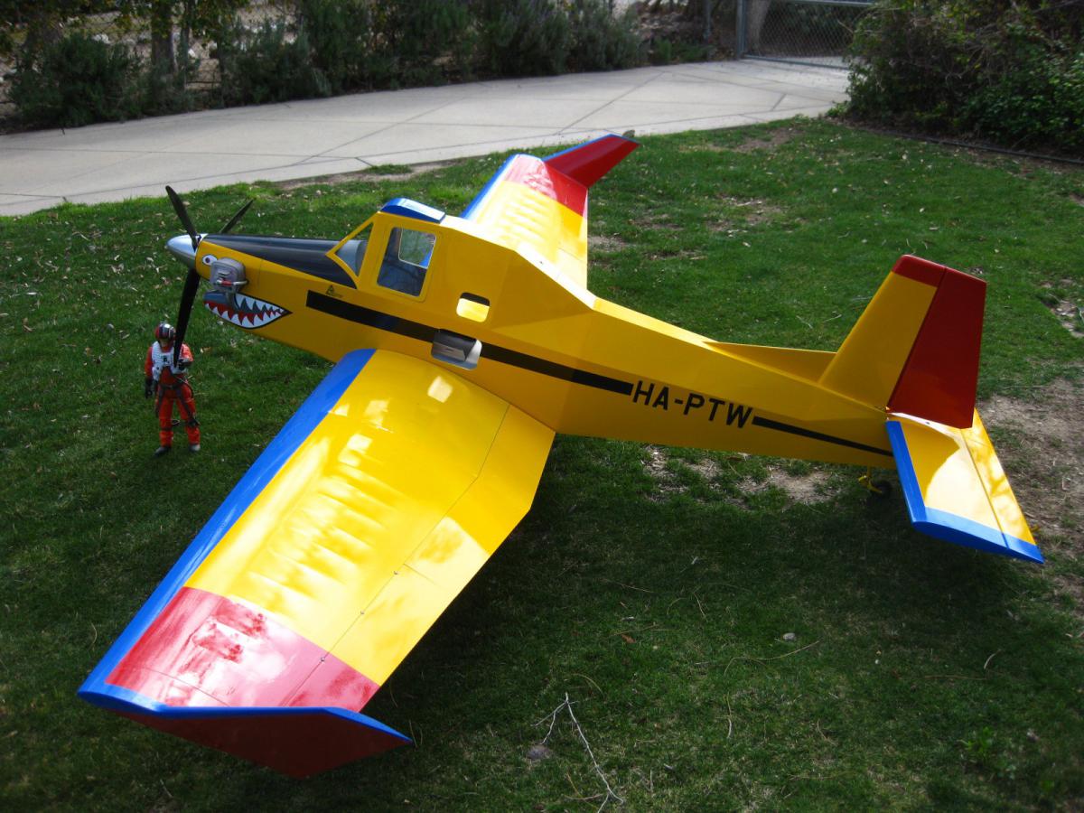

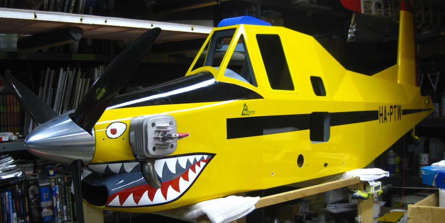

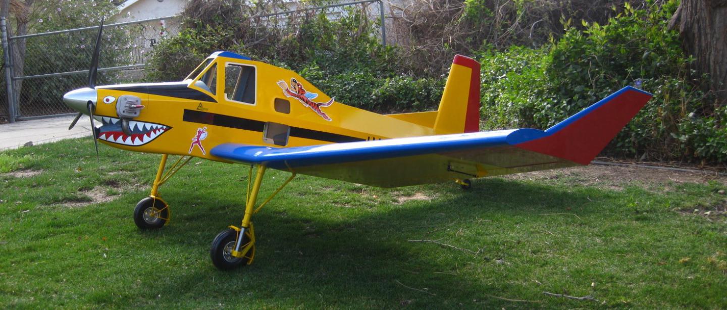

                            • Photo shoot Sunday
