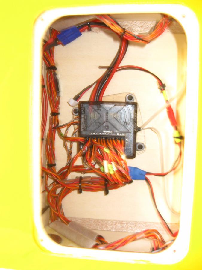

  • night time flap travel balancing - ended up with 55 degrees
    Spaghetti almost under control

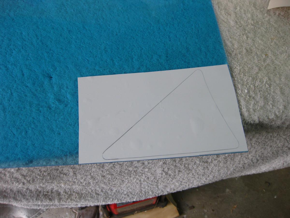

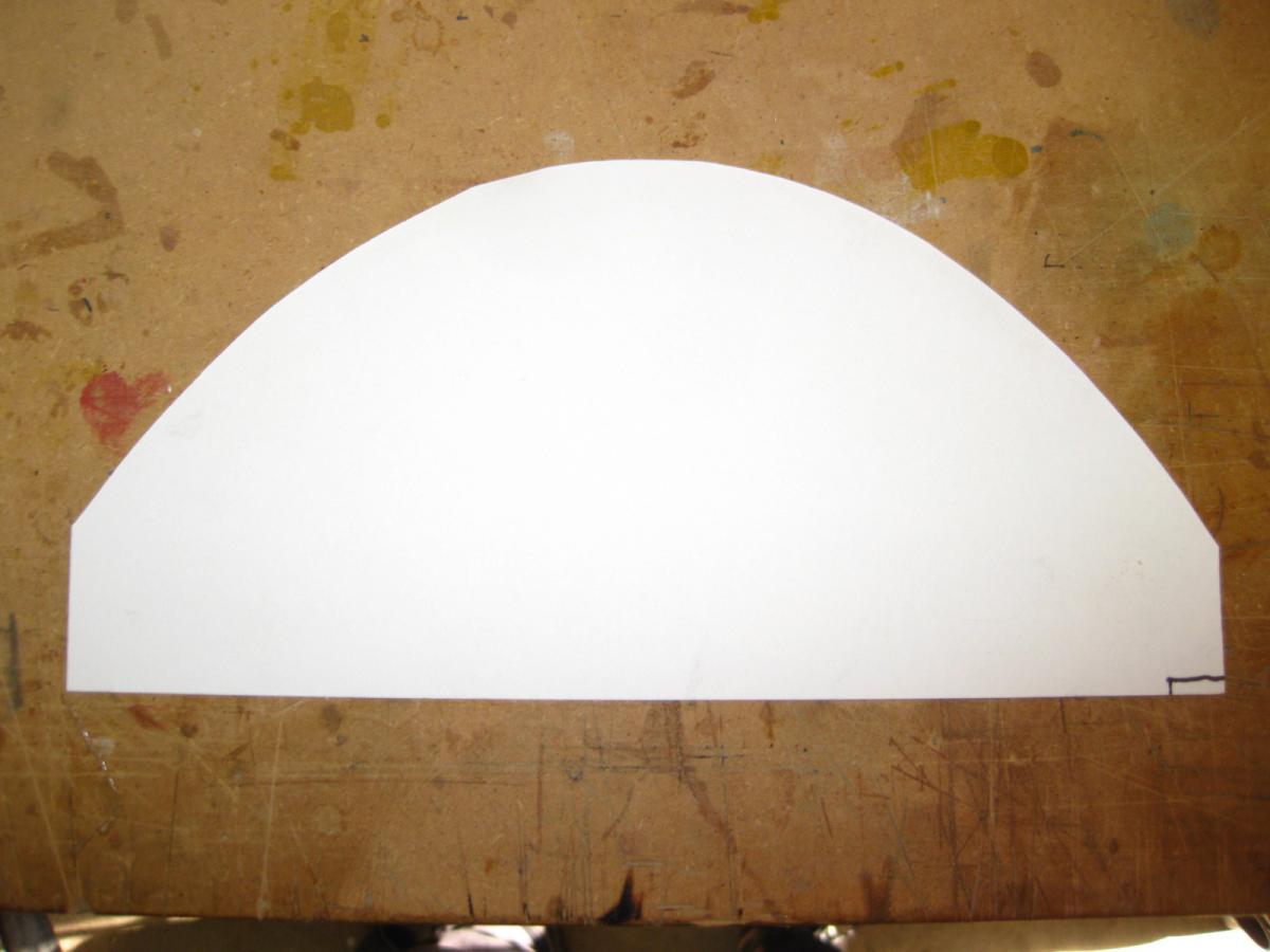

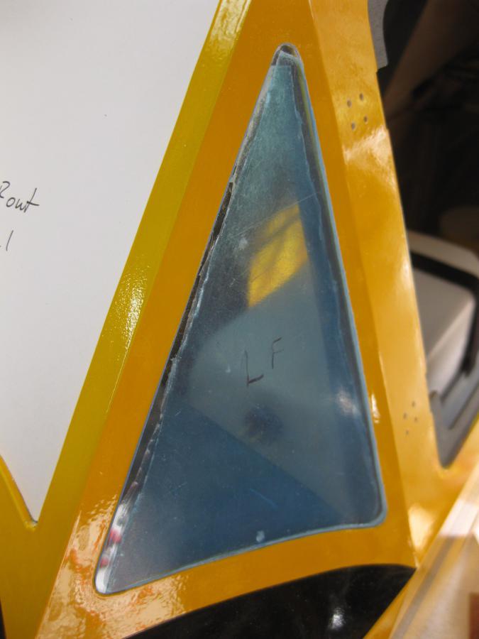

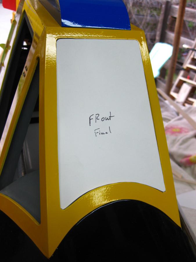

    • Sand to Shape
      Custom nose means custom front windscreen pieces. Started out by making paper templates to the openings, then transferred them to vinyl paint mask applied to the new PTGE material.
      Then as is said many times......Simply....... "Sand to Shape".......easy-piezy.
      Click image for larger version  Name:	IMG_5612.JPG Views:	0 Size:	47.0 KB ID:	40113 Click image for larger version  Name:	IMG_5613.JPG Views:	0 Size:	49.4 KB ID:	40114 Click image for larger version  Name:	IMG_5614.JPG Views:	0 Size:	122.5 KB ID:	40115
      Click image for larger version  Name:	IMG_5617.JPG Views:	0 Size:	46.4 KB ID:	40116

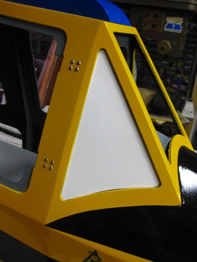

    • Factory Fresh windows ........anti-hanger-rash guards are staying on for the time being.
      Click image for larger version  Name:	IMG_5621.JPG Views:	0 Size:	94.5 KB ID:	40123
