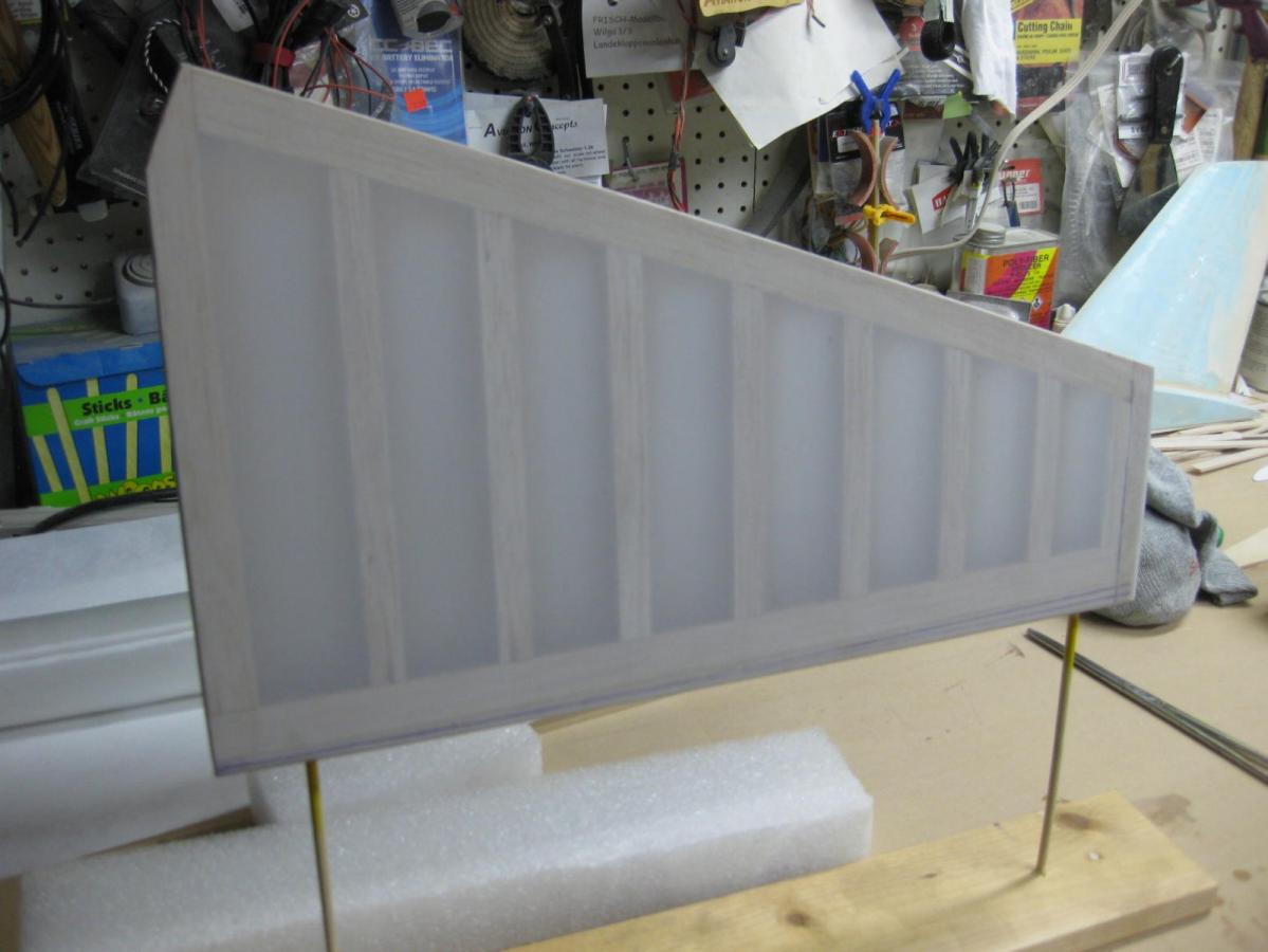

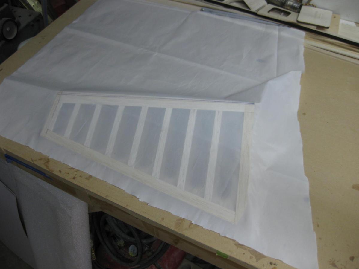

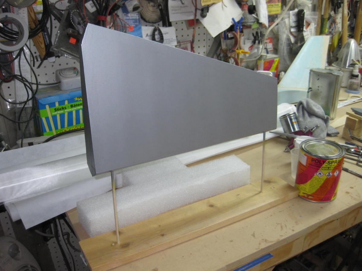

    Mixing things up a bit ....plus, I wanted to play with a "highly flammable liquid and vapor"
    Rudder covered with Polyfiber LITE cloth thru poly-spray.
    Poly-tak is thinned 4:1 and "painted" on the areas where I want to stick the covering to. Wipe solvent ( MEK/reducer) with a papertowel over fabric in place to "glue" it down. Then heat formed around the corners/edges.
    Once things are glued on, the fabric is shrunk down in stages ( 225, 250, 275, 300 )
    Poly-brush ( thinned 4:1 ) is brushed on the entire surface to seal the fabric, then a spray coat of Poly-brush ( thinned 4:1 )
    Poly-spray (uv protection and opacity ) - 3 coats.
    Click image for larger version  Name:	IMG_4952.JPG Views:	1 Size:	61.0 KB ID:	35838Click image for larger version  Name:	IMG_4955.JPG Views:	1 Size:	84.1 KB ID:	35839
    Click image for larger version  Name:	IMG_4957.JPG Views:	1 Size:	104.1 KB ID:	35840

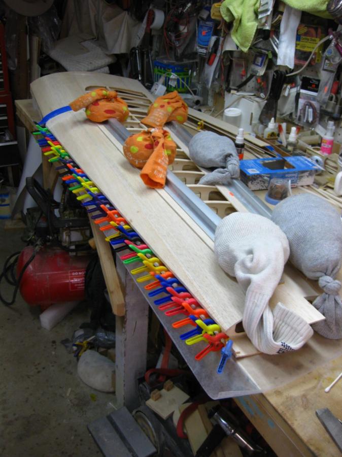

      And the Left Wing Outer

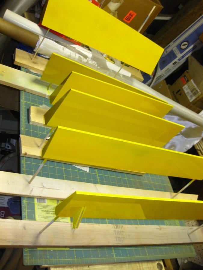

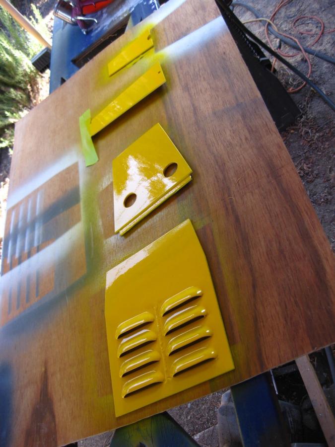

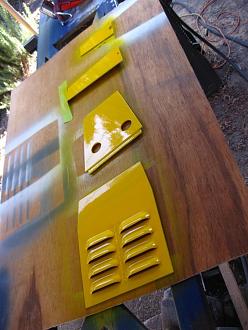

            top and bottom D-box skins and .....Yellow paint.....
ID:	37634Click image for larger version
ID:	37635Click image for larger version

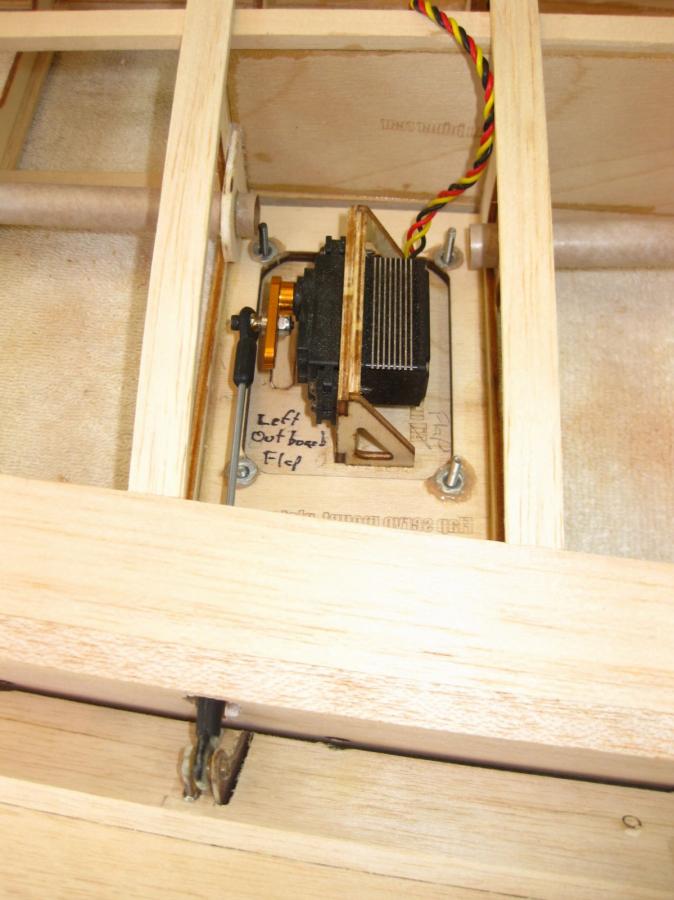

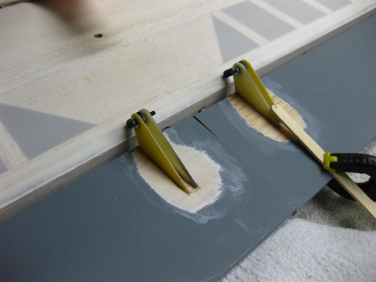

              Working on the Flap linkage before I cover the wing. Servo set for 180 degree rotation so the flaps will stay up when the power is off and lower's the workload when they're down.
              Switched to ball links on the flap since the horn was not moving in a linear track to stay lined up. Found I only needed 20 mm of travel to get 60 degrees of down flap.

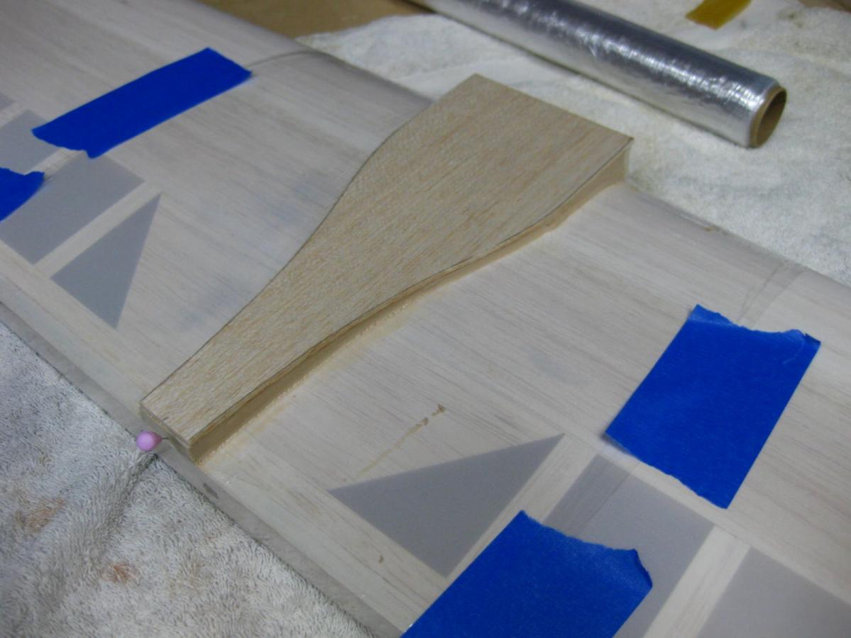

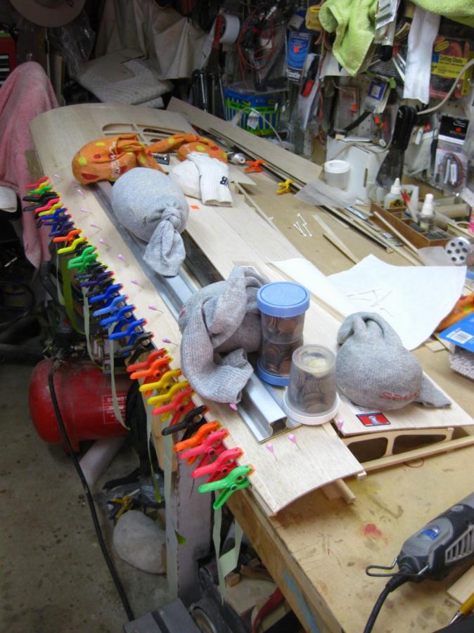

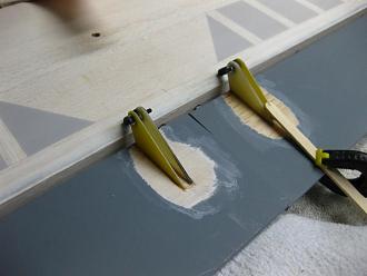

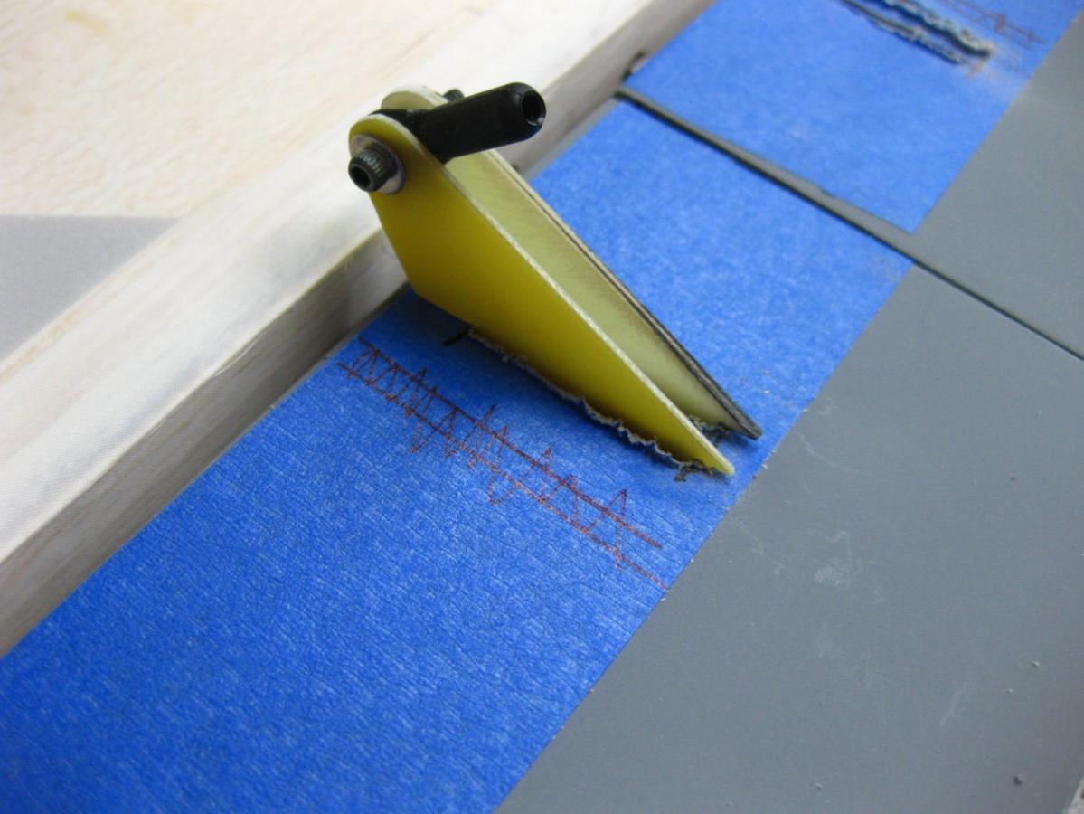

                    Hi Kevin,

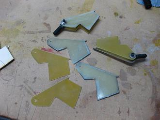

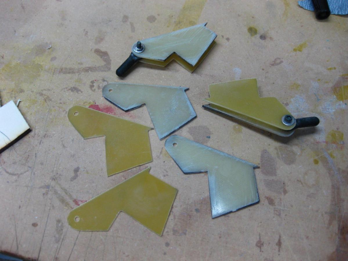

                    Ball links on the flaps are an easy up-grade as the secondary side is only a slot cut in the leading edge of the flap and then a support bracket is glued in. Something to keep in you back pocket.

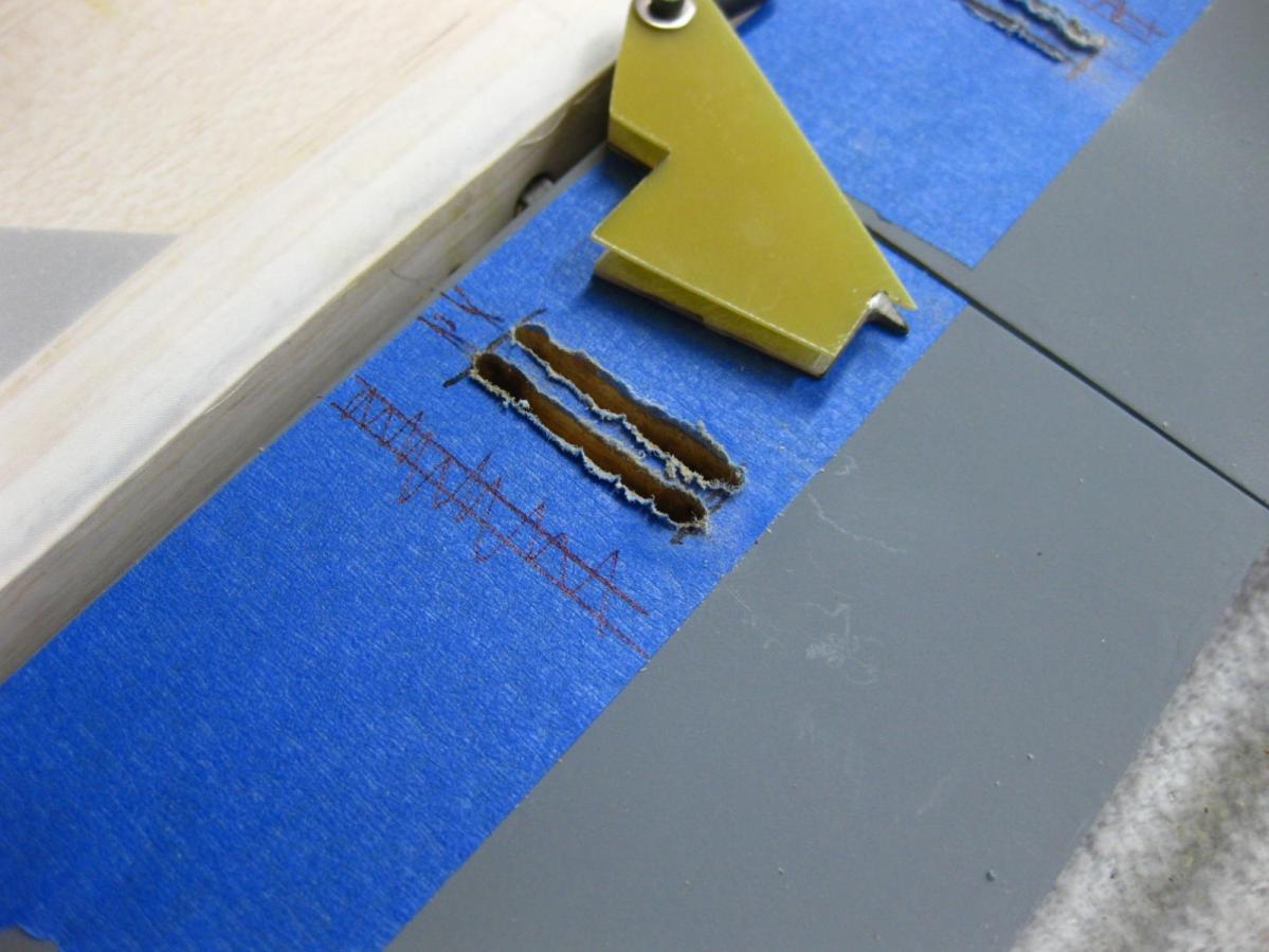

                    Ball links are going on all the control surfaces so I made some secondary brackets for the elevators and ailerons.....then the cutting process.
ID:	37901Click image for larger version
ID:	37900Click image for larger version

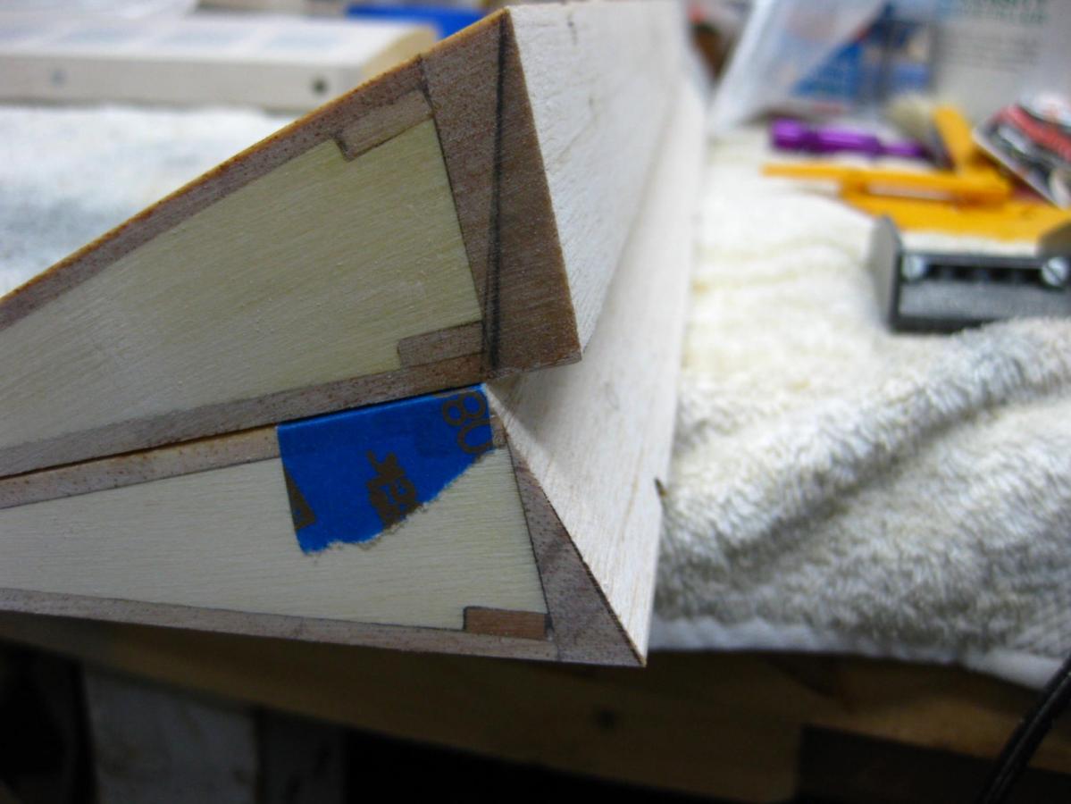

                    I really liked Len's Stabilizer gap fill so...... using epoxy/410 microlite filler to fill in the gaps.

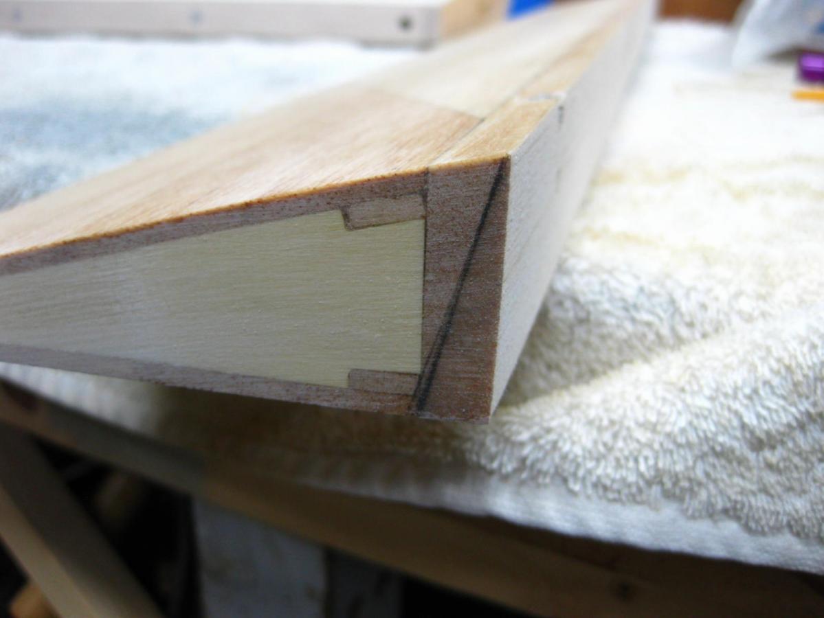

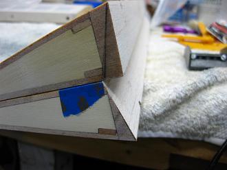

                    Cutting the Aileron bevel. Should be good for 18 degrees down travel
ID:	37903Click image for larger version

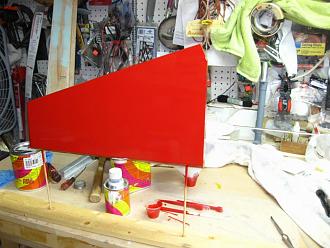

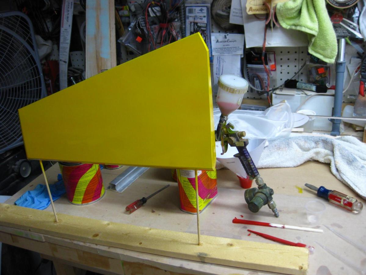

                        I love the smell of Methyl n-Amyl Ketone on a Sunday morning ( thru a respirator, of course )
                        My new favorite color - PolyFiber #140 Orange-Yellow
                        Click image for larger version  Name:	IMG_5089.JPG Views:	1 Size:	67.4 KB ID:	37935

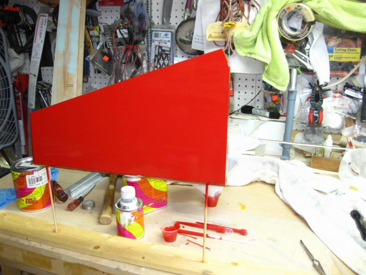

                        I might have been a bit dizzy .....as I started painting the Rudder yellow .....and realized it should be Red.....so......
ID:	37952Click image for larger version
                          Gorgeous. It makes me dizzy from 3000 miles away.

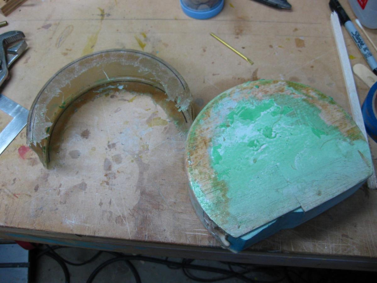

                      • #88

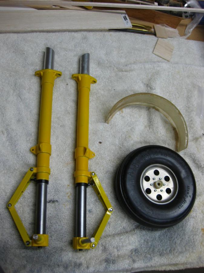

                        I was wanting wheel fenders .....so......
                        Taking advantage of the warm day for epoxy curing
