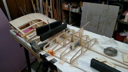

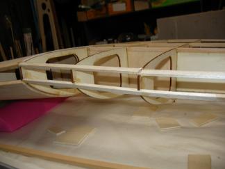

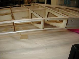

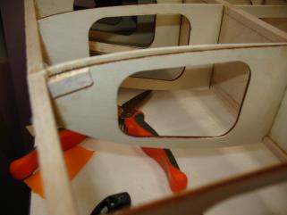

ID:	21948 I seem to have the worst luck. Although everything should key together with the laser cutting...that slight bit of gap can lead to one rib ending up tilted just a tad up or down...I really tried to be careful and only doing a few ribs at a time but managed to get things kitty wampus.
          Decided to make up a partial replacement rib so I could scarf it onto the side of the rib to match the other ribs contour...will do the same on the back side...more weight but hopefully I can get the sheeting accurate.
          these pictures are before which I only discovered when the glue was all dry and

          these second two photos are after i scarfed on the shim rib on the front of the rib.....so lame compared to the wonderful build Len has been showing....if I repair things right though...it still might be accurate enough to be okay. tomorrow will shim the back side of the rib to level that side as well so sheeting can be level...this build is starting to feel like scratch building for me...I am disgracing this thread !!! Len and Pete will probably not sell me any more kits since I am doing such a crappy job !!!
            Chin up Kevin, it will be just fine! Remember, when the covering is applied it will look great! I'm following along.
            Shoot... I'm a 'Scarfmeister"! FWIW, my method of wing building is to put TE on packing, set a straight edge for the nose of ribs to 'bump' into then glue TE. Next is to glue LE (or false LE) then drop the spars in place. I cut the spar slots AFTER the fact. Then you re-sand things level before putting on any sheeting, etc. Of course that isn't doable on this kit but the spar slots can still be adjusted to suit. Just because the kit is laser cut or some goof like me makes the parts doesn't always mean they are gonna fit! Another tip... don't eat glue or wood chips!

          You're doing great, just keep working on it and deal with whatever situations arise. You should be commended for sharing this build, even the things that don't go 100% perfect for you. Its a great way for others to possibly avoid the same pitfall
          When setting the ribs, I'll often set the first one, then if possible set one at the tip ( making sure its perfectly set ) then run a straight edge across the tops as I fill in between. This will ensure all the ribs are aligned in height to each other.
          Regardless, always check and double check before committing to glue. It's crazy how when you think its perfect, then walk away for a minute, come back and check it again its totally off? That still makes me shake my head.

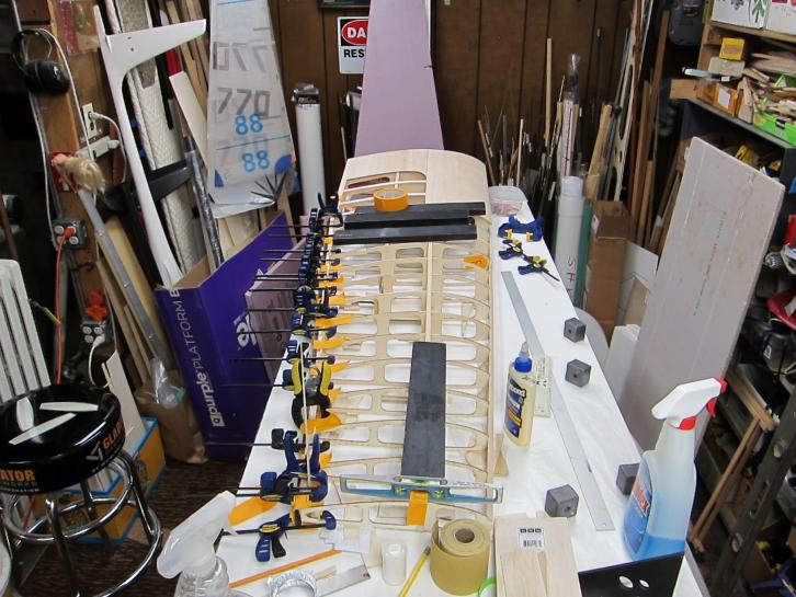

ID:	21990 Due to a major hick up on my wing build that has me stumped, so far have not figured out a way to move on with it and hesitate to do the other wing for fear of the same outcomes...hard to explain in words...Len has been helping me try to figure it out. Will seek some local builders to eye it as well for ideas.
            I have in the meantime shifted to building the Fuse...at least the front half...apparently the back half is a real Rubic's cube to figure out...

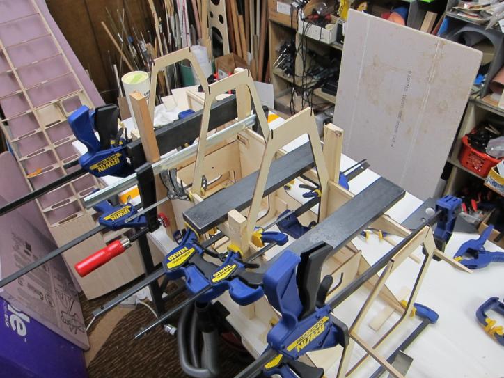

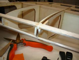

ID:	22072 One can never have enough clamps...Got the wife to help today as we lathered on the Tite Bond to put the two halves of the fuse together...
                questionable wing is in the background...have ideas on how to get the 6 degrees of "twist" out of it...hoping I can get it straight...
                I think about the third one of these I could probably build it correctly...one mistake just carries on and on and on since everything is linked...put wrong part somewhere that looks almost identical to another...well...making parts is what one has to do !!!

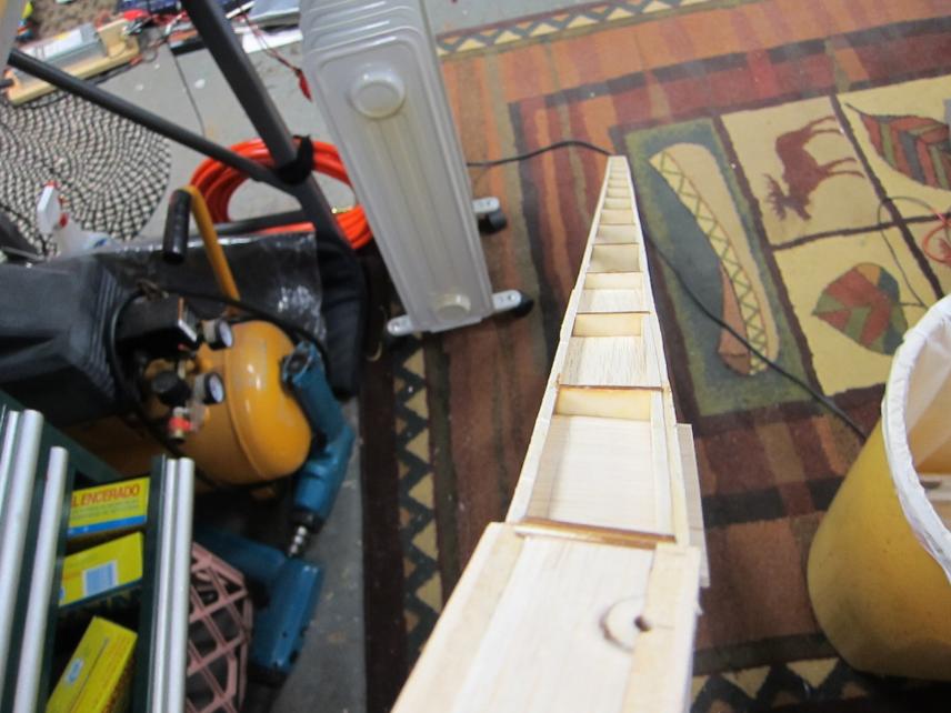

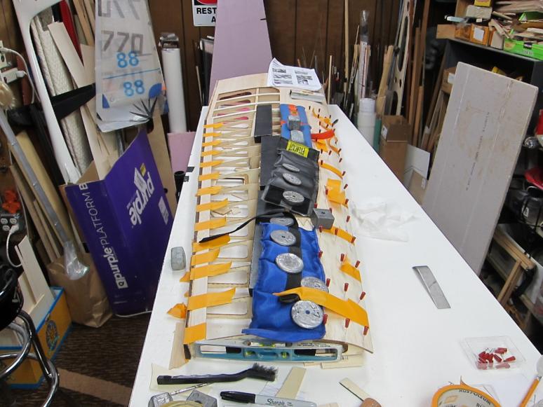

ID:	22137 Friends over yesterday to give another set of eyes and hands and we cut three ribs and removed about 3/32 of wood from the top to help with rotation...the first picture before looked like a corsair wing...now pretty straight...
                  used some additional sheer webs on the three inner ribs and blocked everything up till got rid of the negative 6 degrees of twist... I know the the rear sheeting should have gone on first but I needed the stabilizing effect of the big chunk of balsa TE piece with the laser holes for the hinges to hold this floppy wing straight...reverse engineering...
                  Pete would probably faint if he were to see this but I don't think he visits my build thread !!!
                  getting there slowly but poorly but I think in the end it will be fine..

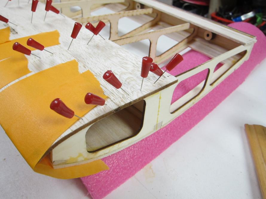

ID:	22166 another day at it...got the trailing edge sheeting done to try to hold the wing stable...next up was the D box top sheeting...velcroed the level to the side of the rib so I could sheet over it....hopefully the Velcro stayed true !!! bummer if Ii didn't....
                    Looks like a porcupine with all the pins in the wing sheeting....very thin needles from Midwest Products...thanks to Larry SOrenson for letting me know of their existence...they pushed into the plywood ribs better than the thicker T pins at the hobby stores.....by hook or crooke will get this beast done one way or another...

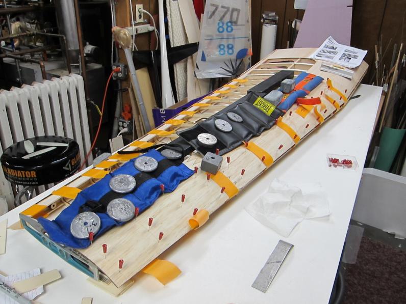

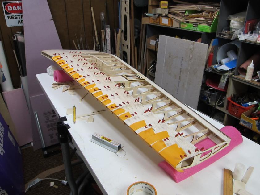

ID:	22224 tite Bond and 100 Grip Pins later...
                        Pete says to build the wing flat..no wash out...the top is done and appears to be "flat" so now onto the bottom sheeting....no weights to cause any twisting, so tape and pins...
                        hopefully things will remain flat when all done...then onto the other wing and continuing construction on the fuse....lots of little pieces to glue to it before starting the complicated rear part of the fuse that apparently is difficult to do correctly...dang...I've had enough problems already...wish me luck on the rear fuse then !!!!
                          Yeah... it's a balancing act to not put too much weight on these structures. It has to be just right... like the Three Bears nursery rhyme!
