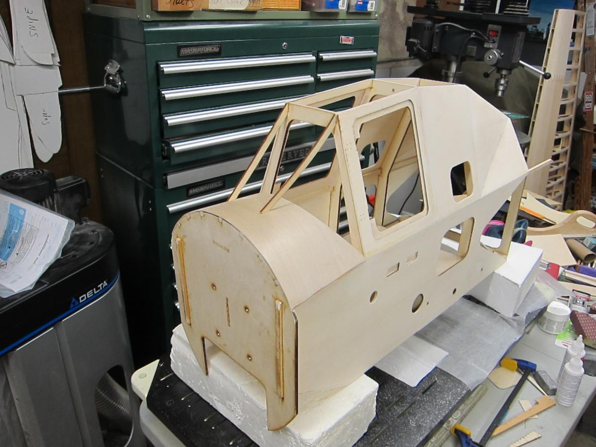

ID:	24396 Finally back at things as my lungs are cleared enough to get back to some dust...
      Got the dashboard and the under boards for the cowl...doing the last few things before tackling the rear of the fuse which is very challenging to do correctly according to both Len and Pete...so far my building has been less than ideal...see if I can up my game now for the last half of this build...

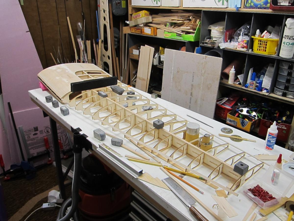

ID:	24461 Finally getting going on the second wing but being much more careful and triple checking everything before I walk away from each rib gluing...
        I really thought I might be done by now but have to be patient and not rush things...

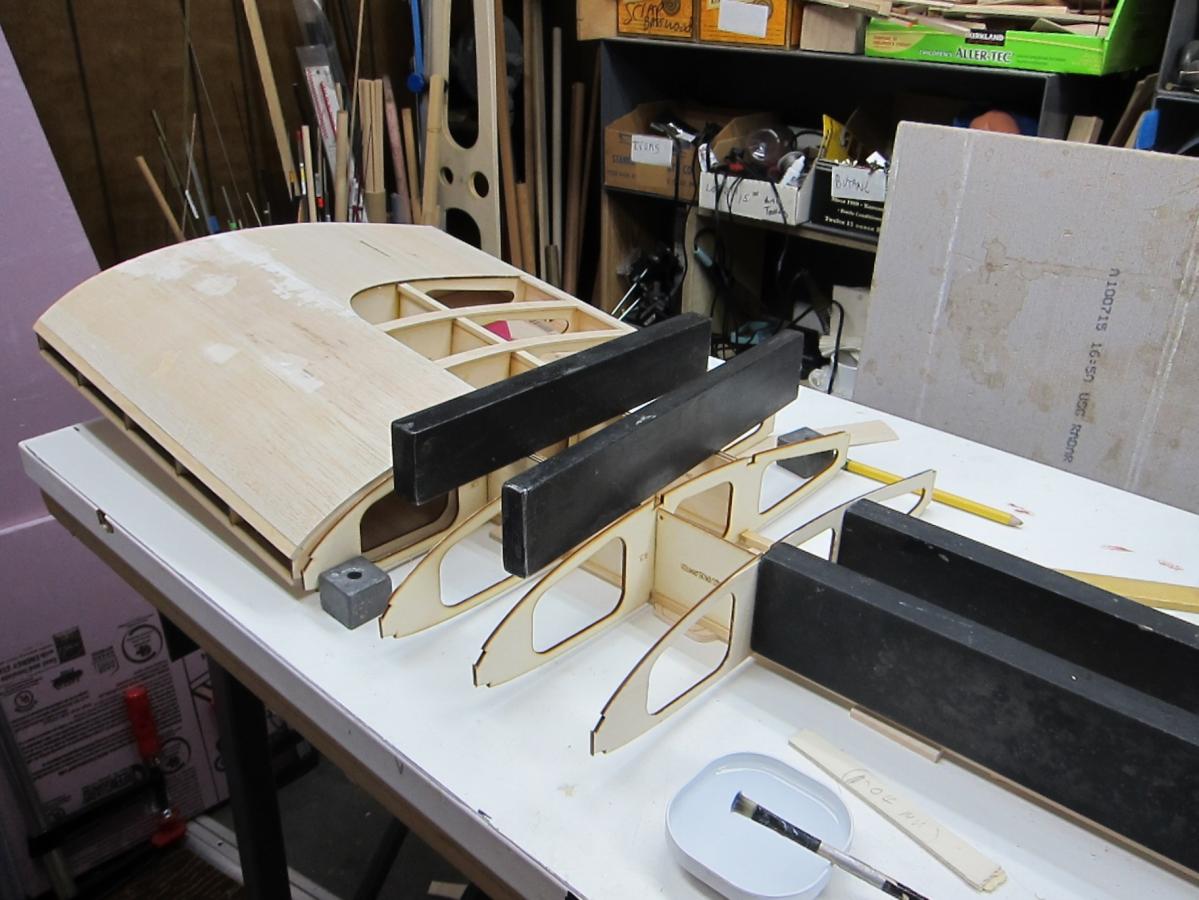

ID:	24600 Did as Len suggested and did a balsa under layer for cowl deck and then did the 1/64th plywood. Tricky to not get some puckering since the shape is odd. Used thin cardboard to make a template first to reduce how much wood I would waste...even then it took a second try...
          Got all the ribs in place on the second wing now and I think it is straight and not having rotation issues this time.
          sorry for small pictures, larger pictures pasting won't let me add text.Click image for larger version

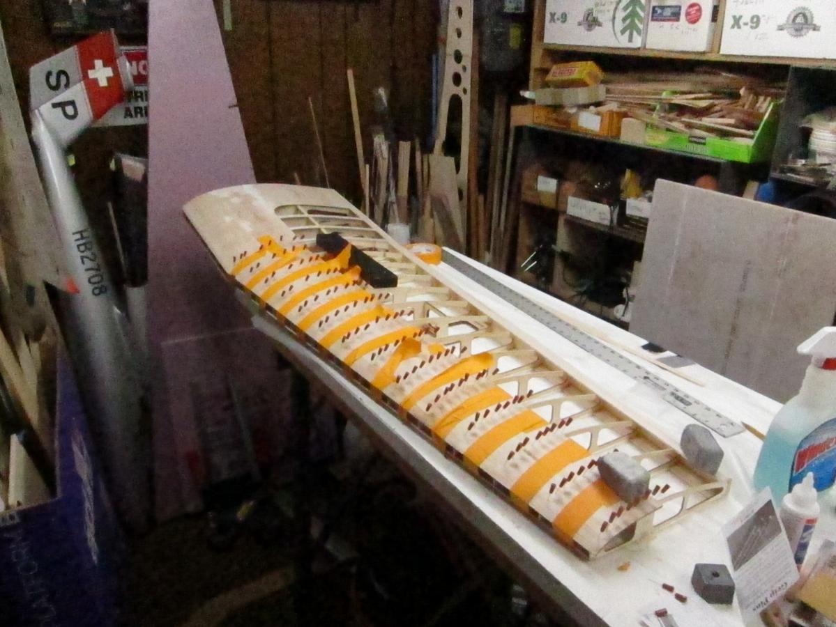

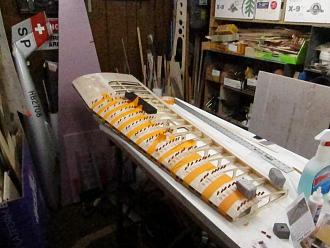

ID:	25089 After fighting with twisting on the second wing as well, (agh) a experienced scratch builder came over and did his surgical magic and helped me get things back under control....now onto sheeting and hopefully stabilizing the wing...I did the "iron the dried glue" gig which I did on the horizontal stab but on that I used Tite Bond, on this I used the Speed Bond but wasn't sure things would hold while ironing so I also used the Grip Pins just in case...probably over kill but I really need the sheeting to stabilize this wing.
              Once sheeted I need to build the ailerons, the flaps are done...then I can start on the rear part of the fuse...perhaps the most dreaded as it may well be the easiest part of plane to hose up given the skeleton type structure...

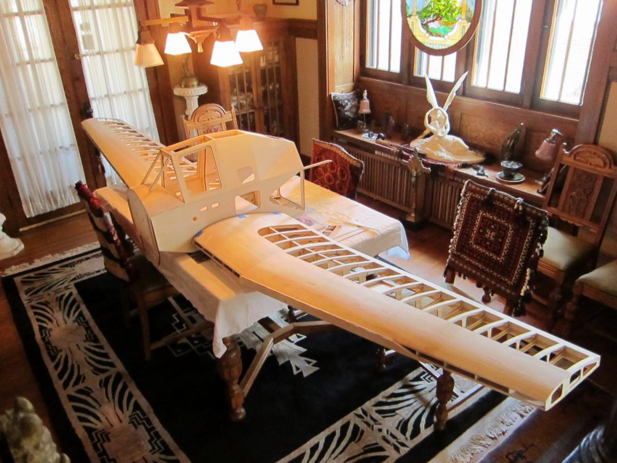

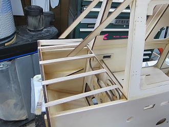

ID:	25714 first visions of what to come...test fitting the wings to the fuse...some issues but will add and subtract some wood here and there to make things
                mate closer than they are now...try like I did...1/8" plywood ribs do not always stray straight when gluing with water based blue...no excuses here, but just a fact...
                Anyway....onward to completion I hope next month....everything is pretty much done except LE of wing and final sanding....
                Wife is coming home from vacation tomorrow so plane will be gone from dining room table by the time she gets home !!!
