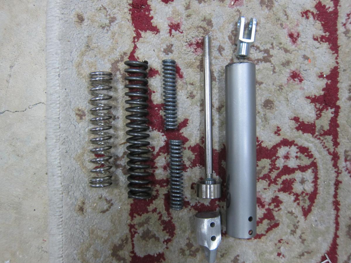

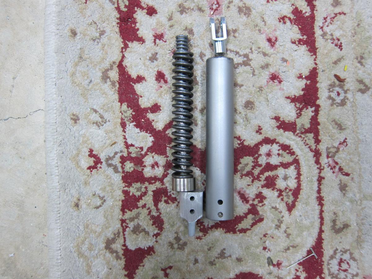

                        • Click image for larger version  Name:	IMG_0003.JPG Views:	1 Size:	159.3 KB ID:	37858Click image for larger version  Name:	IMG_0004.JPG Views:	1 Size:	175.3 KB ID:	37859 Post maiden fixin….decided that the McMaster Carr longer springs are really not much stronger than the shorter original PAWNEE springs....the Original Pawnee spring is on the far left.. next is the McMaster Carr replacement spring...the smallest springs are the ones i am adding to INSIDE the McMaster Carr springs....additively...hopefully the right amount of resistance on landing.... and see if I can get about 20-30 % more buffering on my landings with OUT being too stiff....I turned the spacer part on the steel insert down in the Lathe so as to accommodate the skinner springs than stock ...the small ones fit inside the McMaster Carr replacements...I had gone to multiple spring web sties only to be totally over whelmed with various specs and could not figure it out...so went back to McMaster carr and got the next strongest spring but it is clearly TOO strong....lots of experiements I suspect before this gets determined.
                          I know very few people chose to use the Pawnee Gear on their Cmelaks...perhaps a hand full...but maybe this will be a helpful post to them if you are not happy..I love this bird !!!!
