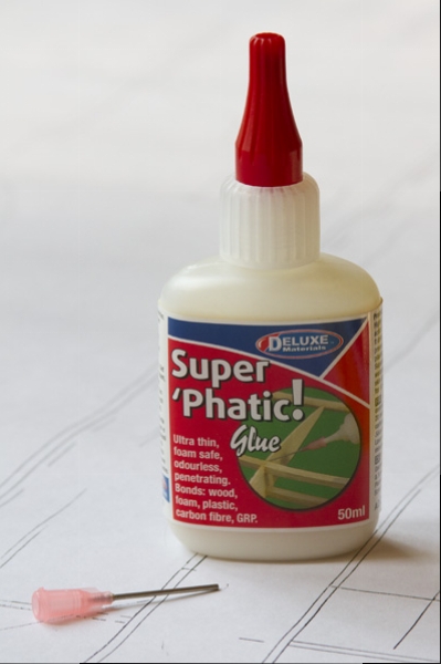

      I'm looking forward to your progress. Have you looked at or considered Super'Phatic? It sets a lot faster than normal Aliphatic glues. Off hand I don't know if its ingredients would cause you any issues, but I know it does not give off the vapor/fumes that CA does.
      I buy it locally from my Hobbytown USA, but I think you can order it from Horizon. I also remove and rinse the hypodermic tip in warm water after every session and re-use it (I actually ordered extras on Amazon).
        Thanks so much, Actually I have been using that Super Phatic as pictured for years since I developed my severe allergy to CA. I often use a small paint brush to brush on the glue and smooth it out, keeping things flowing with frequent water changes as well...There are times with bigger surfaces where TItebond is my other choice. Neither bother me at all. My local hobby shop carries the Super Phatic and I try my best to buy local to keep them going. My reaction to CA is not the eyes, but rather my whole Body reacts as if I have instant severe flu and I am sick for up to two days after as little as a whiff of the stuff. Like many allergies, It keeps getting worse over time.
