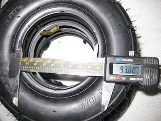

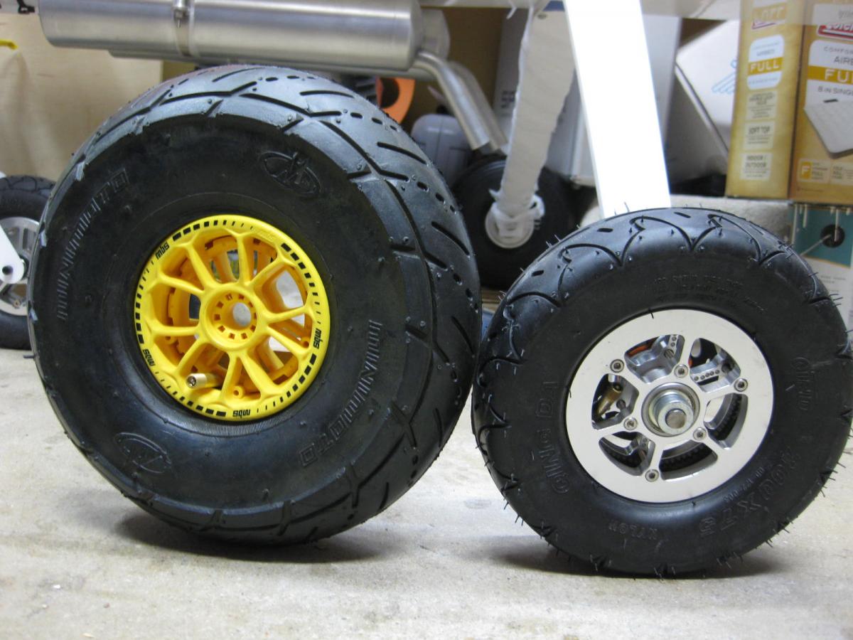

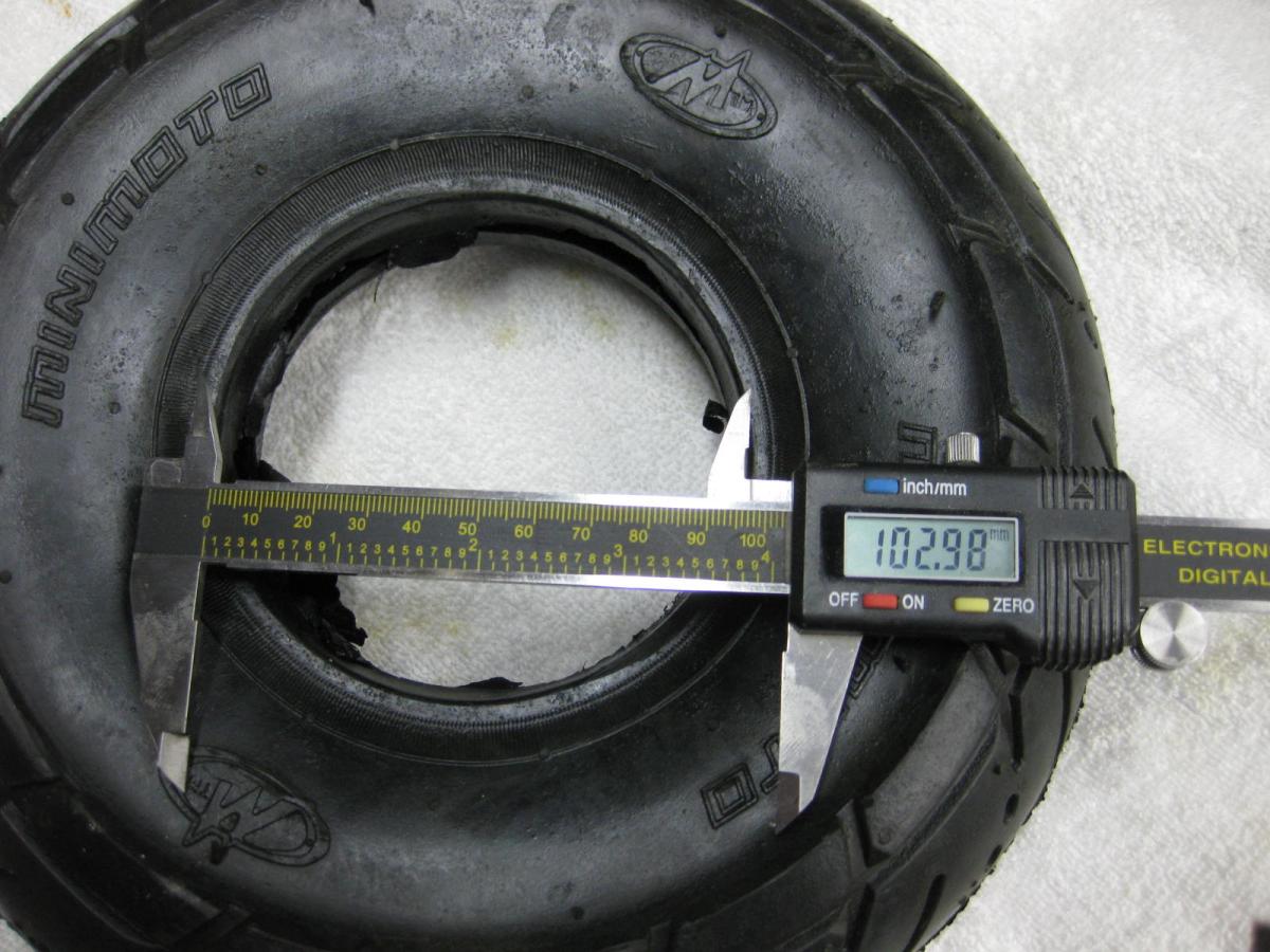

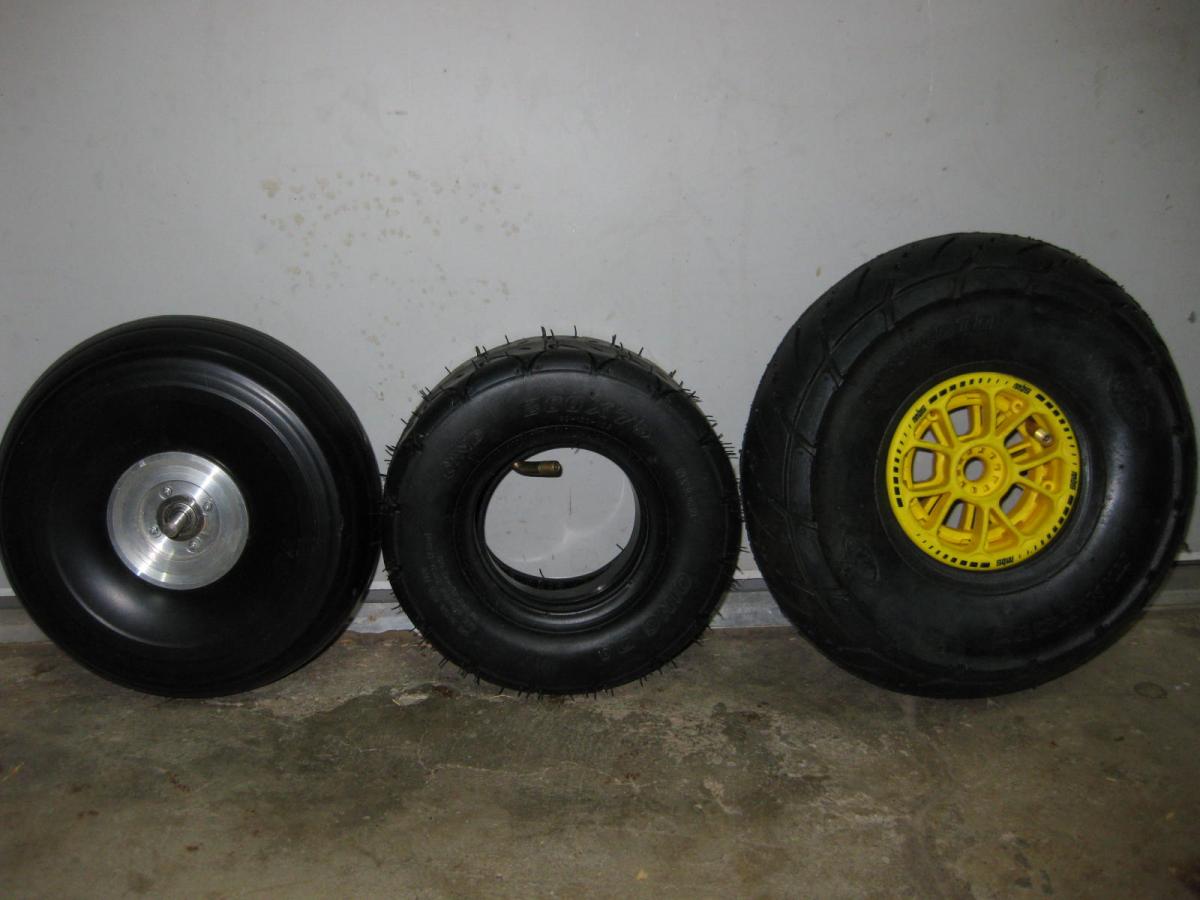

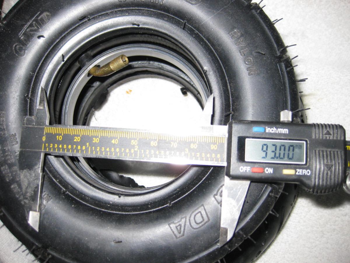

    Looks like I spoke too soon on what tire fits what rim. I ordered a pair of the ultra "cost conscious" 3.00-4 tires and found they have a slightly bigger inner diameter than the 200x50/75 tires causing it to pop off the rim.
    Here's a some pictures for size comparison ( original Bidule tires too )
ID:	9583 Click image for larger version
    looks like the 200x50/75 tires have a 93-95 mm inner diamemeter while the 3.00-4 tires have a 100-103 mm inner diamemeter

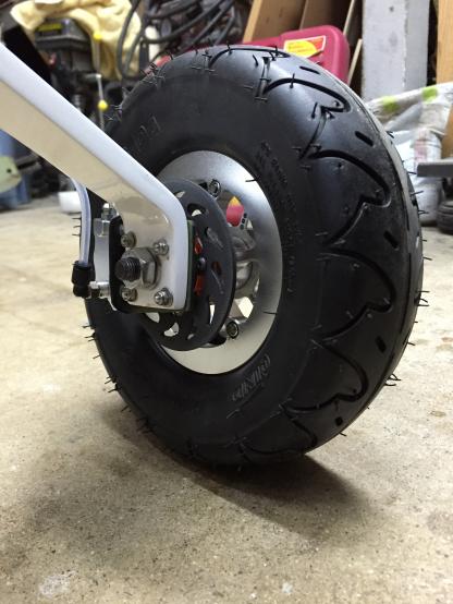

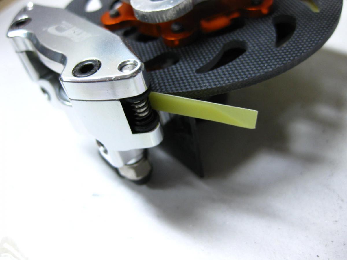

          Thanks Scot for the balance info, just about at that point.
          But back to the brakes system

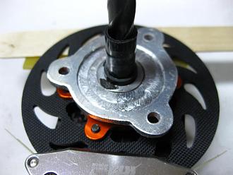

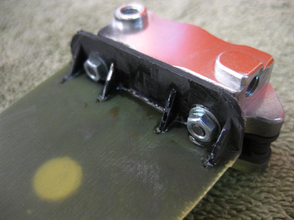

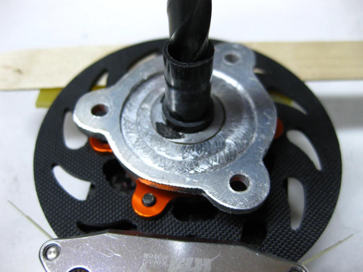

          Used some 0.020 spacers on the disc rotor against the caliper return springs to space it out., then used double spacers (12/10mm and 10/8mm) and a drill bit to mark where to drill
          Then used a stepped drill for the 10mm job
ID:	9634 Click image for larger version

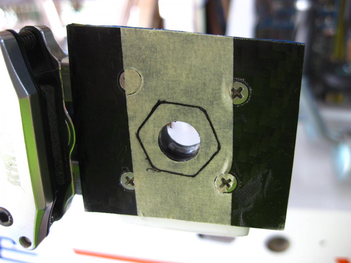

          Added a little thickness to the mounting plate as I didn't want the flat head screws pulling out - along with some really small triangle reinforcements
ID:	9635 Click image for larger version

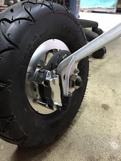

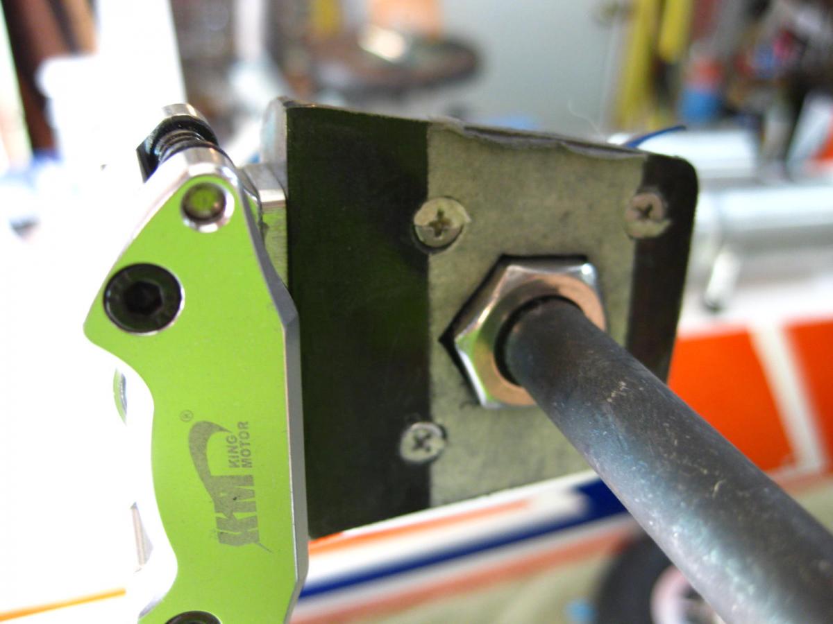

          Mounted the Caliper plate and recessed the axel bolt
ID:	9638 Click image for larger version

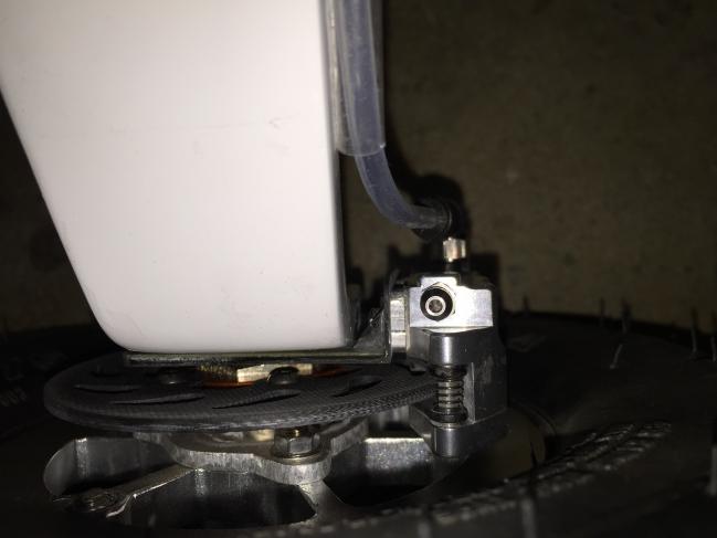

          • #66

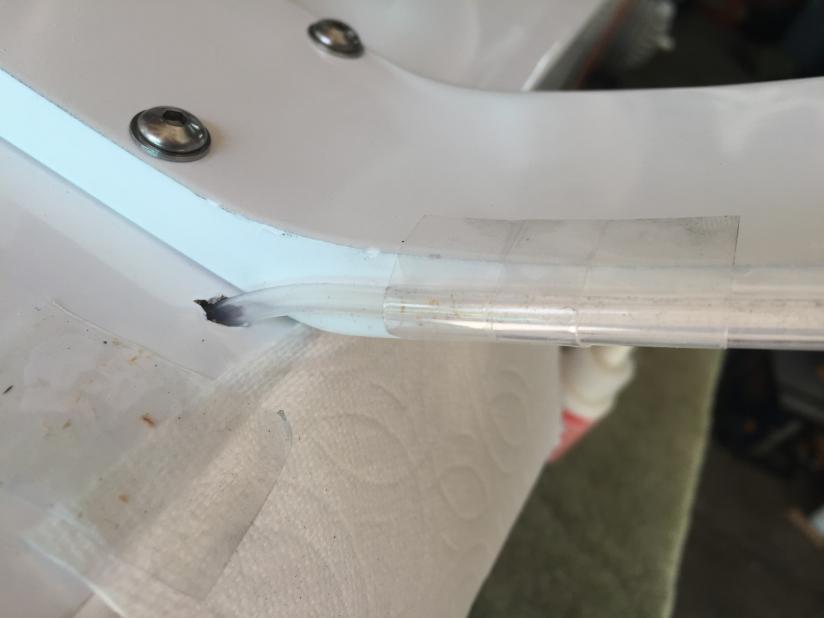

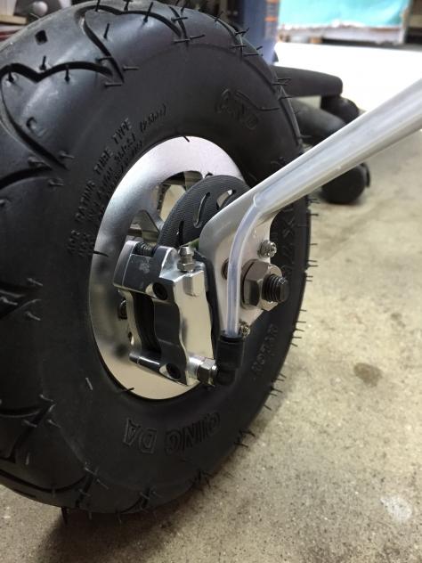

            Was trying to come up with some type of attachment system for the brake line along the landing gear leg and found an empty K&S metal rod storage tube (clear plastic) that fit the 4mm OD. brake line. Glued it on to the gear leg with Formula 560 Canopy glue. I think I might put some white sign vinyl over the top eventually
            I sized the 12/10mm wheel axel spacer/standoff to get the brake rotor nut so it was somewhat in the center of the rotor contact area so it can float either way.
ID:	9656 Click image for larger version
ID:	9657 Click image for larger version

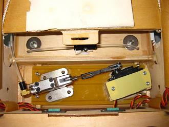

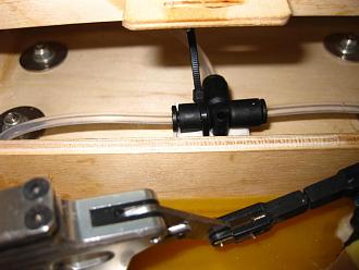

                        Finishing up the brake installation -
                        I'll have to find some small caps for the caliper and master cylinder fill ports so dust/dirt doesn't get in.
ID:	9883 Click image for larger version

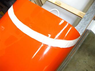

                        I must be getting close as there's glue on the Canopy.(Pacer Formula560)

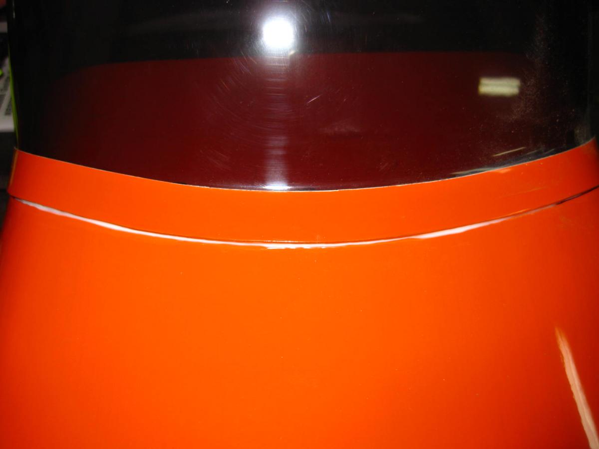

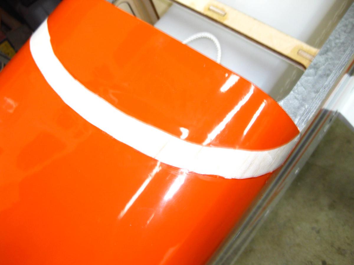

                          Did you remove the covering under the canopy before you glued it on? I didn't originally and the canopy came off. Luckily it was noticed before it came off in flight.
                          • #75
                            Thanks Len on both counts......I broke out my Xacto knife and worked the canopy off.....had a really nice glue line to guide the inside cut on the front.
                            Just need to remove the glue from the canopy side then re-glue........
