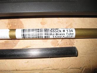

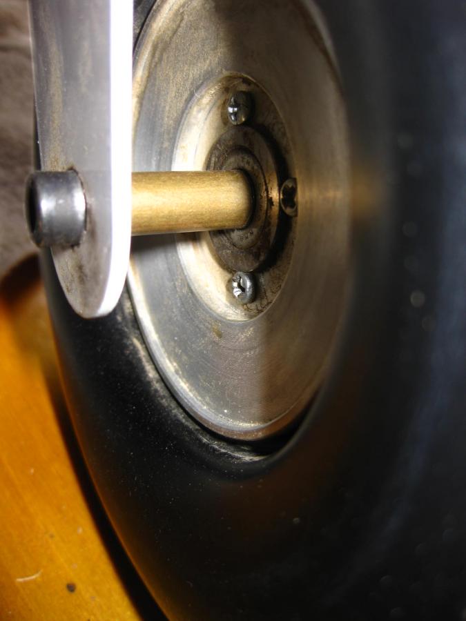

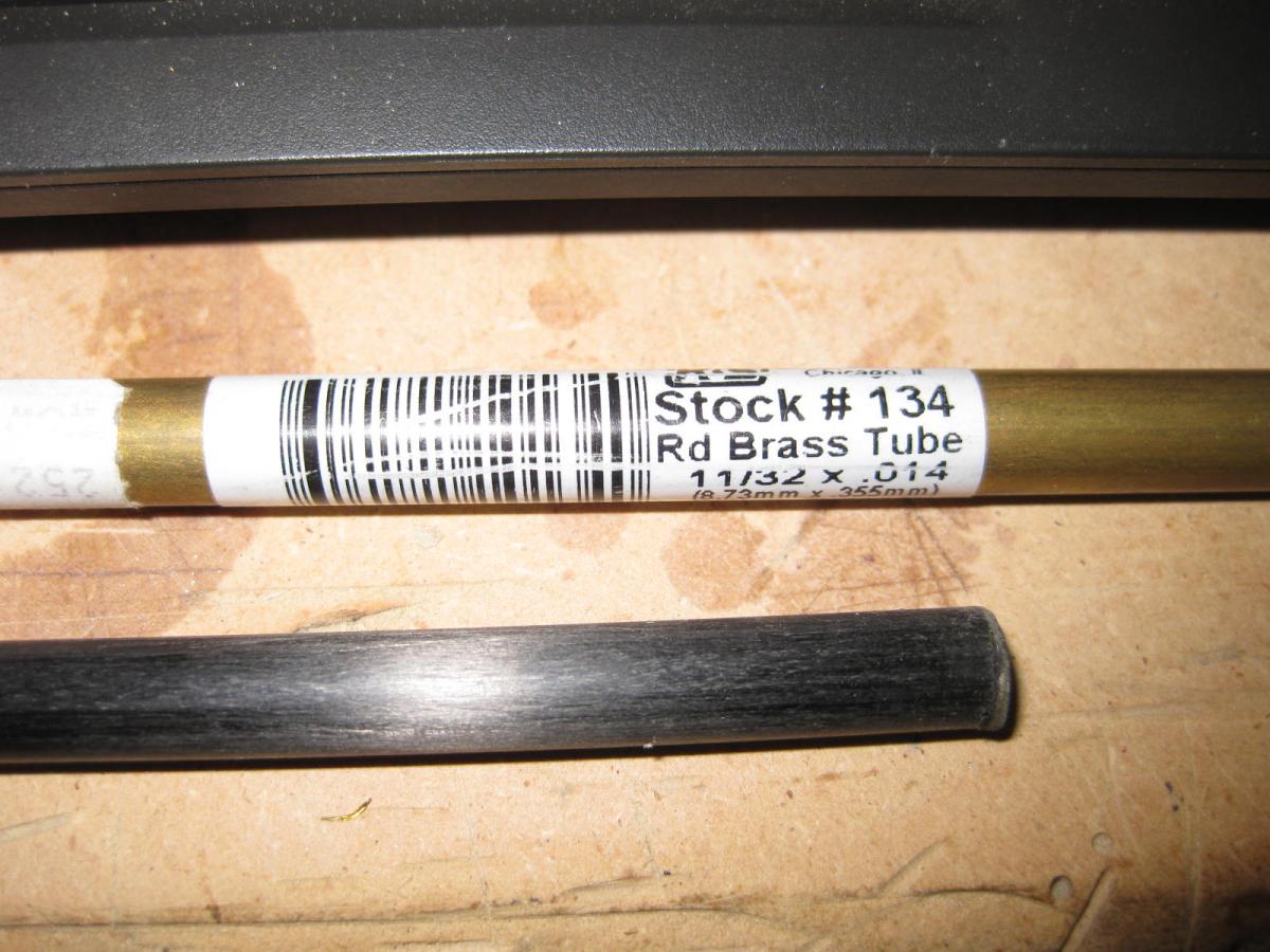

          Nose wheel axle spacer simple mod .....added a brass tube over a 6mm id./10mm od. carbon tube. Tested yesterday at the Visalia November AeroTow.

          • Scott, does that system clamp the nose gear side plates under the bolt head and at the nut end? The concern is vibration and wear wallowing out the bolt/axle hole.
            • MarnochS
              MarnochS commented
              Yes it does, the bolt clamps everything together.
