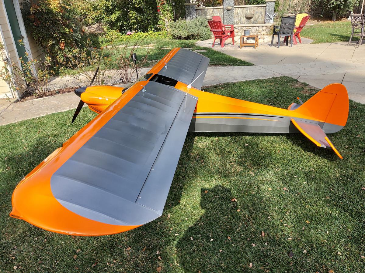

Carbon Cub FX-3......
    10% left to do.............
ID:	46303 Click image for larger version
    Click image for larger version  Name:	20211031_104710.jpg Views:	0 Size:	253.1 KB ID:	46302 Now on to engine and avionics installation
      Isn't that the hard part? Looks beautiful Scott
        Nice Job Scott!
        SCC AAA TT TN
          Another masterpiece, Scott. Great job!
            Thanks All - it was very motivating assembly. - just wish i could find some 12" PR Brush wheels to complete the look.

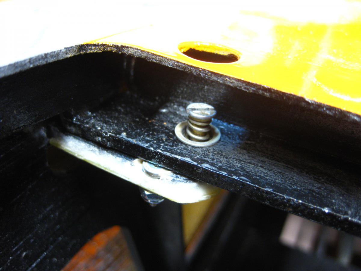

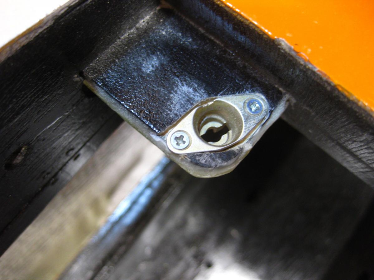

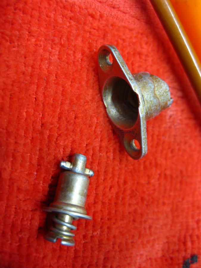

            Meanwhile .....adding some easier access to the top hatch via CamLoc 2700 studs and receptacles.
ID:	46320 Click image for larger version
ID:	46321 Click image for larger version

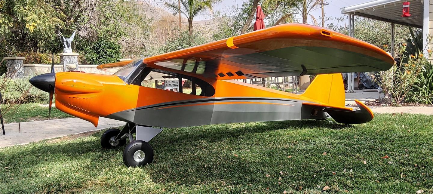

                I'll make some hub caps too. Found some pictures while searching the web.
ID:	46362 Click image for larger version

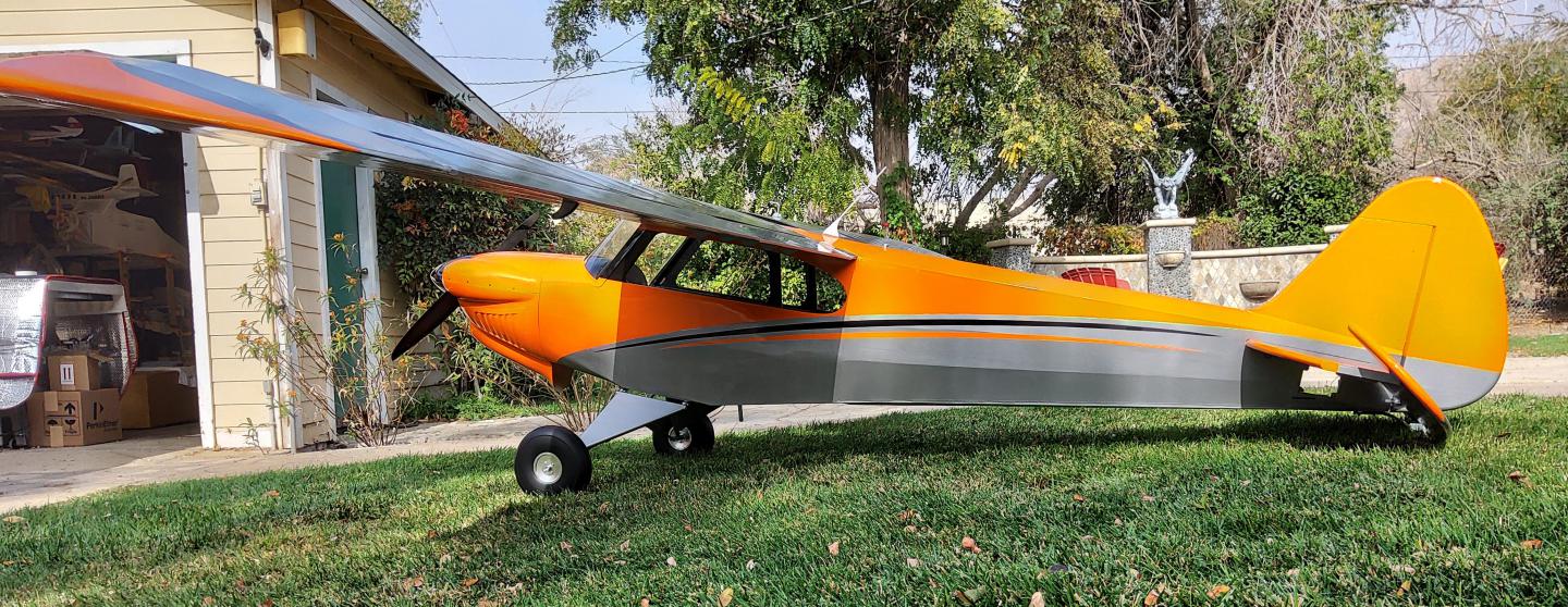

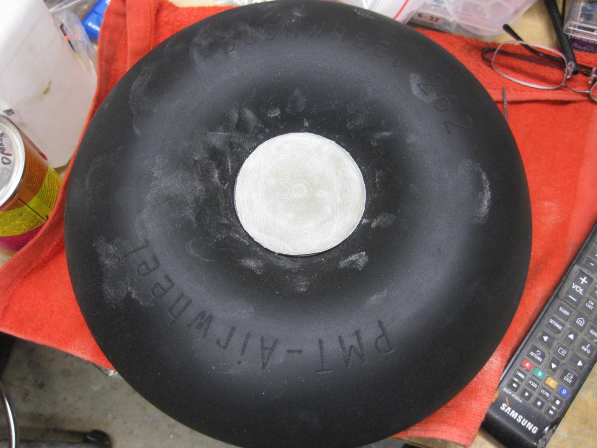

                  Hub Caps for the PMT 262 Bush Wheels - using the stock wheels as a form.....
                  Click image for larger version  Name:	IMG_6252.jpg Views:	0 Size:	123.9 KB ID:	46387 Click image for larger version  Name:	IMG_6253.jpg Views:	13 Size:	120.5 KB ID:	46389

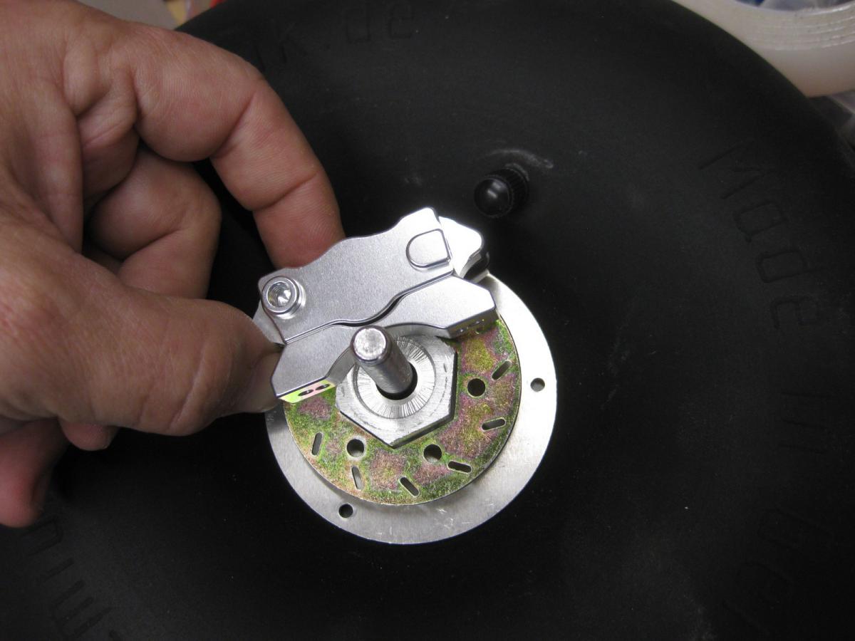

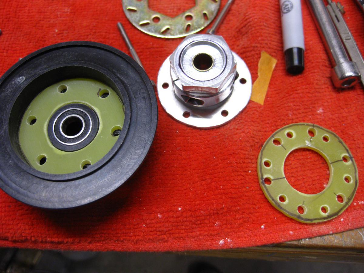

                    Cut down the wheel adaptor plate from Aviation Concepts Bidule Brake kit and drilled, along with the 1/8" spacer......extra holes in the other adaptor plate due to mis-alignment of the alignment jig.......
                    Click image for larger version  Name:	IMG_6267.jpg Views:	0 Size:	137.2 KB ID:	46400 Click image for larger version  Name:	IMG_6256.jpg Views:	0 Size:	108.4 KB ID:	46399

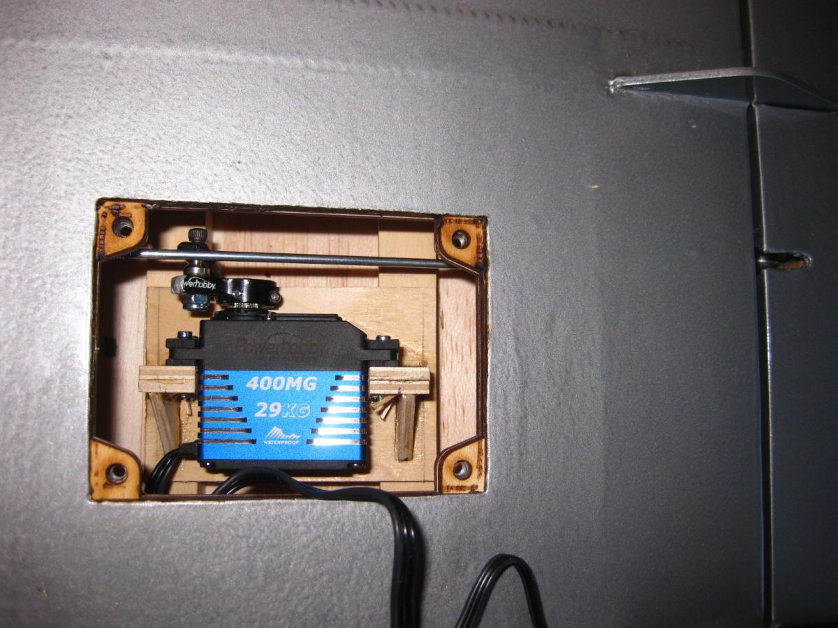

                      Working on the Flap servo installation
                      Need about 20mm of pushrod travel for full flap deployment so the servo arm ball link attachment hole was moved in so I can have full servo arm movement.
                      Click image for larger version  Name:	IMG_6275.jpg Views:	0 Size:	141.0 KB ID:	46445
                      75 degrees of deflection should be good enough to slow things down
                      Click image for larger version  Name:	IMG_6276-1.jpg Views:	15 Size:	109.6 KB ID:	46456

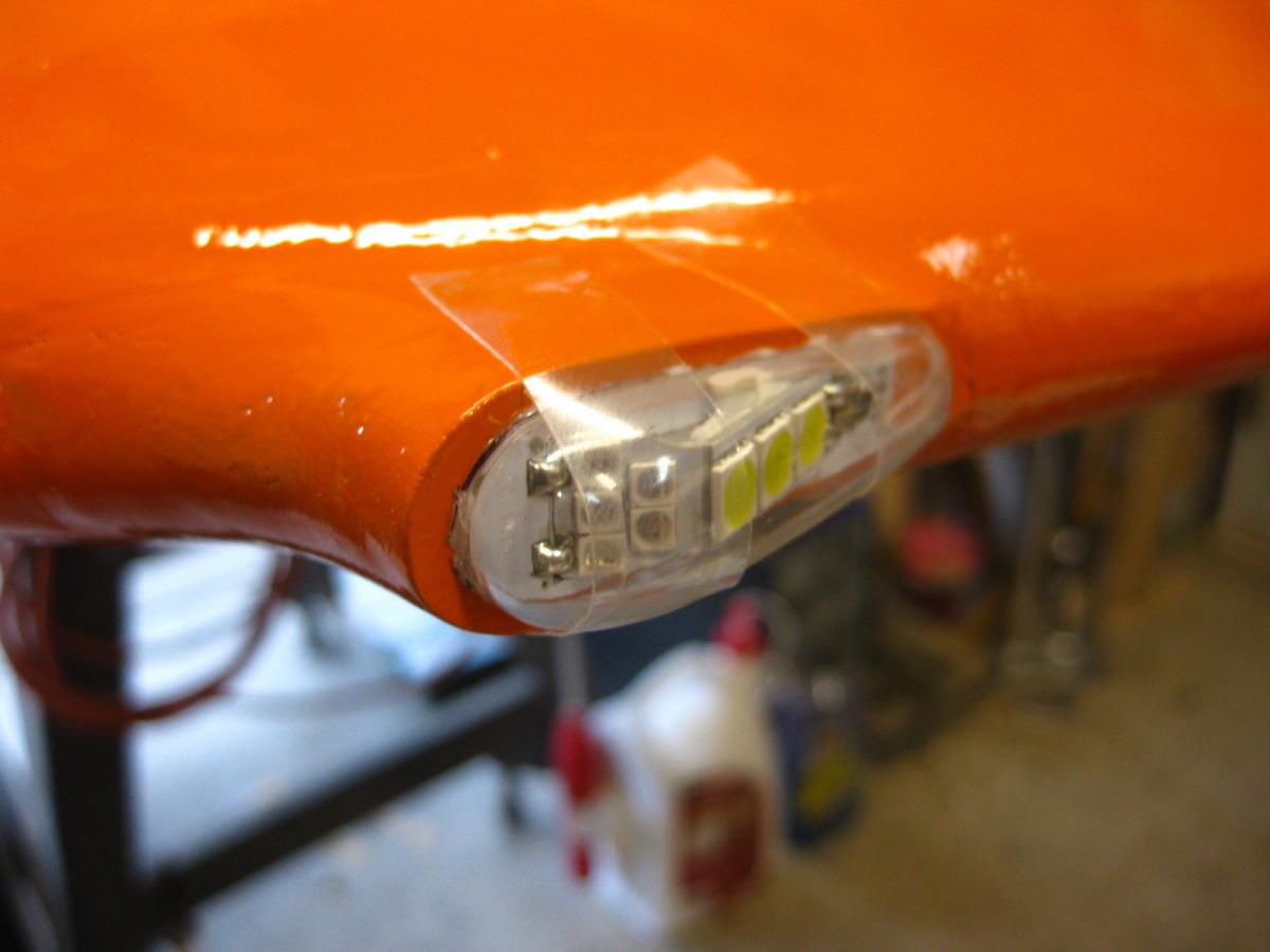

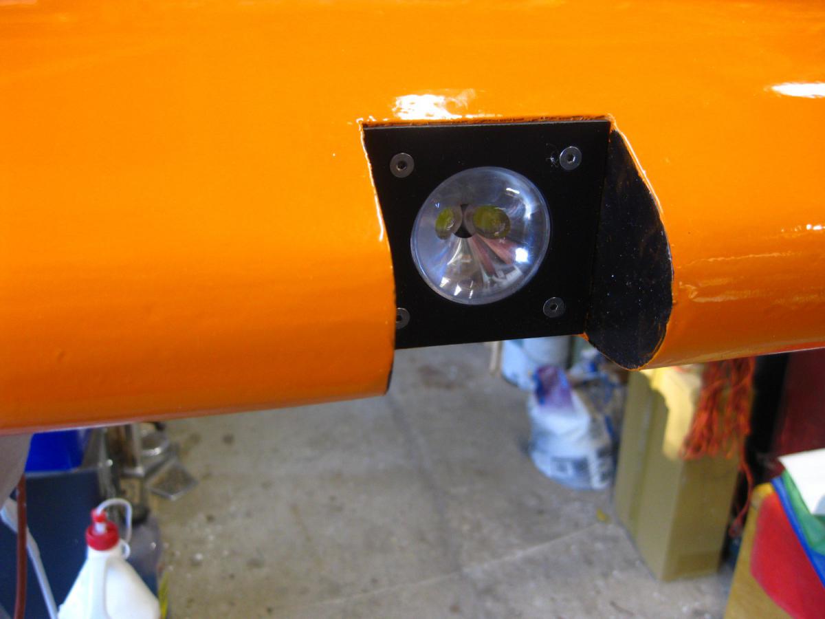

                        Lights.....I think I need a different landing light cover than the one that glues over the top
                        Click image for larger version  Name:	IMG_6287.jpg Views:	0 Size:	67.0 KB ID:	46493 Click image for larger version  Name:	IMG_6285.jpg Views:	0 Size:	65.4 KB ID:	46494

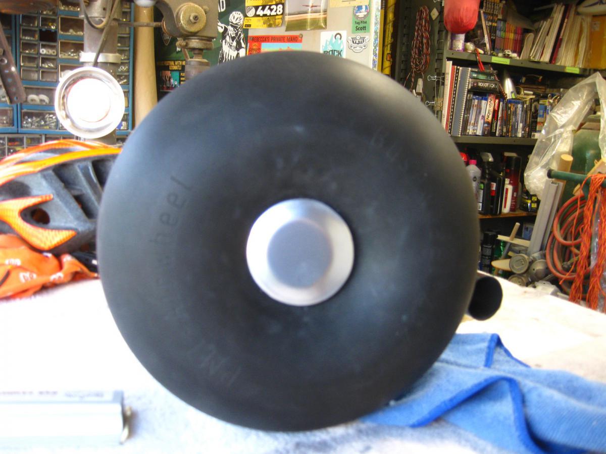

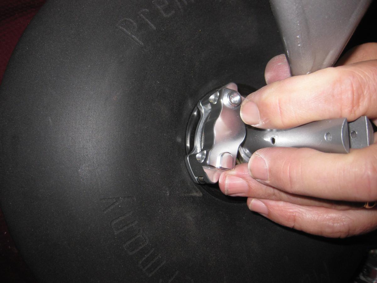

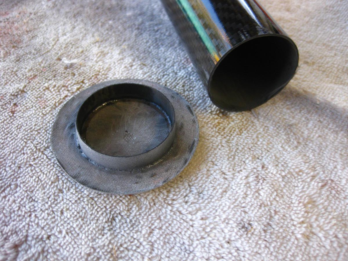

                          Wheel hub cap came out passable - Rust-Oleum Bright Coat Metallic Finnish Aluminum
                          44 mm carbon tube.....just have to make sure to have the axel installed before installing the hub cap --- its a smug fit.

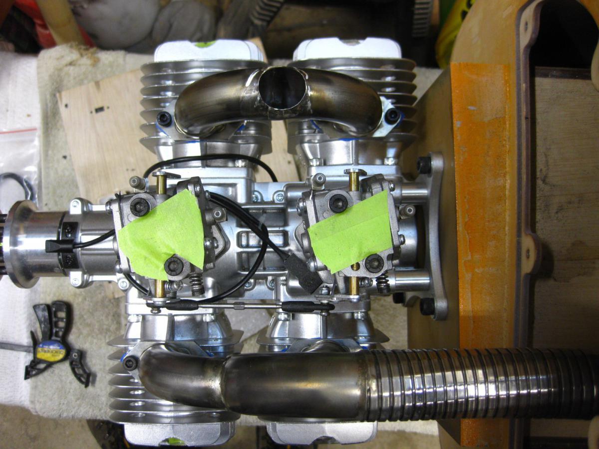

                            Exhausting progress over the holiday.......

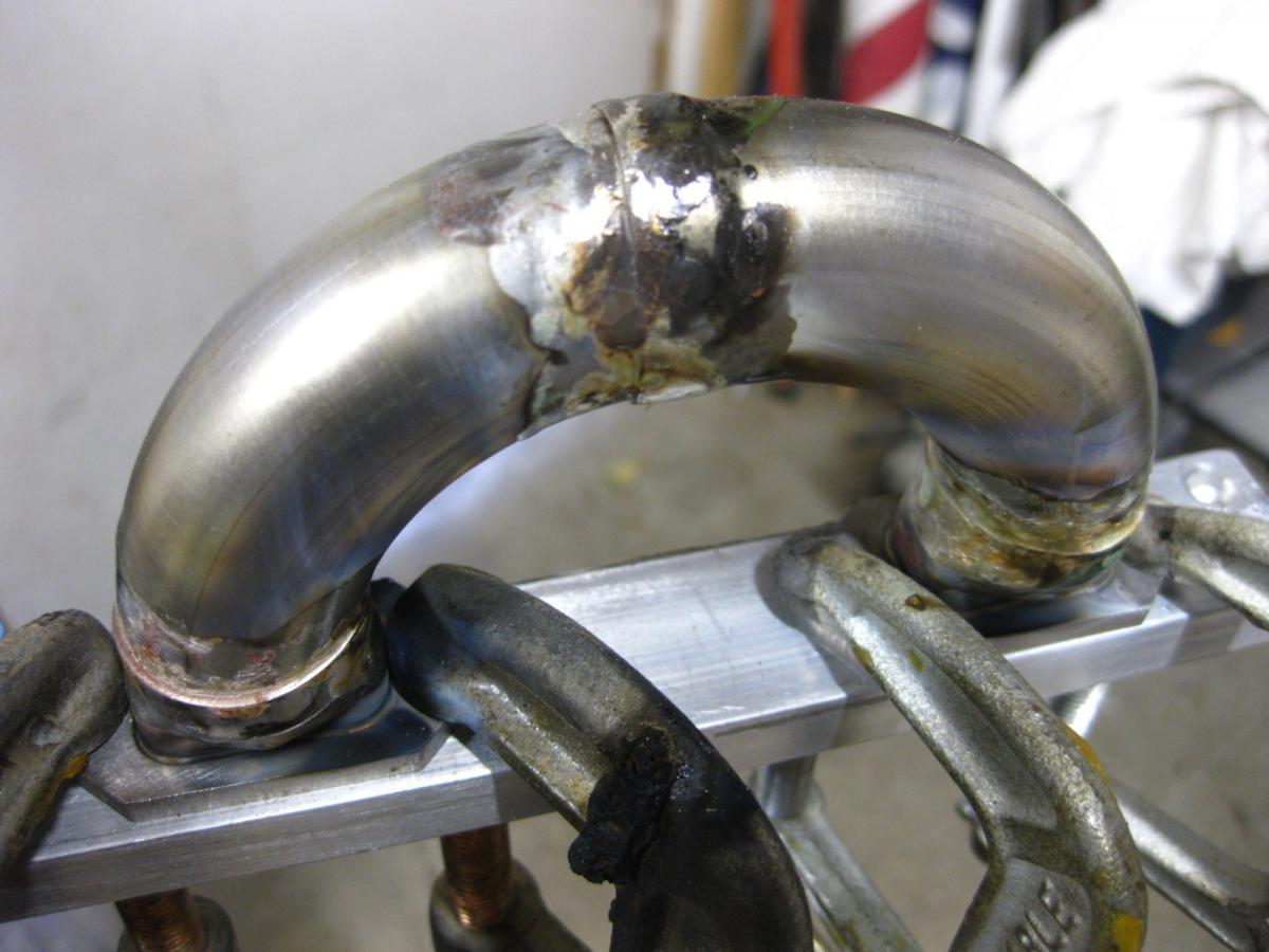

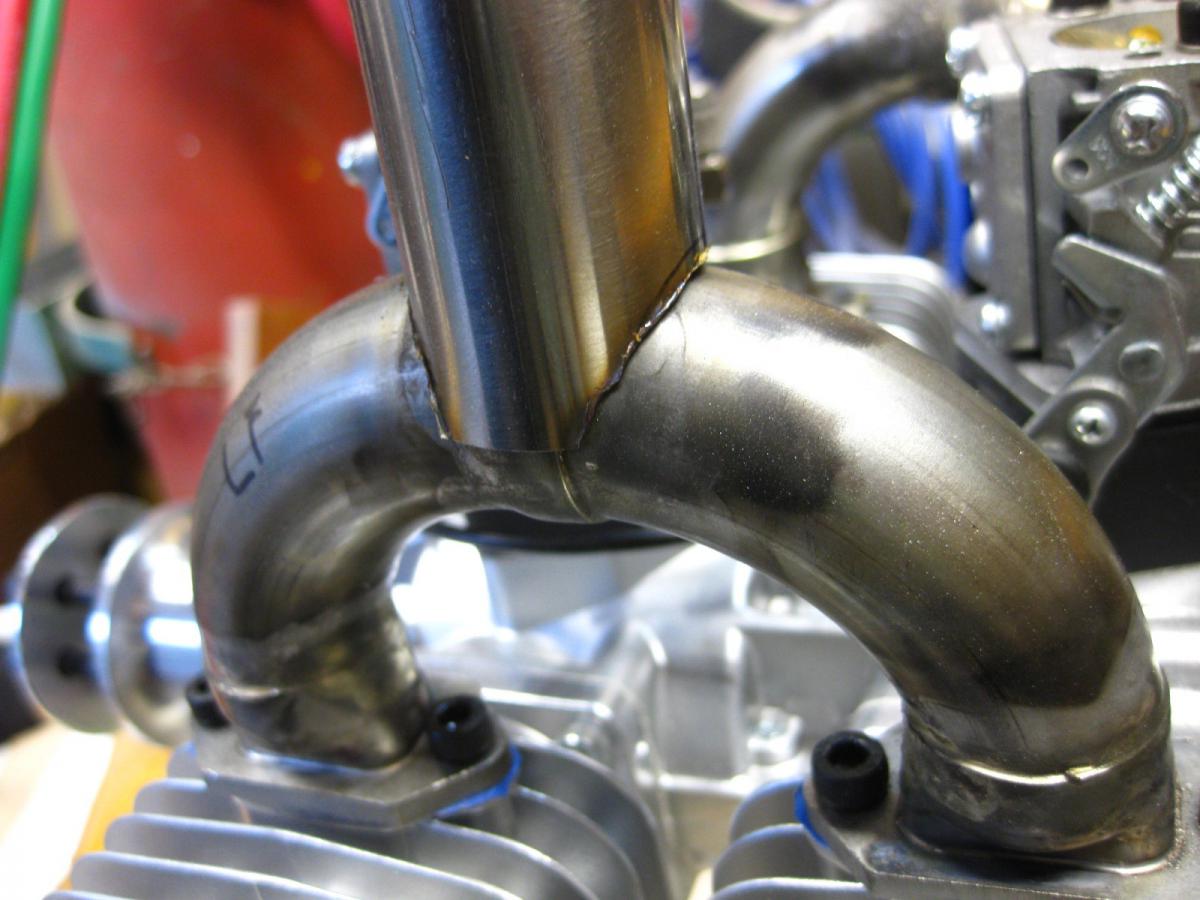

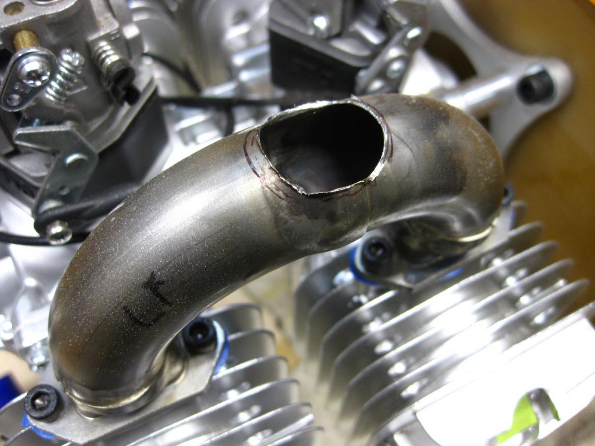

                            Initially, tacked things together on the engine and then transfer off to finish up the brazing.
ID:	46689 Click image for larger version
ID:	46688 Click image for larger version
                              And the second side
