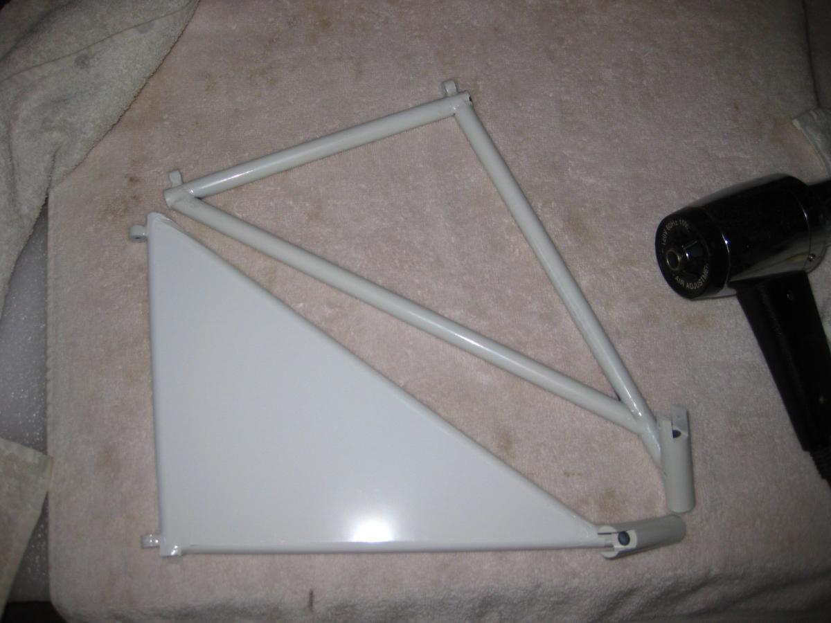

    It all started by...... a heat gun with a puropse.......and a pair a tweezer.......

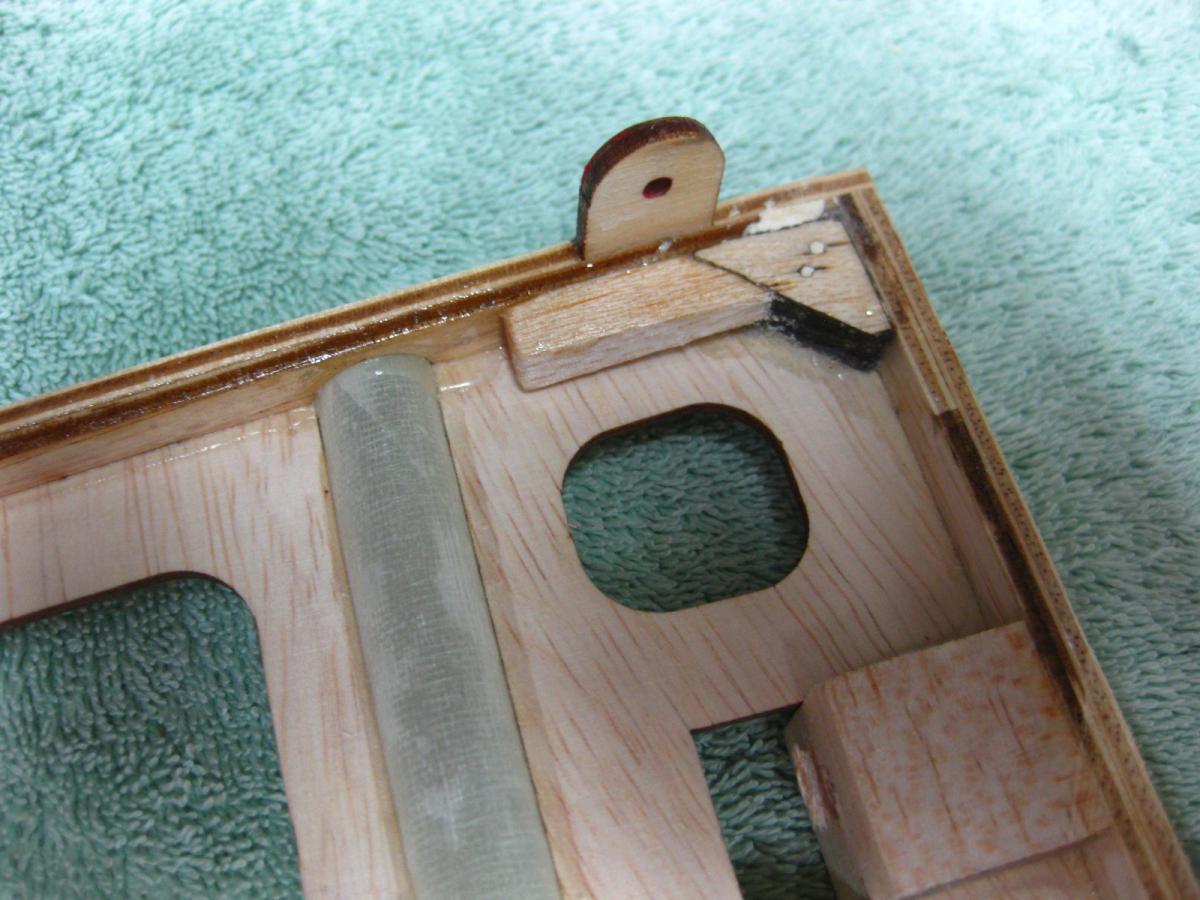

    Some extra attachment area was added and then.....
ID:	44925 Click image for larger version

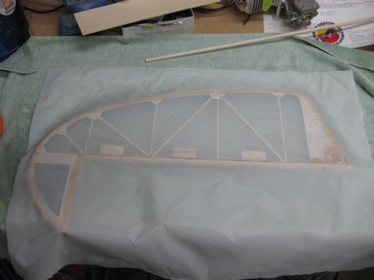

    4:1 thinned Poly-Tak was applied to the surfaces to be glued. Then thinner was applied to the fabric as it touched the surfaces.
    Then Poly-Brush to seal the Fabric......almost all the full size kit built EX3 have the pink stuff

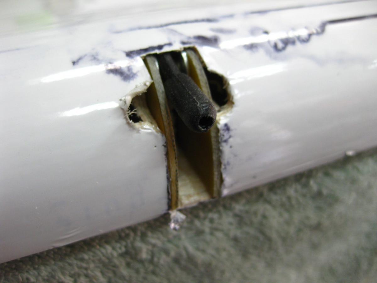

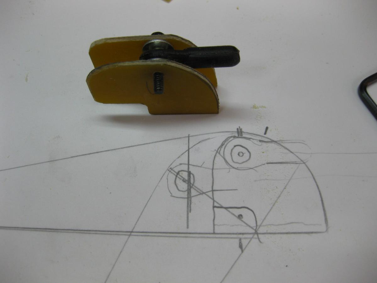

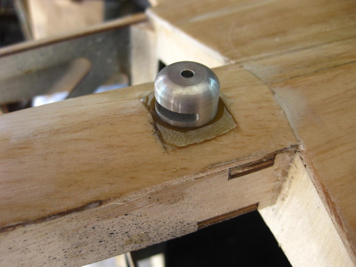

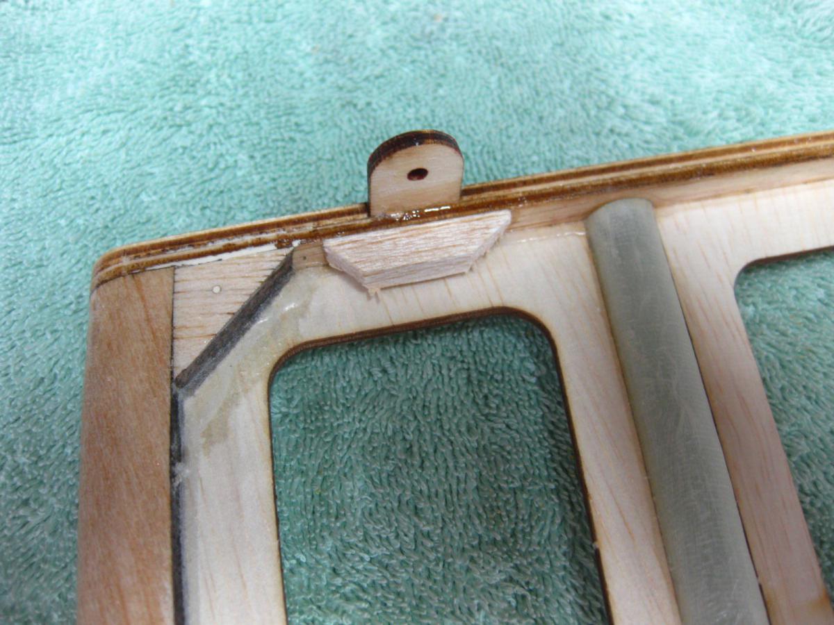

    While I wait for the 3/4 pinked tapes from http://PinkedTapes.com , converting the flaps to top driven to hide the control linkage.
    inserts are made with 0.060 G10 material. 4-40 washer on either side of the ball link for spacing to clear the body
ID:	44974 Click image for larger version
ID:	44972 Click image for larger version

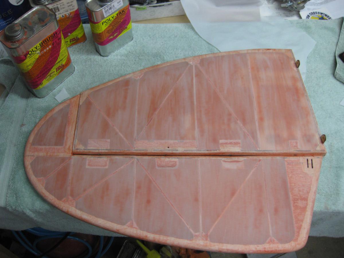

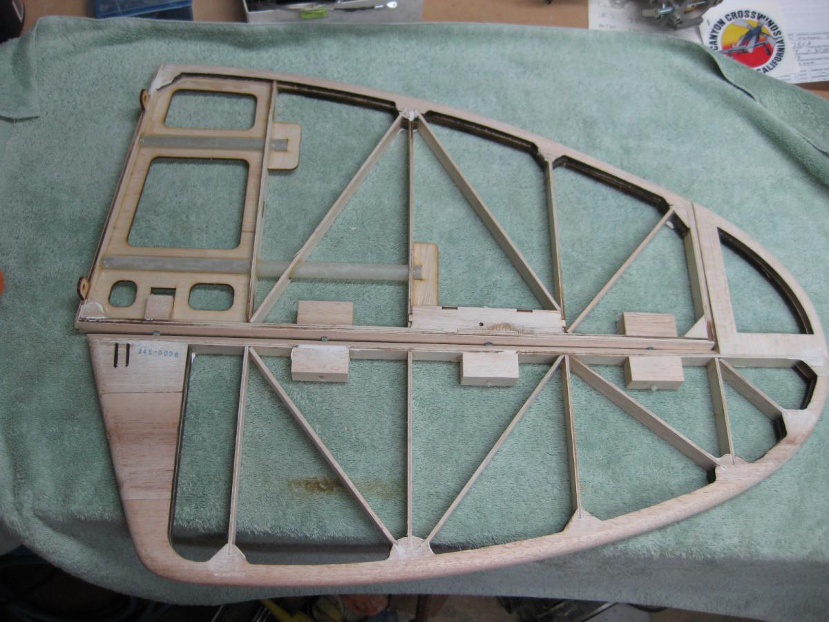

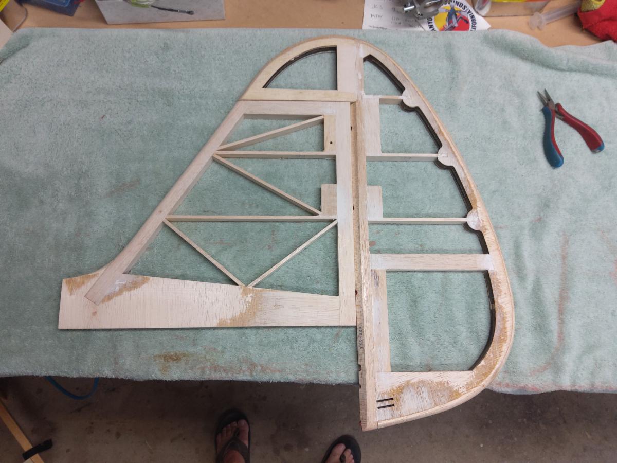

      Rudder / Fin internal composition

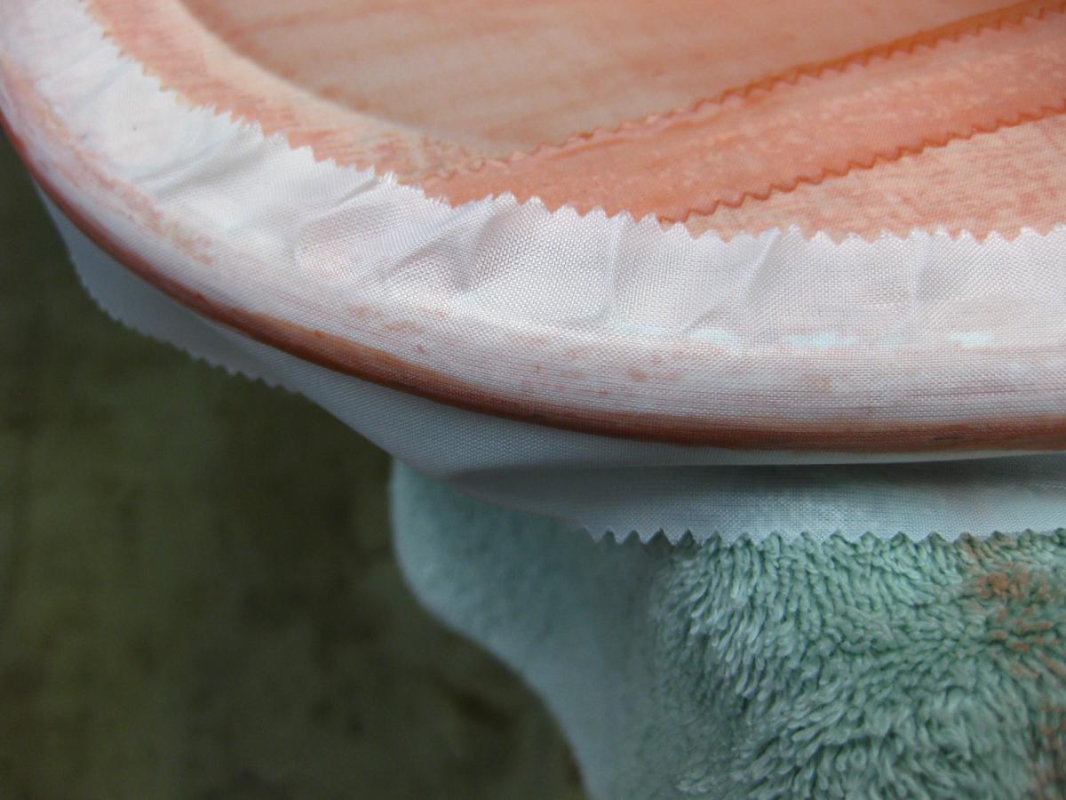

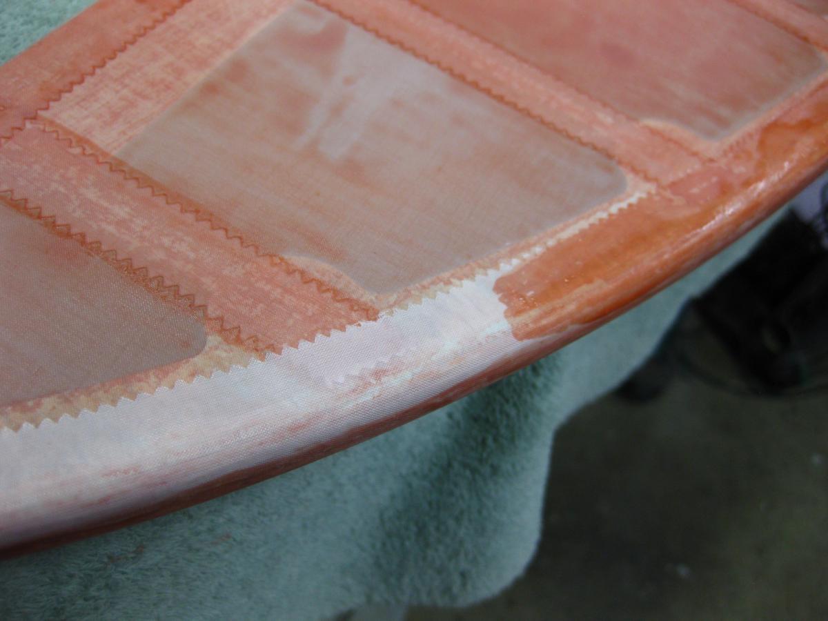

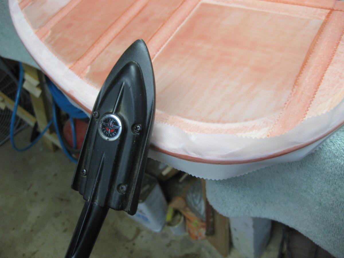

        Pinking Tapes added - talked with http://PinkedTapes.com about applying the perimeter 2" wrap tape. They suggested using the heat forming technique but at 350 degrees. I was a apprehensive but gave it a shot......and it worked great.

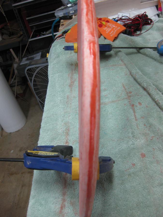

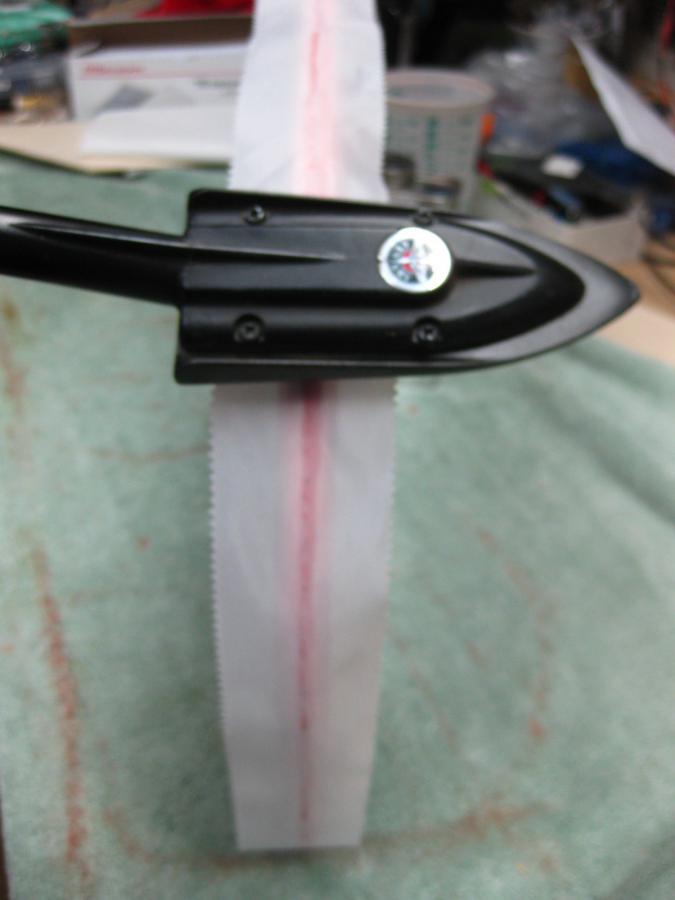

          My technique for doing the wrap
          apply a coat of Poly-Brush to the center.......
          Iron on the 2" tape at 200 F ( mark the center line of the 2" tape for a guide ) ....then apply more Poly-Brush to the center of the tape to keep it from moving around .
ID:	45050 Click image for larger version
          Dial the Iron up to 350 and start forming , the tighter radius need a little care not to get folds in the tape.
ID:	45052 Click image for larger version
          Things looked a little odd but formed up nicely ..... then a coat of Poly-Brush .

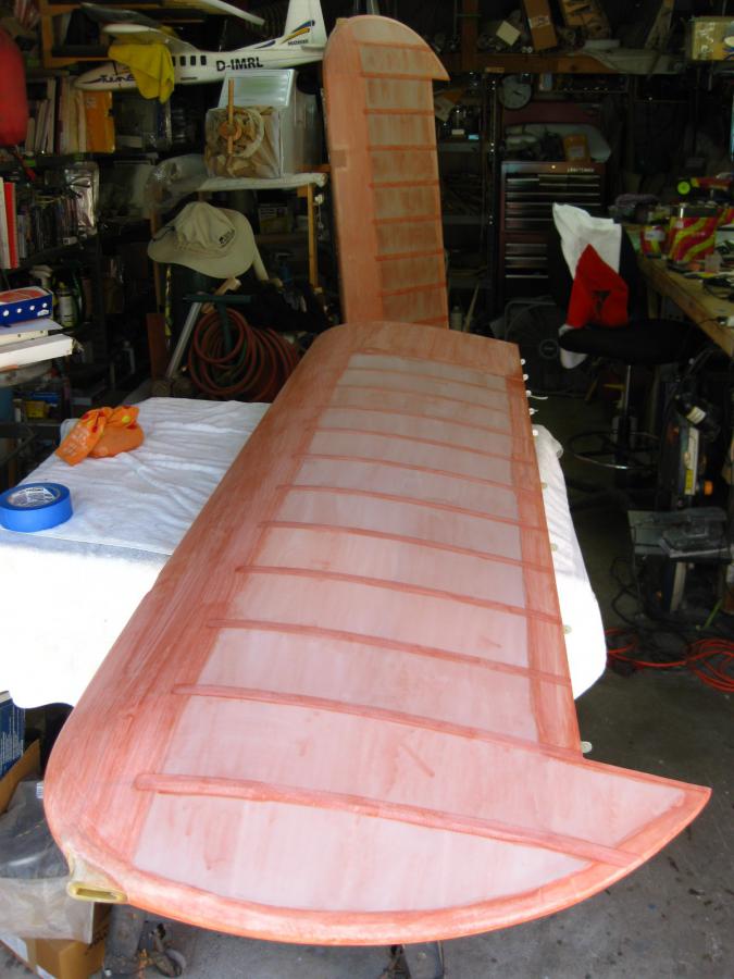

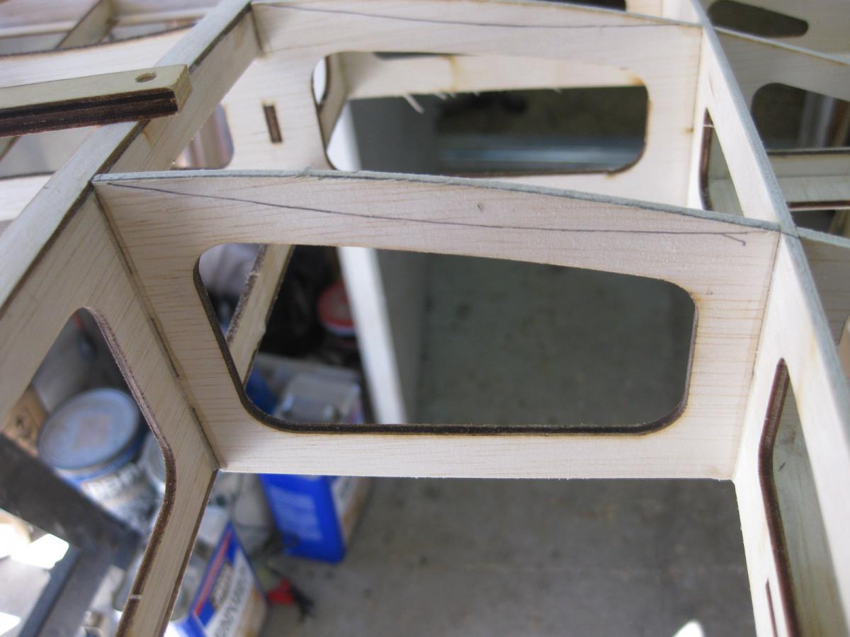

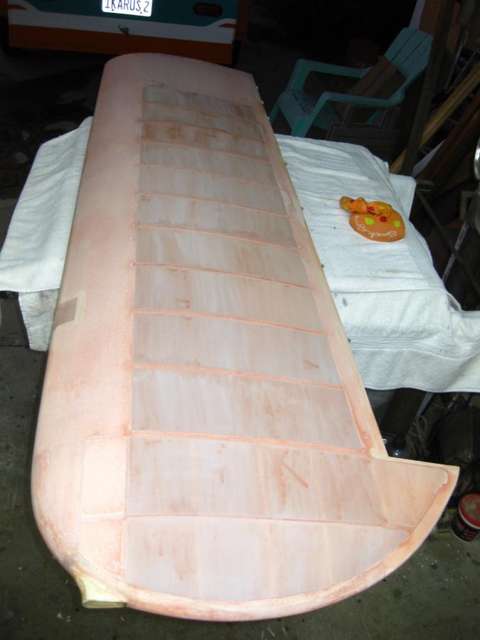

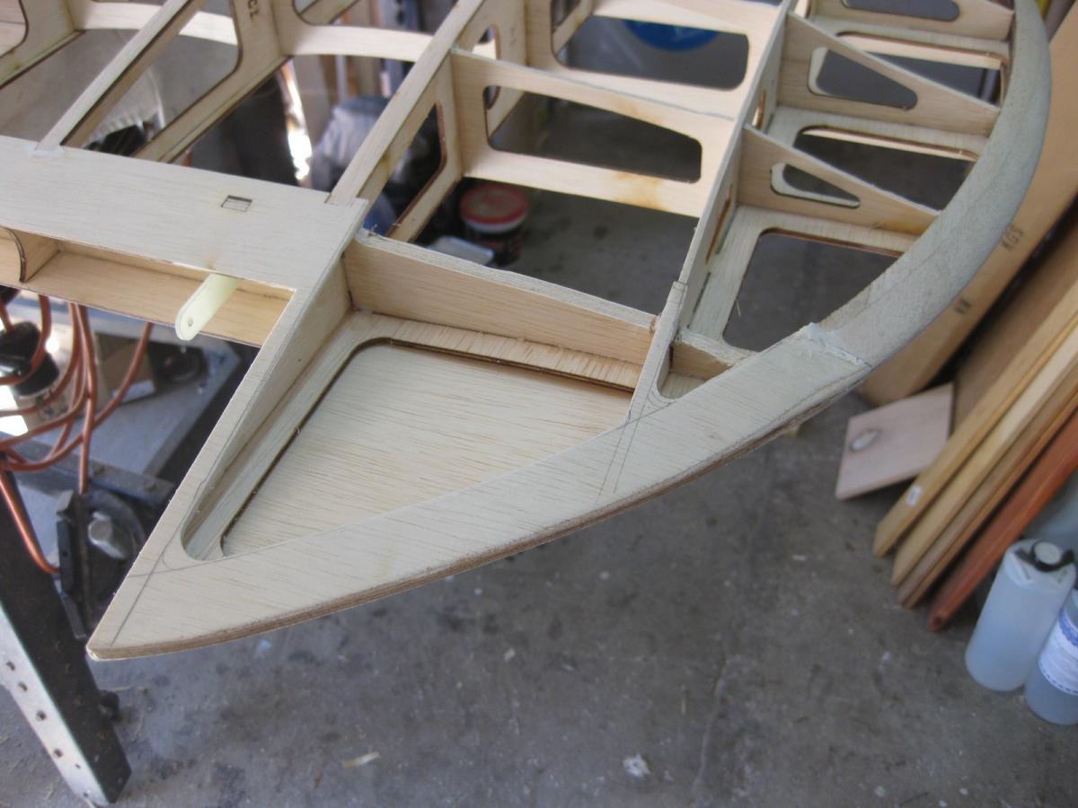

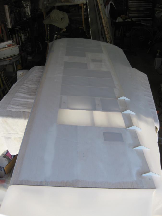

            The Wings......... Some filling and removal to smooth thing out
ID:	45078 Click image for larger version
ID:	45079 Click image for larger version

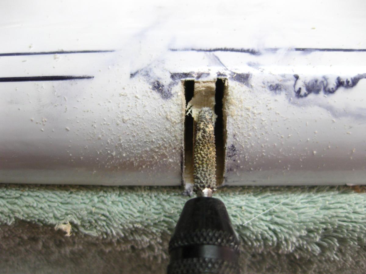

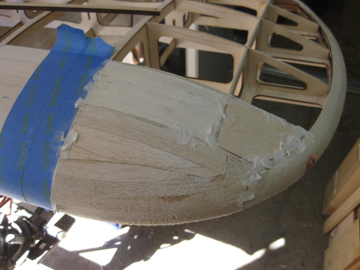

            Removing some material so the fabric will bow between the ribs
ID:	45082 Click image for larger version

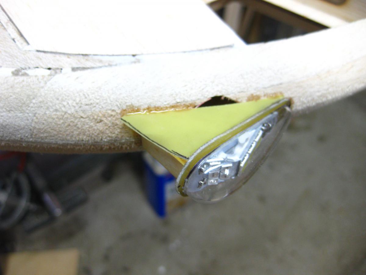

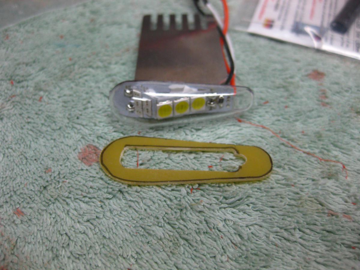

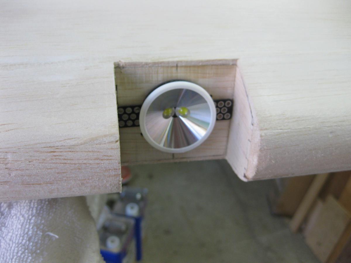

            Some UniLights Strobe/NAV ( DUAL 14F-320x2 RTWE & GNWE ) mounts.
ID:	45085 Click image for larger version
ID:	45084 Click image for larger version

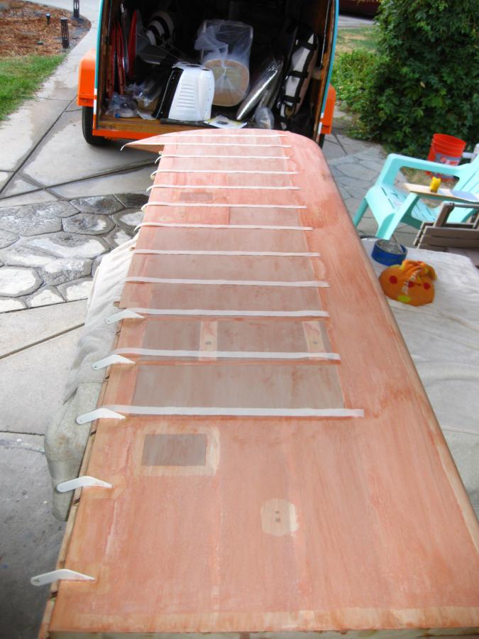

              Fabric time
ID:	45094 Click image for larger version
              Poly-Brush
                I love the lights, the quality is second to none. Great job Scot.
                  Thanks Len, the strobes are ....well ....pretty bright.....inside a small garage.

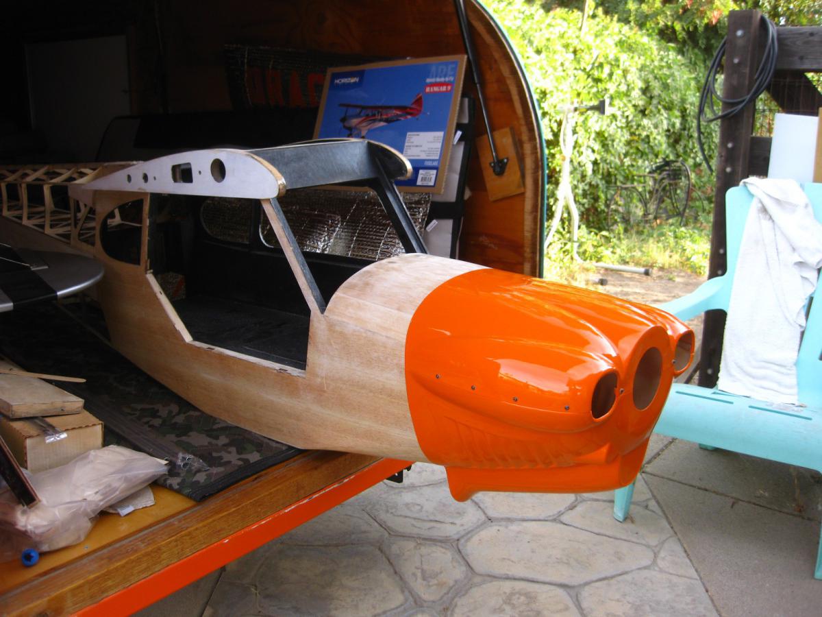

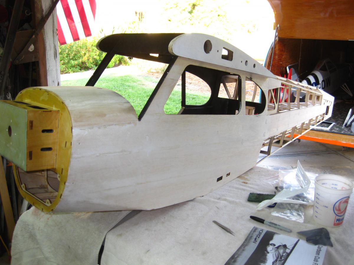

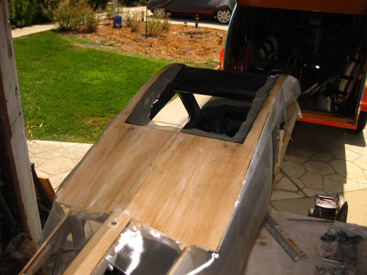

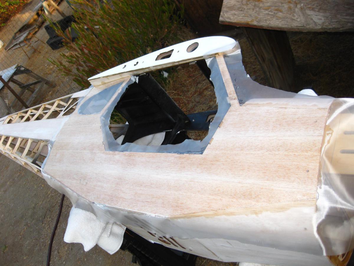

                  the fuselage made it's way out of the box in preparation of recovering and ....well .....kinda big.
                  Click image for larger version  Name:	IMG_5954.JPG Views:	0 Size:	78.0 KB ID:	45132
                  Click image for larger version  Name:	IMG_5956.JPG Views:	0 Size:	71.5 KB ID:	45133

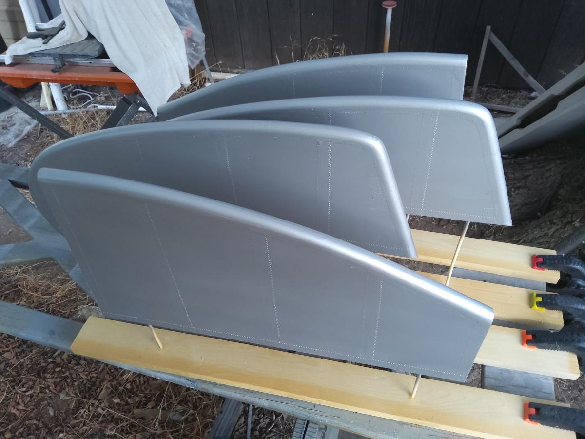

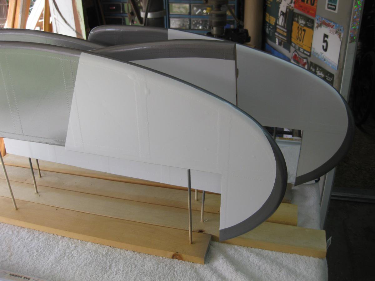

                      Poly-Spray on the tail surfaces

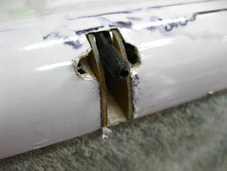

                        Uh-oh.....
                        Click image for larger version  Name:	IMG_5981.JPG Views:	0 Size:	96.2 KB ID:	45291 Click image for larger version  Name:	IMG_5984.JPG Views:	0 Size:	116.4 KB ID:	45292

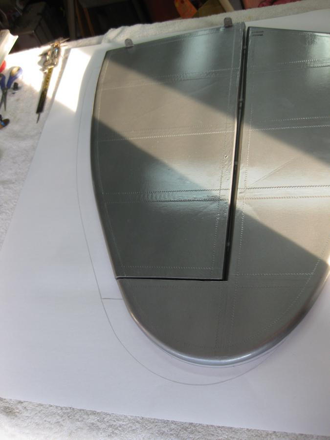

                        1/2 oz fiberglass
                        Click image for larger version  Name:	IMG_5986.JPG Views:	0 Size:	132.2 KB ID:	45293 Click image for larger version

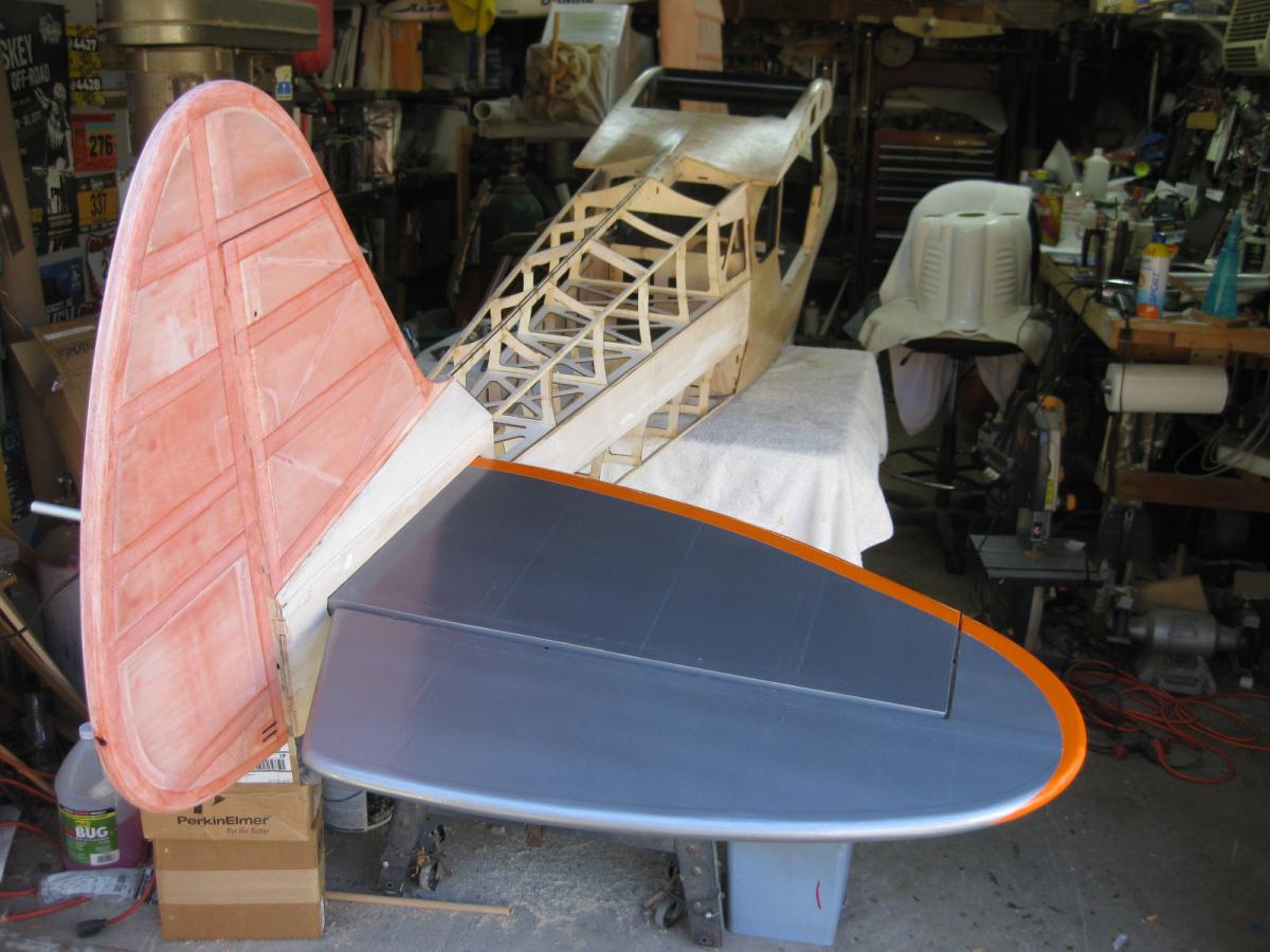

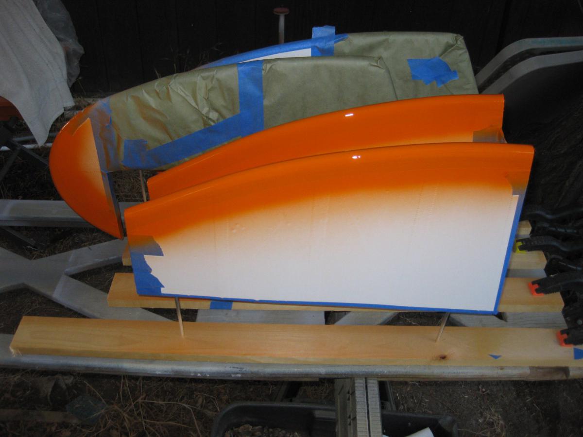

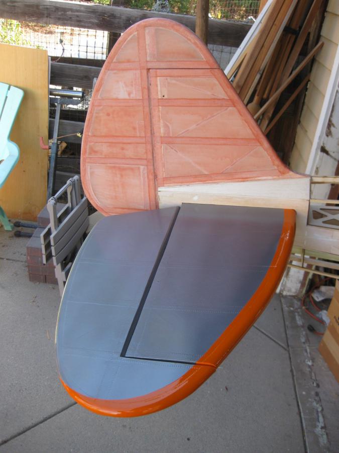

                          Orange leading edge stripes for the tail feathers.
                          Made some patters on poster size card stock and then transferred to paint mask.
                          First step was to paint the silver surfaces white and then orange - using PPG Omni LV - Omaha Orange ( 60156 - FORD ).
                          Click image for larger version  Name:	IMG_5998.JPG Views:	0 Size:	45.9 KB ID:	45346 Click image for larger version  Name:	IMG_6001.JPG Views:	0 Size:	86.2 KB ID:	45347 Click image for larger version  Name:	IMG_6003.JPG Views:	0 Size:	84.8 KB ID:	45348
                          I think I like it.....

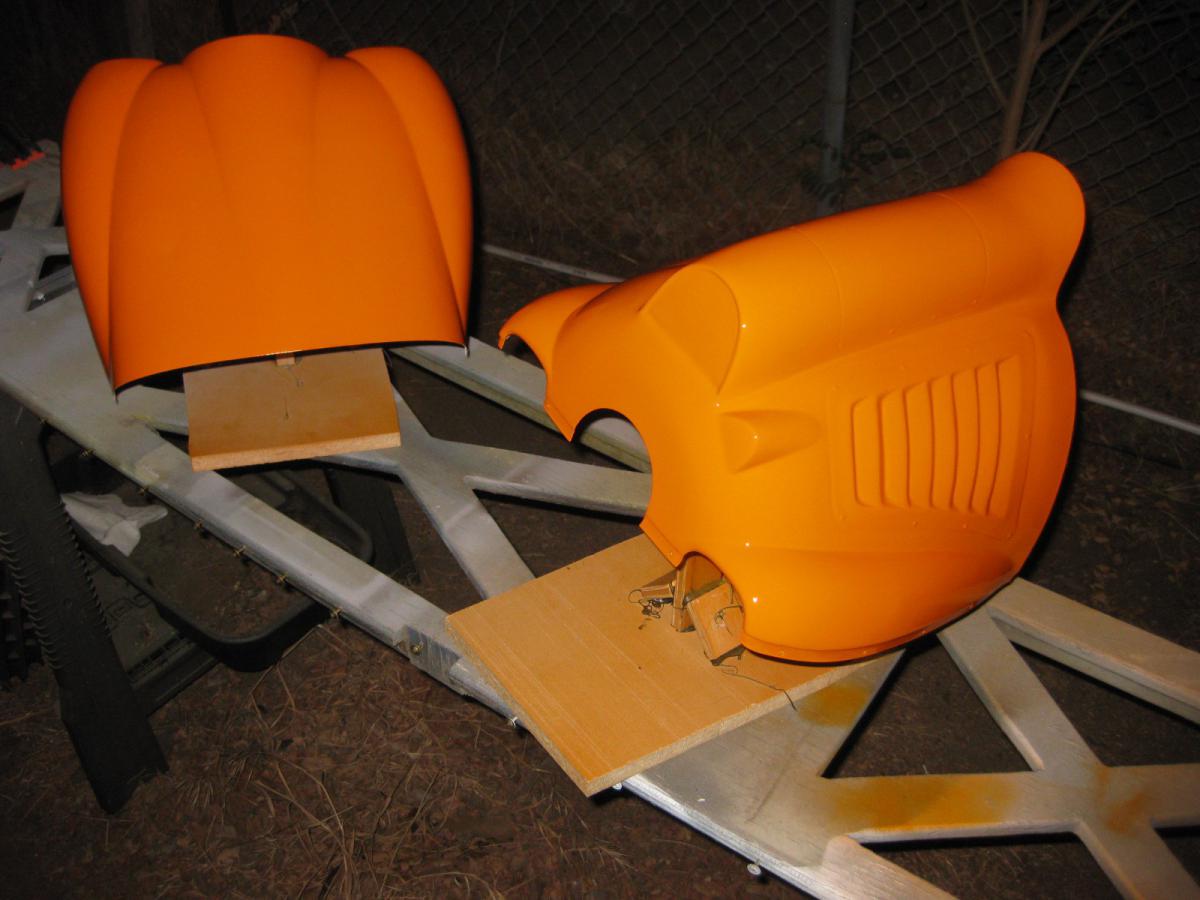

                            It's the Great Pumpkin...Charlie Brown
                            Click image for larger version  Name:	IMG_6010.JPG Views:	0 Size:	95.7 KB ID:	45378

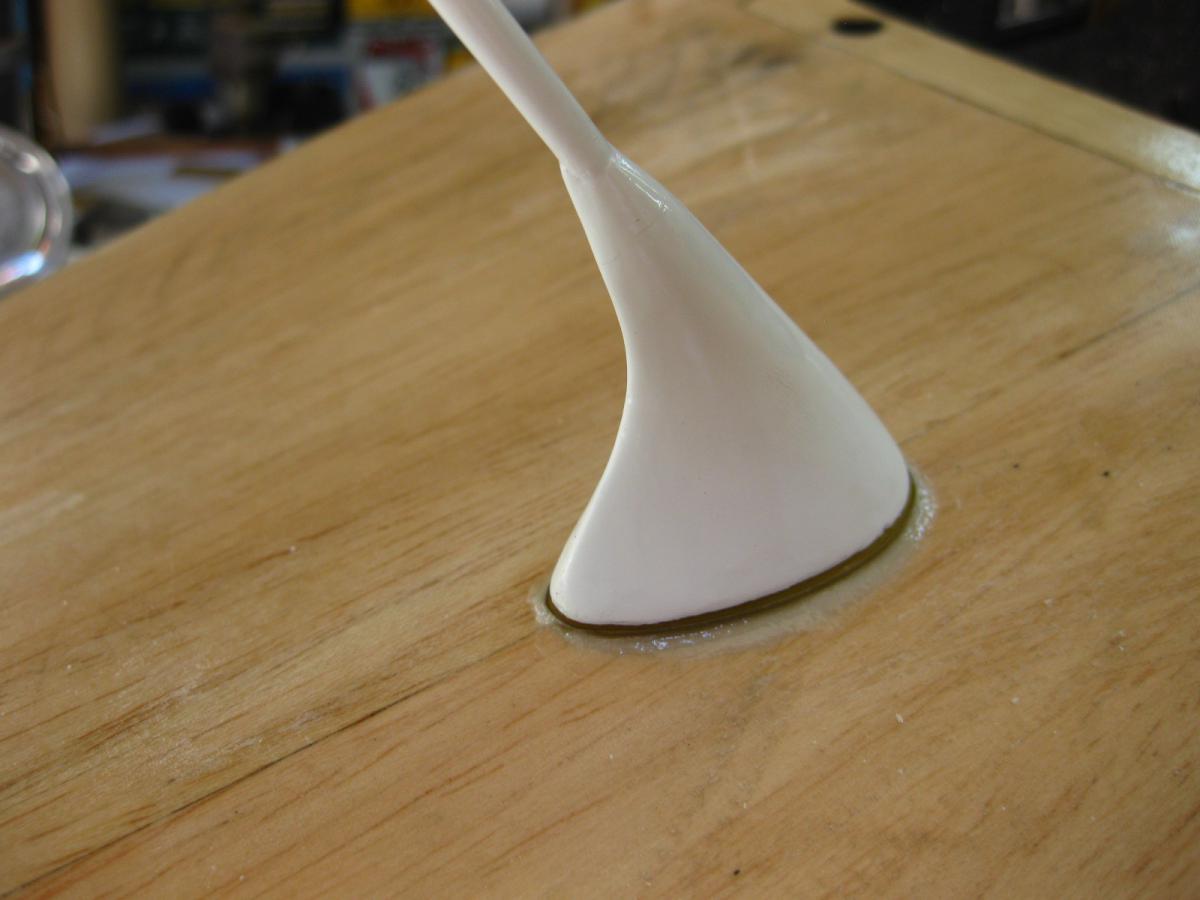

                            some sundry items:

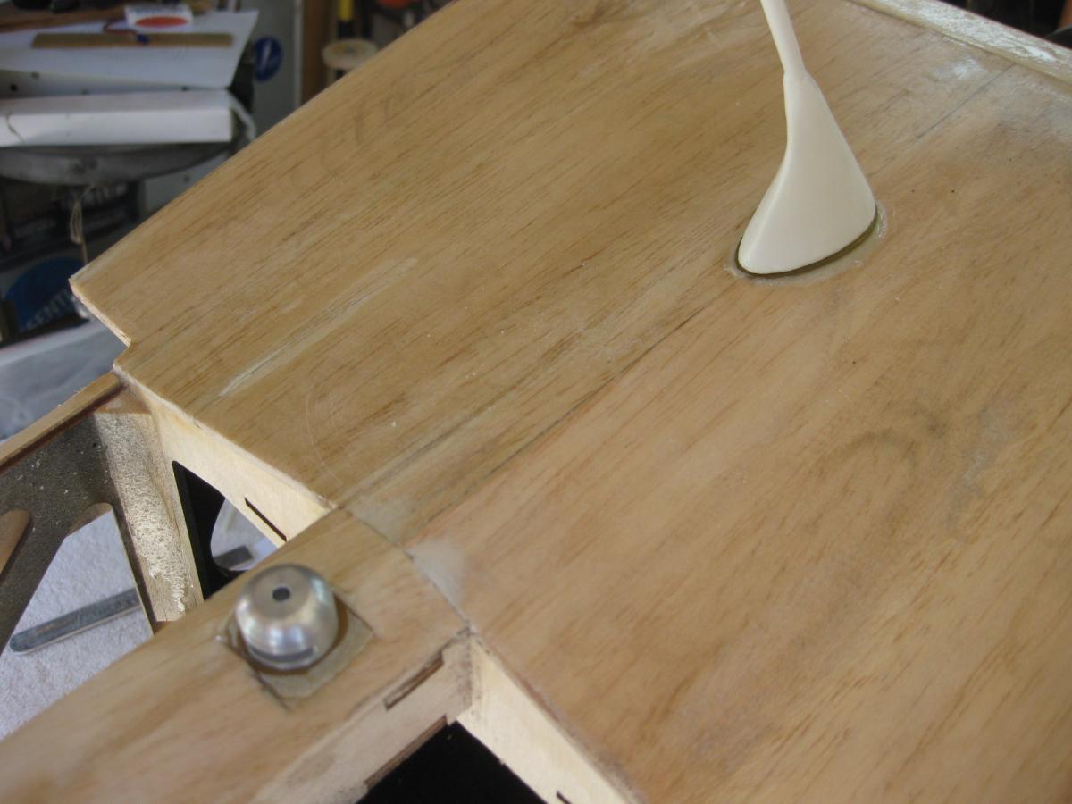

                            moved the VHF antenna over to the center and added a base.
                            Tow Release got a G10 - 0.040 base too.
                            Click image for larger version  Name:	IMG_6012.JPG Views:	0 Size:	88.4 KB ID:	45391 Click image for larger version  Name:	IMG_6015.JPG Views:	0 Size:	70.8 KB ID:	45392 Click image for larger version  Name:	IMG_6014.JPG Views:	0 Size:	94.5 KB ID:	45393 Click image for larger version

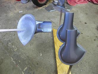

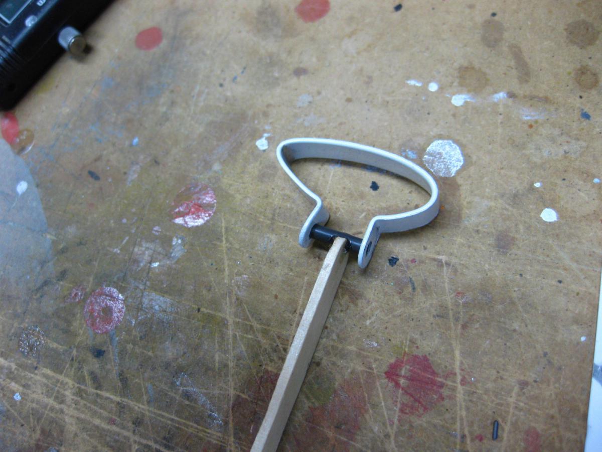

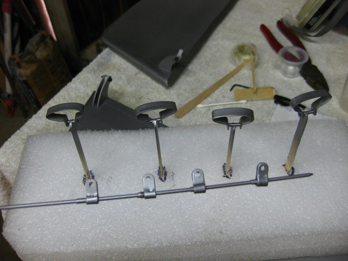

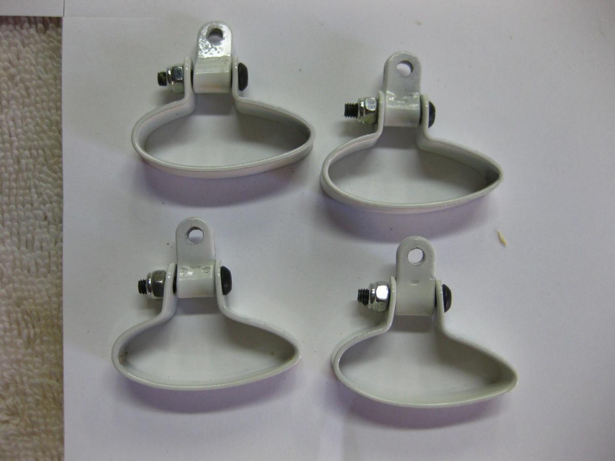

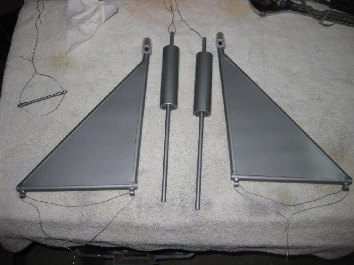

                              Wing Strut Jury Strut attachment band ........how to hold it for painting?........carbon tube and popsicle sticks
                              Click image for larger version  Name:	IMG_6020.JPG Views:	0 Size:	67.4 KB ID:	45426 Click image for larger version  Name:	IMG_6021.JPG Views:	0 Size:	122.0 KB ID:	45428 Click image for larger version  Name:	IMG_6025.JPG Views:	0 Size:	102.5 KB ID:	45427
