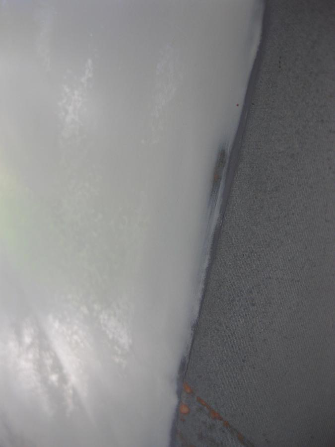

    Spending some time blending the fabric attachment at the rear of the cockpit area with rattle can automotive primer.
    New California Primer takes 24 hours of dry before sanding ......
    overly enthusiastic blending.....oops

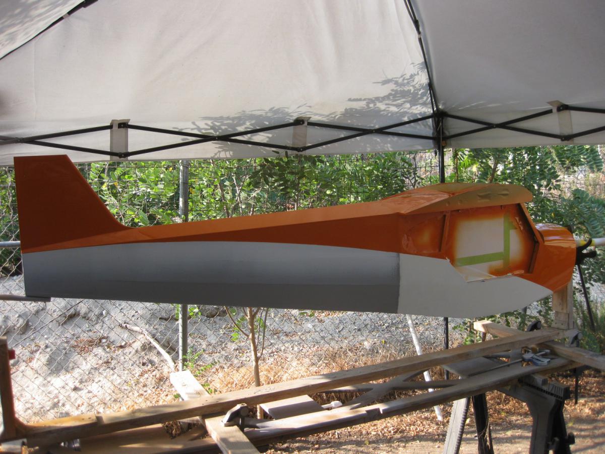

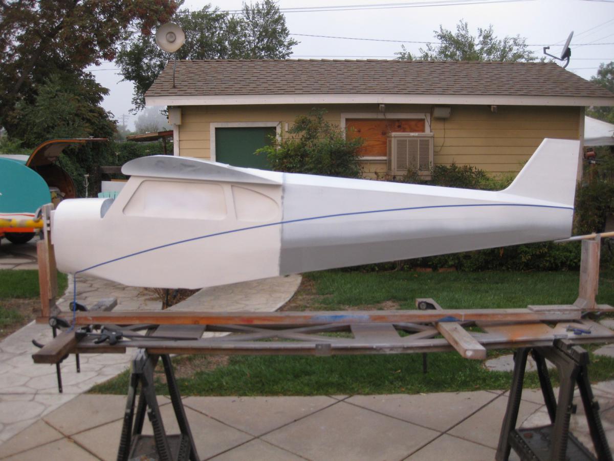

      got the PPG Omni MP801 surfacer down on the front, now just some feathering on the rear and then masking.
      Click image for larger version  Name:	IMG_6143.JPG Views:	0 Size:	151.0 KB ID:	45998
      Feathering the overlap of hard surface and fabric attachment

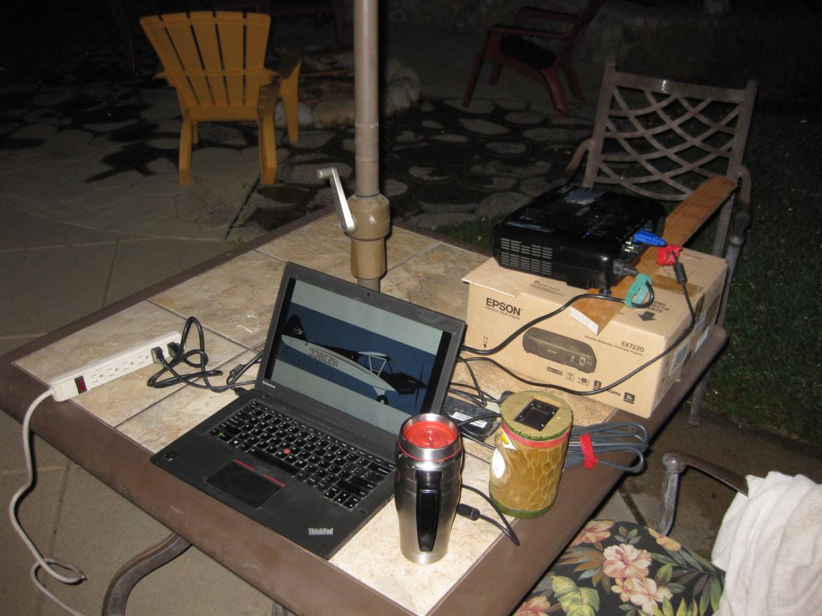

          Mean while back at the Ranch...... projecting the image i want.....
          Click image for larger version  Name:	IMG_6165.JPG Views:	0 Size:	65.1 KB ID:	46001 Click image for larger version  Name:	IMG_6168.JPG Views:	0 Size:	126.9 KB ID:	46002
          the Setup with all important coffee and Epson projector.

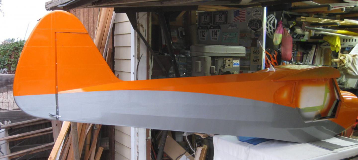

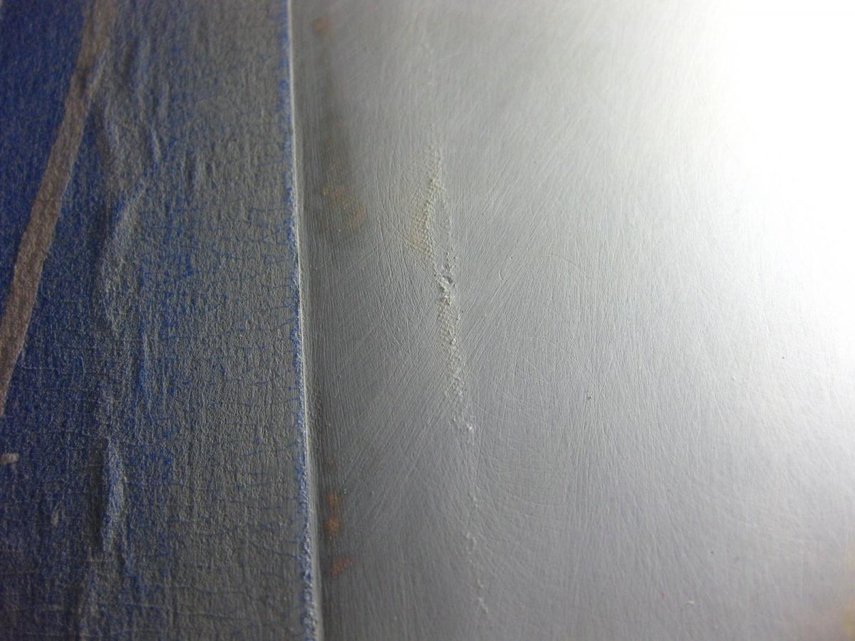

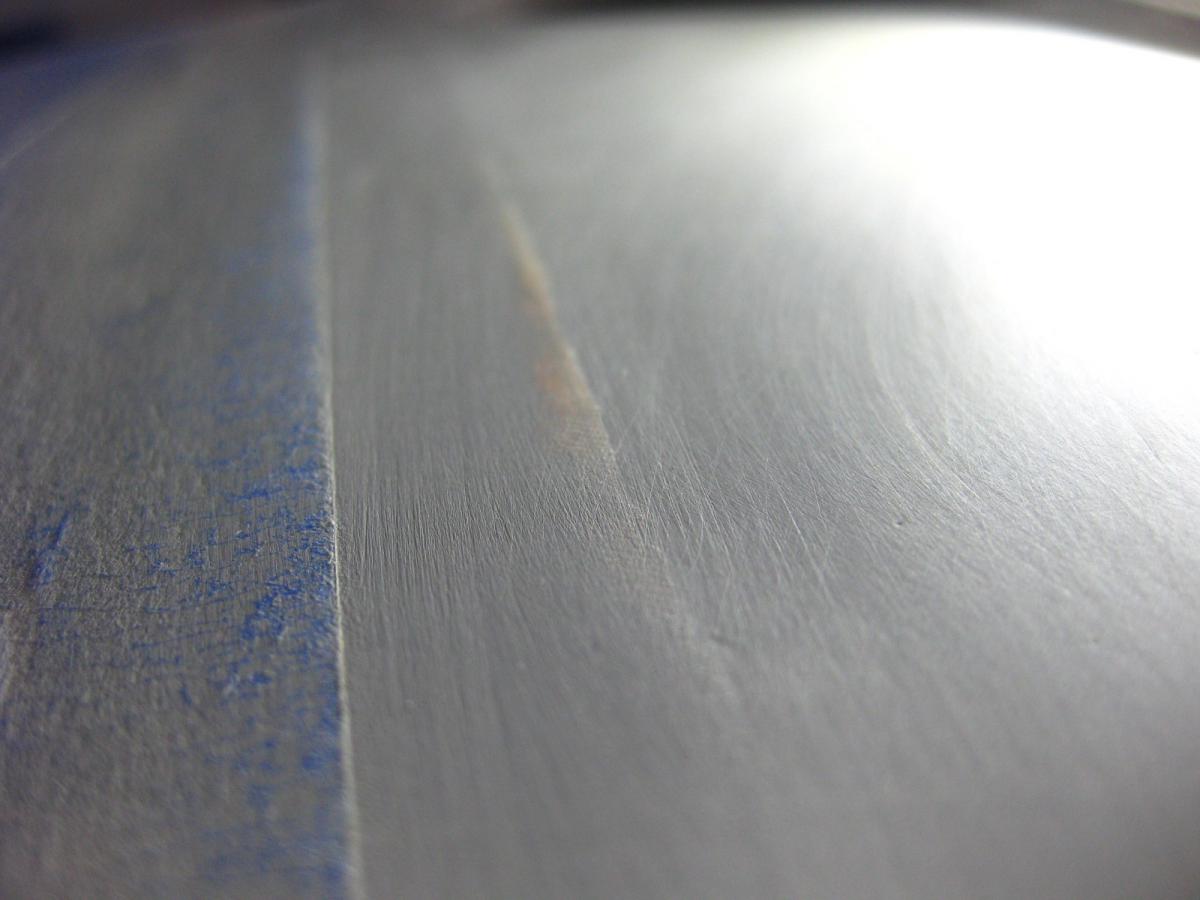

            Silver has got to be one of the more challenging colors to put down.....really makes you work on your spray technique.
            Click image for larger version  Name:	Silver overlap.jpg Views:	0 Size:	214.2 KB ID:	46016
            When is first goes on it a little disconcerting .....but looks kinda cool.
            Click image for larger version  Name:	IMG_6184.JPG Views:	0 Size:	99.2 KB ID:	46015

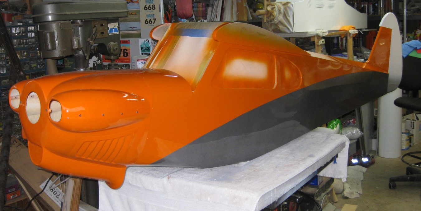

              Shinny
              Click image for larger version  Name:	IMG_6190.JPG Views:	0 Size:	127.4 KB ID:	46021 Click image for larger version  Name:	IMG_6192.JPG Views:	0 Size:	144.3 KB ID:	46022

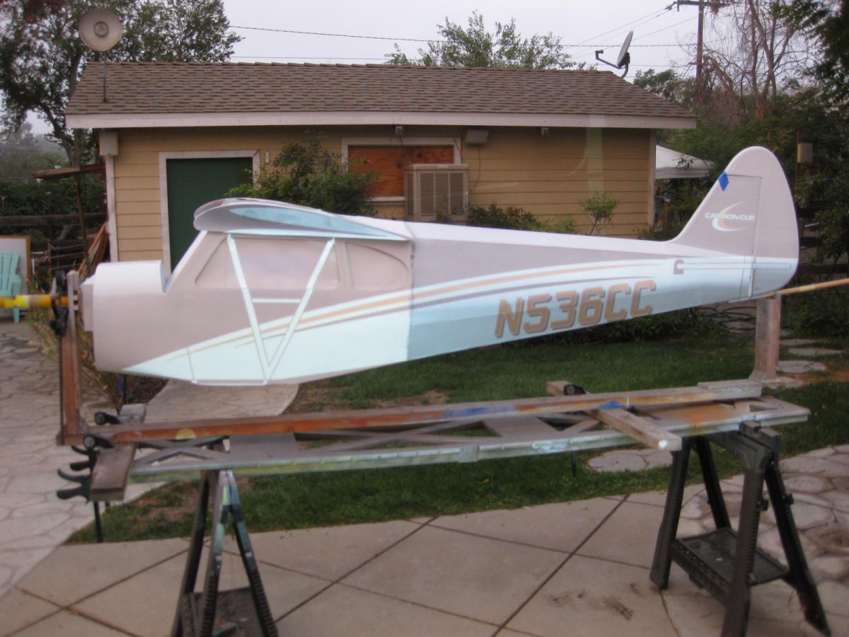

                Rudder painted.....

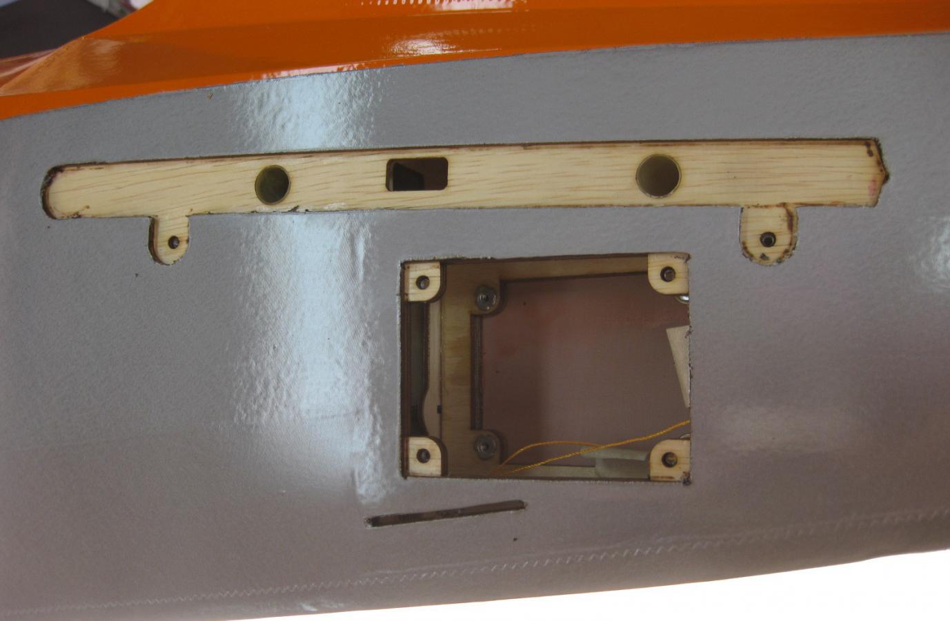

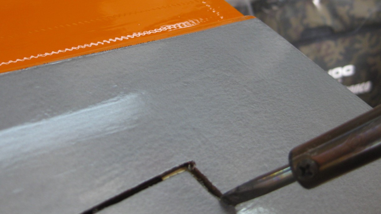

                  60 watt soldering iron and a modicum of courage for "cutting out" the elevator servo and stab attach areas.
                  Click image for larger version  Name:	IMG_6198-1.jpg Views:	0 Size:	110.1 KB ID:	46117 Click image for larger version  Name:	IMG_6200-1.jpg Views:	0 Size:	93.3 KB ID:	46118
                  Marking out the cockpit door.............................................. ............. Starting to shape up nicely
                  Click image for larger version  Name:	IMG_6208.JPG Views:	0 Size:	85.2 KB ID:	46116 Click image for larger version  Name:	IMG_6203-1.jpg Views:	0 Size:	272.6 KB ID:	46119

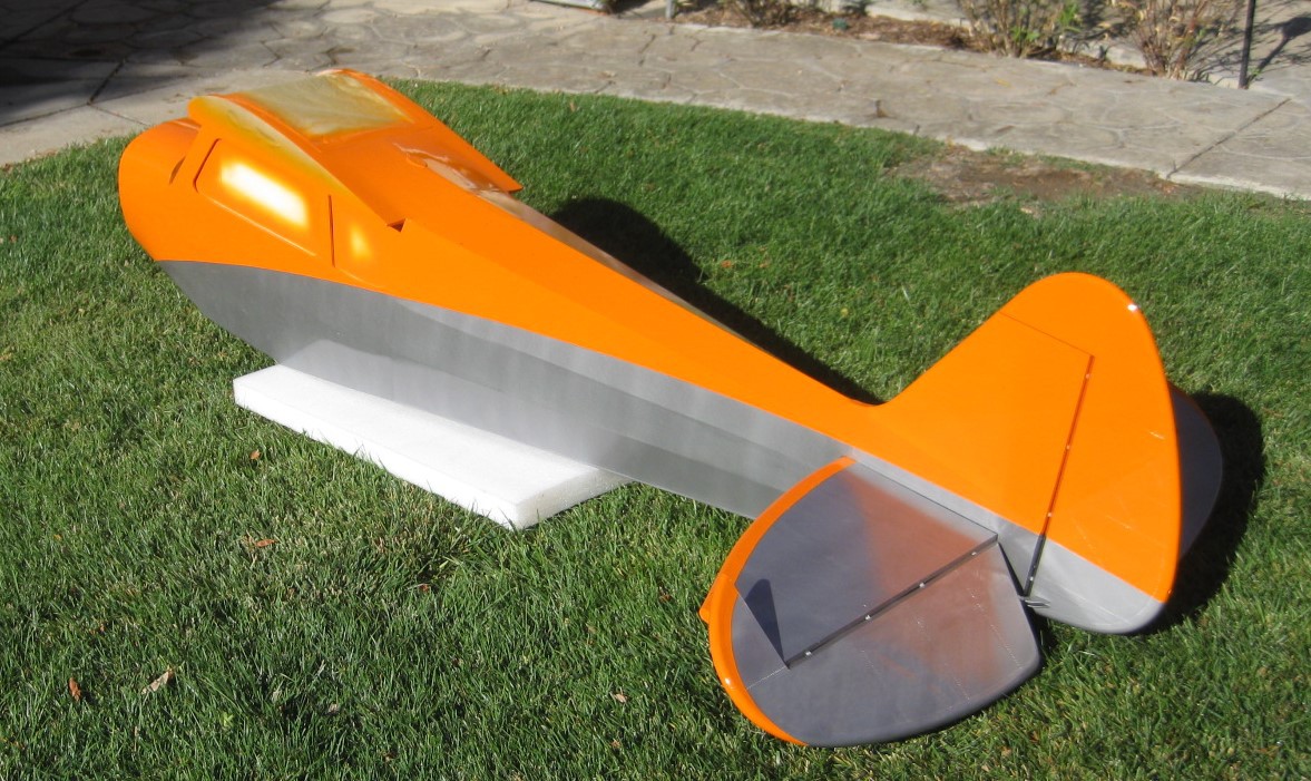

                  • #39

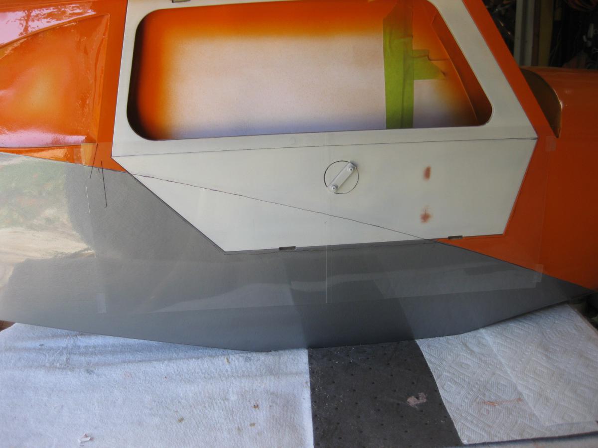

                    Bringing the silver on the wings farther in on the fuselage.
                    Click image for larger version  Name:	CubCrafters-FX-3-18-1.jpg Views:	0 Size:	87.3 KB ID:	46135 Click image for larger version  Name:	IMG_6210.JPG Views:	0 Size:	50.2 KB ID:	46133
                    door lines up nicely.
                    Click image for larger version  Name:	IMG_6211.JPG Views:	0 Size:	111.5 KB ID:	46132

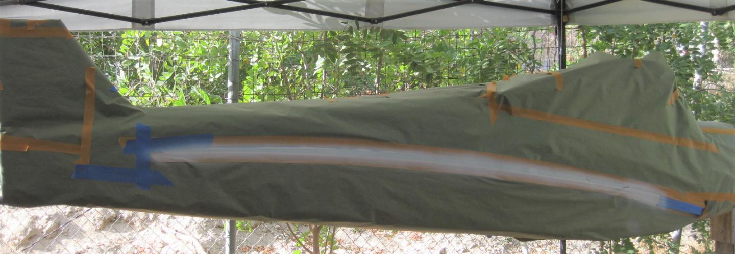

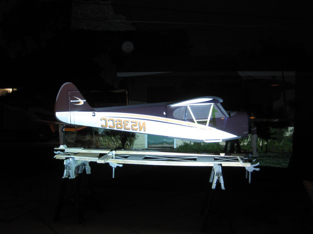

                        More projector time and quality vinyl tape........resulting in ....a black stripe
                        now its just waiting for paint to dry.....

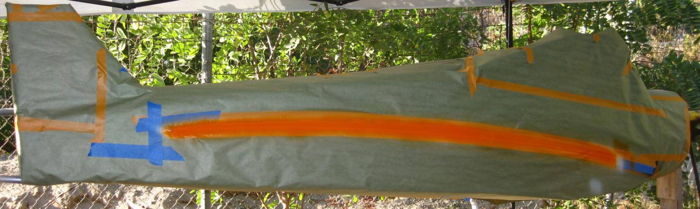

                          Masking paper has been changed
                          White changes to Orange...
                          And now back to the Regularly Scheduled Program of....." Waiting for paint to dry"........

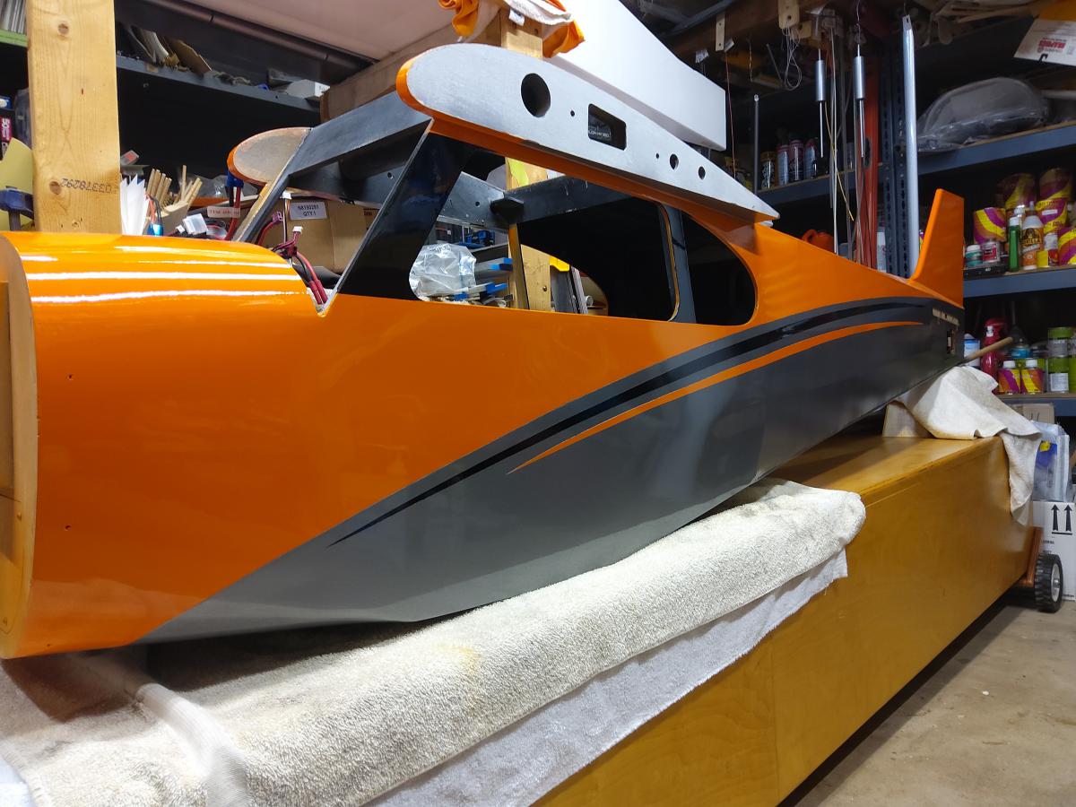

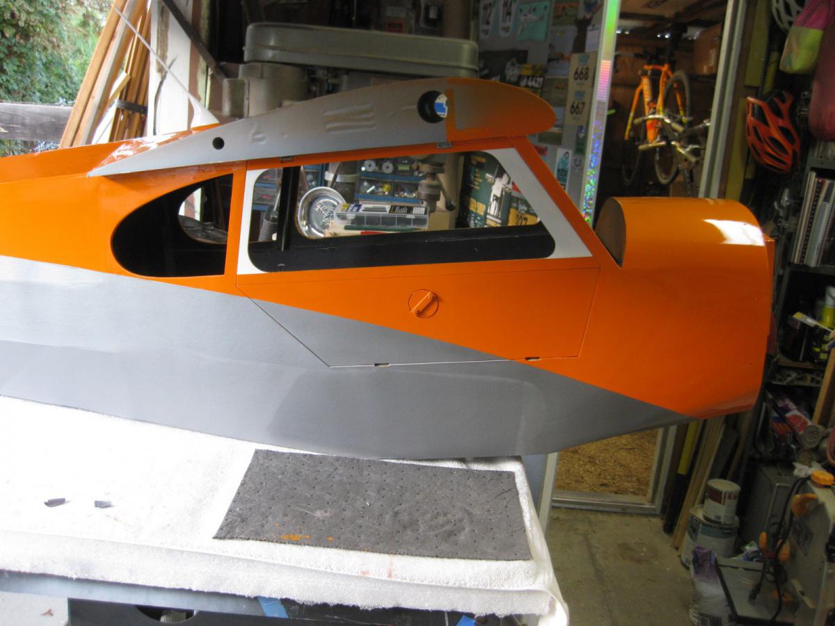

                            Happy with the results
                            Opted for the black cabin frames to simulate one big window.

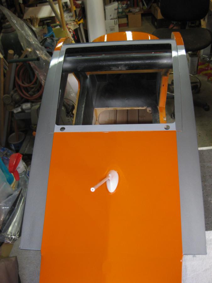

                            • #44
                              Fitting the front windshield and decided to upsize the Cabin support tubes to 8mm from the 5mm rods that were provided in the kit - checked my full size Citabra and it has 0.750" tubing ....so 40% would be 0.300" and 8mm is 0.318" .......plus the tubes are roll wrapped so you can see the Fabric , instead of the the Pultruded version.
                              Of course, masking off the instrument panel area for a coat of Flat Black.
                              Click image for larger version  Name:	IMG_6229.JPG Views:	0 Size:	77.5 KB ID:	46199
