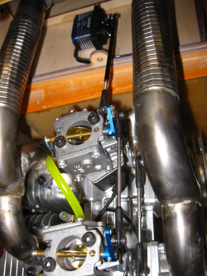

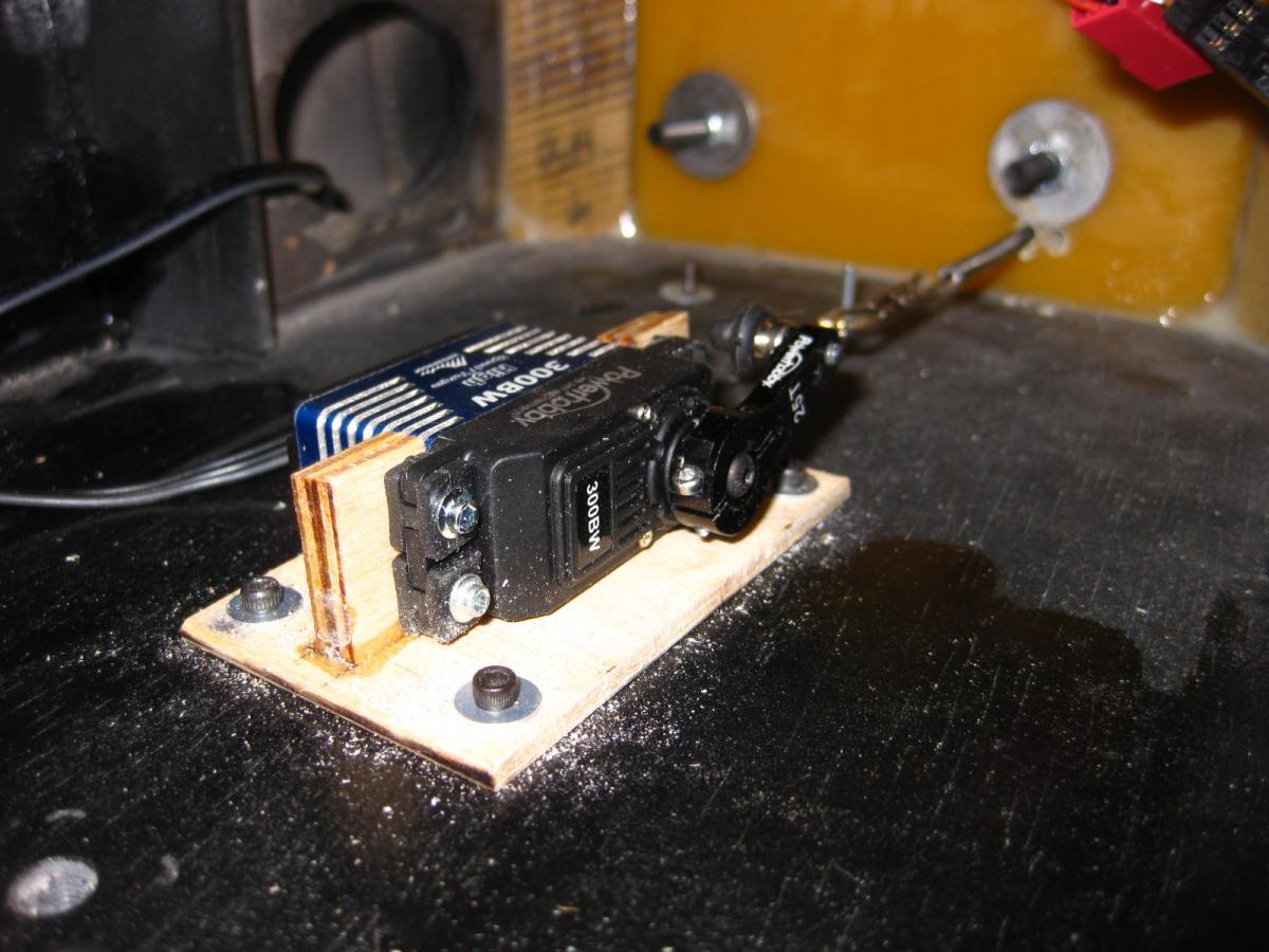

    Working on the Servo actuated choke on the DLE-222
    Installed two throttle body arms and linked them together.

      be careful with choke on both carbs it will flood fast. i had a 3 cyl inline rotomotor 170cc it had choke only on firewall cyl in use and started very well.
      • #63
        Thanks, I'll keep a watch for that.

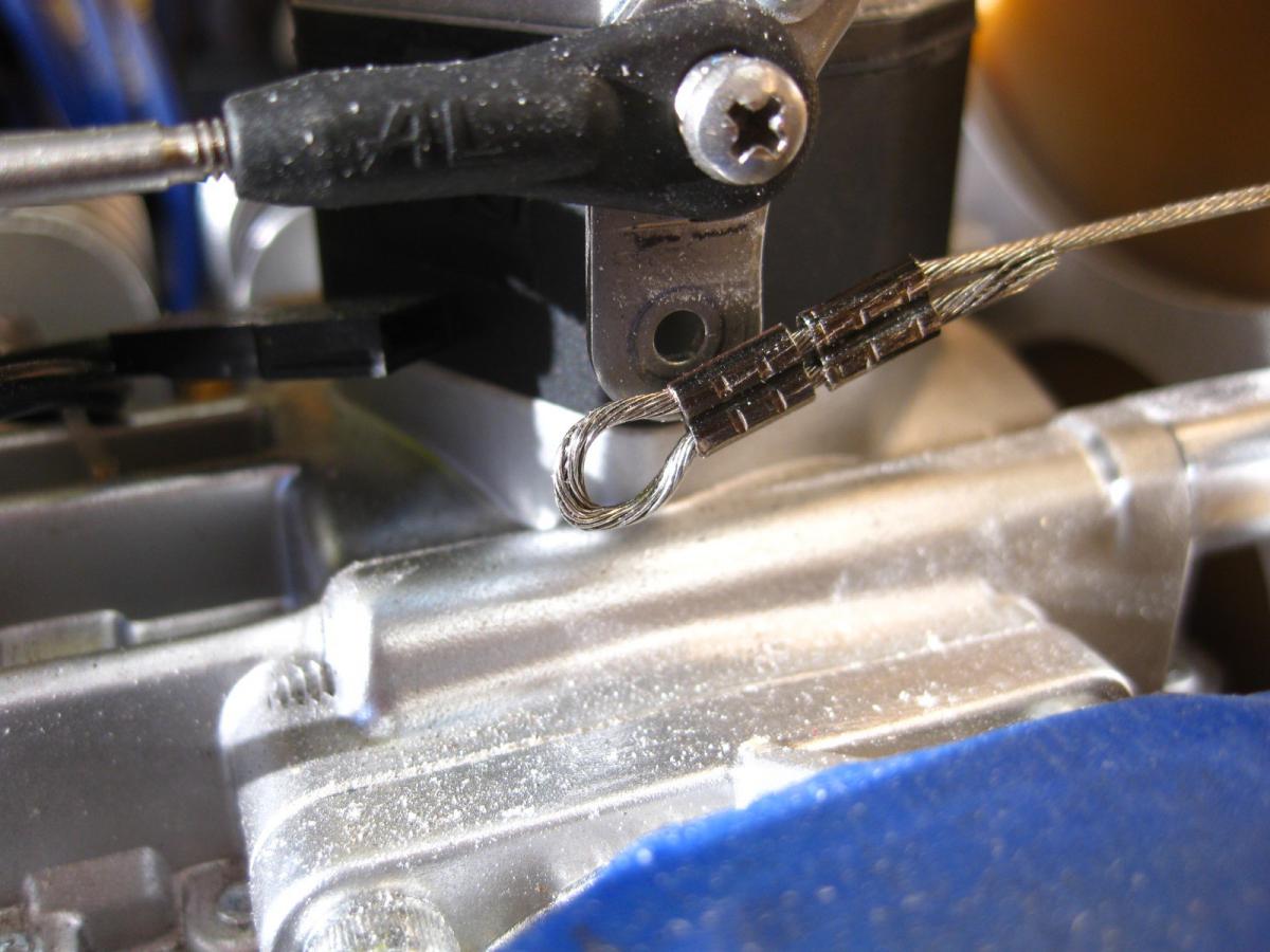

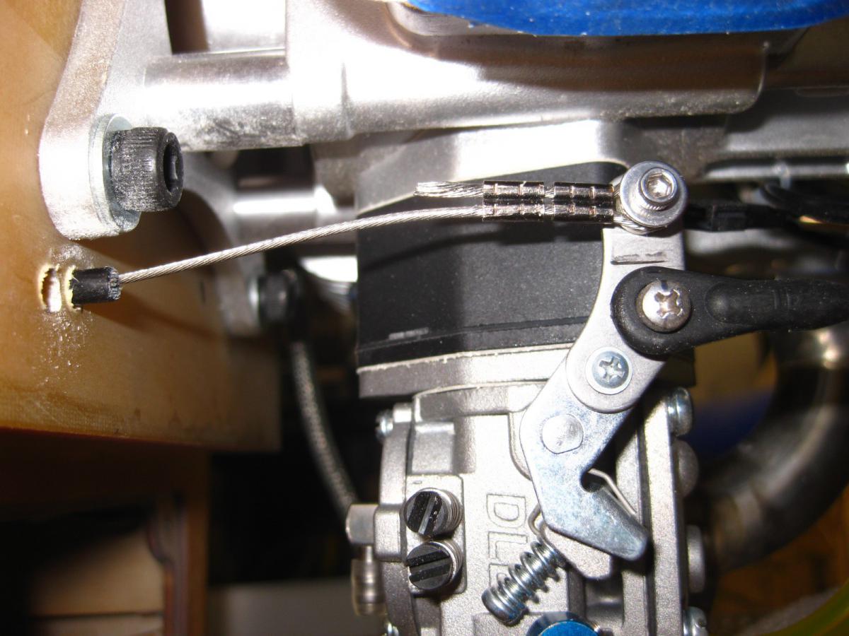

        Was checking reports from the Aerobatic users of the DLE-222 , they're indicating that it doesn't start very good using a one choke method.
        Throttle linkage fun.....saw someone was using a cable system on the Carburetors as both have return springs ......so

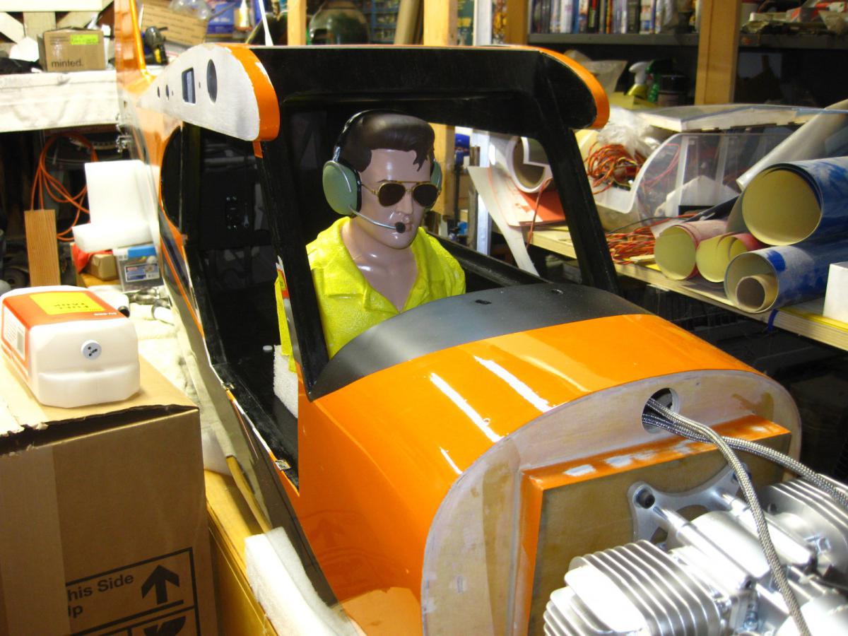

          Elvis is in the House........Litepilots.com 50% "George" ProSeries Aerobatic Pilot.

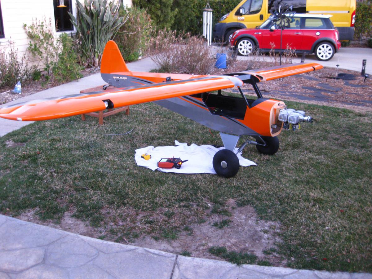

              Playing with the fuselage wiring harness now that I received my Spektrum powersafe 12 channel receiver , inevitably right wing was plugged into the left wing receiver ports and aileron and flap were reversed too, pretty much expected it as I was hooking stuff up in the inverted position.
              I like my hub caps.........PMT 262 wheels are cool too.
              I thought the DLE-222 was big when I pulled it out of the box........now it look pretty scale size.
              Click image for larger version  Name:	IMG_6328.jpg Views:	0 Size:	198.1 KB ID:	46963

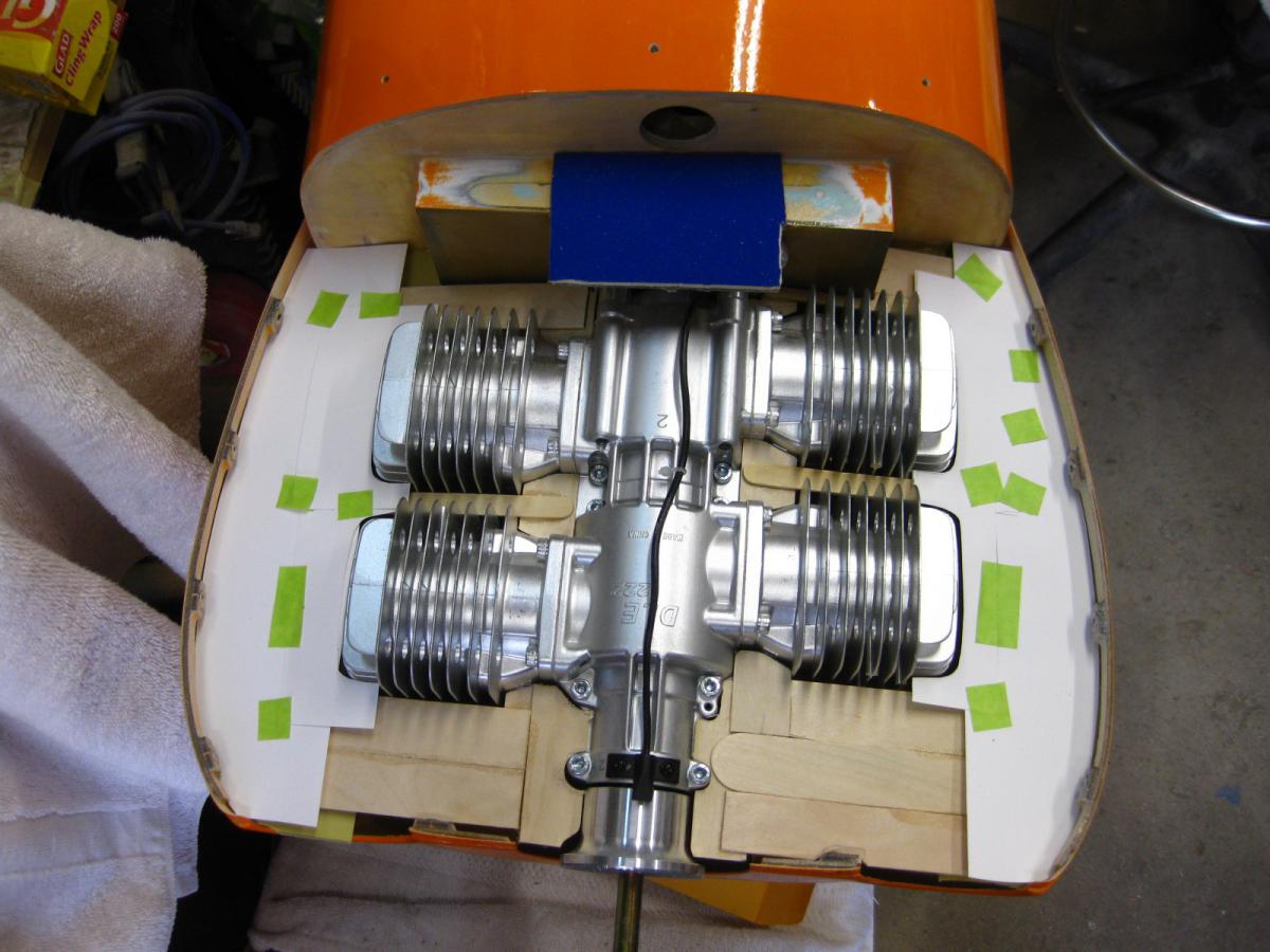

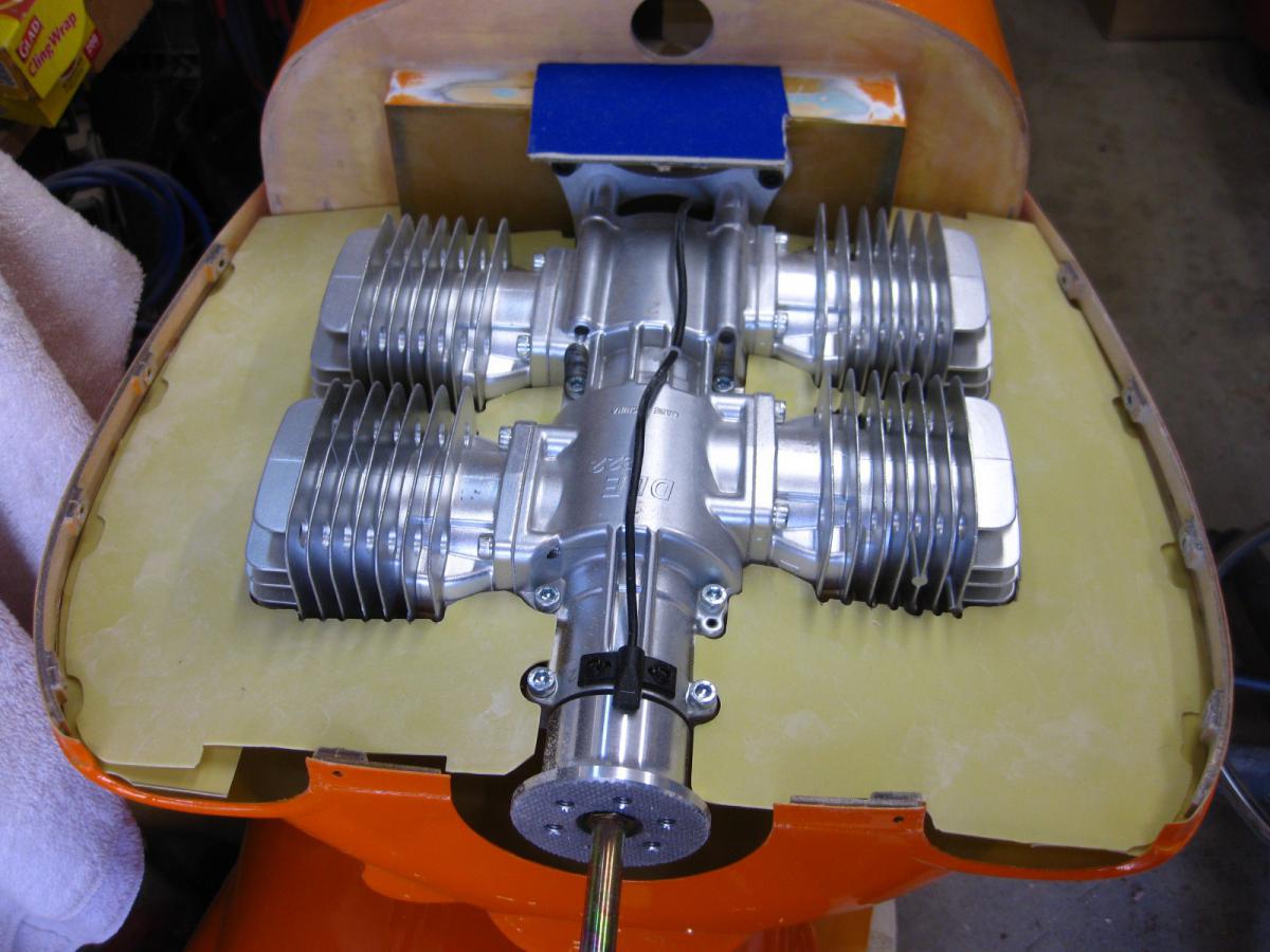

                Working on the fiirewall forward section - baffling patterns.....popsicle sticks and card stock seem to be the material of choice for me.
                Click image for larger version  Name:	IMG_6343.jpg Views:	0 Size:	120.7 KB ID:	47050

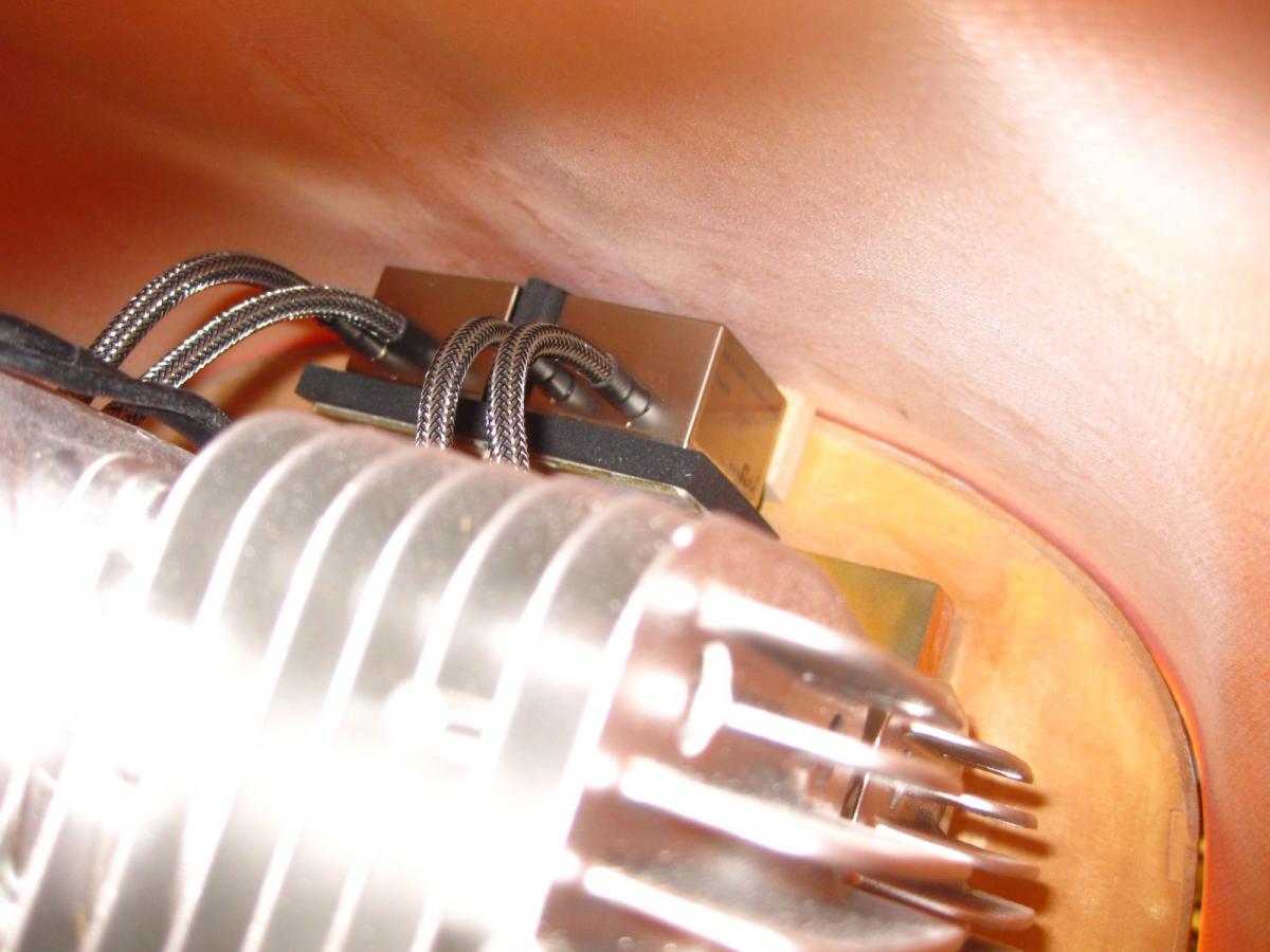

                checking to see if the ignition modules have enough clearance....
                Click image for larger versionName:	image_18829.jpgViews:	3Size:	91.3 KBID:	47051
                0.040 G10

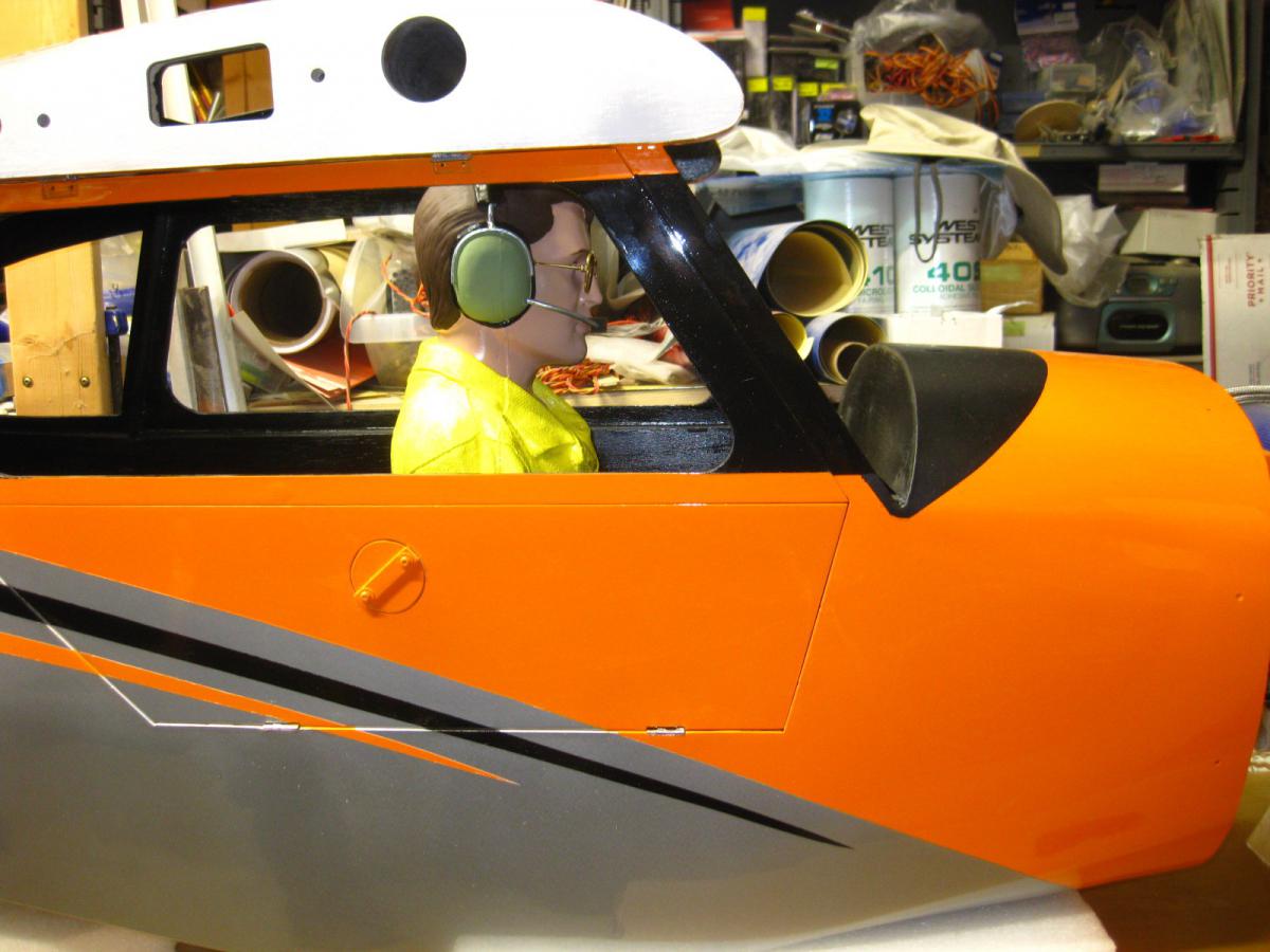

                • #68
                  Passable

                  • #69
                    Passable? that looks Awesome!!
                    • #70
                      Thanks Steve,
                      It does look really cool.....although there are some "issues" only the builder would grouse about...

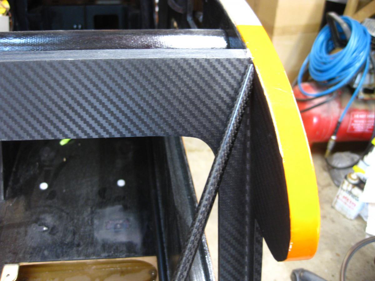

                      Meanwhile......I really liked what Kevin did with the floorboards on his C-185 ......soooo........
                      Click image for larger version  Name:	IMG_6353.jpg Views:	0 Size:	114.4 KB ID:	47217

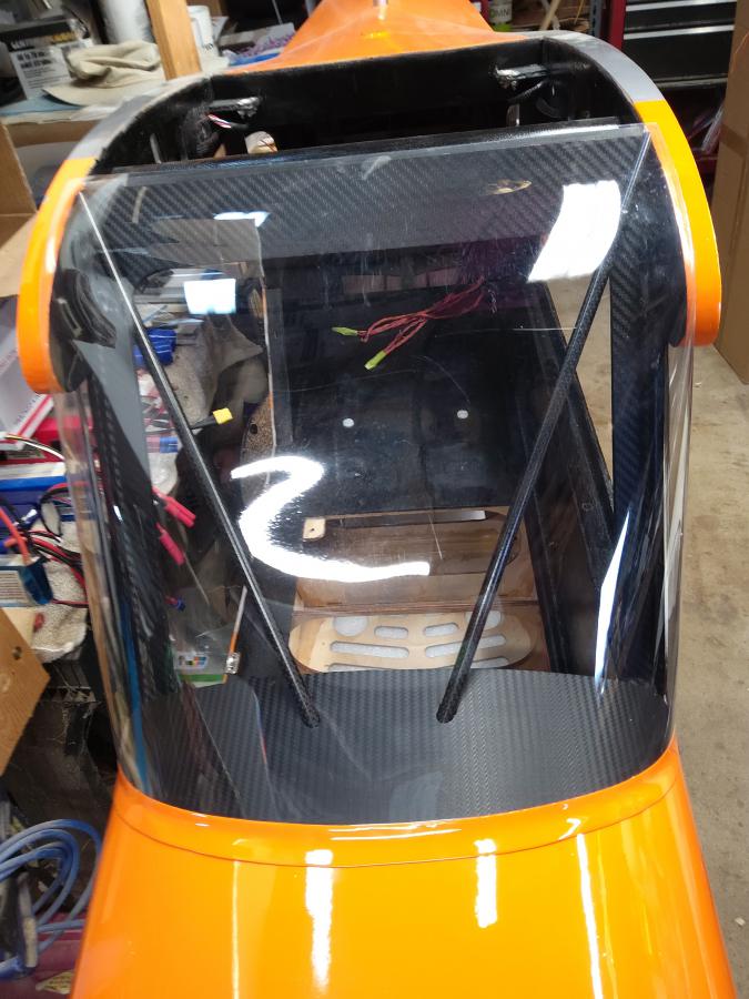

                        Instrument panel cover too

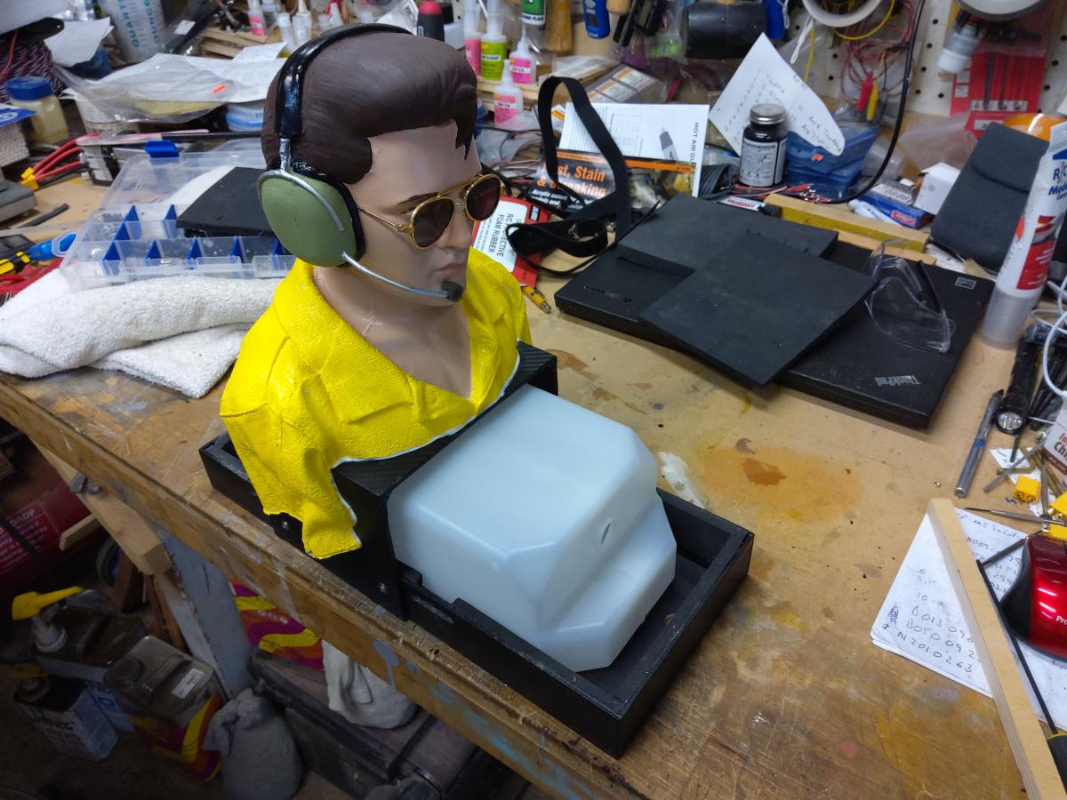

                              Elvis is ....all tanked up

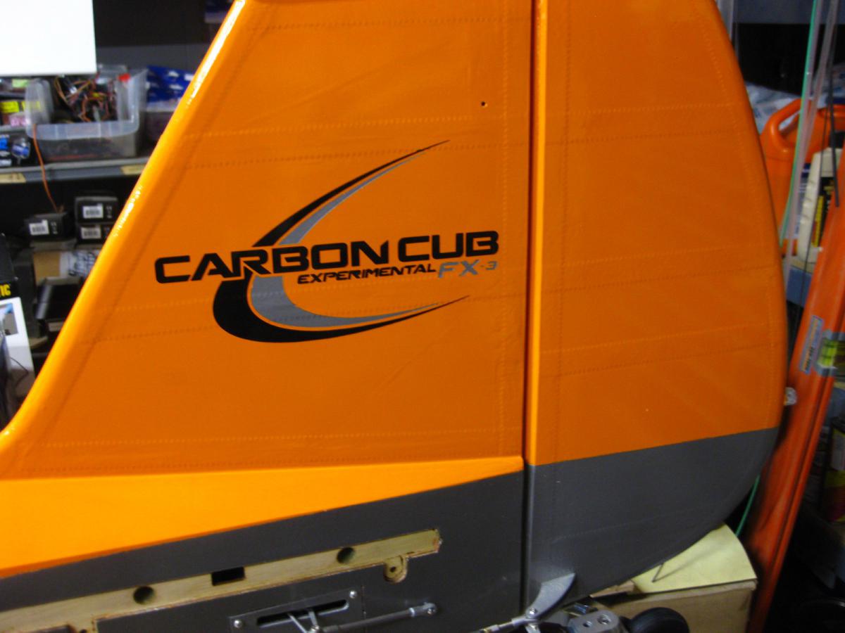

                                Wing / tail bags are coming along swimmingly. I really like it that REVOC send you pictures of your project
