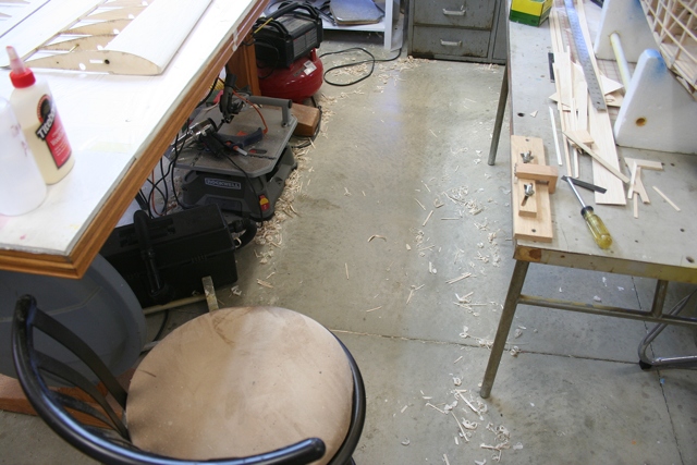

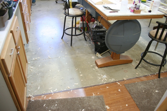

      First I thought I had better clean up a little. The wood chips have been flying.

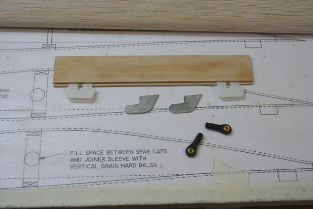

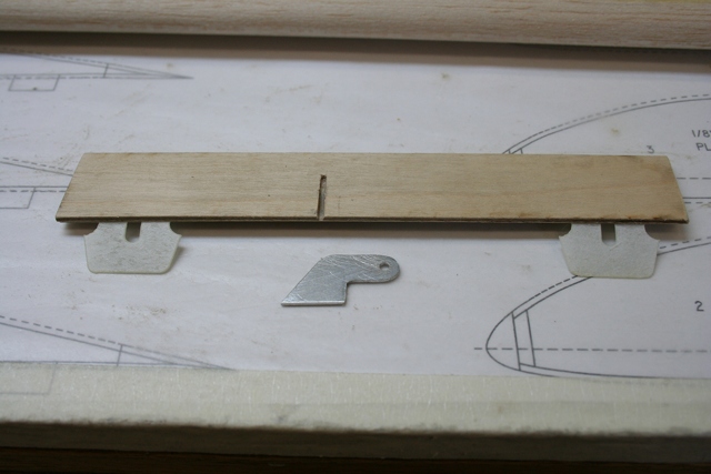

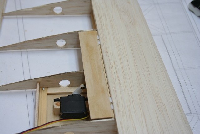

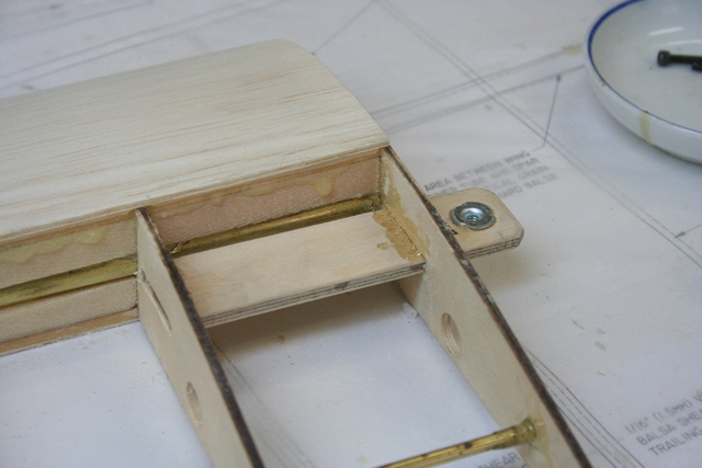

      The spoilers are made from 2 pieces of 1/16" ply laminated together. I sandwiched 2 CA hinges in between. The control horns are cut from some scrap aluminum and I dug up a couple of ball joint rod ends for connectors.
      I cut a slot almost through one layer of ply for the control horn and then epoxied them in.

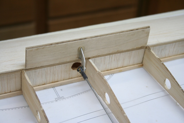

        I cut a slot for the hinges between the top sheeting and the spar cap with an X-ACTO knife.

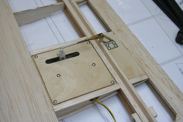

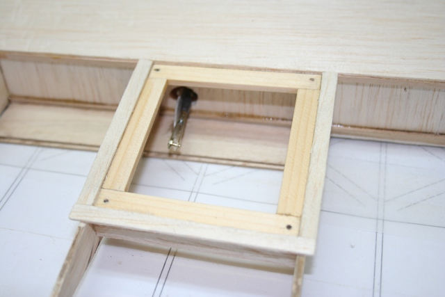

        Framed in the typical servo cover.
        And one servo is mounted. One more servo and I'll be done with the spoilers. I used Hitec HS 81 servos here.

        Here you can see the hinges. The plywood pieces are offset about 1/16" to allow the spoiler to raise 90 degrees.

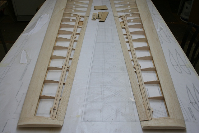

        • Update time:

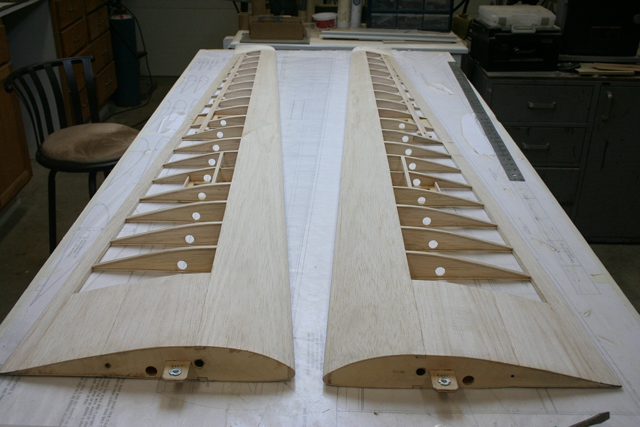

          I've been working on the Cherokee every spare minute. The wings are ready for filling and final sanding.

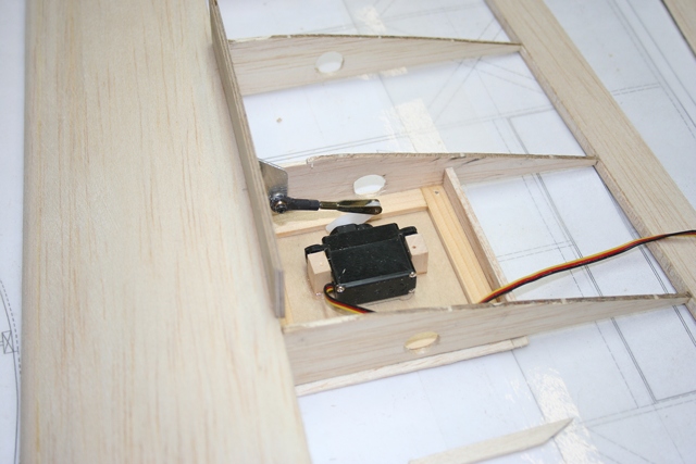

          Both aileron servos are done. Nothing new or interesting here. I used Hitec HS 225 BB servos for the ailerons.

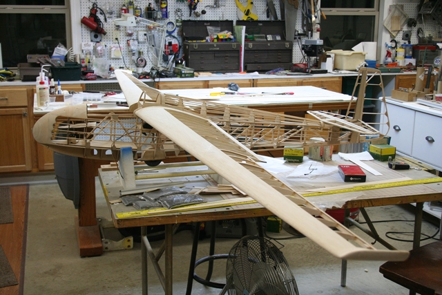

          The wings were put on the fuselage for the first time to fit the root ribs and glue in the retention tabs.

          Ready for filling and final sanding.

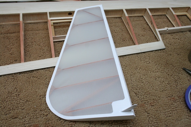

          • Ok a quick update. I glassed the wing tips and rear 1/4 of the center section shoulders and all the filling and sanding is done. I'm covering now and I won't post any more photos until she's done but here is a teaser. I think I got the look right.
            Full scale rudder.
            My rudder.

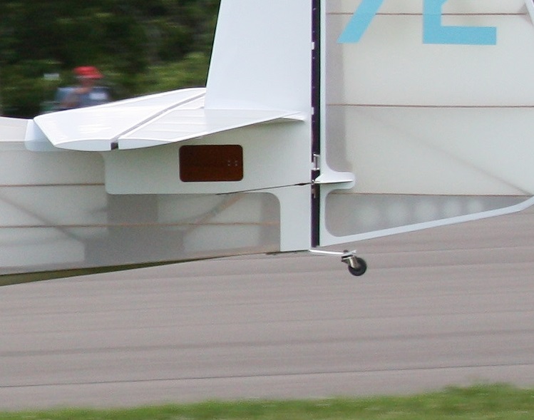

            • I know I said I wasn't going to post more photos but I kinda need to. This is a shout out to Swiss1 (Jeremy). Dean's plane has a spring mounted swivel type tail wheel. The closest I could come to it with what I had is in the following photos. I was wondering if you might have something a little more to scale, say 1/2" or smaller. I think this one is going to look ridiculously big. I've searched on the web and everything is for power planes and too big.

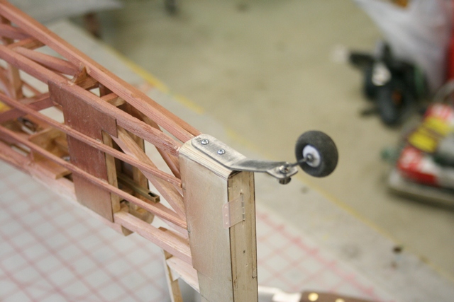

              Full scale.
              This one is 7/8" diameter. Needs to be 1/2" or smaller.
              • Sullivan makes nice small tail wheels. They are commonly used at the wing tips on the bigger gliders.
                It looks like you should be able to fit them to the bracket you have. Great build and thanks for sharing.
                Scot
                • Sullivan
                  Tailwheels
                  These solid rubber tailwheels feature one-piece lightweight machined aluminum hubs. The hubs can be drilled out as needed.
                  Number Size Axle Size Weight
                  S350 1/2" x 3/16" 12,7 mm x 4,8 mm 1/32" (.032")/,75 mm 0.04 Oz/1,0 g
                  • Sorry I was out of town, and just saw your PM.
                    1/2" Sullivan is the smallest with Aluminium Hub, $1.66
                    Another manufacturer is Ohio Superstar www.ohio-superstar.com
                    You can call me at The Model Box 205 978 8787
                    • Hey guys, thanks for your replies. I was hoping to find a complete assembly with a 1/2" wheel and that Jeremy might be able to bring it to Huntsville. The smallest Ohio-Superstar might work but I think I'll go with what I have and put a 1/2" Sullivan wheel on it. At least I have something that will work. Thanks again!!!
