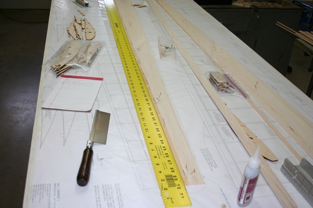

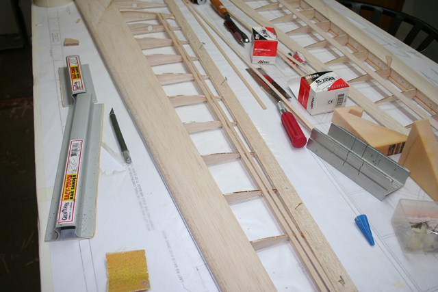

    Gluing the bottom spar cap to the sheeting. I used a straight edge to lay out the spar cap so the ribs will be nice and straight. Click image for larger version

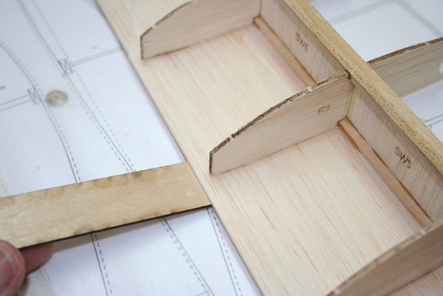

    I used scraps of Divinycell foam to fill in above and below the wing rod sleeve. Click image for larger version

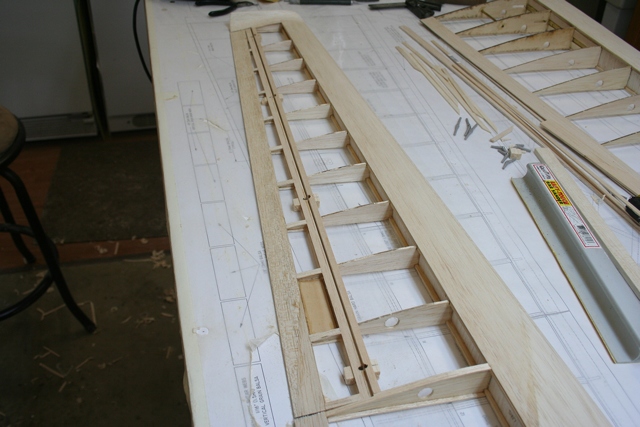

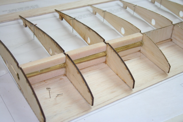

    • Update continued:
      Shear webs are all glued in. Click image for larger version
      The top spar cap being glued on. I know you guys like the shell boxes so here you go. Click image for larger version
      Continuing with right wing panel. Click image for larger version
      That's it for now. Back to the shop.

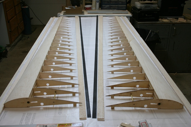

      • Update time:

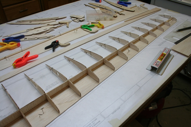

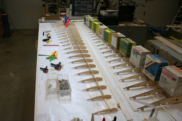

        I have made more progress on the wings. I'm building both panels at once to save time. So far it's working quite well, there are natural stopping points that make it efficient to bounce back and forth between right and left. You also avoid the dread of repeating it all over again after you finish one wing.
        Due to the under-camber I found it necessary to use small wedges to raise the bottom sheeting and spar cap to the ribs for gluing.

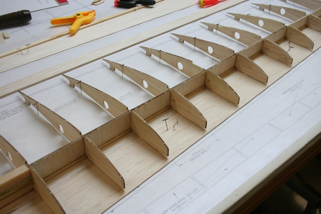

        The right wing ribs and shear webs are in.

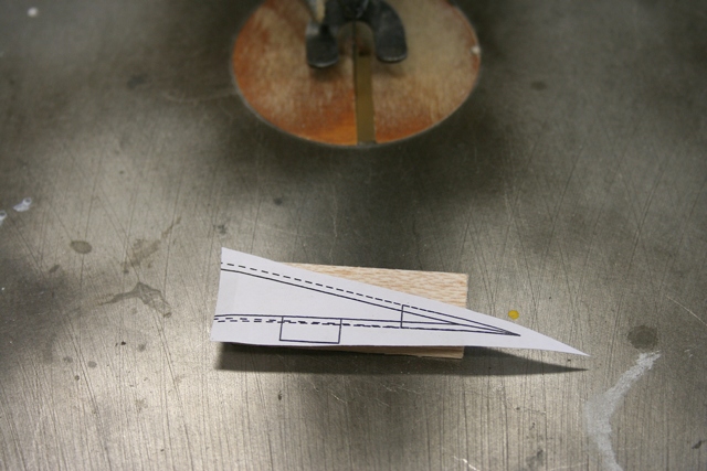

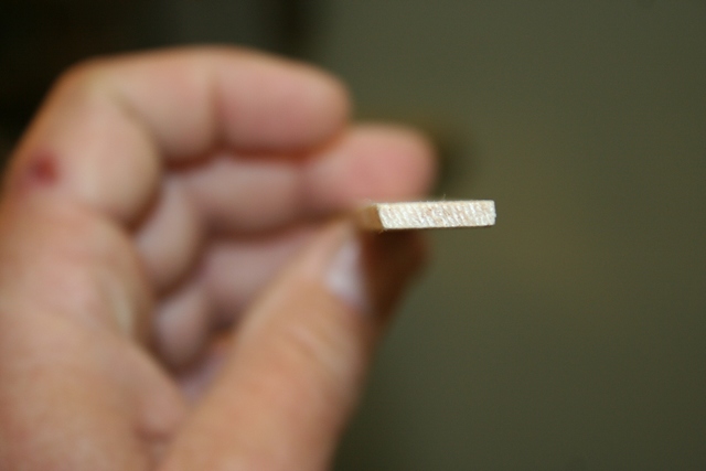

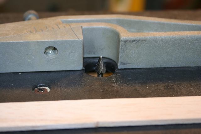

        I wanted to bevel the bottom of the sub-leading edge prior to gluing it in and rather than sanding it I found a Dremel bit with just the right angle of cut.
        With it and the router table accessary I made short work of prepping the 1/8" X 3/4" sub-leading edge.

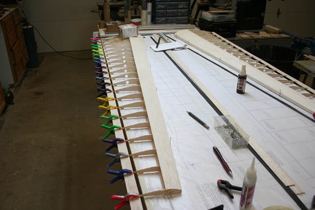

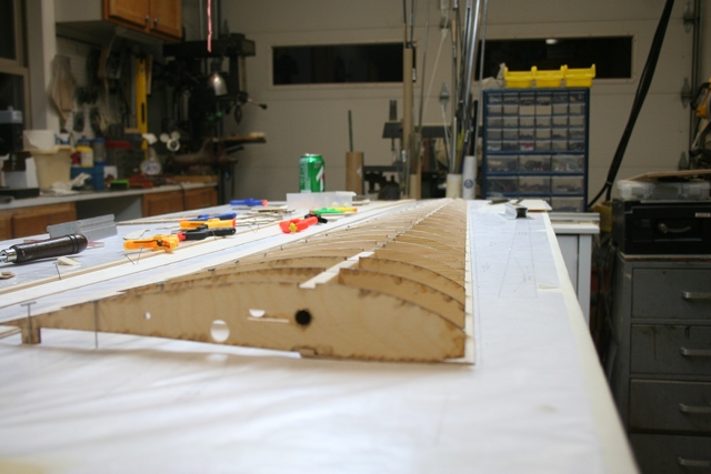

          Next I glued the bottom sheeting to the ribs by using thin CA and prying up on the sheeting. Click image for larger version
          Then I glued the sub-leading edge to the ribs and sheeting with thin CA. Click image for larger version
          Here the spar cap on the right wing has been epoxied and cured over night. I'm sanding it flush with the ribs. Click image for larger version
          After planing and sanding the sub-leading edge we're ready for the top sheeting. Click image for larger version

          • Update continued:

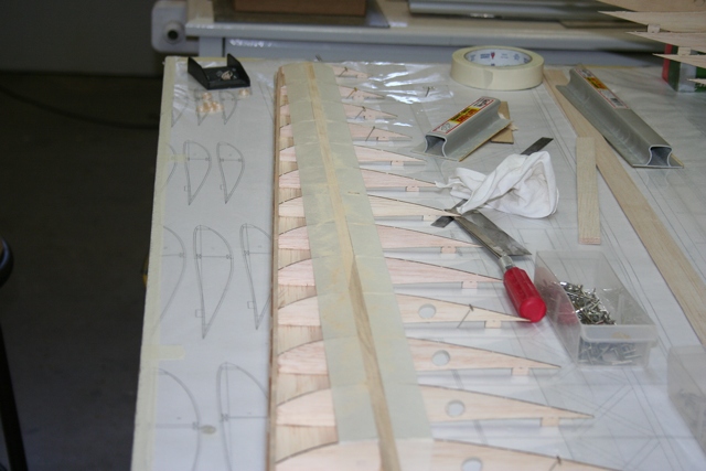

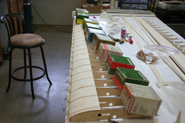

            Gluing down the top sheeting with extra thick CA. Click image for larger version
            More planing and sanding. Click image for larger version

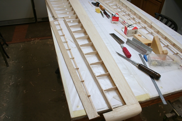

            Both panels are ready for the leading and trailing edges. Click image for larger version

            • How in the world did you do the top sheeting with thick CA? I would have a crooked mess in about 3.2 seconds. Lately I've been using the wood glue/hot iron technique with great results.
              • ingrahal
                ingrahal commented
                Hey Dion, the "extra thick" CA allows more open time and some repositioning. The most important step when applying the sheeting is to tape it down at the aft edge of the spar cap. Fold it back while applying the glue then when you fold it forward it will be aligned.
            • ok, makes sense. I dont use the thick stuff much, so I may need to try that technique.

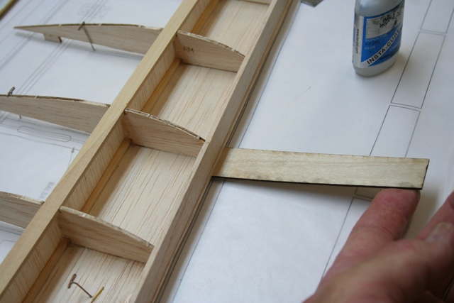

                I aligned the trailing end of the ribs with the edge of the table so I could clamp the trailing edge balsa while gluing.
                Gluing in the trailing edge shear webs. I cut the thin strips of vertical grain 1/8" balsa with the bandsaw.

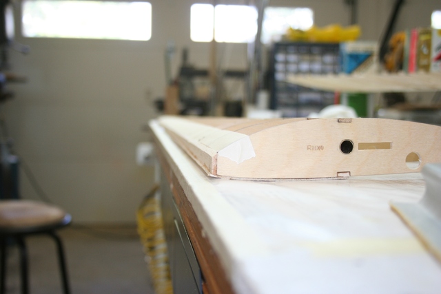

                Gluing on the 1/4" balsa leading edges with Titebond.

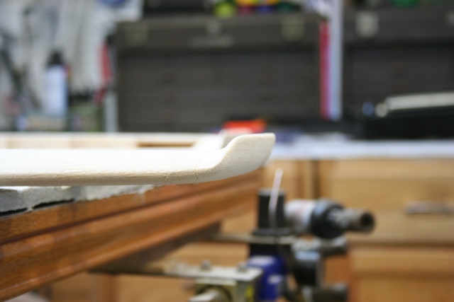

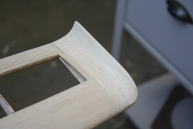

                Shaping the wing tips.
                Continued on next post....

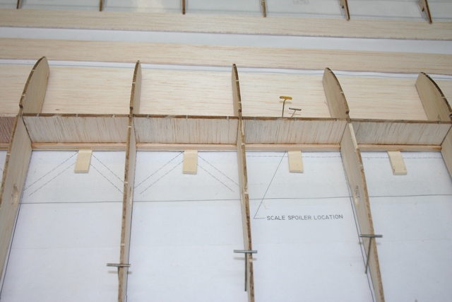

                  That's it for now. Ailerons and spoilers next.

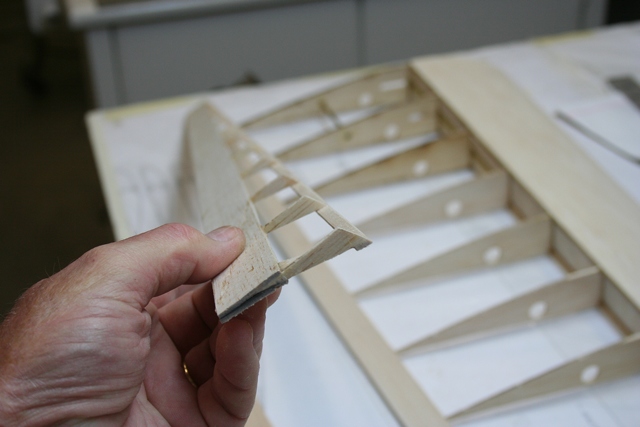

                  • Update:

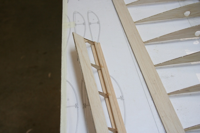

                    I've got both ailerons done now but not without some minor issues. Click image for larger version

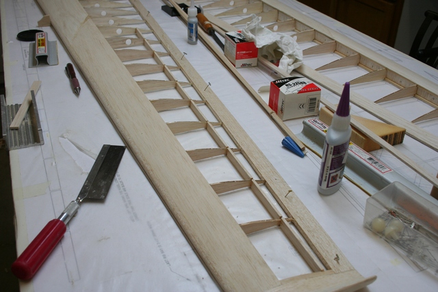

                    Here I have glued in the 1/8" X 1/2" balsa trailing edge.

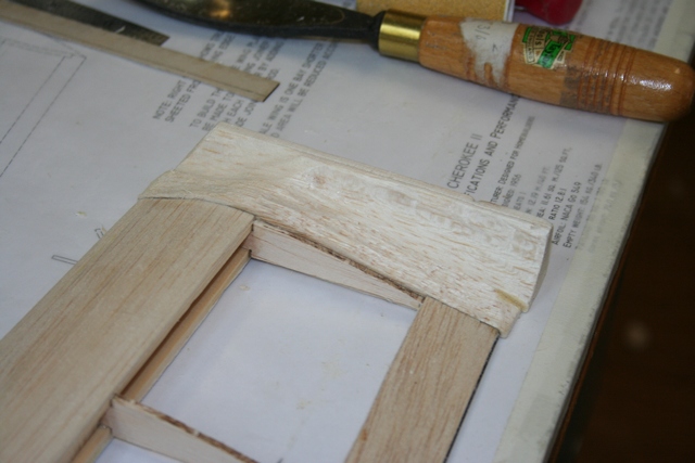

                    I had to cut 2 rib ends for the inboard end of the ailerons.
                    Next I glued 1/16" X 1/4" strips to the top of the trailing edge and the leading edge of the aileron.
                    Here I have cut the aileron loose.

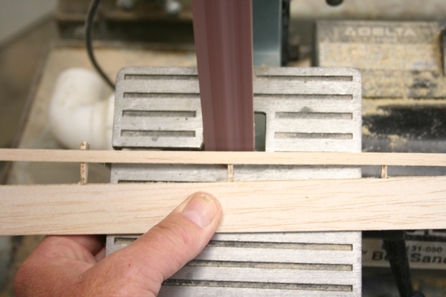

                      Using the belt sander to prep the aileron for the 1/8" X 1/2" leading edge.
