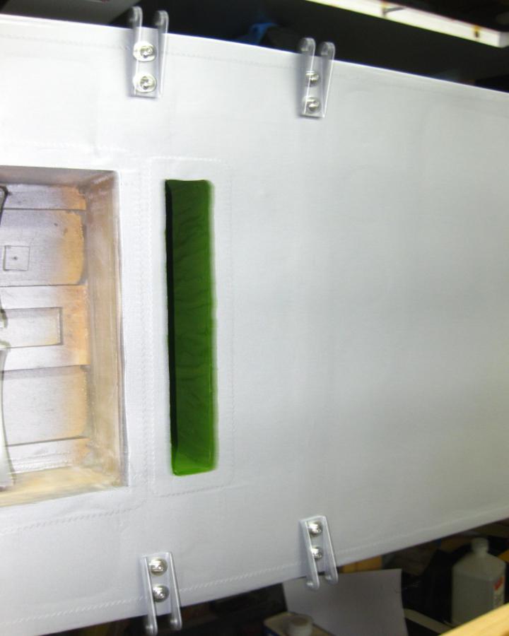

    • Windows needed to be repainted.....and I thought a zinc chromate interior might look neat
ID:	42067 Click image for larger version
      I seem to be procrastinating on making a new front window, I guess that's next on the list

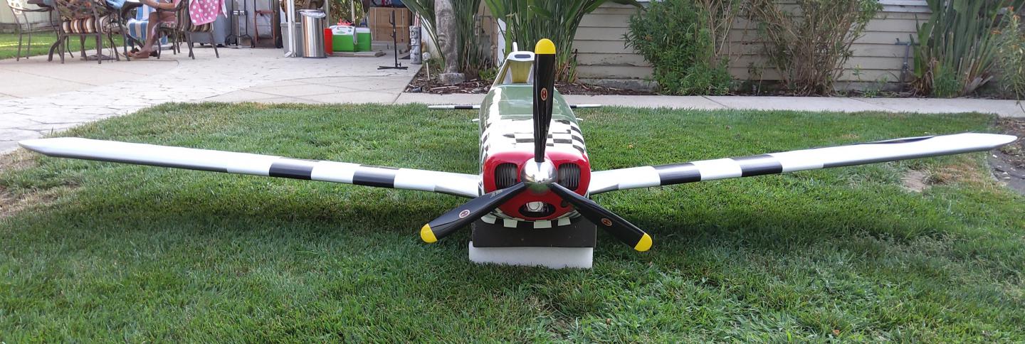

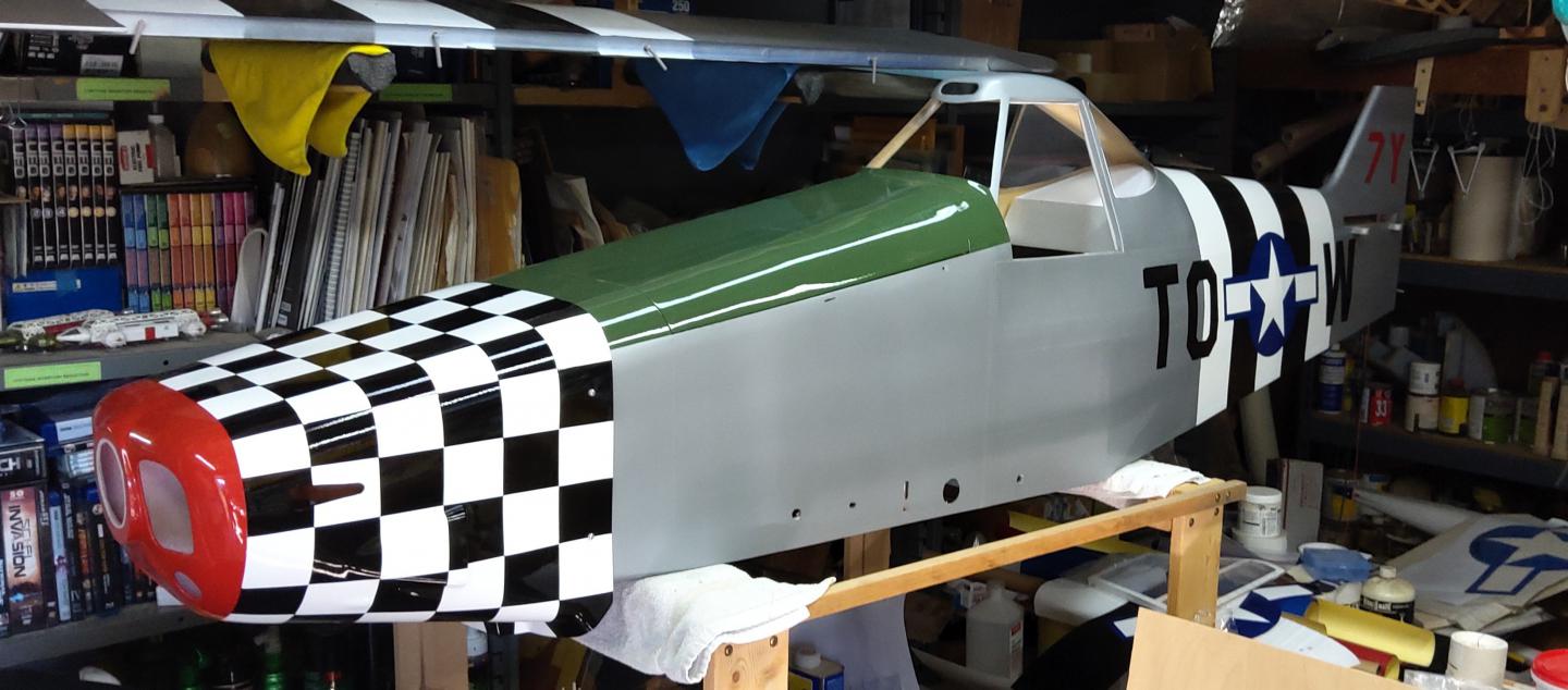

        • Sunday morning Motivational Assembly
          Click image for larger version  Name:	20200823_080532.jpg Views:	0 Size:	194.4 KB ID:	42221
          Click image for larger version  Name:	20200823_075638.jpg Views:	0 Size:	174.0 KB ID:	42223
          I think I like the polished aluminum spinner look.
            Exceptionally cool!

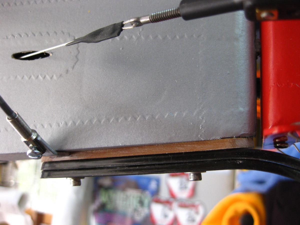

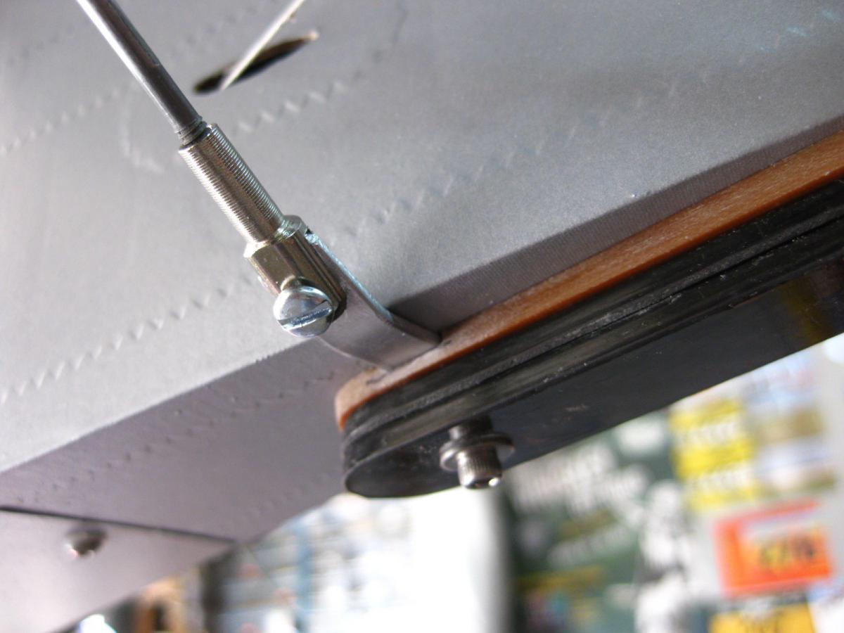

          • Some of the finer points.....
            Stabilizer flying wires are using Dubro 4-40 Threaded / Soldered Rod Ends for a bit more secure connections.
            The lower rear attach point was moved up to look a little more clean and the spacer adds a little stiffness to the part
            Using a Leaf spring setup for the Tail Wheel as I found I would break the single unit setup on my old Pawnee. The Spacer is so the tail wheel Tee bracket doesn't get brutlized when landing a little "stiffly".

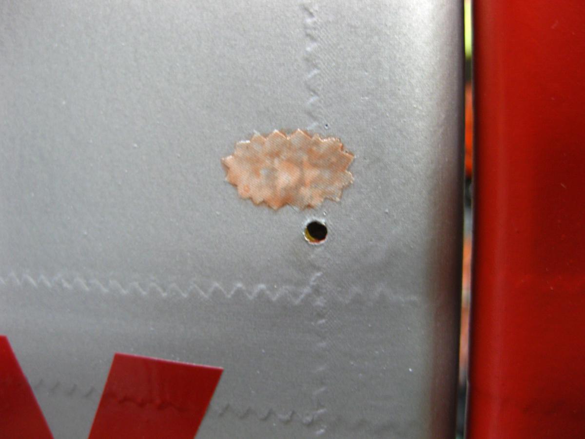

            OOPs.......I kinda knew I should have opened up the attach points.......Patches give it that "scale" look........

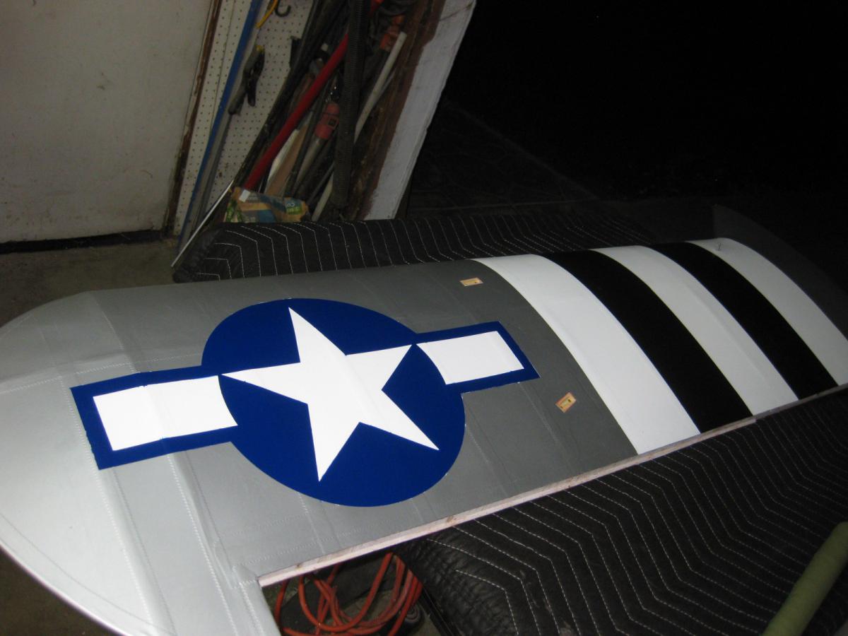

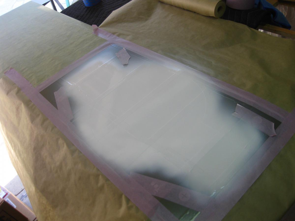

                Finally got up the courage to do the Stars and Bars on the wings........I don't recommend Mactac paint mask as it isn't very solvent resistant ( at least for Polytone paint ) It is nice in the respect that it's a transparent film so it makes positioning easier but it doesn't conform as well to irregular surfaces.
                Click image for larger version  Name:	IMG_5815.JPG Views:	0 Size:	112.3 KB ID:	42515
                Click image for larger version  Name:	IMG_5816.JPG Views:	0 Size:	62.6 KB ID:	42517
                Click image for larger version  Name:	IMG_5820.JPG Views:	0 Size:	87.2 KB ID:	42516

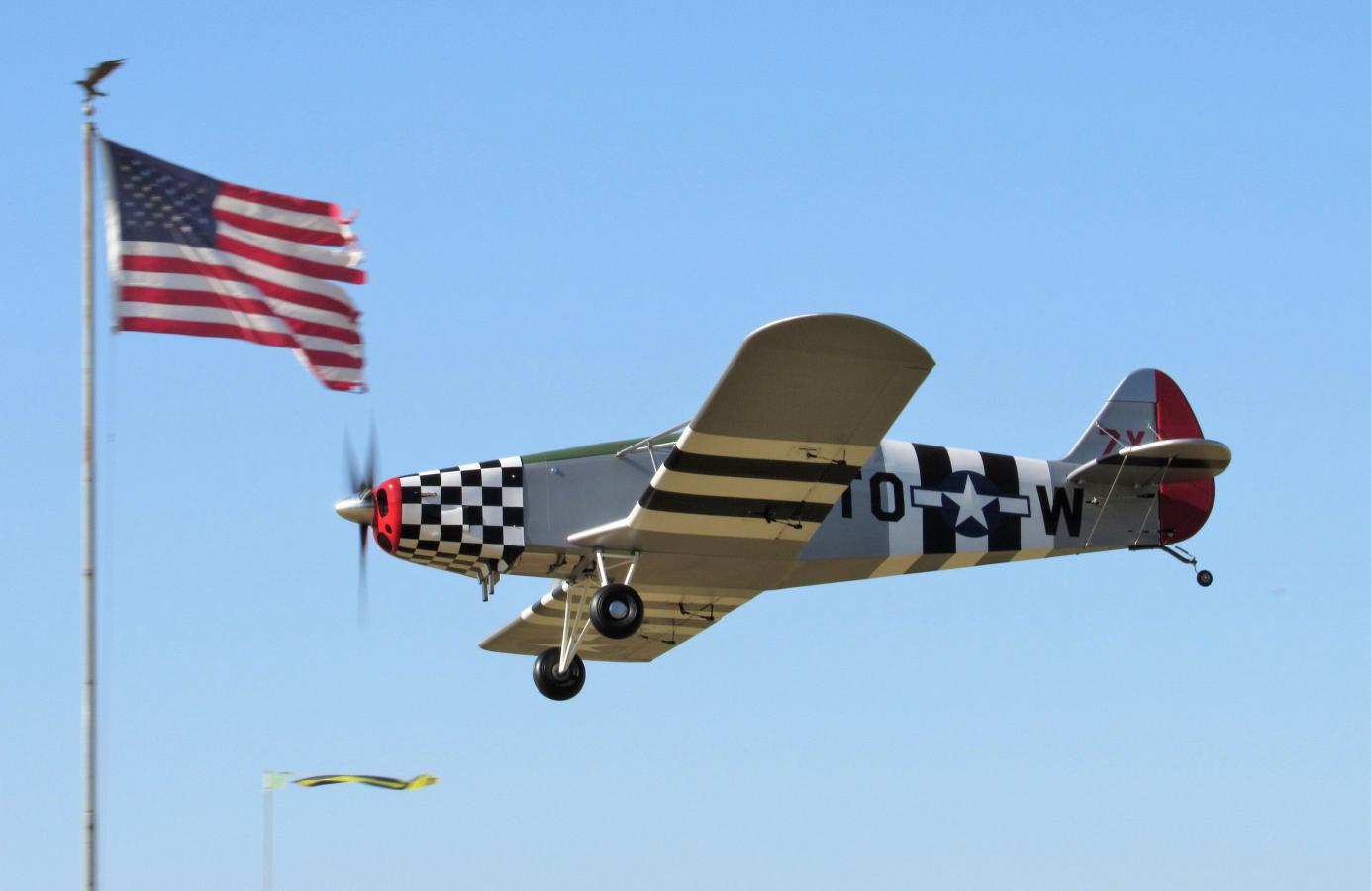

                      • Successful Maiden flight in overly blustery conditions ......wasn't.really sure if i was flying a rowboat in the open oceans or forgot how to fly.
                        All parts still where they should be.....except for the ones I forgot to apply Loctite too.
                        PGD 40% SGS 1-26 in the background

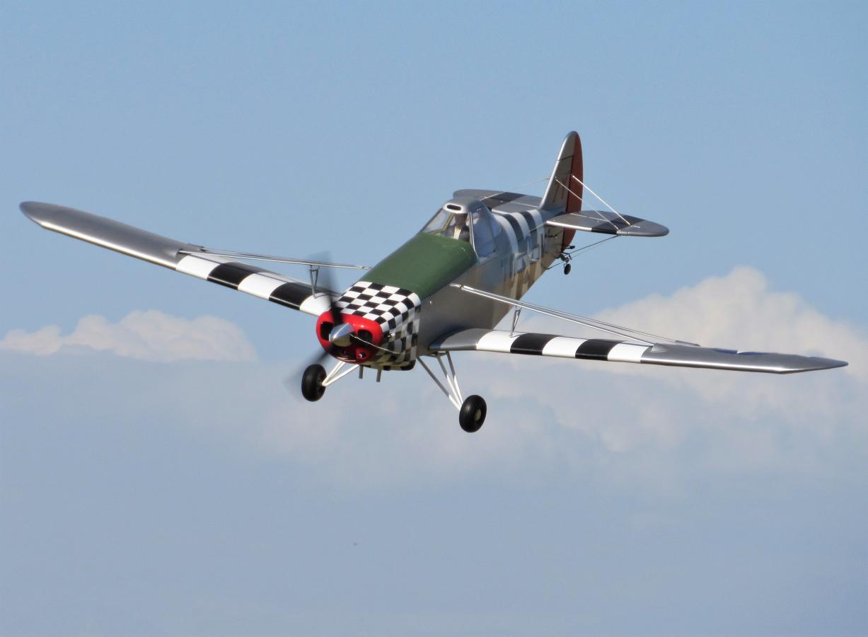

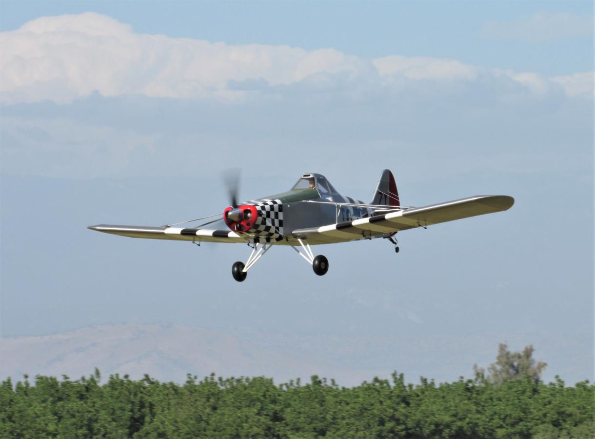

                        • Tony Accurso got some amazing photos of the Pawnee this last weekend at the Visalia Spring AeroTow
                          Click image for larger version  Name:	186193557_743249706330813_6802821896815660573_n.jpg Views:	0 Size:	61.6 KB ID:	44641 Click image for larger version  Name:	186553572_846216895985315_464876149311826939_n.jpg Views:	0 Size:	48.9 KB ID:	44642
Name:	01 Pawnee 02.jpg
                            Nice! Great shots

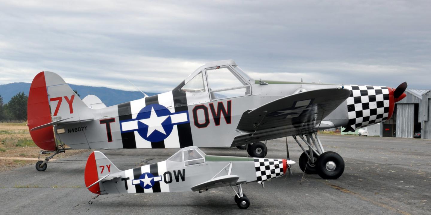

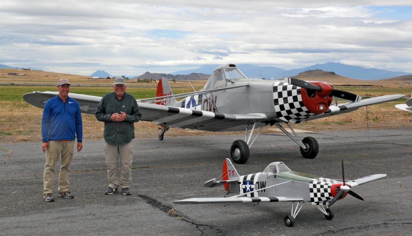

                        • Finally got some photos of the Real Deal....
