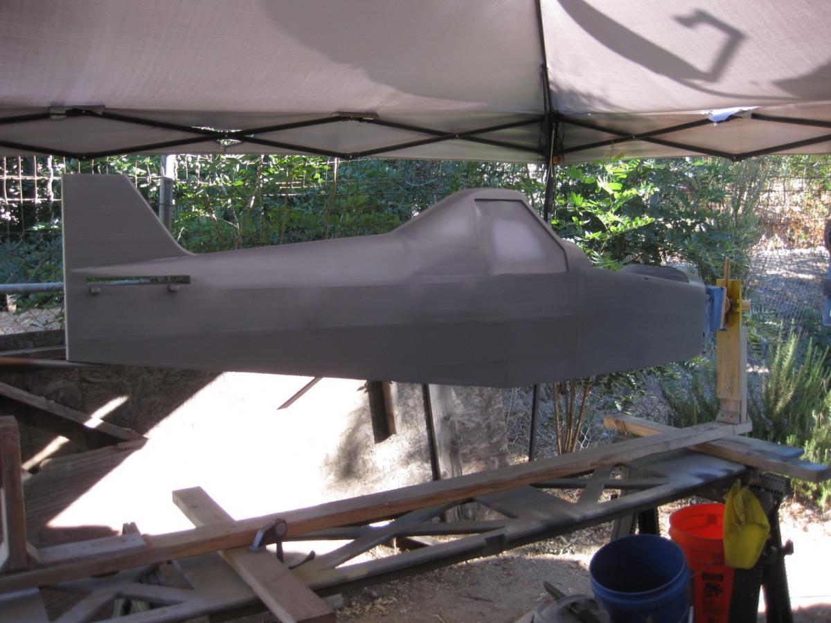

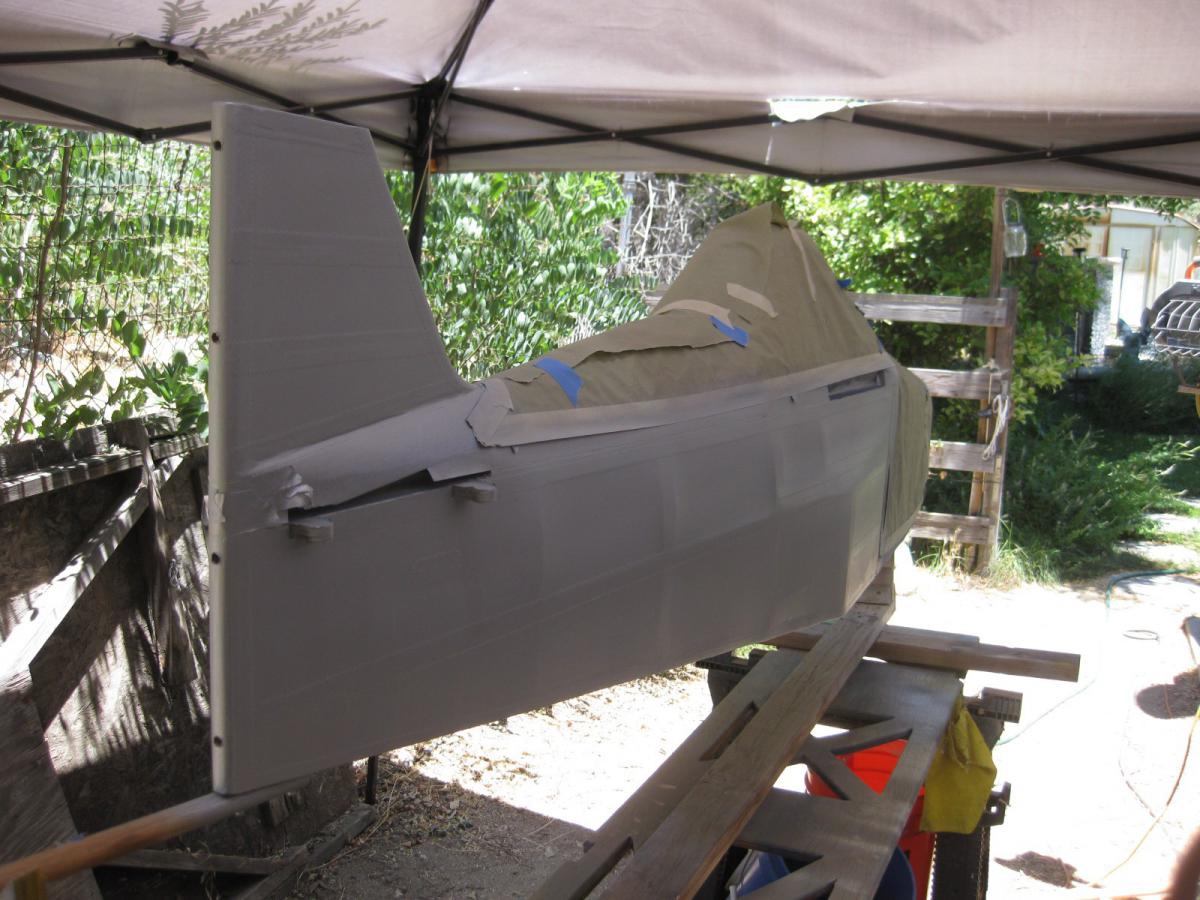

    And Poly-Spray on the fuselage fabric.....

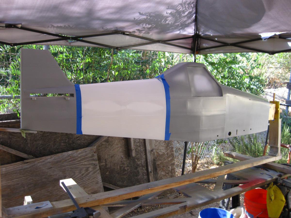

        AeroThane 220M Nevada Silver mixed 2.5:1 with Flattener to match the semi-gloss finish of the Poly-Tone on the wings

        Filtering paint as it goes in the gun .......

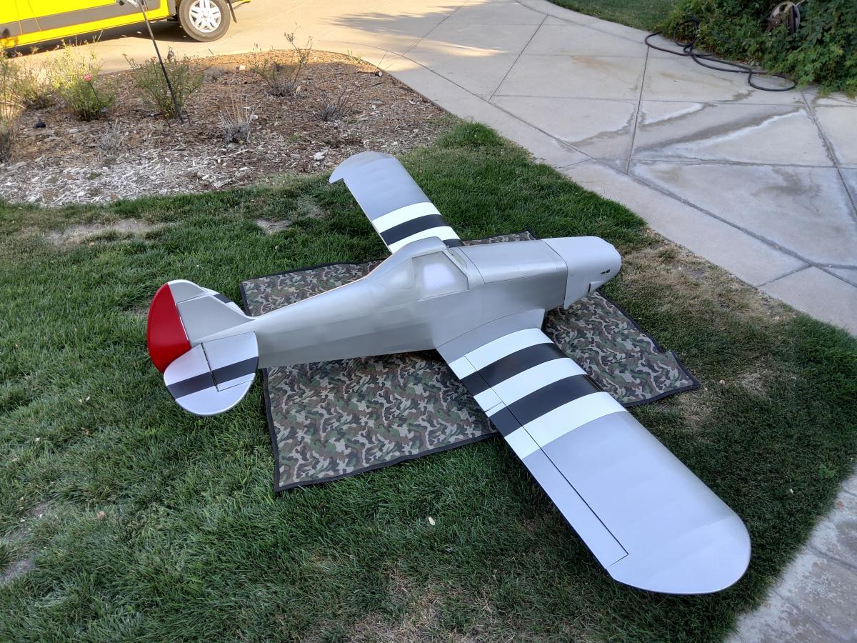

          • #95
            Projection .....trying to balance scale stripe size vs. fuselage real estate .

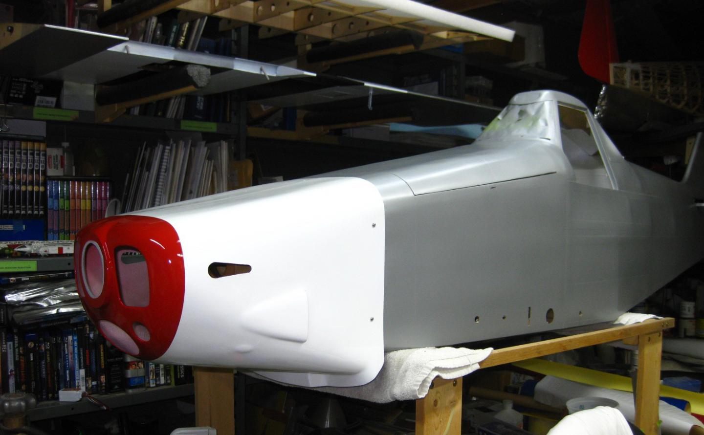

                  • #99

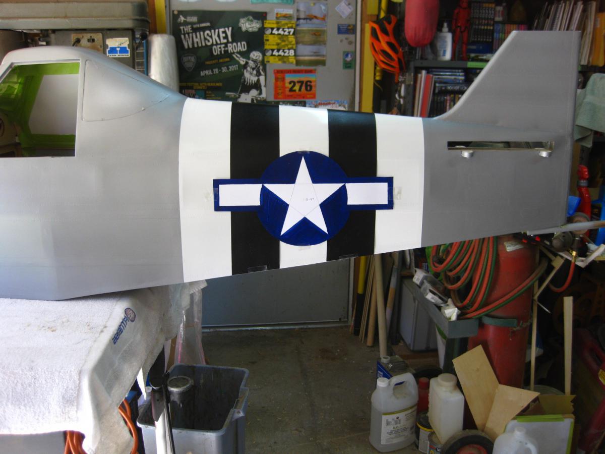

                    Starting the Fuselage Invasion stripes - going for a little glossy-er with reduced Flattener ( 3:1 ). also using a finer paint filter ( 100-120 mesh ) as the flattener seems to have some excessive debris that has separated out.

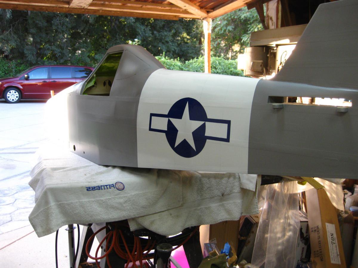

                    • made some paper black stripes and a star & bars mockup to check if things are fitting before painting.

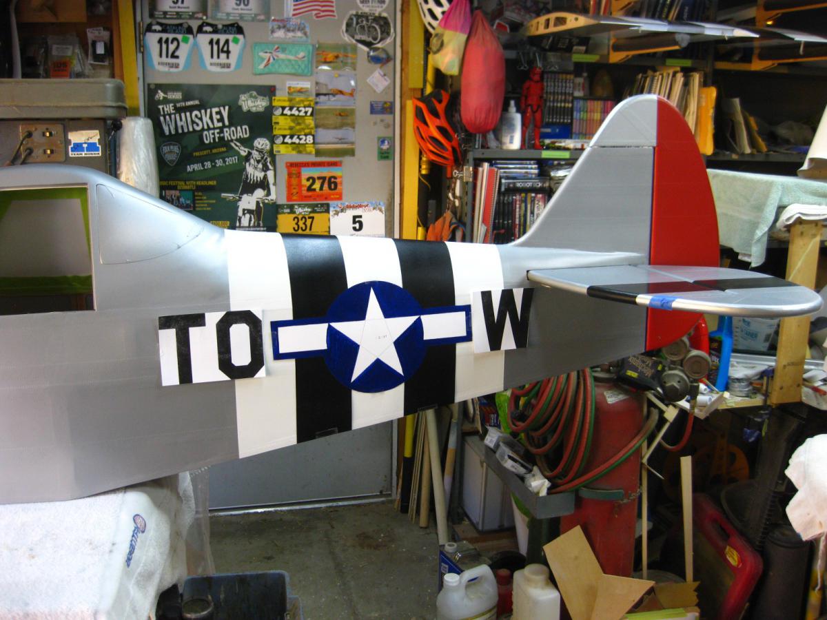

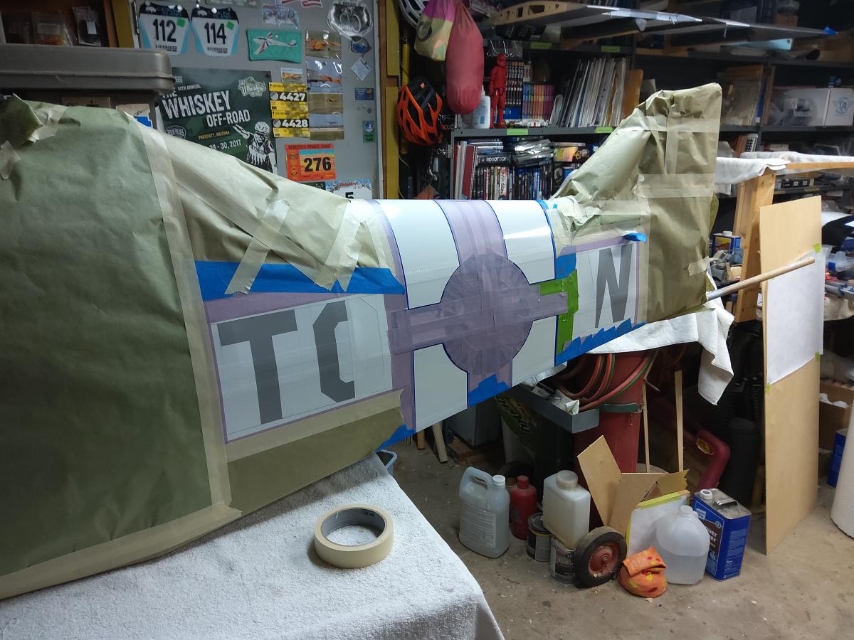

                      • I think i'm liking it........

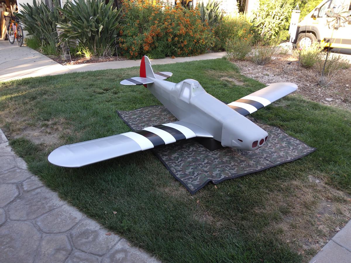

                        Maybe a little larger on the lettering though...... right now it's 4 inch .......I think 5 inch will fit OK.
                        two paws up....( err..aah ..out ....) from the " inspector" ......hard at work.... on Sunday......

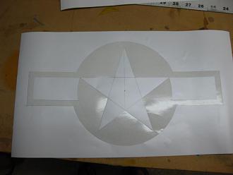

                            Vinyl paint masks for the Stars and Bars, then final alignment checking.
                            Click image for larger version  Name:	IMG_5753.JPG Views:	0 Size:	38.0 KB ID:	41787 Click image for larger version  Name:	IMG_5754.JPG Views:	0 Size:	51.3 KB ID:	41786 Click image for larger version  Name:	IMG_5757.JPG Views:	0 Size:	73.5 KB ID:	41785

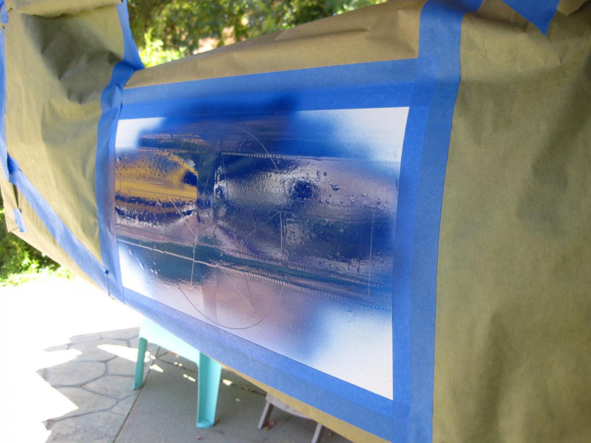

                            Then paint - Christen Eagle Blue
                            Click image for larger version  Name:	IMG_5767.JPG Views:	0 Size:	110.9 KB ID:	41788 That's a little weird looking - my house looks like an oversized SUV of some type......at least I can see my Yellow ProMaster van......

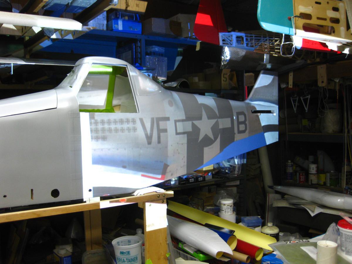

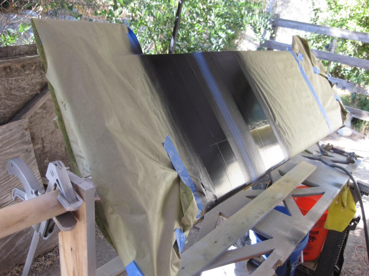

                            • Masking......masking....... and more masking .....now I have to buy some more tape , the delicate stuff this time.
                              Click image for larger version  Name:	20200715_183239.jpg Views:	0 Size:	115.1 KB ID:	41795 Click image for larger version

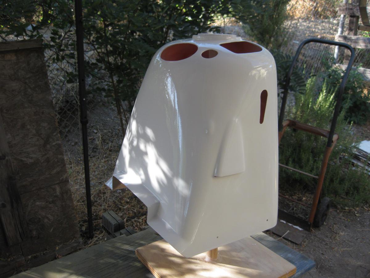

                              • Applied a coat of clear in a bid to reduce bleed thru..... then the big step.....
