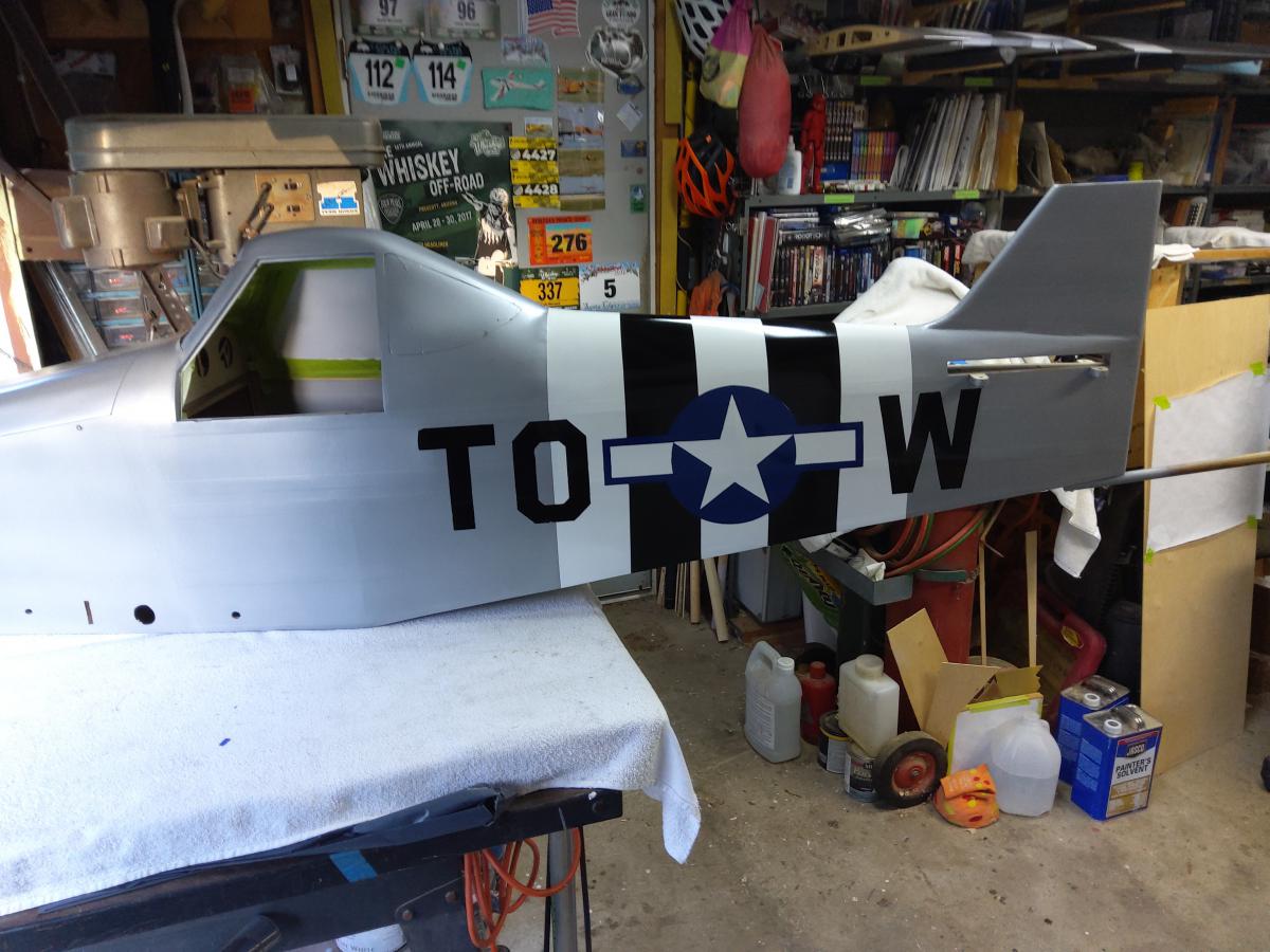

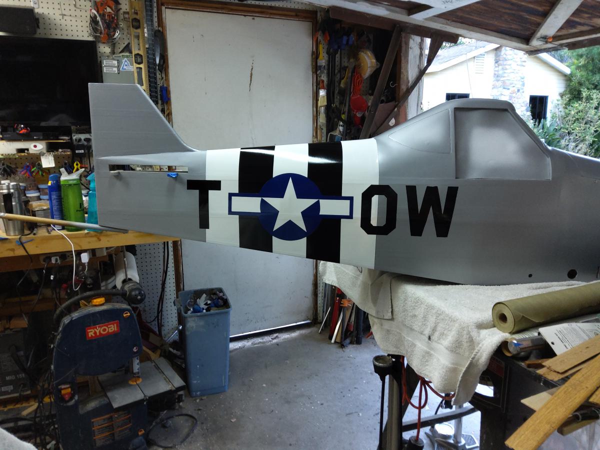

  • A few ragged edges here and there on the lettering that will get cleaned up with the red outlines....... acceptable though.

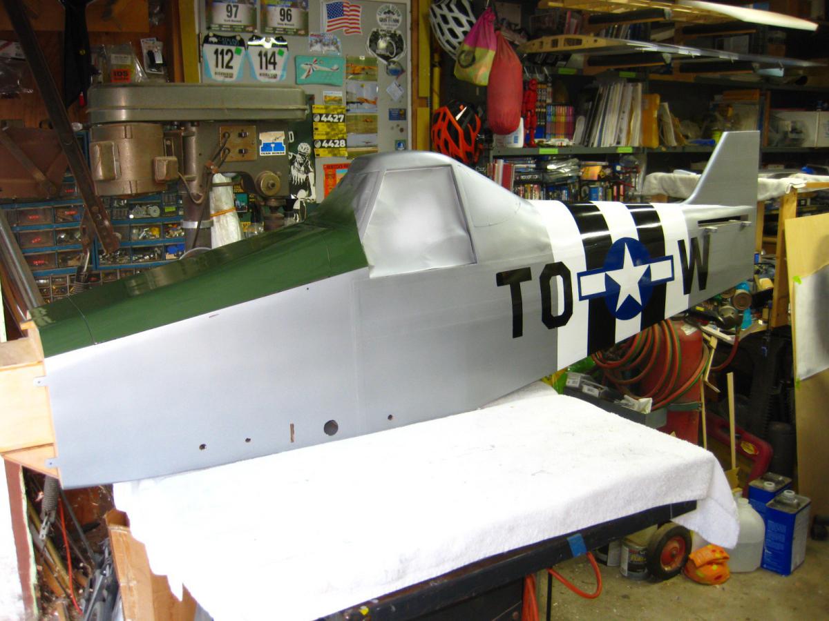

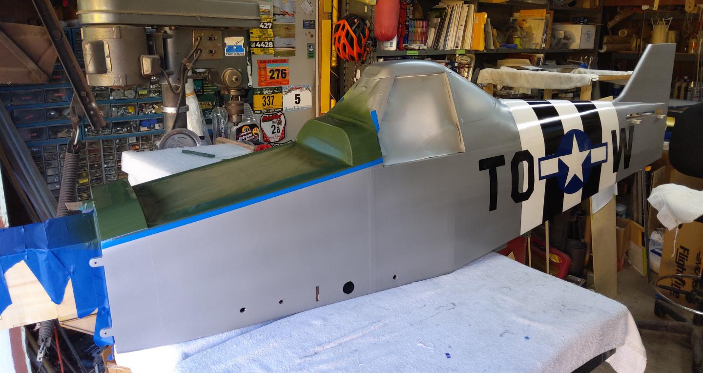

          Stopped by my local hole-in-the-wall automotive paint shop looking for a OliveDrab half-pint single stage urethane for the "anti-glare" in front of the cockpit . Ended up with a BASF Supreme Plus ( ppg omni LV equivalent). Paint # SG097.50. Used my existing ppg omni lv hardener and thinner @ ratio 4:1:1 ( I actually thinned it a bit more to 4:1:2 ).
          Click image for larger version  Name:	20200717_183423~2.jpg Views:	0 Size:	144.0 KB ID:	41813 smells really good too.........
          full gloss.....anti-glare........

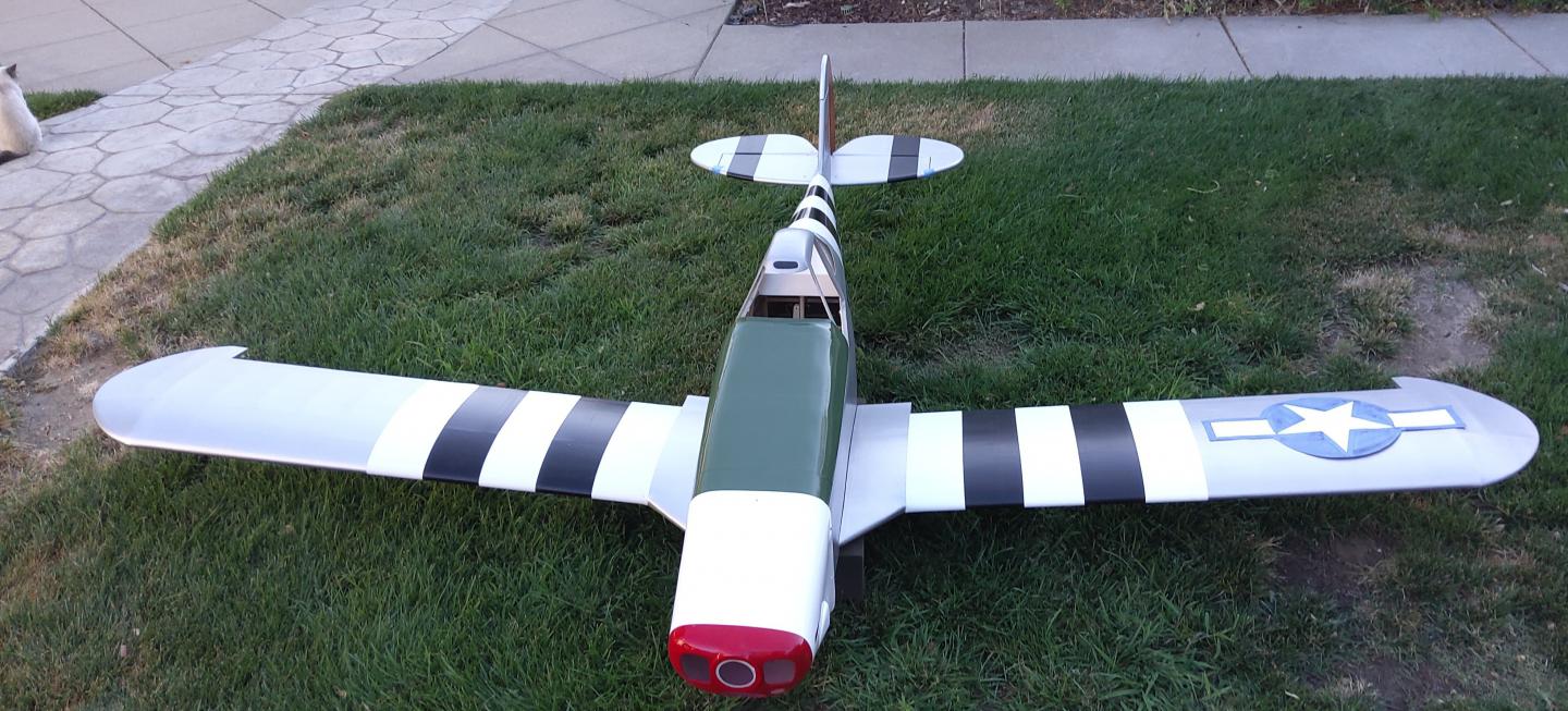

            Click image for larger version  Name:	20200719_071357~2.jpg Views:	0 Size:	307.6 KB ID:	41821
            Sunday morning motivational Assembly.

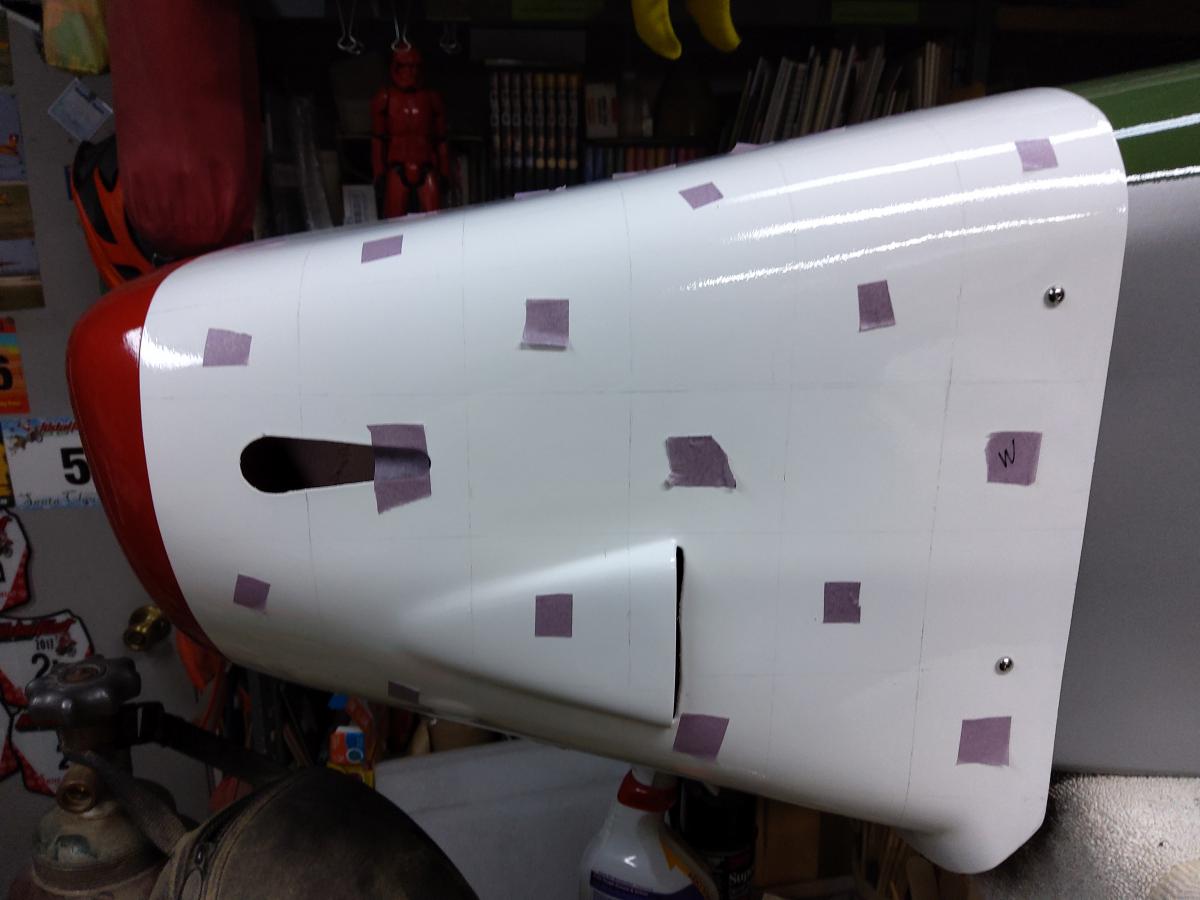

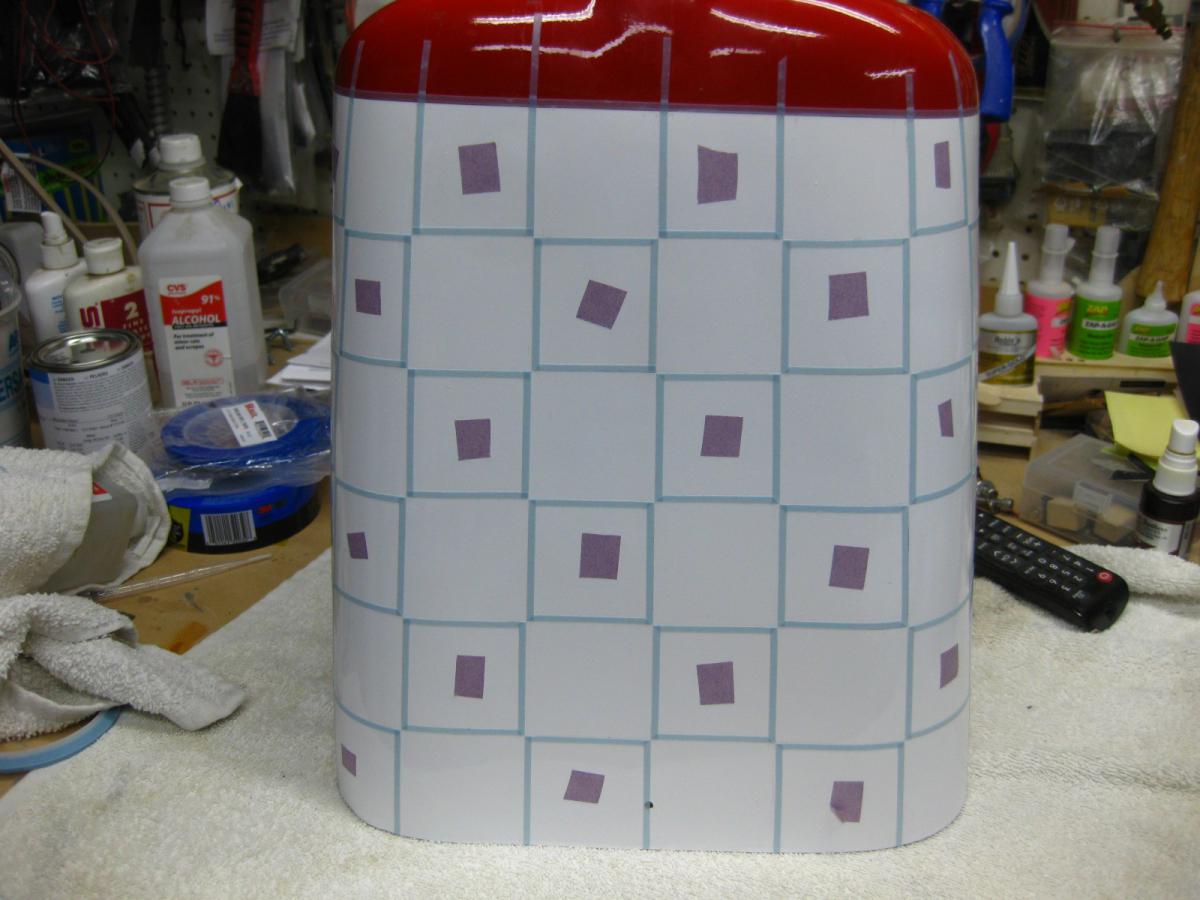

                    initial layout in pencil

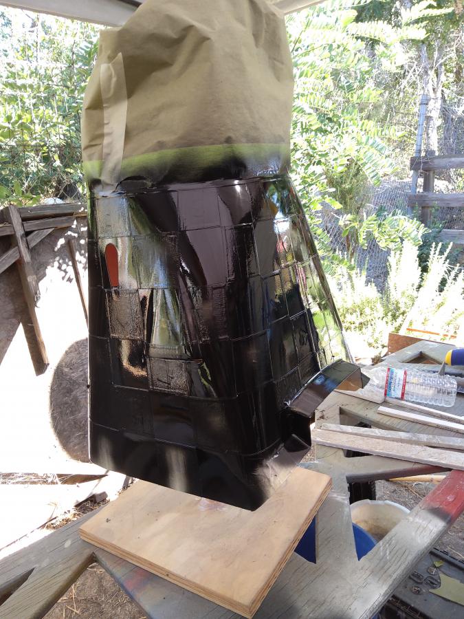

                    • aargh........ my original technique didn't work.

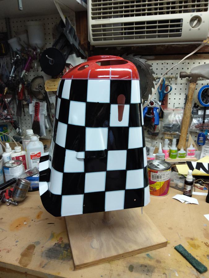

                      Switched over to 1/8" thin ( hi-temp ) vinyl tape and changed to taping individual squares with better results.
                      • Holy Cowl!
                        • Ive been wondering how you would do the checker board!

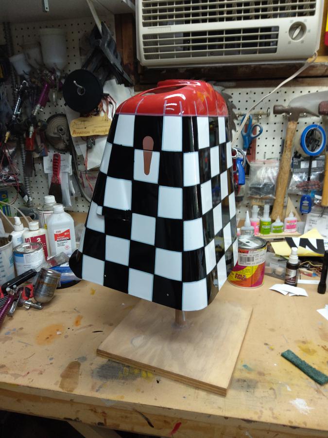

                          • After a coat of clear to hopefully seal the edges and prevent bleed thru..........
                            • Super Cool......

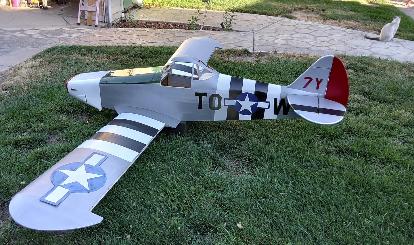

                              Click image for larger version  Name:	20200801_130221.jpg Views:	0 Size:	95.5 KB ID:	41966
