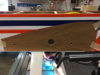

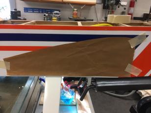

      When a plane gets this size and weight it becomes a challenge to balance alone. My process for doing this is to create a balance rib for each side of the fuse.
      Using craft paper, take it to the fuse side over the wing root area.
      Click image for larger version  Name:	IMG_4603.jpg Views:	1 Size:	13.6 KB ID:	14677
      Use a flashlight to find the holes
      Click image for larger version  Name:	IMG_4604.jpg Views:	1 Size:	5.2 KB ID:	14676
      Cut out the wing attach holes
      Click image for larger version  Name:	IMG_4606.jpg Views:	1 Size:	13.5 KB ID:	14675
      Make a pair of rib templates for balancing. The tab on top if for attaching the hook or string at the exact balance point needed.

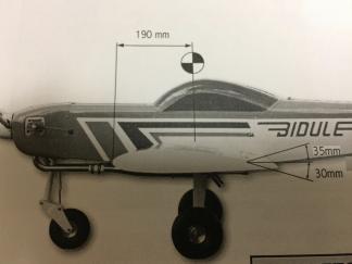

      Balance point for the Bidule 170 is 190mm from the Wing LE
      Click image for larger version  Name:	fullsizeoutput_3c.jpeg Views:	1 Size:	8.9 KB ID:	14679

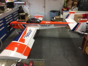

        The plane is done.
        I ended up only adding about 10 oz to the tail and all up weight is 48lbs. If I remember right, the weight of the first Bidule was about 53lbs, with 23oz in the tail. Saving the 5lbs is a big deal when it comes to flying characteristics of this plane.
        I'm looking forward to another great towing season and this Bidule will be on the front line waiting for a challenge...
        Thanks to all for your input and suggestions. The modification made to this tug should make it even better, if that's possible?
