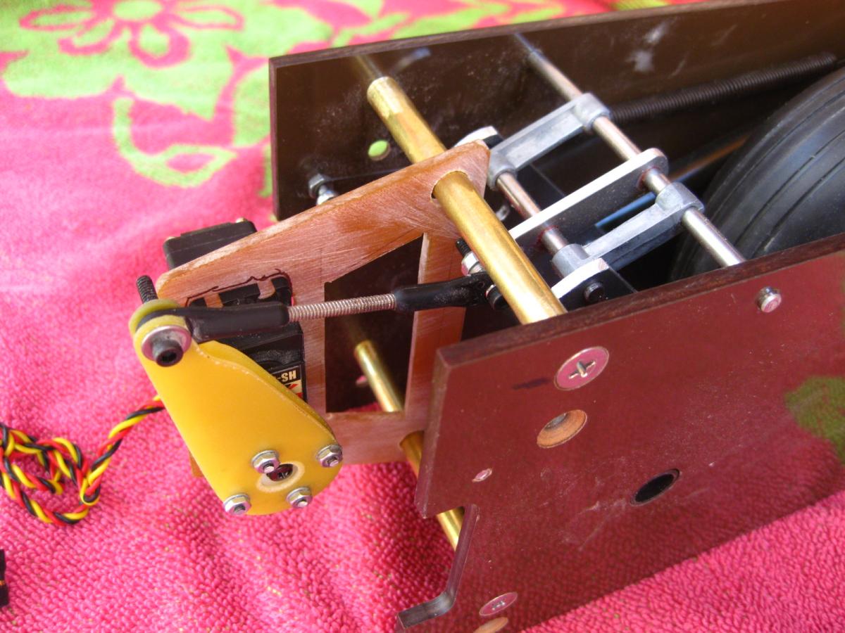

        Worked on the landing gear system - as you can see its one of the original units

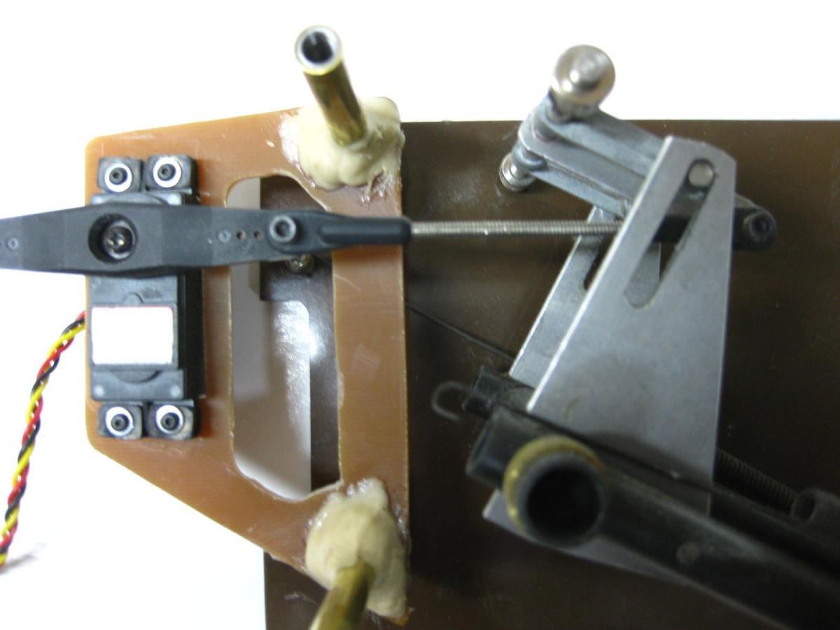

        this was my first attempt but I found that the servo was drawing 1/2 amp trying to keep the gear retracted.

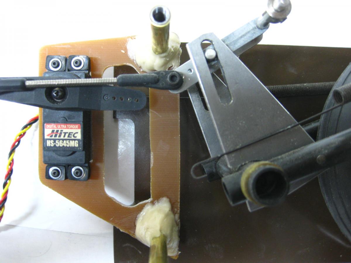

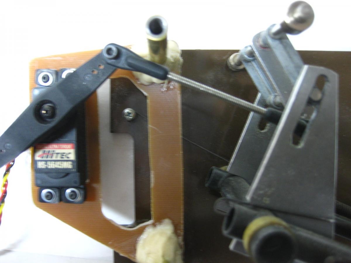

        Here's the final version with 180 degree movement and minimal current draw in either position.

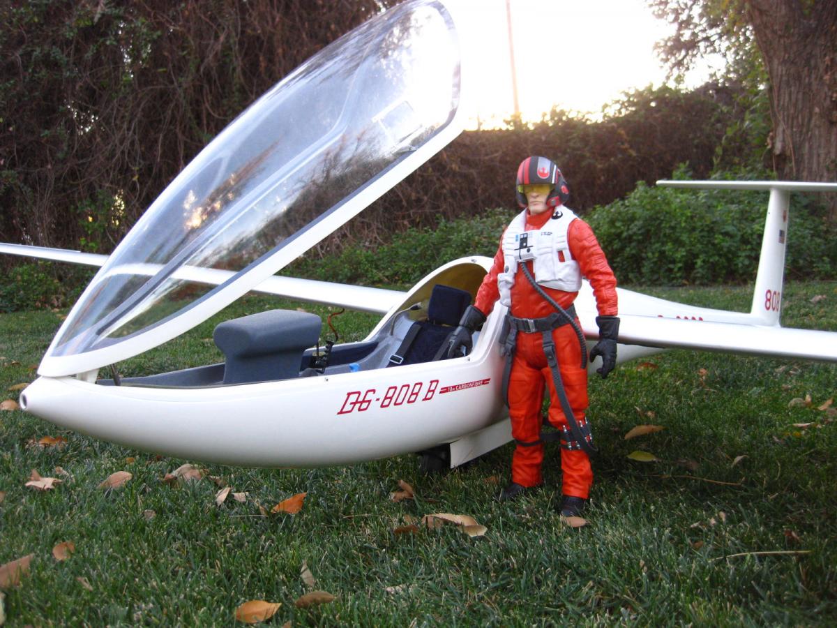

                              found a Pilot for the DG 808b
