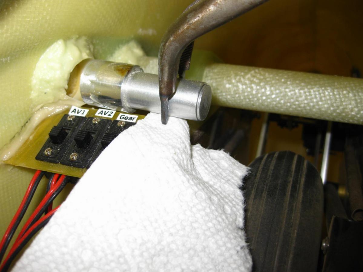

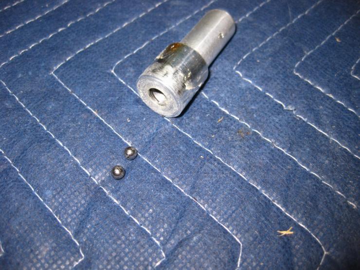

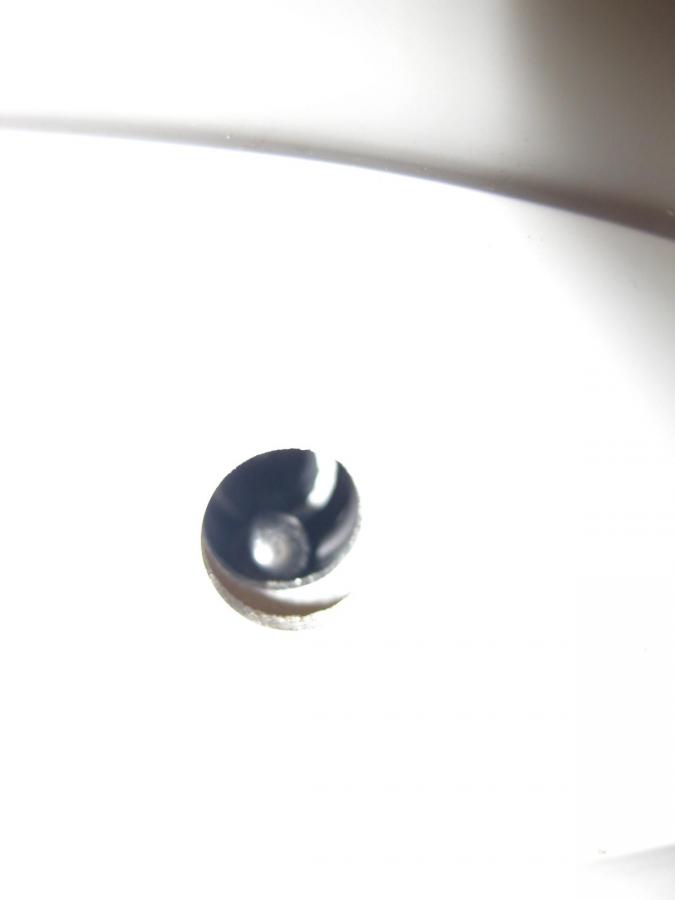

    Ran in to a bit of a problem getting the wing off with the retention system.... and then it popped .....humm, a ball bearing where it shouldn't be.

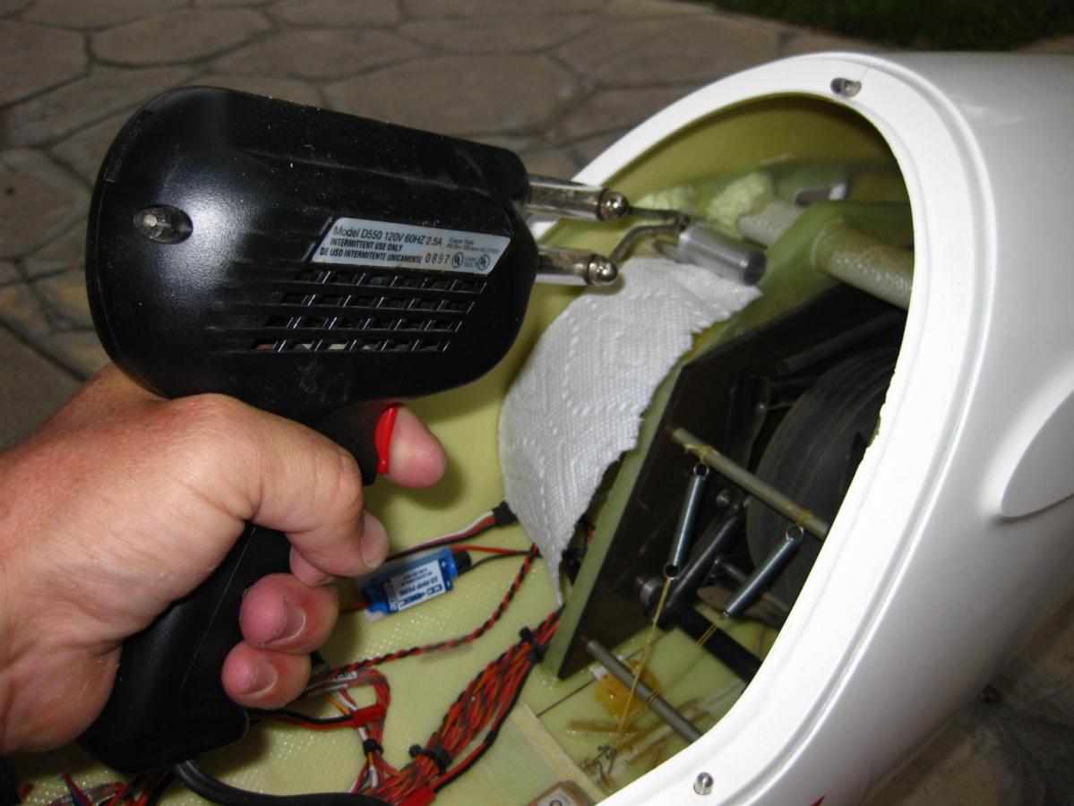

    Converting to manual screw-on retention using round dowels but first getting the glued in MonoBlocks was a simple task for my trusty 200 Watt soldering iron.
