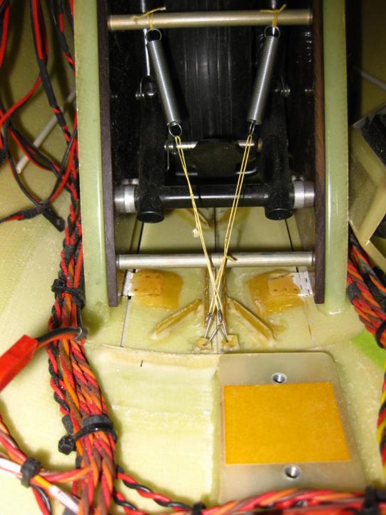

        Landing gear doors "guidance" plates installed so the doors won't bind on the landing gear as it cycles. 1.75"x 0.25" springs (0.020 wire gauge) and Kevlar thread for keeping the door closed.

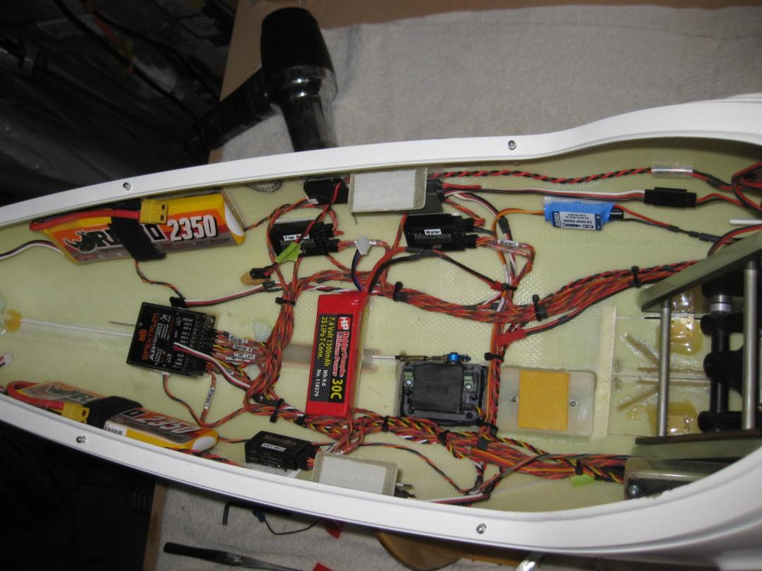

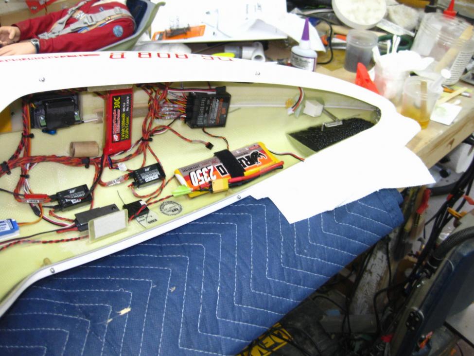

        Finishing up on the fuselage electronics ....

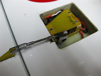

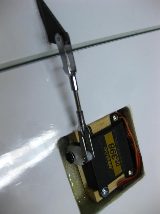

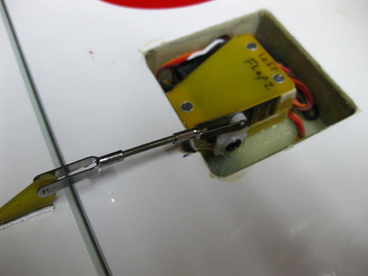

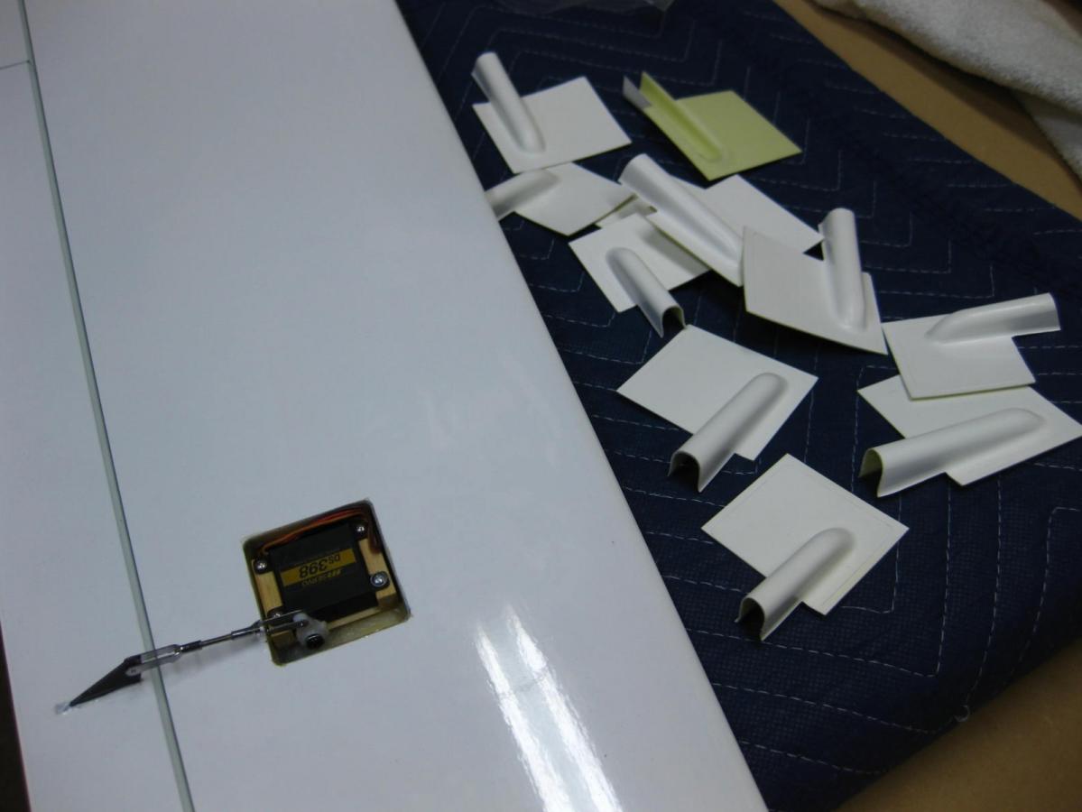

        Flap, Aileron, spoiler, and Water servos installed.....now I just have to fit the servo covers
ID:	17109Click image for larger version
ID:	17111Click image for larger version

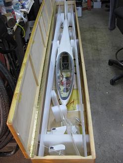

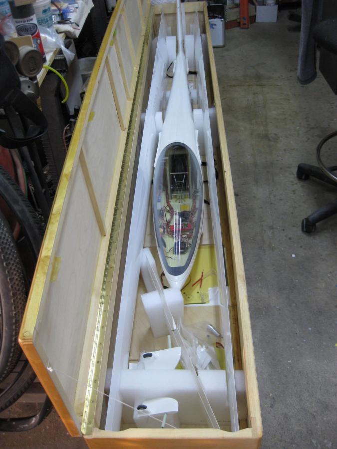

        And of course the transportation box

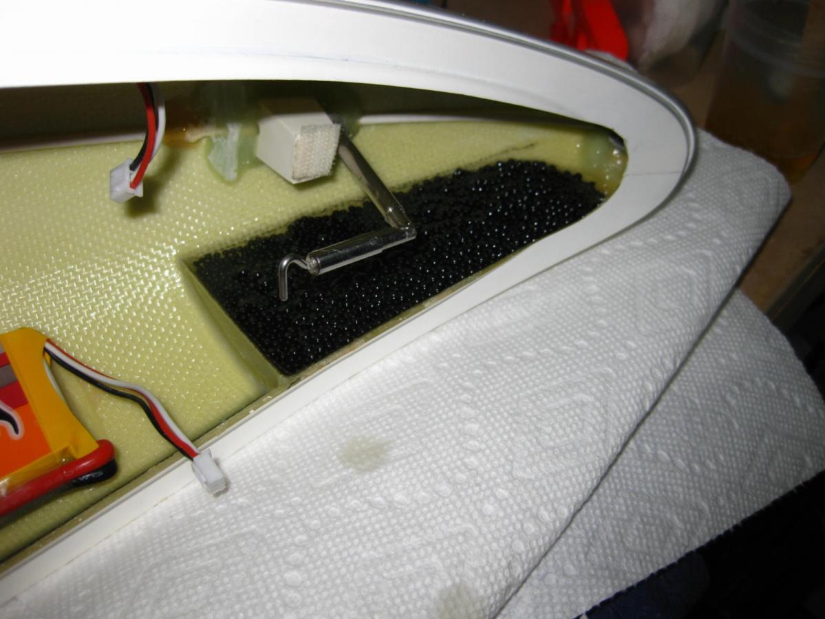

          Water Servos!
            Well....hopefully not....."Water Servos"...
            The 808b is equipped with 1.25 liter water tank in each wing ....which of course is a scary prospect in a styro-Abachi wing...
            I don't plan on using it ...

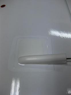

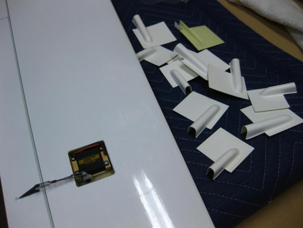

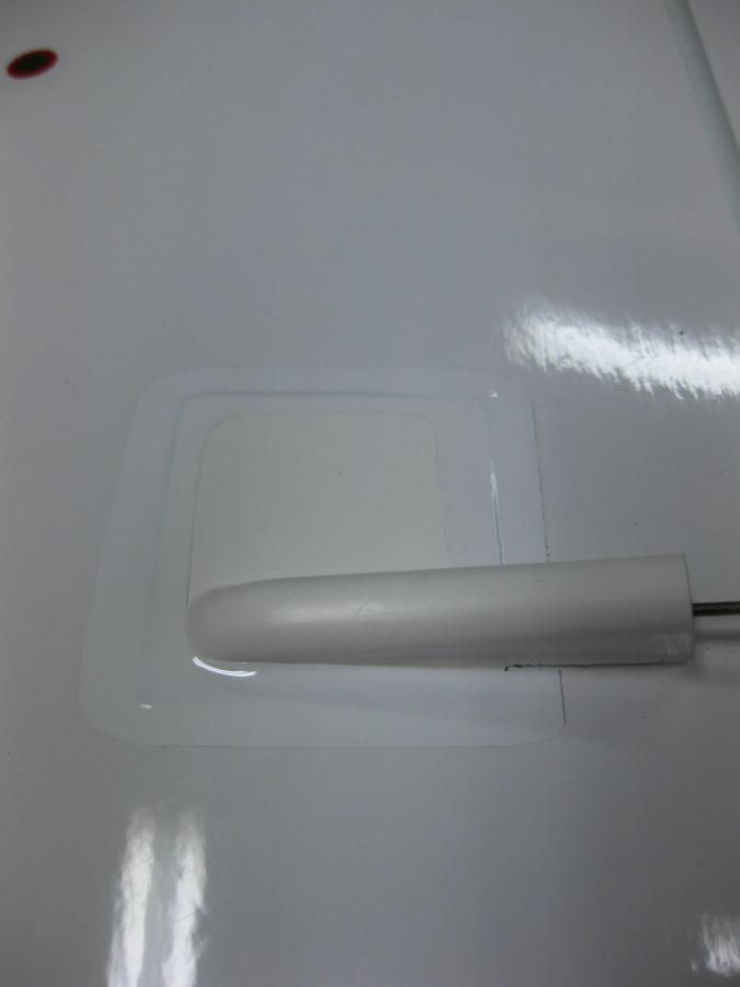

            Taking the easy way out on servo cover attachments....monokote trim sheet
            Click image for larger version  Name:	IMG_4033.JPG Views:	1 Size:	21.2 KB ID:	17143
            Scott
              That is the smart way!!
              PS, Callie can cut those for you also.
                And white vinyl peels off the surface and replaces much easier than monokote trim

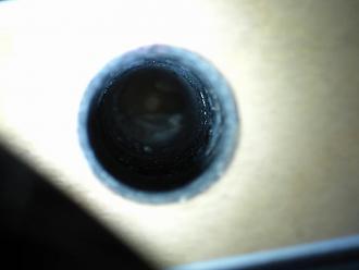

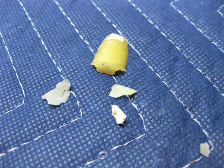

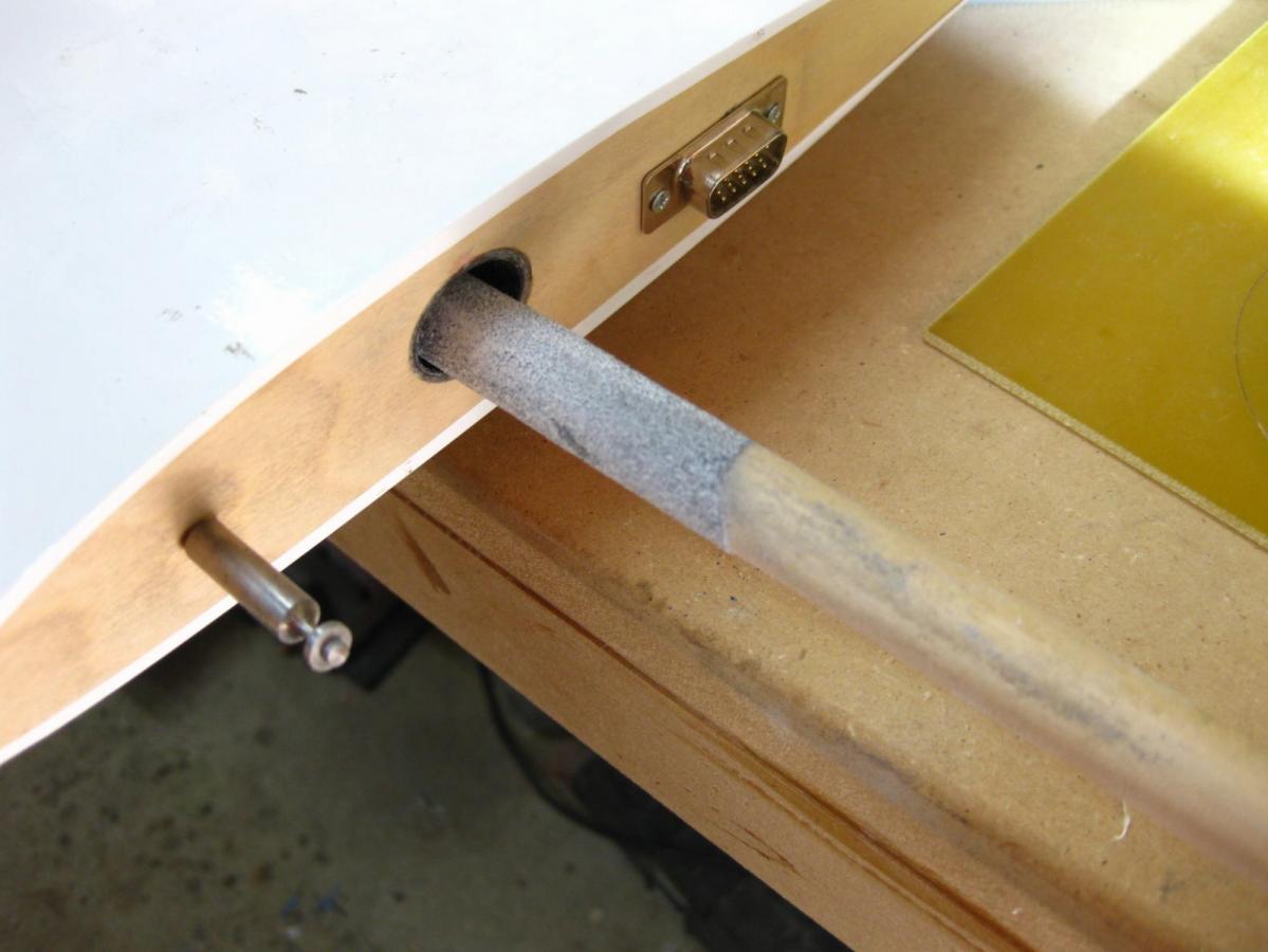

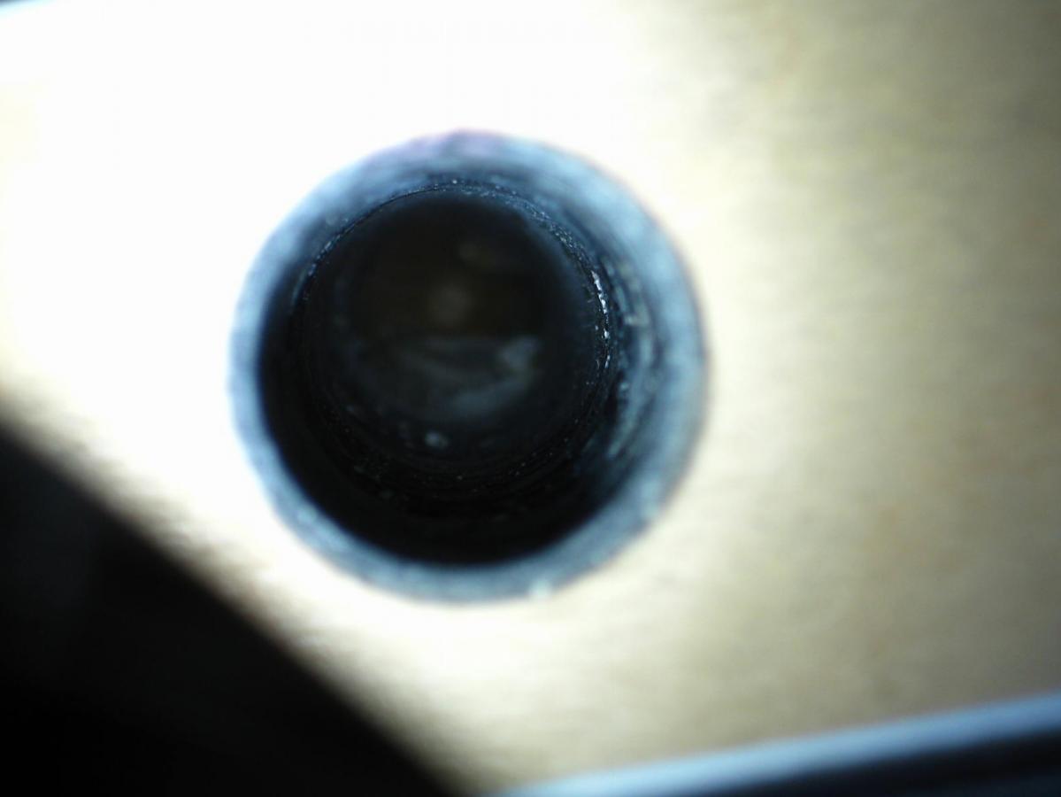

              Was having some minor difficulty getting both wings installed.......finally looked down the wing joiner tube and found my impediment....some left over epoxy. So out came my collection of dowels with sand paper attached........ some of the larger "things"....
ID:	17198Click image for larger version
ID:	17199Click image for larger version
                Assembled for nose weight determination -- looks like 1000 grams to get the CG over the wing spar. I'll add stick on weights to fine tune

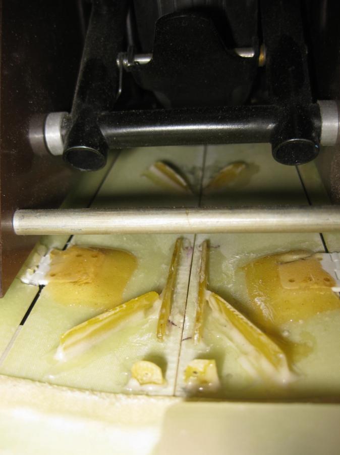

                Shot and Epoxy
ID:	17208Click image for larger version

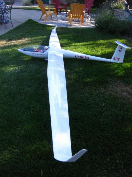

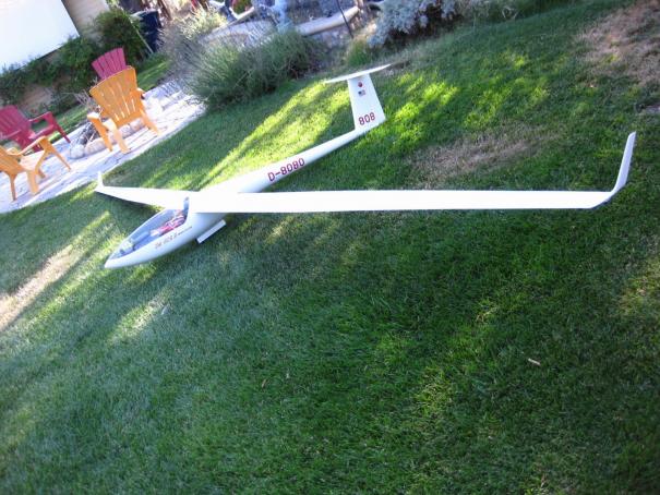

                  Successful Maiden flight @ Montague Glider Festival
Name:	Montague DG808b.JPG
