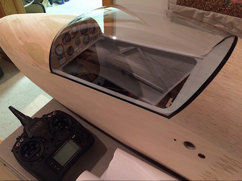

  • Normally I hate cutting a canopy and fitting it to the frame...it was still not my favorite thing, but the canopy Peter supplies for this model is very high quality and easy to work with. Very pleased with the end results!
    • I see a nice instrument panel, does it come with it?
        Instrument is an aftermarket product.

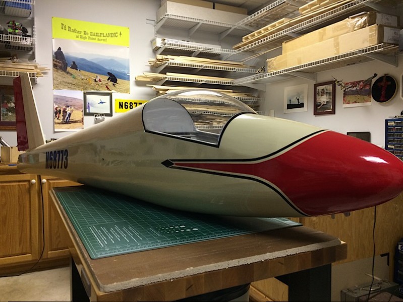

    • Finished covering the wings this morning and spent the rest of the day on the fuselage...almost there!
      • Outstanding! I really love it!
        i sense a neat red bling bling that needs to be heading your way. He he.
          +1 Very classy color scheme!
          Thanks! It's a variation on the PGM factory scheme.

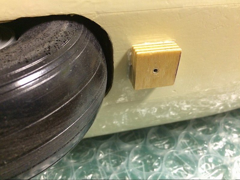

                    • The nose skid is made from a laser cut piece of 1/8" plywood. After a little smooth sanding to round the edges, thin CA was applied around the edges to seal them and then the skid was painted with thinner epoxy. The mounting holes get opened with a counter skin bit so the included screws tighten in flush with the bottom surface of the skid. At the back, a 1/2" thick standoff block was made from scrap plywood. This piece gets glued to the fuselage about 1/2" in front of the wheel well opening.

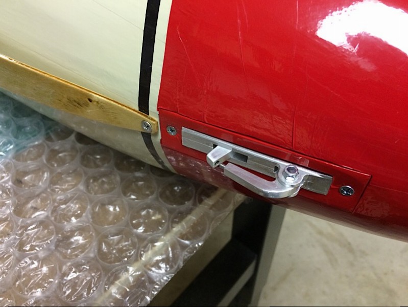

                      We shortened the skid slightly because of the scale tow release mechanism.

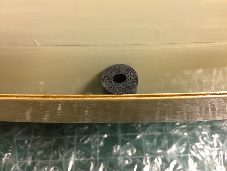

                      The included soft foam rubber tube gets cut into two pieces that are spaced between the rear block and front of skid.
                      These foam pieces are glued to just the skid (not to the fuselage). We used Zap Goo for this task, but Peter says that CA also works fine.

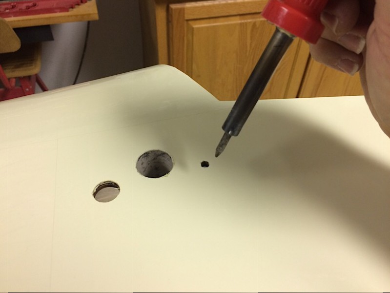

                      • I use an old soldering iron to open holes in covering. works really well and sticks edges to airframe nicely. Here we open up the holes for the wing tube, servo leads, anti-rotation pin, and wing bolt.

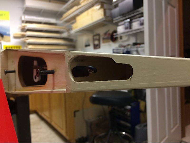

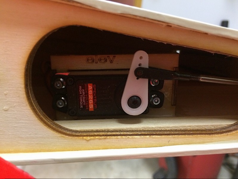

                        The elevator servo installation works best with the output shaft to the rear. Push rod attaches in second hole out from center.

                        Opening in aft fuselage needs to be opened up some to accommodate the attachment of the ball link to the elevator horn.
