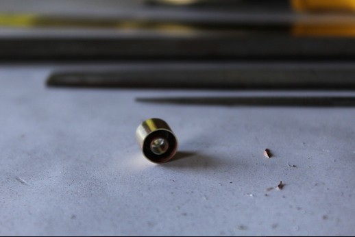

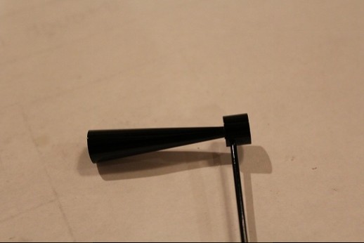

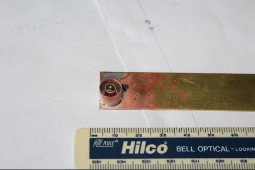

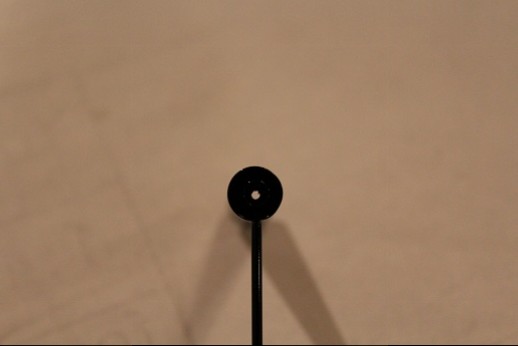

    • The venturi is finished and just needs to be mounted. Brass tubing was cut to size then Stay-Brite soldered onto brass sheet then the central air pass hole was drilled. A hole was drilled into the side for the 'tube' to mount. The tube is music wire. Metal cutting shears were used to rough cut the assembly free then a Dremel was used to trim a little closer. I taped the tubing in case the Dremel wheel touched the tube. Hand files used for final sanding of the sheet edge to the tube's edge keeping things 'square'. A paper pattern was used to fashion the venturi's rear cone section. When satisfied the pattern was traced onto lithoplate. The lithoplate was cut and carefully rolled into a cone then epoxied into the tubing/sheet assembly. After epoxy cured the fore portion of the venturi was masked while the rear cone section got lots of primer and sanding treatments to hide the seam in the lithoplate. I forgot to take pictures of the 'cone rolling party' but I'll tell you a secret... it was a bit of a pain in the rear getting it quasi-proper! I could always have it 3-D printed but then it wouldn't be 'mine'! I'll finish the gap covers and head rest tomorrow. Look at the beautiful iris!

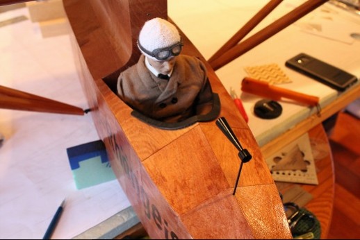

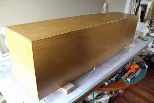

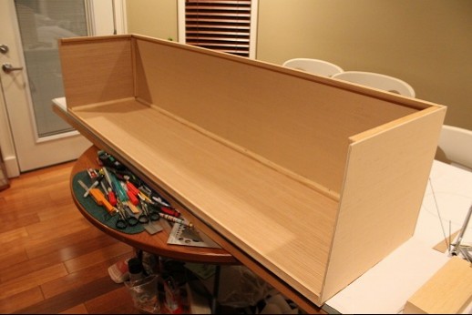

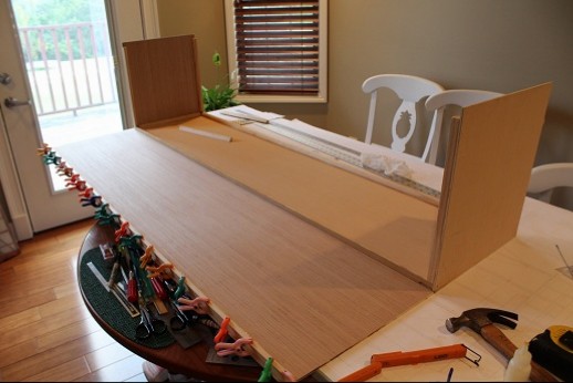

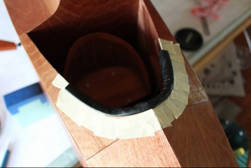

      • I started building the box and the cockpit coaming was put in place using leather from an old tie.

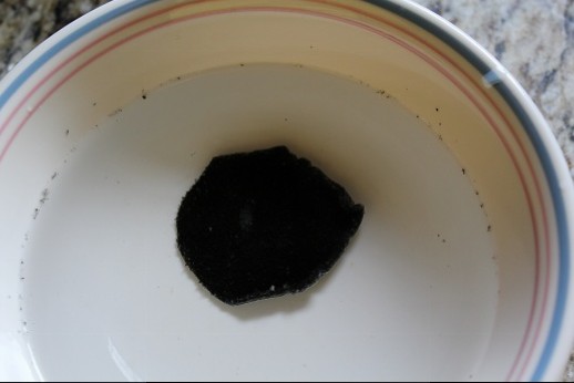

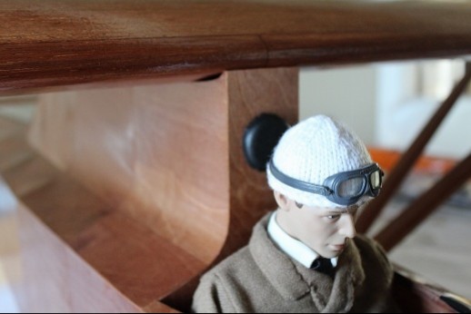

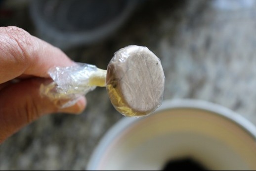

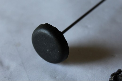

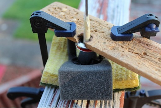

        • I asked my buddy Bill about wet forming leather. Bill is the same friend who helped me put the engine and tranny in the '59 Bug! He is a really good re-curve archer and leather worker! Soak the leather in hot water then stretch it around the form to dry. It'll pretty much hold its shape. It was put on the headrest which is 'cover' for the wing retention system at the pylon! A socket was used to fit over the mold for compression by clamps while leather dried. The same method was used for epoxy cure, too. After the epoxy cured the leather was trimmed with a new X-acto blade. All that is left on this build are seat belts and wing gap covers.

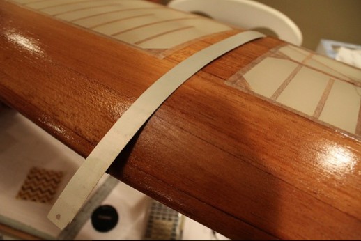

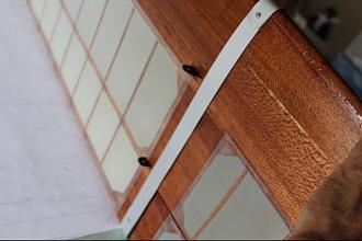

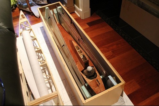

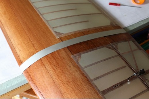

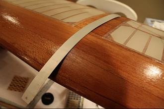

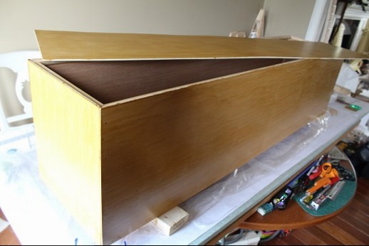

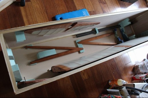

          • Hallo! The Professor is done! The box with foam inserts to hold components is finished. The wing gap covers from lithoplate are finished. The pilot has a seat belt so he won't make an inadvertent dirt dive. The receiver and satellite are in place and all controls wiggle the proper amount in the proper direction. Lastly, the balance is at 28% MAC. 2019 Horizon Aerotow at Muncie Indiana here I come!
