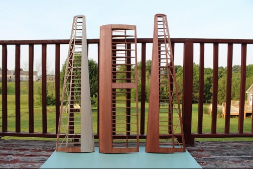

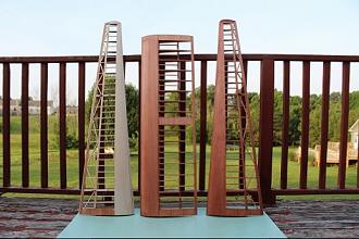

  • Pic shows difference with and without stain. Now just waiting for stain to dry. Will cut ailerons free tonight and start covering everything. I'm still waiting on the UPS delivery of spruce in order to make struts.

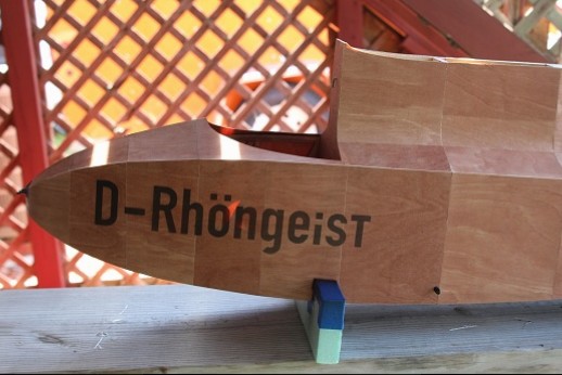

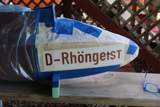

    Stencils arrived from Callie Graphics and were put to immediate use! Vinyl(the masks) and dope(thinners) aren't very compatible so extremely light mist coats were sprayed with a good five minutes between each coat. After an hour and a half...it was done! BTW...Vinyl doesn't stick well to wood so I had to continually rub the stencils onto the surface... even while spraying. It was a 'ticklish' feat!

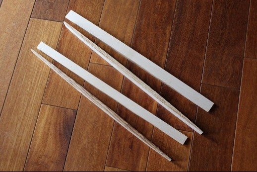

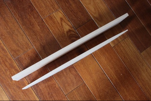

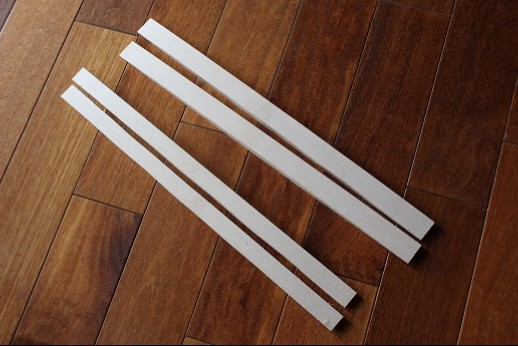

    The spruce stock was delivered the same day as the masks so a start was made on the struts after the painting was done. The spruce was clamped to the workbench outside and a belt sander was applied to each end on both sides creating a taper. Rough strut blanks were then cut from the stock. The fore struts (~540mm long) are a little wider the the aft ones(~560mm long). They will require more sanding to get an airfoil shape then fittings will get let into their ends.

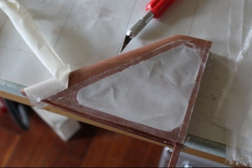

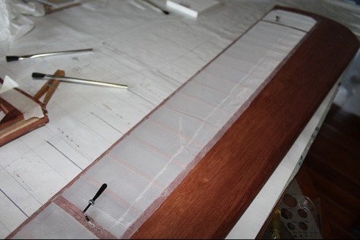

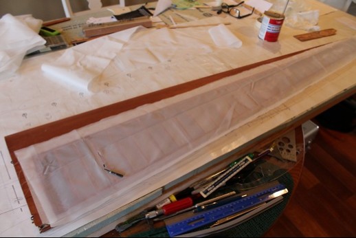

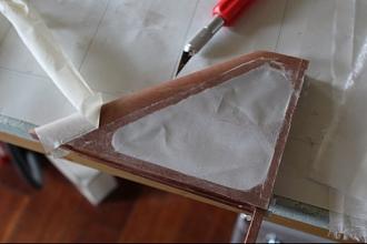

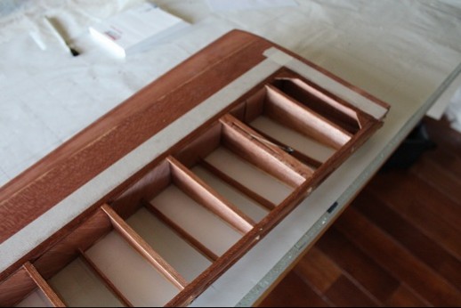

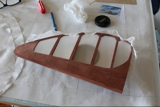

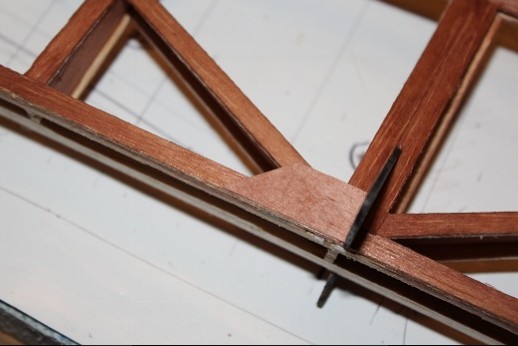

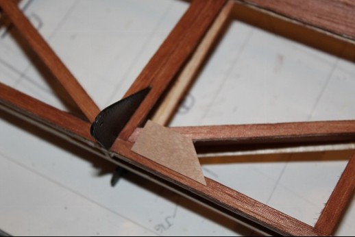

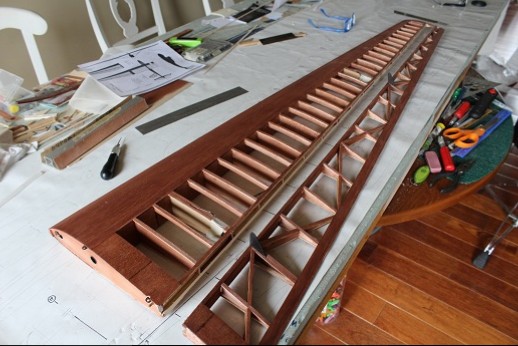

          • Back to hobby! The ailerons were cut free from the wings. The forgotten gussets were added to the center section, outer panels and ailerons...all ~88 or so of them! Fabric was sized and cut... 10 pieces for the wings and 6 pieces for the tail feathers. Masking tape was laid down to delineate were the adhesive (Stix-It) goes. The top of the ribs don't need adhesive but the undercambered portion of the wings do. After attaching fabric a new X-acto blade is used to cut excess fabric away using the masking tape as a guide. It works really well. When all panels are covered I'll use the iron to get rid of fold-lines in the fabric. For the most part, the fabric is pretty tight without heat and dope will tighten it a bit more.

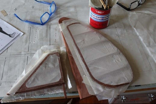

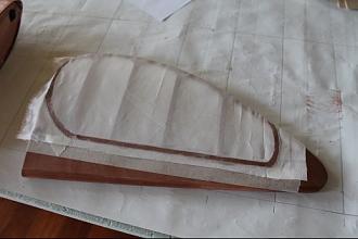

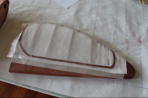

            • More pictures... the first just shows the fabric being sized but before any adhesive put on it. The second shows fabric glued on and excess trimmed away. It just needs a little tightening with heat.

              The last pic shows fabric in place waiting for excess to get cut away using masking tape as a guide.
