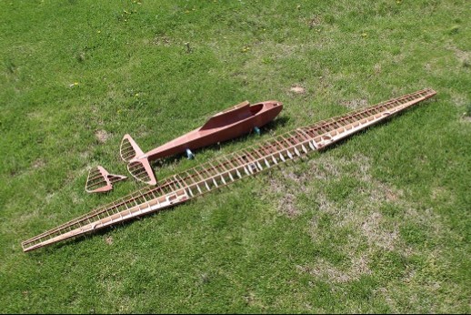

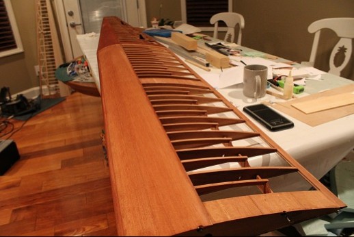

1:4 1928 RRG Professor

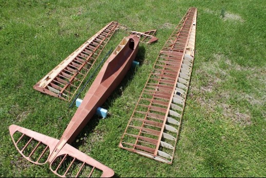

  • Some 'outdoorsy' pics!
ID:	25607Click image for larger version
    Good night!

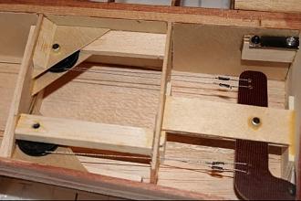

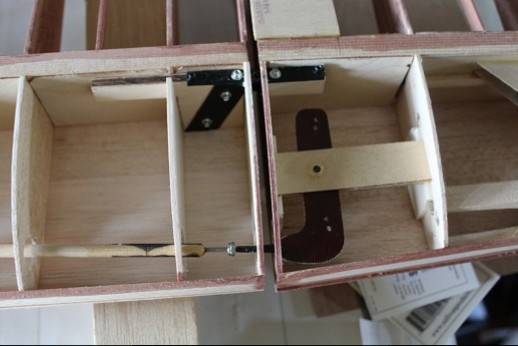

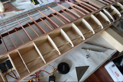

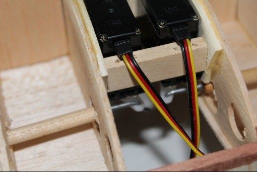

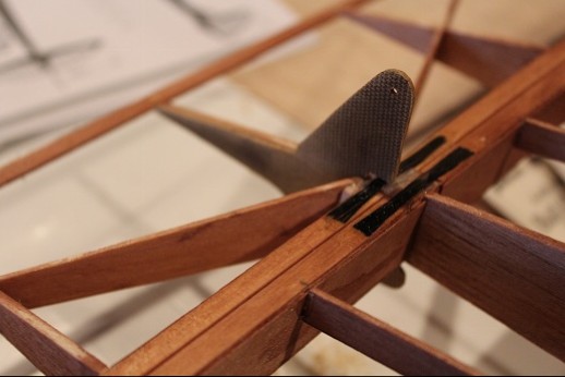

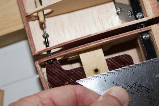

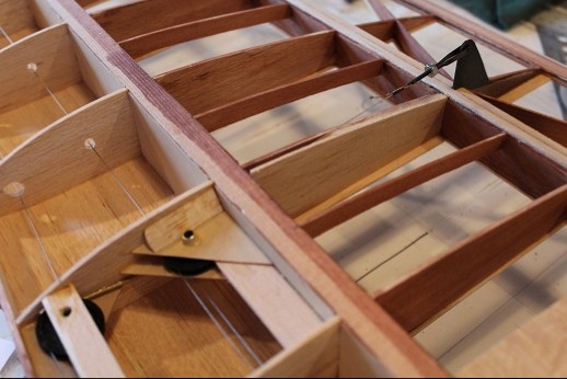

  • Sorry for no activity. The post surgical swelling on my nose has gone down enough that I can wear glasses to see to do stuff! Actually, I have a string tied to the glasses to fit over the top of my head and to keep the glasses up off the bridge of my nose. It's still pretty swollen and tender. Oh well... could be worse!
    The wing parts were assembled, the receiver powered up and servos were 'centered' then push rods were fabricated for the center wing section and set up to 'square' the bell cranks located in the outer wing sections. After this lock nuts were used to set the clevis locations. The routes for the push rods were cleaned up so that no rubbing occurs. The servo arms were adjusted so that more 'up' than 'down' movement is possible, i.e., differential. This works really well on the Eaglet so is the reason for the repeat performance, here! Paper patterns were used to fabricate phenolic items. I just can't tell from the photos what the full scale horns were made.The hole spacing for the cables is 60mm on the inner horns and 50mm on the outer ones. This spacing matches that of the bell cranks. A bit of Ackerman-like geometry is built into the design. More to come just no pictures taken. The ribs are currently getting cap stripped and the cables will be connected very soon.

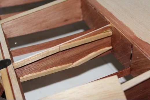

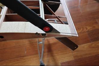

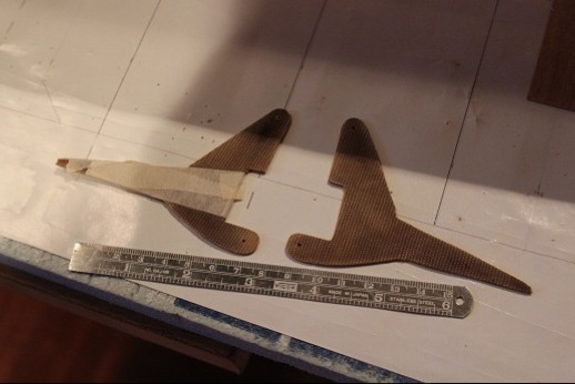

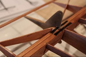

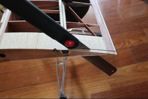

      • Thanks Al! This nose of mine has certainly put the brakes on the build. I couldn't wear glasses for a week my nose was so swollen. Oh well... More stuff. The ribs that have the cable fairleads were built 'out' at their surface so that covering will have purchase. Hard points were installed to attach gap covers (not shown). I'm waiting for shackles from www.harbormodels.com before the wings get closed. The shackles connect the cables to the aileron horns. Different sizes (lengths) were purchased so that 'fine tuning' the ailerons' cable tension can be done. The aileron roots ends were cut but the ailerons won't be cut free from the wings until after the cables are installed. So... while waiting for the shackles to arrive the wing was put onto the fuselage so that the struts lengths can be determined. I don't have enough Bass wood so need to order some. I may go ahead and use Spruce and order that from Aircraft Spruce and Specialty. The last pic shows how the pushrod from the center section connects to the bell crank in the outer panel. Don't ask me why these pics are of different sizes. They all get edited the same way.

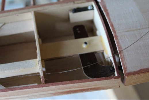

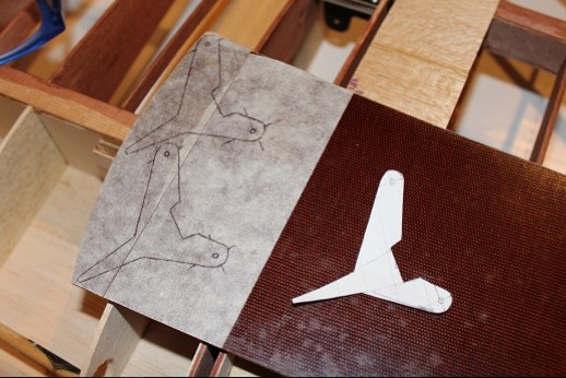

        • All the pull-pull aileron cables have been run so the wing can get closed! I decided against the shackles and went with conventional clevis attachments to the horns.

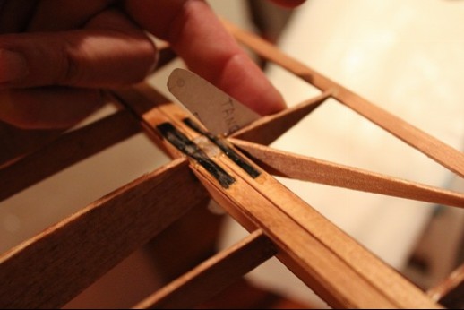

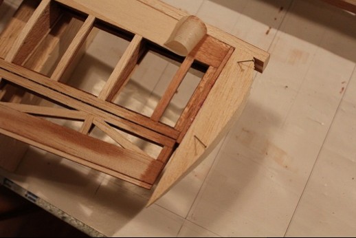

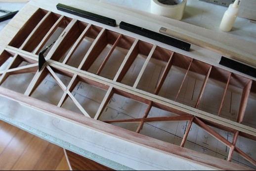

          • Here is the last wing panel with some cap strips in place. It will be done this evening then the LE will get put it place and sanded. It's surely getting down to the wire!

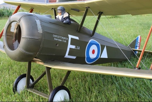

            On a side note: here is a scratch built 1/4 scale DH-5 I hope to finish for the 2018 Dayton Dawn Patrol. I've been working on and off this thing for quite a few years. All scratch built from my own plans. I had to make a mold to make the cowl then make a mold to make the cowl stiffeners. What an ugly but unusual airplane! You don't see these every day!

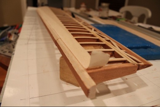

            • The LEs have been installed and rough sanded. The wing tips get put on tonight and faired into the LE of each outer panel then finish sanded tomorrow. The covering will begin and, hopefully, the dope and varnish this weekend. Like I said... it's getting down to the wire!

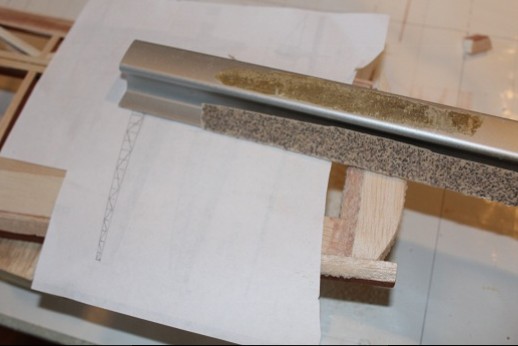

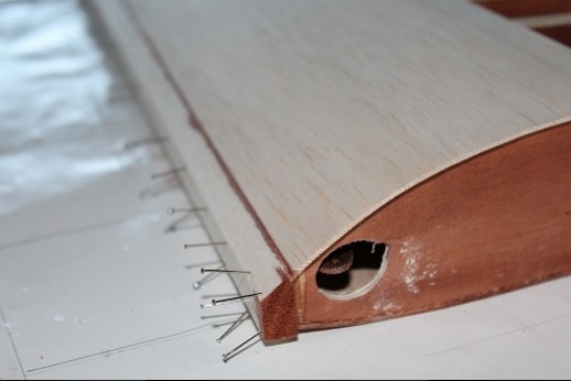

            • Only one outer panel needs its LE and wing tip sanded. That will get done tomorrow AM before work. Masking tape was put along side the LE to guide the sanding process. Paper was used to guide wingtip sanding. I put some stain on the finished panels. I can't wait to start covering! I really enjoy it!
