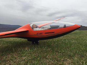

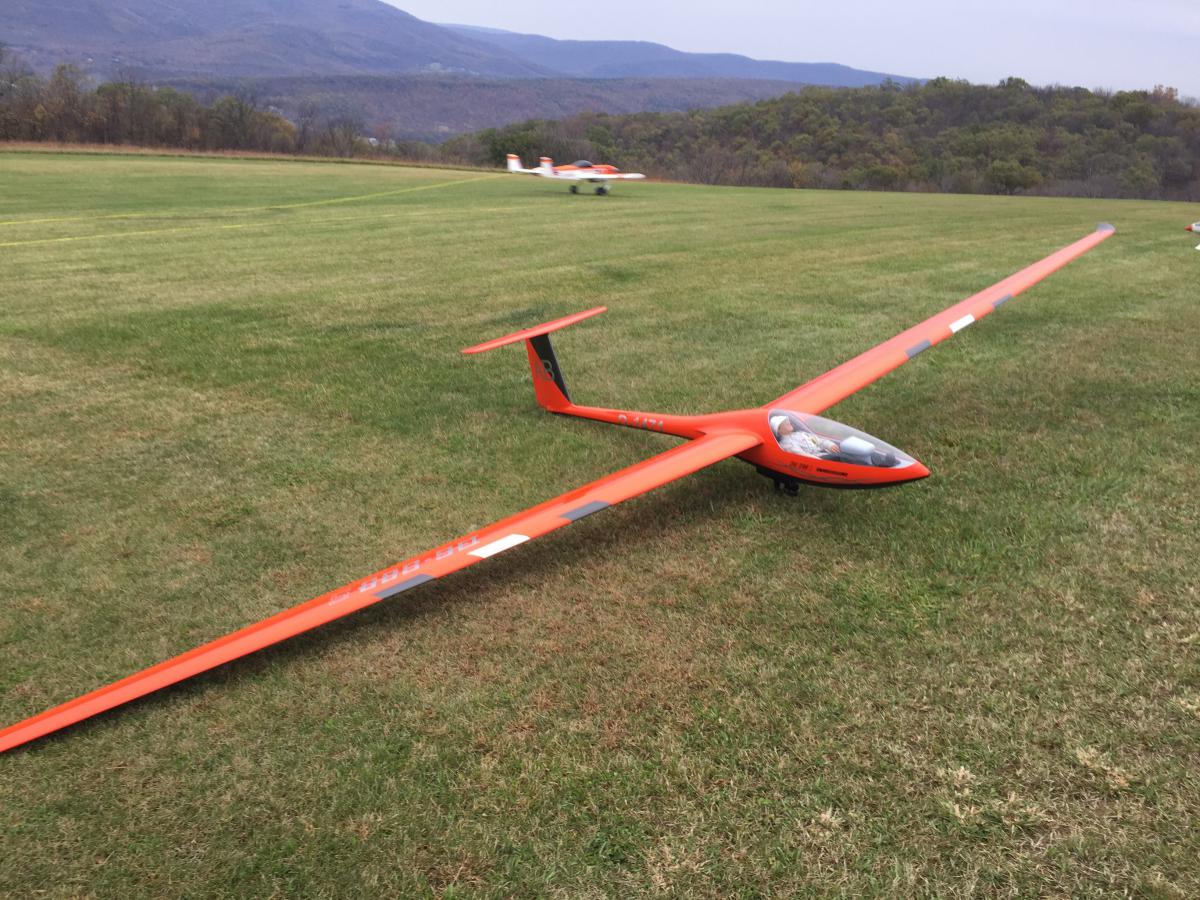

                    Welcome Martin.
                    Love the full scale DG800 !!!
                    Needs a color change to ORANGE?
                    Click image for larger version  Name:	IMG_6979.JPG Views:	0 Size:	156.5 KB ID:	41057 Click image for larger version  Name:	IMG_6974.JPG Views:	0 Size:	196.8 KB ID:	41058

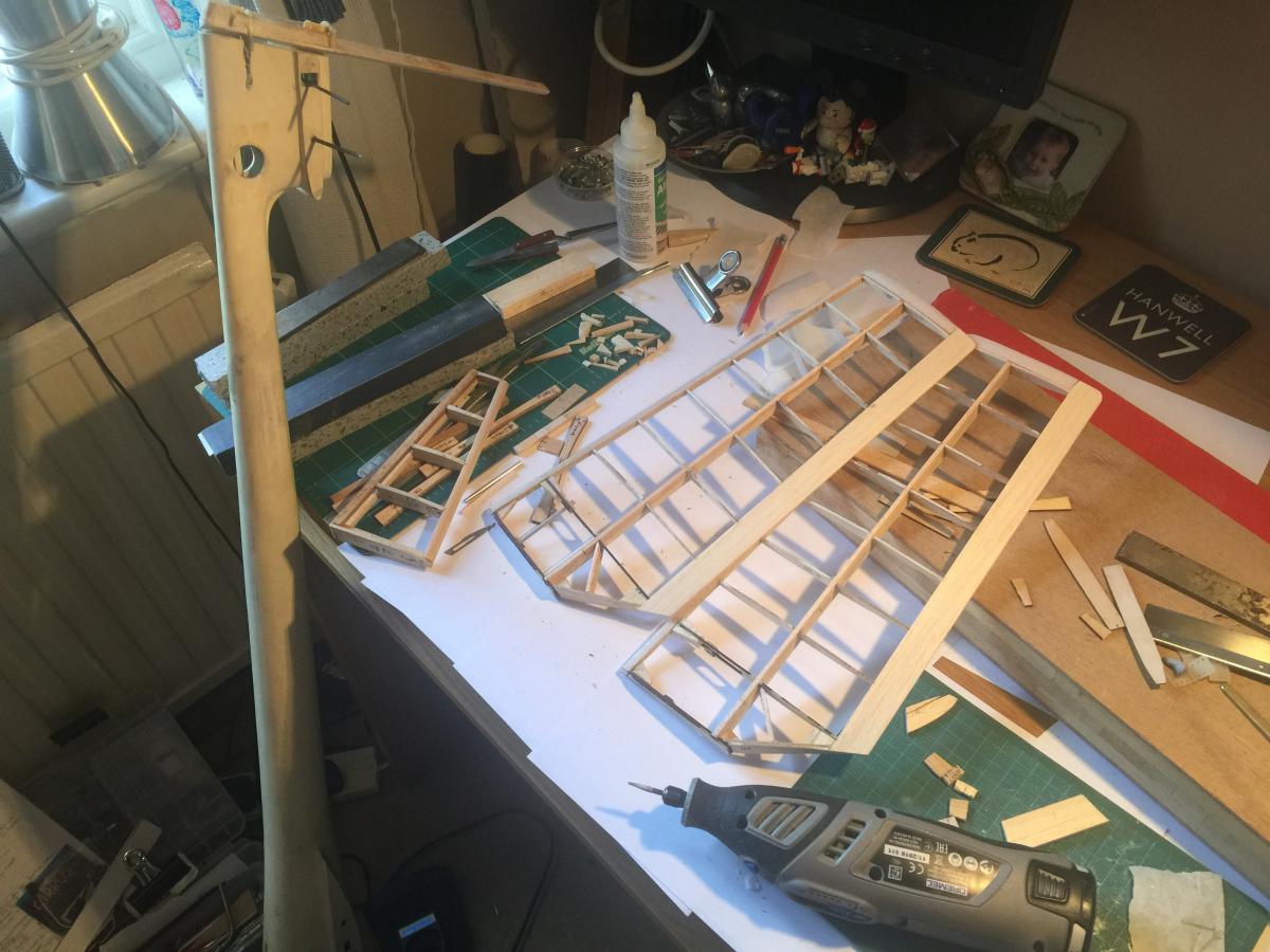

                          My Cirrus stabilzers are virtually complete; Click image for larger version

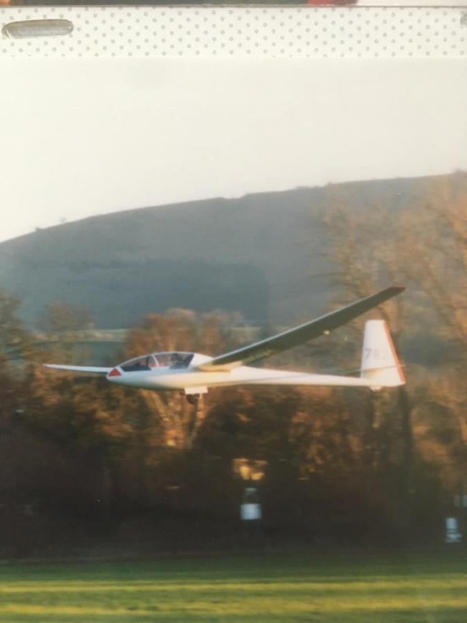

                          Meanwhile - I found some photos to work from from way back of me flying the Cirrus; 1992 Click image for larger version

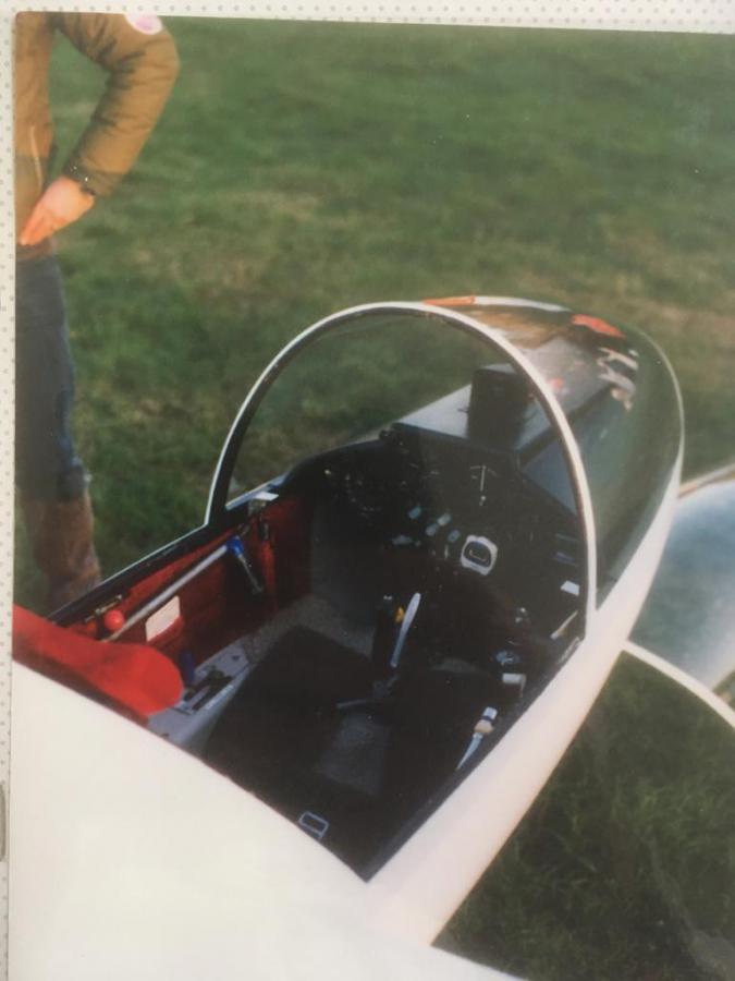

                          Interior shot. Very basic panels in those days - no GPS/moving map, no nuthin!
