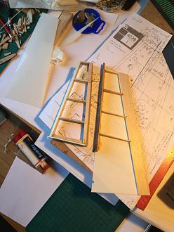

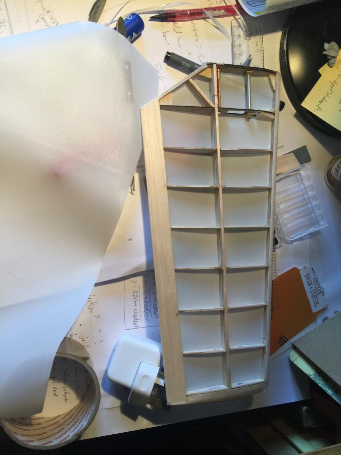

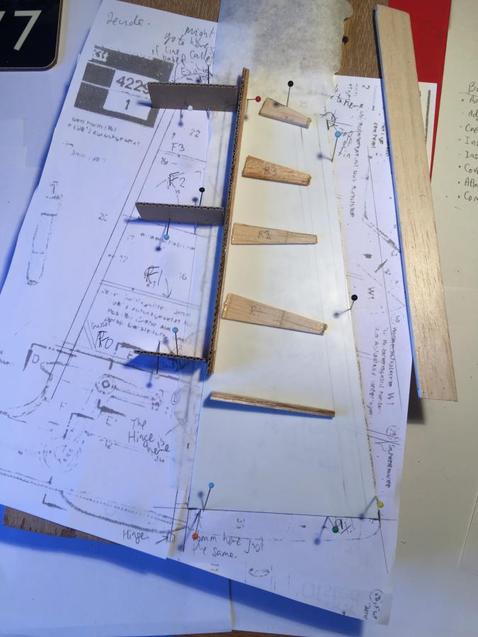

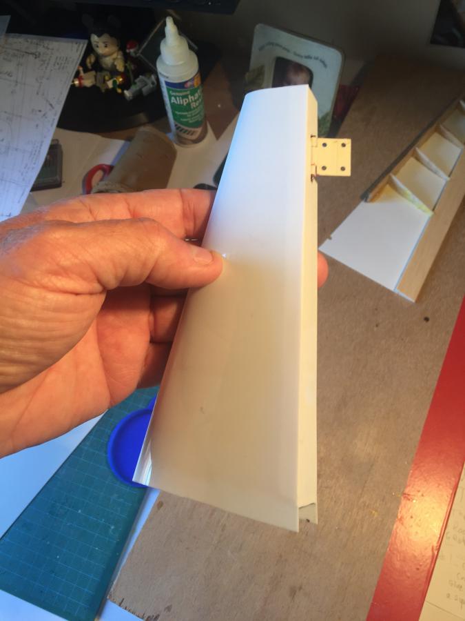

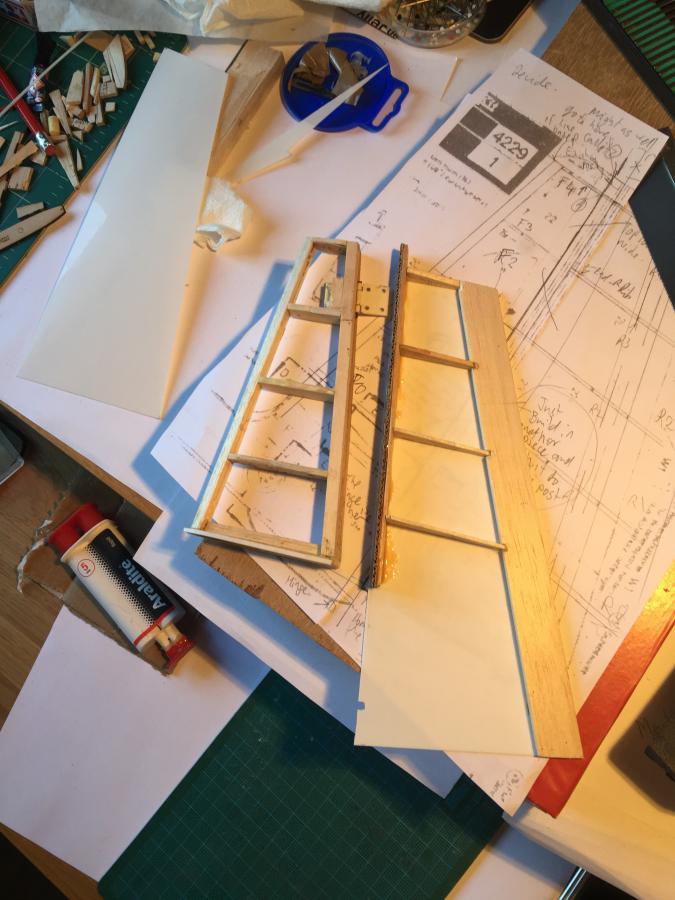

        Meanwhile - my Graupner Cirrus re-furb is crawling along. Working with 0.5mm Plasticard is interesting - but it is too thick to bend to shape in order to form it around the fin. It doesn't take kindly to being heated either and is tricky stuff. So - I am going to attempt to sand down the plasticard so that it is 0.4mm at the point of bending around the leading edge of the fin. Hopefully that will work without it splitting. Then I would glue the sanded side inside the fin and the shiny side on the outside. We'll see how it goes. Then I have the daunting task of stripping off the 35 year old paint from the fuselage, refitting the fin/rudder and re-integrating and refinishing the complete fuselage. Then - even worse - re-kitting the wings. Phew!

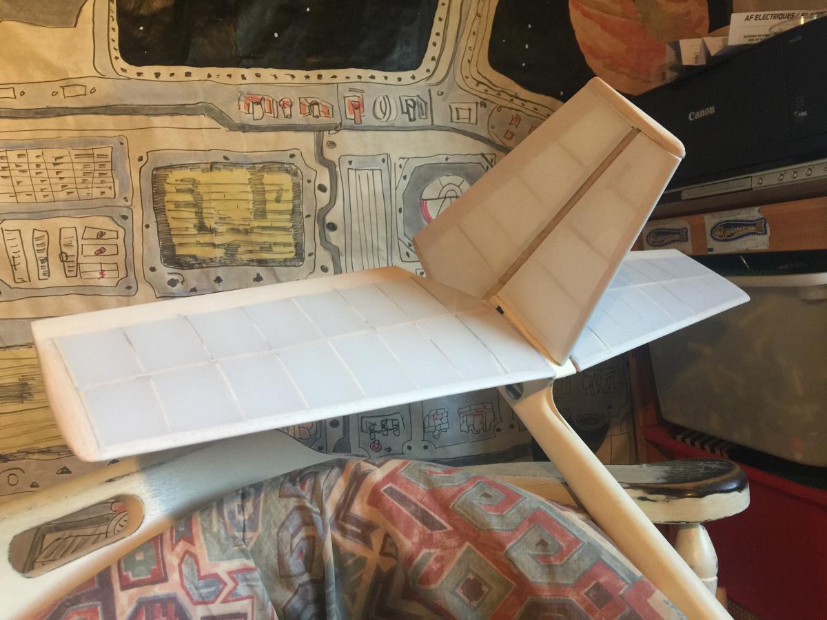

              I'm pleased to be triggering memories of some very interesting prototypes; HP-14, Slingsby T65 Vega. I remember seeing a stunning 1;4 HP-14 at Ivinghoe in about 1985. It was too beautiful! Modelling definitely inspired me to take up the real thing!

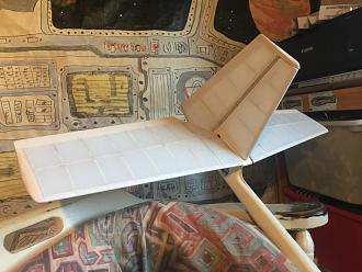

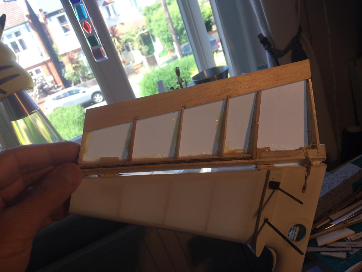

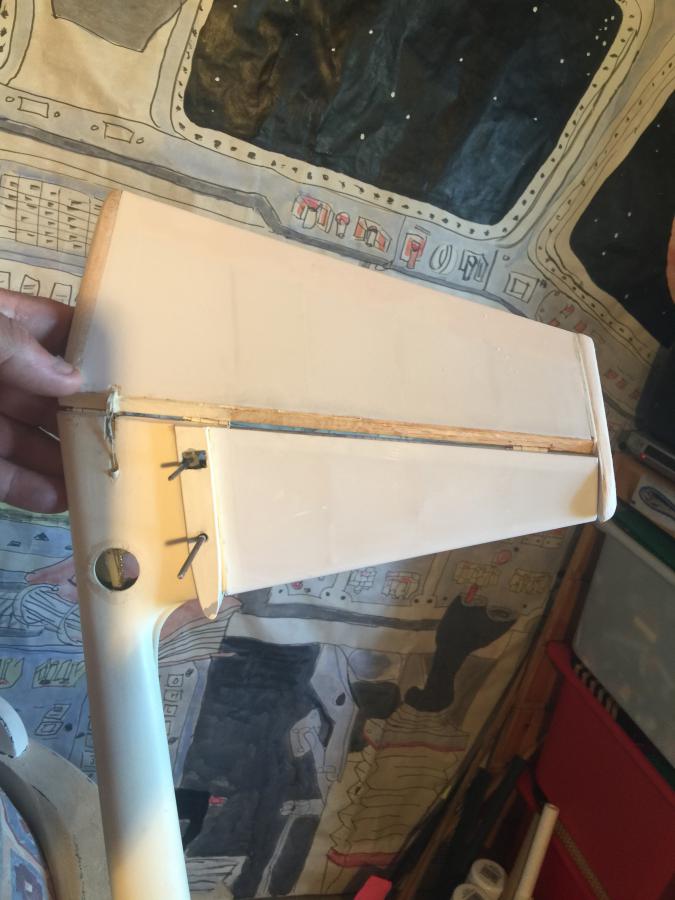

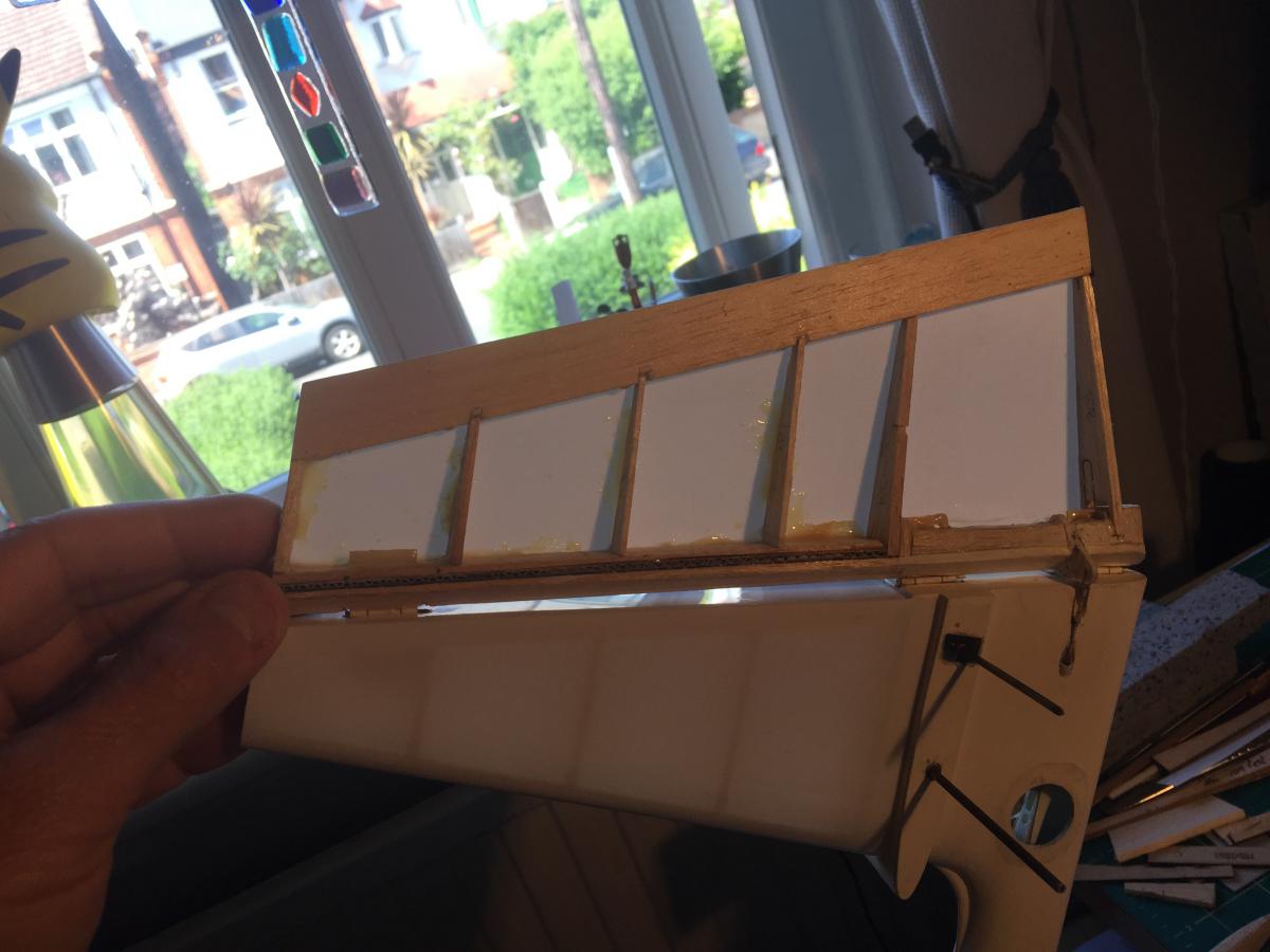

ID:	41368Meanwhile, I have finished the tail feathers of my Cirrus. I'm quite pleased with it - even down to the balance tab on the rudder.Click image for larger version

              So - the fuselage is complete. I am now re-equipping with modern elevator and rudder servos - re-siting those servos much further forward (old 1970's/80s 27MHz radio was sooo bulky!) and beginning to think about re-kitting the wings with ailerons and Schempp-Hirth type brakes. I have obtained the 185mm electric brakes from Topmodel.fr and they look and work brilliant!
