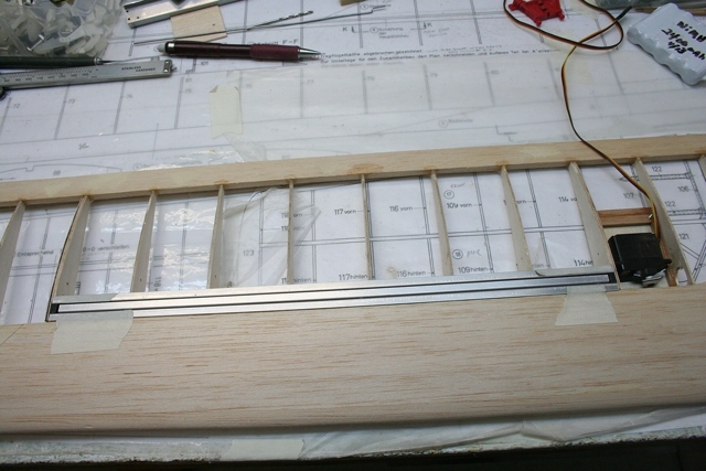

    Update: The horizontal stabilizers are built very light and delicate and were getting hanger rash so I went ahead and covered them. I also got the aileron and spoiler servos installed in the right wing.
    I think this set of stabs will go on one of the other ships and I will make a set without the dihedral for this one.

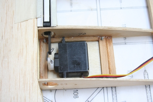

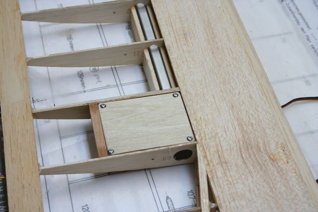

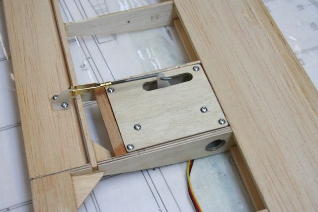

    Here is the spoiler setup.
    There wasn't enough room for mounting blocks for the servo so I glued it directly to the hatch cover.

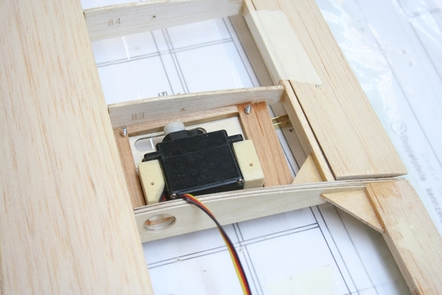

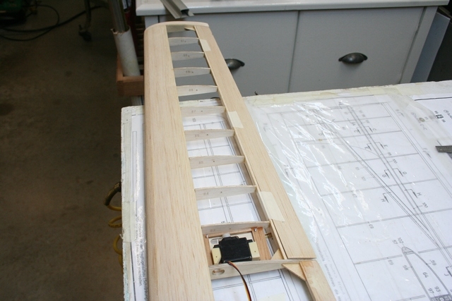

    The aileron setup is pretty standard stuff.

      Looks like a tricky little devil to get set up.
      • ingrahal
        ingrahal commented
        Hey Len, not too bad, just a little head scratching. The aileron servo wire will have to be routed around the spoiler linkage and installed prior to covering. No pulling it through with a string after covering.

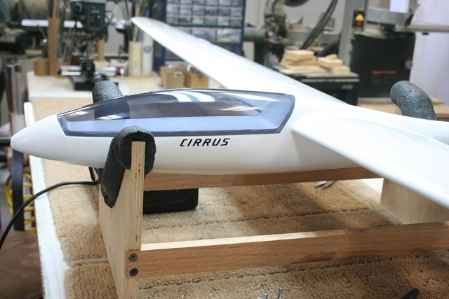

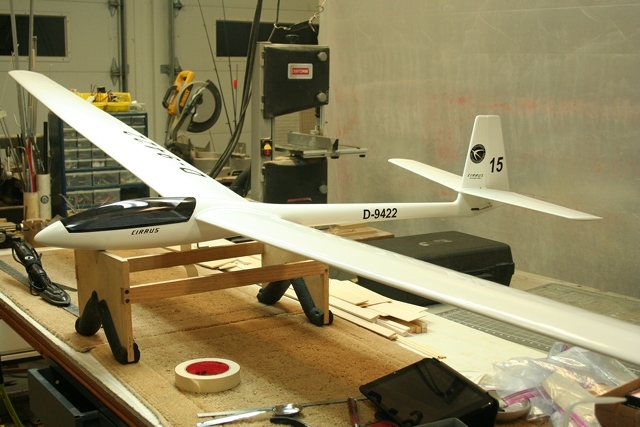

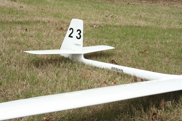

          Cirrus #1 is done!!!

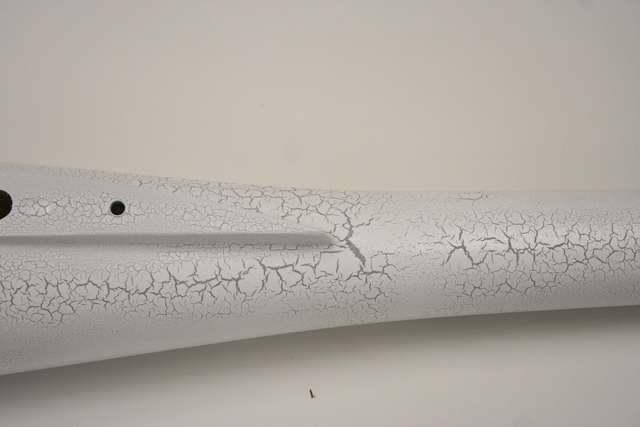

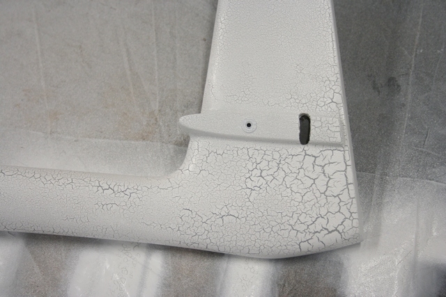

          The painting didn't go so well at first. The primer that John sent with the white is not compatible. I'll have to let him know. Click image for larger version  Name:	640IMG_4470resize.jpg Views:	1 Size:	140.9 KB ID:	15821
          Click image for larger version  Name:	640IMG_4471resize.jpg Views:	1 Size:	196.1 KB ID:	15822
          After stripping it all down and just painting the white it turned out fine. Click image for larger version  Name:	640IMG_4472resize.jpg Views:	1 Size:	203.1 KB ID:	15823

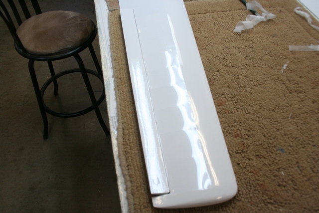

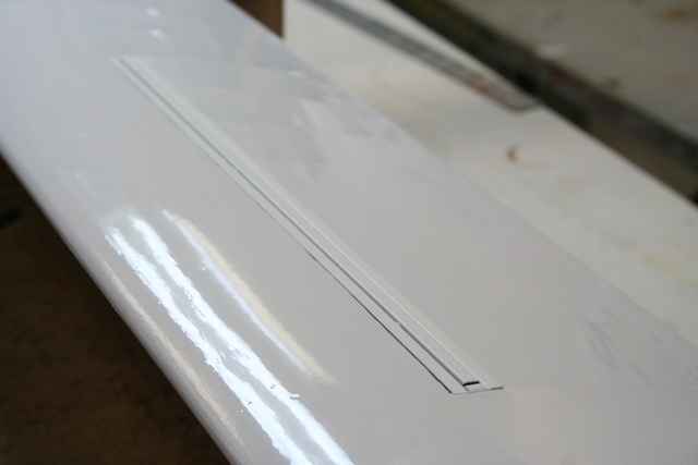

          Here the spoilers are being glued in with RC56 canopy glue and my trusty ammo boxes for weight. I may regret gluing them, time will tell. Click image for larger version  Name:	640IMG_4473resize.jpg Views:	1 Size:	185.1 KB ID:	15824

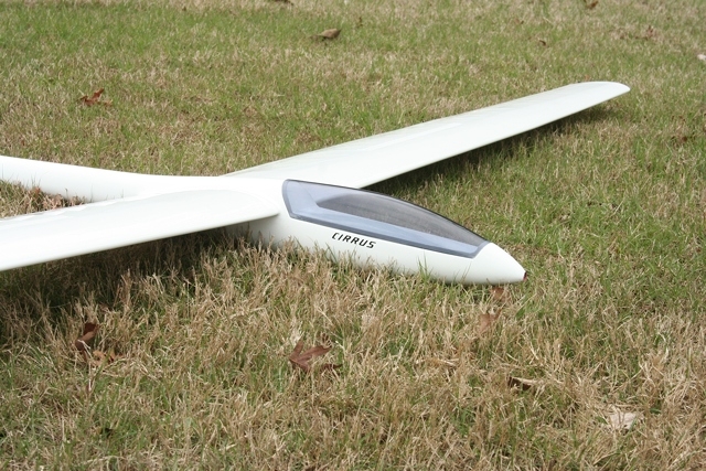

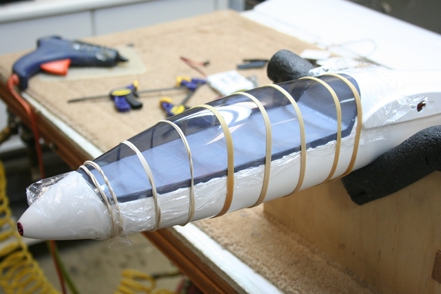

          I vacuum formed the canopies out of PETG and tinted them with Jacquard iDye Poly Synthetic Fiber Fabric Dye Black. It is much harder to get a nice even tint than it was with Rit dye on acetate. Balsa canopy frame painted white and RC56 glue.
          Click image for larger version  Name:	640IMG_4474resize.jpg Views:	1 Size:	170.0 KB ID:	15825

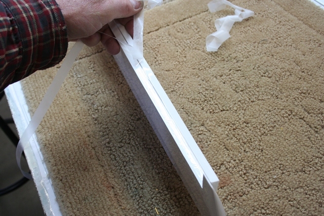

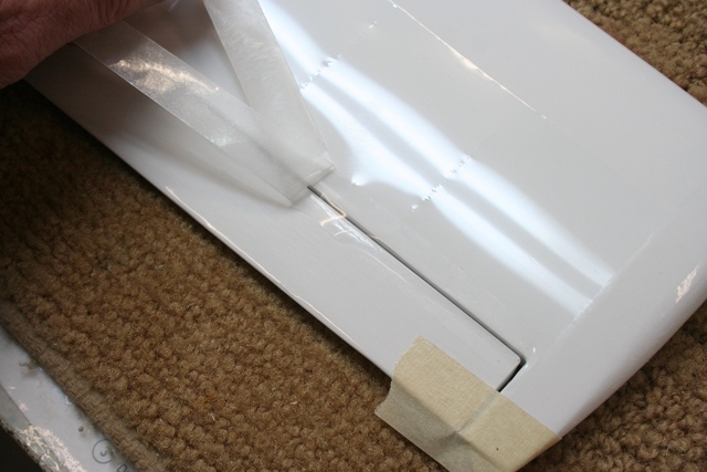

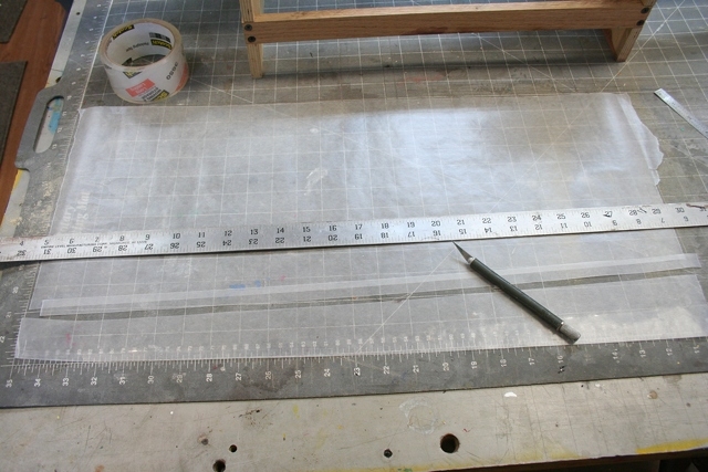

          I thought I would share my method for packing tape hinges. I've used this hinge some lately and it seems to work pretty good. Lay out a piece of wax paper. Then lay a strip of packing tape down on the wax paper nice and smooth. Now cut the appropriate width strip using a straight edge and hobby knife. Now you have a peel and stick piece of tape. Being careful not to get dust, dirt or fingerprints on the sticky side apply the tape to both sides of the control surface. Click image for larger version  Name:	640IMG_4475resize.jpg Views:	1 Size:	204.8 KB ID:	15826
          Click image for larger version  Name:	640IMG_4476resize.jpg Views:	1 Size:	168.5 KB ID:	15827
          Click image for larger version  Name:	640IMG_4477resize.jpg Views:	1 Size:	247.7 KB ID:	15828
          Click image for larger version  Name:	640IMG_4478resize.jpg Views:	1 Size:	174.1 KB ID:	15829

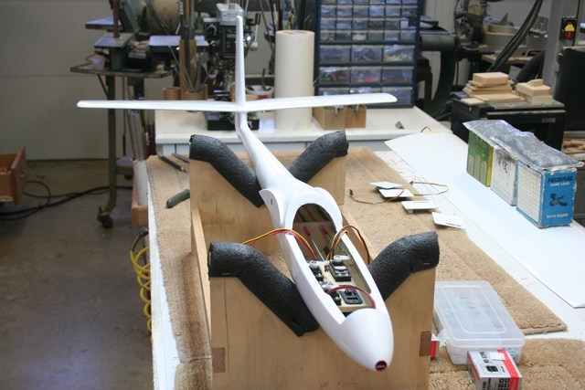

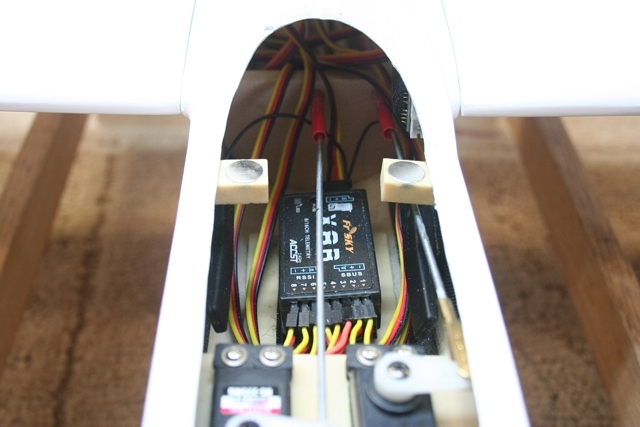

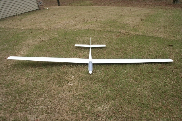

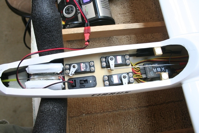

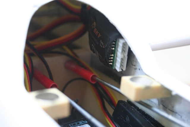

            It was a tight fit but I managed to fit all the radio gear in there. I made a U shaped battery pack to accommodate the tow release. The outdoor photos aren't great it was a very cloudy dark day. Click image for larger version  Name:	640IMG_4481resize.jpg Views:	1 Size:	210.4 KB ID:	15833
            Click image for larger version  Name:	640IMG_4483resize.jpg Views:	1 Size:	105.8 KB ID:	15834
            Click image for larger version  Name:	640IMG_4484resize.jpg Views:	1 Size:	137.9 KB ID:	15835
            Click image for larger version  Name:	640IMG_4485resize.jpg Views:	1 Size:	191.5 KB ID:	15836
            Click image for larger version  Name:	640IMG_4491resize.jpg Views:	1 Size:	301.6 KB ID:	15837
            Click image for larger version  Name:	640IMG_4492resize.jpg Views:	1 Size:	289.5 KB ID:	15838
            Click image for larger version  Name:	640IMG_4493resize.jpg Views:	1 Size:	303.0 KB ID:	15839
            Click image for larger version  Name:	640IMG_4494resize.jpg Views:	1 Size:	273.9 KB ID:	15840
            Click image for larger version  Name:	640IMG_4495resize.jpg Views:	1 Size:	291.1 KB ID:	15841
            Now on to building the other two. They will be much more simple. Just rudder/elevator and tow hook. The only modification on them will be the straight wing rods.

            The crinkly crackly paint effect looks great on some furniture! Your finished Cirrus is very nice and elegant!
            • #39
              Thanks Michael. Yeah not the effect I was going for. Freaked me out as you can imagine. I'm happy with the outcome and can't wait to see how she flies. My only complaint is that Graupner didn't make the forward fuselage more scale. Would have helped make more room for the electronics too.

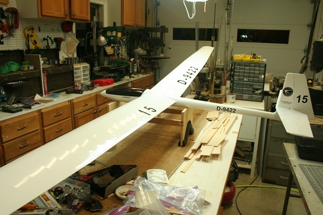

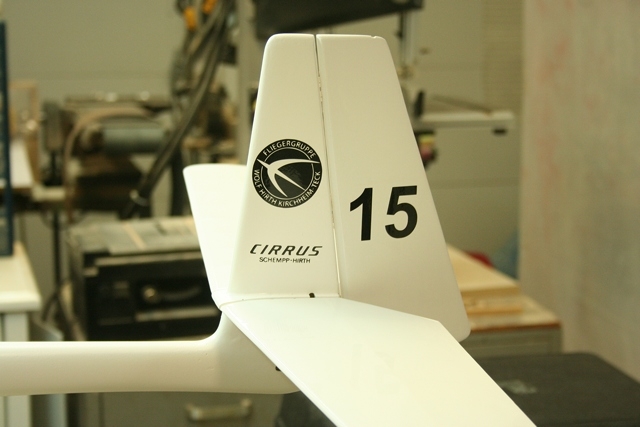

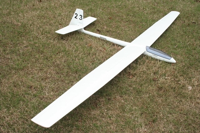

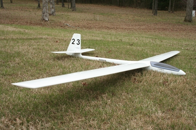

                      Cirrus #2 is done. Thought I'd post some pics of the second one in this project.
                      One more to go in the Cirrus marathon!!! There is a good chance that #1 will be maidened this weekend.
