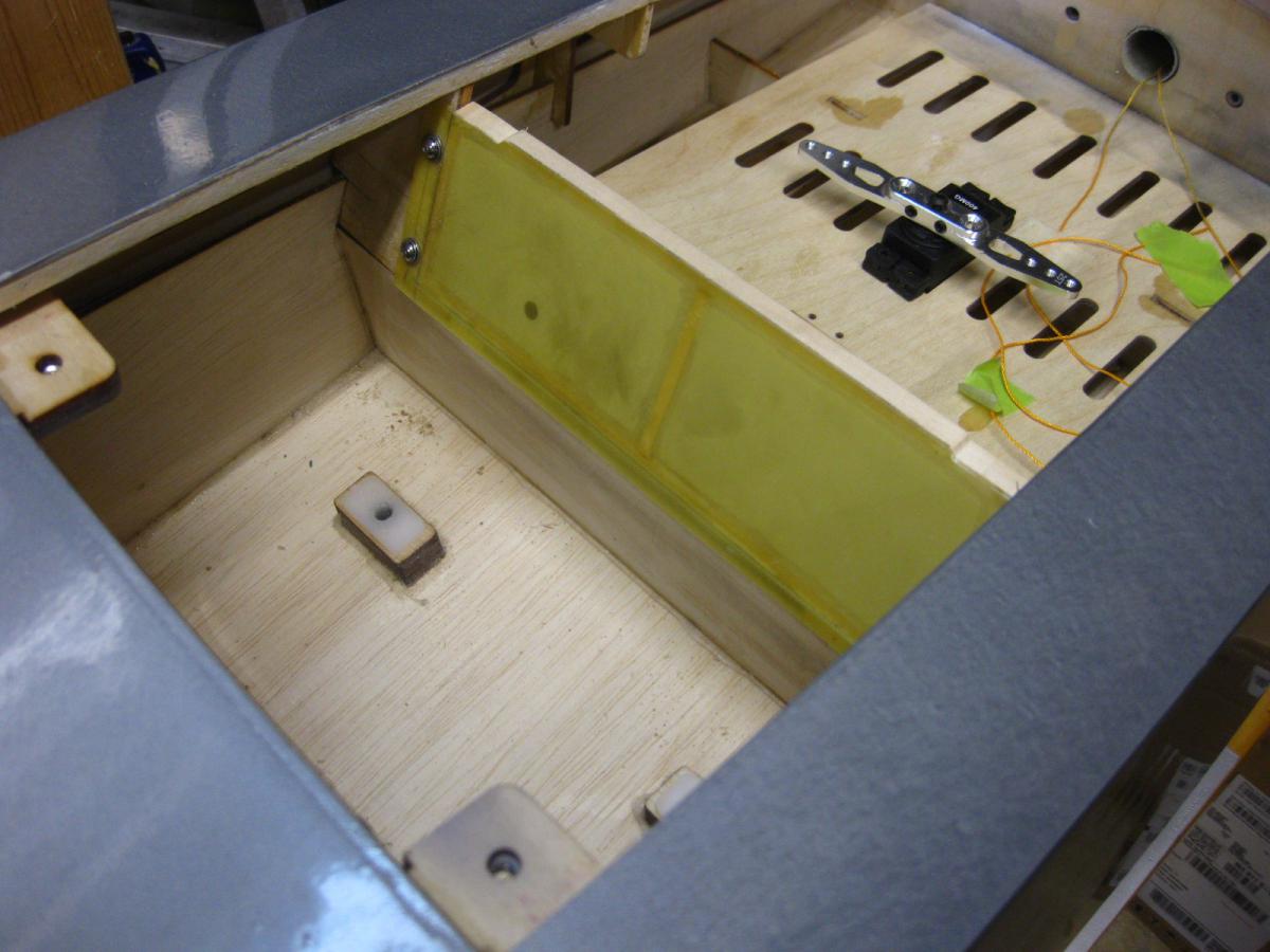

                              • #60
                                Sealing off the receiver compartment from the canister hot air exit
