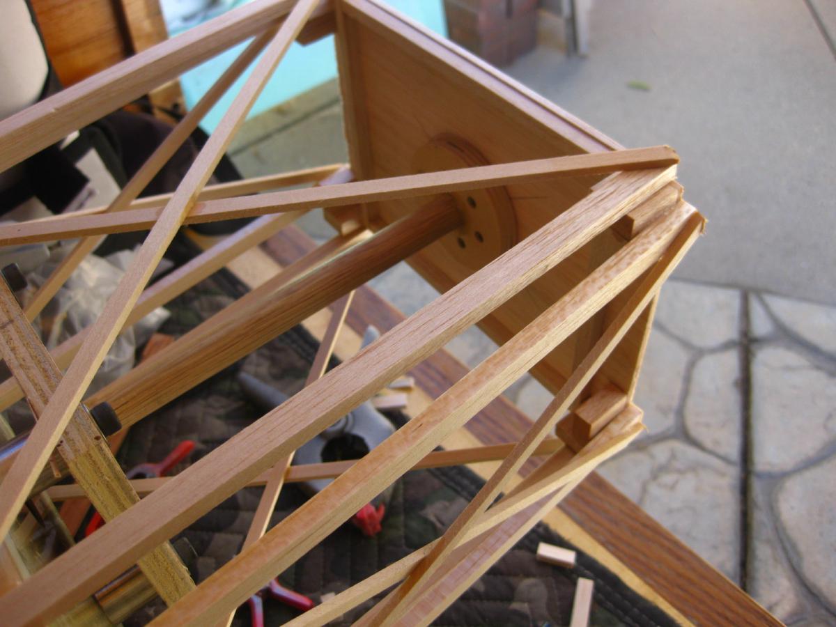

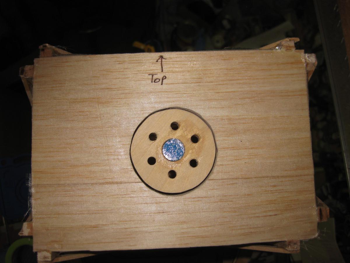

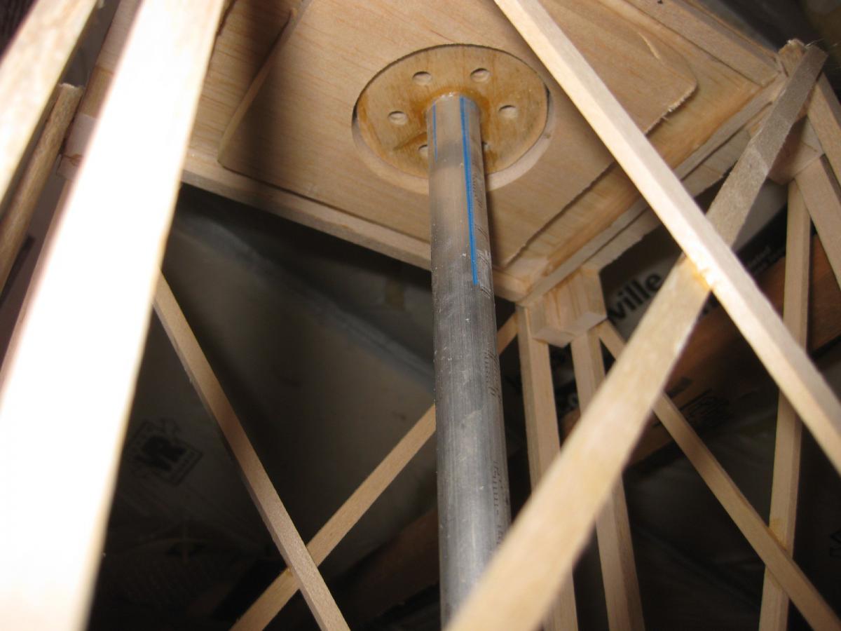

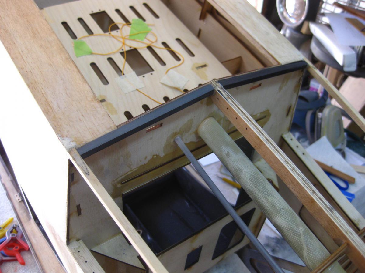

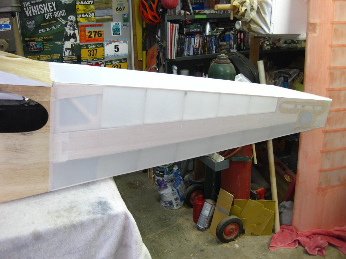

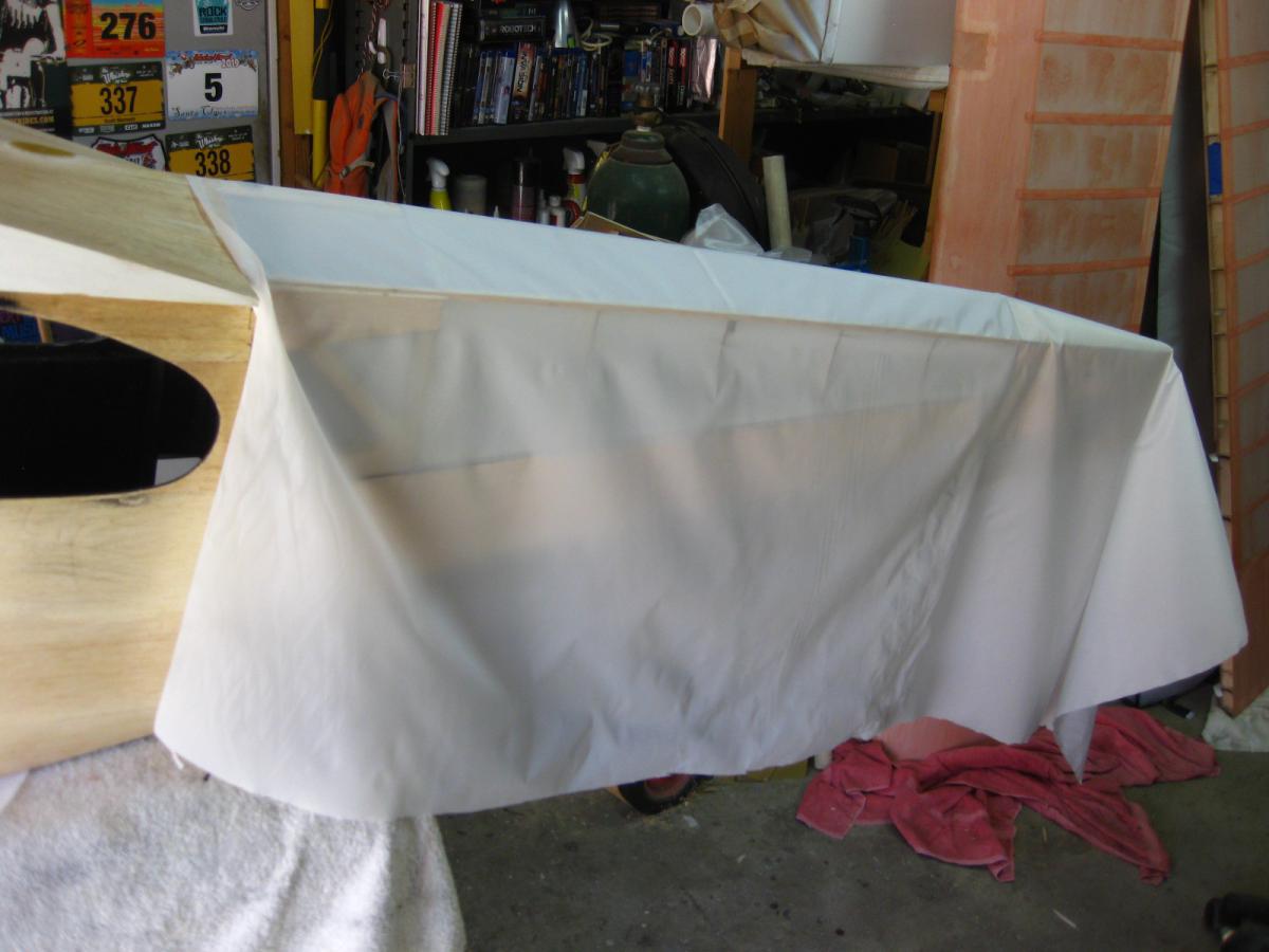

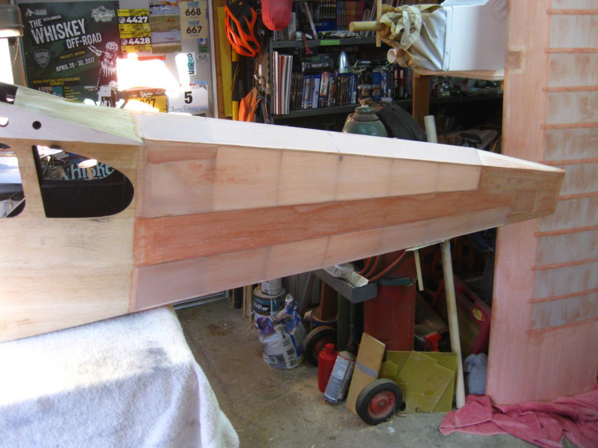

    Added some reinforcing to the lower rear hatch with some carbon square "rod" that I had on hand. Then added fabric.
    Click image for larger version  Name:	IMG_6031.JPG Views:	23 Size:	116.3 KB ID:	45466 Click image for larger version  Name:	IMG_6032.JPG Views:	24 Size:	135.1 KB ID:	45468
    Click image for larger version  Name:	IMG_6033.JPG Views:	24 Size:	86.0 KB ID:	45467 Click image for larger version  Name:	IMG_6035.JPG Views:	27 Size:	115.5 KB ID:	45464
    Poly-Brush to seal the fabric. Pre-coated the center section to seal the balsa
    Click image for larger version  Name:	IMG_6036.JPG Views:	24 Size:	117.3 KB ID:	45465

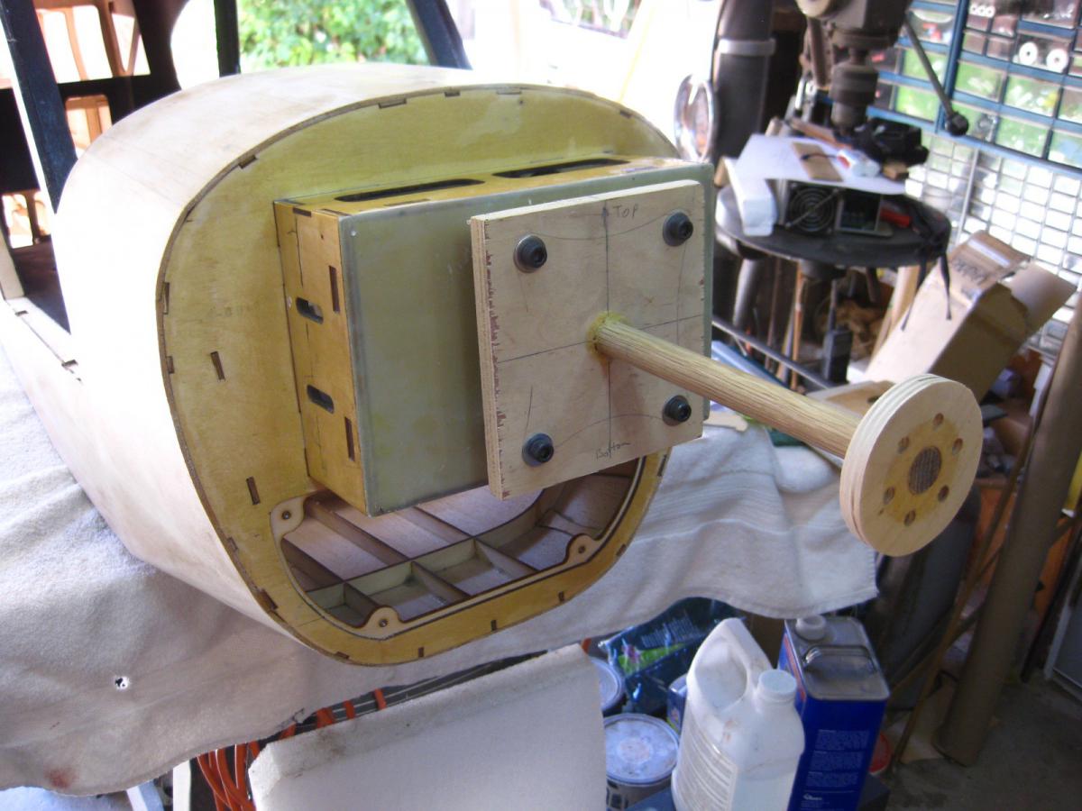

      DLE-222 installation / conversion
      Mounting a "dummy" 170 template to get the prop hub position and check the cowl alignment.
      Click image for larger version  Name:	IMG_6038.JPG Views:	0 Size:	100.8 KB ID:	45482 Click image for larger version  Name:	IMG_6039.JPG Views:	0 Size:	118.8 KB ID:	45485
      Click image for larger version  Name:	IMG_6040.JPG Views:	0 Size:	119.0 KB ID:	45484 Click image for larger version  Name:	IMG_6042.JPG Views:	0 Size:	65.1 KB ID:	45480
      Click image for larger version  Name:	image_18149.jpg Views:	59 Size:	109.2 KB ID:	45481 Click image for larger version  Name:	image_18151.jpg Views:	60 Size:	56.7 KB ID:	45483

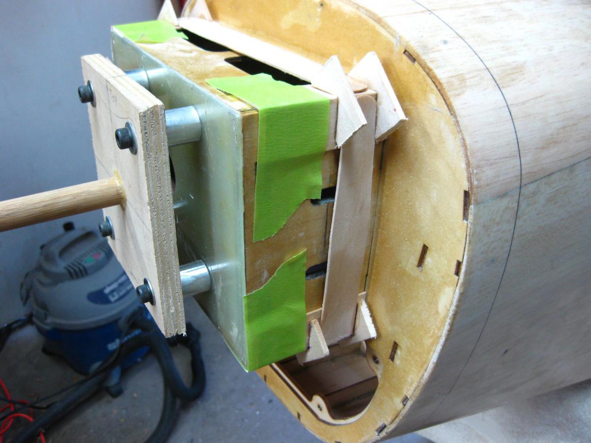

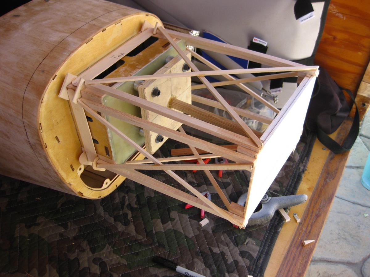

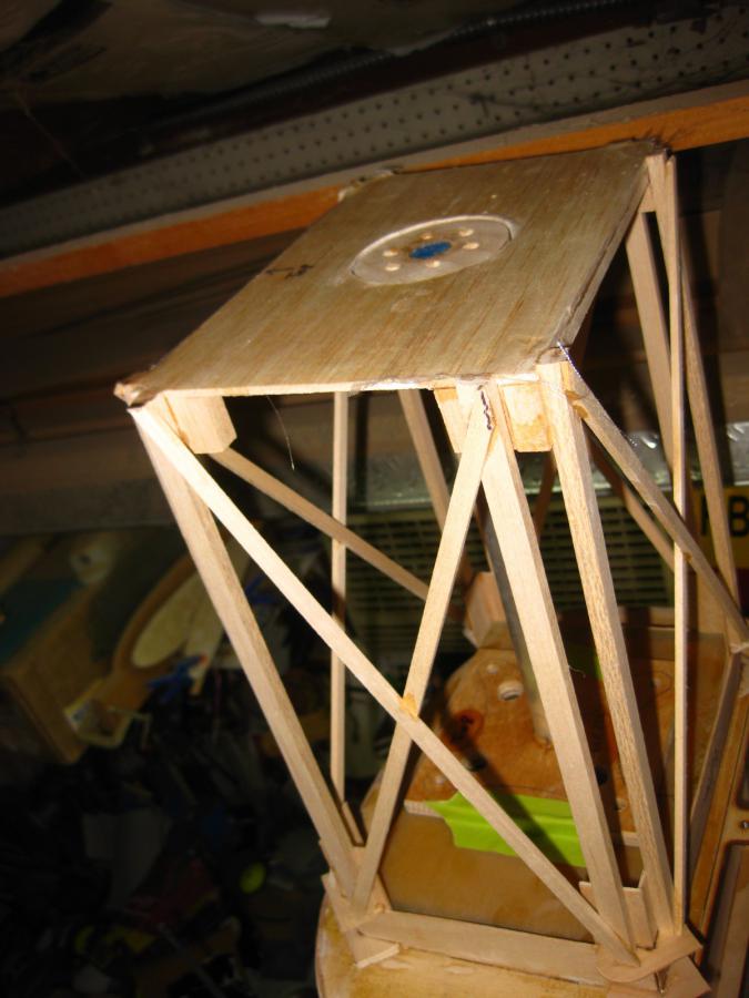

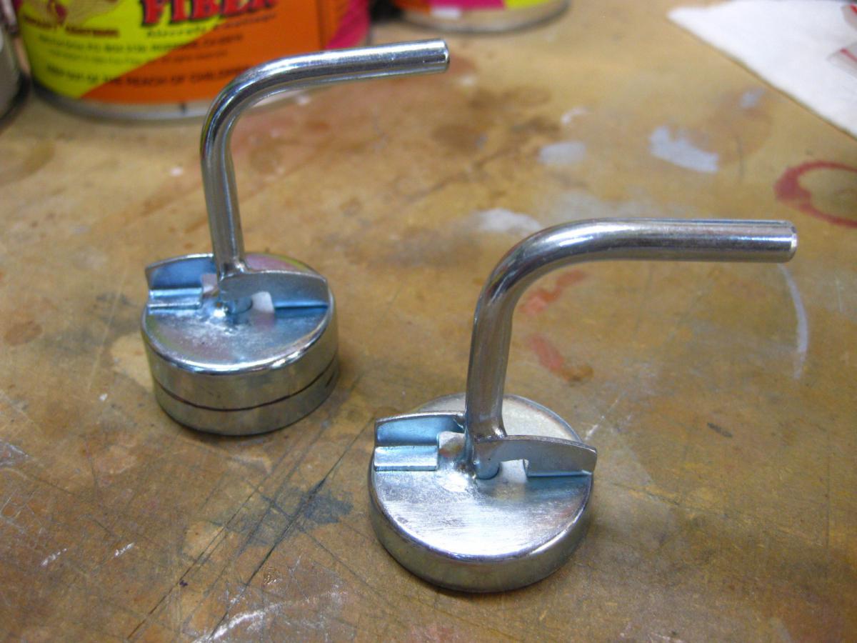

      Starting on the JIG using "tounge depressors" popsicle sticks. Hopefully it will just slide on and off.
      Click image for larger version  Name:	IMG_6047.JPG Views:	0 Size:	109.5 KB ID:	45486
        JIG to capture the prop hub location using the engine box / firewall as a reference.
        Click image for larger version  Name:	IMG_6048.JPG Views:	43 Size:	128.4 KB ID:	45507 Click image for larger version  Name:	IMG_6049.JPG Views:	43 Size:	110.3 KB ID:	45505
        The DLE-222 "Dummy" engine ( 261mm long )
        Click image for larger version  Name:	IMG_6050.JPG Views:	44 Size:	67.7 KB ID:	45508
        49 mm removed
        Click image for larger version  Name:	IMG_6051.JPG Views:	43 Size:	116.5 KB ID:	45506

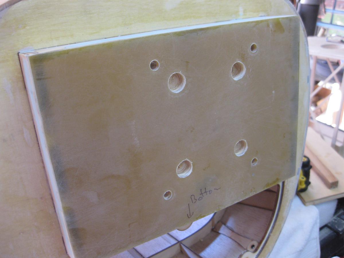

        Firewall installation

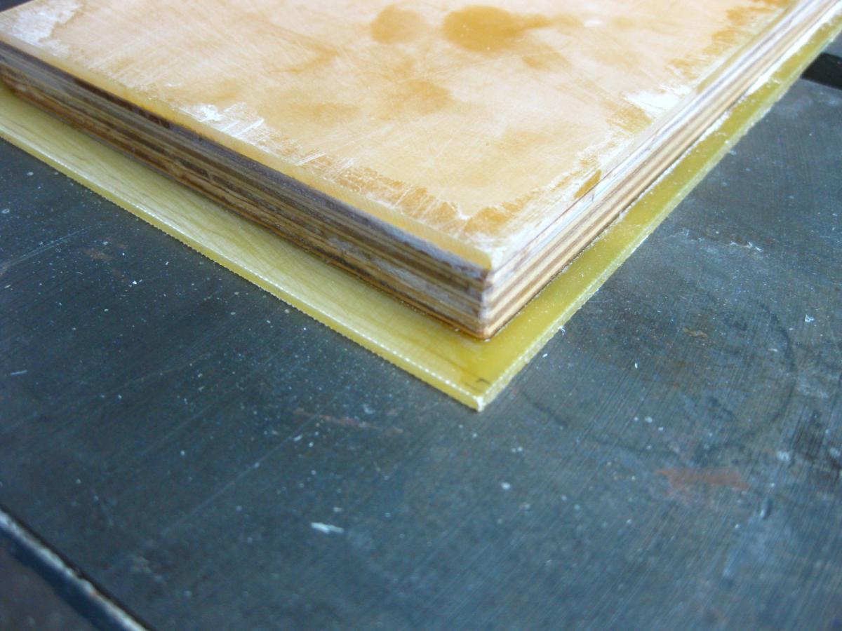

        4 layers of 1/8" Baltic birch glued together with Gorilla wood glue
        Outer layers are 0.90 G10 material - on the original firewall was 0.60 G10.
        Click image for larger version  Name:	IMG_6057.JPG Views:	23 Size:	77.0 KB ID:	45534 Click image for larger version  Name:	IMG_6059.JPG Views:	23 Size:	112.8 KB ID:	45537

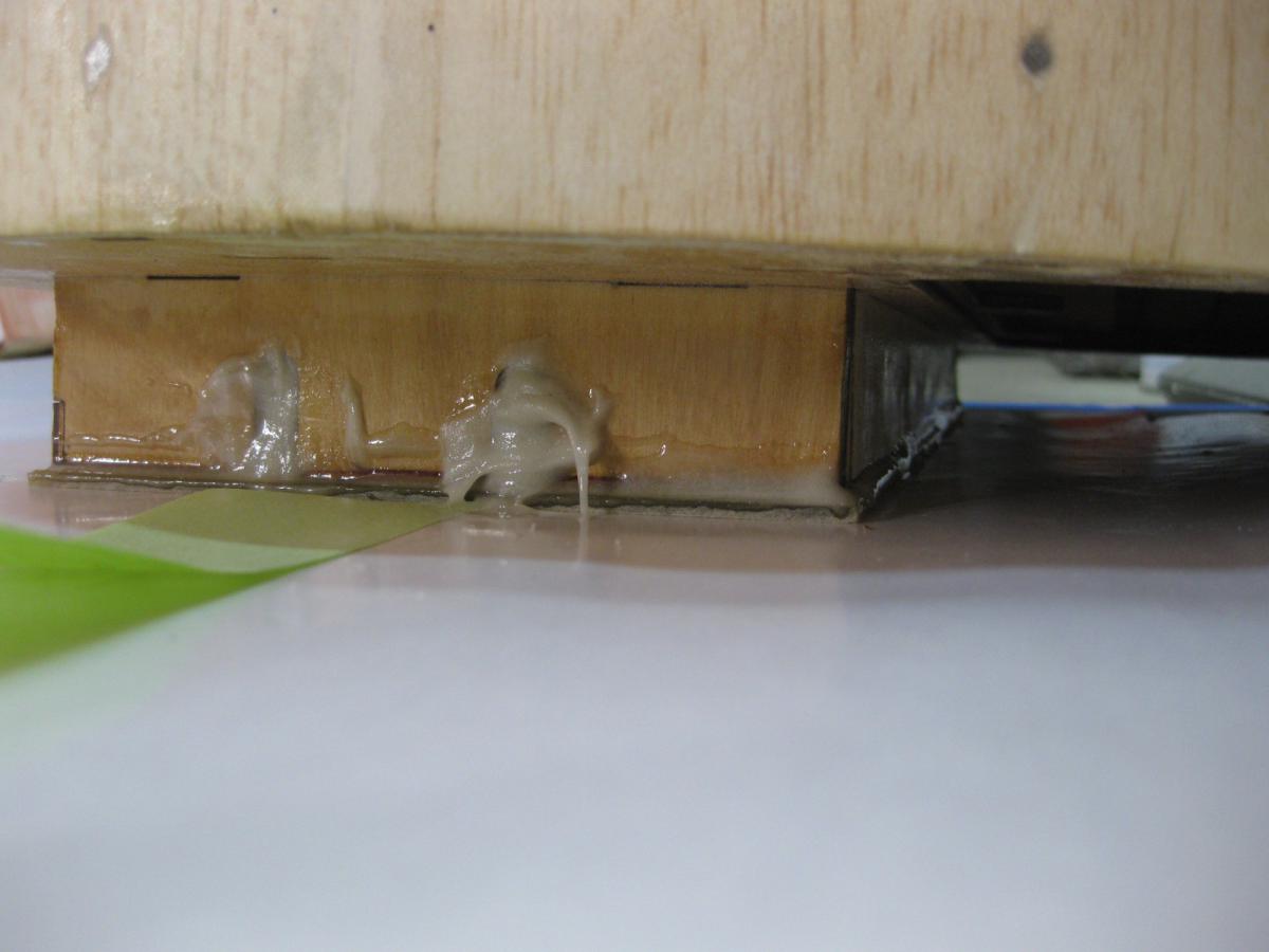

        West Systems and 404 high strength additive for attachment. 1" triangle stock on the rear side of the firewall.
        Gravity method.
        Click image for larger version  Name:	IMG_6060.JPG Views:	23 Size:	72.1 KB ID:	45536 Click image for larger version  Name:	IMG_6064.JPG Views:	22 Size:	74.1 KB ID:	45535 Click image for larger version  Name:	IMG_6071.JPG Views:	23 Size:	62.7 KB ID:	45533

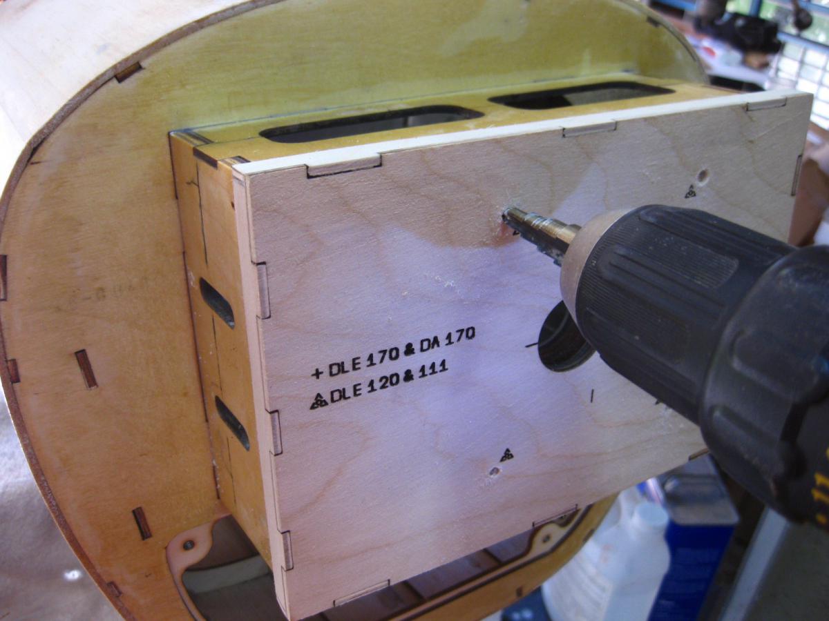

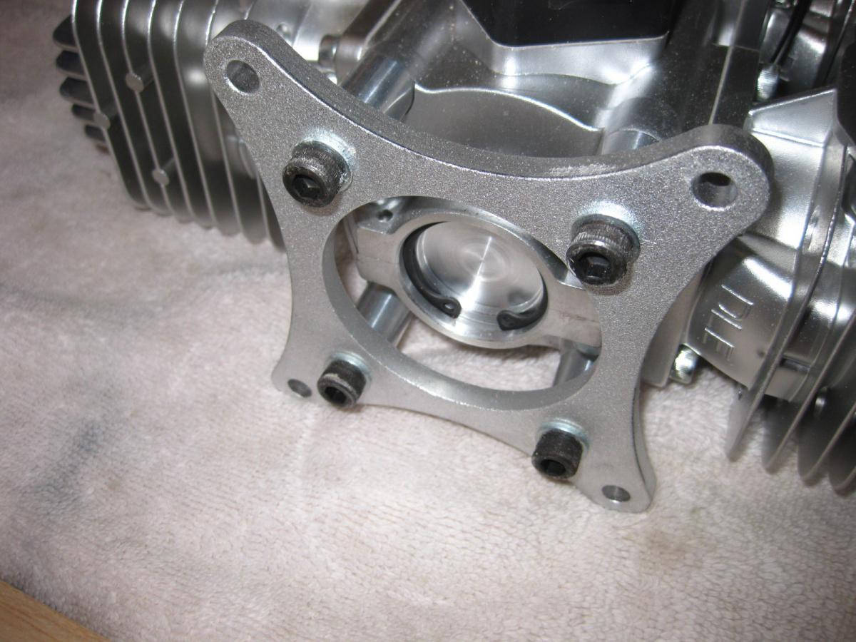

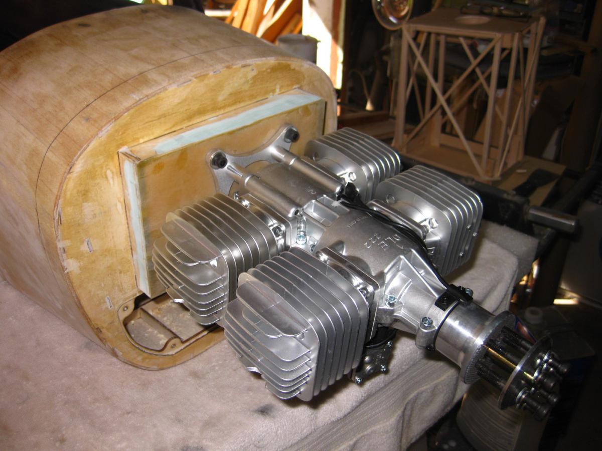

          Vertical Gravity method again for Positioning the DLE-222 "dummy"
          Click image for larger version  Name:	IMG_6073.JPG Views:	0 Size:	89.6 KB ID:	45556
          Checking to make sure things are lined up before taping it down and marking the holes.
          Click image for larger version  Name:	IMG_6079.JPG Views:	0 Size:	66.1 KB ID:	45555 Click image for larger version  Name:	IMG_6077.JPG Views:	0 Size:	81.4 KB ID:	45553 Click image for larger version  Name:	IMG_6076.JPG Views:	0 Size:	118.1 KB ID:	45560
          The rear of the DLE-222 has some Socket heads sticking out so extra holes are required - with a little fine tuning required.....aka ...Dremel tool.
          Click image for larger version  Name:	IMG_6092.JPG Views:	0 Size:	128.8 KB ID:	45557 Click image for larger version  Name:	IMG_6081.JPG Views:	0 Size:	82.0 KB ID:	45554
          Success.........
          Click image for larger version  Name:	IMG_6090.JPG Views:	0 Size:	126.6 KB ID:	45558 Click image for larger version  Name:	IMG_6089.JPG Views:	0 Size:	146.1 KB ID:	45559

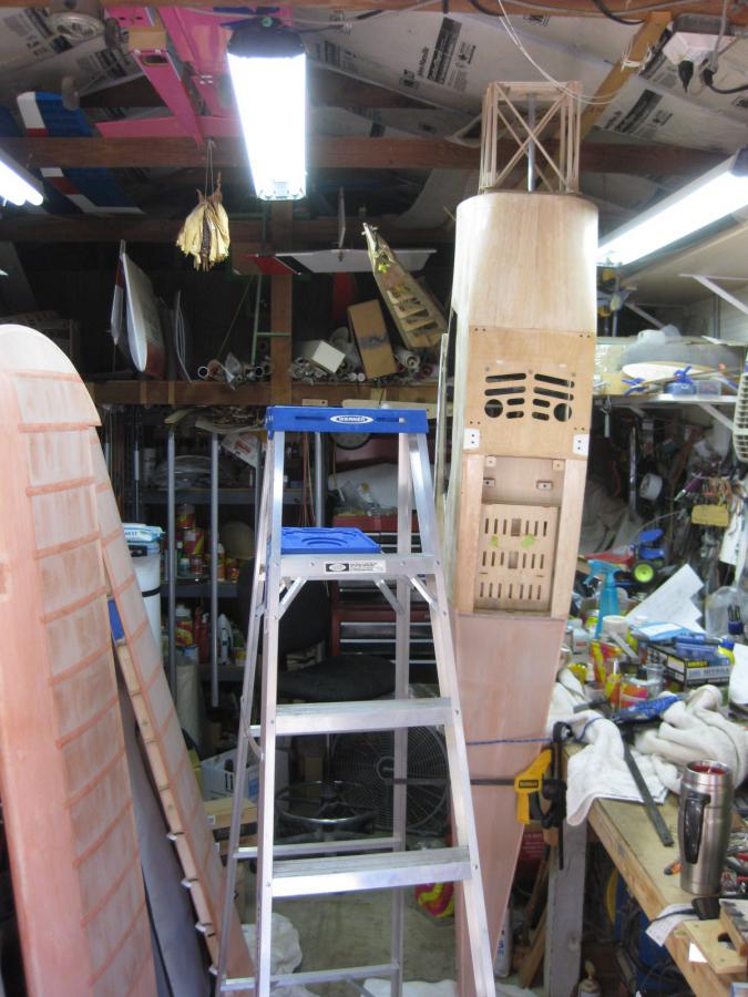

          Now I can install the rotisserie mount on the front and paint the fuselage.

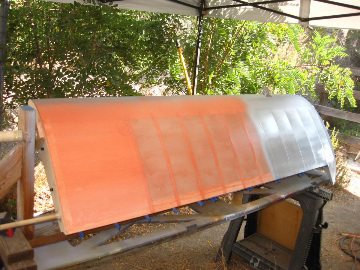

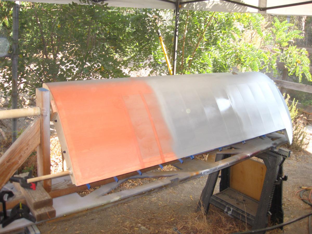

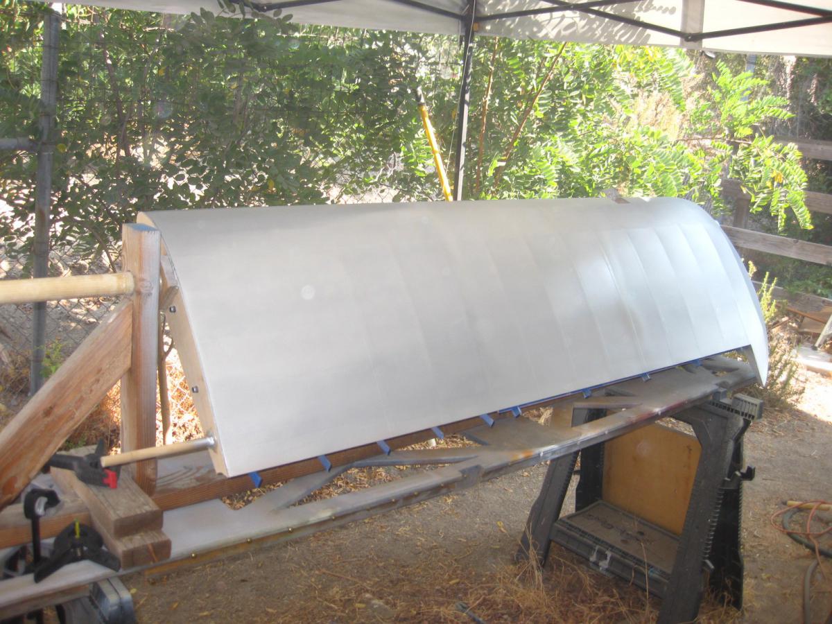

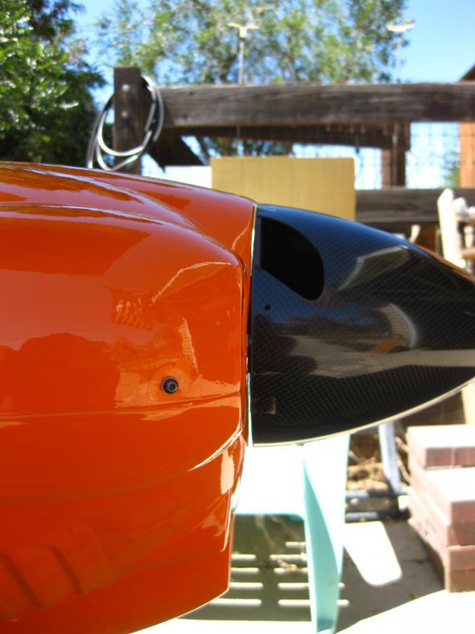

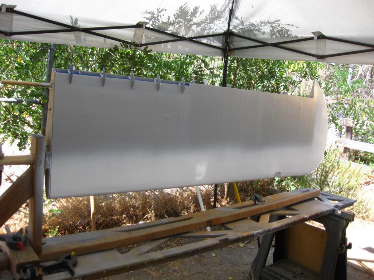

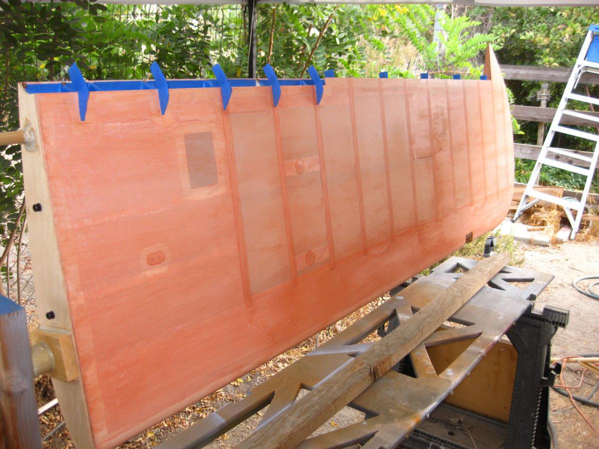

            Back to the wings, ...two spray coats of Poly-Brush to seal the fabric.
            Click image for larger version  Name:	IMG_6095.JPG Views:	0 Size:	154.1 KB ID:	45601
            And then the fun part , Poly-Spray UV protection and anti-model "see-thru" look.
            Click image for larger version  Name:	IMG_6096.JPG Views:	0 Size:	178.9 KB ID:	45603 Click image for larger version  Name:	IMG_6097.JPG Views:	0 Size:	170.3 KB ID:	45604 Click image for larger version  Name:	IMG_6098.JPG Views:	0 Size:	165.5 KB ID:	45602
            I have to wait 4 days for the solvents to boil off before I can spray the Aero-Thane, I put two coats of Insignia White 105 Poly-Tone to where the Omaha Orange is going to be applied.
            Click image for larger version  Name:	IMG_6103.JPG Views:	0 Size:	158.2 KB ID:	45600

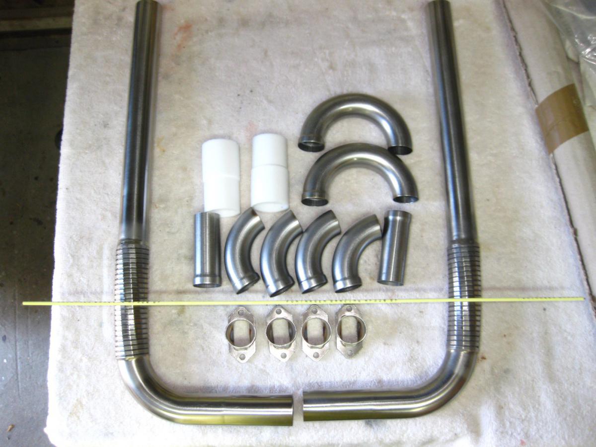

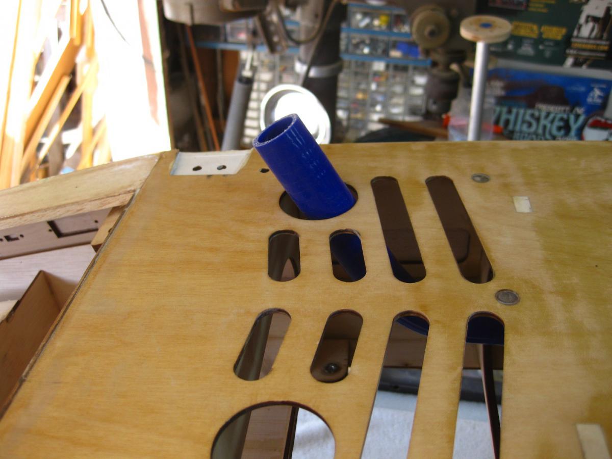

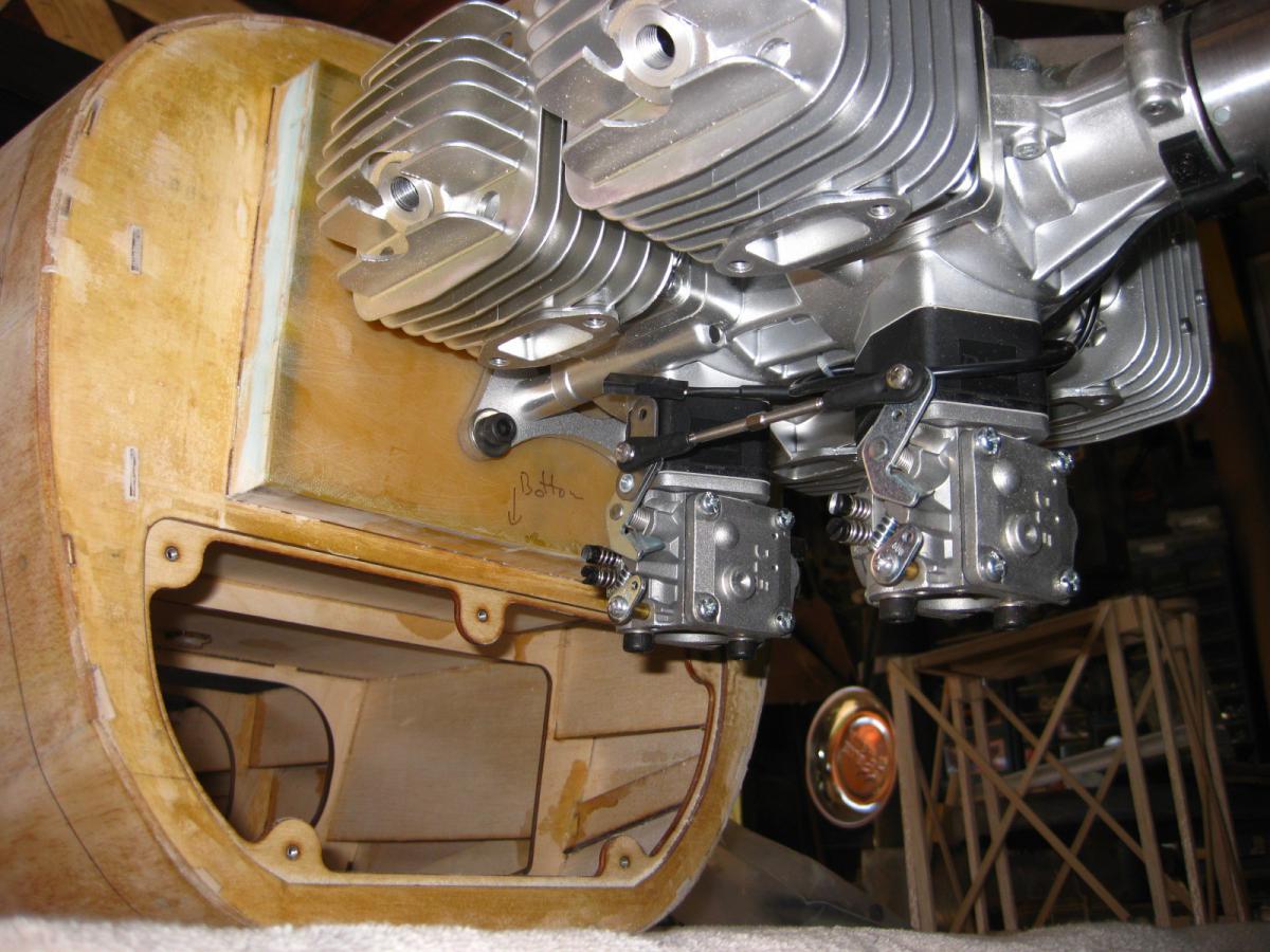

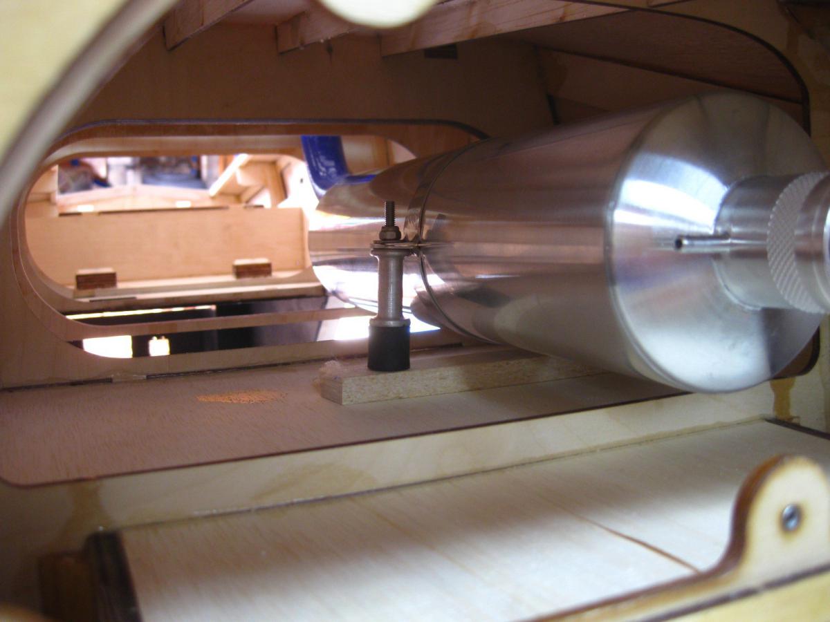

              Saw Steve P post about the DLE canisters and figured "what the heck" .......I got the DLE-170 tuned exhaust system since I'm going to be dumping two cylinders into one ( at different times thou ) I figured a little more volume would be helpful. I stuck my borescope inside to see what there and its pretty simple 2 chamber design - exhaust goes all the way to the back , exit tube goes all the way to the front with 4 rectangular punched holes partially pushed open ( one side still attached ). Kit comes the a 45 degree exit silicone line that makes positioning easy ( and anti-chaffing )
              Getting the general layout while I wait for the exhaust stubs and other items from K & S in Germany.
              K&S #506 comfort mounts as the Canisters are 75mm in diameter.

              Exhaust headers....in component format...."some assembly required"
                Happy brazing! The part I like least.

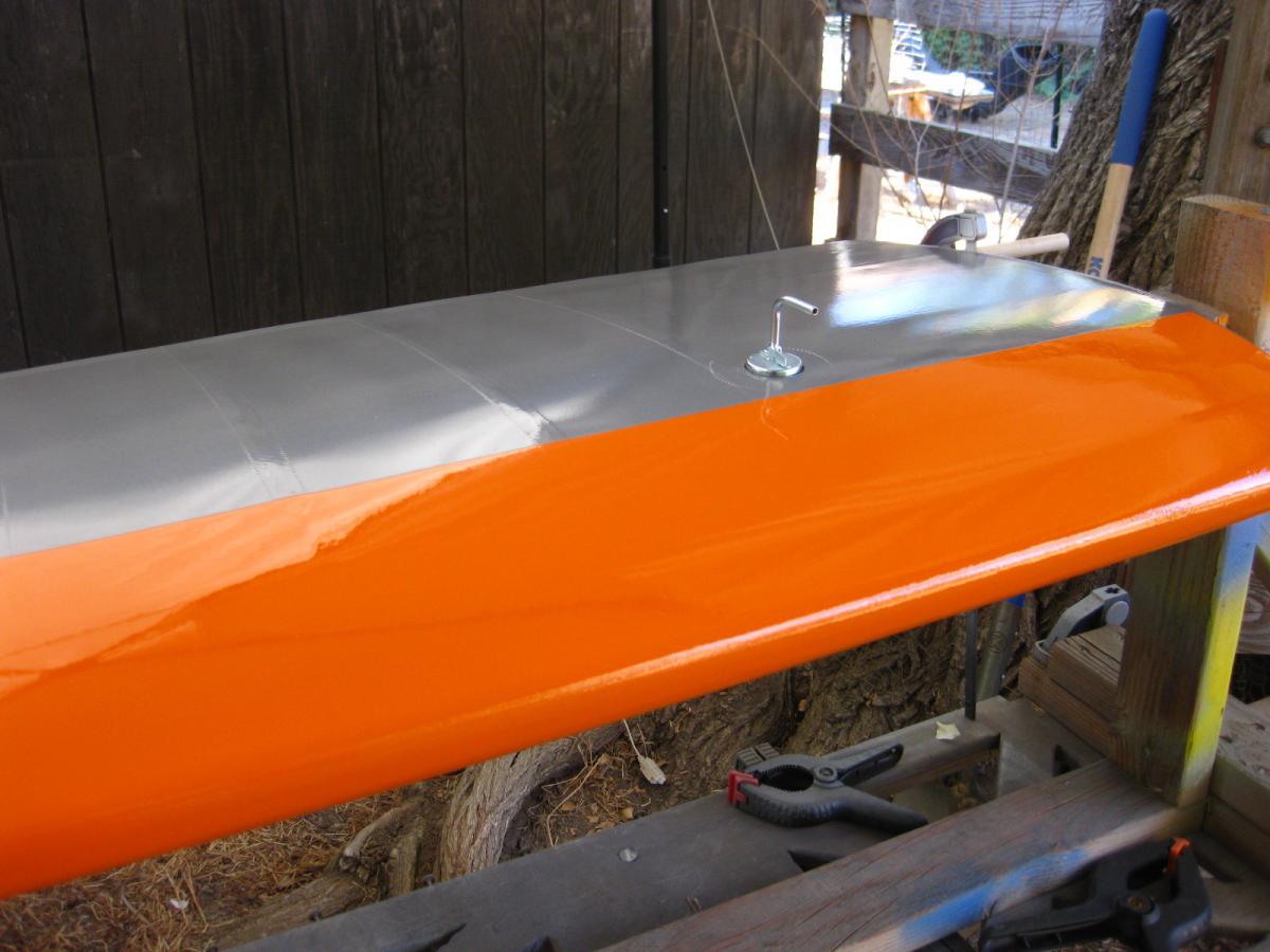

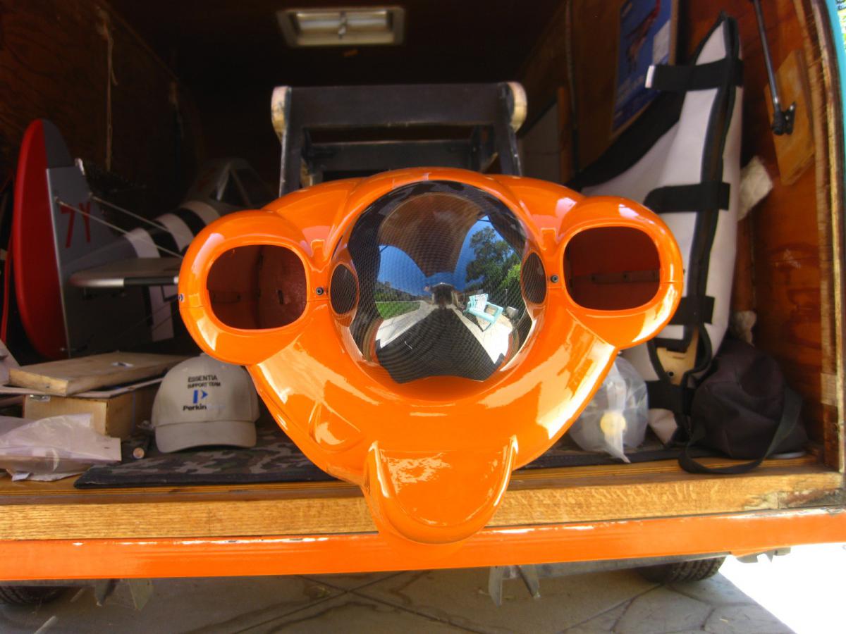

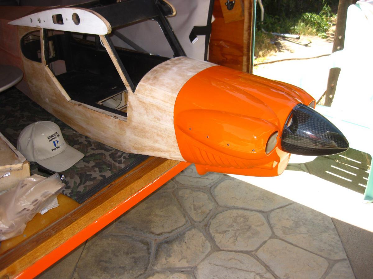

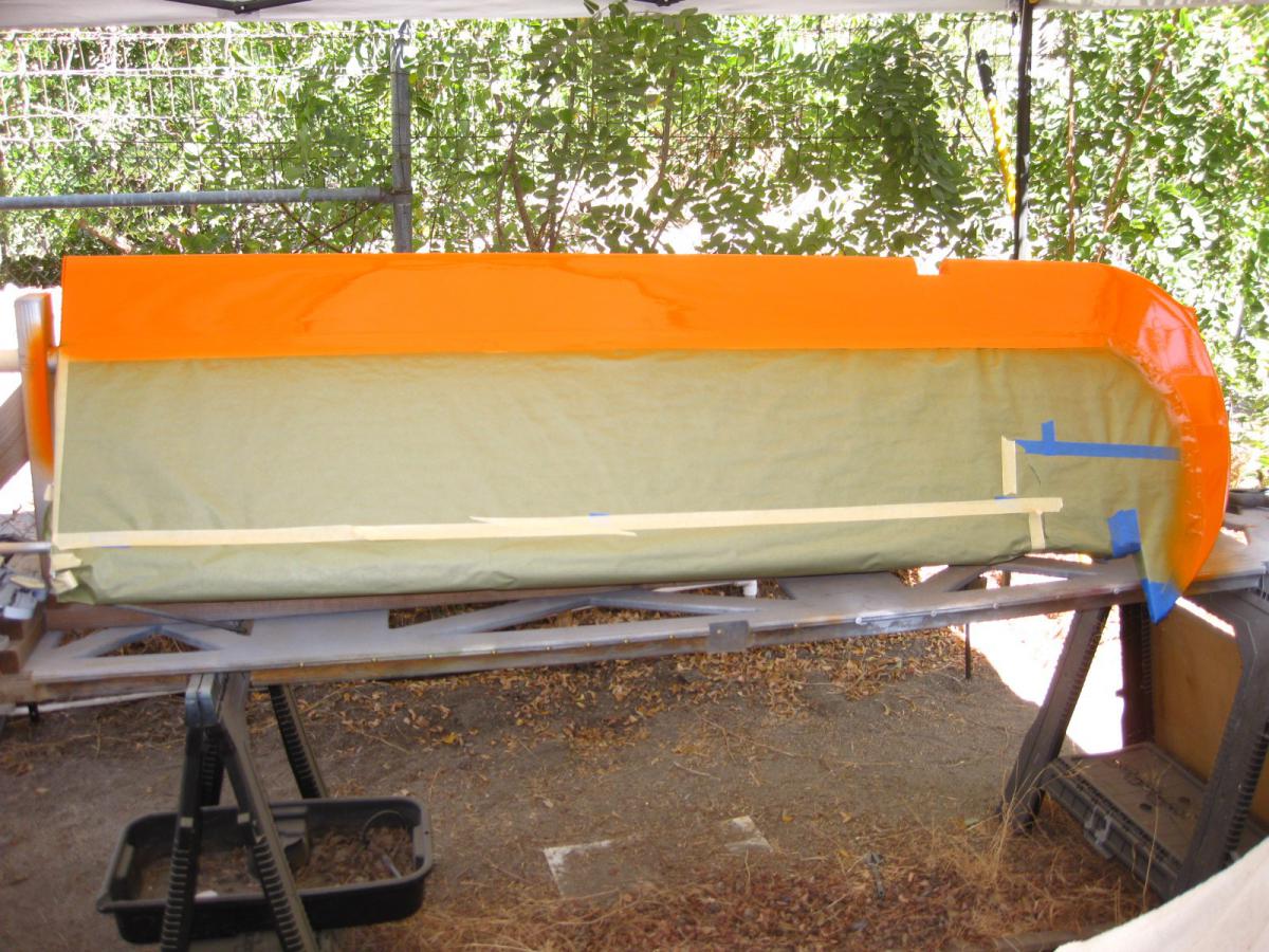

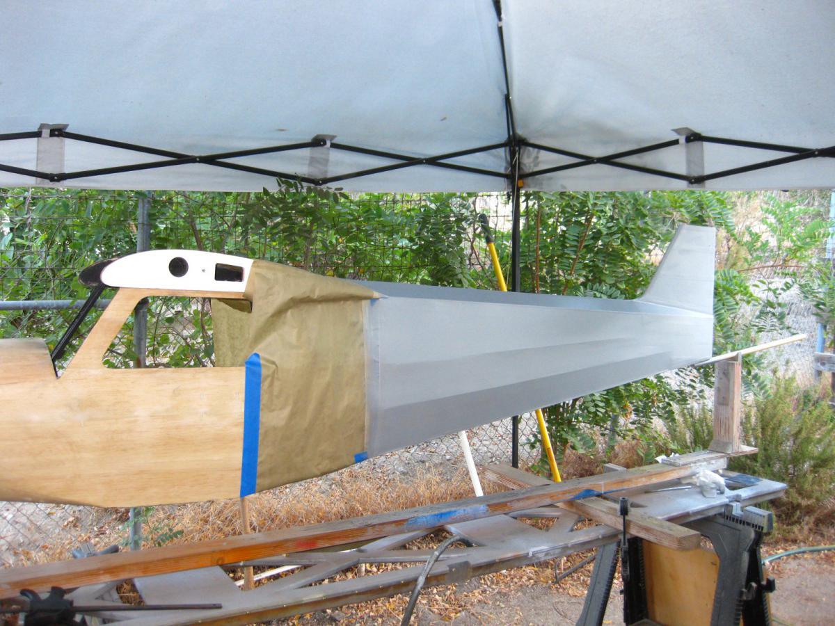

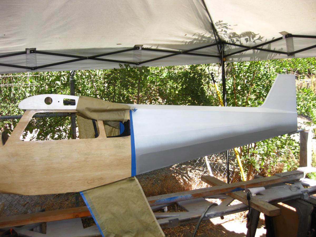

              2 spray coats of Poly-Brush on the fabric area then 2 spray coats of Poly-Spray........followed by a little bit of sanding to smooth things out.
              Then 1 coat of Insignia White Poly-Tone ( where the Omaha Orange is going ).
              Now on to the front half with Primer.......
              Click image for larger version  Name:	IMG_6114.JPG Views:	0 Size:	166.6 KB ID:	45780 Click image for larger version  Name:	IMG_6118.JPG Views:	0 Size:	174.2 KB ID:	45779

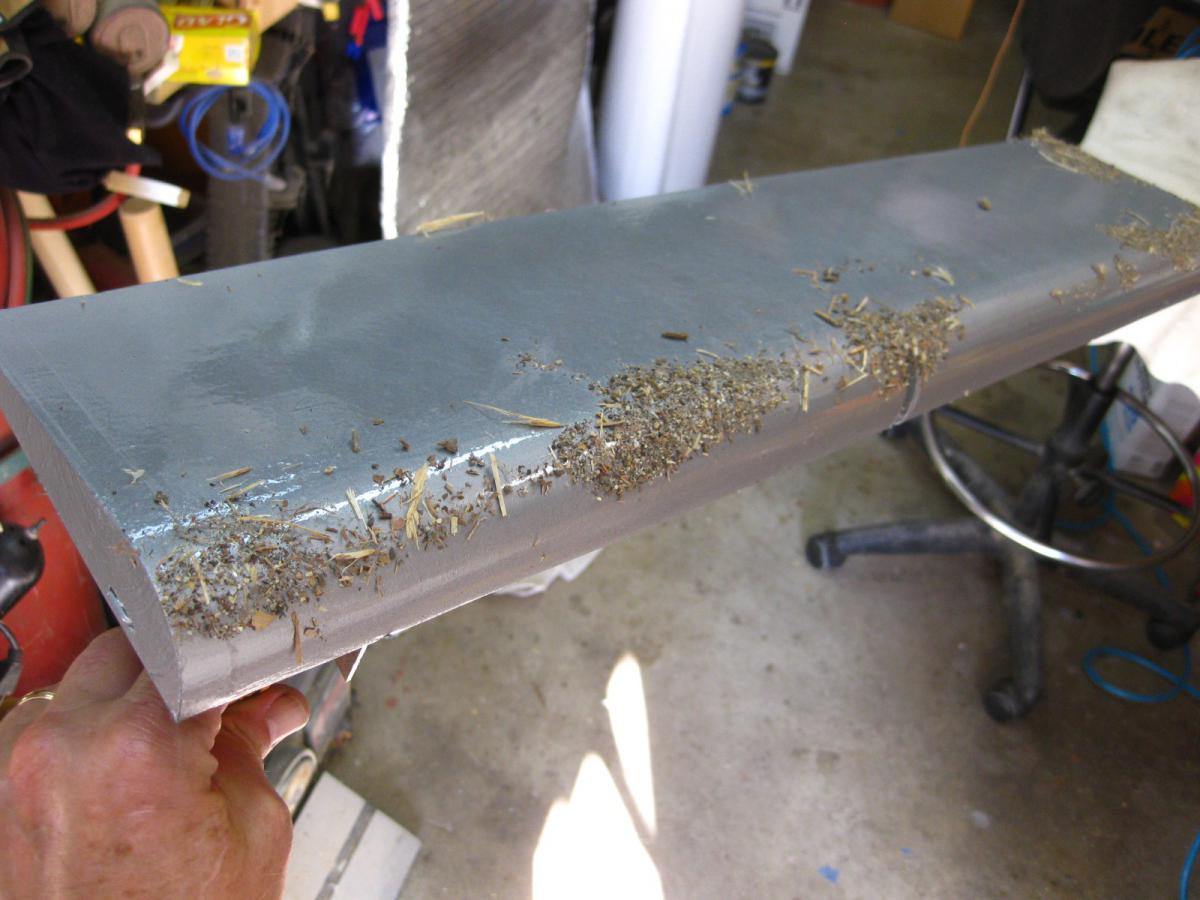

                  Oops...........poor clamping technique........where did I put that buffing compound.....it's around here somewhere
