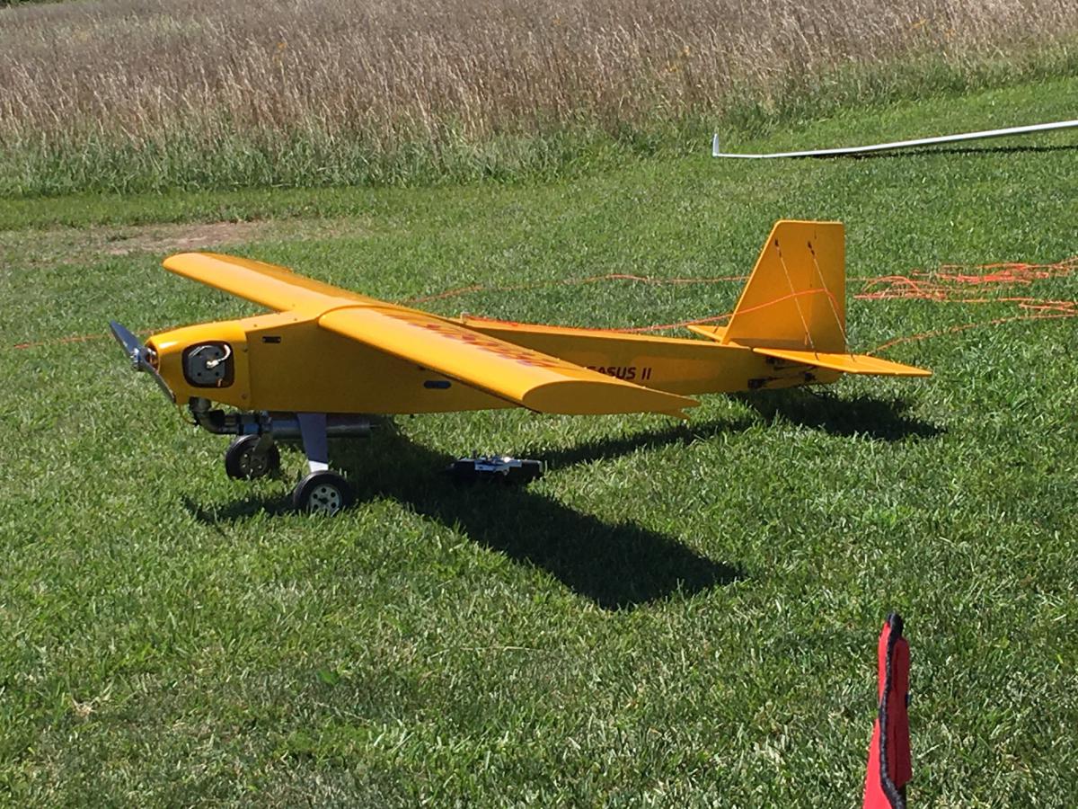

        A lot of memories from your post. My build thread here on Scale Soaring was lost in the hacking a few years back. I have many years of flying my Pegasus which I built with a lot of help from several of my
        local flying buddies who helped me when I ended up severely tail heavy. I think making things a light as possible instead of really strong like I did will help in your build. a 120 cc engine will allow you to tow anything that will show up. I made mine 108% because I had 150cc engines lying around. We call it the beast and it is still flying and has been a work horse the past 7 years of our Sled Works Aero Tow here in Minnesota each summer.

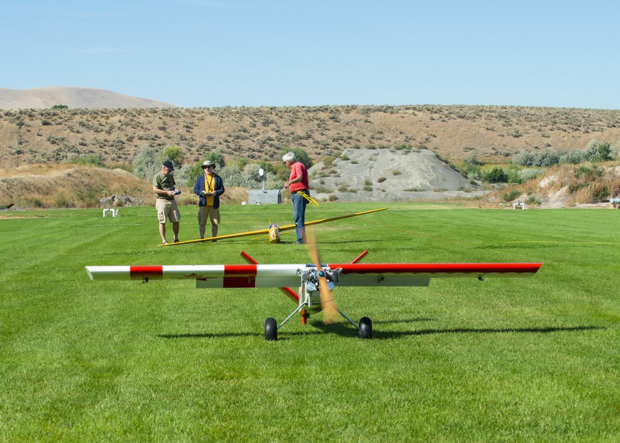

                The Mighty Peg! This green monster did a ton of service for us on the East Coast circuit. 3W-120 on a 3-blade. It lived first in Len's feet and then in mine.

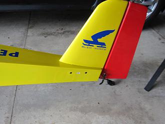

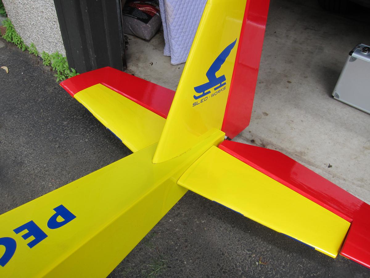

                Here's our 'Peg. As you can see it is modified to V-Tail which turned out great as it keeps the towline between the stabilizers. Also a custom mod around the tail wheel to stop it picking up the line if you happen to run over it.

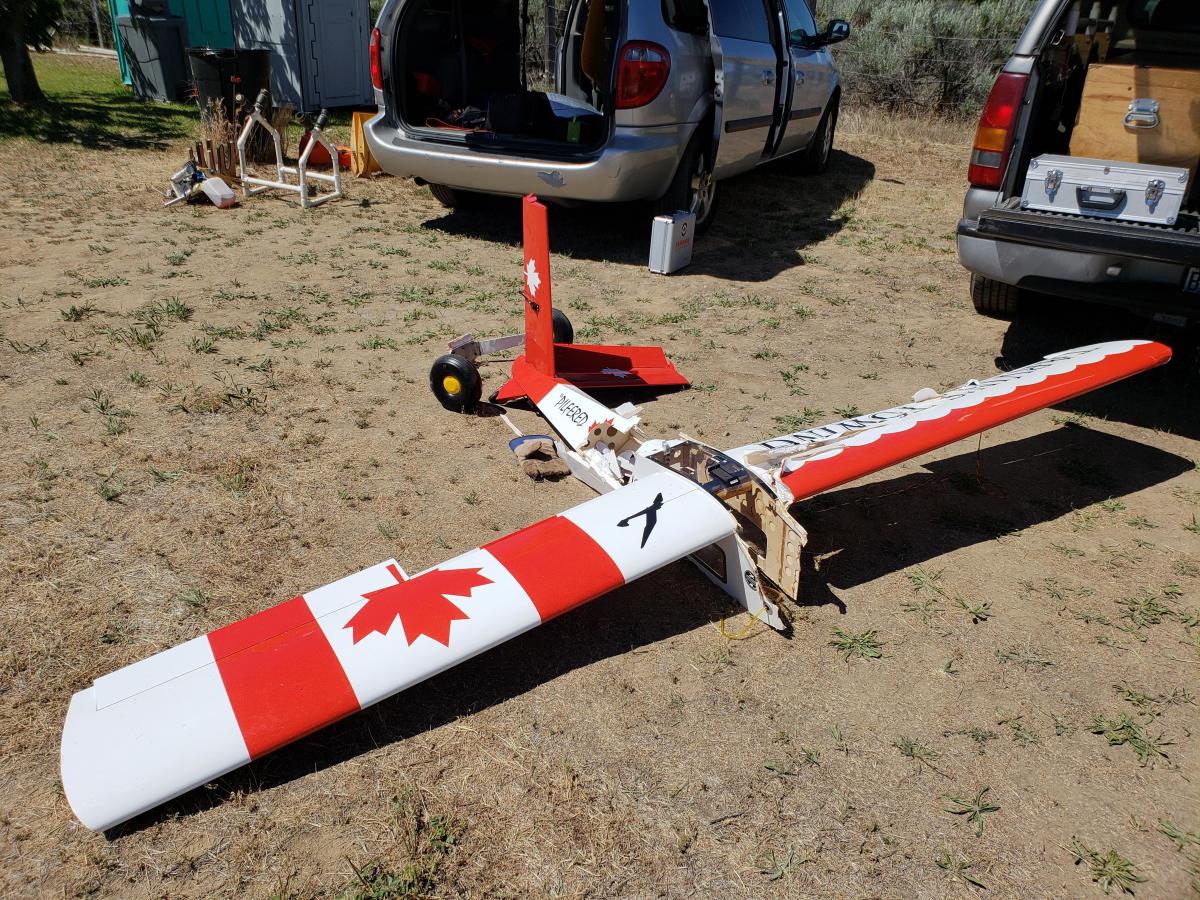

                This plane was modified and built by Nigel Tarvin, and came into our hands a couple of years ago. Suffered a rough merge with high density material, but has been repaired to fly again!
                Old Brison 105 twin as power, just right for most of what we do. Originally was a manual ignition, now modified to electronic and runs like a charm.

                    Our V-Tail peg stabs are removable as well, but the tubes they mount on are permanently attached to the airframe. Nevertheless it certainly saves some transport and storage space. I'll post some pix in the next few days. Same technique could be used for horizontal stabs, with the added advantage that the tubes could be dismounted too.

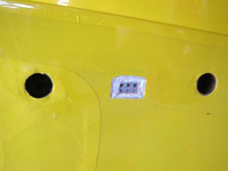

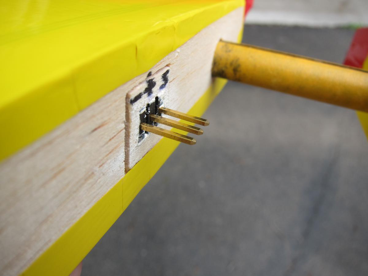

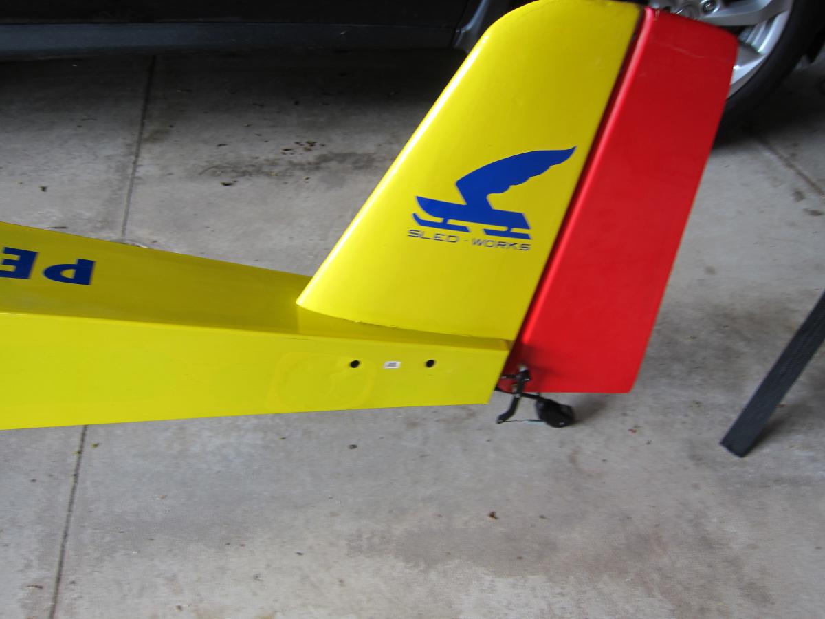

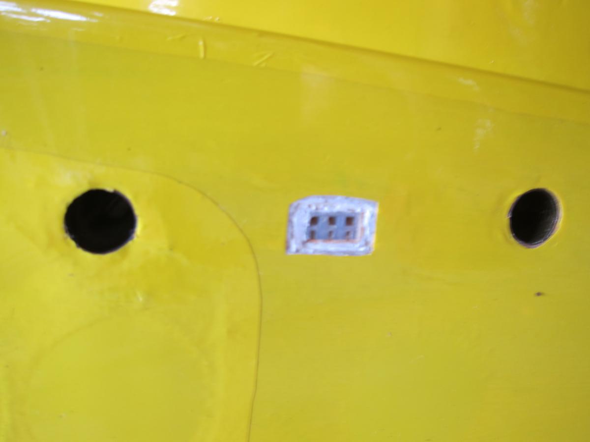

ID:	41283Here are some photos of the detachable horizontal stabs I talked about earlier on my 108% Peg. These stabs were salvaged Aero Tech Extras but I am sure most any symmetrical airfoil that is strong enough that hold the servos would work...they are held on by a 4-40 allen bolt threaded into a piece of oak dowel glued inside the carbon tube. It has worked flawlessly for hundreds of assemblies..
                  On one side the bolt is left fully inserted, while on the other side it is screwed in and out with allen wrench. female tubes were made by wrapping wax paper over the carbon tubes. connectors are by Digi Key which are a bit hard to come by but I bet MXP or others would work too.
                  Keep up the good work... Click image for larger version
