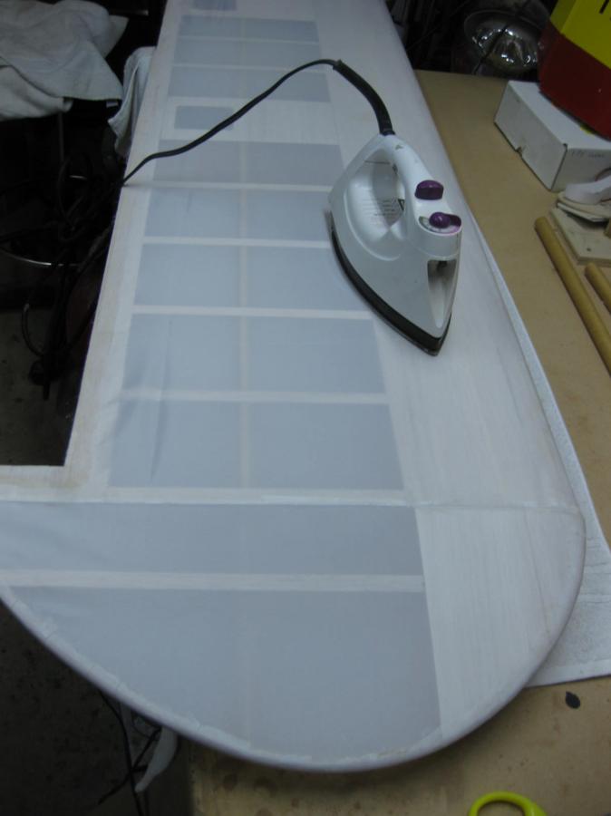

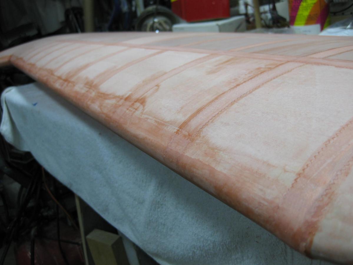

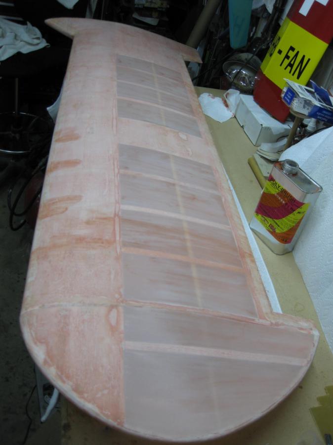

    Shrinking.....Poly-Brush.....and tapes

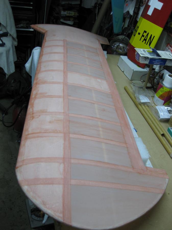

    Bare wing is 1180 grams (uncovered Aileron/Flap included)
    Original wing is 1580 grams

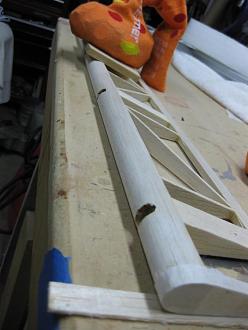

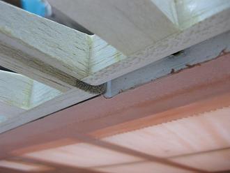

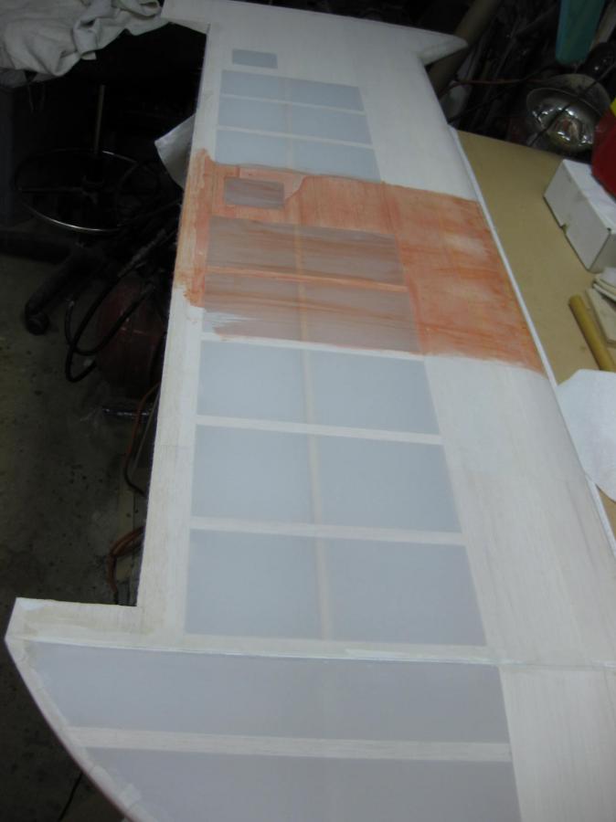

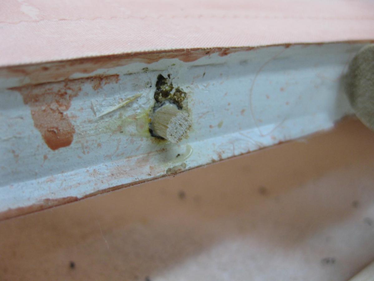

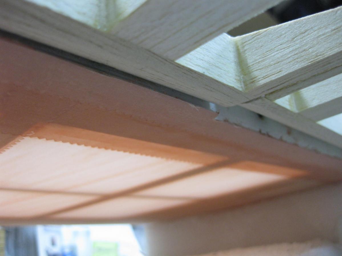

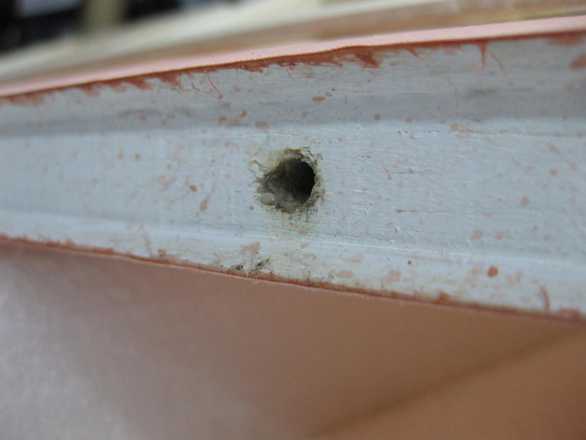

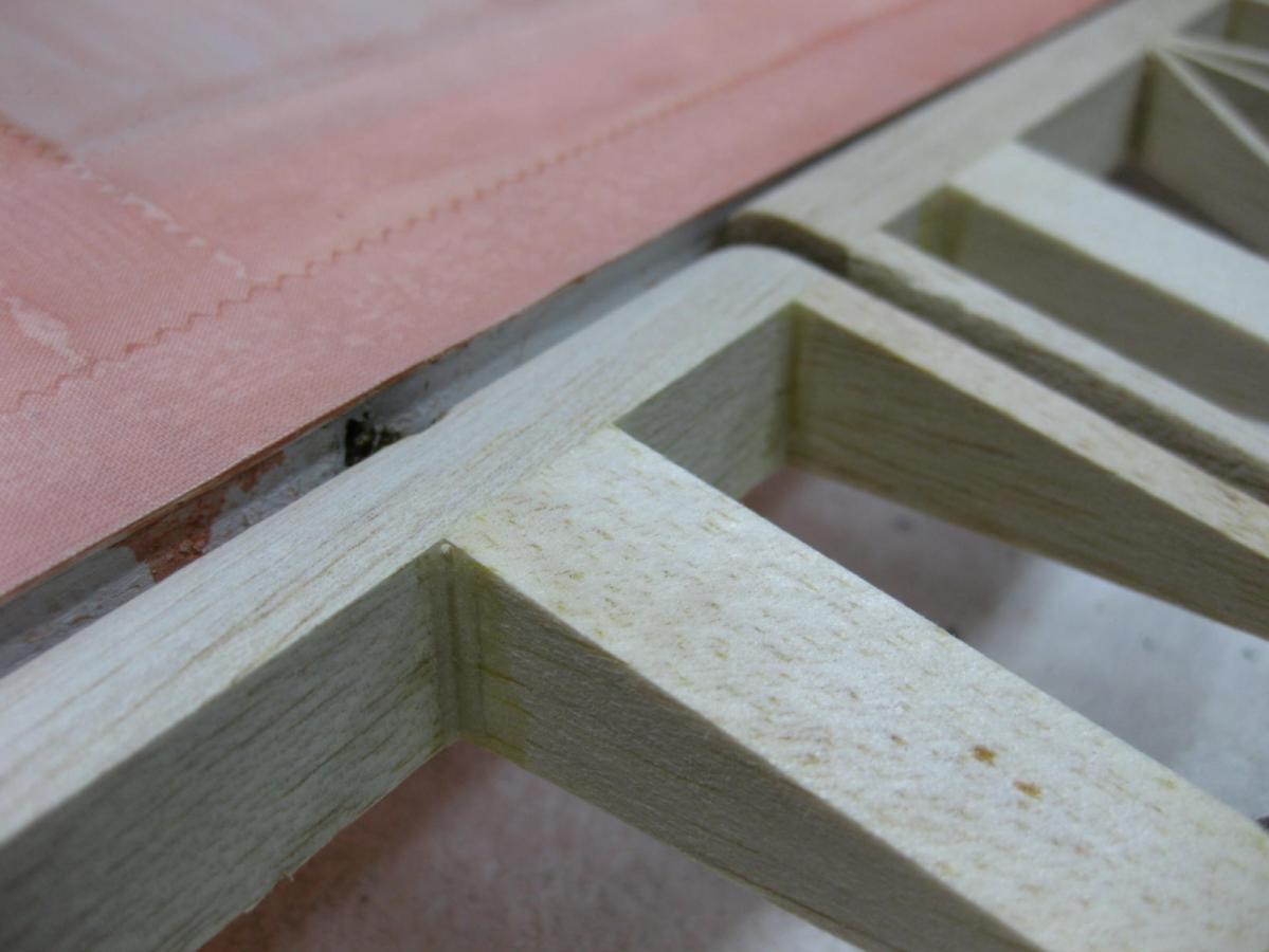

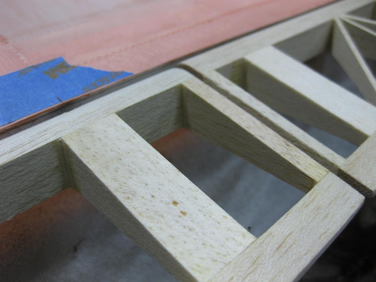

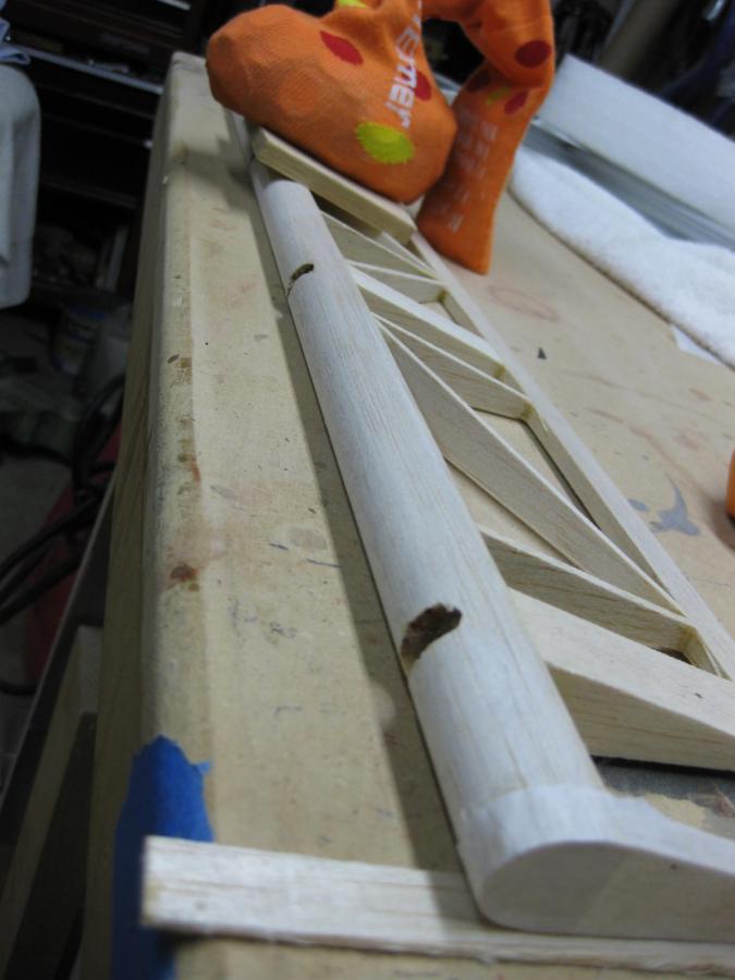

    Minor plot complication, .....Noticed there wasn't much down aileron movement before I removed the aileron and flap. Checking the fit before recovering them, I found out why. The holes in the trailing edge are offset a little toward the bottom. Checked the right wing and is seems to suffer from the same issue.
    Click image for larger version  Name:	IMG_3879.JPG Views:	1 Size:	77.2 KB ID:	14258Click image for larger version  Name:	IMG_3880.JPG Views:	1 Size:	70.8 KB ID:	14254Click image for larger version  Name:	IMG_3878.JPG Views:	1 Size:	64.0 KB ID:	14256

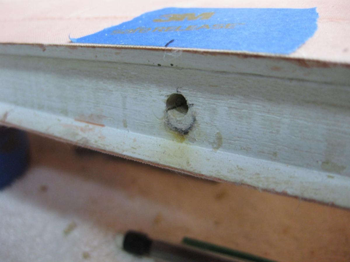

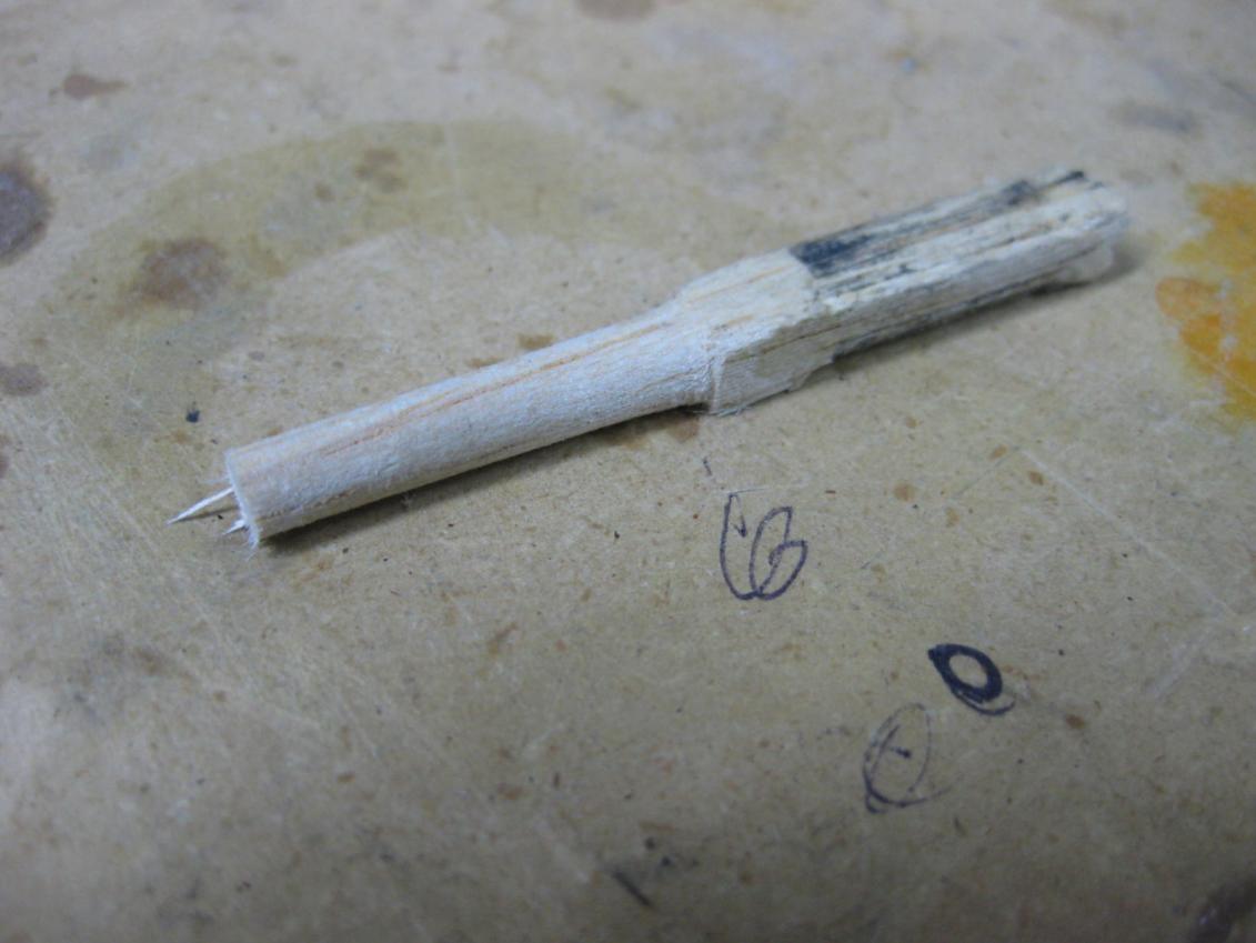

    Attempting to plug the holes and re-drill ....of course 3/16 balsa dowel construction too.
    Click image for larger version  Name:	IMG_3881.JPG Views:	1 Size:	75.7 KB ID:	14257Click image for larger version  Name:	IMG_3882.JPG Views:	1 Size:	66.2 KB ID:	14255

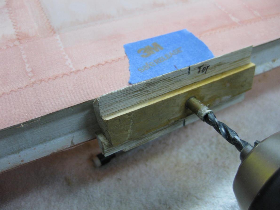

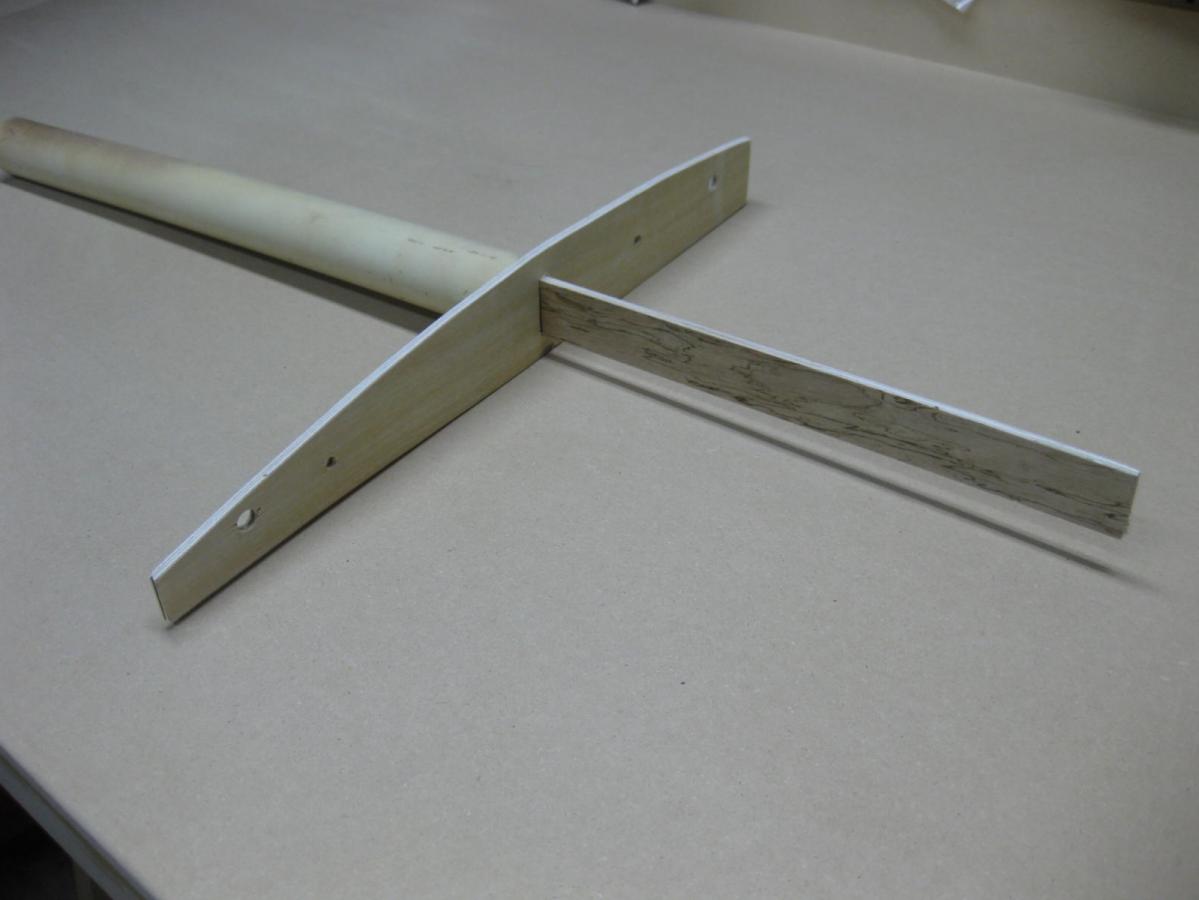

      Made a Jig to drill the holes consistently for both wings..

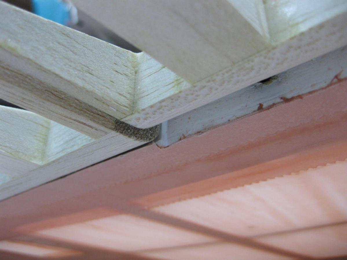

      Things line up much better and lots of down aileron.

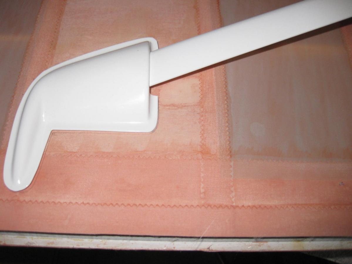

      On to covering the aileron / flap.
        Found a bit of a bow in the Aileron, so a little water on the leading edge balsa, some leftover change, and time helped out.

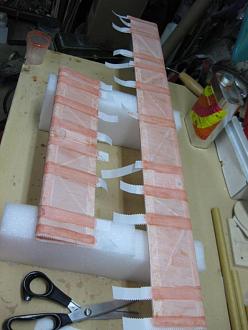

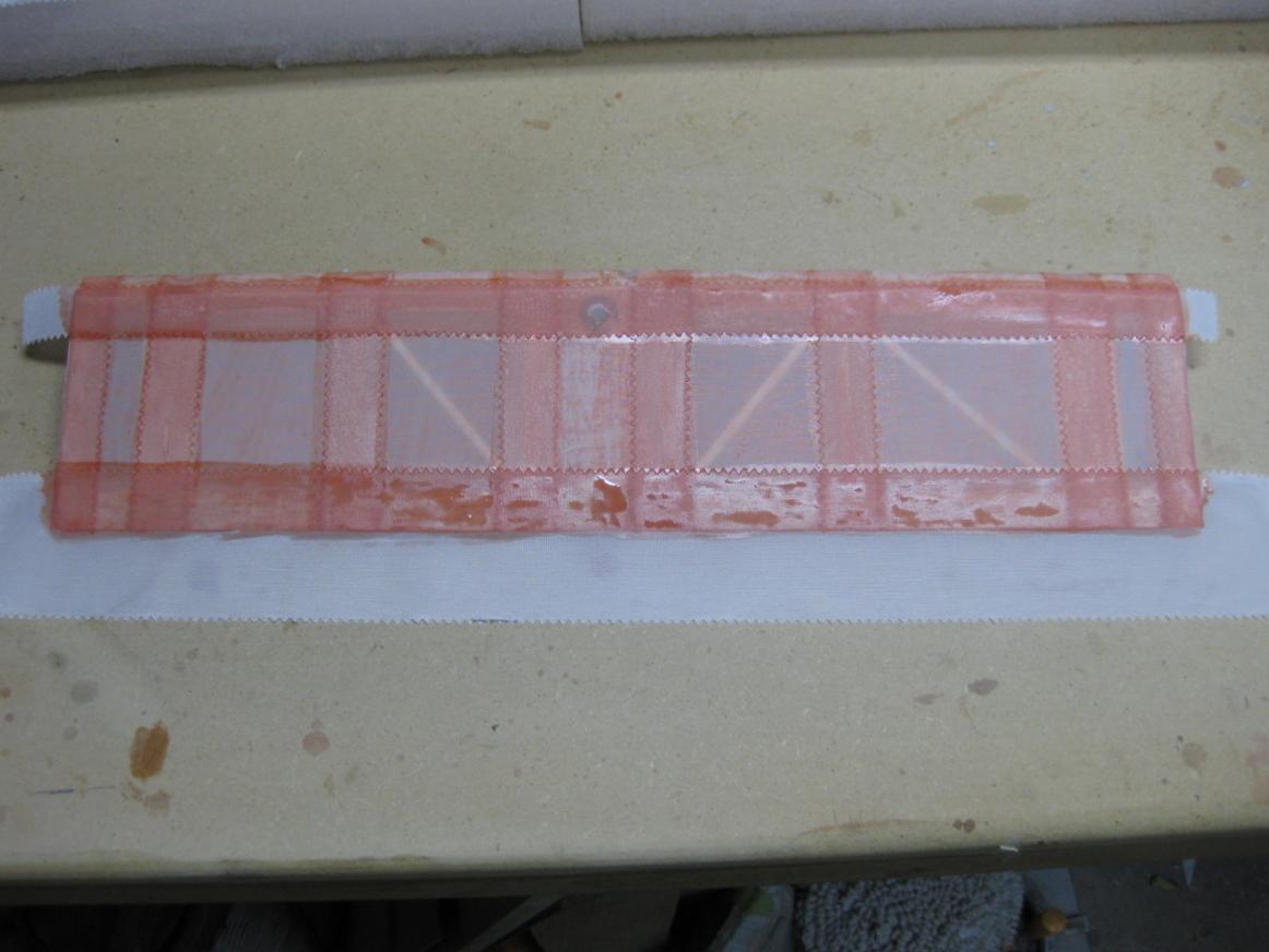

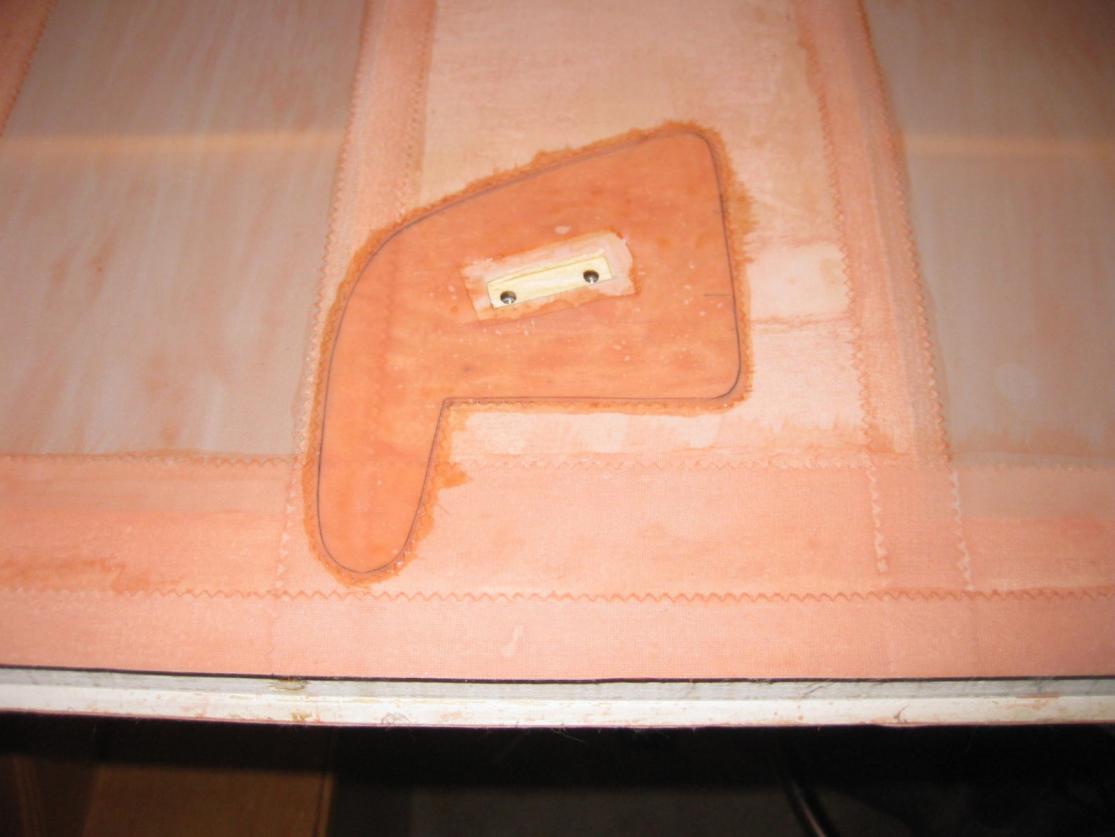

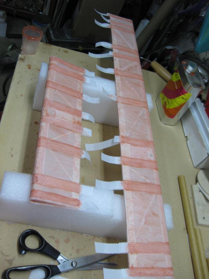

        On to the covering and tapes. Installed the 8-32 threaded counter sunk screw first so I could put a patch over the head to hide it.
ID:	14638Click image for larger version
        Wing strut cover reinforcing patch - pencil lines made it easy line up. ....also so I could get an idea of where the invasion stripes stop.

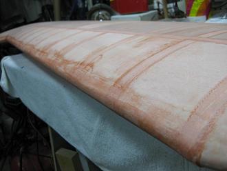

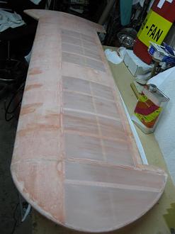

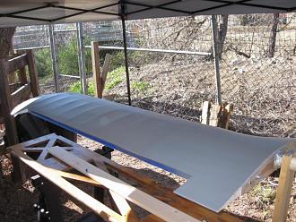

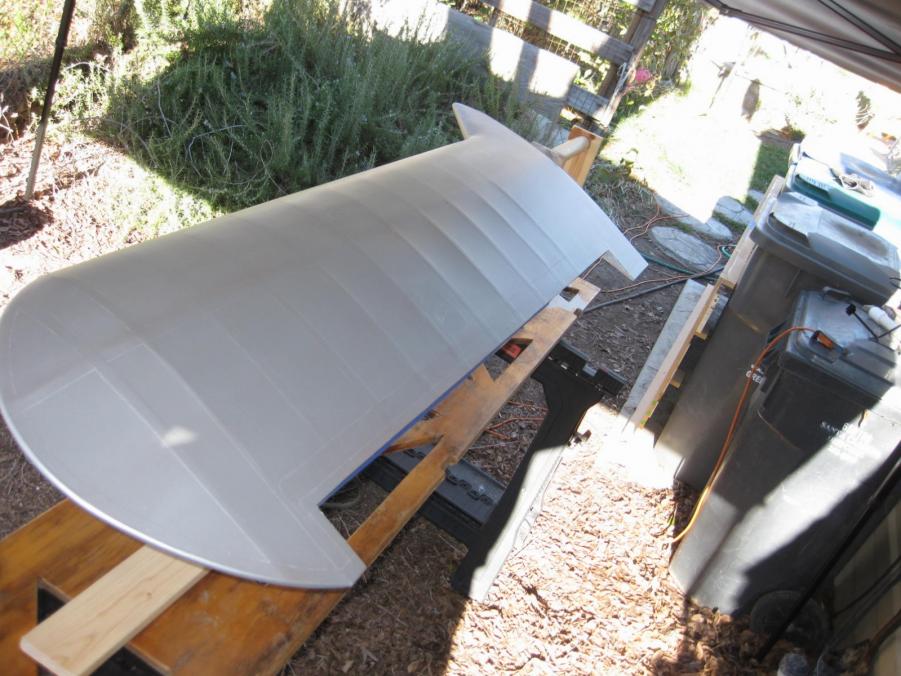

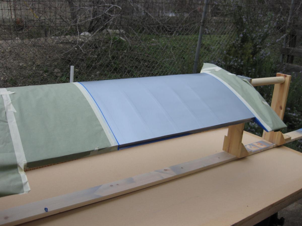

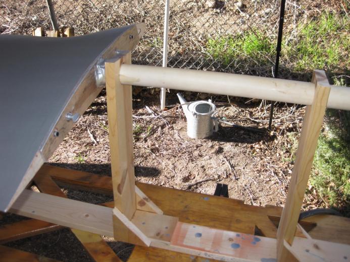

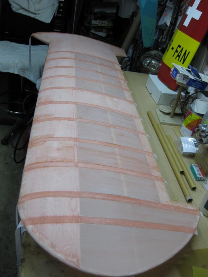

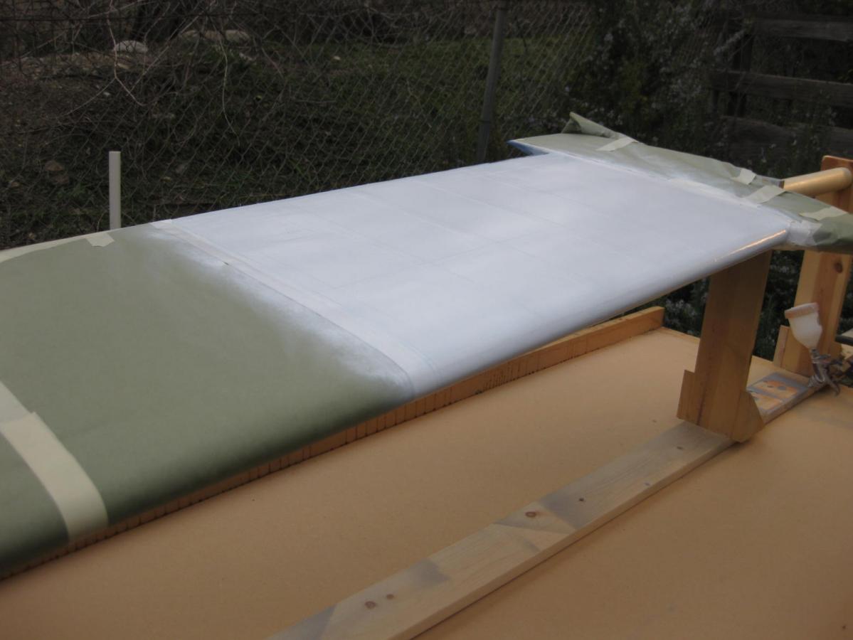

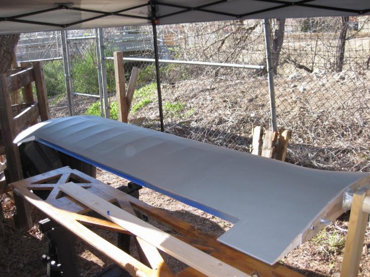

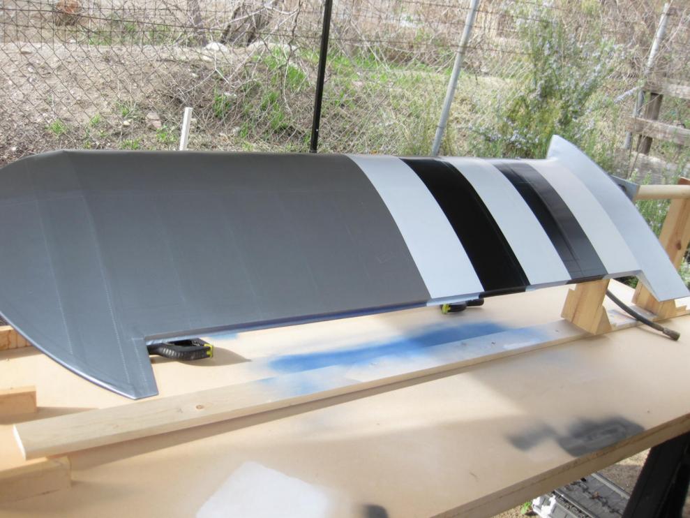

          It stopped Raining so....... Poly-Spray on the wings. ....had to come up with a wing rotisserie too ....
ID:	15045Click image for larger version

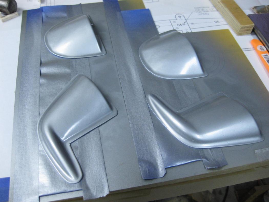

            Testing the Poly-Tone Nevada Silver on the plastic parts - wasn't sure if things were going to melt or wrinkle.......
            Used loop of 2" tape ( taped down on the sides ) to stick the parts to to keep them from blowing off the table.
            Looks like Invasion strips are on the agenda next.

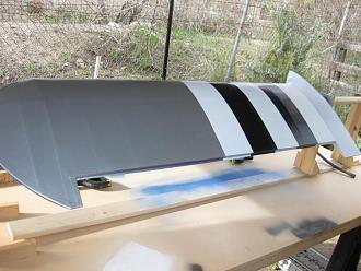

                I let the paint dry for about 30 minutes ....then, I couldn't stand it any longer........
                Scott

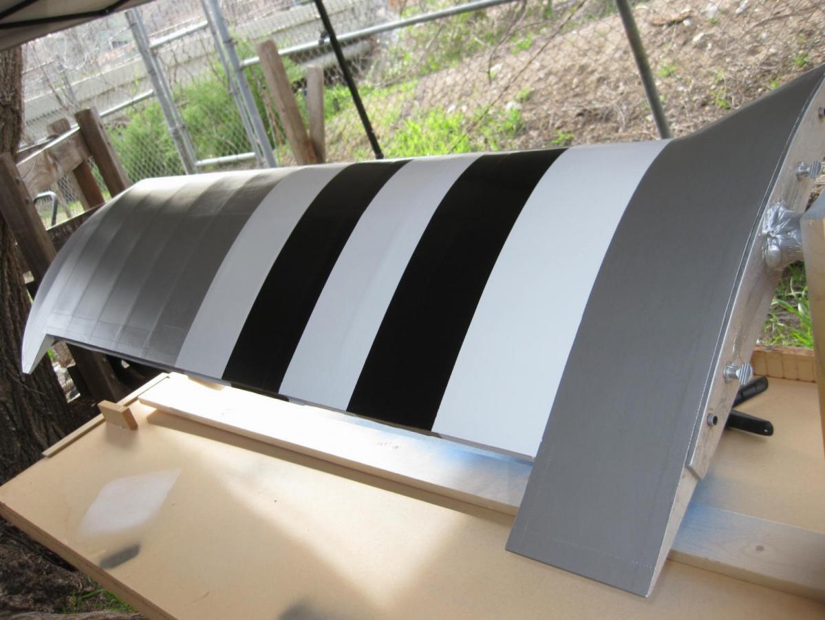

                        Thanks Guys......funny how excited I can get over white and black stripes......

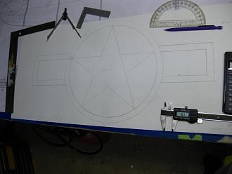

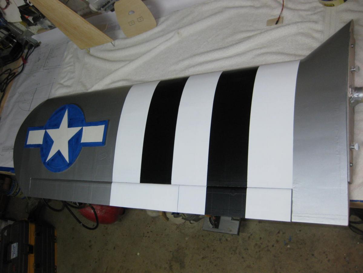

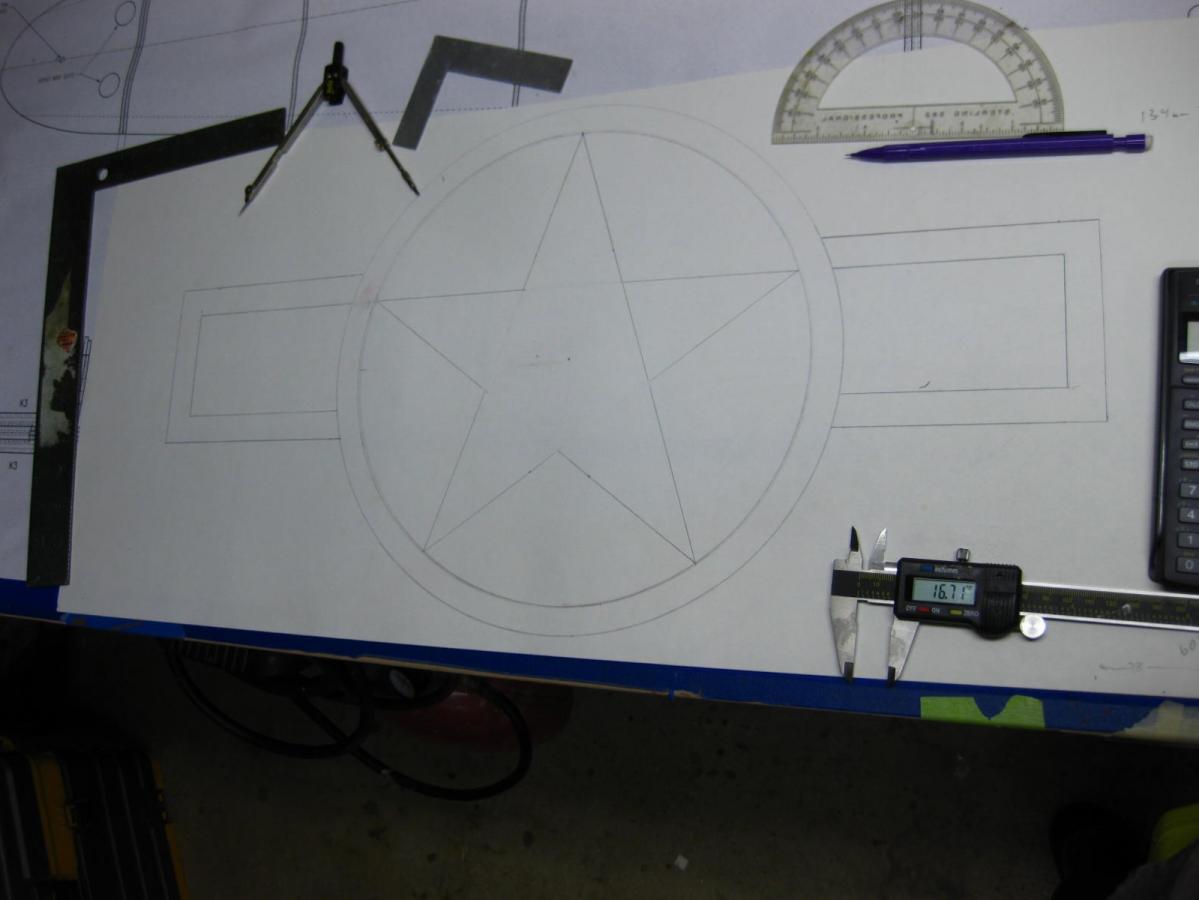

                        Little bit a rain here ....so I spent some time with my ruler / protractor / compass ......
                        Click image for larger version  Name:	IMG_3989.JPG Views:	1 Size:	61.0 KB ID:	15675
                        Only Blue I had was the PolyTone......so out came the paint brush....and tried to follow the lines.....
                        Click image for larger version  Name:	IMG_3995.JPG Views:	1 Size:	79.0 KB ID:	15676 Click image for larger version
                        seem to be missing some black on the aileron.......waiting for paint to "dry"

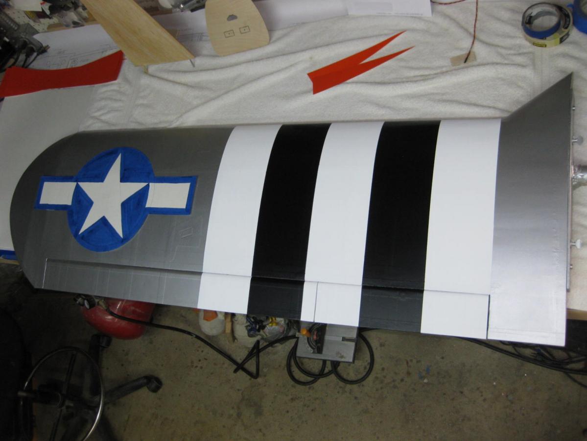

                        Painting the Stars & Bars on so the pinking tapes will show thru....using painting masks
