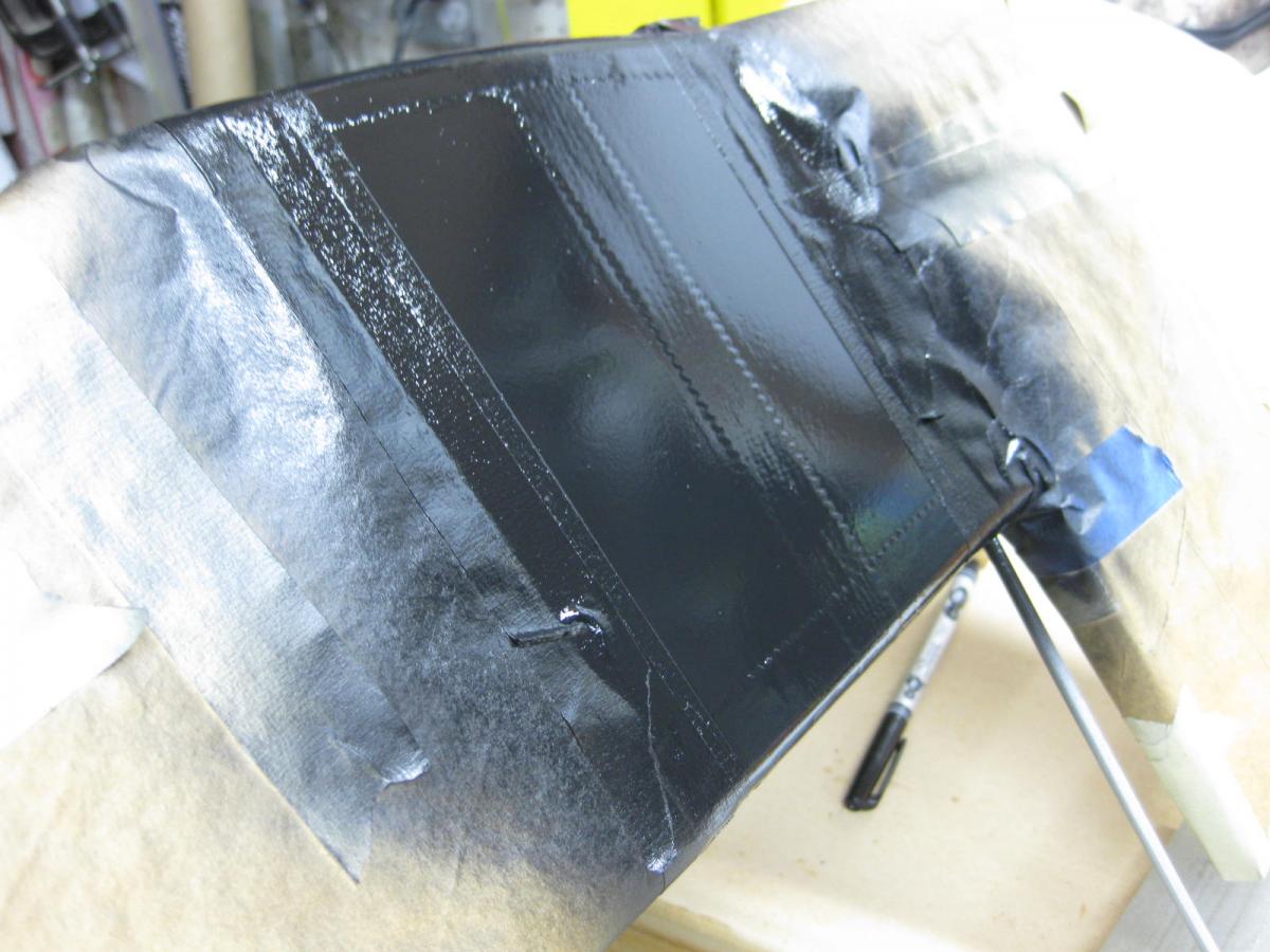

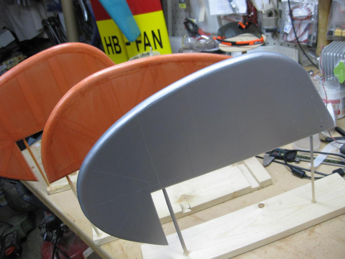

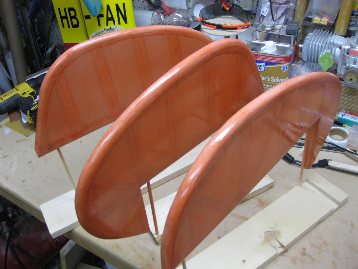

    Fun with the Spray gun........two spray coats of Poly-Brush
ID:	13533 Click image for larger version
    And then on to the Poly-Spray with two coats
ID:	13535 Click image for larger version
      Georgeous work, Scott. The pinking looks fantastic all painted out.
        Nice stuff Scott, but how much weight does all that sealer and paint add to the overall mass?
          Hi Jeremy,
          That is a very good question, I thought about it as I was removing the last of the Ultracoat off of the rudder. The Rudder as it stands right now thru Poly-Spray (UV protection) is 102 grams.
          Most of the Poly-Brush and Poly-Spray evaporate off as the label on on the Poly-Spray indicate that its 30-40% Toluene, 10-20% Methyl Ethyl Ketone, 10-20% Methyl Isobutyl Ketone.......Pretty much all solvent......

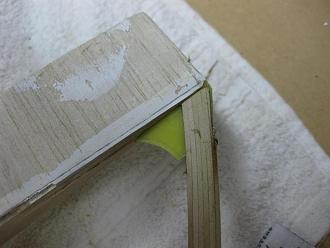

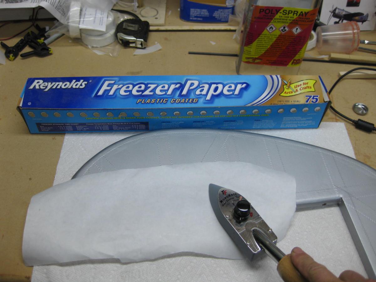

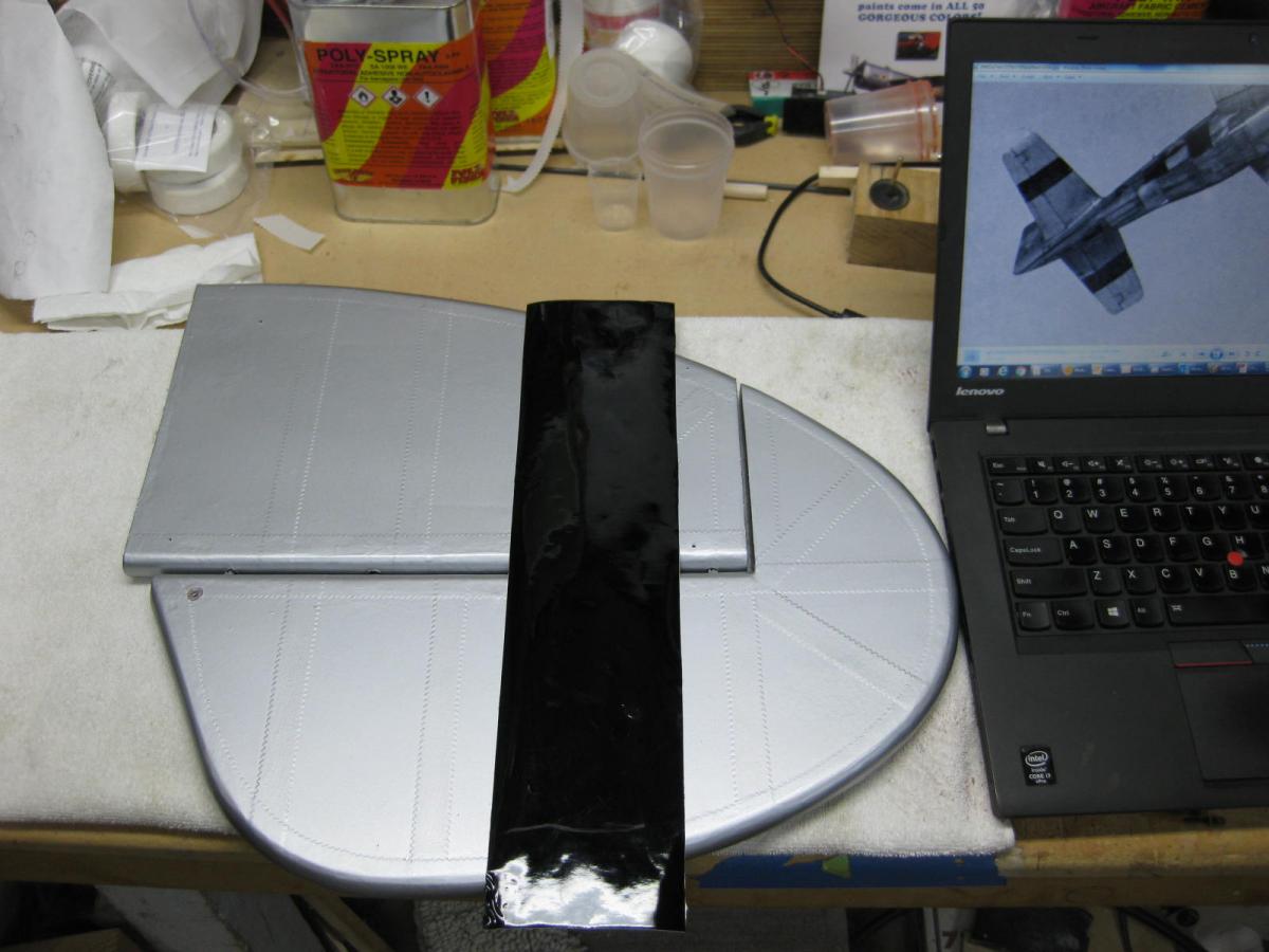

          Of interest, I found that if I use some Freezer paper ( waxed on one side ) and an Iron set to 200 degrees, I can reseal and smooth out the Pinked tape edges that lifted a little without damaging the surface.
          Scott
            You can also use the left over backing from vinyl, I use it on painted Solartex without effecting the paint!

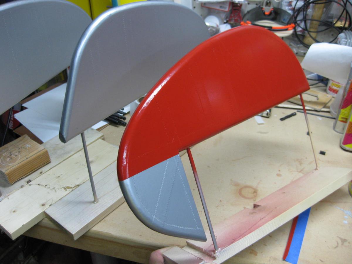

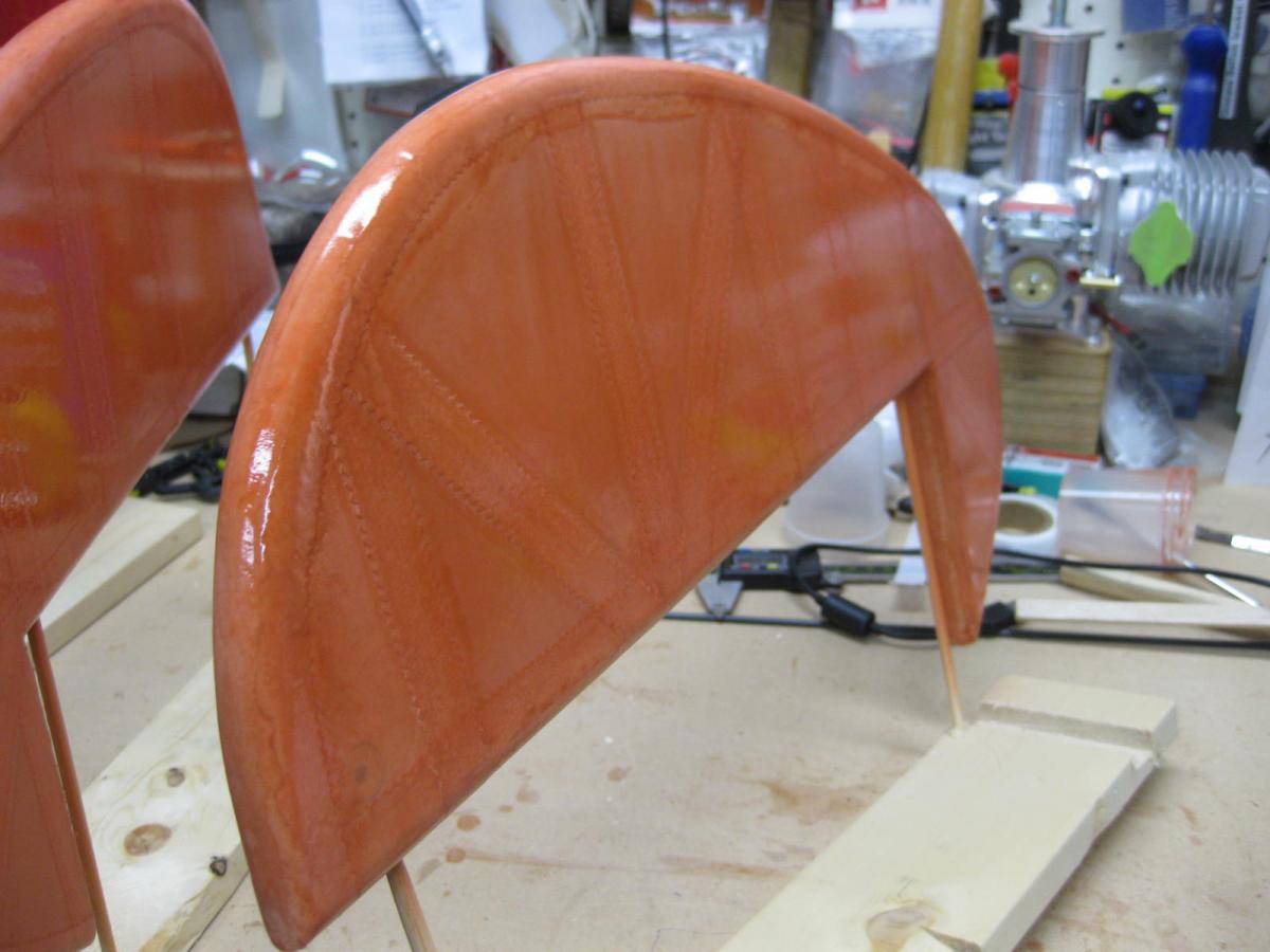

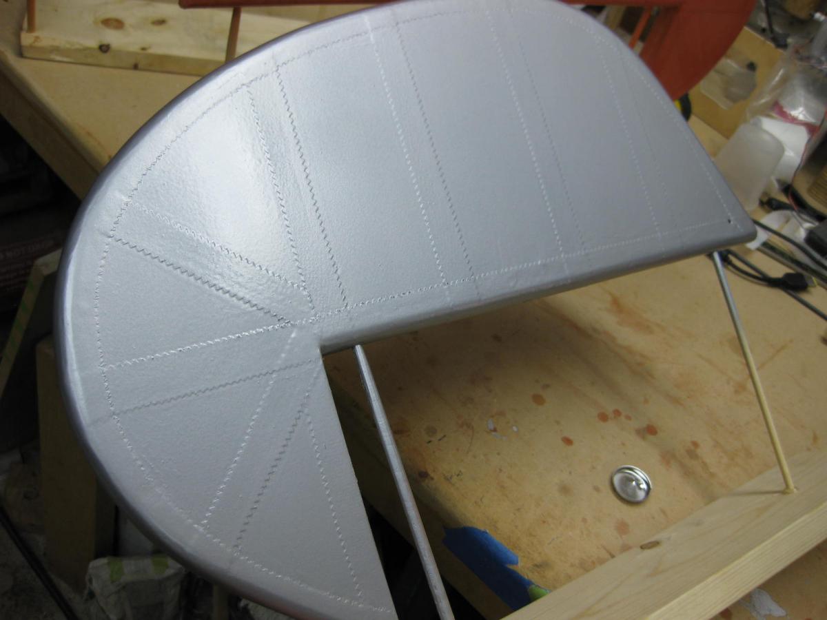

            And ....a splash of color...on the Rudder..........Poly-Tone Eagle Red.....and Nevada Silver
            Rudder final weight is 106 grams

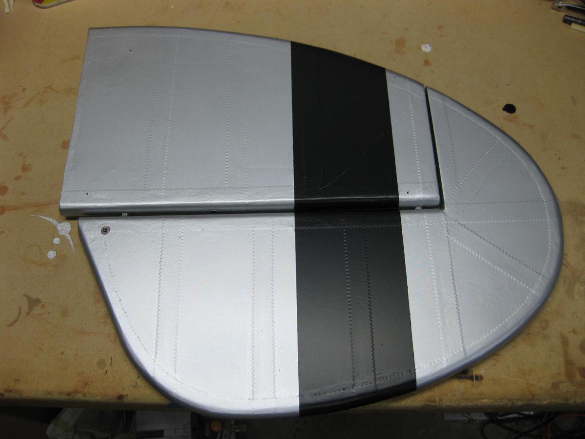

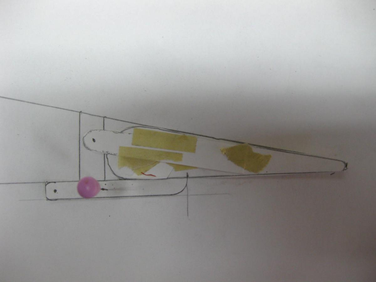

            Checking on ETO-band.....size and placement via "reference" material......
            Fresh paint.......
            and one side done....

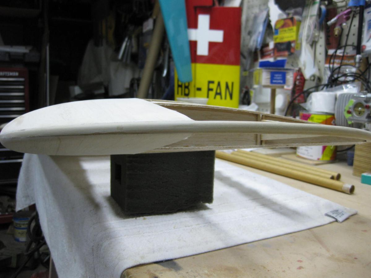

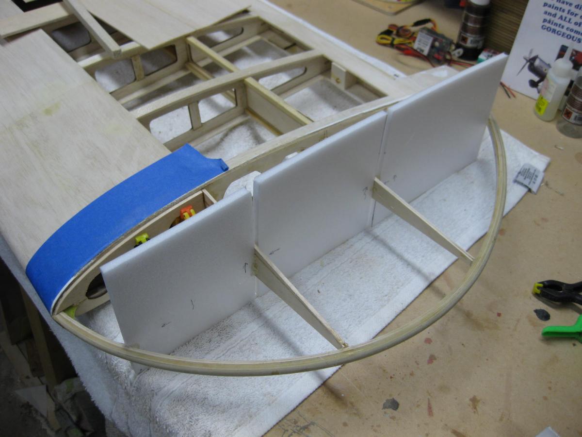

              While the Poly-Tone dries on the other half.....on to the wing. Tip bow cut and rough shaped...... a few clamps to see what it looks like
ID:	13638 Click image for larger version
              After thinning the trailing edge

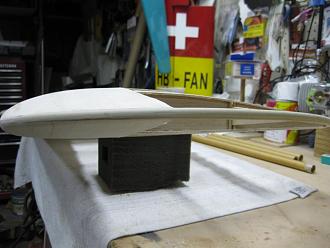

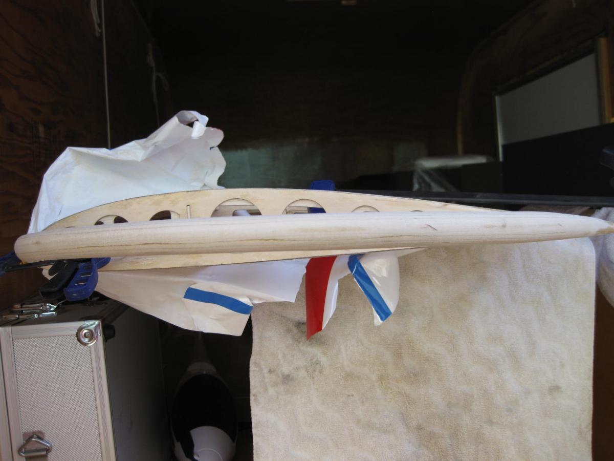

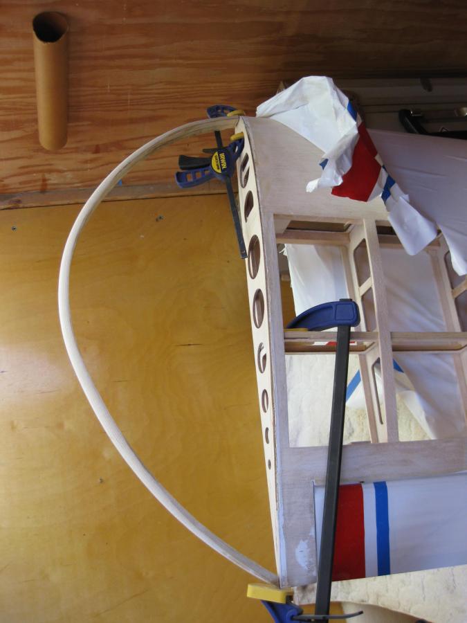

                minor modification to the tip bow- it was looking a bit too "thick" so the other bow that came off the form went through the band saw....10mm.....

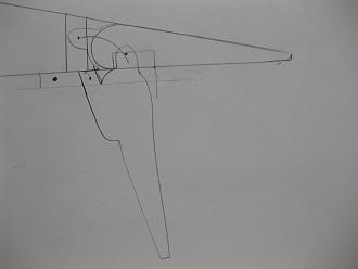

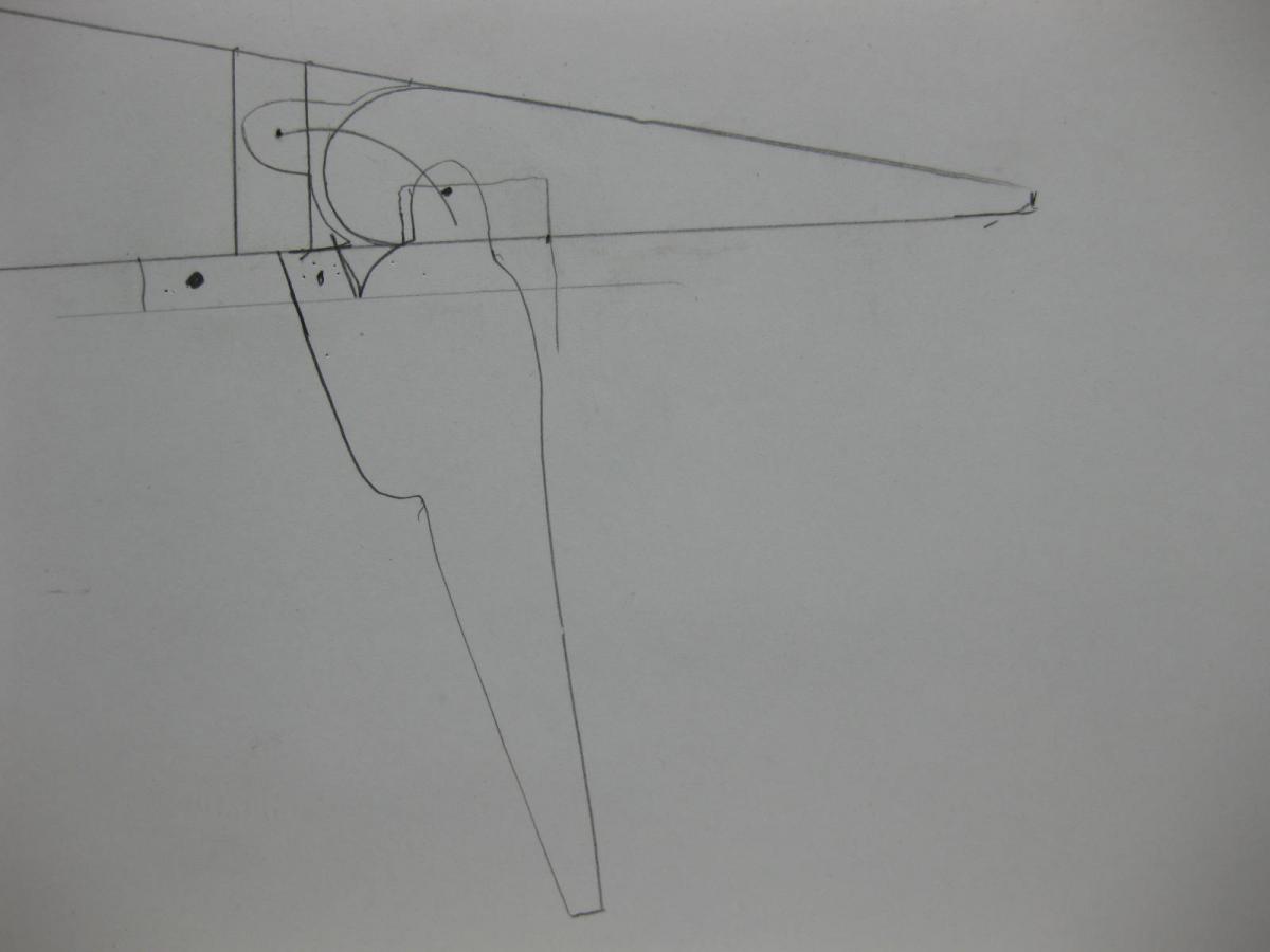

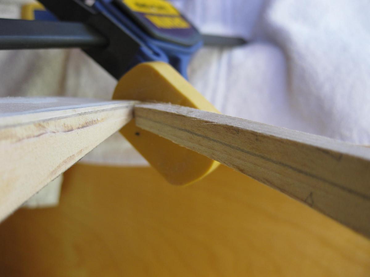

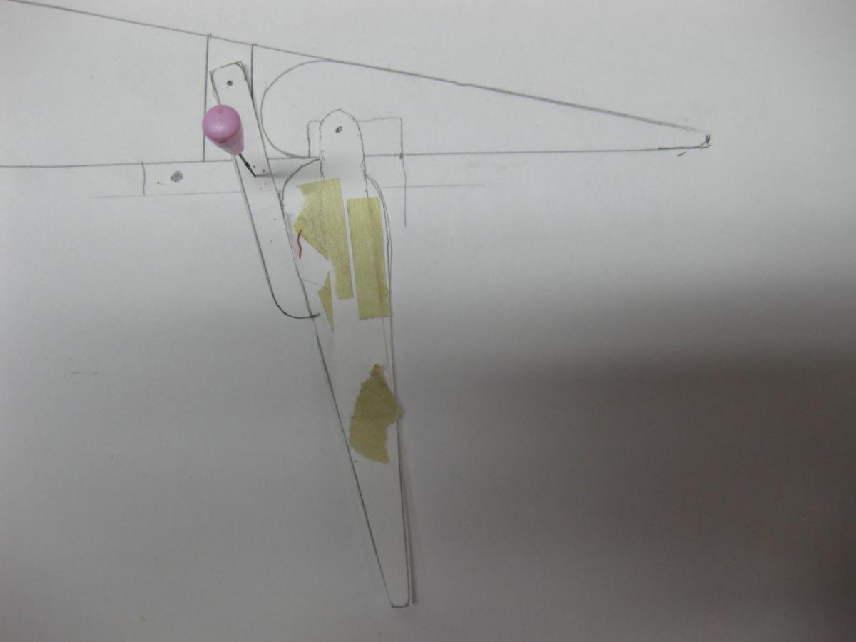

                Working on the flap reconfiguration to get more travel and top driven......70 degrees.....
ID:	13723 Click image for larger version
ID:	13724 Click image for larger version

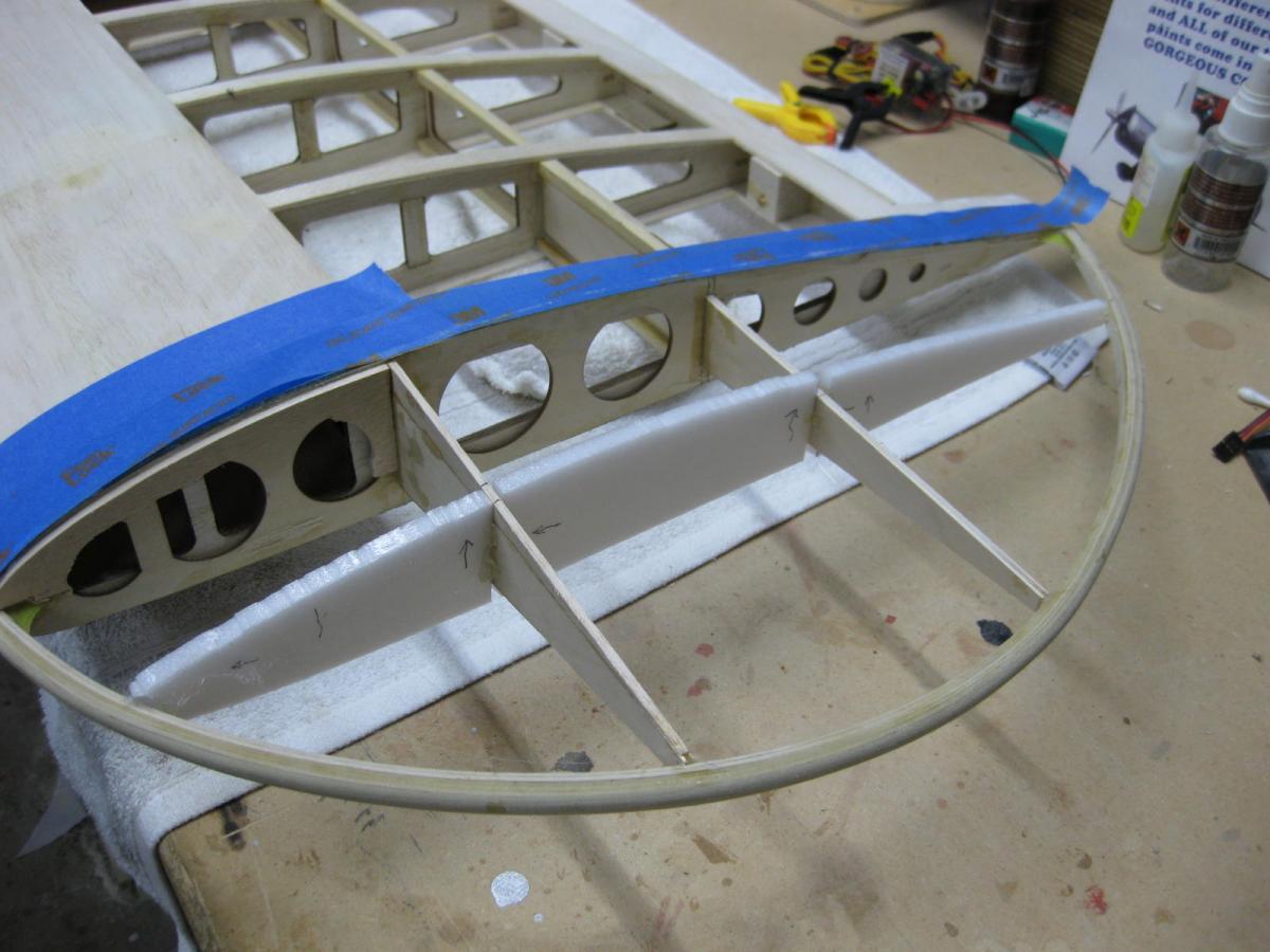

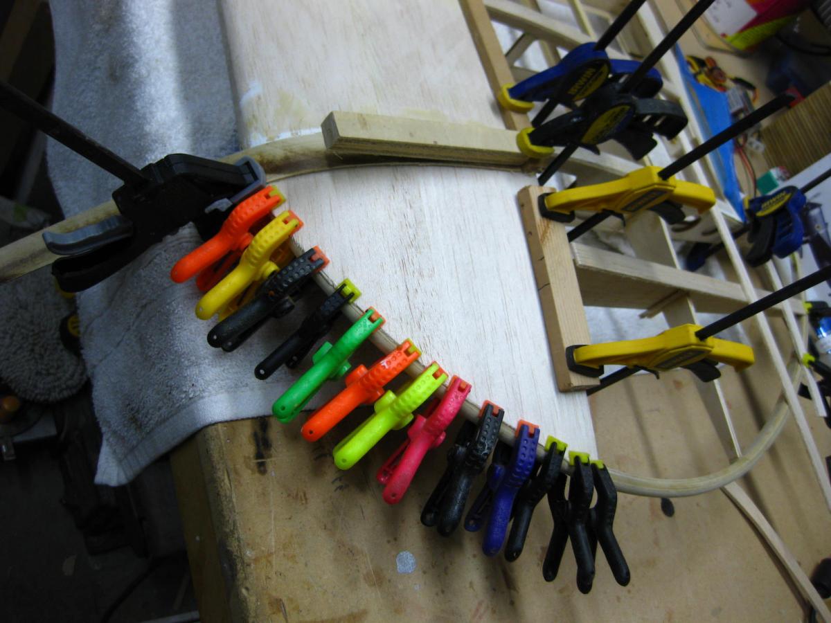

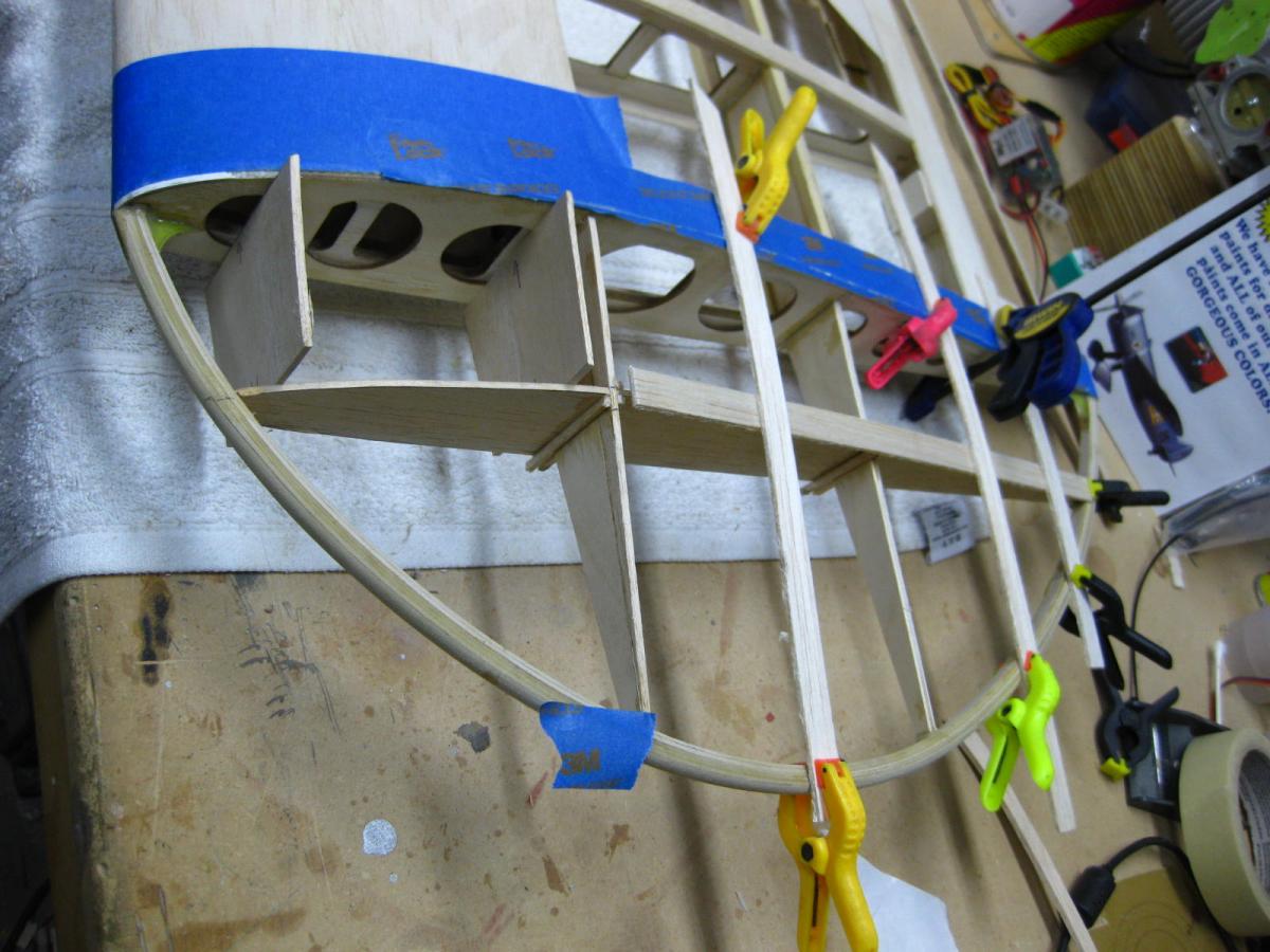

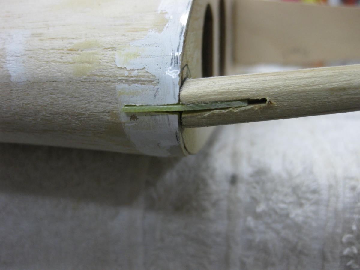

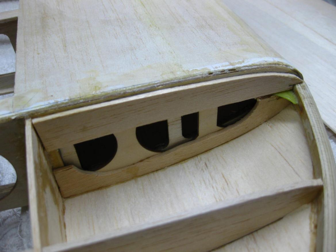

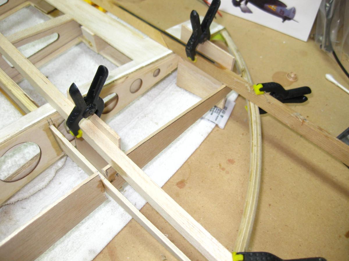

                  Wing tip progress with the thinned bows - pondering the sheeting process of the forward section and center rib.....0.040 G10 bow reinforcement .
ID:	13779 Click image for larger version
ID:	13780 Click image for larger version

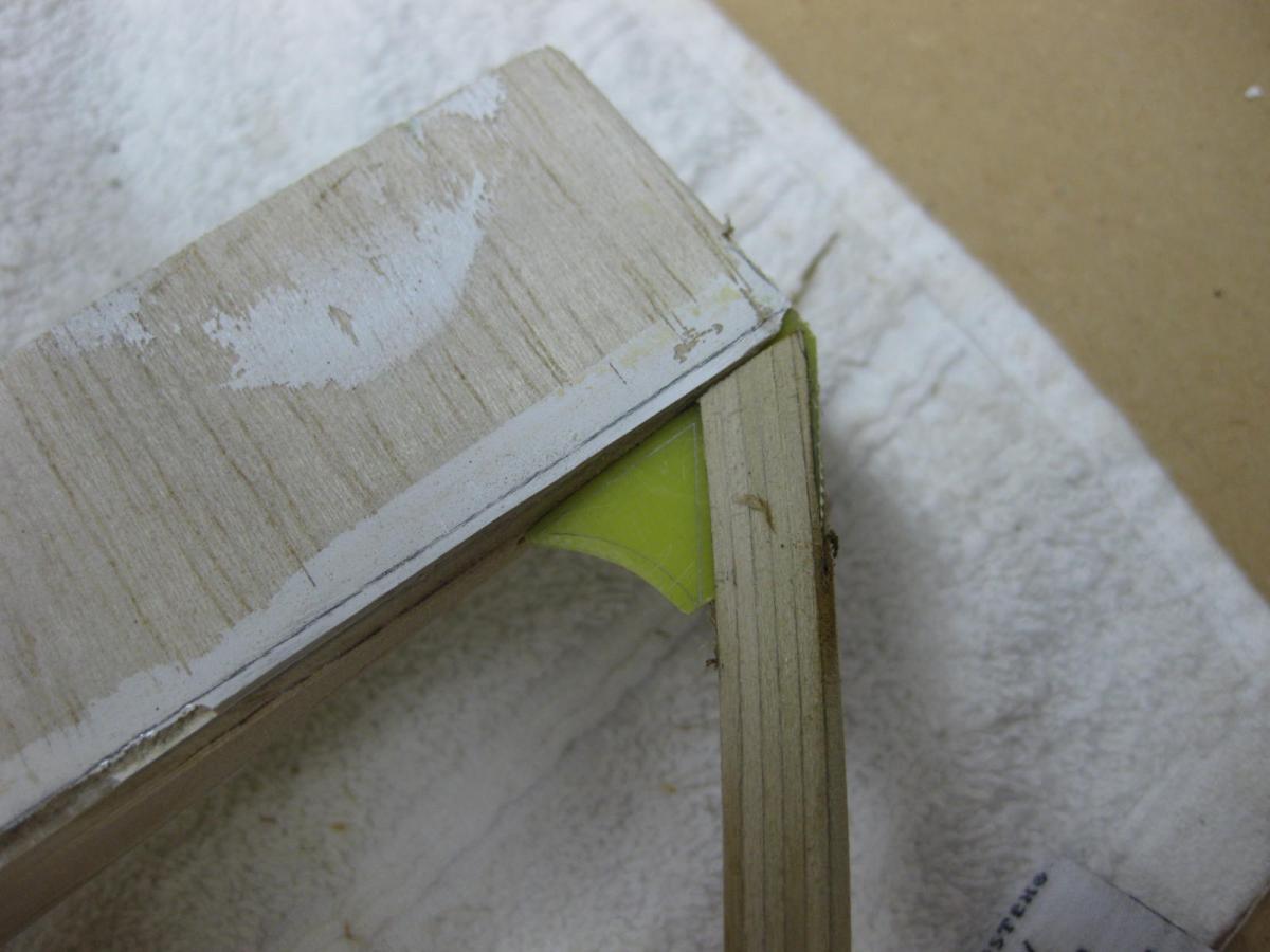

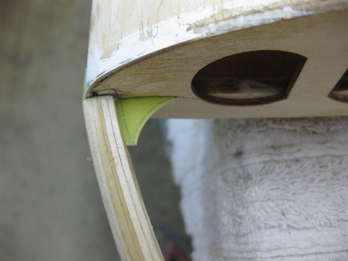

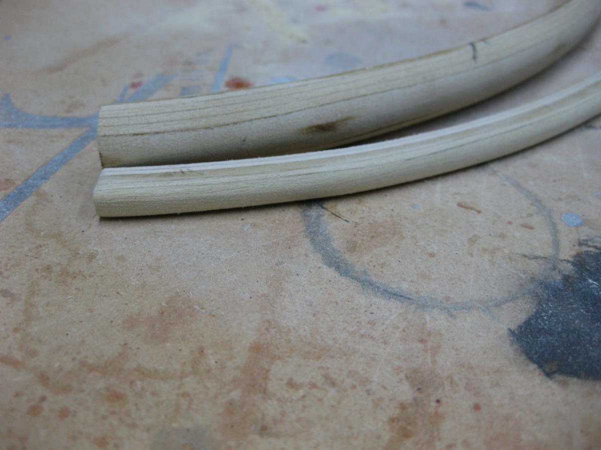

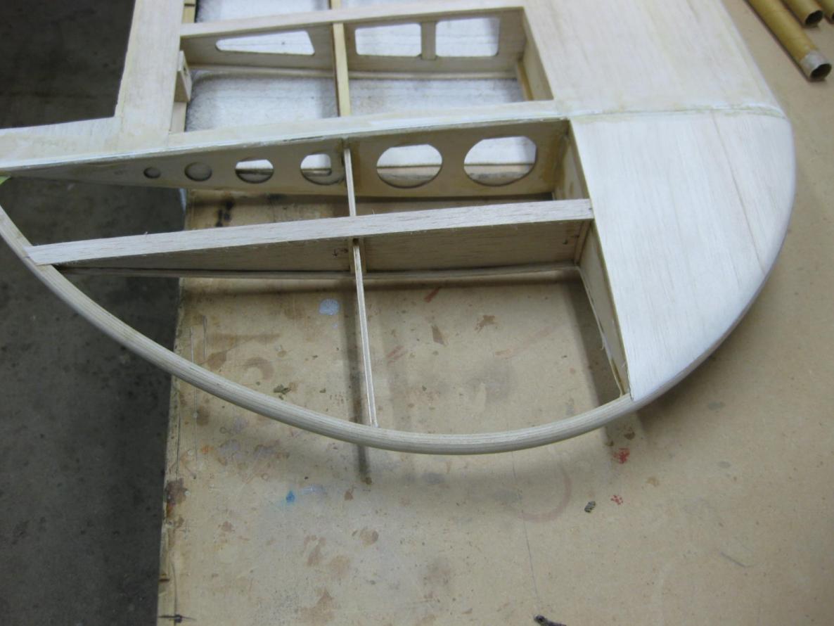

                    Got stuck on the tip bow ribs and how to cut/sand them to shape......settled on the hotwire version.
ID:	13981 Click image for larger version
                      Now that is a slick idea!

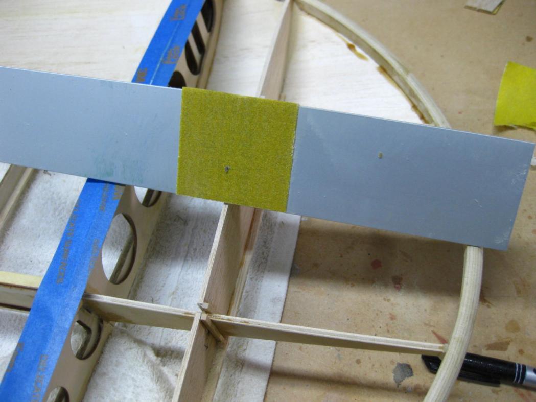

                    Lookin' good! I love the looks of the fabric. I think you have it covered () but to help with sheeting the tip slide your sand paper off the 'T' sander a bit and let the naked end glide along the rib. That'll give you a nice transition at the bow end for the sheeting to lay.
                      Hi Mike,
                      Thanks for the Tip... tip. Now I just have to get out the VM/P Naptha solvent to get the old sandpaper of the bar

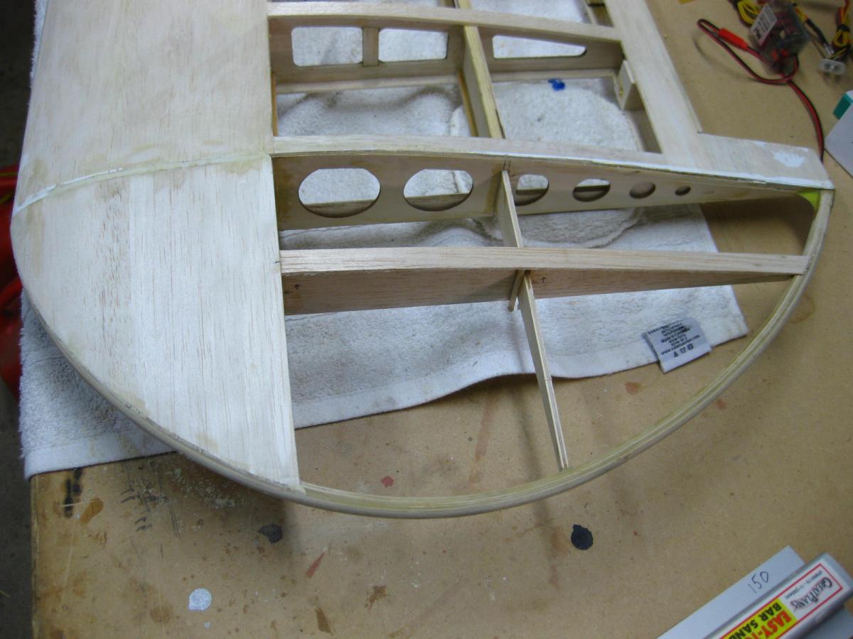

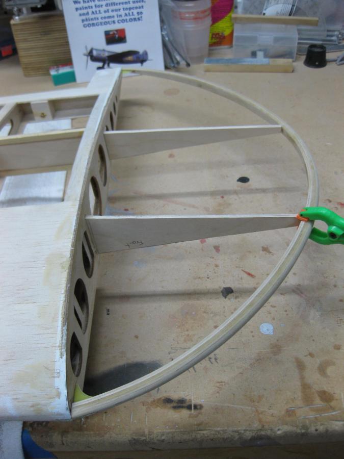

                      Used two alignment guides/spacers for gluing the ribs on square. Ribs are 3/32 balsa
ID:	14017 Click image for larger version
ID:	14020 Click image for larger version

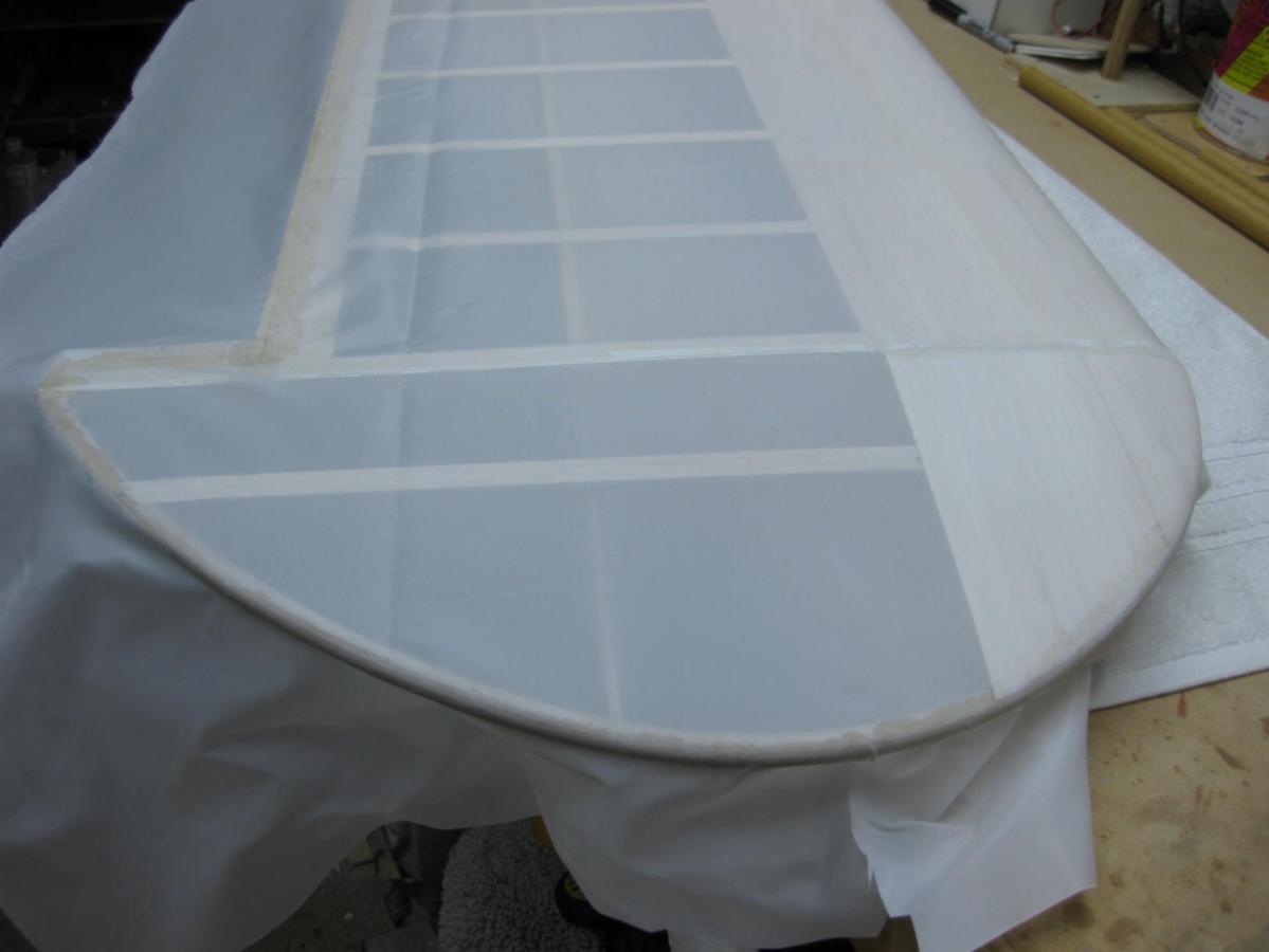

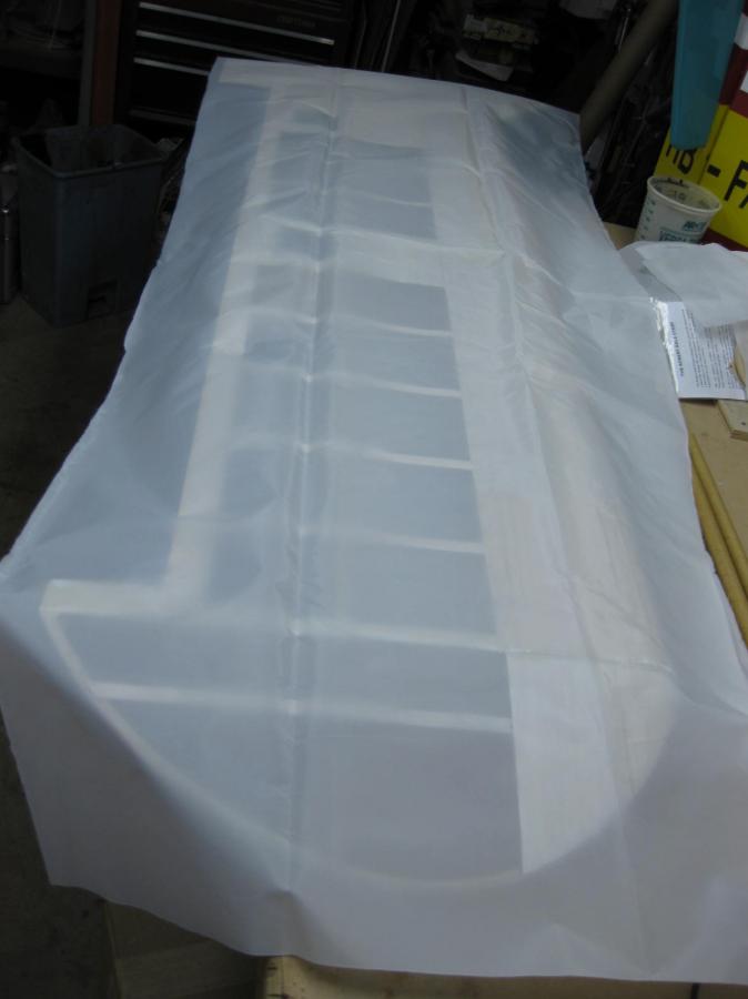

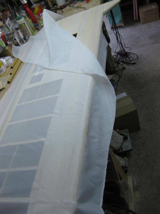

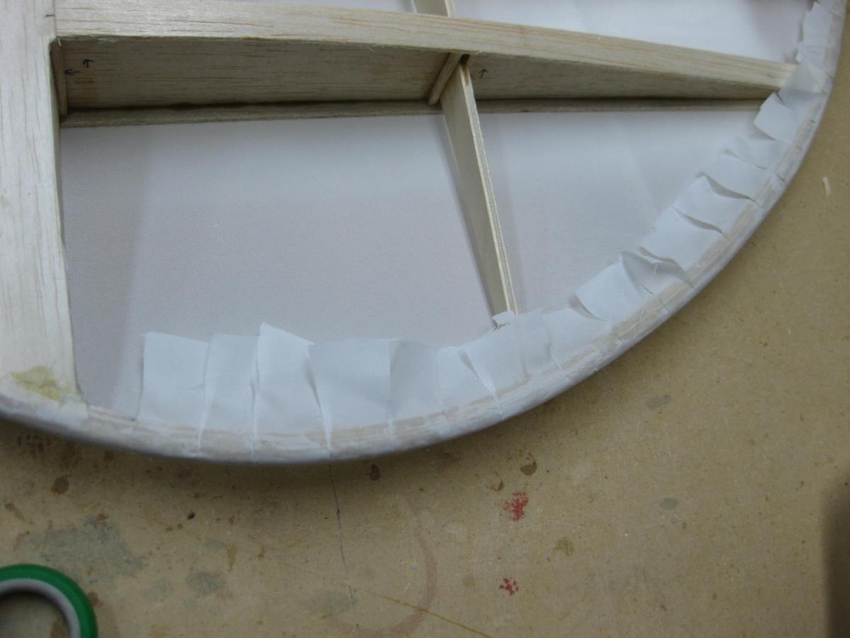

                        Looks like its time for fabric.......
                          Fabric, Poly-Tac.........and endless hours of peeling the glue off finger tips.
ID:	14086Click image for larger version
