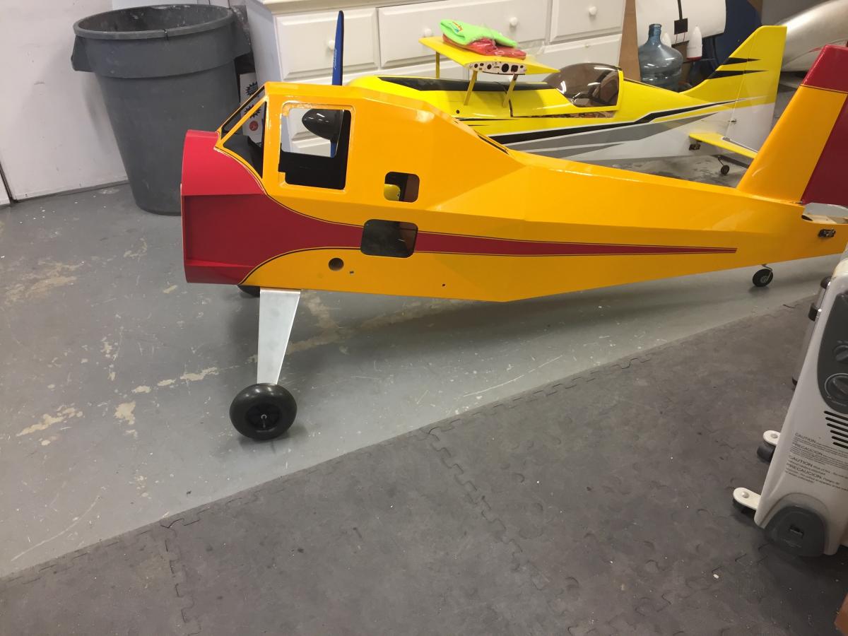

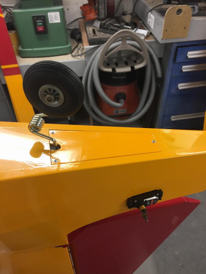

          Tail wheel setup, the servo driving the wheel is inside the tail.

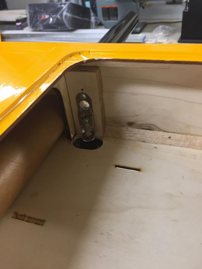

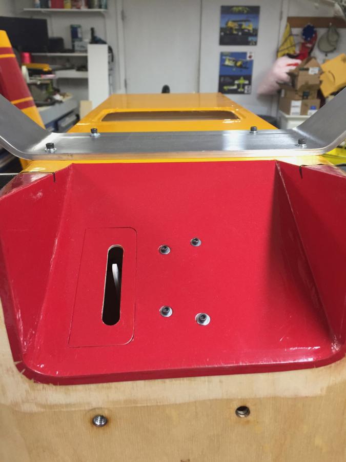

          Snap Latch installed for quick and easy field setup. After chatting with Jim, we decided the best access will be through he inside of the cabin, next to the fuel tank.

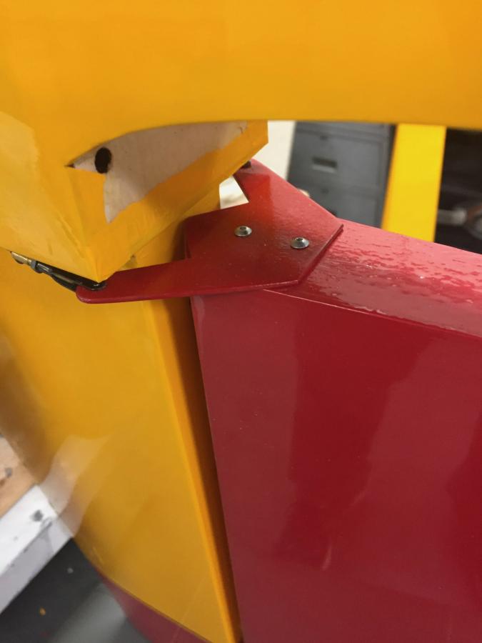

          Rudder horn was painted red to match.

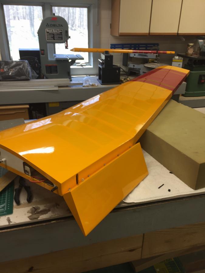

          Flaps are MOVING!!!!

          Servo for the throttle. Easy to remove with 4 bolts, remember to keep the plane light. Peter says it needs tail weight, so no extra stuff in the nose

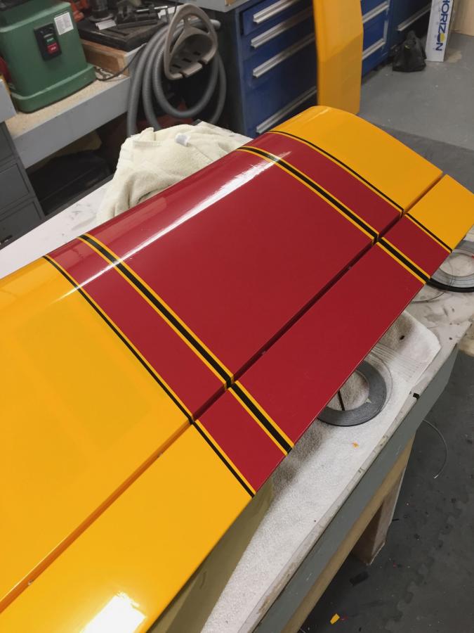

          Pinstripe, pinstrip and more pinstripe

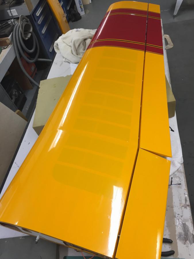

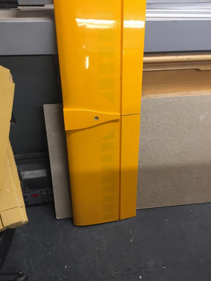

          Finished wing panel. ( almost) I have to add the wing walk tape and maybe LE de-icing boots

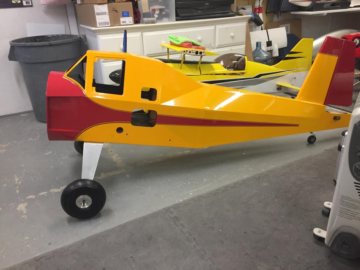

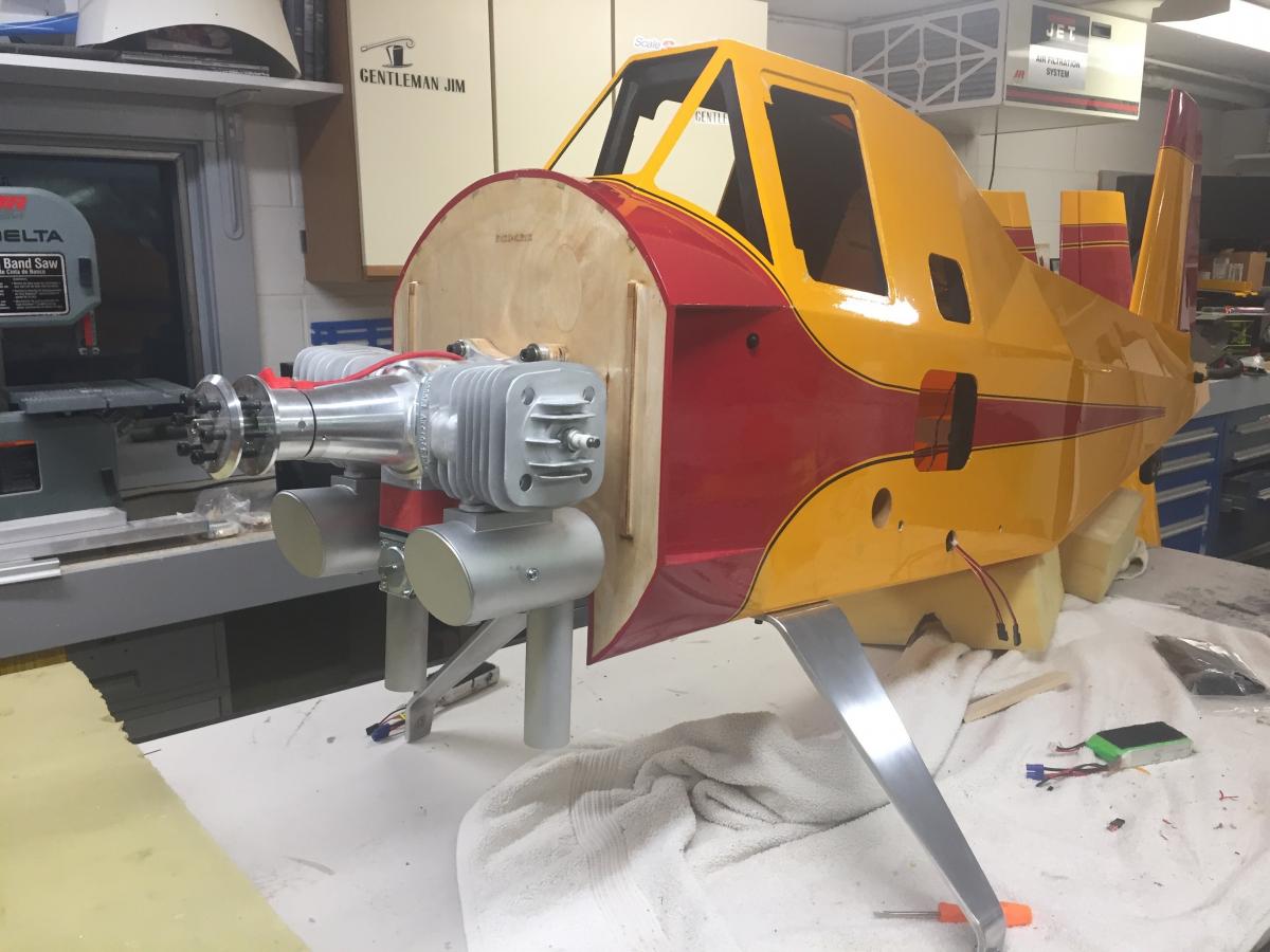

        • #51
          Click image for larger version  Name:	IMG_8703.jpg Views:	1 Size:	97.7 KB ID:	25853
          THIS IS A 6" WHEEL......
          Click image for larger version  Name:	IMG_8704.jpg Views:	1 Size:	106.6 KB ID:	25854
          THIS IS AN 8" WHEEL
          Click image for larger version  Name:	IMG_8710.jpg Views:	1 Size:	106.1 KB ID:	25851
          DA 150 ready to pull
          Click image for larger version  Name:	IMG_8711.jpg Views:	1 Size:	51.8 KB ID:	25852
          Since the DA150 has a low tone, unlike the DA 100 and especially the 120, I'm going to try just can mufflers. We were paying attention to Peter's plane during the event last fall and it sure seemed pretty quiet. Of course my ears could have just been damaged from listening to Kevins Pawnee.

            Looking good, Len. Should be a “stump puller” as we say down south.....
            • #53
              Awesome Len...glad you mentioned the wing fastener gig...I still can do that yet...once again, you have inspired me to keep going on this build...
              • #54
                I dont know? There was an awful lot of talk about making cans mandatory. We want quiet so we reduce the chances of annoying neighbors! Also it looks like you need 7" wheels.
                • #55
                  I'll be flying the quiet Pawnee at Windy Ridge, we just instituted a noise limit... I don't think your Smelly Yak will pass!
                    What? What? I can’t hear you over your tow plane.
                • #56
                  I knew I would bait you two in!!! Mahwahahahah
                  ill put the 150 on mufflers against the 120 on canisters any day
                  Kevin, did you get the bill I sent you? It was from my hearing specialist.
                    Put the letters 'G-O-T-C-H-A' on the side of your Smelly Yak! Like on the AT-6 race plane! lol

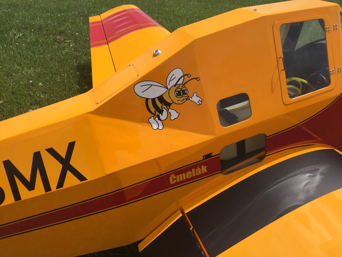

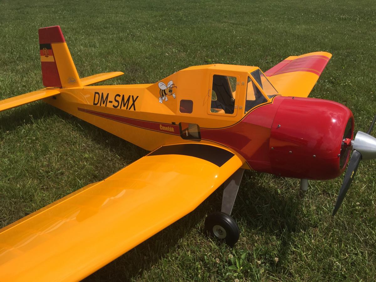

                  • #58

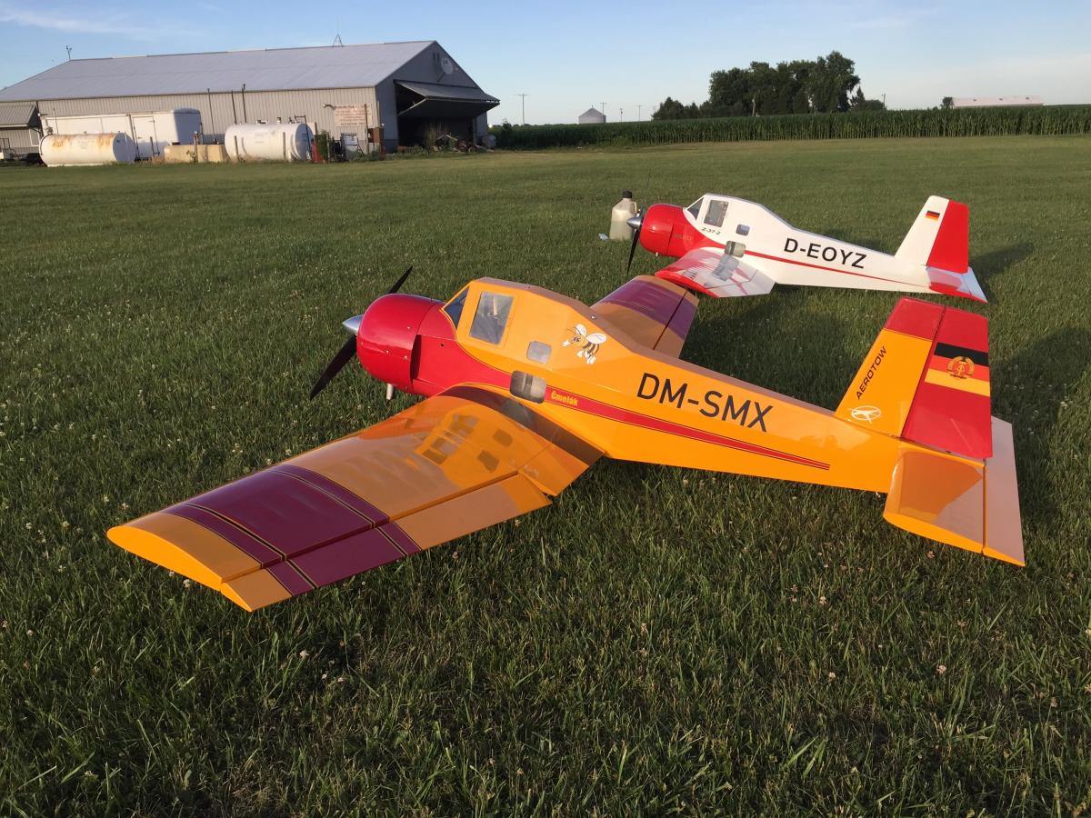

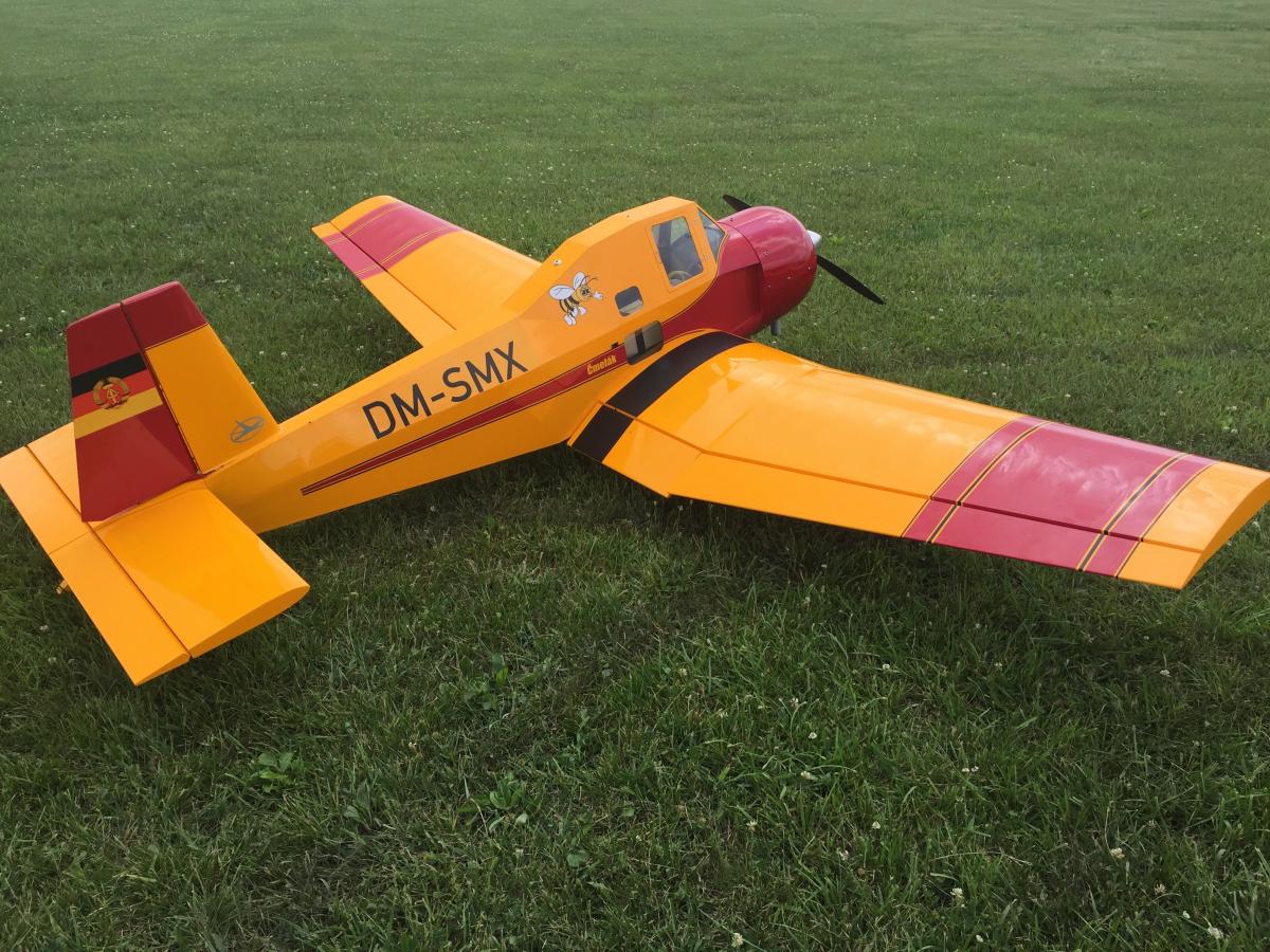

                    Pete says it was his own airfoil that started life as a Clark Y\
                    Plane flies fantastic, it towed for about 10 hours at the recent Horizon Hobby Aerotow.

                      The wing fastener was a FAIL.
                      No mater how loose or tight we made it, the think kept coming loose and eventually I just put a bolt in the wing.
                      Like Peter says, the harder to put the wings on, the harder for them to fall off.
