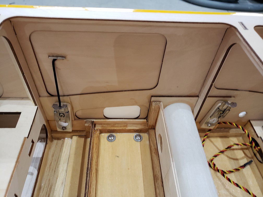

                  Moving along with this build...

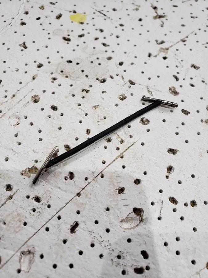

                  I finally found a use for those little elastic garters that hold servos to the cardboard backing.
                  These guys....

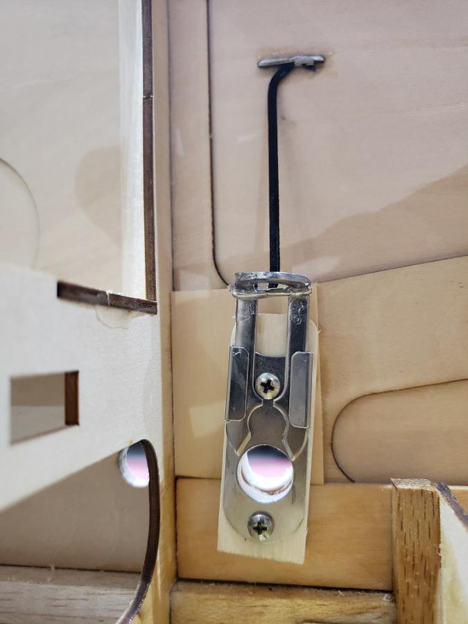

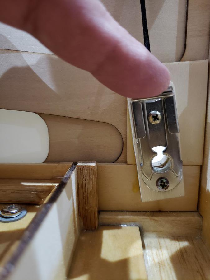

                  I present to you....a little helping hand for installing your wings when you use the MC latches.
                  Just a light push down to latch. I spaced the elastic height so it is basically just holding the weight of the slider. Very little actual pulling force.
                  I only installed them on the aft latches.
                  If you notice, I angled the latches slightly forward to aid in reaching them from the front of the airplane.
                  More tomorrow....
                  Blake

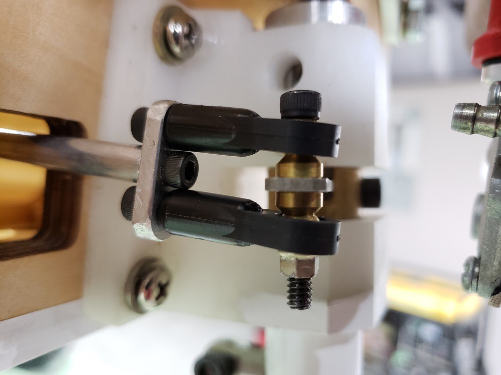

                    I reworked the internal threads of the pushrod to accept the 6/32 socket head bolt and Loctited it in place. I also used an MS aviation metal locknut on the vertical bolt. The rodends are the 6/32 Monster ones as Jim suggested to use. I cut the upper rodend a bit shorter to achieve the angle needed for slanted steering arm. Works like a charm,and no binding when cycled through it's range of travel.

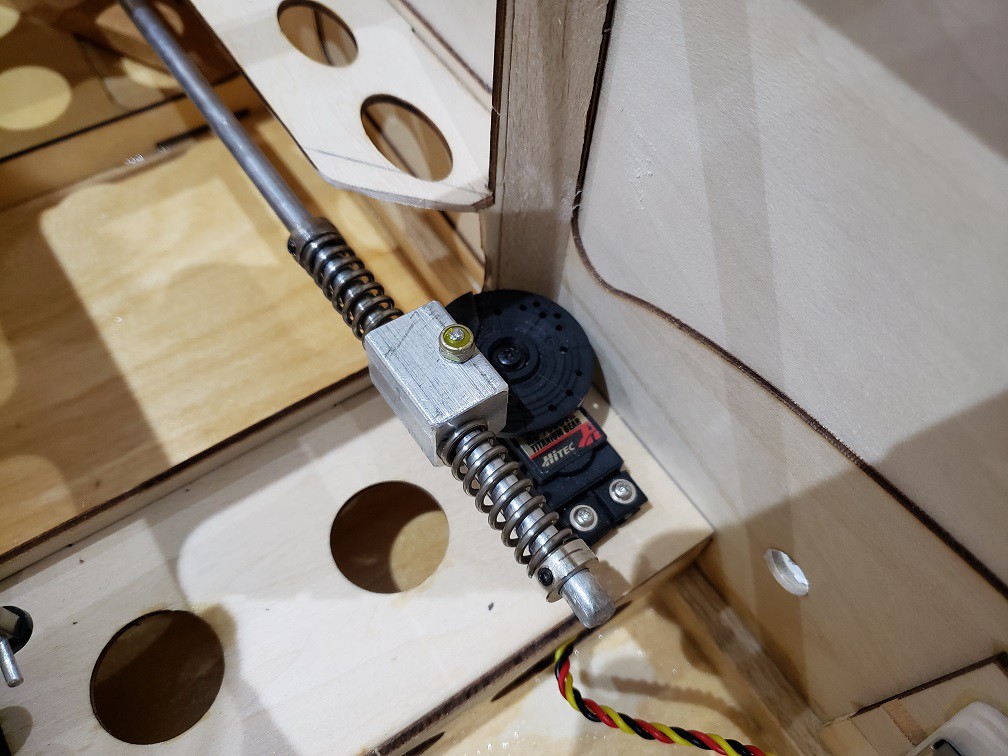

                    At the servo end of the nosegear setup I don't know how much preload to put on the springs, so right now they are just snug against the block and wheel collars. Can someone chime in and offer what they have done please! I did push the fuselage back and forth the length of the workshop to get the steering centered.

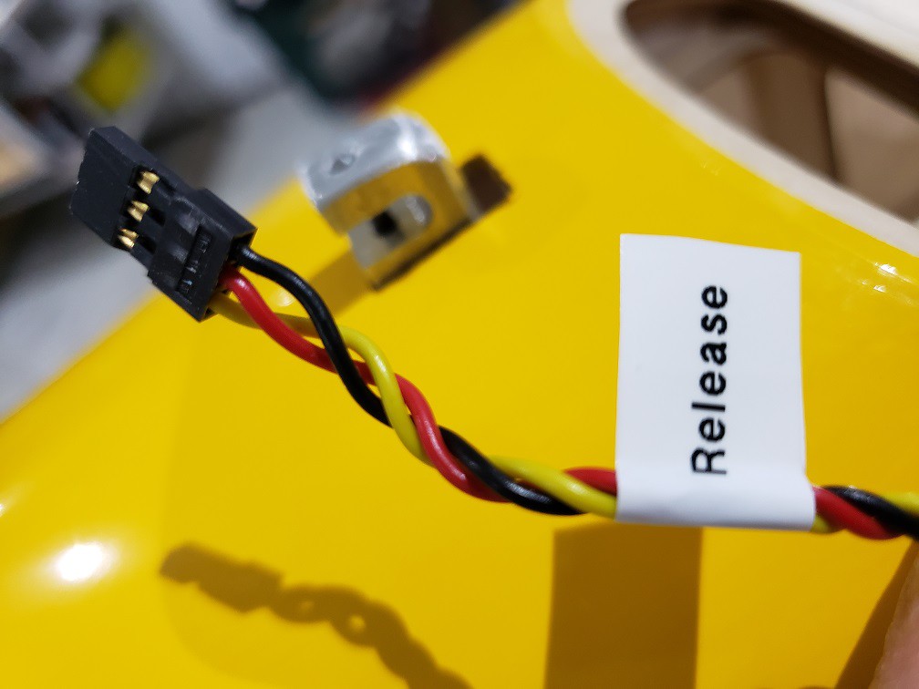

                    Just a side note, Santa brought me a nice label maker so I tried it out today. Sure looks a lot nicer than masking tape and a felt pen!
                    So I finished off today with both the nosegear and throttle hooked up and operating. The choke servo is next to go in, so that will be tomorrow's job.

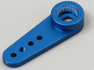

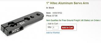

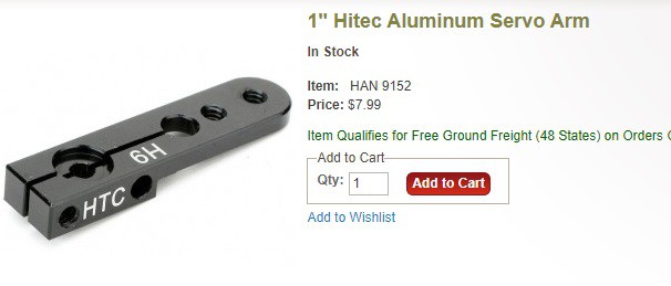

                      Nice! The new style nose gear set-up works well. You will need a better servo arm than the one shown as even with the springs, the teeth in the arm will eventually fail from repeated shocks. Either use a heavy duty DuBro or go for metal. I'm using a Hangar 9 metal arm for two years and several hundred event tows with zero issues after quickly eating a few plastic ones.
                  • Steve,
                    Thanks for the input.
                    Is this the arm you were talking about? 1" in length or the longer 1.5" arm?
                    Do you see anything else in my build that is questionable?
                    Blake

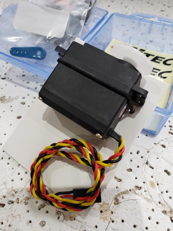

                    • Or can I use the standard metal arm that came with the servo?
                      • Blake,
                        Use the blue horn shown in Post 99. It is metal
                        • Steve K
                          Thanks, I have a bunch of those on hand so I will use one of them.
                          Blake

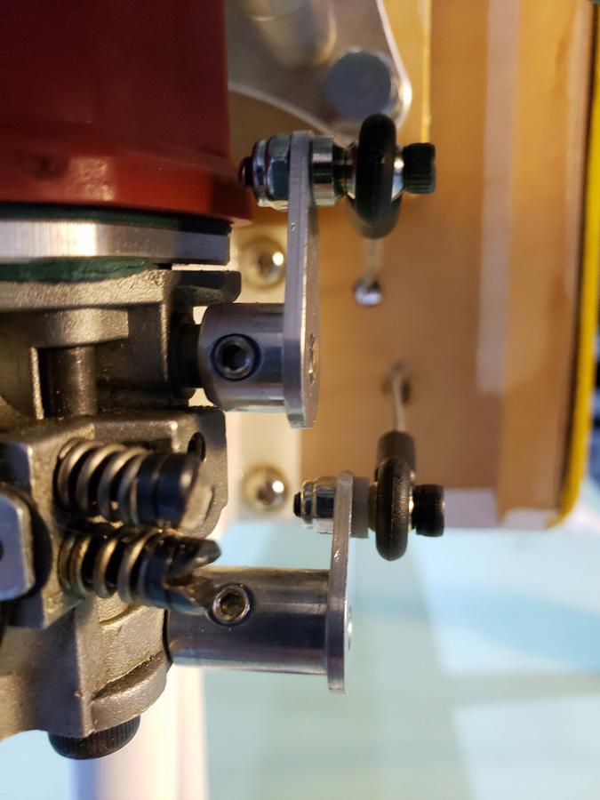

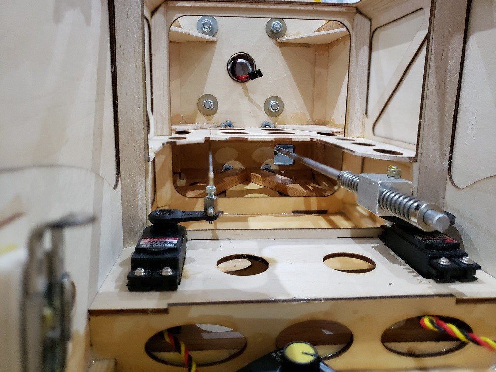

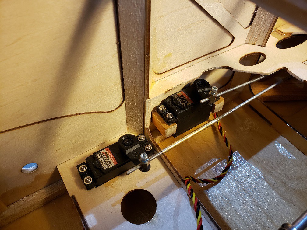

                          • While I'm waiting for the Viton fuel line to show up, I continued on with the engine control hook ups, namely the choke.
                            I glued a thin plywood doubler on the side of the fuselage before mounting the servo there. And I checked the clearance of the throttle linkage before committing to placing the servo where it ended up.
                            Pretty straight forward installation. Should be, as I just copied what Jim did in his build...LOL!
                            Click image for larger version  Name:	20200102_160950.jpg Views:	0 Size:	233.2 KB ID:	39344
                            Good clearance of the linkages from the carb and exhaust areas. I used the PSP throttle and choke arms, and they worked out very well. All of the fasteners and set screws were installed with blue Loctite. The throttle arm does not rub on the carb body, bad angle for the photo. I paid careful attention to eliminating any side play in both of the shafts.
                            Click image for larger version  Name:	20200102_160550.jpg Views:	0 Size:	55.4 KB ID:	39345

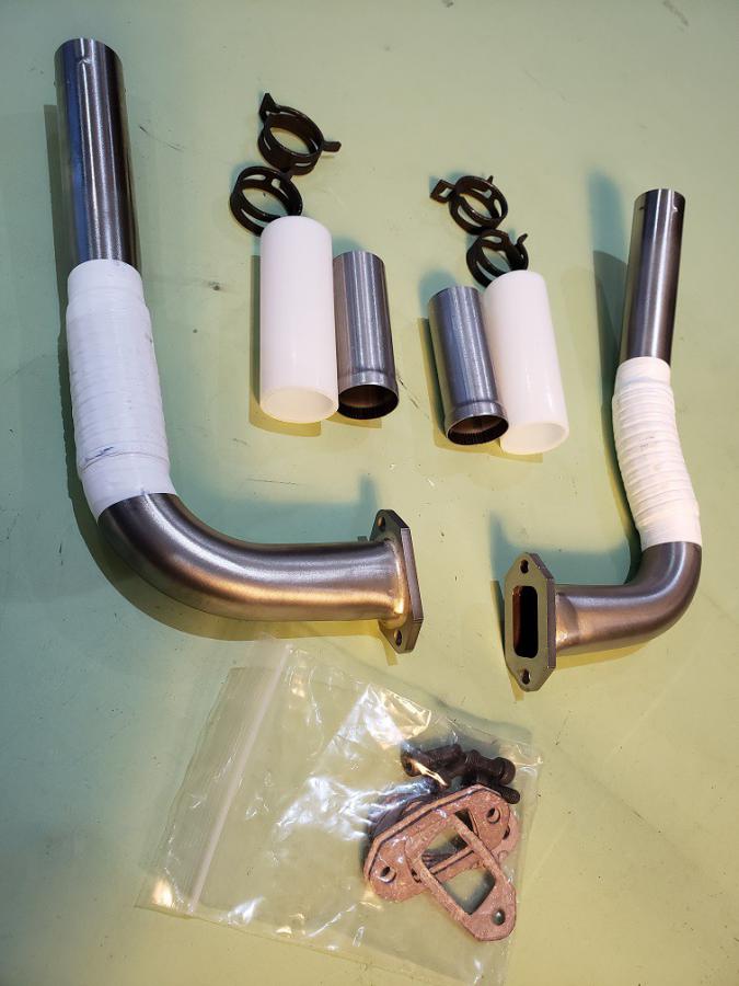

                            Then I got these guys out and started planning my way ahead with their installation. Any words of wisdom from anyone on what I should or shouldn't do...?

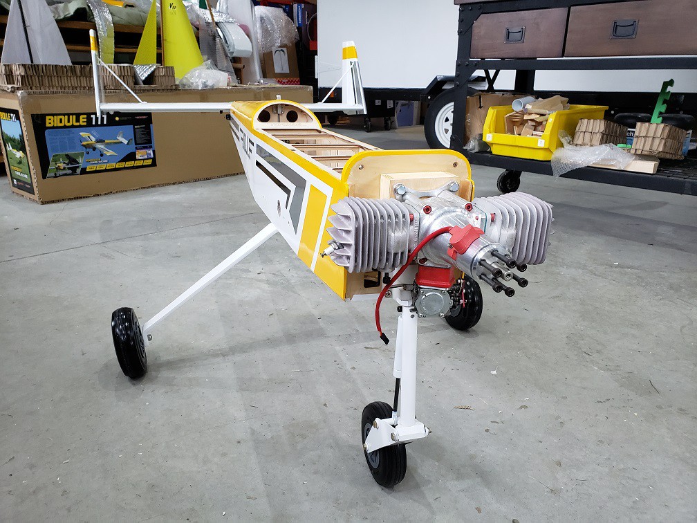

                            I don't think I will be getting Gunny's fancy extensions like Jim did. I will just cut the headers and weld in the little extension tubes once I measure the height needed for the exhaust canisters.
                            More tomorrow!
