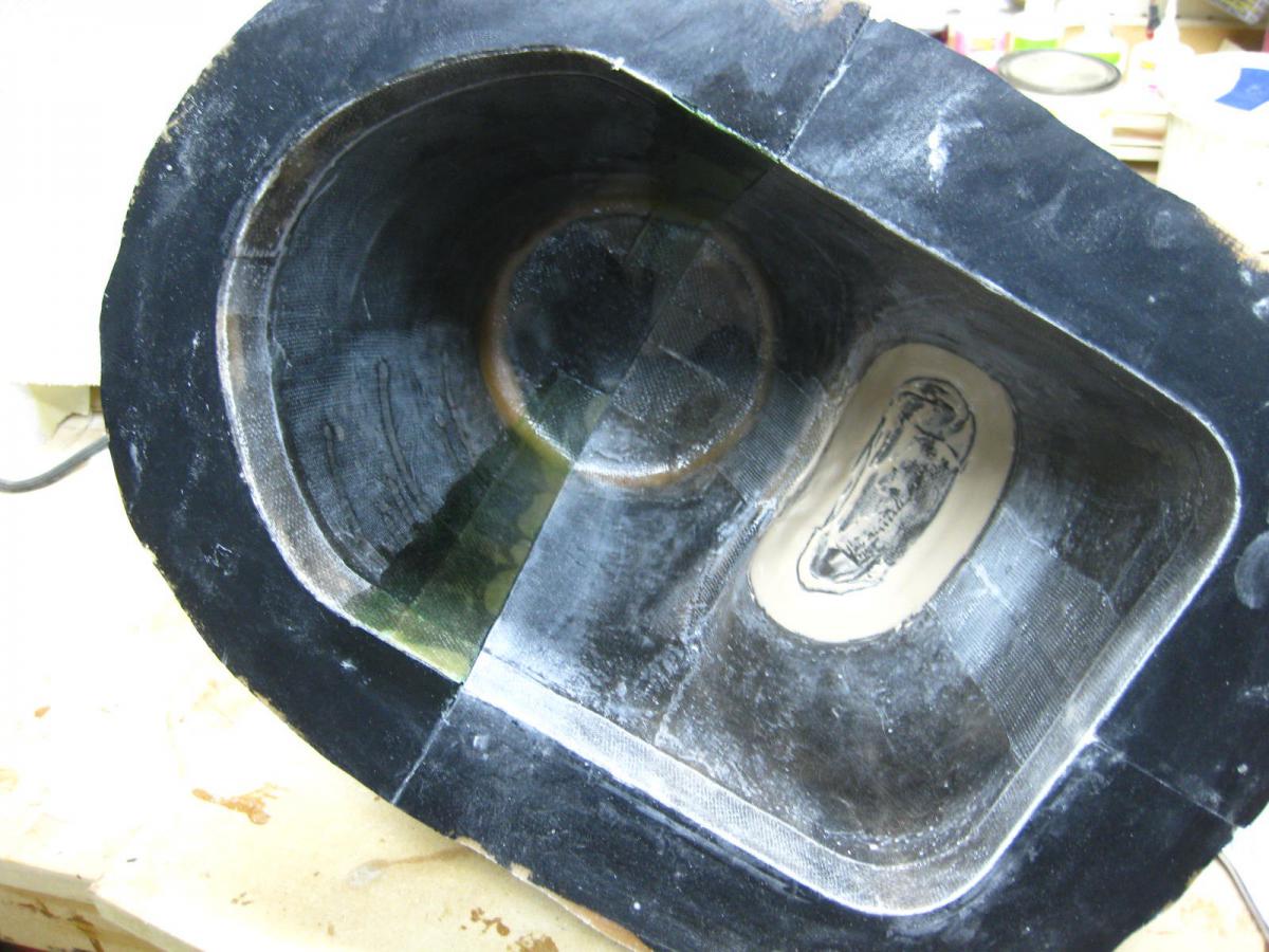

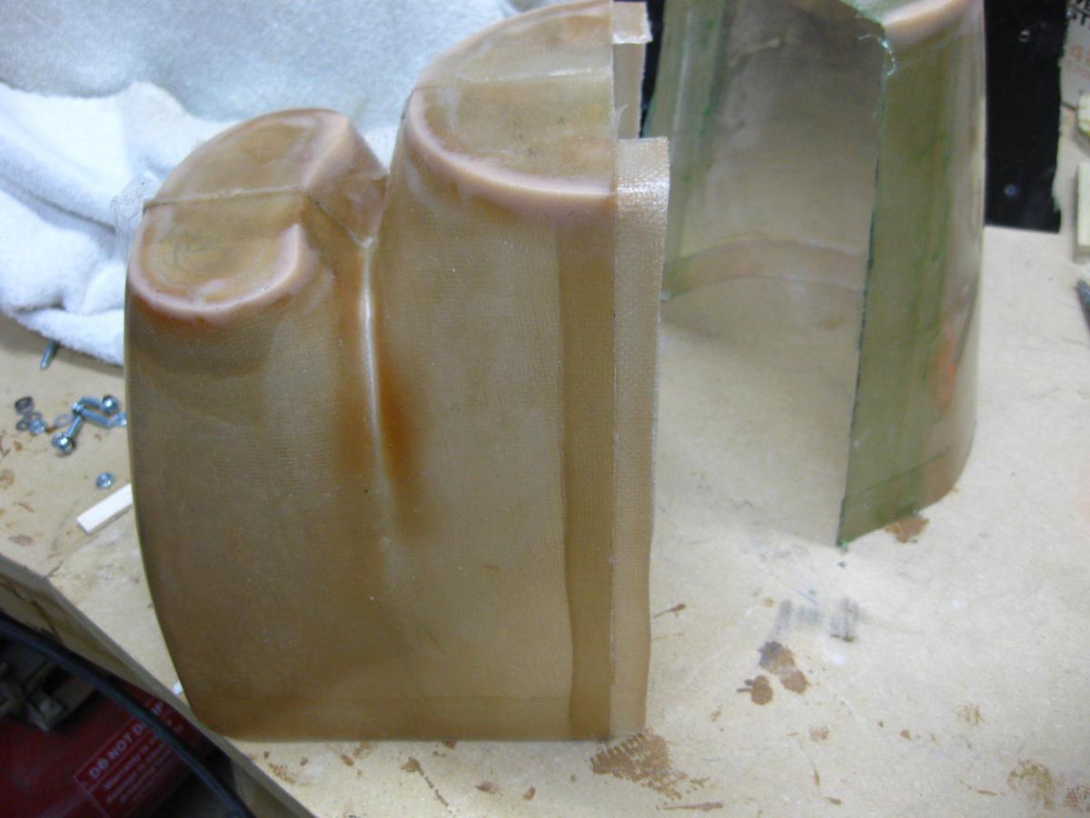

    Guys/Len, A few hacks ago, I believe there was a "how to" on cutting the top off a one piece cowl, adding fiberglass for new mounting flange to the top, and bolting the two piece back together around an engine that is too wide. I think it was done by Len B. but wouldn't bet lunch on it. It was for a tow plane of course, but I don't remember which one. Can anyone share how they have done such a modification? I hope so. Len, our new family member "Flynn" will be flying from Kentucky to our home in a couple weeks. Thanks for the assistance!

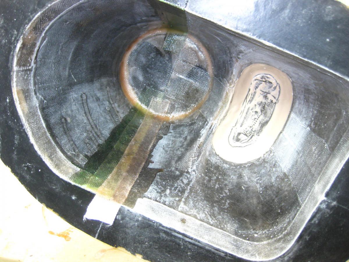

      Going with a split cowl and Ring mount so I added the divider (two layers of 1" standard fiberglass tape ( Partall Film #10 brushed on the top cowl )
ID:	44050 Click image for larger version
ID:	44049 Click image for larger version
